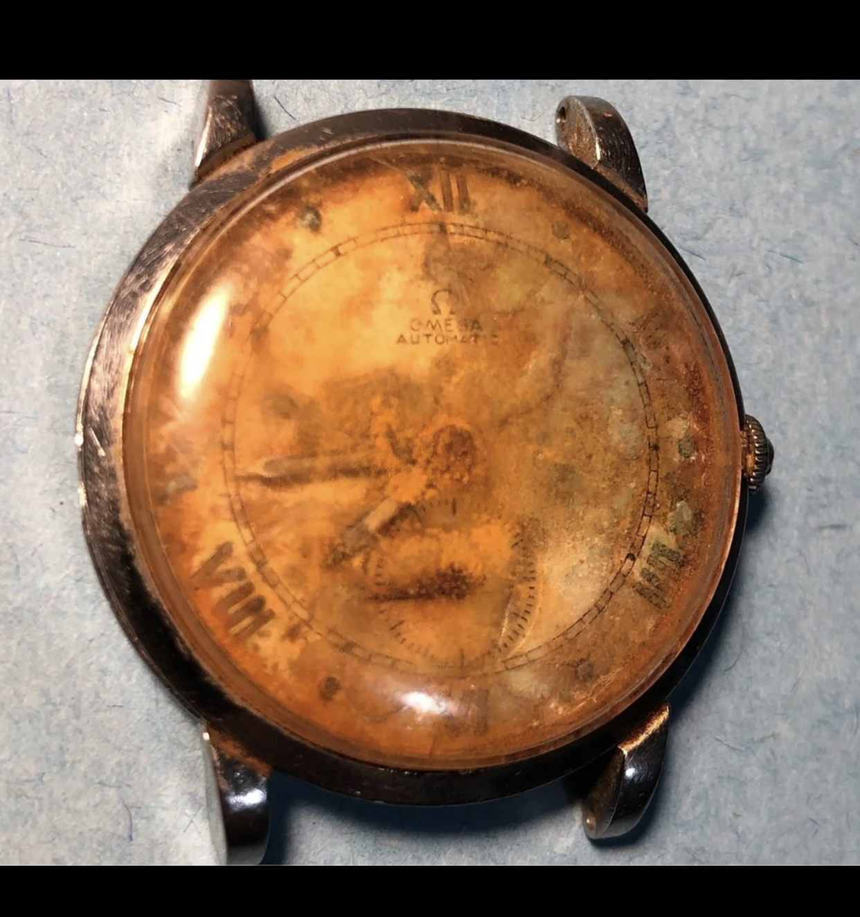

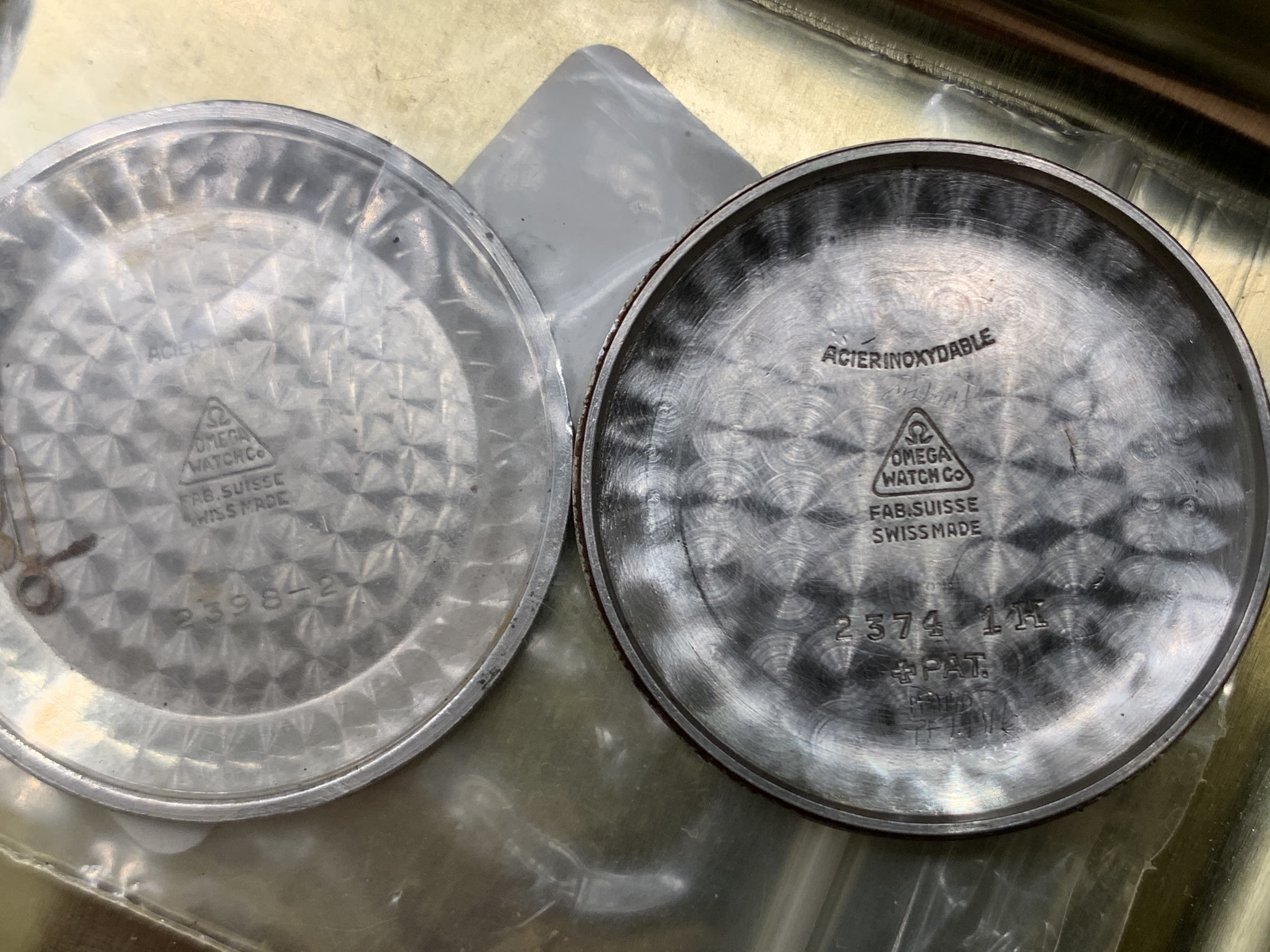

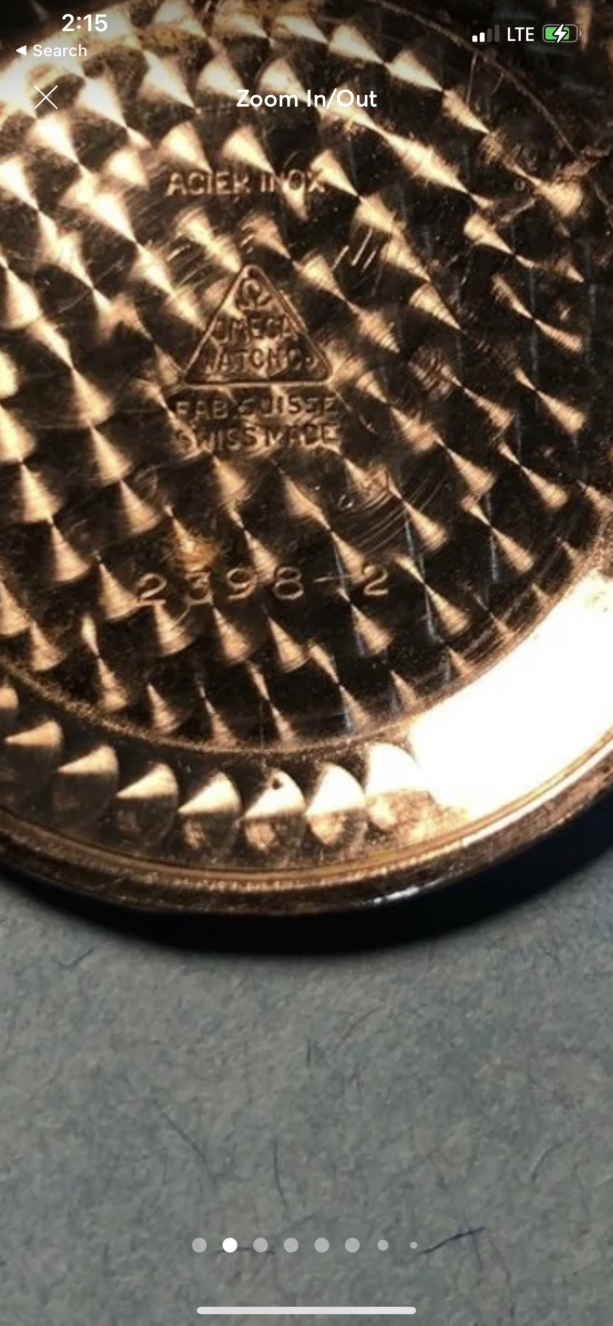

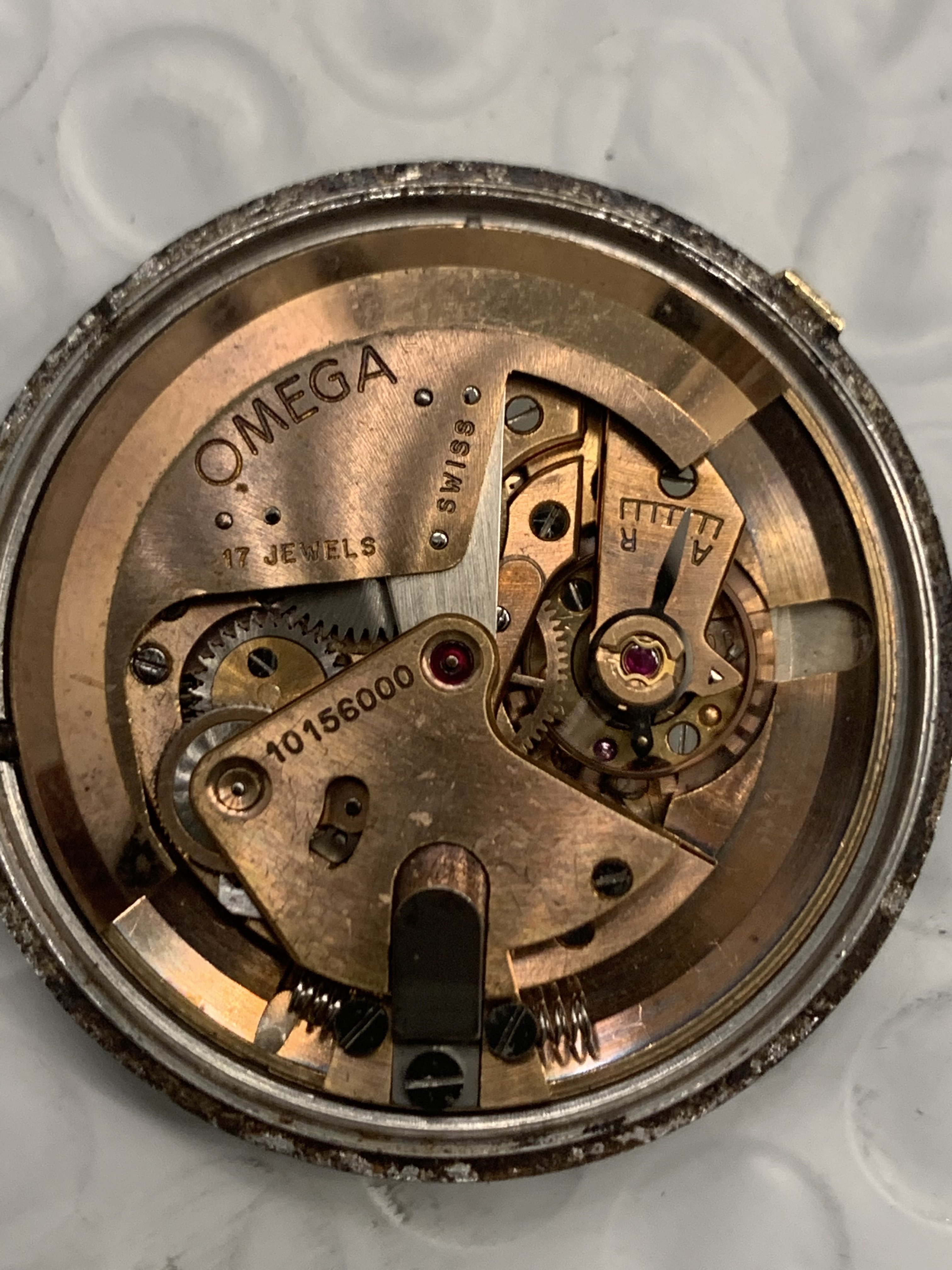

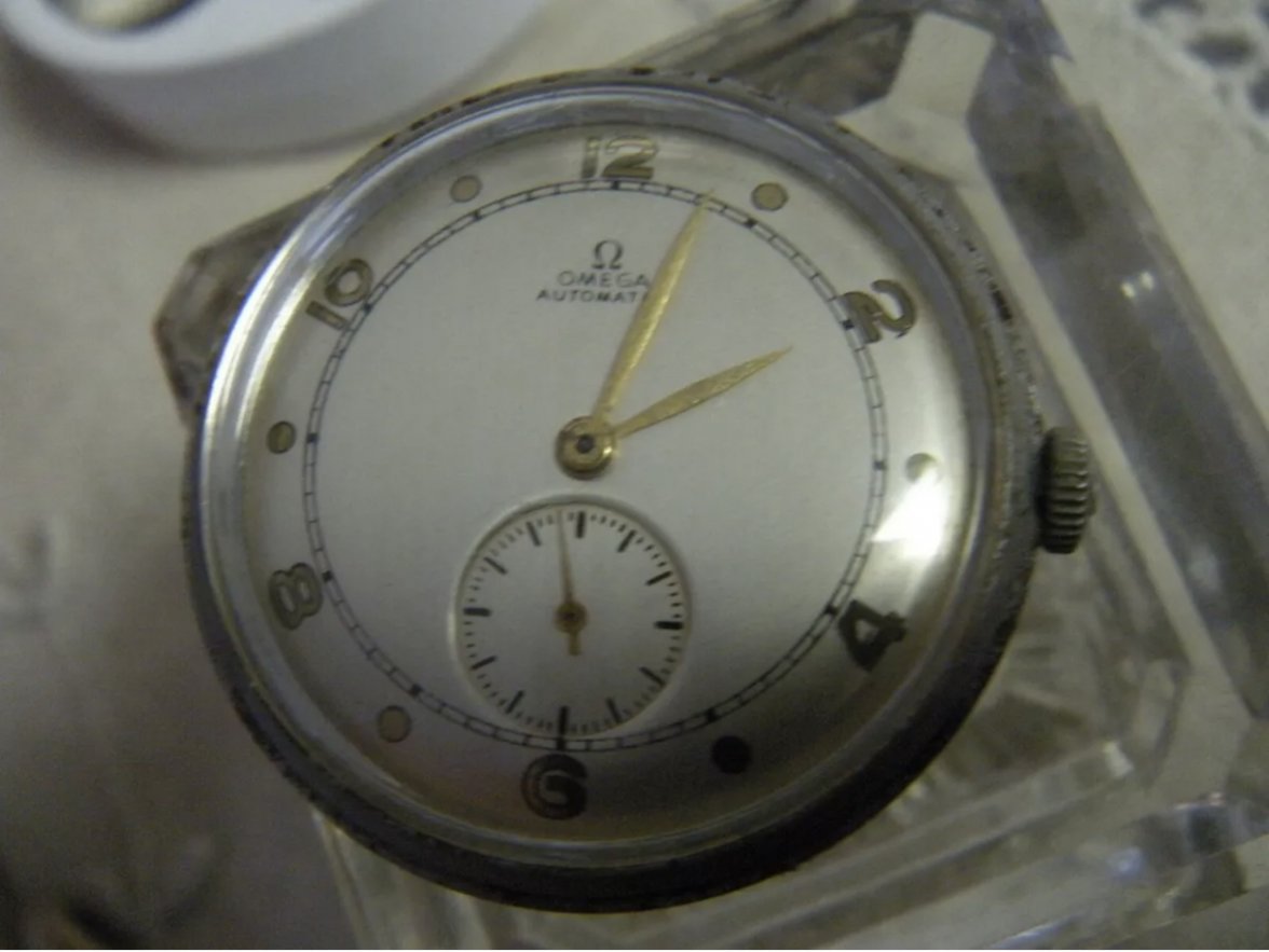

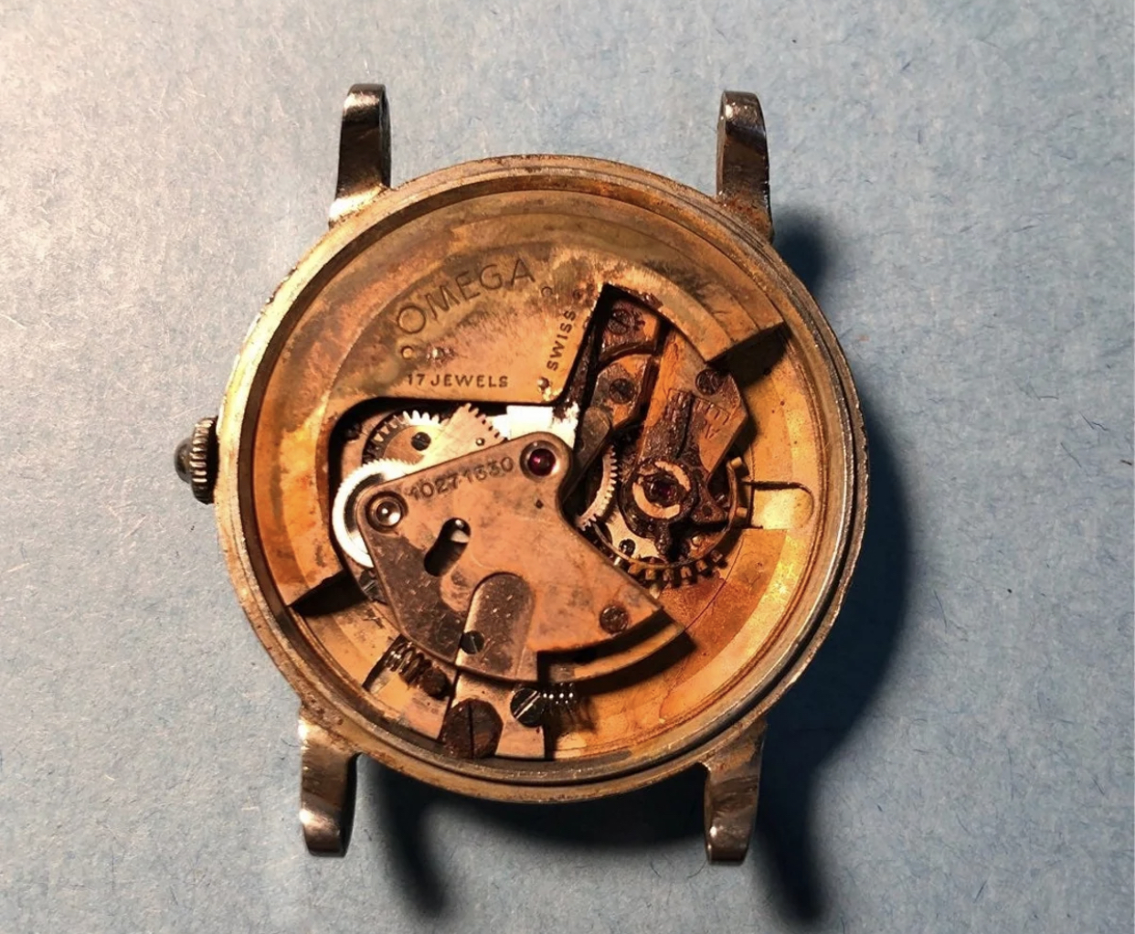

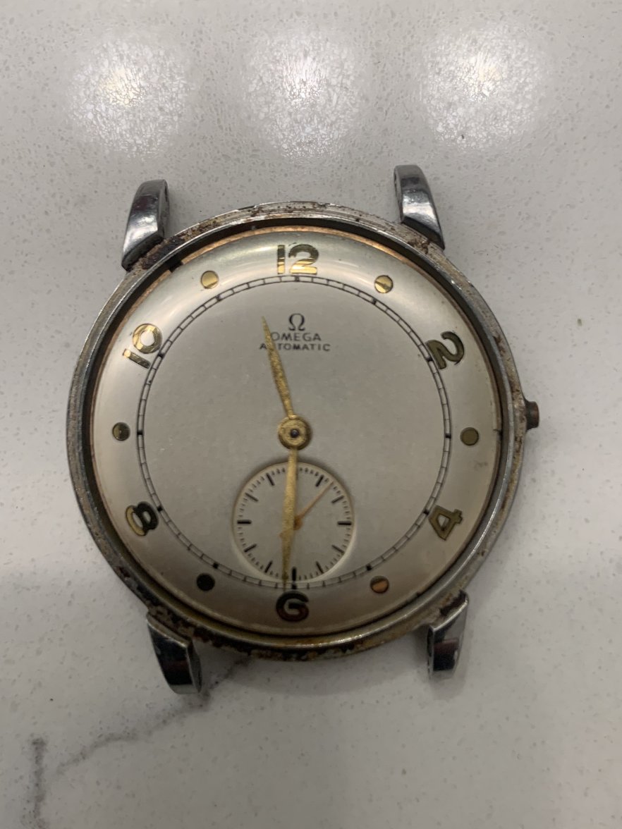

Hey forum I need some help with my 1944 project watch. I purchased a rusty 1944 bumper case reference #2398-2 and began the search for a movement. I was able to locate one with a good dial that I thought would fit but it’s not seating like it should it came from a different case reference (2374 1H) watch but I read the movements were the same. It fits inside but the bezel is making contact with the dial. Do I have to use the original dial? Or is this a whole different movement? Any help would be appreciated.
13,493
31,814
Different cases use different dials, mix and match usually doesn't work.
5,729
9,513
You have both Dials. Measure the dial height. If the same, a different crystal might do the trick. But then it's time for a watchmaker......
