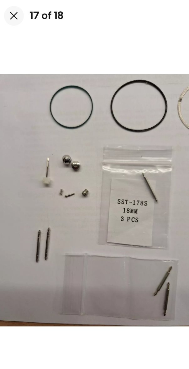

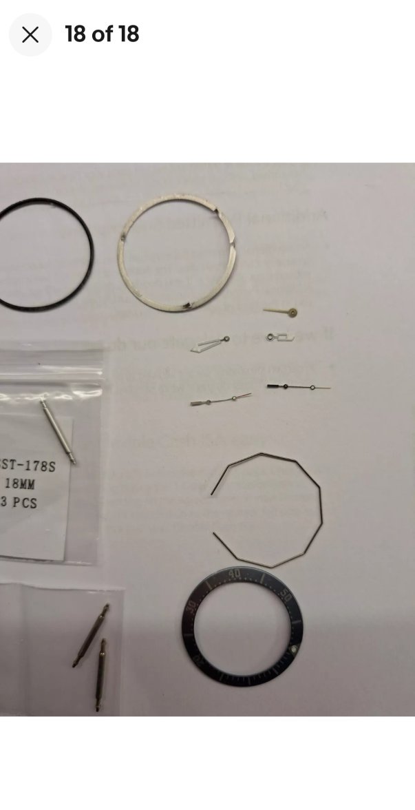

Have come across a 1999 SMP 300m 36mm.
It has had a service recently with the hands, dial and bezel changed (the original parts were given back)
Would the change of hands / bezel etc cause a lot of issues if I ever wanted to sell it in the future?
The old parts will come with the sale

You haven't shown the watch which would've made everything rather easier but I suspect the presence of a loose bezel insert suggests it has been replaced with an aftermarket item. Omega don’t supply the insert singly, they supply a full bezel. If this is the case then yes the aftermarket insert will negatively affect the value. Replacing the hands with genuine items won’t have been a problem as at this age both would be SuperLuminova items, but curiously amongst the removed parts I note 2 Seamaster second hands and also what looks like a chronograph counter hand, which has no place on this SMP model. The plastic crown and stem suggest the movement was changed, which is normal for a factory service on a modern quartz Omega but I'd want to be sure it hasn't had a generic ETA movement dropped in by a third party watchmaker.
