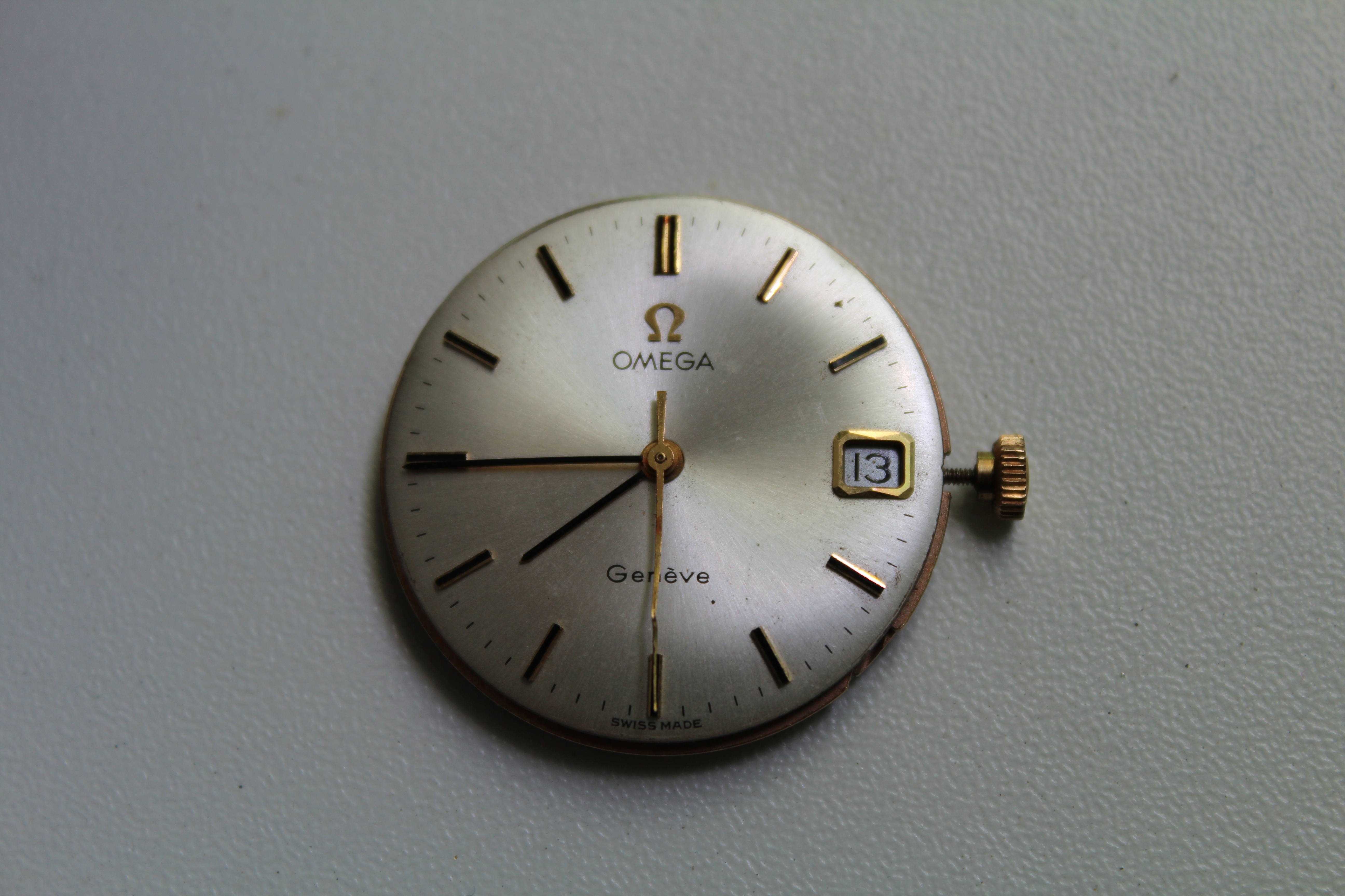

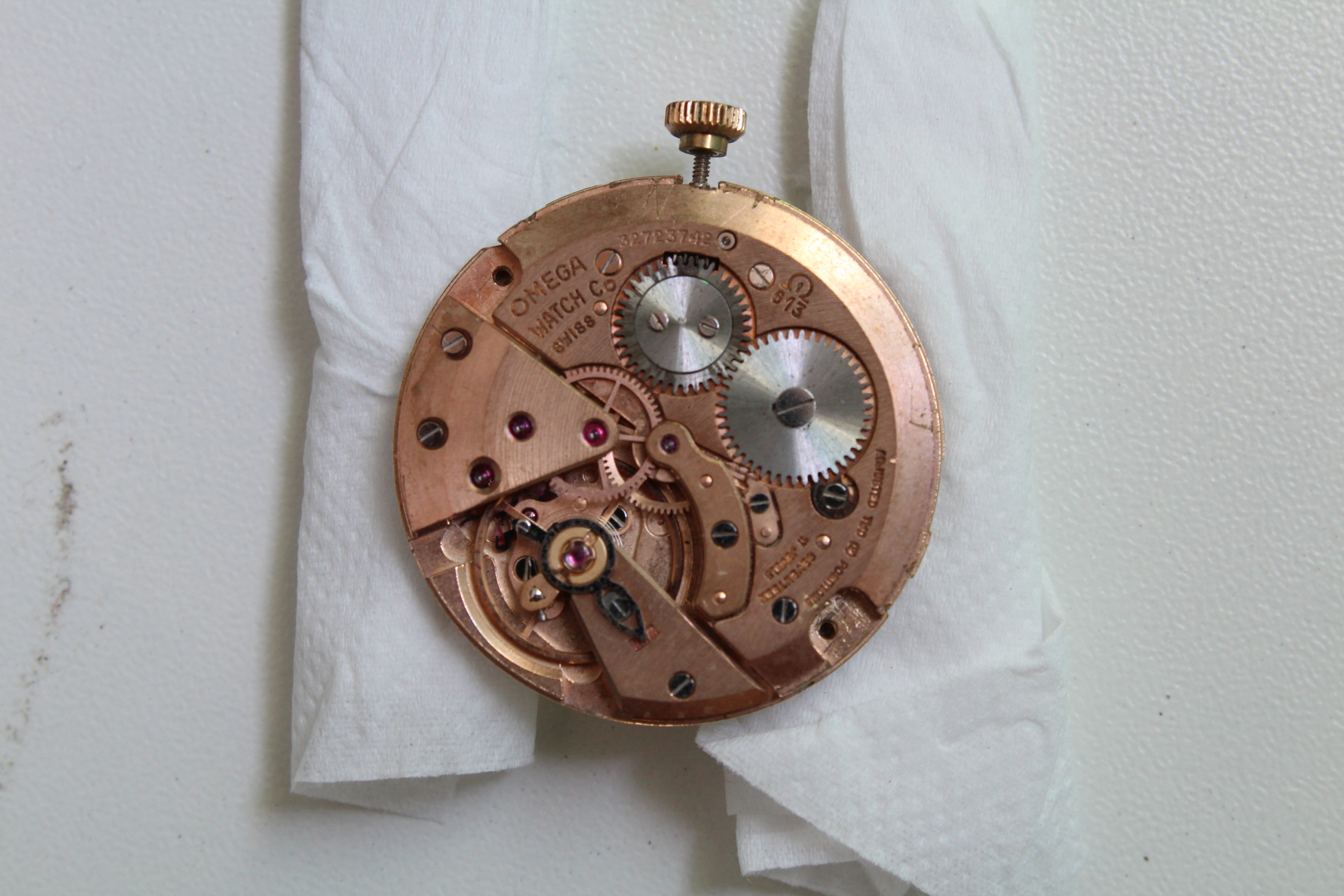

Hi, recently i bought an Omega 613 that need some help and i decided go for it and bring back to life.
The good news is that he just need a service, case, seconds hand (maybe) and 3 screws (not from the movement). The parts that i need are: Screw 2284 (from the dial) just one and both Case Clamps and screws.
There is a reliable site where i can find this parts? or can i just order from Omega himself?

Helps if you post your location.
Doesn't help if you order from cousins which is in the UK and your in the US
When you order. Mention caliber, case reference number (on inside case back) and parts needed
Last. Ask for a generic sweep hand. Usually under $10. Omega is more than $30.00

My dial is 27.3mm.
Which watch case should i buy? one for 27mm or 27,5 dial?

My dial is 27.3mm.
Guessing the answer to that will be the size of the dial you have a 27.3mm dial, it's unlikely to fit well into a 27mm case, and also factor the distance to crown.
Dont forget case will come in parts, including front glass/lens, potentially separate back etc.

Your movement is wider than your dial, so the opening for the movement is based off the width of the movement lip just under the dial which you can see poking out around the edge.
Here's the hard part. Finding the case. Any sold on Ebay. You have to see the reference number inside the case back and then Google search to see the model.
Better off buying a fairly complete project and work from there.
