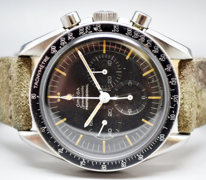

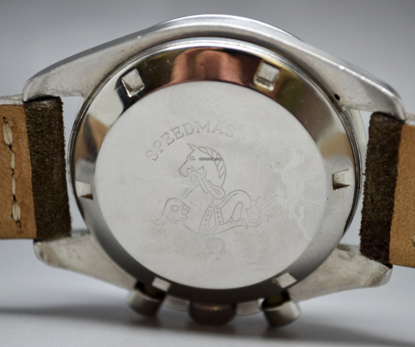

Hey!
I took all your advice about finding a watch that I really like the appearance of and I have just done that.
I have been trying to see if there is anything wrong with it but I can't really find anything. Well except the ugly suede strap. The requested price is €7300, serviced last year and 12 month warranty.
The only problem that I can see is that the back case has been polished quite hard. So maybe the whole case is over polished? I can't really tell. The lume is a little bit too yellow maybe as well?
Thanks in advance for all your help and patience!

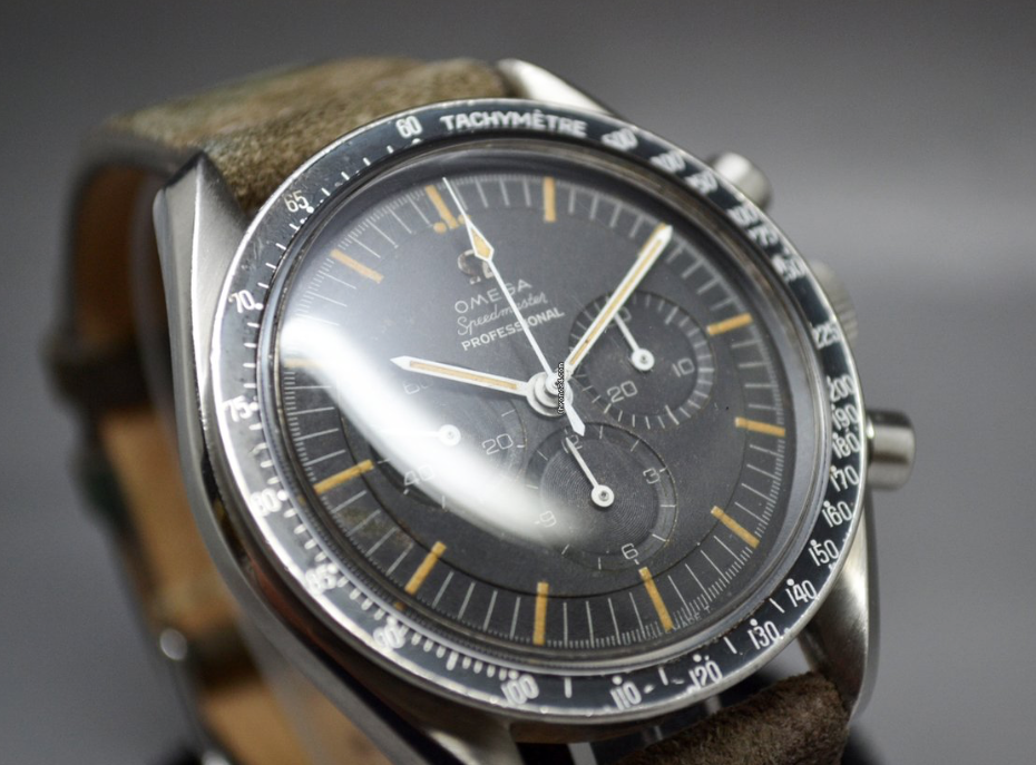

I find that one aesthetically very pleasing I have to say. One thing that I'd double check before the purchase would be the lume. Maybe it's down to the picture processing but I can hardly remember to have ever seen such an even saffron colored lume. Please don't get me wrong, I have no indication to say it's relumed. I just don't find it common and would therefor have a second look.

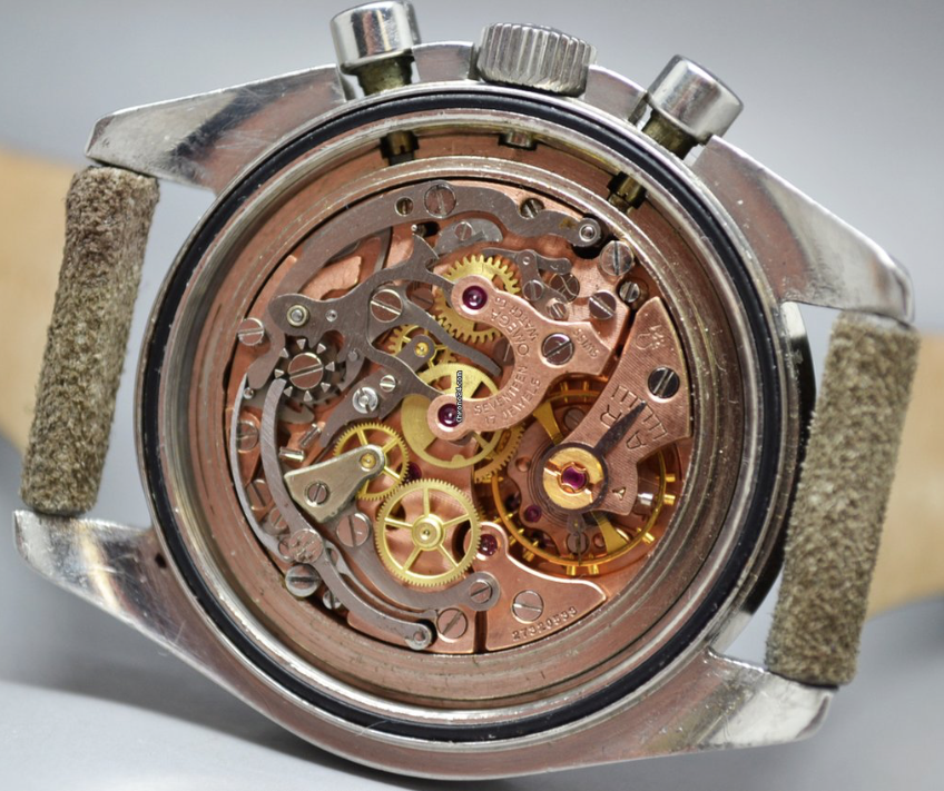

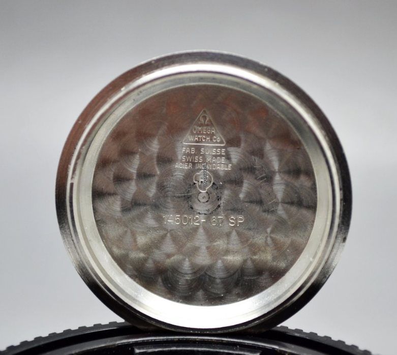

According to MWO, 27320xxx is a very high but correct, rare movement number for a 145:012.

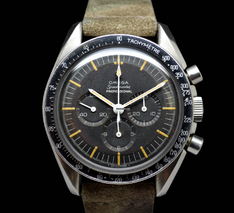

I thought 145.012 should have wide spaced T's

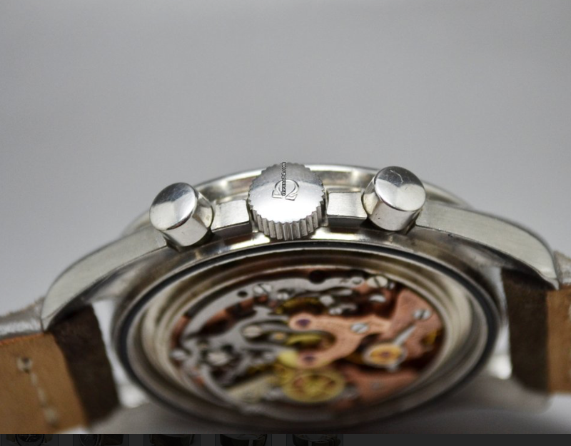

Also crown a replacement but no biggie there.

I don't like that dial. Wide T's on a 67? Look at the Professional text. Seems iffy.

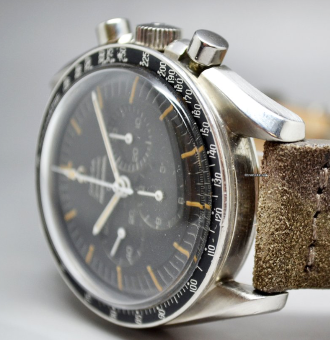

The caseback and mid case seem to have a very different sheen as well and case is too polished for me.
Coupled with the movement no, I'd be very wary.

looks "prepared" to me.. not a good authentic/honest piece, IMHO... I'd say a dial and hand relume, case is soft from polishing, dial has issues like the scratch in the 9 o'clock subregister, no bracelet included, etc. I'd rather pay a bit more for a better example with a bracelet... but that's me.

With the serial on the higher end for -67, I'd assume a wide T's dial. However I think the dial should be the main area of concern for this watch. I totally understand the urge of owning one especially this being your first Speedmaster but I'd remain patient. Good luck!

How do you spot a replacement crown?

dial is from earlier model (105.012) and to me it looks in nice condition. crown replaced, no big deal. case looks polished.
over all 7300 is a bit too much I think!

I agree that the case seems overpolished. But the most worrying thing to me is the dial which looks in bad conditions with signs of scratches and brown areas around the sub-registers.

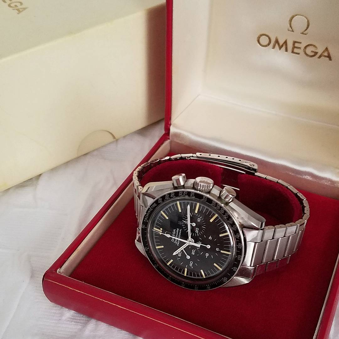

In the same price range and with similar yellow tones I d rather this one http://www.chrono24.com/omega/speedmaster-professional-321-vintage-145012-67--id6256809.htm . Although the galaxy like patina is particular and may not appeal everyone.
Regarding the piece you've shared, can the lume age to that extent? Or has it been artificially coloured.

The case has been "cleaned". That's my own way of saying it's been very slightly polished, probably to get rid of some surface scratches, but the lines are all still there. The crown looks wrong. As for the fonts, I'd have to get the big book out and compare side to side pictures, so I'll defer to the others on that. The caseback probably hasn't been polished - the hippocampus is acid etched and I have a more worn caseback on a later watch. They were designed to be easily polished out to allow a personal engraving and many years of sweaty wrists can damage the engraving.

I'd say that case is boardering on over polished. The edges are not sharp. It would bother me too much.
The dial may not have been tampered with, perhaps I'm on alert as it's not correct for the watch and the whole thing looks suspect to me.
Either way, it's not correct. You have an early 105.012 dial, in a 145.012 with a late movement so it's clearly not original and correct. The case is average at best and the price is high. If you were looking for an early pro dial, this may be worthwhile as a swapper, but if you're looking for your first and possibly only Speedy it's a pass imo.

Agree, case has been lightly polished and looks a little soft. Agree that the dial text looks a bit off.

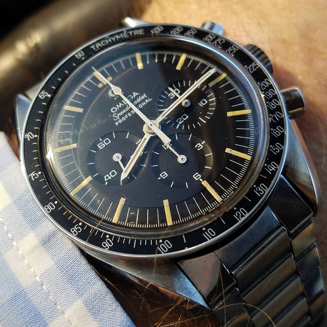

If you wonder about the case, here is my unpolished 67.

Thanks for sharing those photos.
A 50 year old watch made of metal would in most cases be polished more than once. That is one thing, overpolished is another, IMHO.
That's a good question. In my opinion it is not a relume, looks quite irregular and pourous. Concerning the color,I think that part of the strange tone is due to the high saturation and contrast of the image. A natural light picture together with the knowledge of its behaviour in the darkness may be very helpful in this case.
The case also in this ine seems polished, I say "seems" because pictures can be quite tricky amplifying or hiding defects.

At 27,320,###, I'd expect a -68 caseback. High number and older dial also raise the red flag.

There's no doubt. The dial isn't correct for that watch. The movement is a question mark and the case is average at best.
