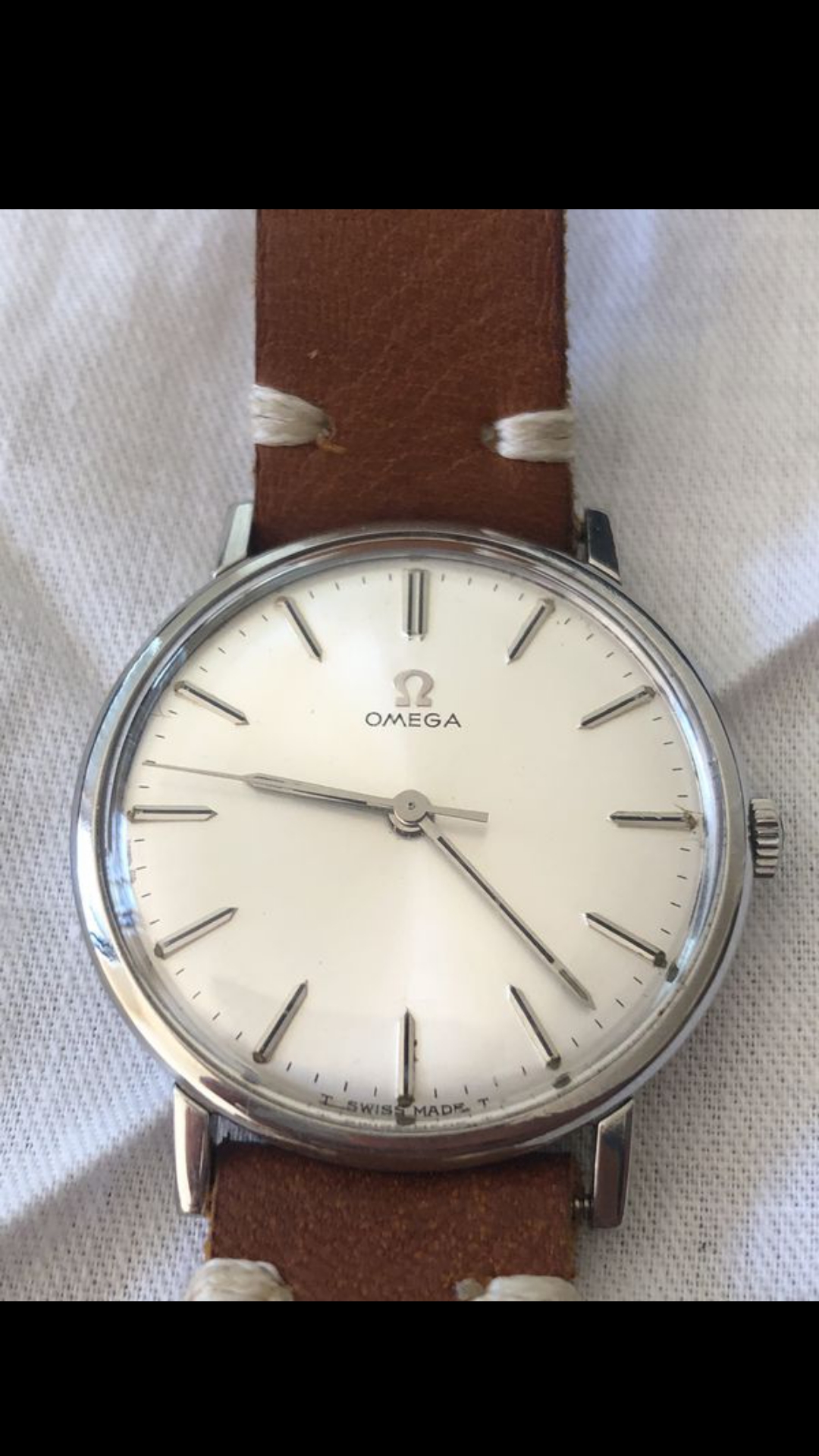

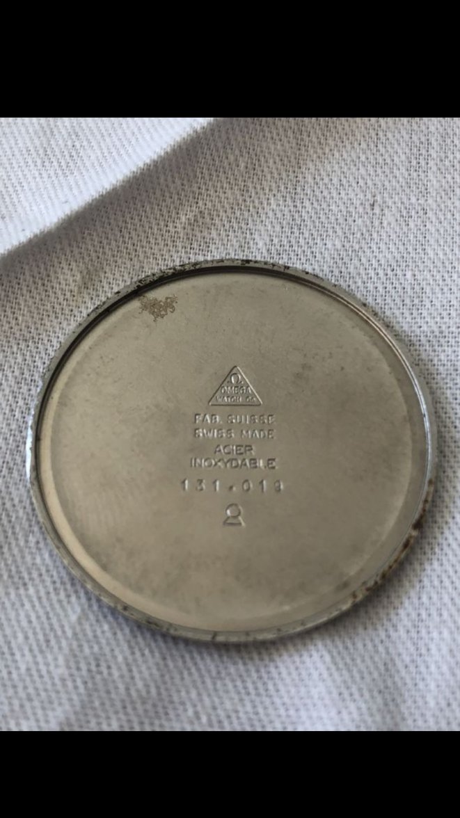

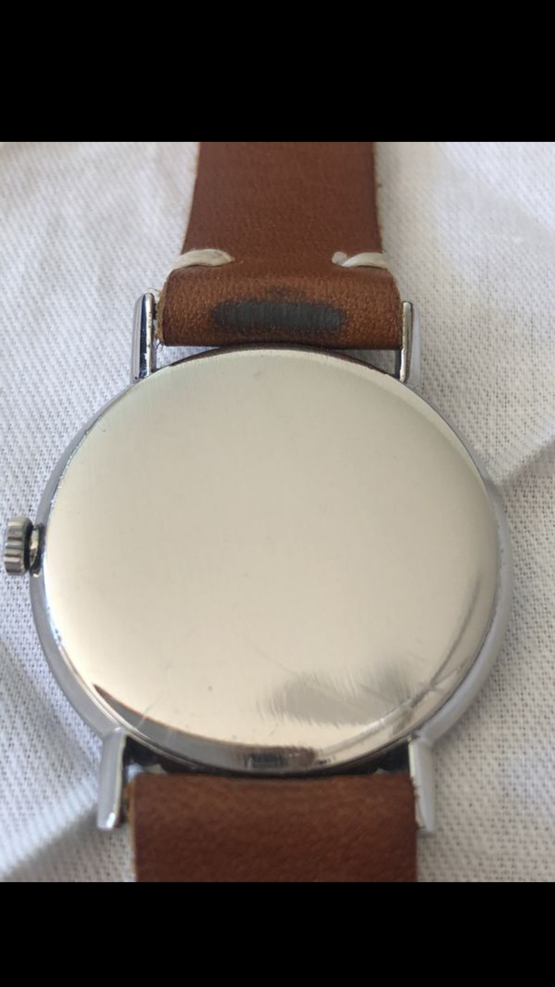

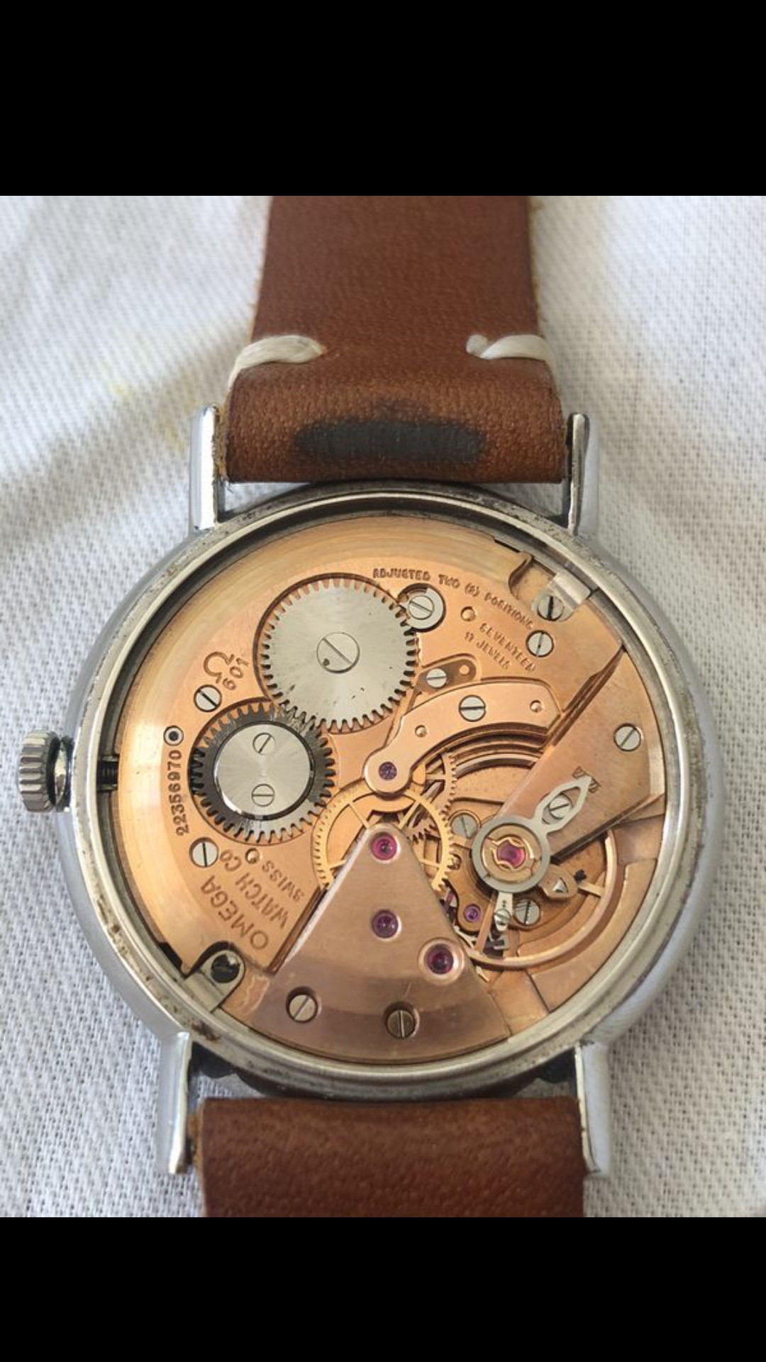

Hi, from a first time Omega buyer.
Found this 38mm 1965 131.019 for sale and hoping you all can help me make an informed decision here. Is there anything that suggests this isnt authentic? I haven't seen it in person yet, and can't meet at a watch shop or jeweler with all the Covid-19 closures.
What would this be worth? Good price?
What should I look out for? I've been browsing the different help posts on here, and they are amazing! Thank you! But still hoping for some specifics with this one.

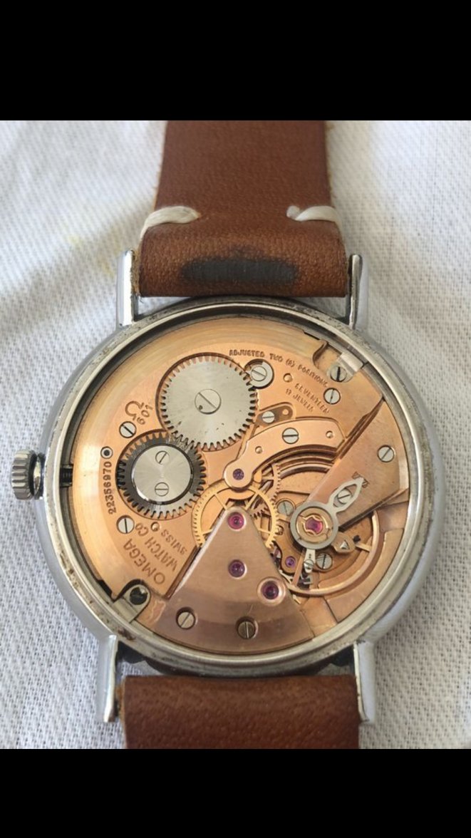

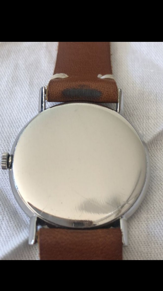

Looks legit, but based on what I can see in the photos, I'm not crazy about the condition of the case. Maybe you can post better photos showing the lugs more clearly. I don't think this reference is 38mm, probably 34mm is more accurate.
5,026
18,608
It's 100% not 38mm. It's 34 and I would not spend more then EUR 300/325.

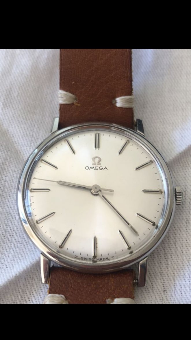

What is the price you've been offered it at?
6
It was listed at 350 usd, but after speaking with him, have it down to 250 usd. Haven't confirmed the measurement yet, nor brought that to his attention. I am a bigger person, so would prefer the larger size.

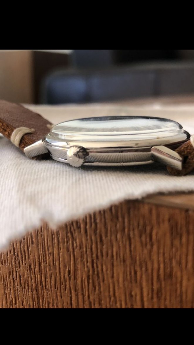

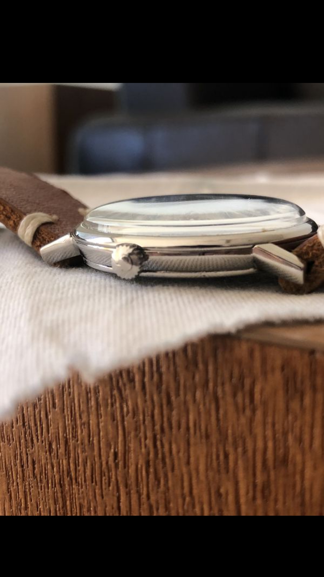

Great input here so far. I'll see if I can get better pictures of the lugs. Funny, I thought it was in too good of condition, but perhaps it's overly polished?
Also, I think I am seeing some sort of blemish on the face behind the 6 o'clock "marker" (I'm sure it has name, that I am not aware of).
4,857
12,285
Polish is the issue to me, but I am pretty new to this. There should be facets on the lugs, but the edges are all polished away.
