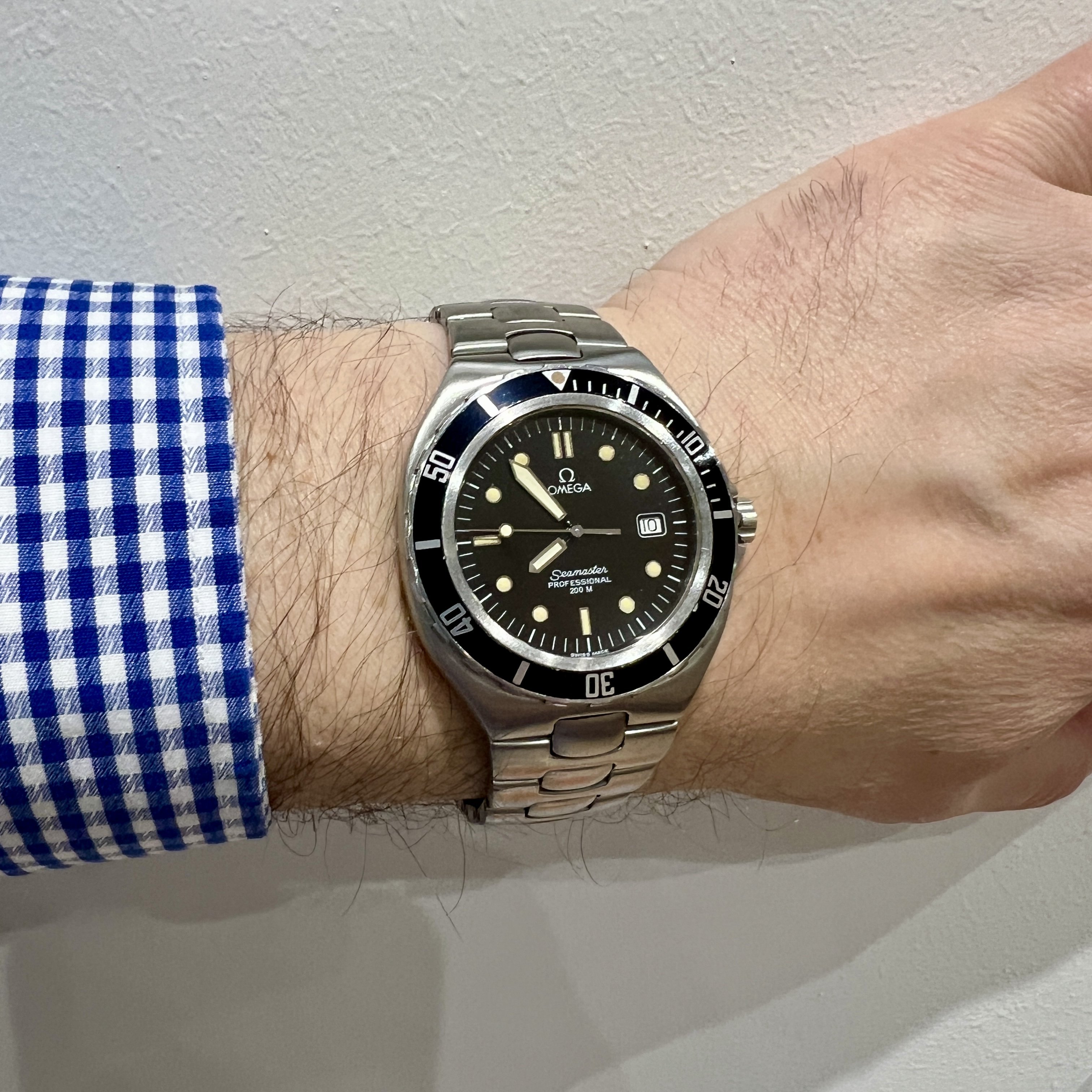

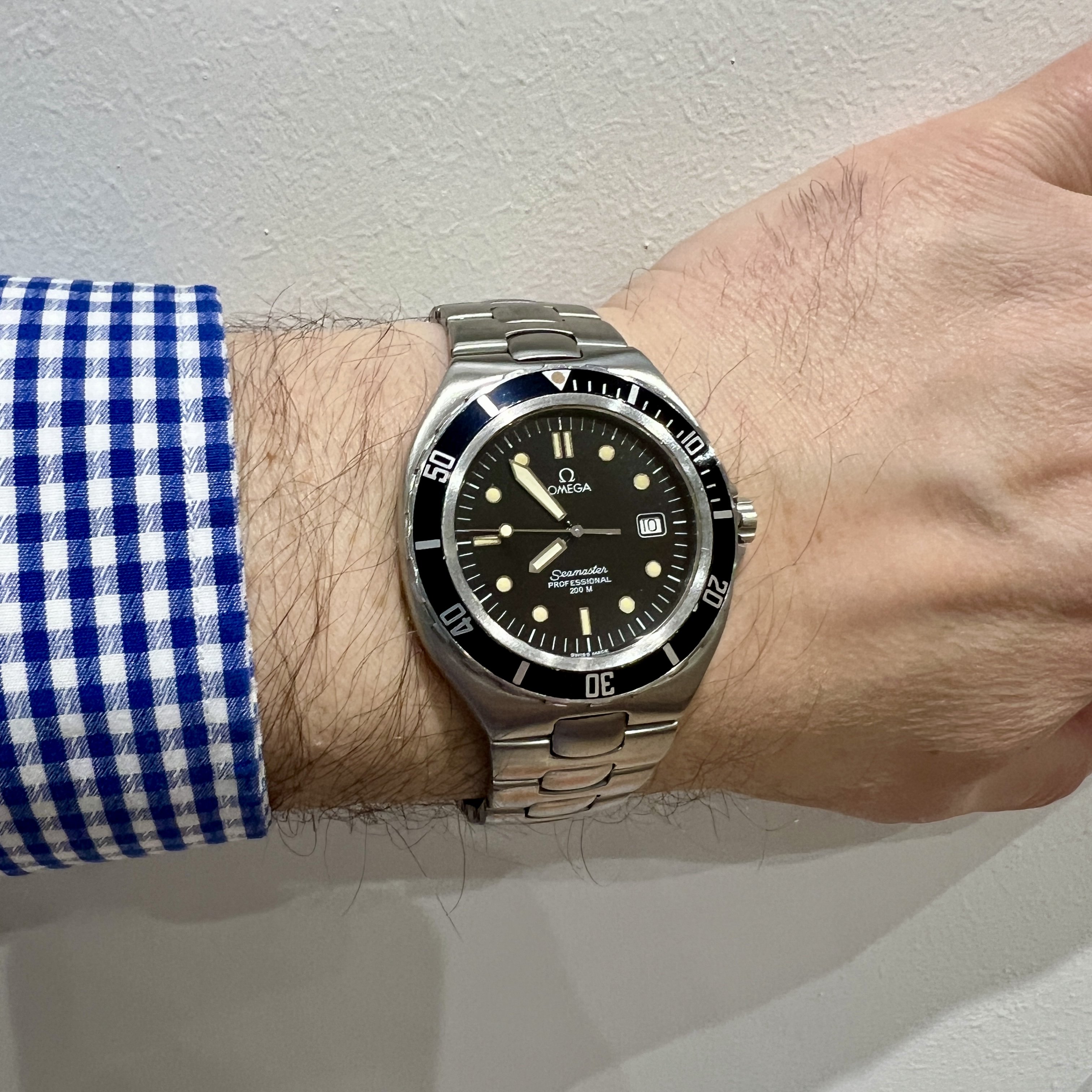

Nice. I too previously had one that was knocked about but my current one is one of the tidier examples, this is a 1041:

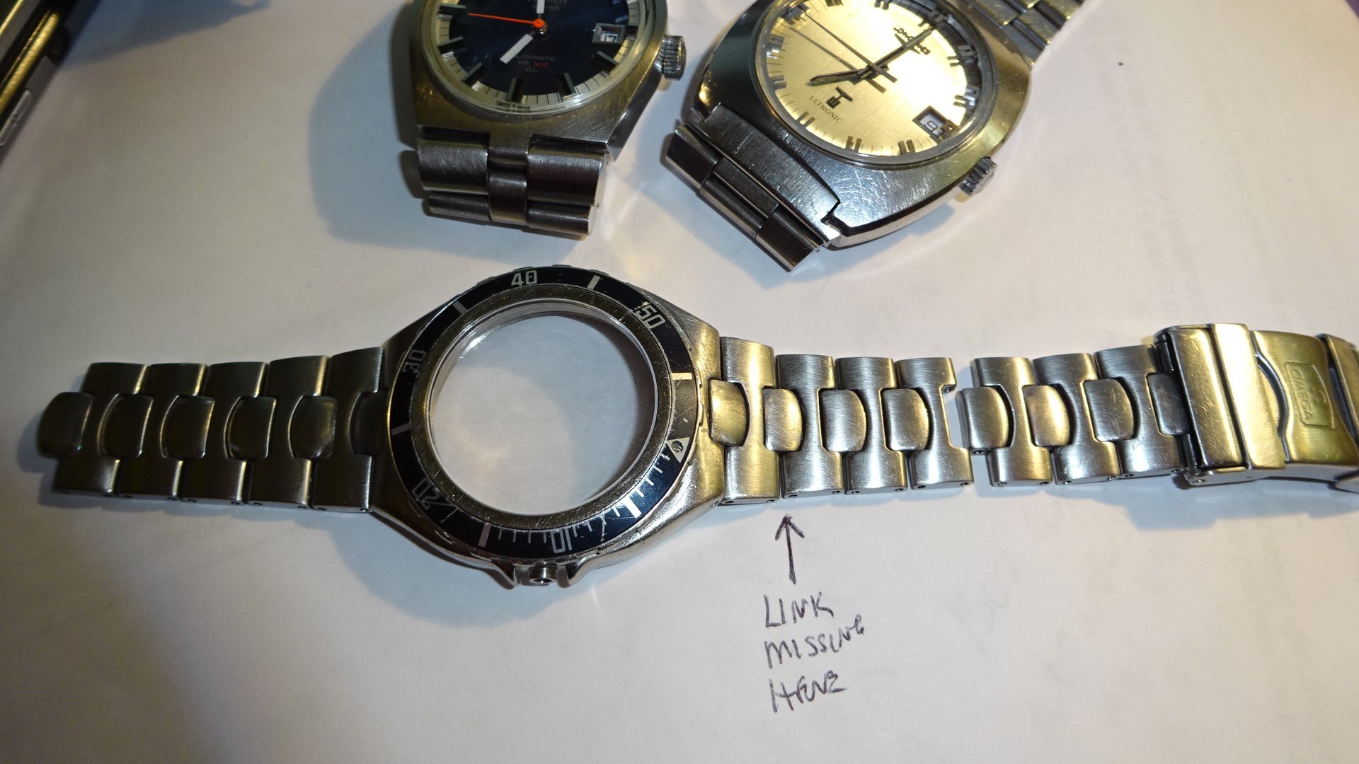

Well, she finally arrived and it's sort of a mixed bag. The watch works fine, no issues there, and keeps good time. The biggest issues are someone lightly polished the watch case (top and sides) and the bracelet (on the upper side only), the bezel insert has seen better days (but will stay original) and the bracelet itself. Luckily they didn't go nuts and polish the crap out of it, so restoring the brushed finish will be easy on the bracelet, and I've already restored most of the original finish. The watch case will take more effort, and I'll get back to that in a bit. The crystal is scratch free (always a good thing) and the only lume that still glows at all is on the lollipop second hand, so it's probably newer. Lume patina on the hands and dial match pretty closely, although the camera makes them seem a little more different, but the hands are not obviously newer. The dial itself looks good, with no issues. The bezel was frozen, but with a little penetrating lube I got it to rotate, but it's still hard to turn without the use of a rag to grab it. I plan to remove the bezel to clean all the crap out and get it functioning again, and will be asking what the best way to accomplish that will be shortly. It also needs to come off so I can properly restore the brushed finish to the top of the watch case. The lume pip in the bezel was mostly gone, and my ultrasonic cleaner did a fine job of removing what was left. So a re-lume of the pip is probably in my future too, but not my highest priority right now, as I need to study how best to replicate the dial patina.

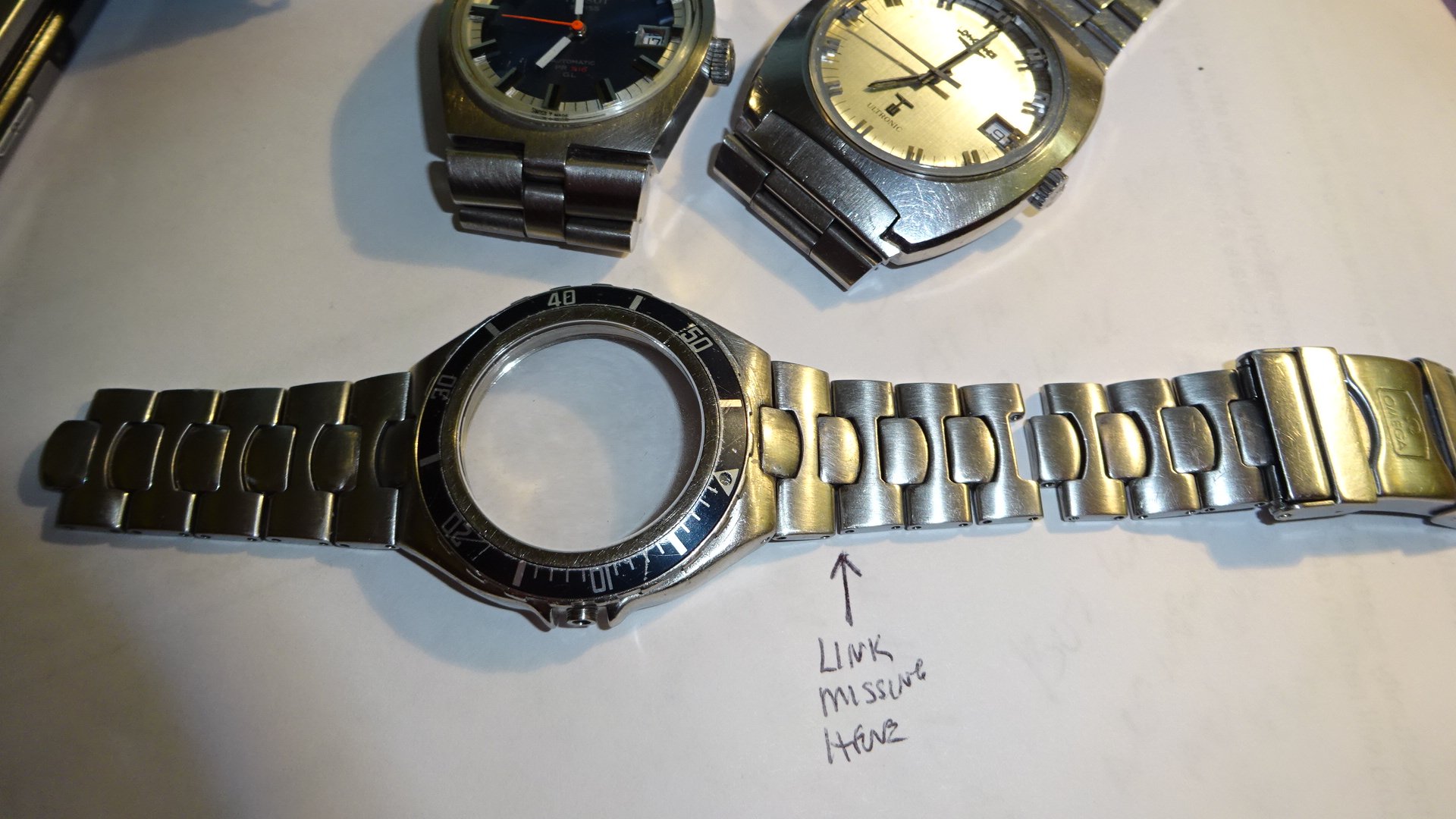

The bracelet, besides the polishing is a bit of a mess. Looks like a couple tubes are missing, and some of the pins are a little bent. I just spent the better part of an hour straightening those pins, but I've ordered a dozen new ones and a dozen and a half new tubes. The biggest issue is one of the tapered links is missing! I didn't notice it at first because it's not obvious until you lay the bracelet flat and can see the change in outer taper. I'm missing the second link from the end link that connects to the watch case. I did a quick search online and came up empty, but even if I did find one I'm sure it would be a fortune. So I'll keep looking, and I might have better luck finding an actual end link for the 1465/452 bracelet and just have to grind it down a bit to become the second link.
I was so anxious to see what I had that I forgot to take pics of the watch assembled. But I plan on putting it back together today to keep my lack of memory from screwing it up until the bracelet parts arrive. I'll add a pick of the bracelet section with the missing link. From what I can tell the Polaris bracelet used shorter end links, at least the ones I see for sale on Ebay are shorter. The one I need is approximately 20.46mm tapering to 19.28mm approximately (LOL), while the end links for Polaris bracelets start at about 19 and change and taper from there. They also attach to the watch case with a different center link that uses a spring bar and not a thru pin and tube, but that doesn't affect the outer end link. So I'll keep searching and maybe I'll get lucky. It's not noticeable on wrist, but being anal..........it will drive me crazy knowing it's missing that link.
Ok, I've probably bored you to tears, so I'll shut up. I'll post a new thread on how best to remove the bezel without screwing it up after I do a search on here to see if it's been covered. No one likes a newbie asking the same questions that have been asked (and answered) a million times. I wouldn't want to wear out my welcome so soon! Thanks again for you help and interest!
regards,
bob
34
16
Sorry, that was a pretty crappy pic, now that I look at it. Try this one. It should be easier to see where the second link is missing.

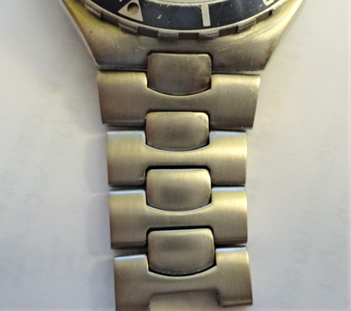

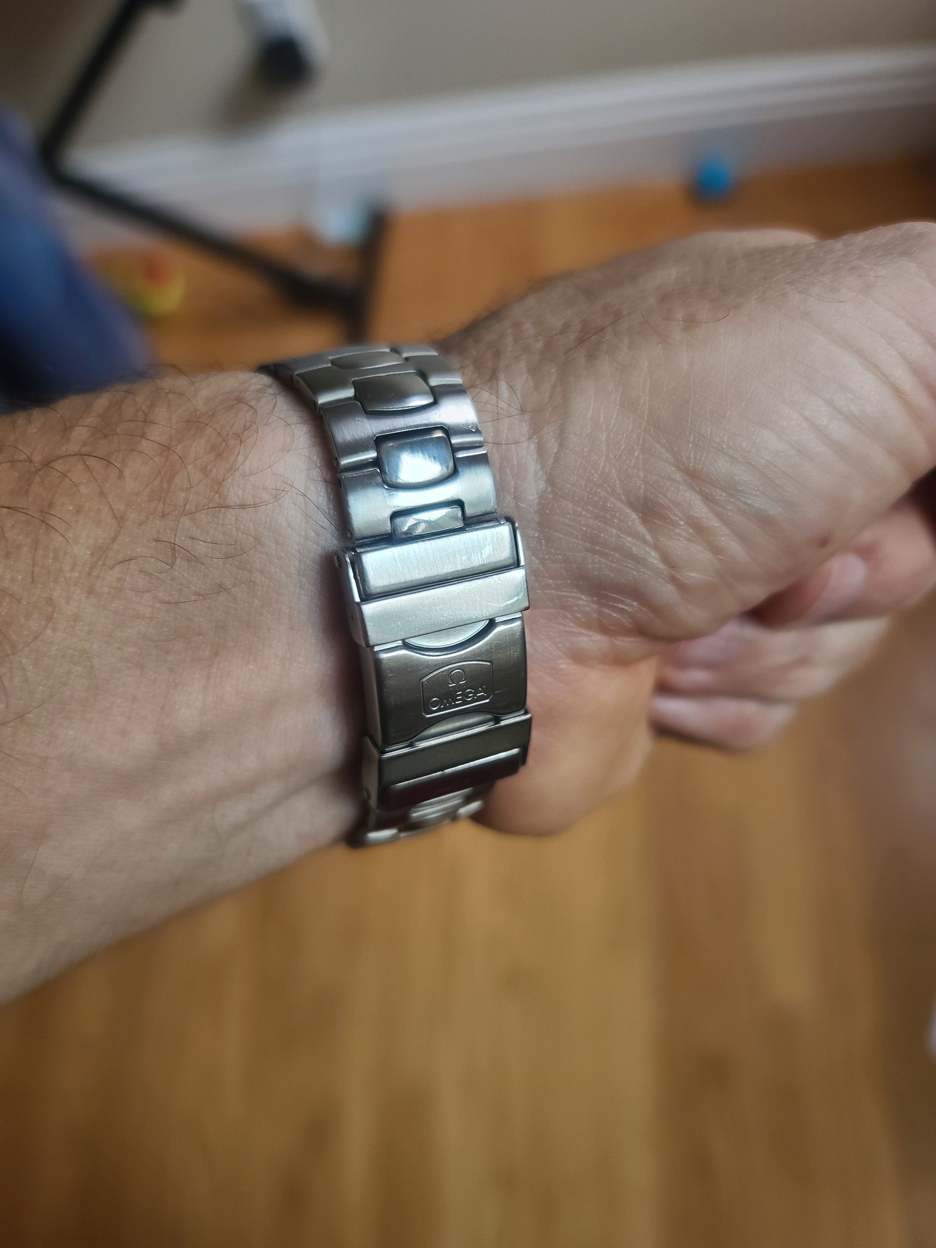

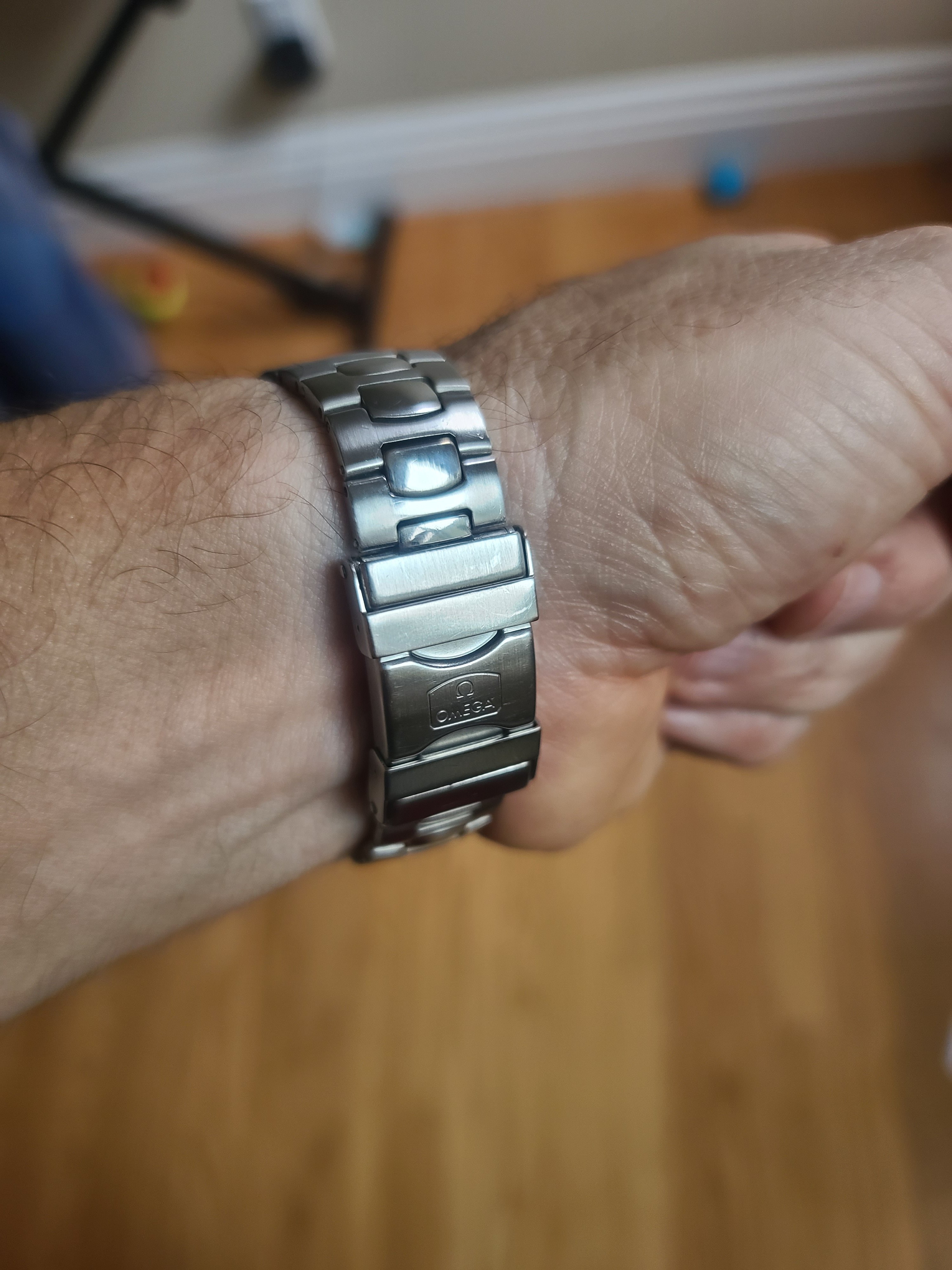

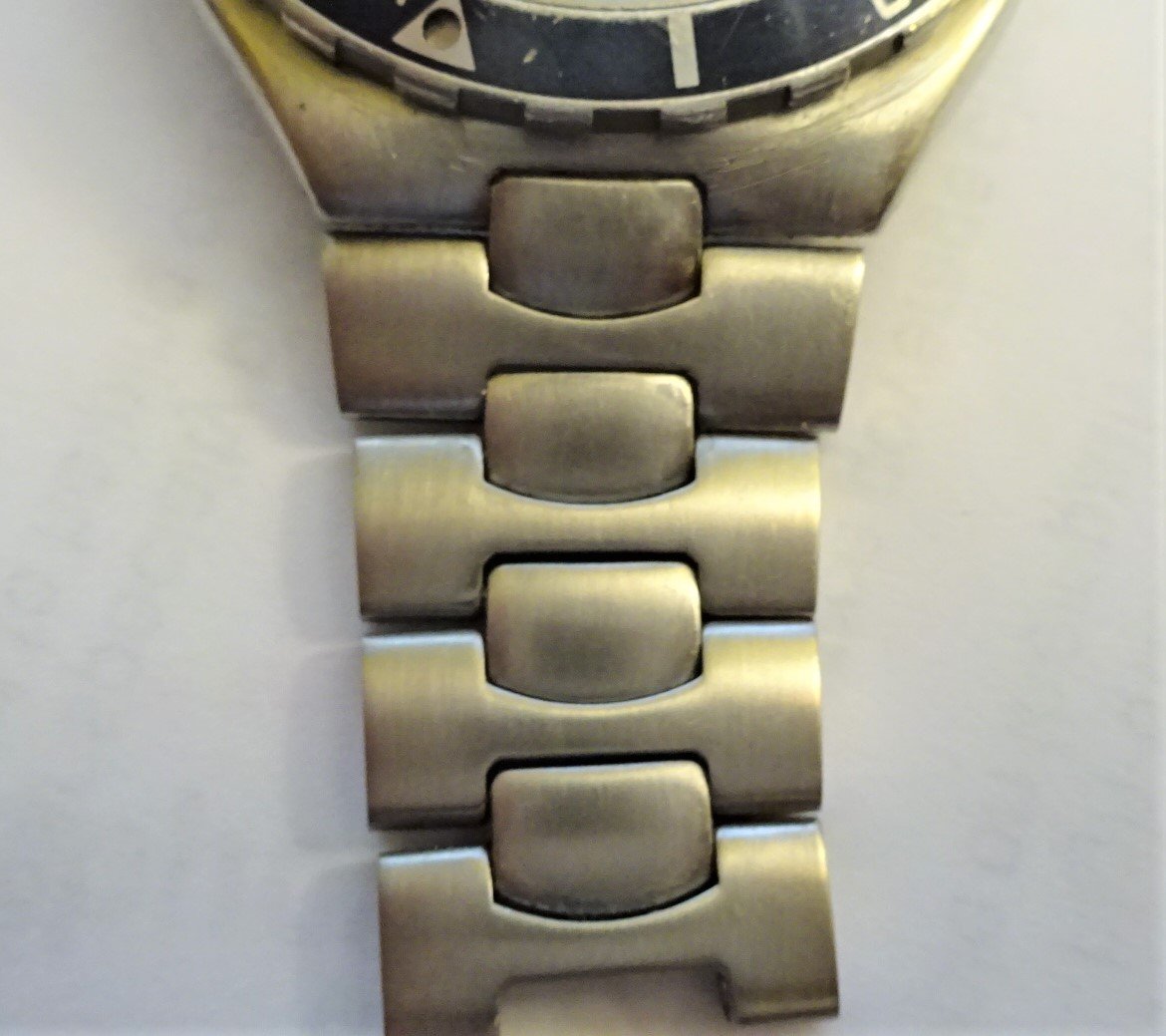

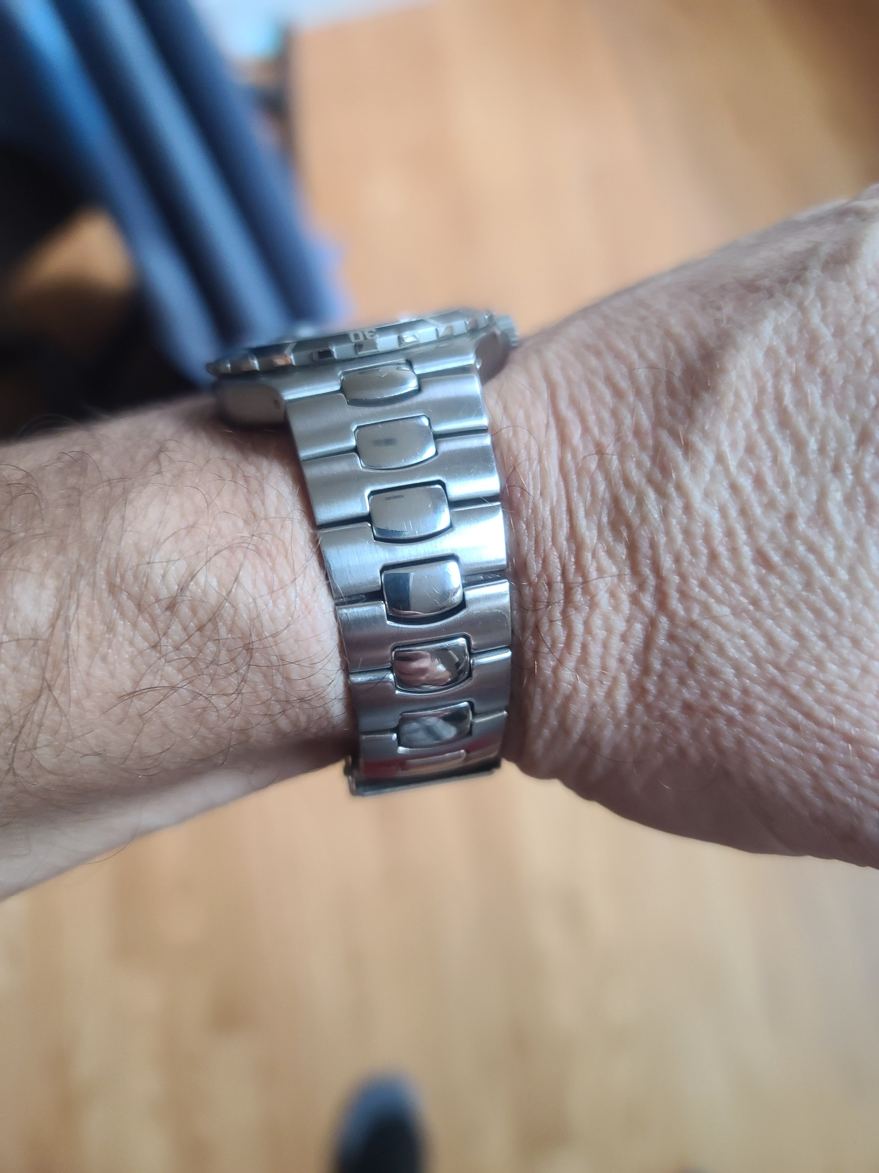

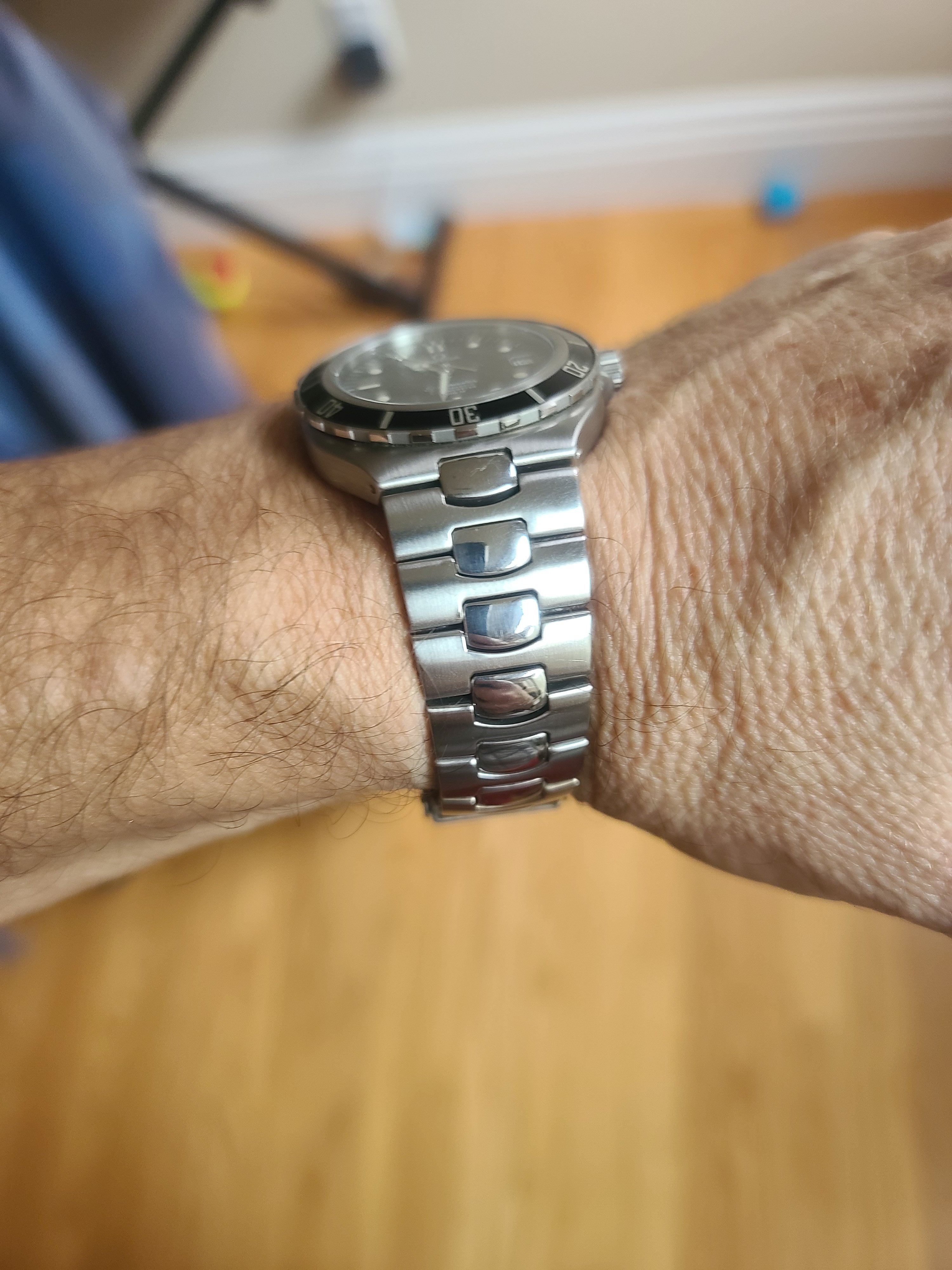

I love the 200m pre bond. I have 10 of them, 4 are automatic full size and the others are quartz full size and mid size. The bracelet will be an issue to fix, you could go to Omega and ask them if they have it. I have one that is in mint condition and the thing i didn't know was that the center links had a mirror finish and the width links were brushed. Most of the time you cannot see the mirror polish anymore on those links,
34
16
Hi b,
Well.......that explains why they're so darn expensive.......cuz you have them all!!! My bracelet is a bummer, but like I said....it's not noticeable on wrist, and if I ever sold it I'd fully disclose the issue if I haven't corrected it by then. And in terms of correcting it, I'll wear it for awhile as-is and if it drives me completely nuts there's another way to skin this cat by simply modifying the taper on the previous link.
I find what you said about the polished center links interesting. I've spent some time reseaching these 200M's before I took the plunge, and have to say in all that I've read and the watches I've looked at.......including many ridiculously priced "perfect" ones, I've never heard anyone speak of polished center links. Neither has anyone who's restored these that I've come across ever mentioned such a thing. I'm not saying you're wrong, I'll leave that to those more experienced on here to do so, if in fact you are. It's just a bit odd that no where has anyone mentioned the words 'polished center links' when describing a 1455 or 1465 bracelet, except the gold versions. I'm curious to hear what others have to say on the subject. Regardless, it would be an interesting look and I'm sure many would like to see it. I don't even think any Polaris model came with polished center links. You might have one unique bracelet there! Next time you pull it out of storage post some pics and get one with the bracelet number on the clasp. I love learning about these things!! Thanks for your reply!
regards,
bob
10,785
16,788
I personally don't think the all steel models ever had polished centre links. I've seen many new or virtually new examples of these and never seen that particular feature. Indeed a few years ago I purchased a whole replacement Pre-Bond bracelet brand new from a boutique and that was fully brushed. As are the all the replacement links I've seen. There were two tone models of course, maybe some of those had polished gold centre links, though I've never seen it there either, but not the steel models IMO.
34
16
Hi padders,
I am curious to see what a 200M looks like with the polished center links though. It would sure be different. I hope bazelot posts some pics!!
;O)
34
16
I LIKE IT! It spices up what's normally a pretty boring bracelet. Thanks for sharing!!
;O)
