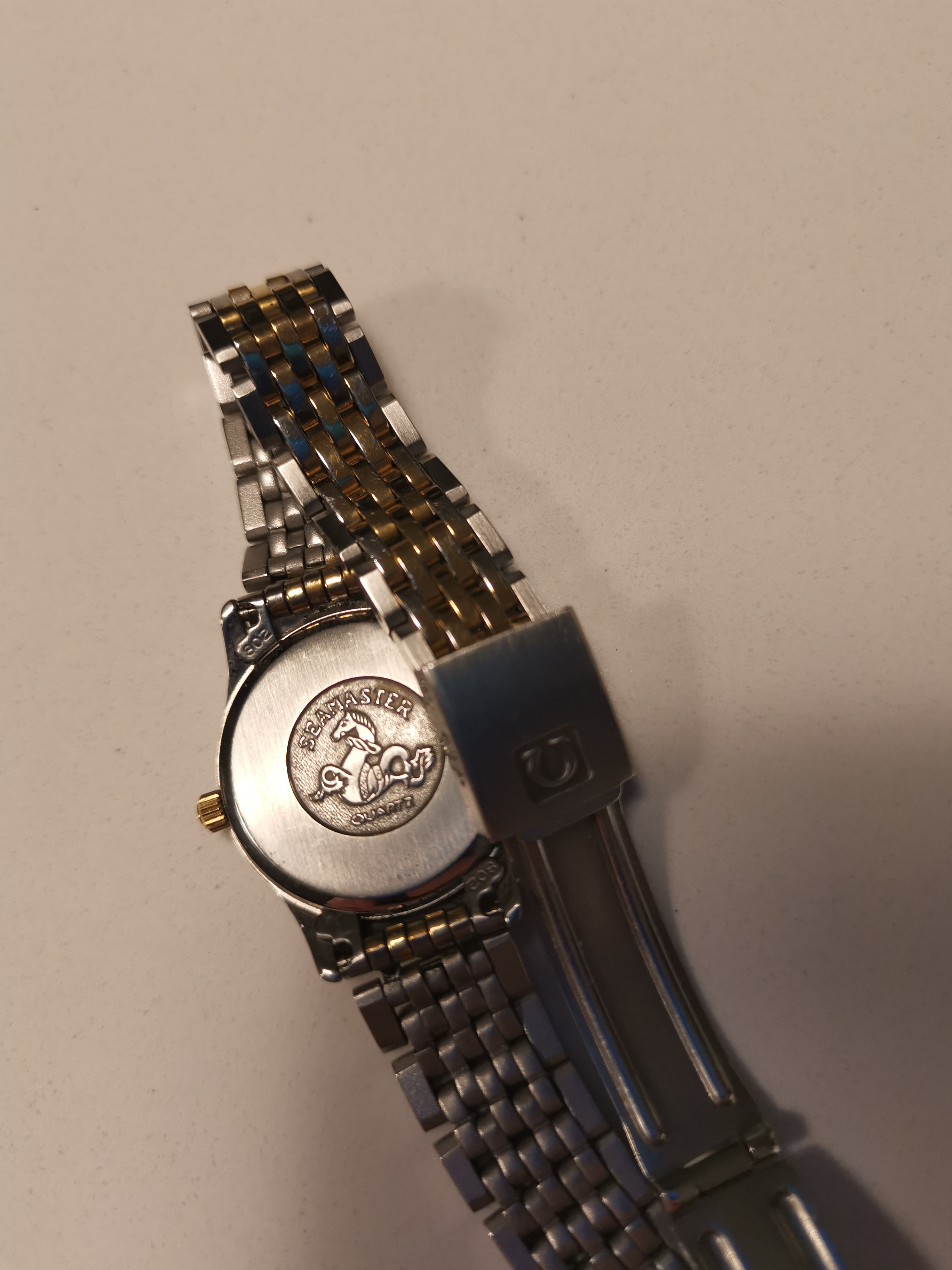

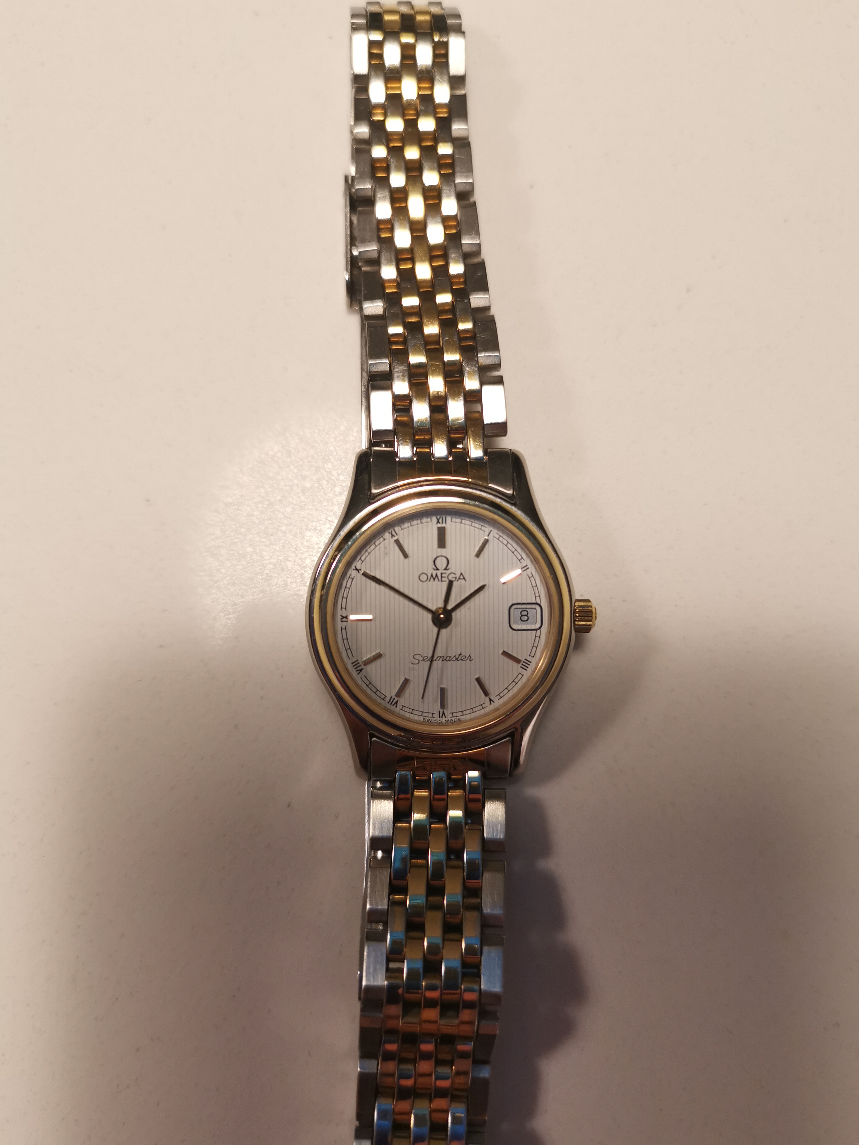

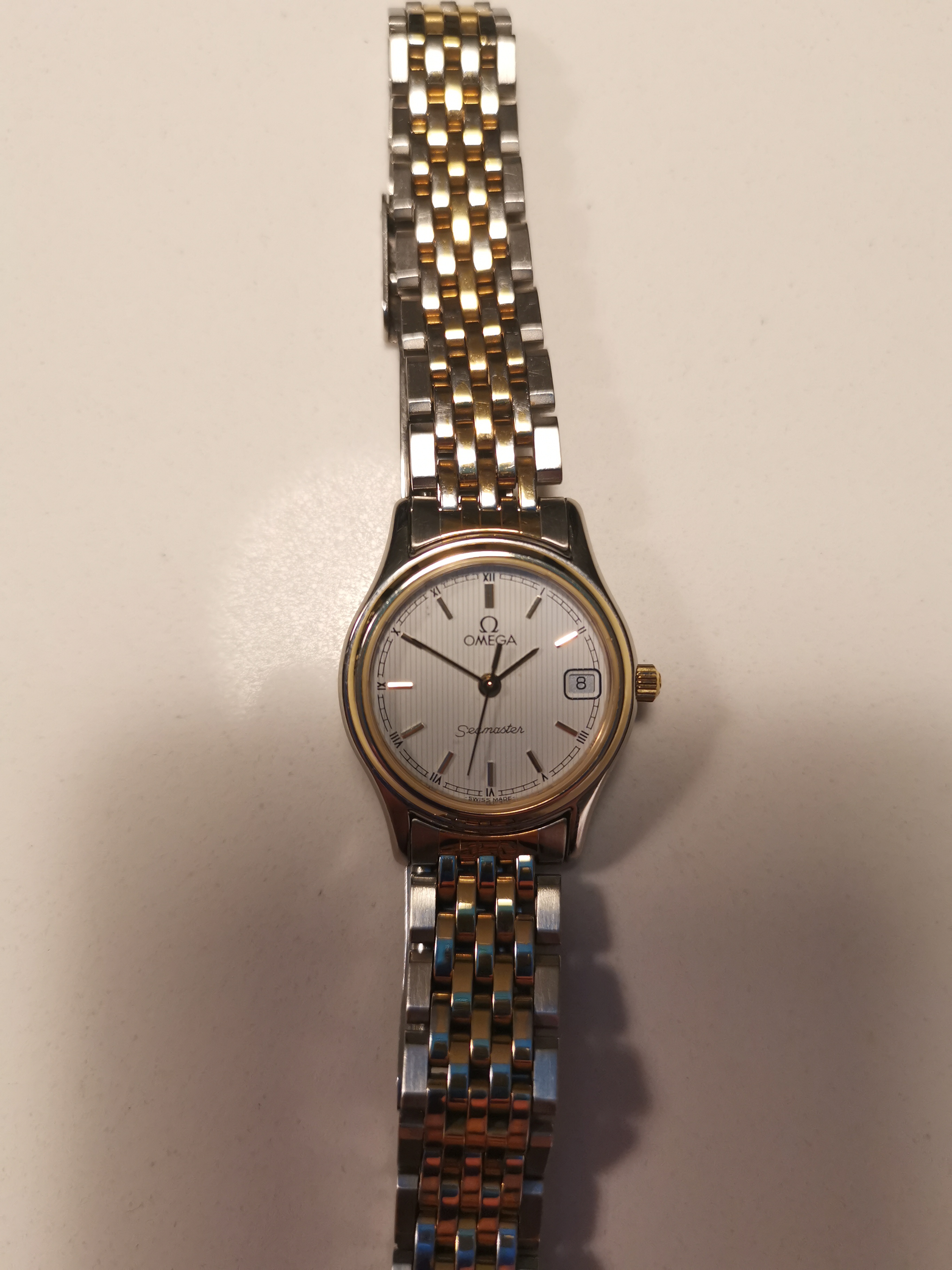

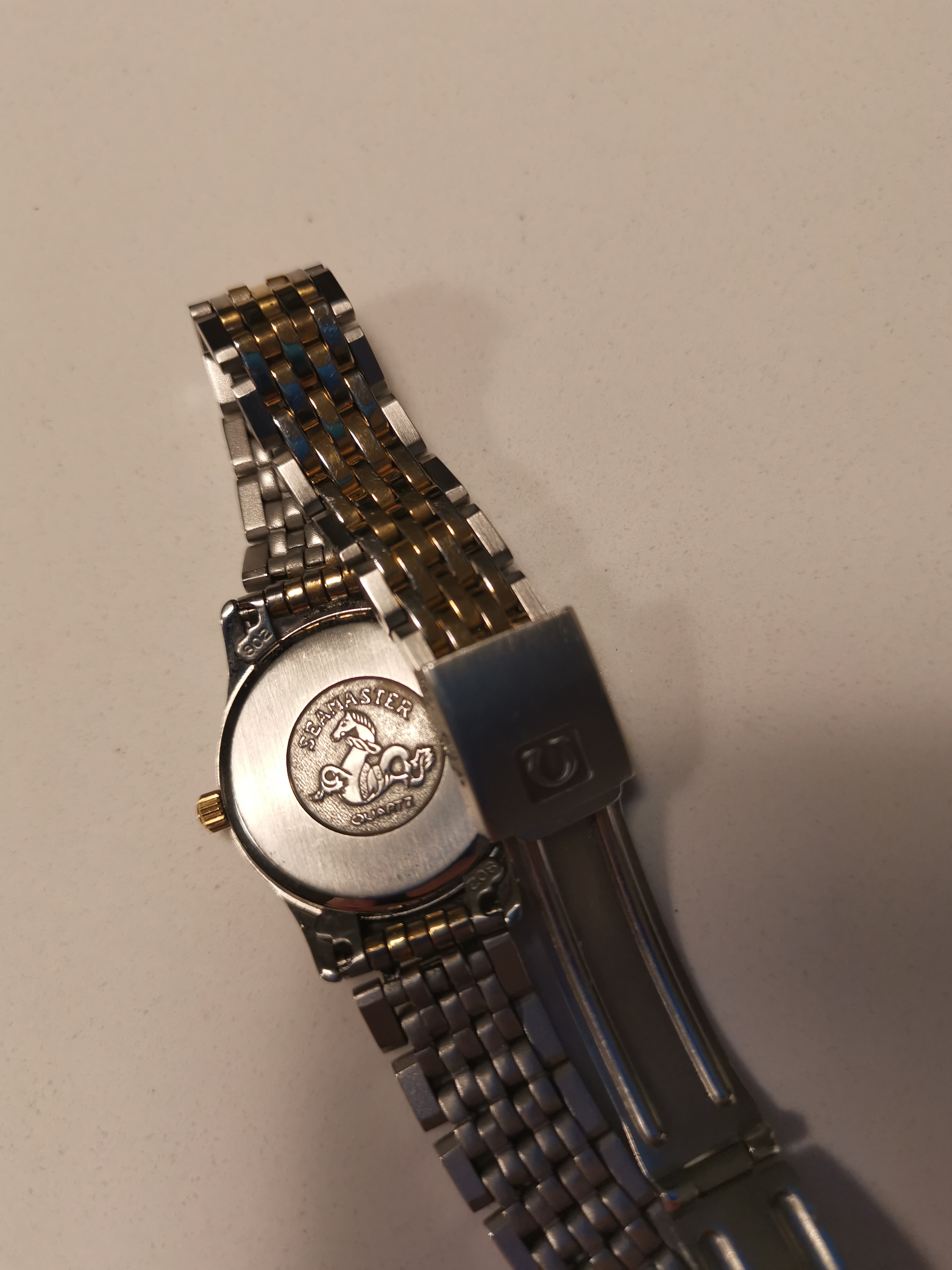

Hello, We have a ladies omega Seamaster, we know nothing about it, what year it is, we would like to know what the model and what strap it is, where the numbers on it are and what the period correct box is as it is missing. Thank You

It's a ladies quartz Omega Seamaster.
To get more information, read this, you can ignore the fake section as yours is OK.

That is very helpful, I will come back once I get the case apart. Also nice to know its not a fake.

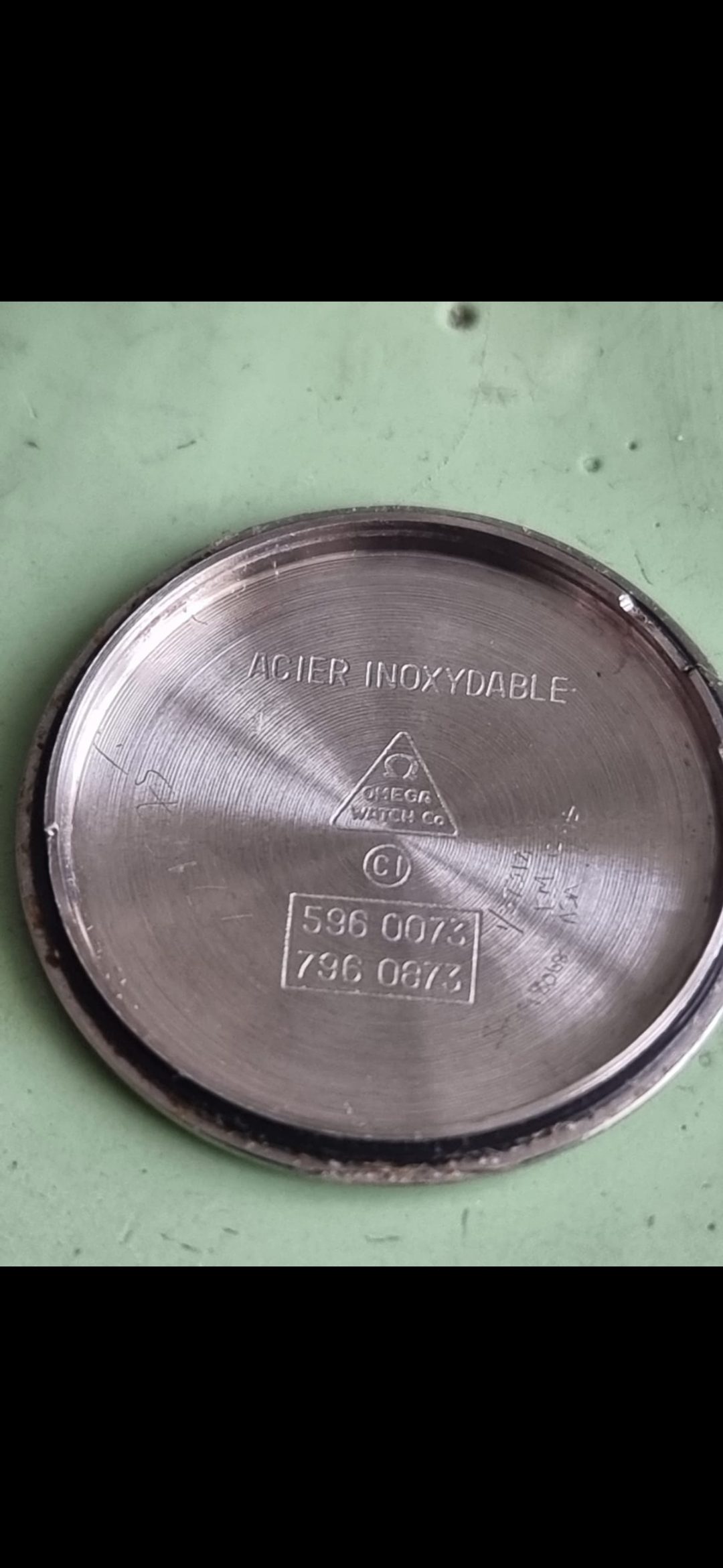

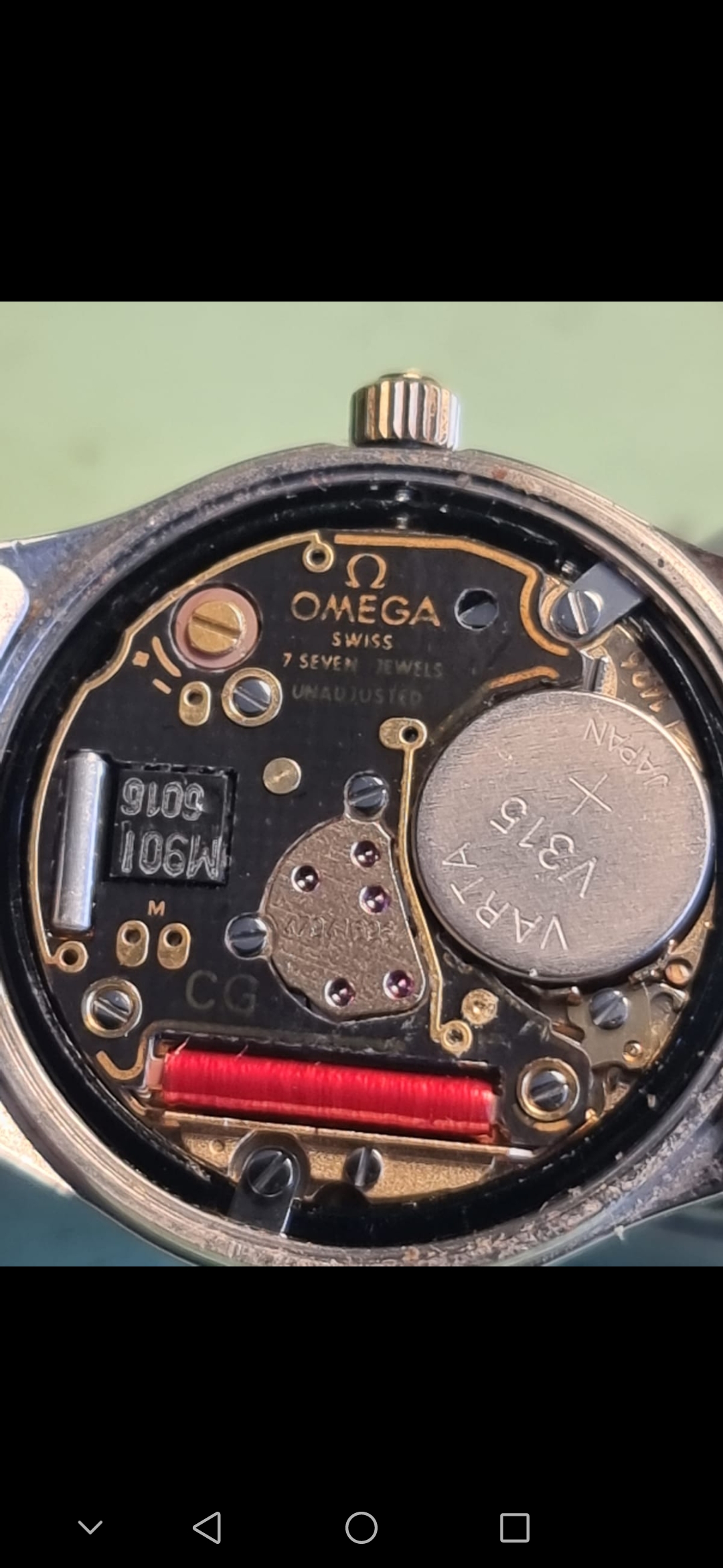

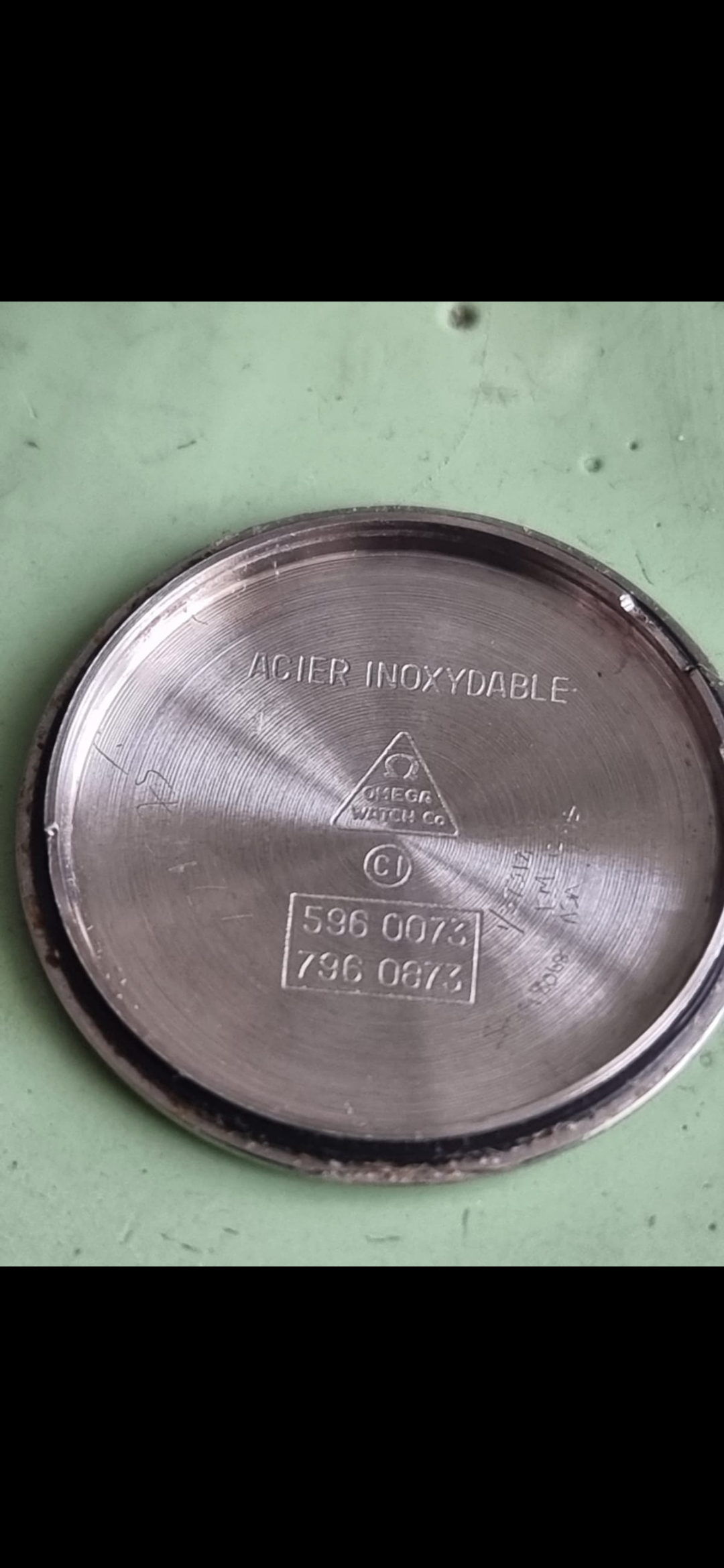

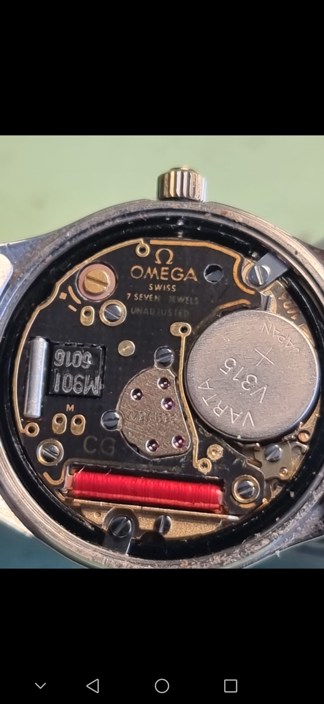

I now have the back off, I can't find information on the link you sent, do you know what it all means? Unfortunately the old battery has leaked so movement will need replacing, do you have any advise on what to do, also what the watch is worth?

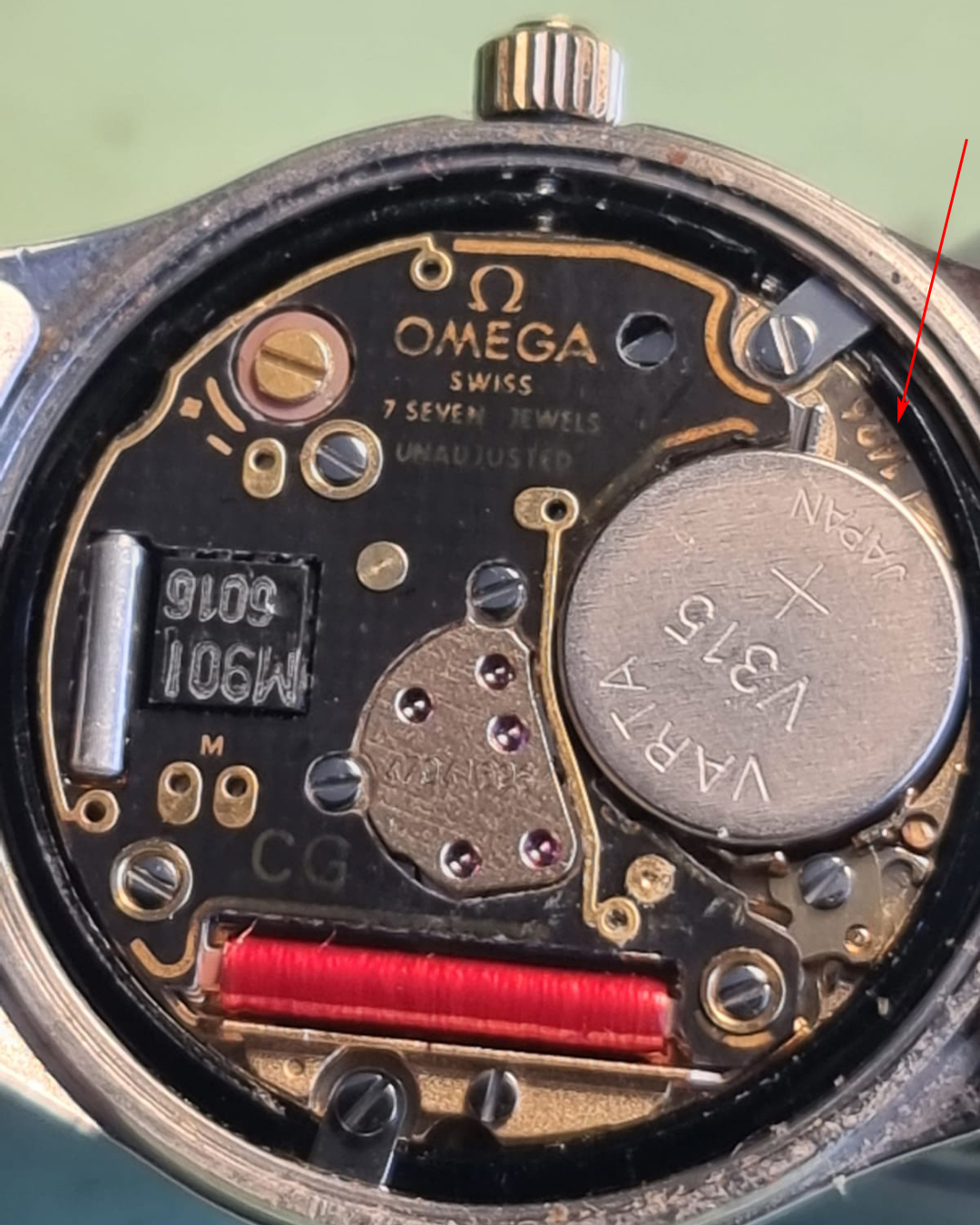

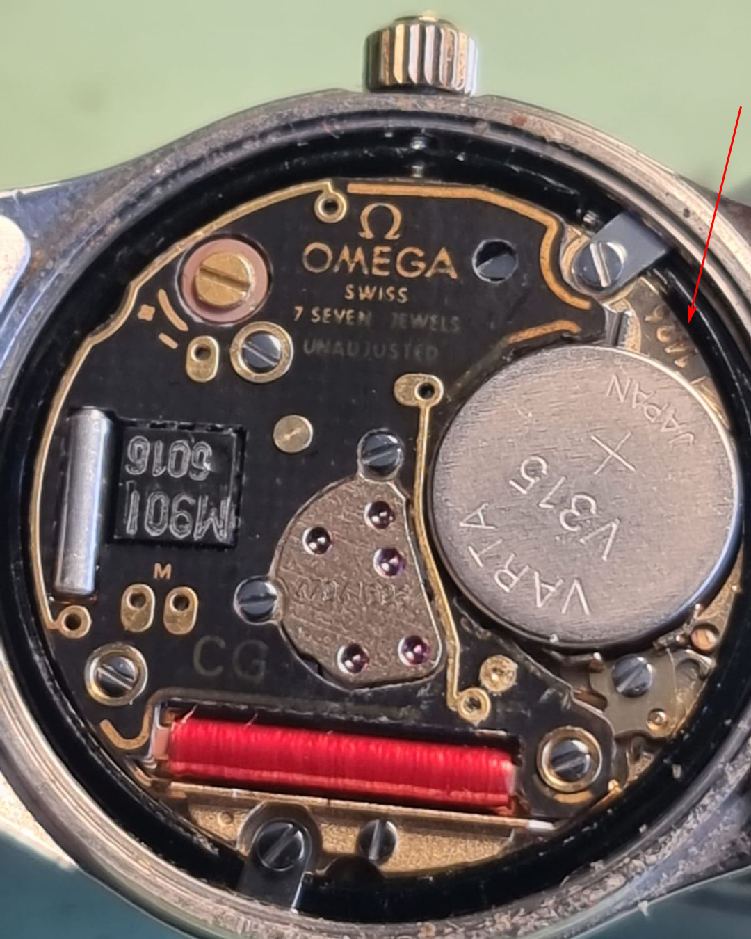

As @X350 XJR noted, it's a mid 1980s issue with a caliber 1426.
The numbers in the caseback, 796.0873, reveal:
7 - Ladies Bracelet Watch
9 - Electronic
6 - Water-resistant Calendar
0873 is just the series number for that model.
You can get an idea of value by searching for sold listings on eBay or Google either of the two numbers.
