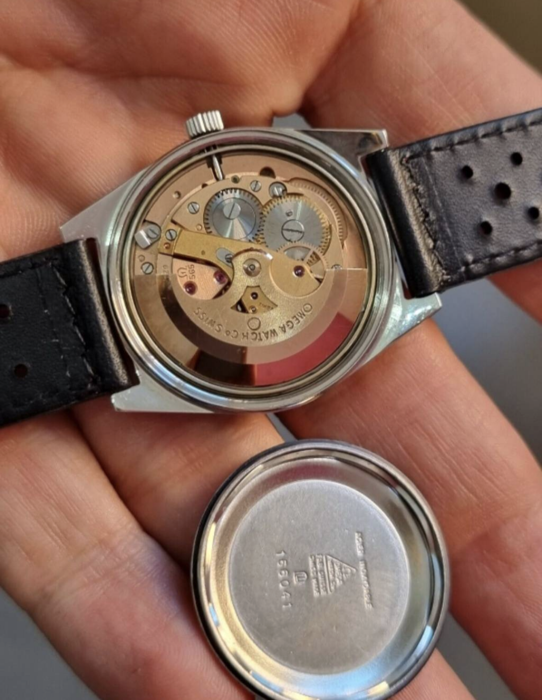

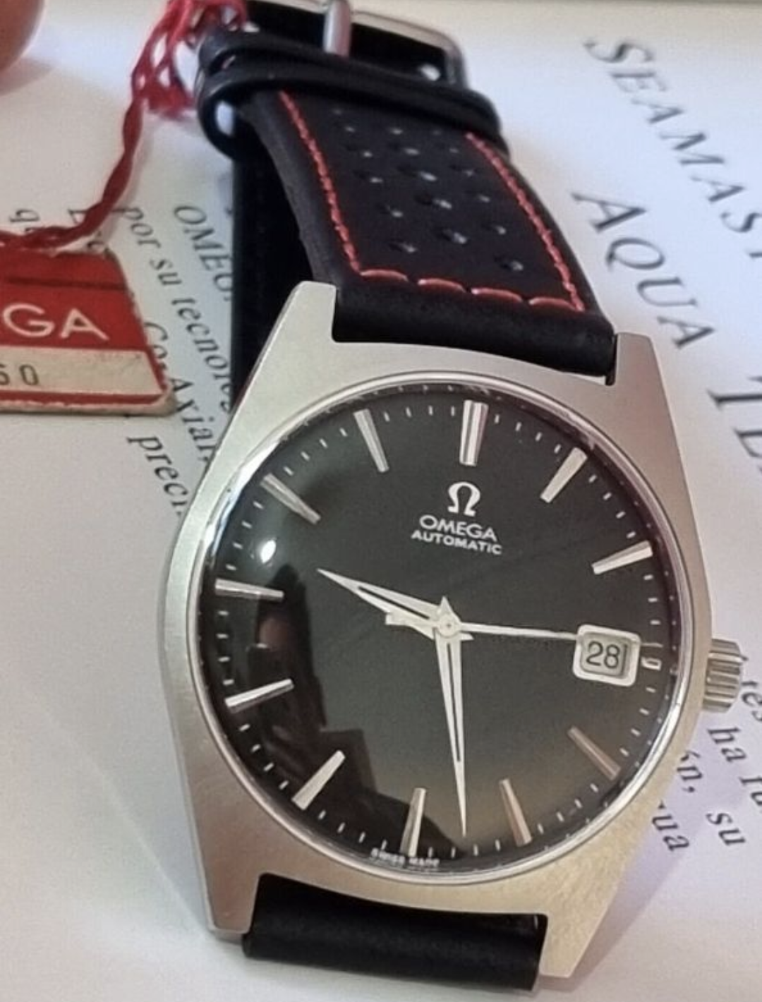

Hey guys, I'm currently considering to buy an omega seamaster and found this one here. I think it's safe to say the strap is not original, but how can I make sure the watch itself is not a fake one? Are these pictures that have been provided to me enough to judge?
Ref: 166.041 from 1960 according to seller.
The seller says it's a cal. 565 one.
Thank you for your help guys!

Refinished dial and incorrect hour + minute hands. Looks like the crown is incorrect too and possibly non-Omega. Worth ~$150 for parts imo.

Many thanks guys, will skip this watch then. Keep looking for a 166.010 model wit ROB, wish me luck.

I've bid 150 euros on every 565 Geneve as a watch I saw, multiple platforms and out of 100+ bids, 0 wins 😁
This will sell for $350 in a day, any day - regardless of the afterwork
That tag on the other hand ... hate it
