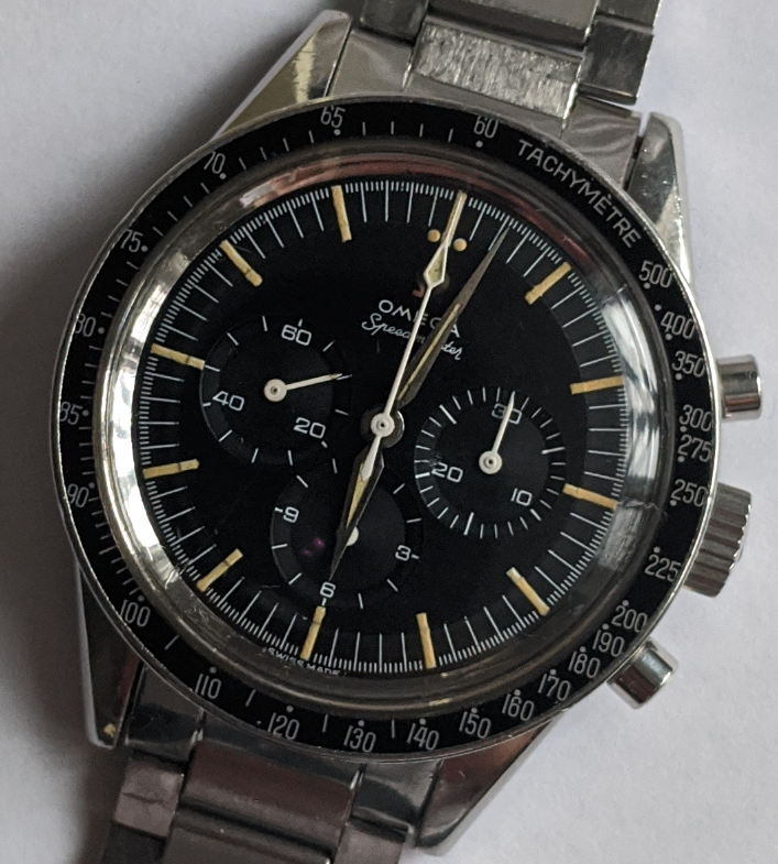

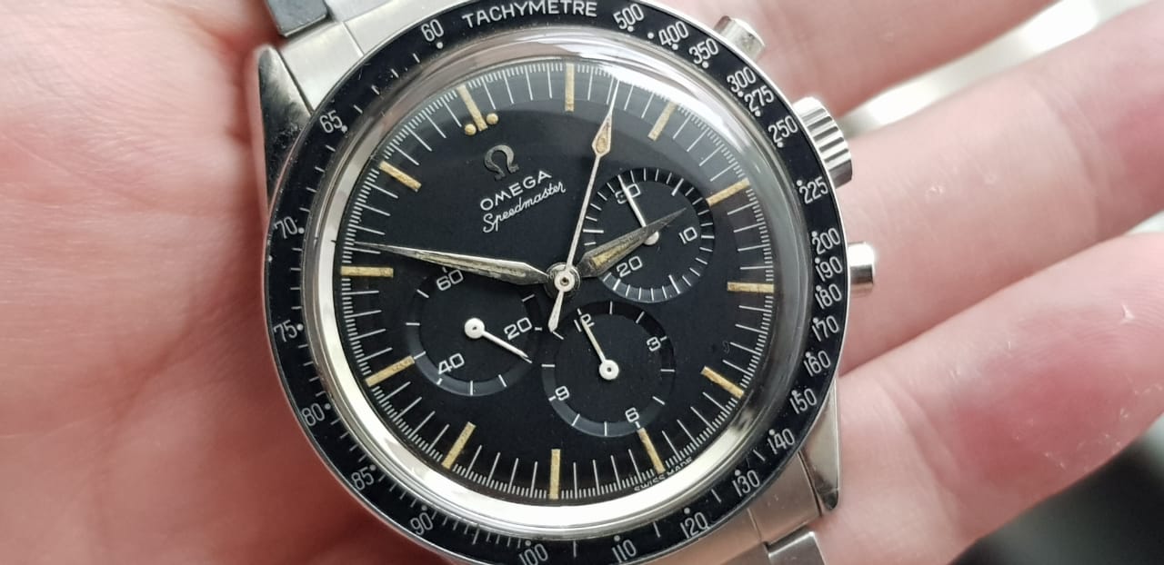

Example 1 - 2998-6
To me looks like:
Good Patina, Original Lume on dial and hands
Excellent Condition Dial, no spots or scratches, I believe thats just dust
Serial in Range for 2998-6
Nice DON, seems like correct pushers and crown
Strong Case - maybe unpolished
Original Flat Link bracelet with clasp to 1961
CON: Later 617 End Links
NEED: A couple better shots of the case

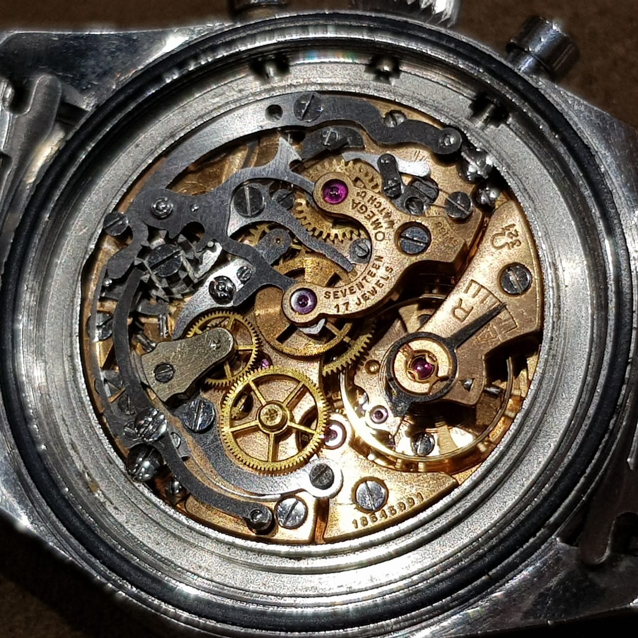

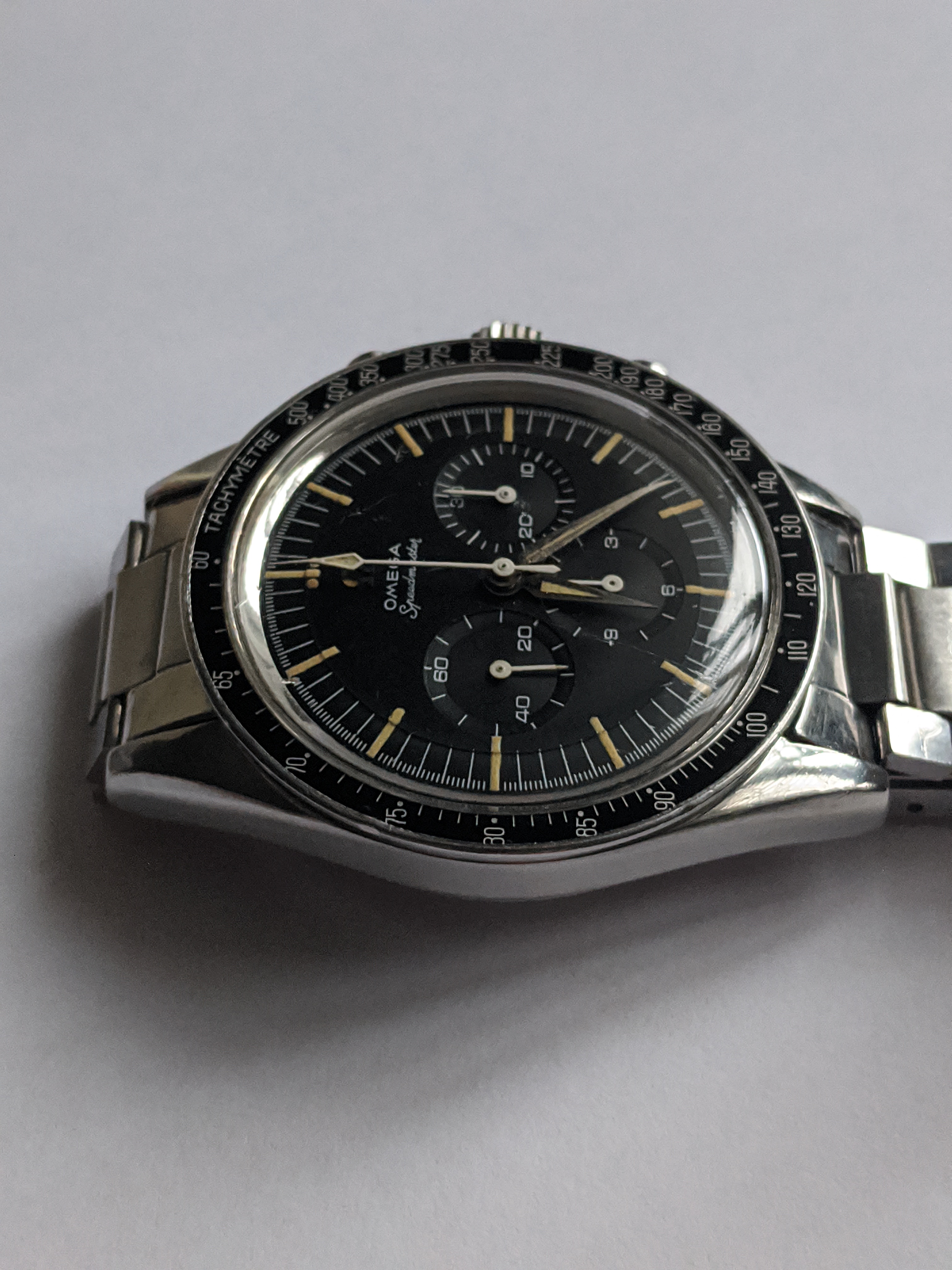

Example 2 - 105.002
Stronger Patina
Serial in Range for 105.002
Original Flat Link bracelet with 6 end links
CON: Numbers 60-100 on the DON bezel seem slightly more clipped than normal, but I am probably incorrect.

#2 is more attractive. Dial and hands are nicer. I am a little confused by the bezel numbers cut off. And bracelet refinishing looks a bit strange (12 o clock). I'm willing to bet case #2 is sharper as well (caseback too).

But I would dismiss the 2998 because if it is not a (older) re lume it sure looks poor.
The cut off bezel is correct, but in my idea it is worth less than a bezel that has no problems.

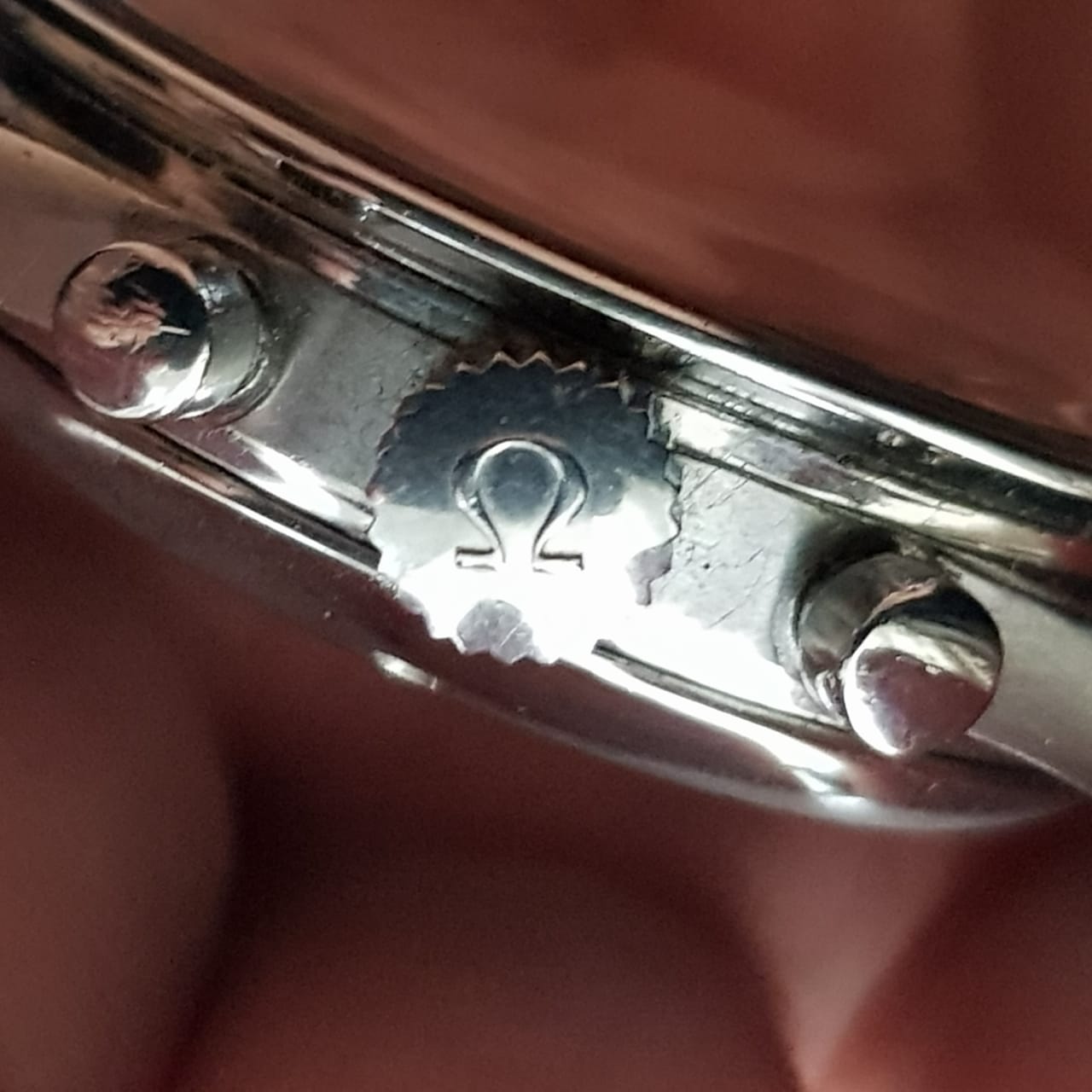

Dont miss that the 105002 has a lug engraving.

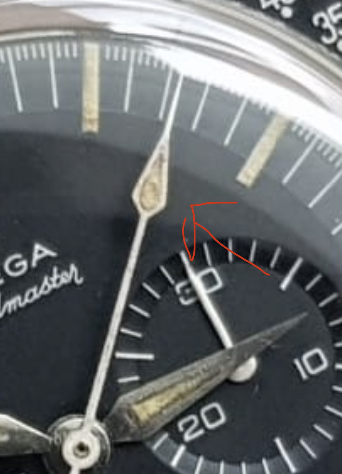

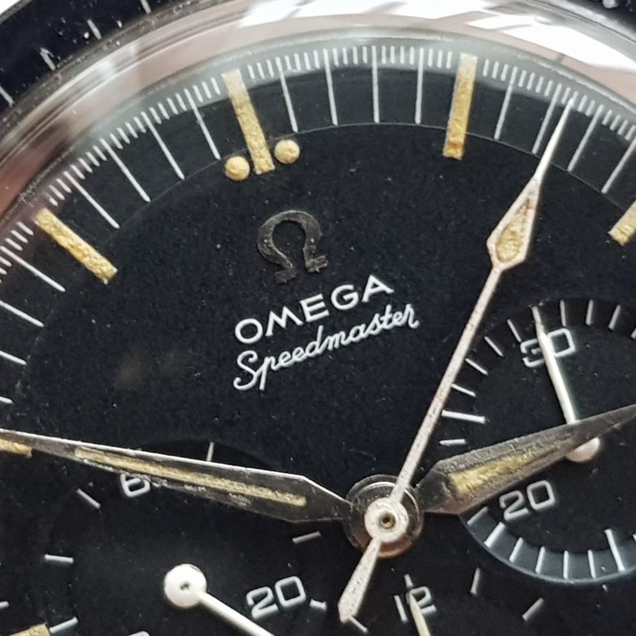

Would a black light shot of the lume on the 2998 help determine its originality? After spending a ton of time reading about the lume plots, it seems very difficult to know if they are original, even speedmaster101 had some back and forth on an Ed White.

The bezel wouldn’t worry me one bit. There are a lot of them like that. It’s the dial/lume/hands that is most important, and in this case the winner clearly is the 105002. But again it all depends on price, as @Spacefruit said. Mind sharing?

The 105.002 is the winner of these two.

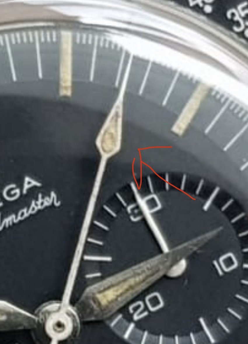

A closer look at the chrono hand on the 2998 would make me think something has been done with the lume.
Also, I would not change that bezel.

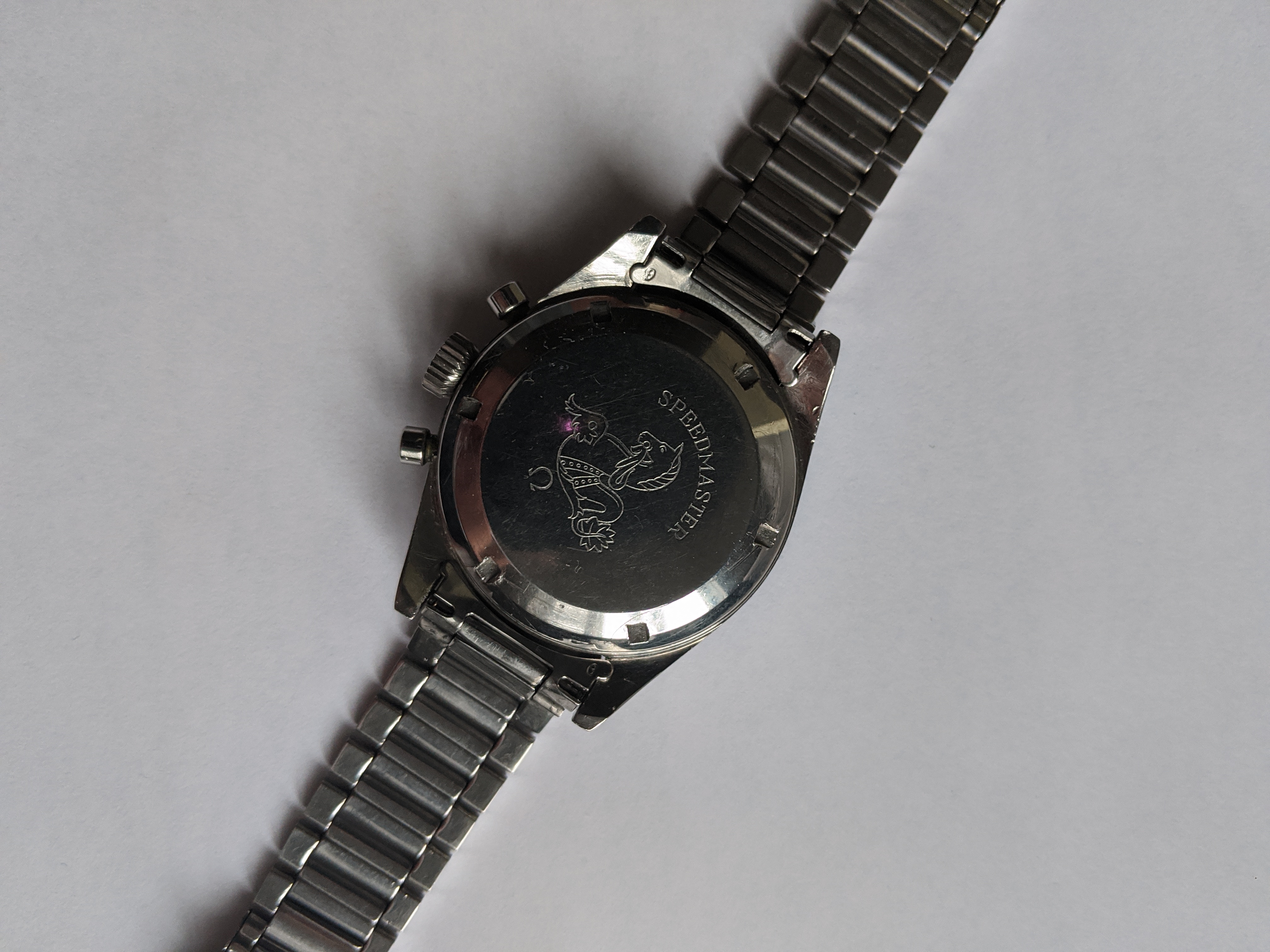

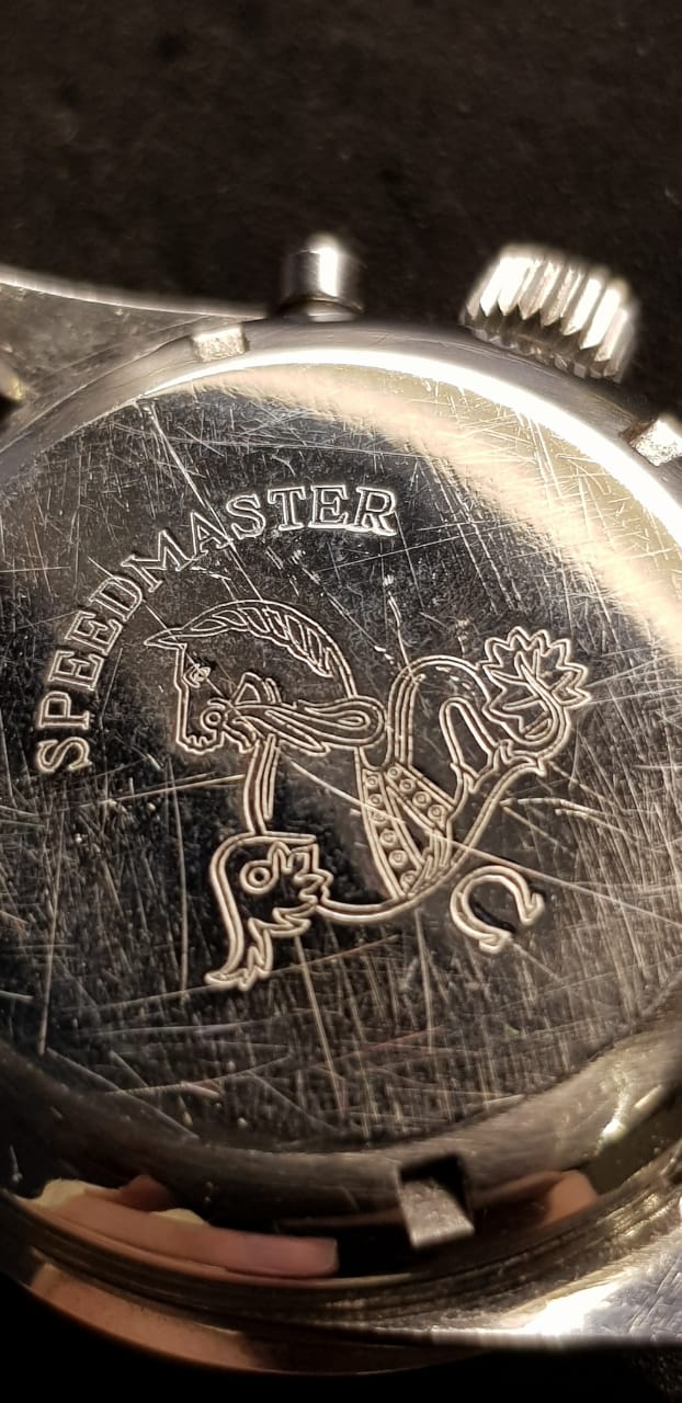

The 105.002 does have an extract of the archives also which seems uncommon. Produced 1963 and delivered to Denmark.
3,653
7,770
If you have the proof by an EoA this is a nice extra specially for a 105.002 - I would go for this, it also looks nicer, I would not mind the bezel.

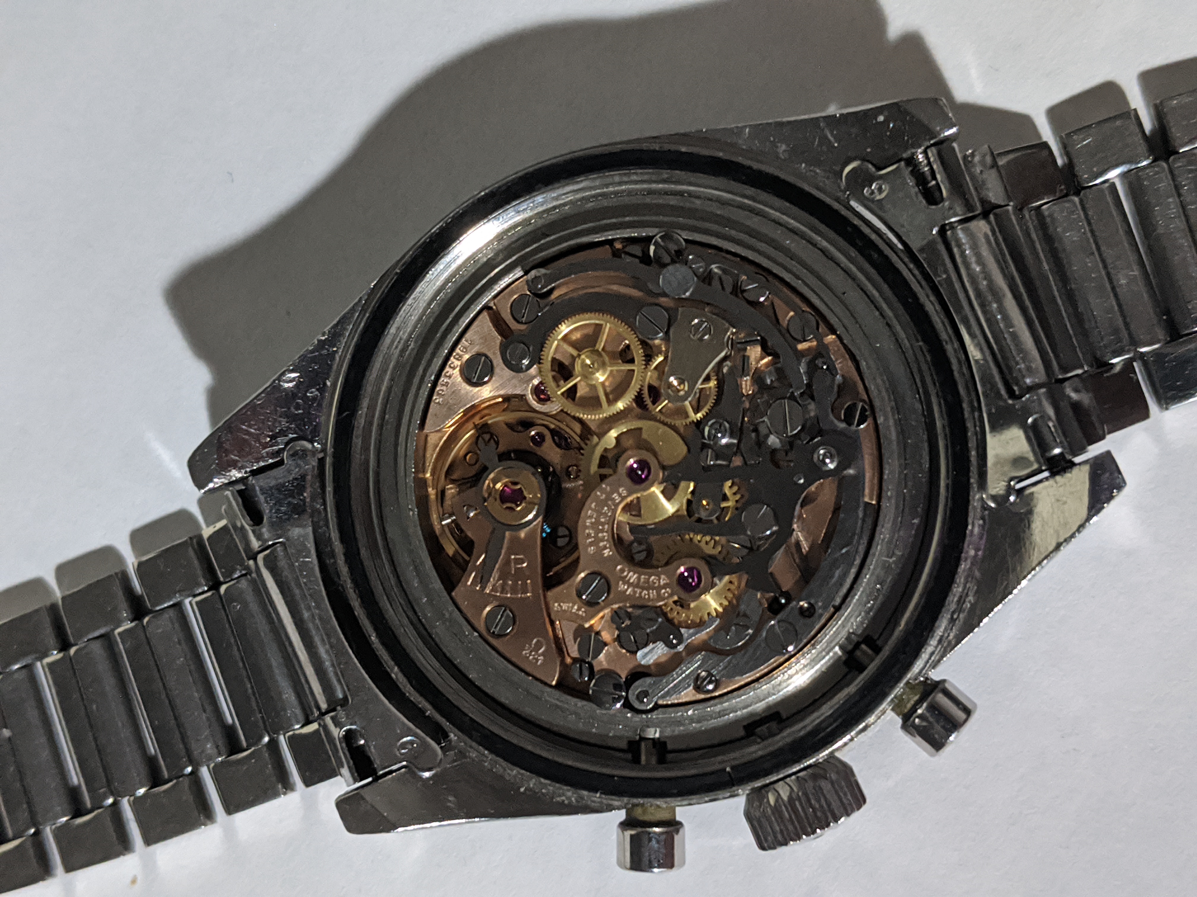

I assume you can see these and are not buying from these pictures? As these must be $10000+ you'd imagine someone could take a few reasonable photos...
The first one appears to have non synchronized hour and minute hands and it looks like the minute jumper spring is incorrectly installed. Coupled with a very sad looking movement, I'd imagine that this watch has not been well looked after. The dial lume seems to bear that out.
The second one (105.002) looks a nicer watch that appears less badly treated. But the photos are still poor.
