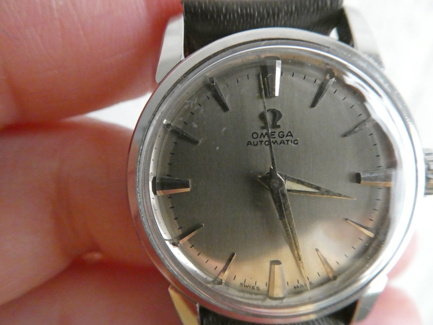

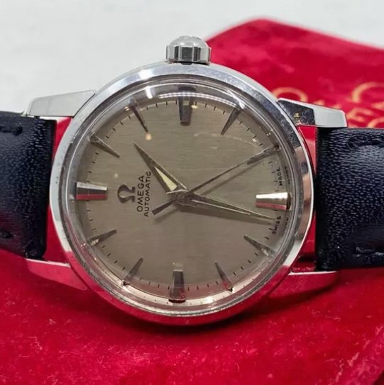

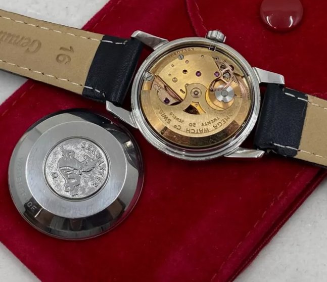

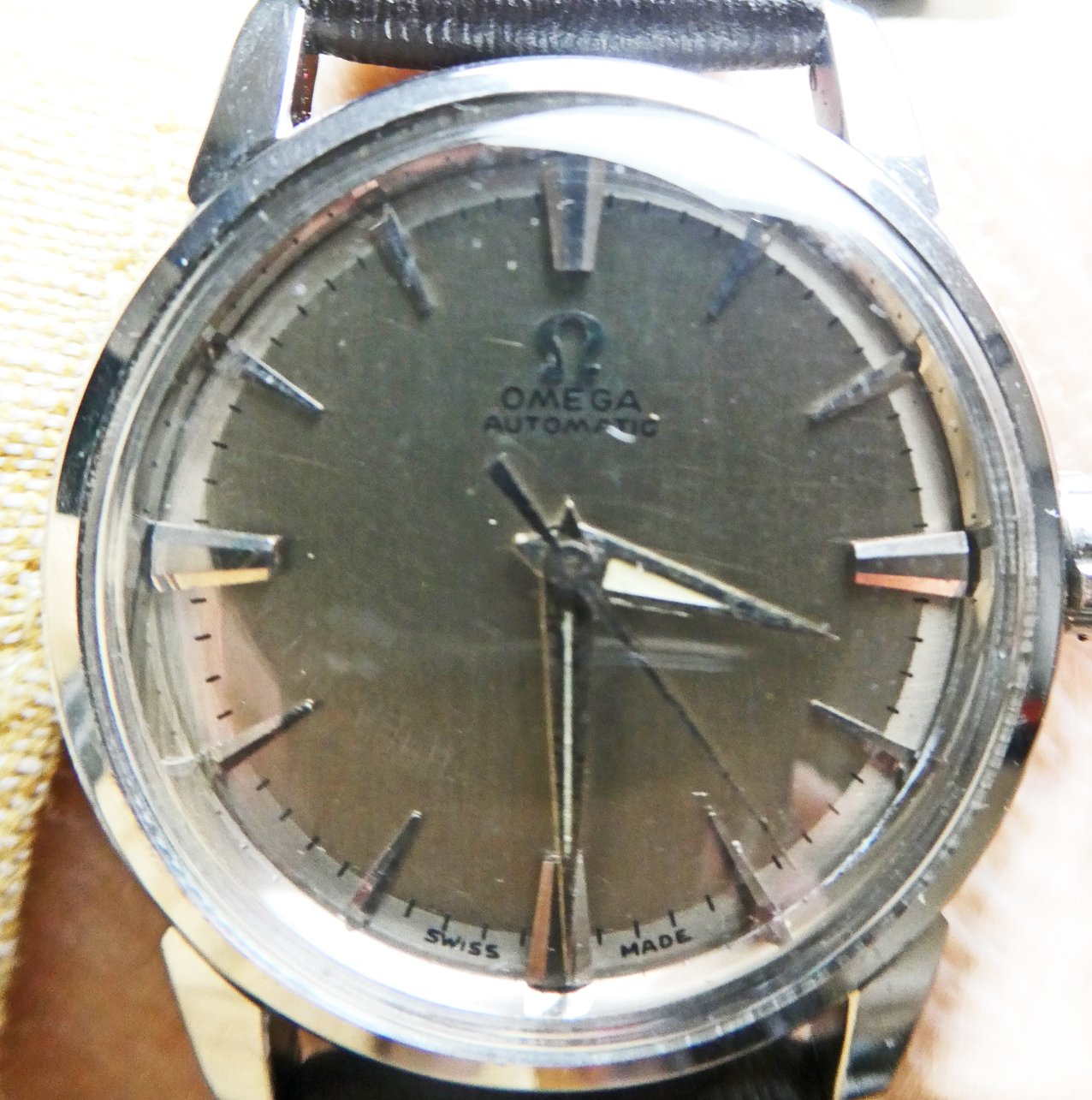

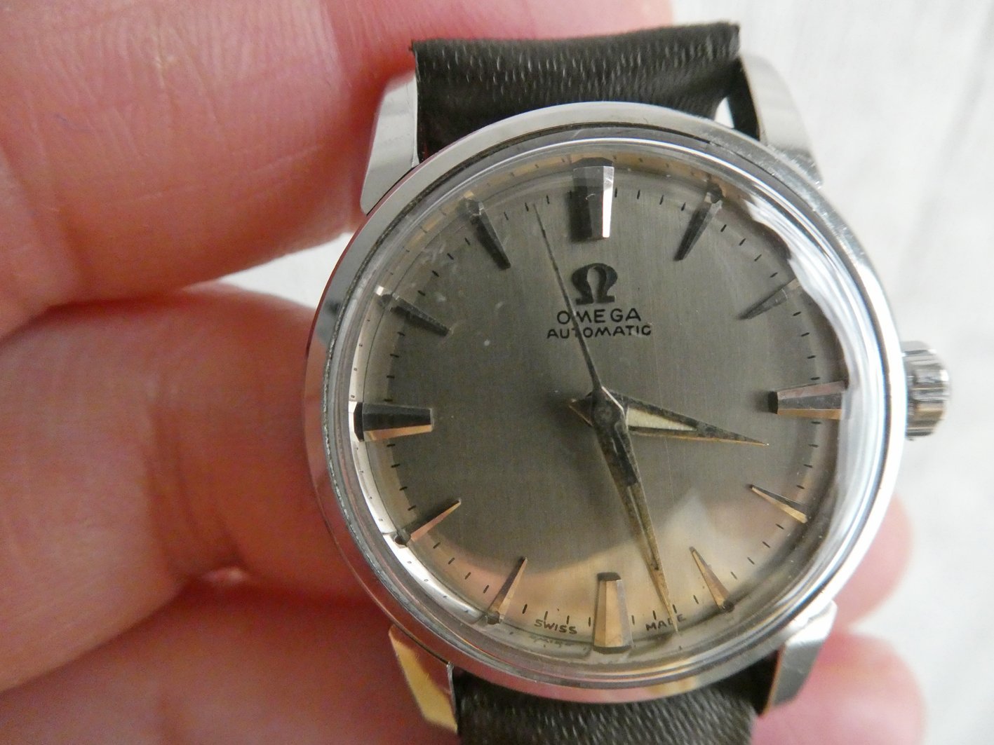

Omega have played fast and loose over the years about what is a Seamaster and what is not. Generally if it says SM on it somewhere, front, back or wherever it will be water resistant to at least 30m and will have gaskets in the caseback and crown. If you don't see gaskets or the place where they would have been its not a Seamaster. Some water resistant models are not Seamasters (eg the Speedmaster series, all modern peices) but no Seamaster has no water resistance. Both models you show above tick the boxes to have been sold as Seamasters but sometimes even when the back has the logo, the dial doesn't.
At the risk of sounding a bit defeatist, with your budget I think you are going to struggle to find something nice. Even if you negotiate the originality minefield and find something that hasn't been messed about, the chances are it will need a service at the least which will add about £200 to your outlay, maybe more. Meaning to hit your budget you really need to find something nice for £100, even in ladies pieces that is a tall order.
25
9
That one might have an original dial but has other serious problems. It looks to have bad corrosion on the lugs, though it might just be filthy and the rehaut round the dial is missing which can mean either it has an aftermarket crystal or the dial isnt right for the case. I'd steer well clear of that one.

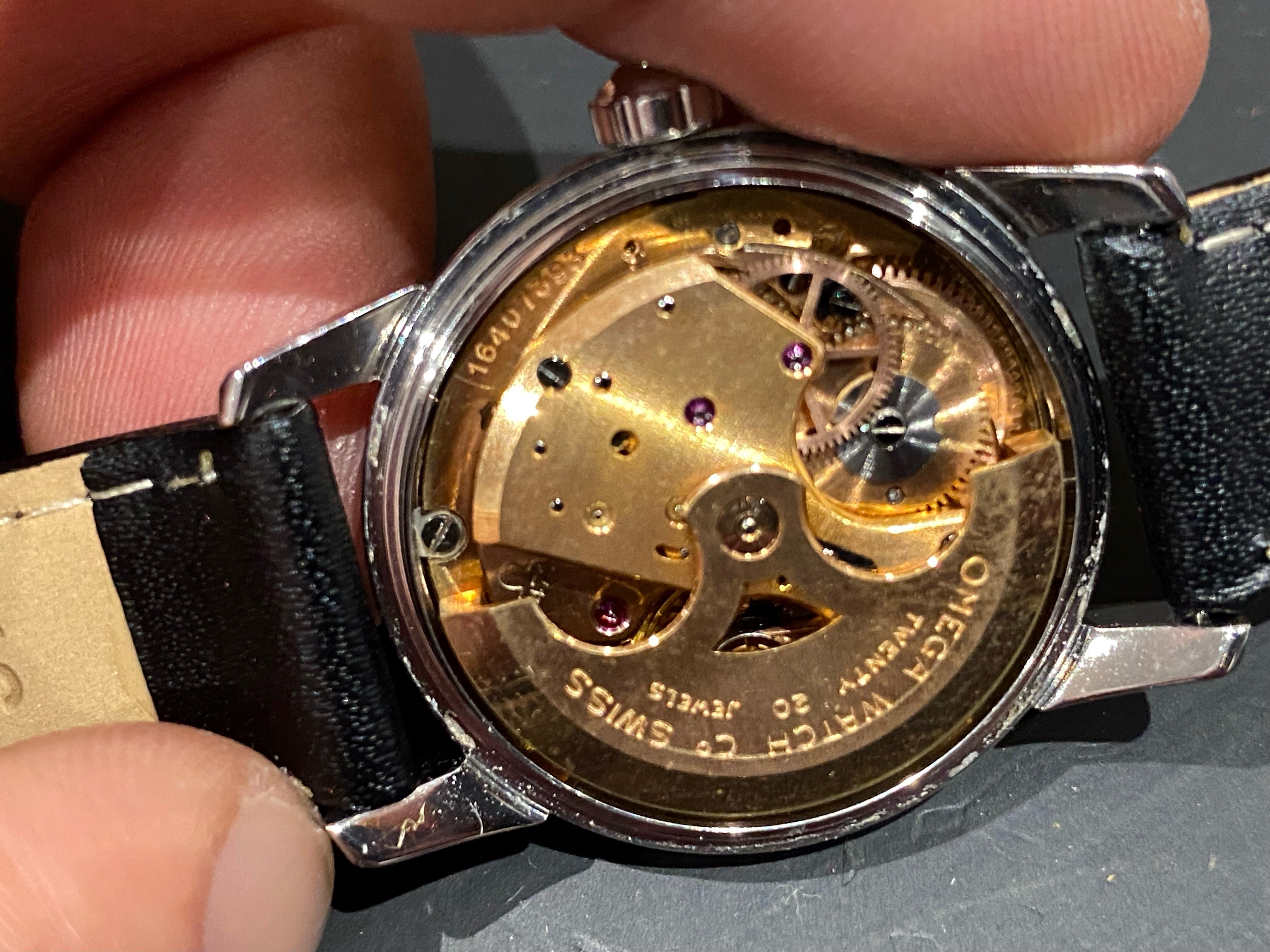

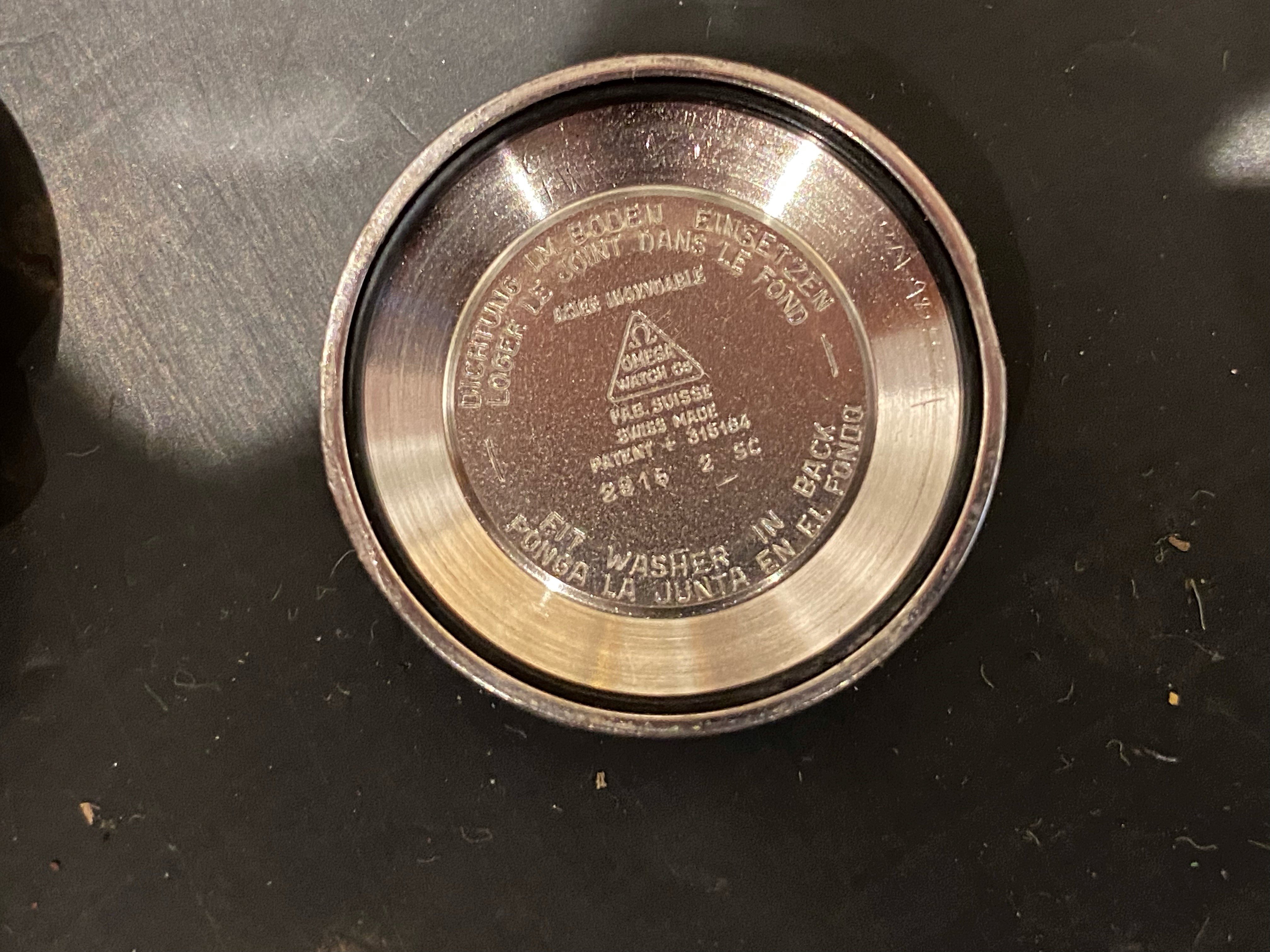

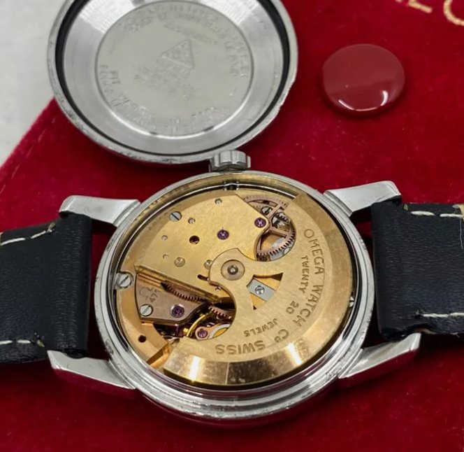

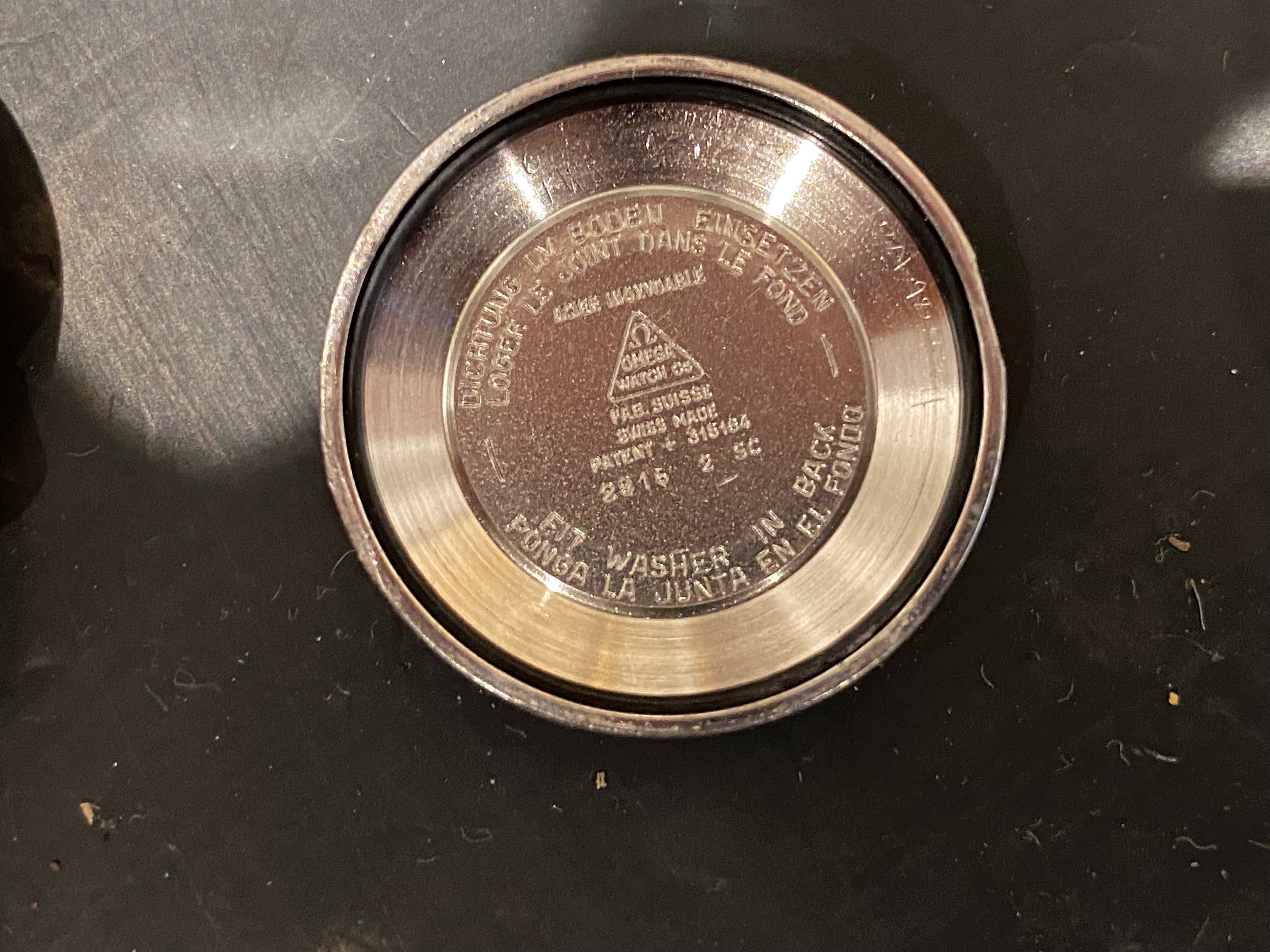

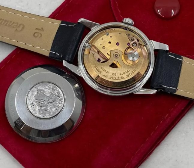

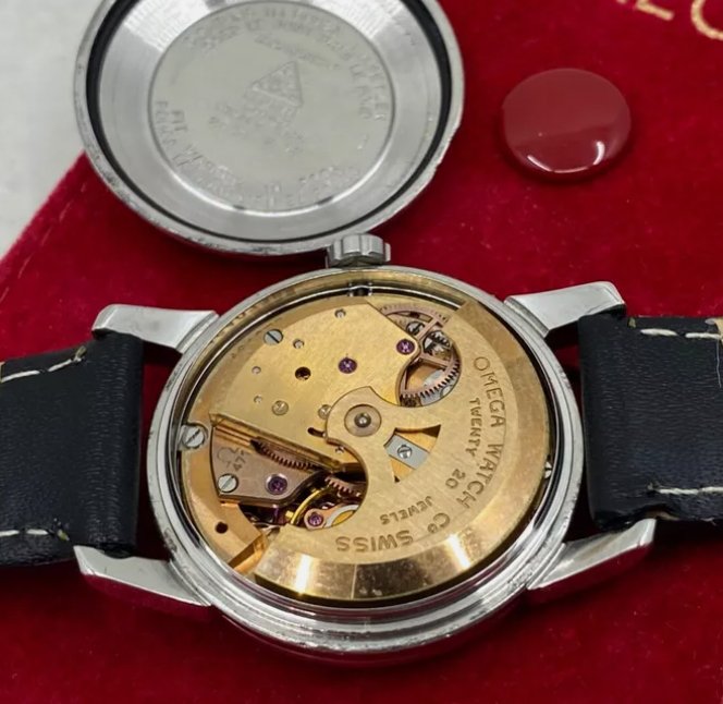

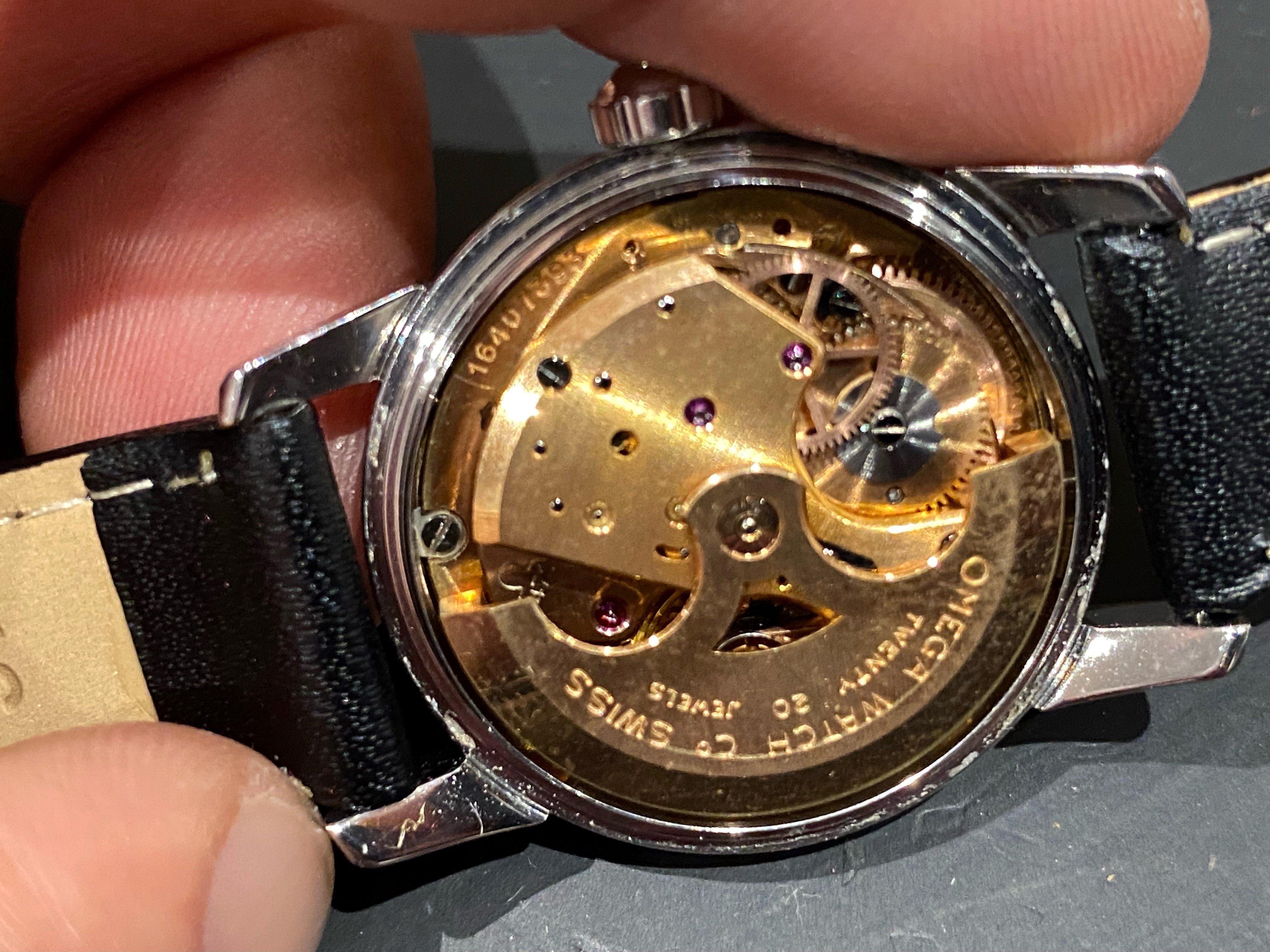

Hello all, I haven't received the watch I have bought yet ( should be tomorrow ), it is the 1958 Seamaster with 30mm case and CAL 471. The inside of the back case was blurry on the photos, but I requested a clearer photo, which is attached. The model is 2816 2 SC, but on the research I did, this dates to 1954 and a bumper movement. Do you think the watch was originally a bumper and has had the 471 movement ( serial number 16407393 ) added at a later date ?
25
9
I think that actually says 2916, which is fine for a late 1950s full rotor model. As you know some of us have reservations about the refinished dial but if you like it and it runs well then you should be all set.

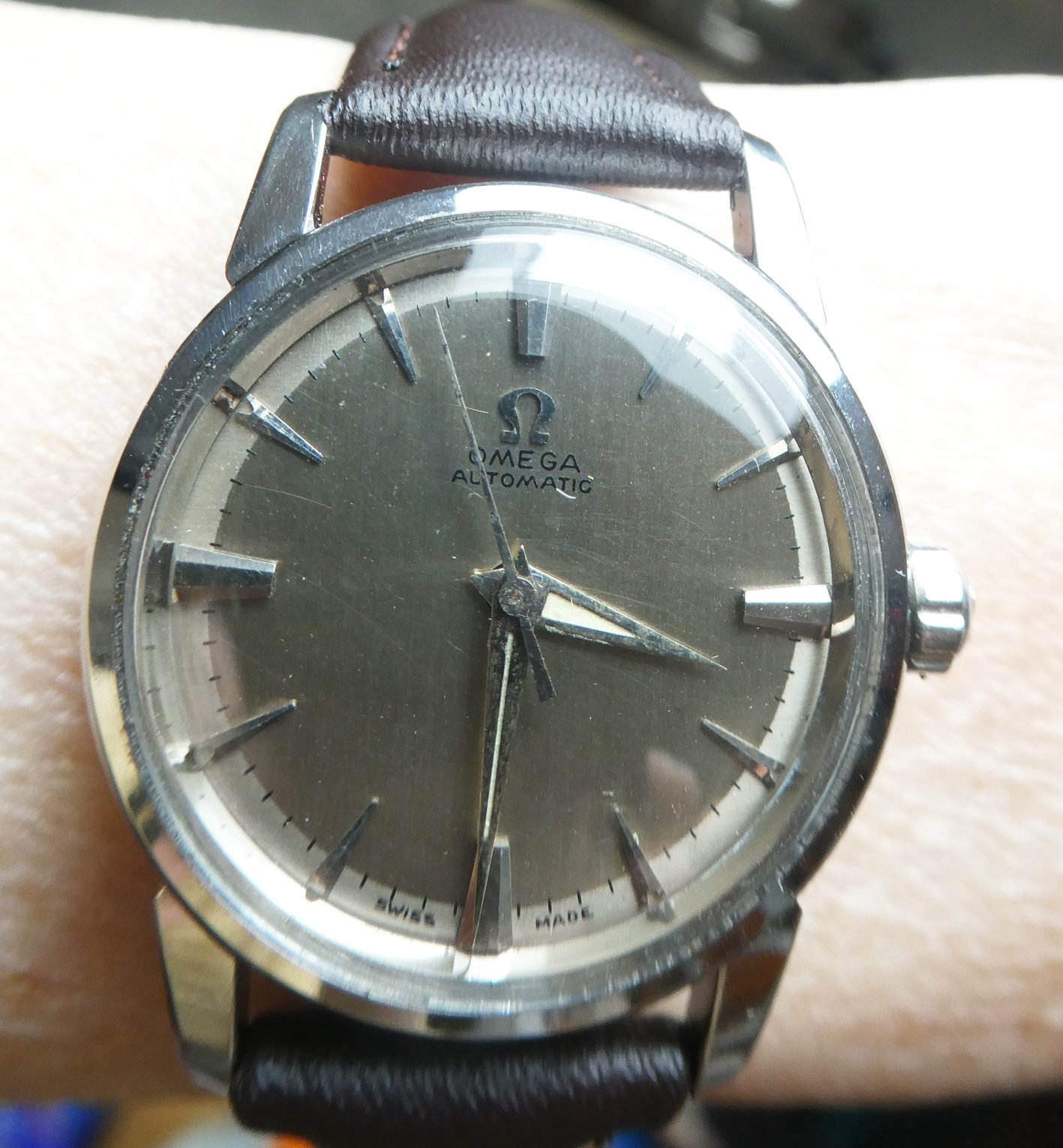

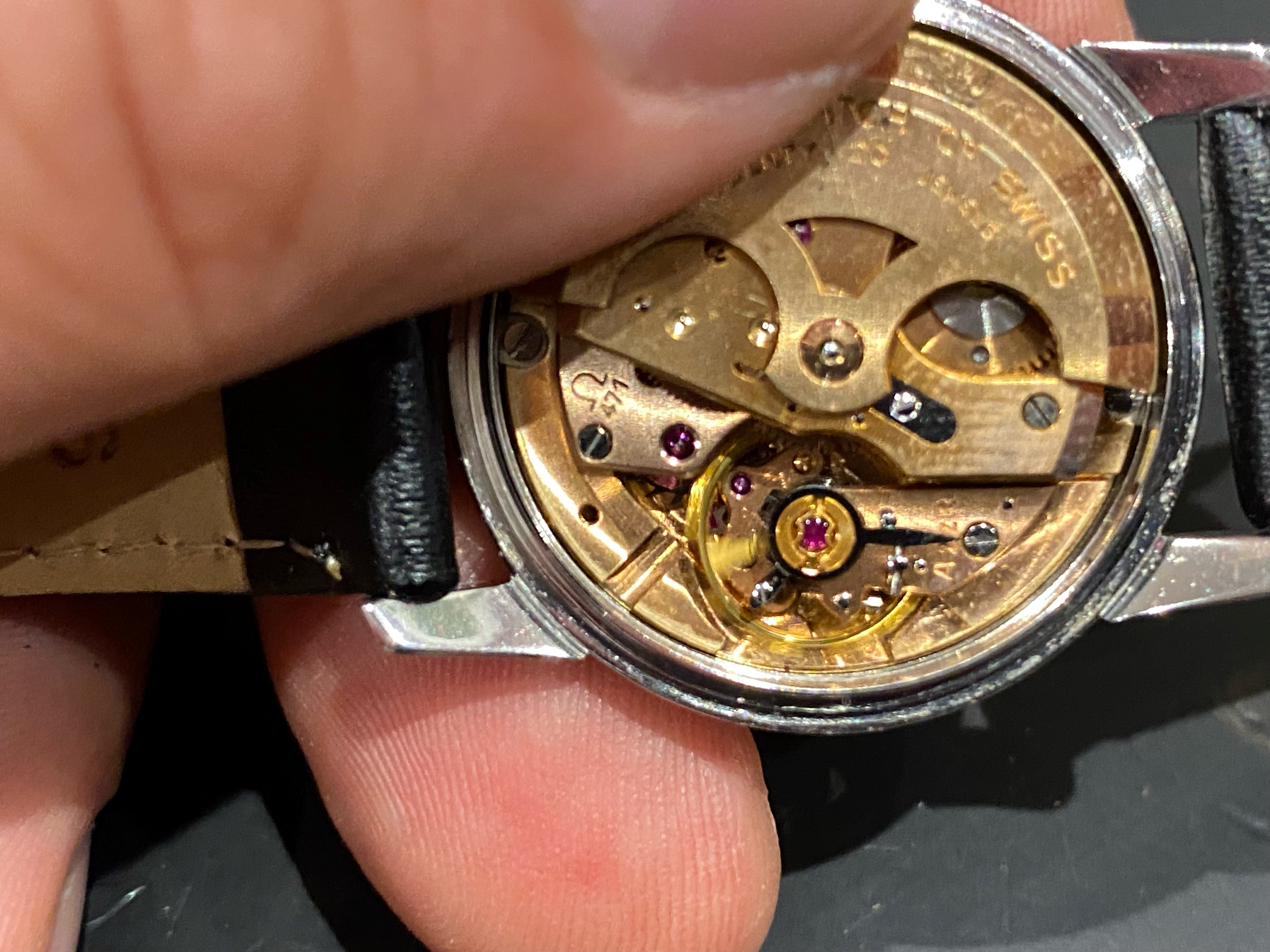

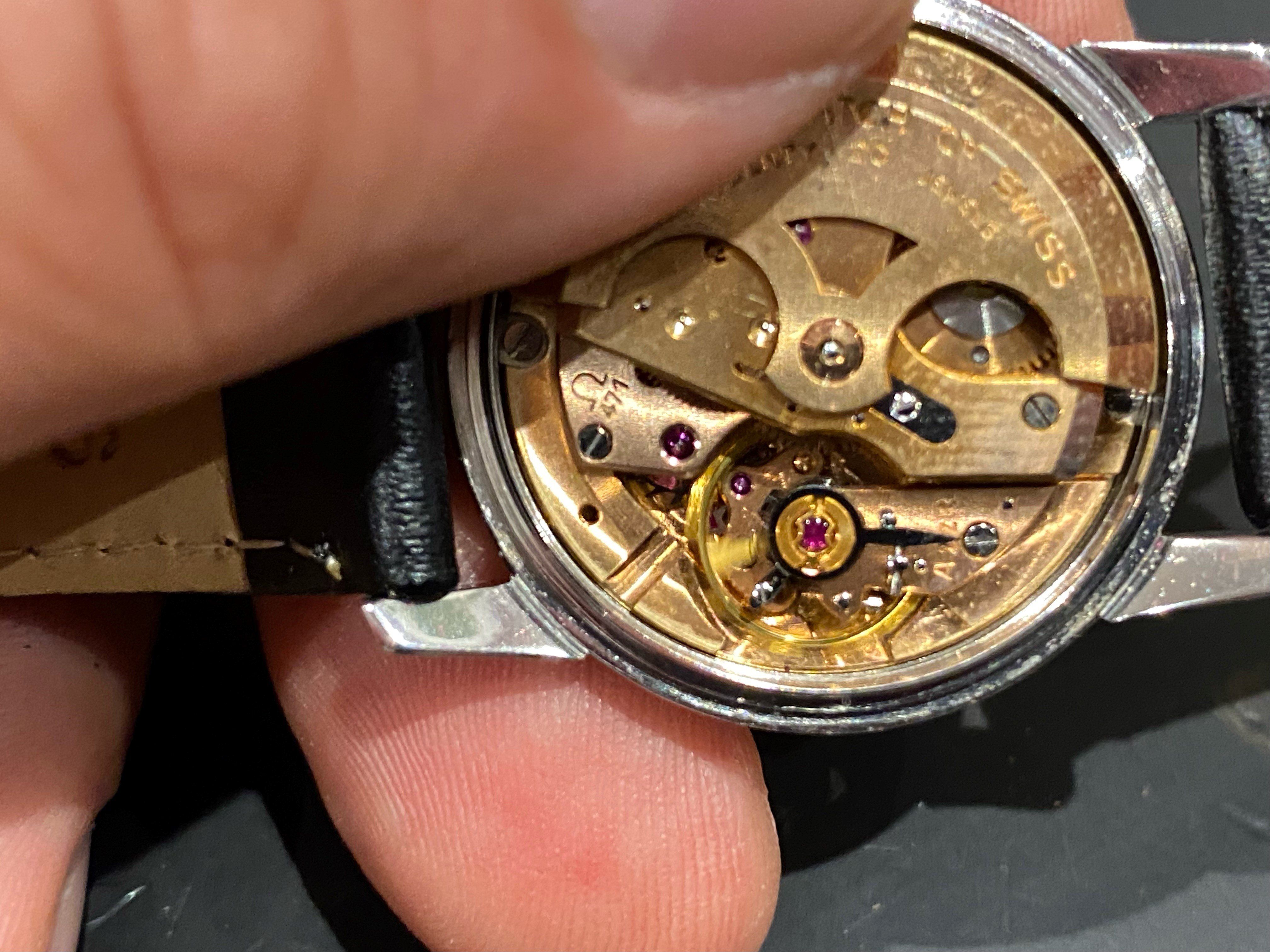

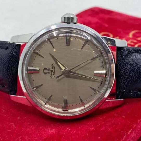

Good morning all, well my watch has arrived and I am totally in love with it! The dial is a champagne gold sort of colour, I think it is still 2 tone but that could just be the way the light hits the dial. I haven't dared to set the time yet, so I will have to do that. Your opinions are very welcome. Thank you all for helping me to end up with a watch I love.
219
209
Glad you like it! That's what matters. Try to send it for general service with a watchmaker once the budget allows it, to ensure it keeps working for many years. Enjoy it and wear it in good health!
