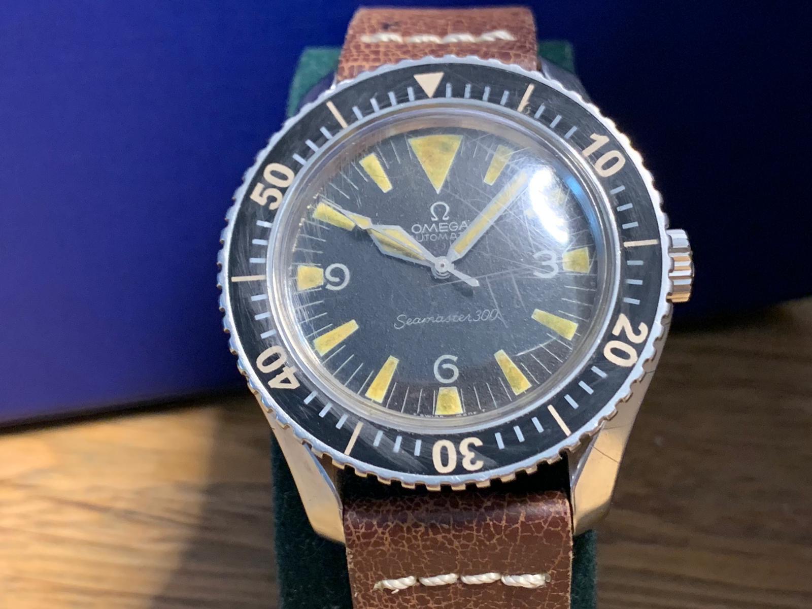

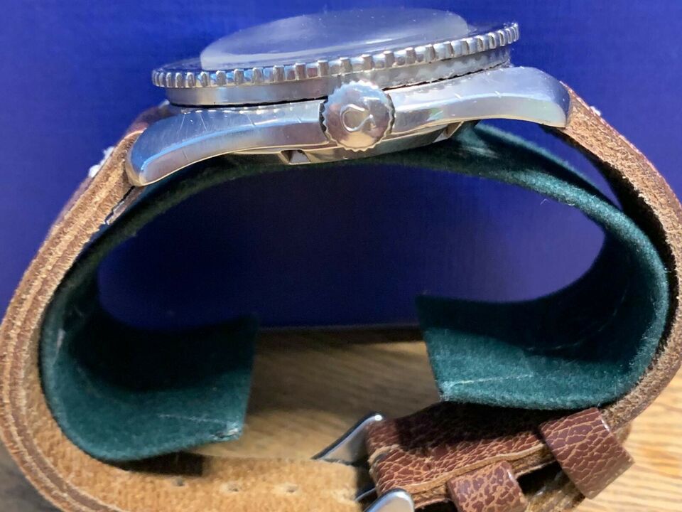

I've been trying a decent Seamaster 300 for some time and came across an ad that looks good at first glance.
Since I have dealt intensively with most of the topics that can be found here in the SM300 forum during my search, I think I can say that this watch is at least tinkering, if not a Frankenwatch.
In my opinion you can see

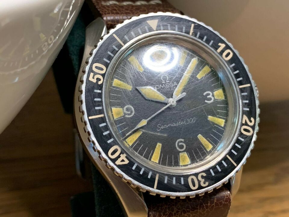

- a fake dial with stubby indexes, missing holes at 12 and 6, maybe wrong font for 3 and 6 (or did the small serifs at the end of the digits sometimes look like this?)
- Fake Bezel, at least I did not find this variant in the variants A-G

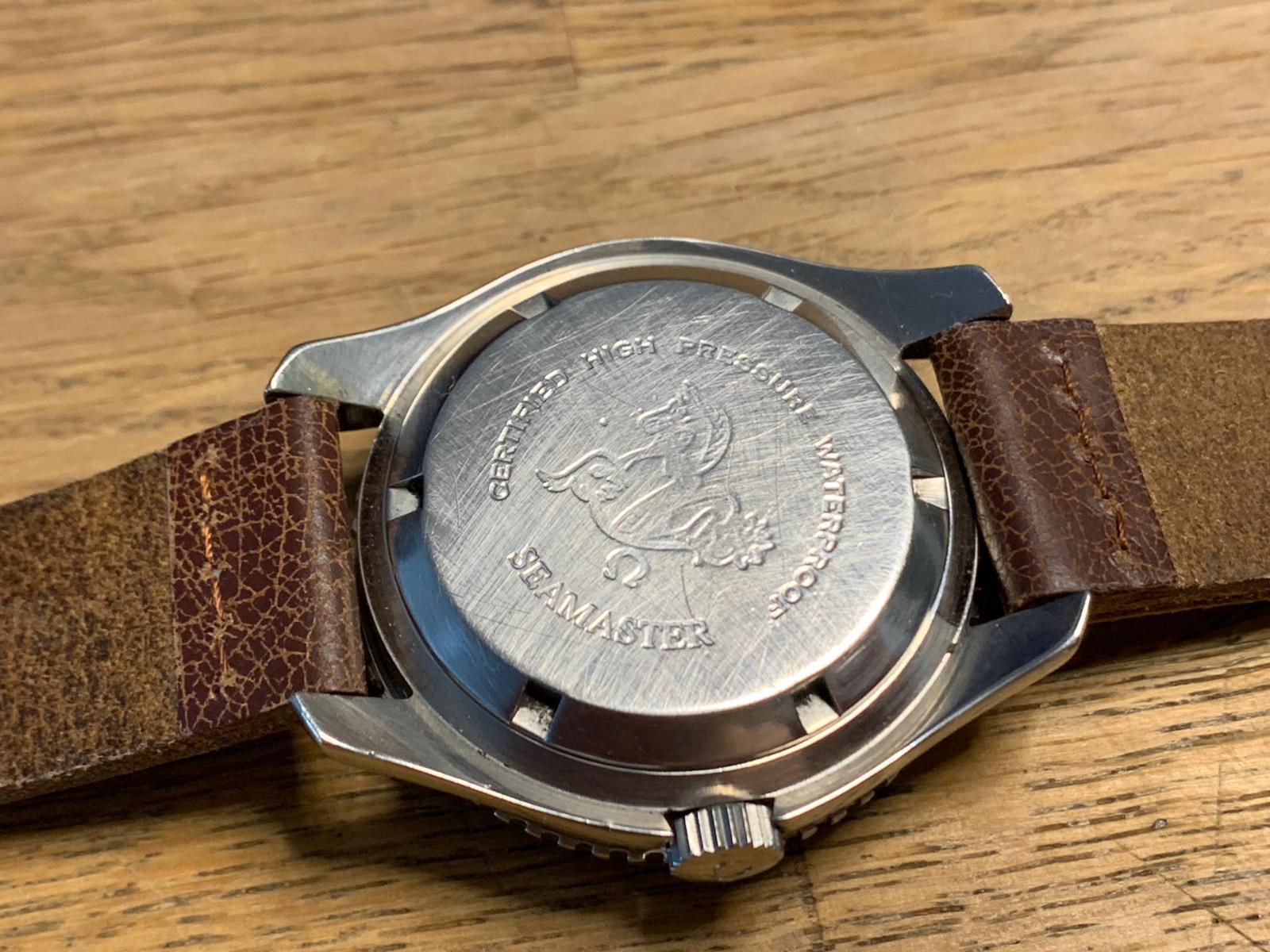

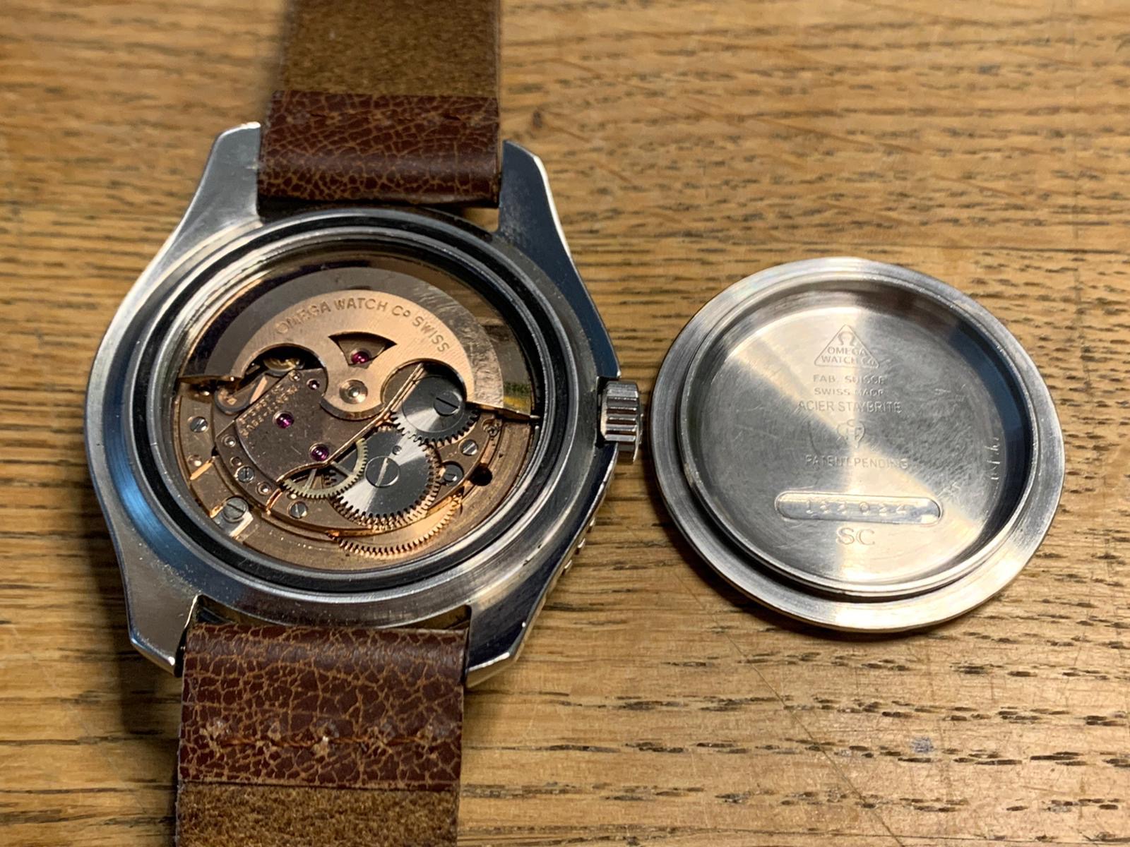

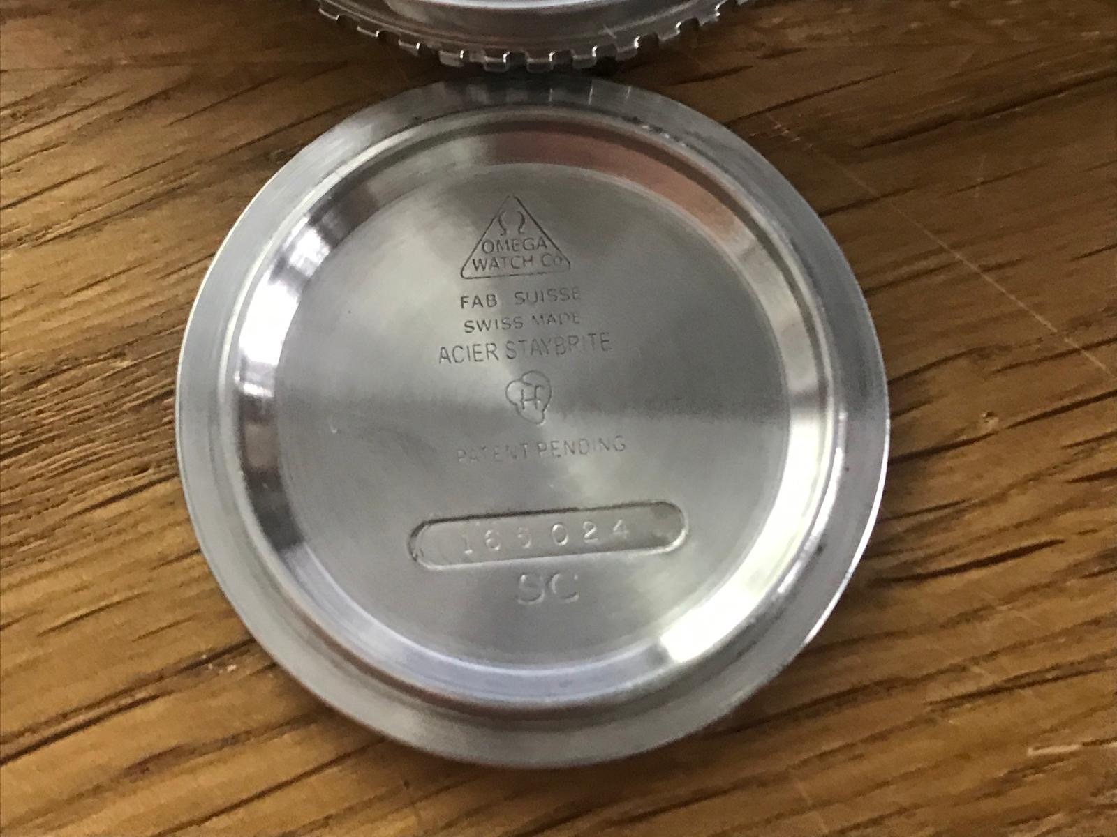

- Lid with unusual inside, 165024 recessed as well as addition SC; the backside looks authentic
- 550 caliber as far as I could tell, no serial number

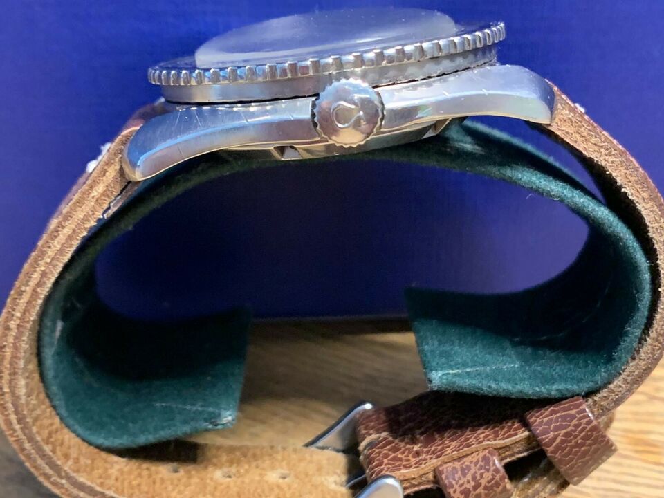

- I cannot estimate the case, crown etc.
I suppose I'd better step back, what would you say? Thank you very much for your opinion.
Best regards from a very interested newcomer ;-)
Harry

As you already noticed, this watch is fake.
So better step back as far as you can... 😉

Thanks for your opinion, will do that 😀

That’s a nice an perfect example.... of a SM300 “All Fake”.
576
1,201
The minute markers going beyond the lume plots. Bezel, crown, movement!! A shocker!

quote from the advertisement: "this is an heirloom and I don't know much about it" 😗

Do they still actually make these fake dials with the stubbies or was there simply a large batch 10-15 odd years ago?

Some very careful artificial wear on that case back 😁
Lol! I went back and looked...sand paper to the right and left, now sand paper up and down, now back to the left and right...perfect!
