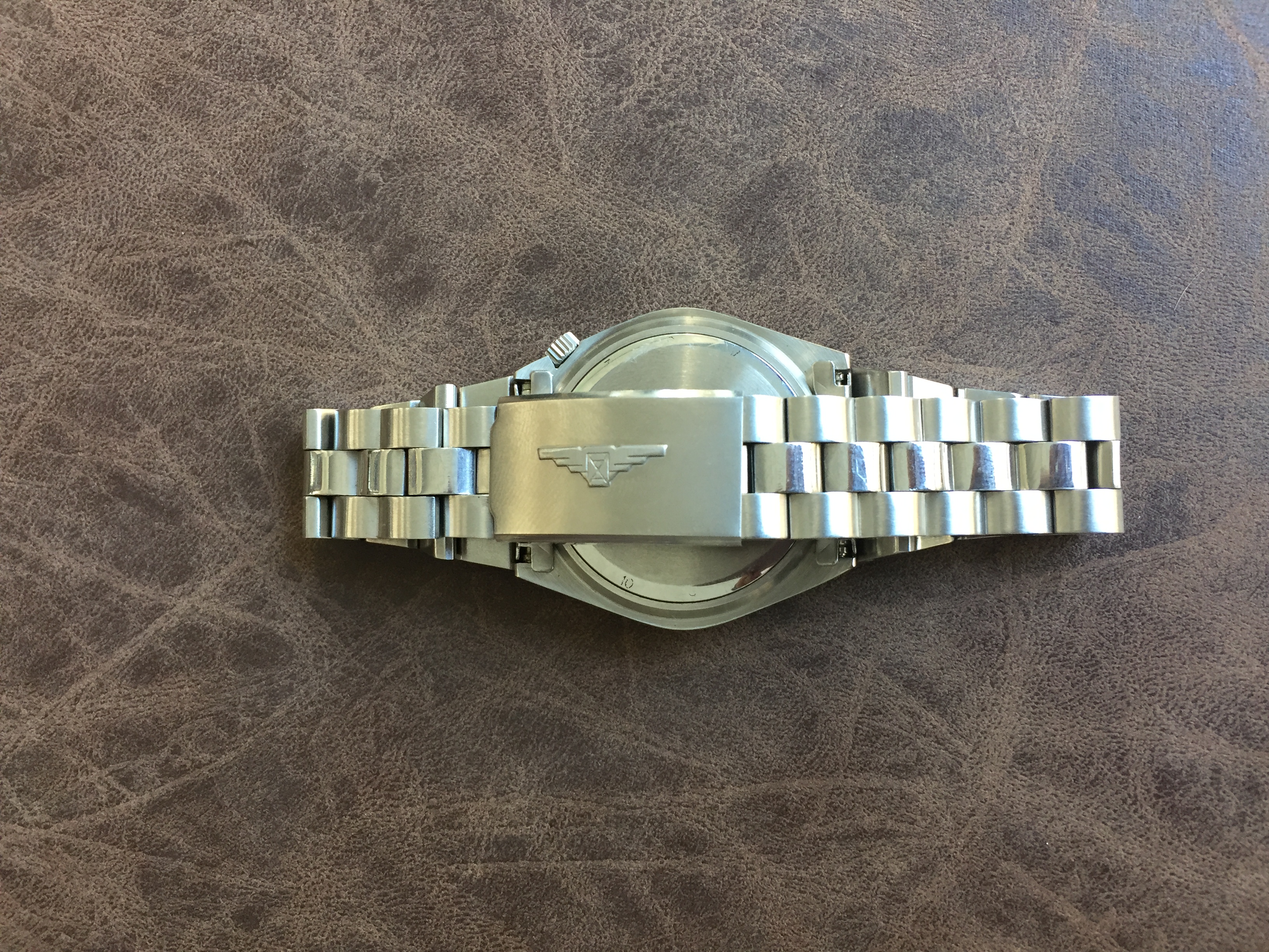

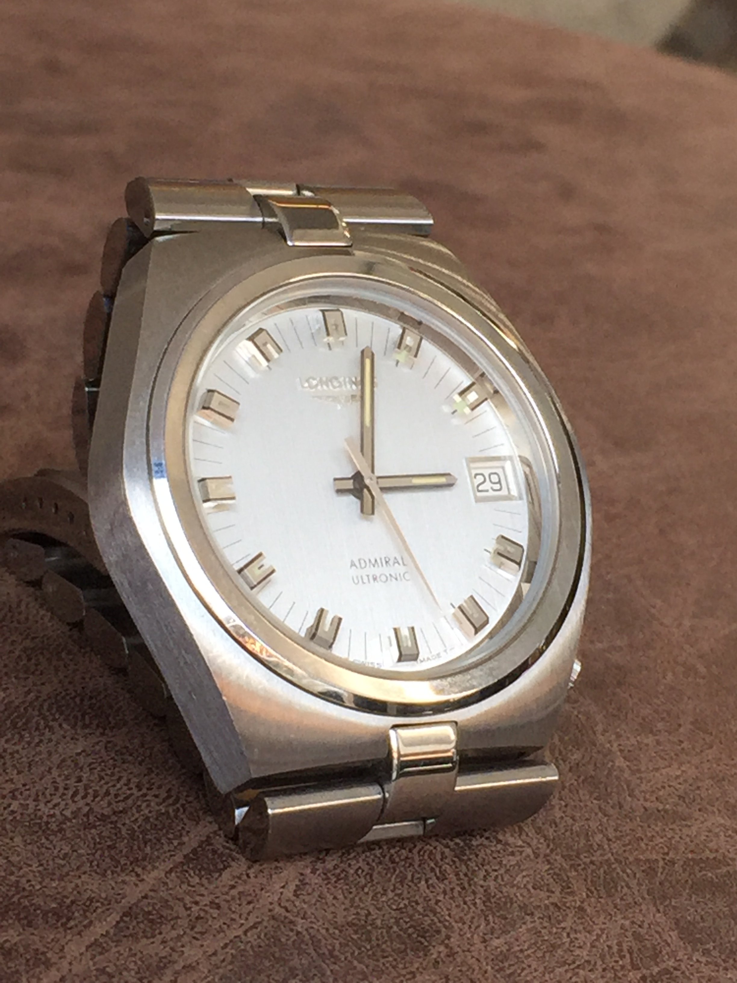

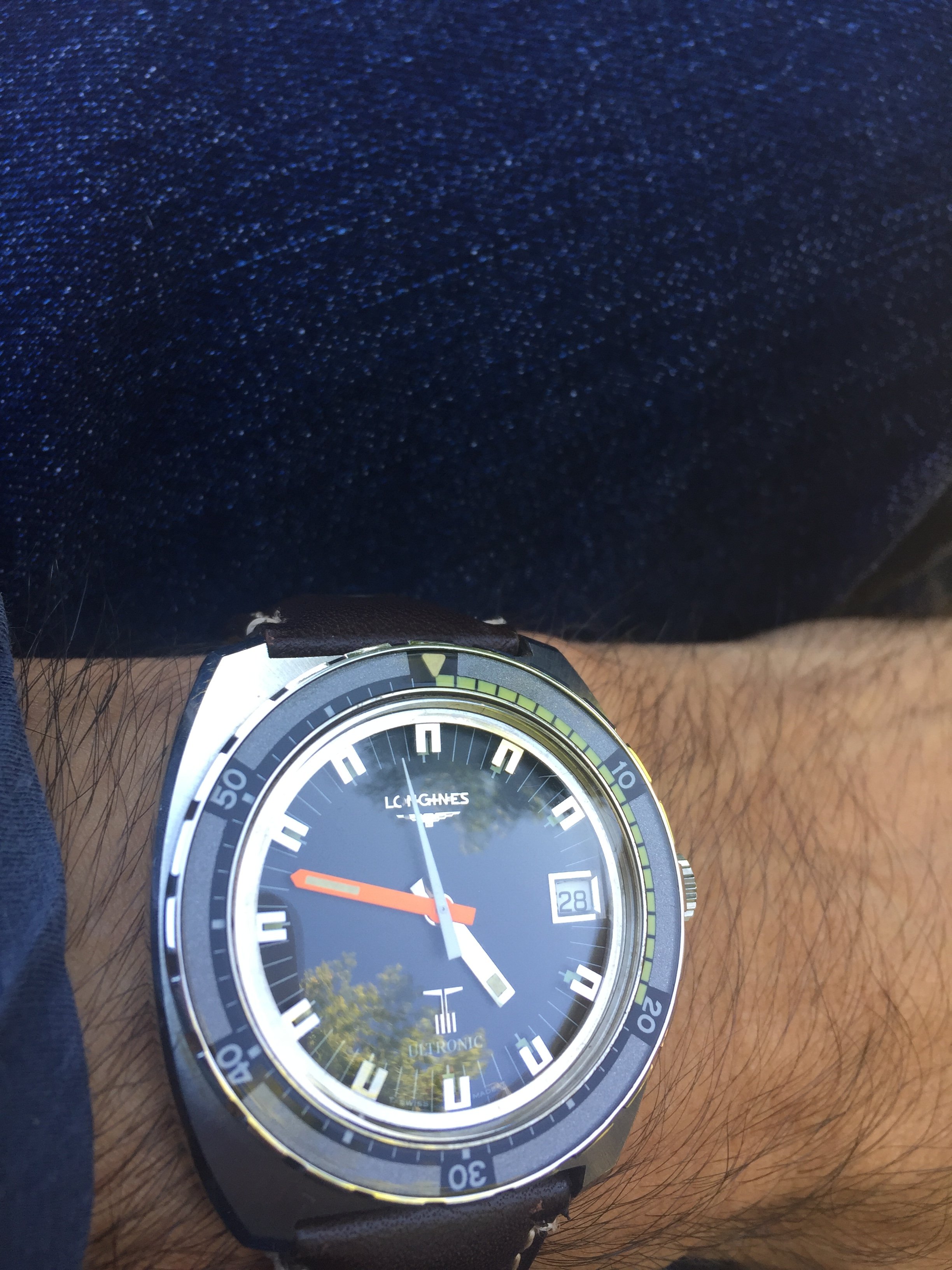

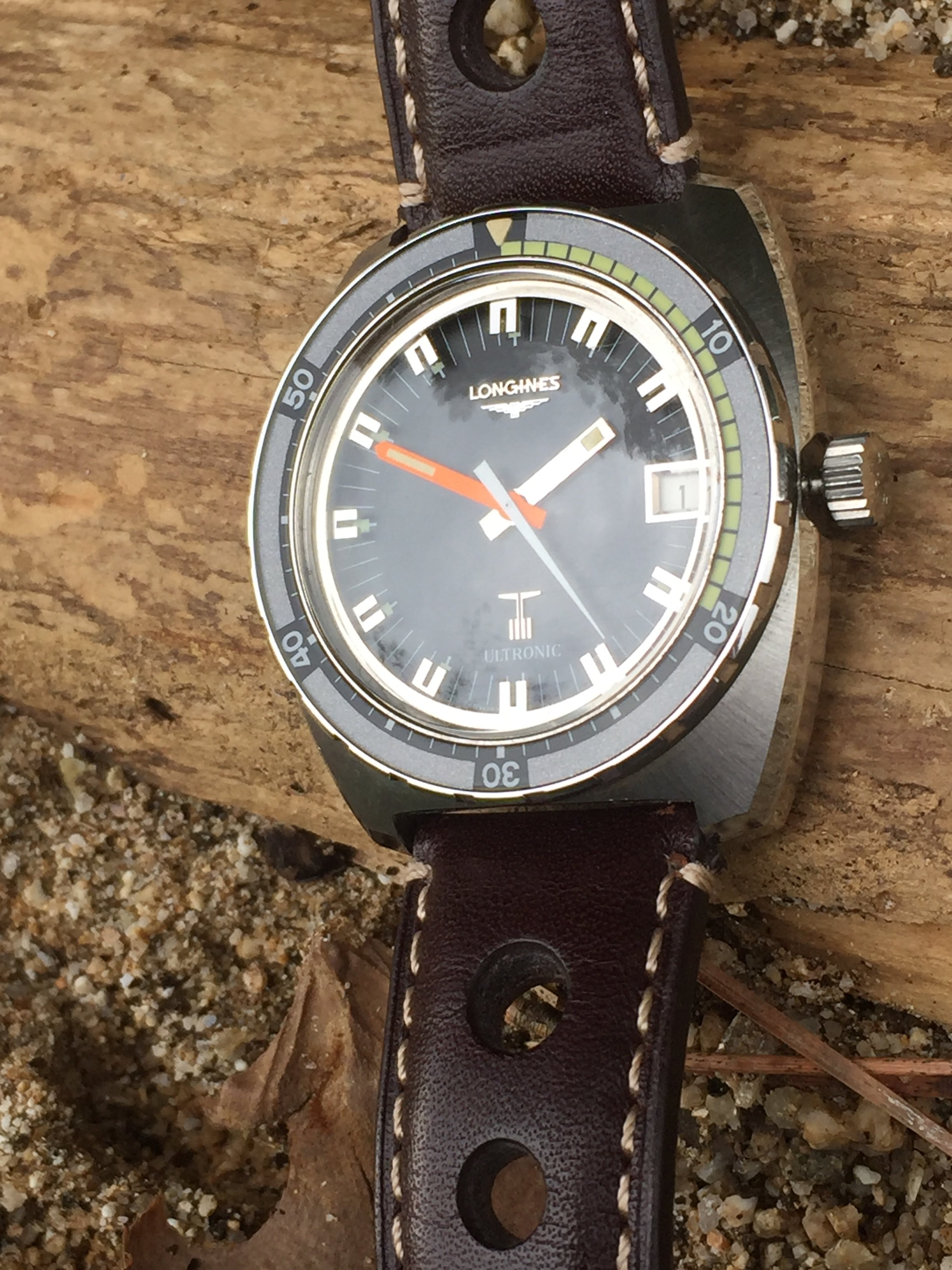

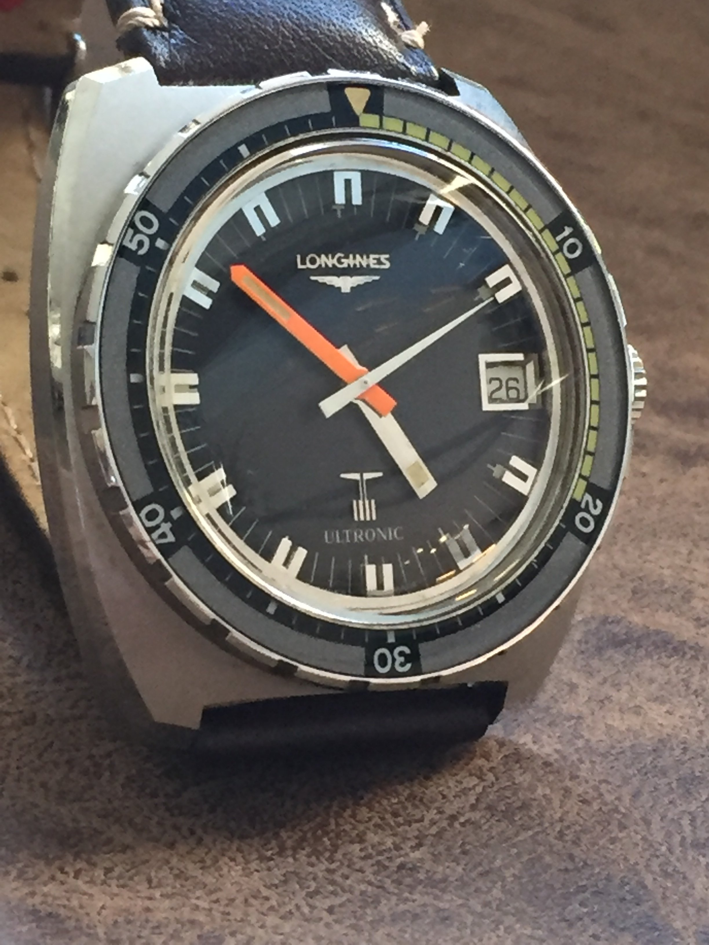

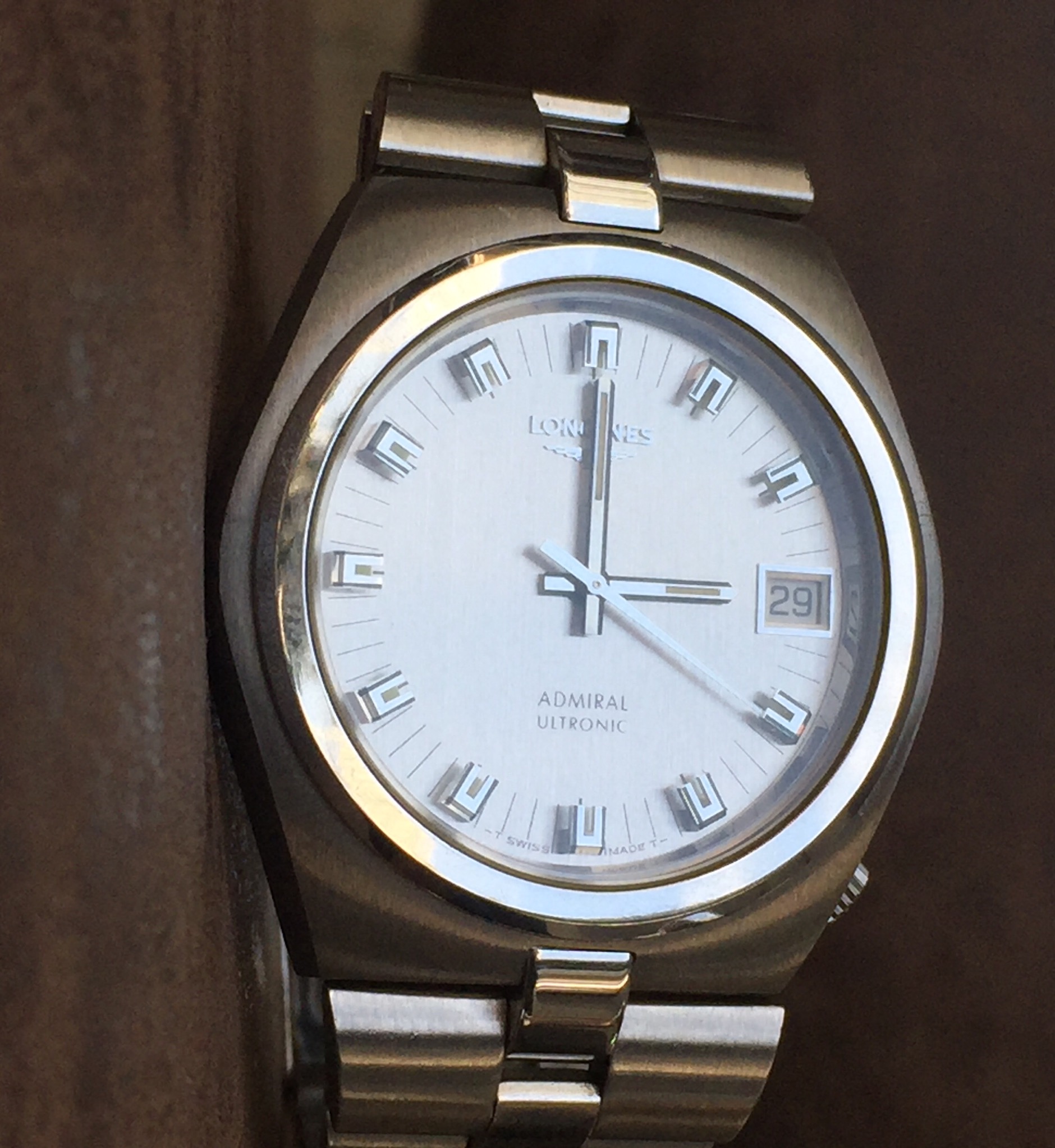

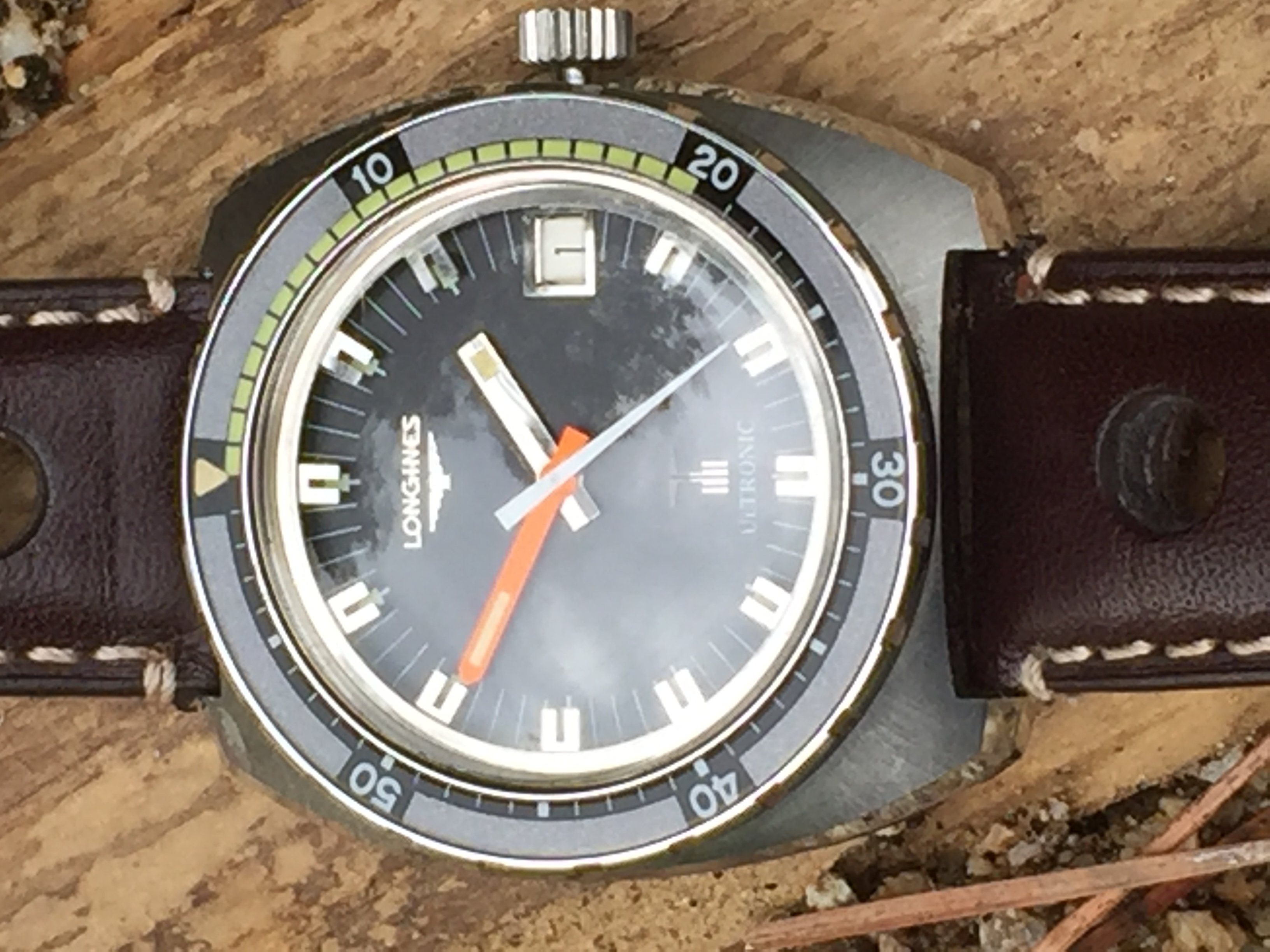

I have 2 Longines Ultronic that I bought NOS, they were working and suddenly stopped , anyone knows a good watchmaker in Europe ( I’m in Spain , Barcelona) that can fixe them, my watchmaker doesn’t work with this type of watches unfortunately.
Sharing pics of the beauties and thanks in advance for your help

The diver’s model might be easy to solve. The crown is in a SETTING position! Press it into the RUN position, and see what happens. Listen to both watches very carefully. Some people have great difficulty hearing these watches humming. Might either or both watches hum?

I listen HUM on both watches , I only pulled out the crow not to damage the watches as it’s humming but not working , so I guess will help not to force the caliber

If they both still hum but the time doesn't advance, then it is time for service. Been there on many in the past.

Both were NOS, so no service history at all
