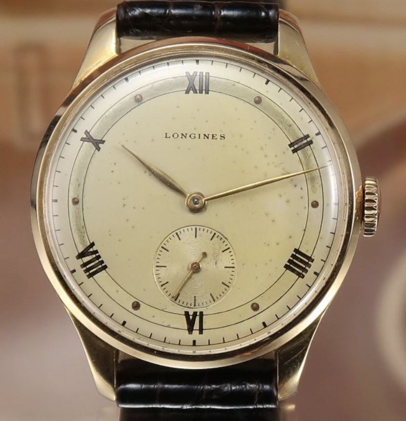

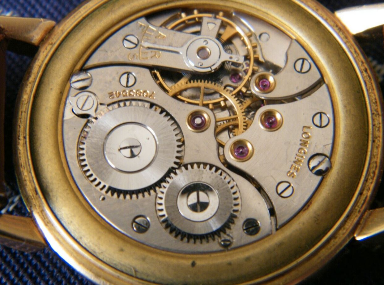

So you think that the hands are gold and with the time got some rust or some .... whatever that changes the color ?

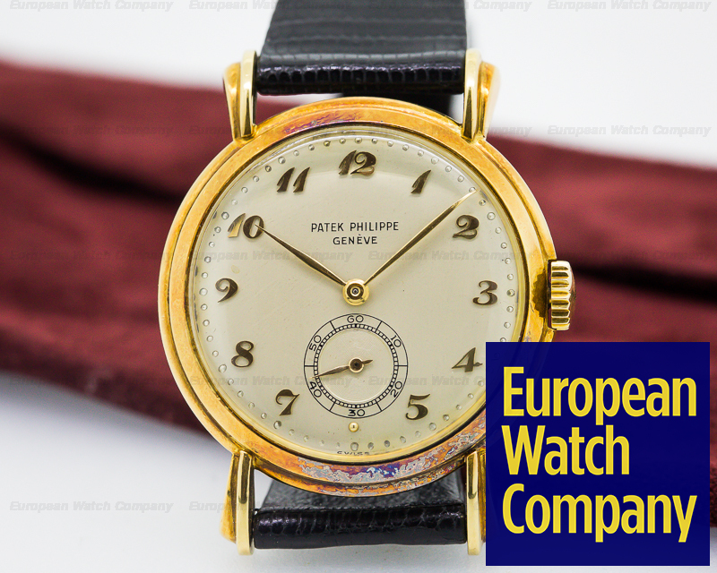

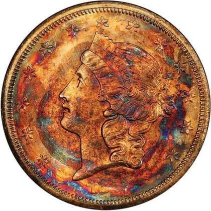

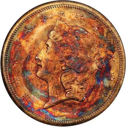

First of all, many people think that gold always looks fine, but it certainly can tarnish:
As I said beore, from the pics it is not completely clear to me what the hands have been. Imho they should be gold or blued. But with that case, I'd expect gold colored hands. But as @bubba48 said, that wouldn't bother me too much.
Concerning the dial, @DirtyDozen12 has already answered your question.
Out of curiosity: What size is the case?
2,829
4,945

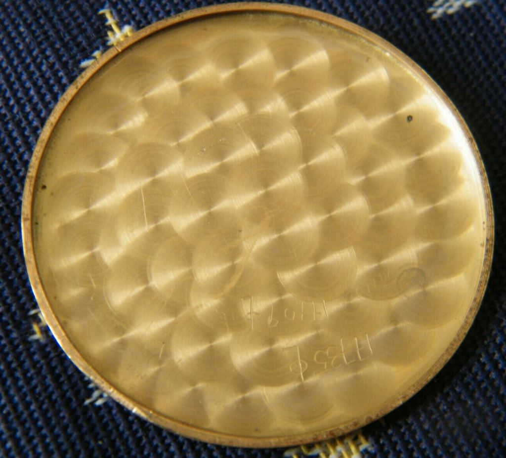

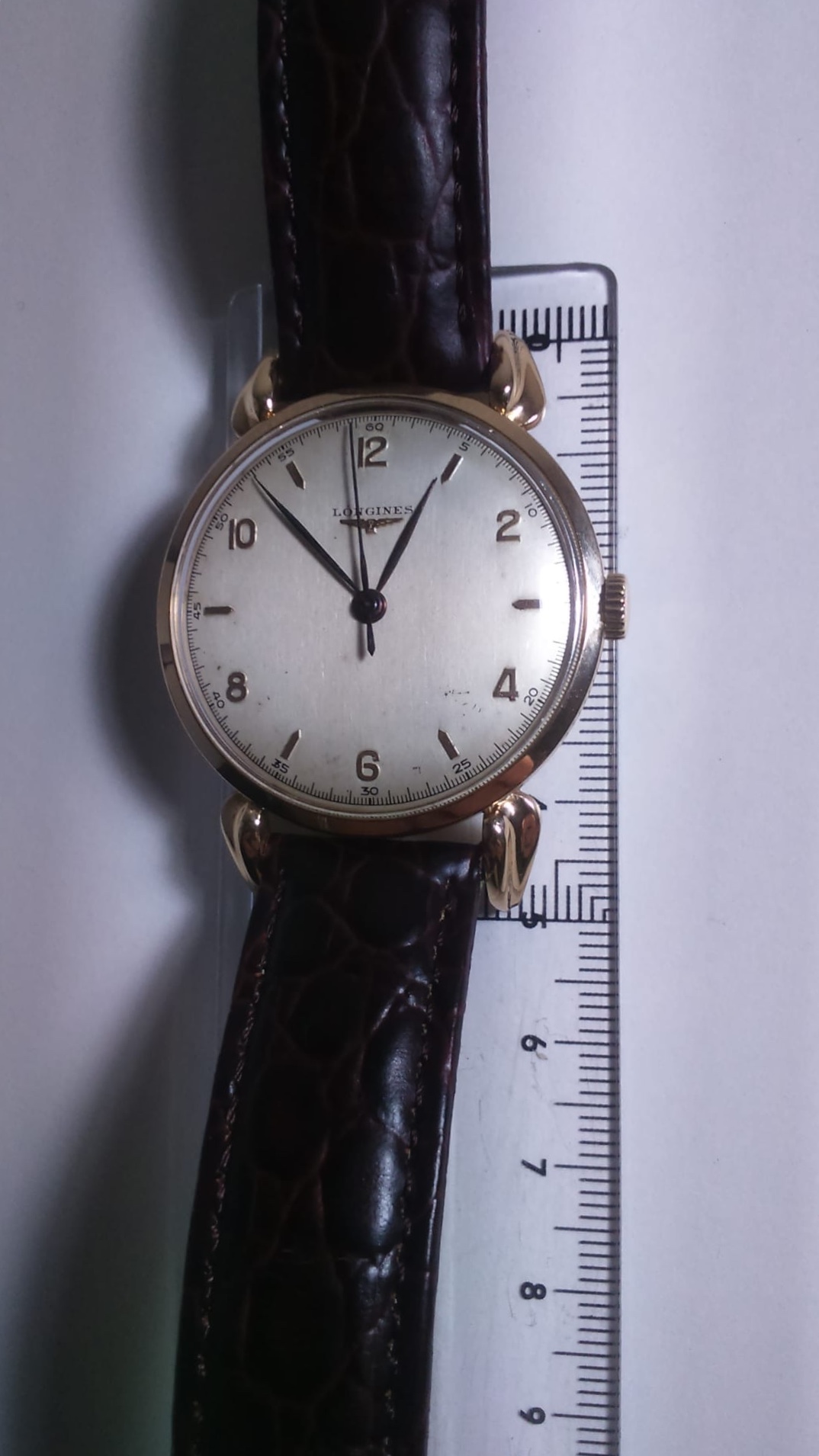

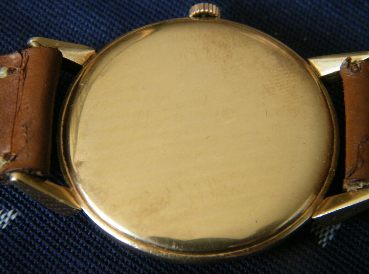

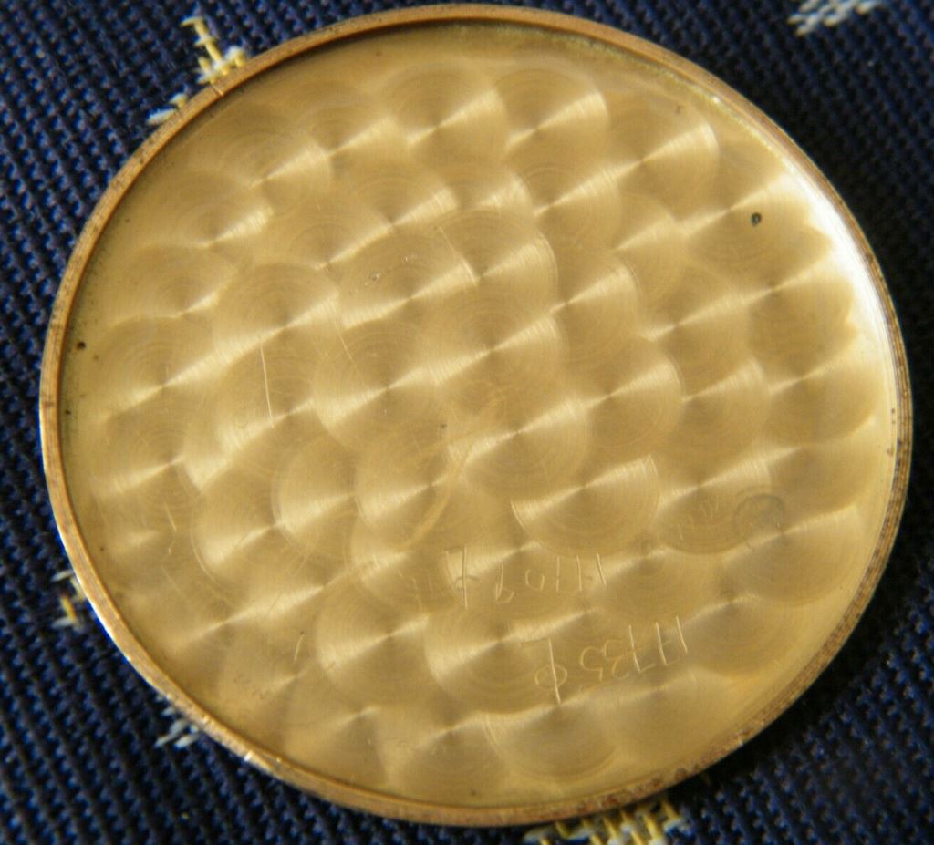

The serial number dates the watch to circa 1949, which is early for an embossed, winged-hourglass emblem (on the dial) but this does not really concern me. The case, on the other hand, is marked in such a way that suggests to me that it is not authentic. No reference or serial number, no hallmark, no maker's mark, all of which suggests a non-original case. Contacting Longines with the serial number will provide confirmation. But I would stay away at this point.

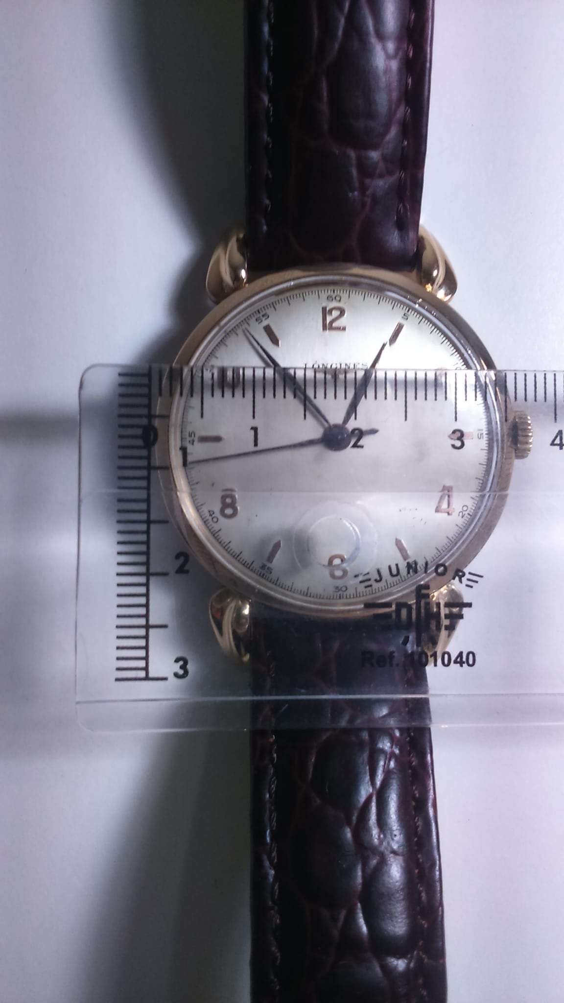

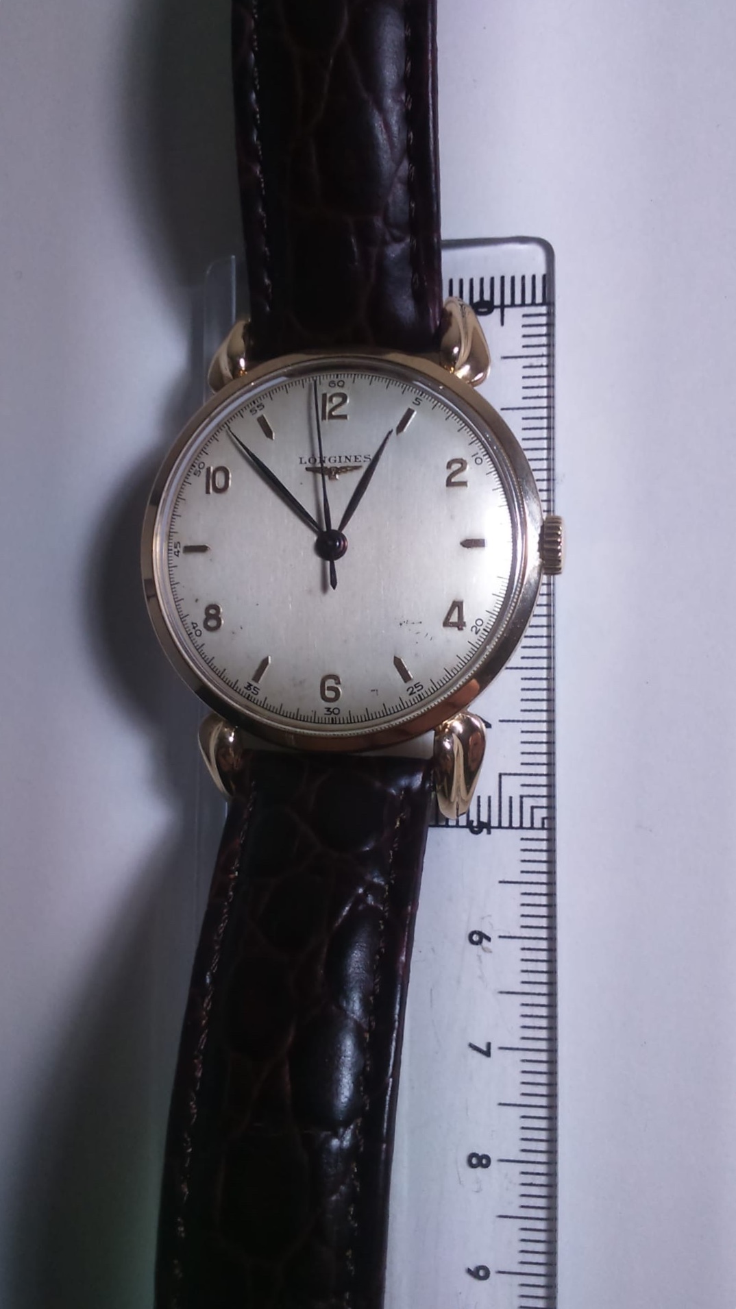

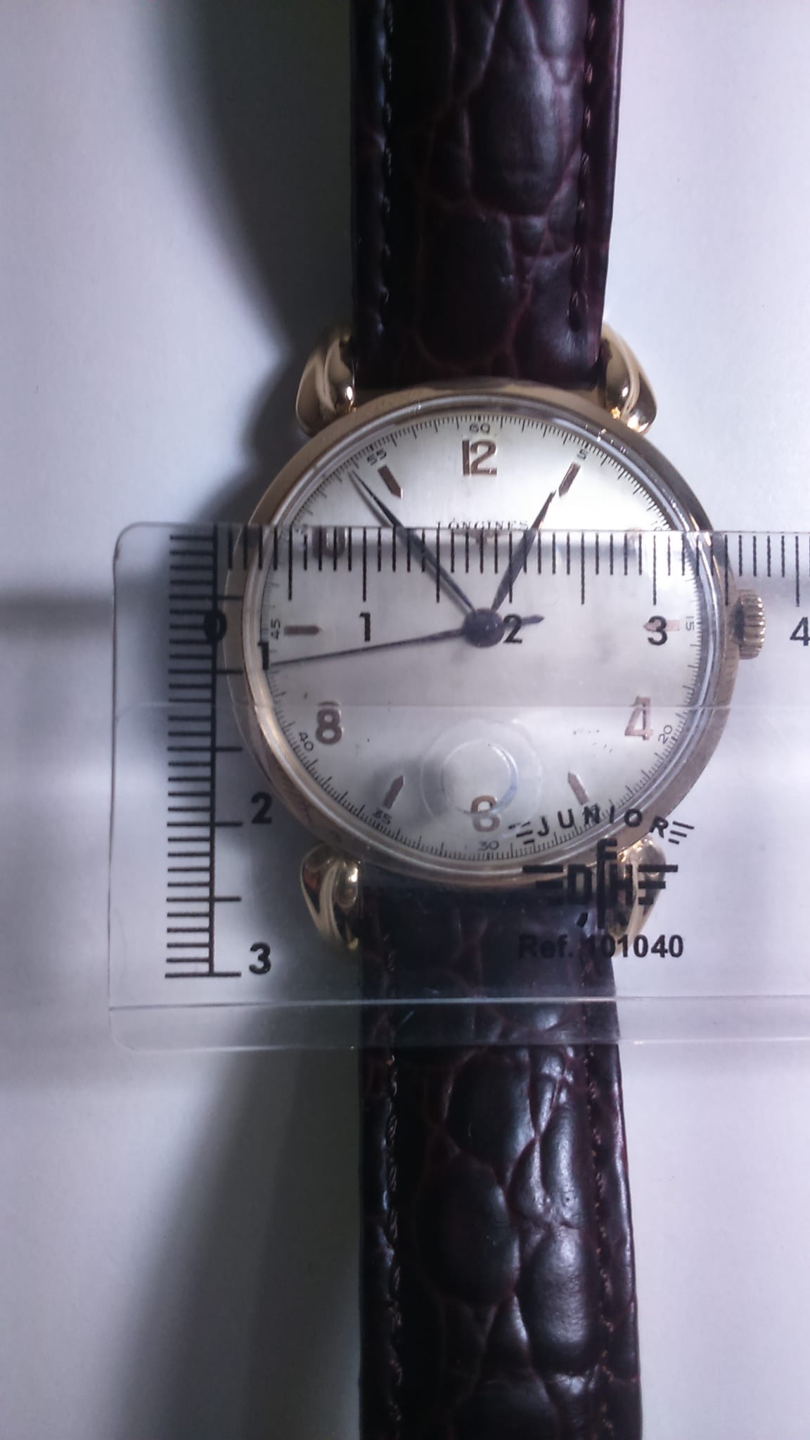

thanks again for sharing your knowledge , regarding the size is 35 x 50 mm as you can see on the pics
I have sent email to Longines, let's see what they reply. thanks DirtyDozen

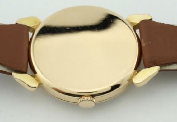

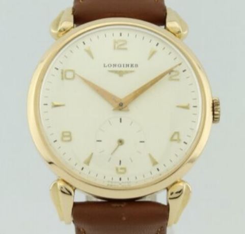

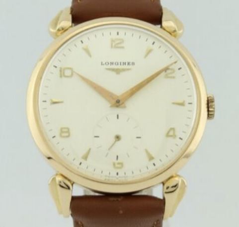

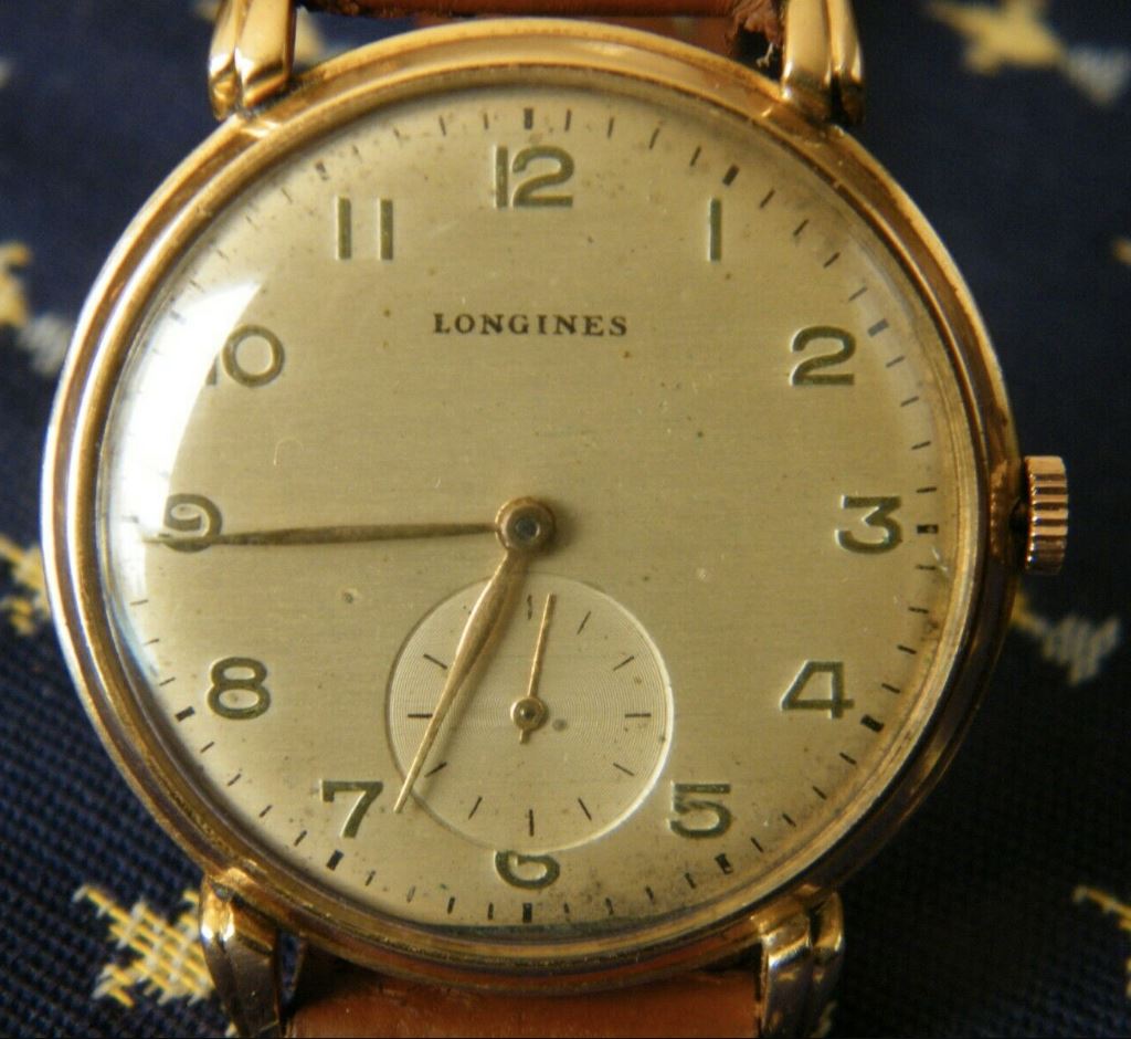

Below is a Longines that is for sale in Spain. Unfortunately, I have not seen the inside of the case-back but the design of the lugs is similar to the case in question. I wonder if both watches were originally sent to Spain where gold cases were produced locally. This was common for watches sent to France at the time when these examples were made.
7,689
22,049

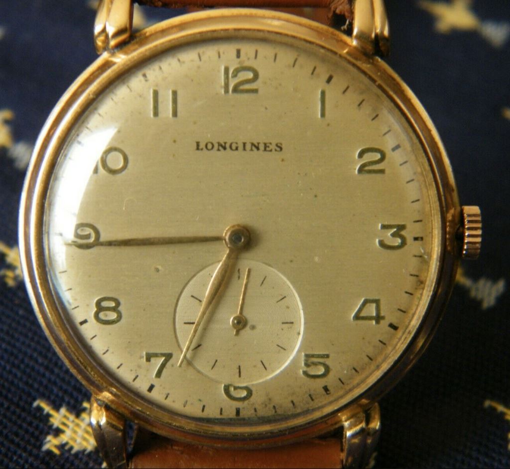

Gold cases produced locally would not be marked “Longines” with the winged hour glass logo like this one is. If it’s a fake it looks pretty good, but it’s true that it’s always best to be cautious and the lack of any numbers stamped inside the case is a bit odd.
As for the Swiss gold hallmarks, I wonder if the 750 mark that is indeed present is sufficient or whether additional stamps are required - that would have to be checked with the various on line ressources.
All that would require additional research— but in any event the proposed trade value of this watch for a very nice Conquest + 400 euros seems completely bizarre.

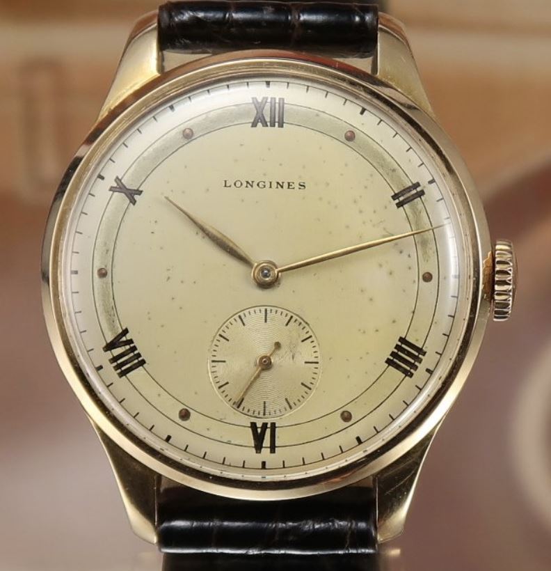

I agree that this is not how they should be marked, hence my initial comment that the case did not appear to be authentic. But could it be a proper, locally-made case with an improper marking? I wonder.

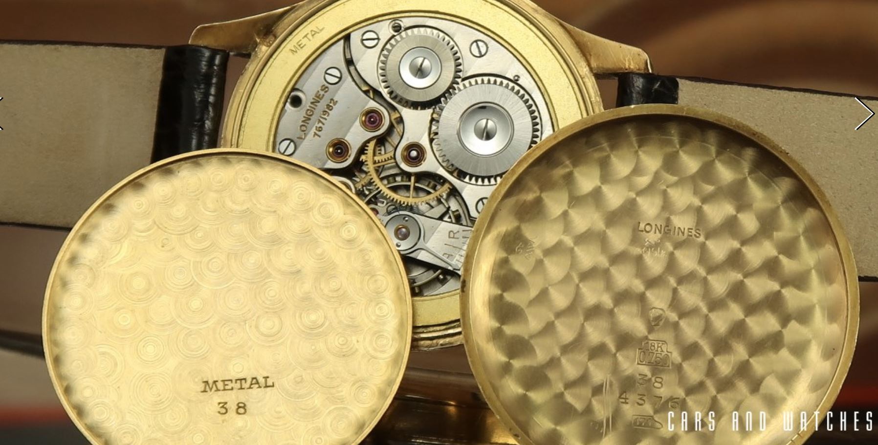

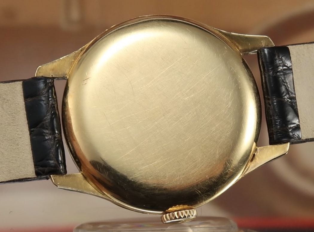

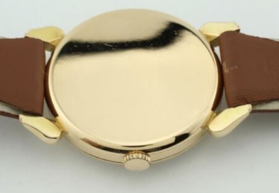

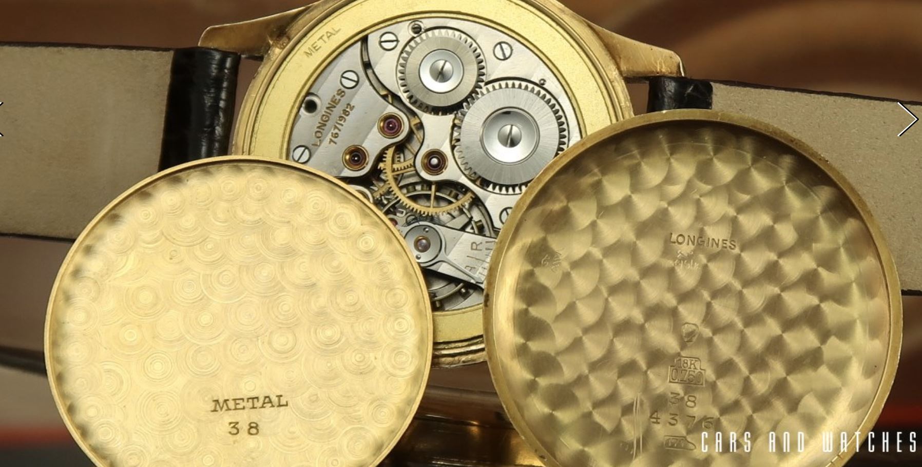

Based on a large sample size of gold Longines from this period, the 750 mark is not sufficient for a Swiss-made case. In addition to the 18K/0.750 mark, there should be a Helvetia, a maker's mark (e.g. 143 in a hammerhead), "Longines", a 4-digit reference number, and an individual case number.
Below is a watch that was, apparently, originally sold to Spain in 1949. The case-back is marked as expected for a Swiss-made, 18K case.

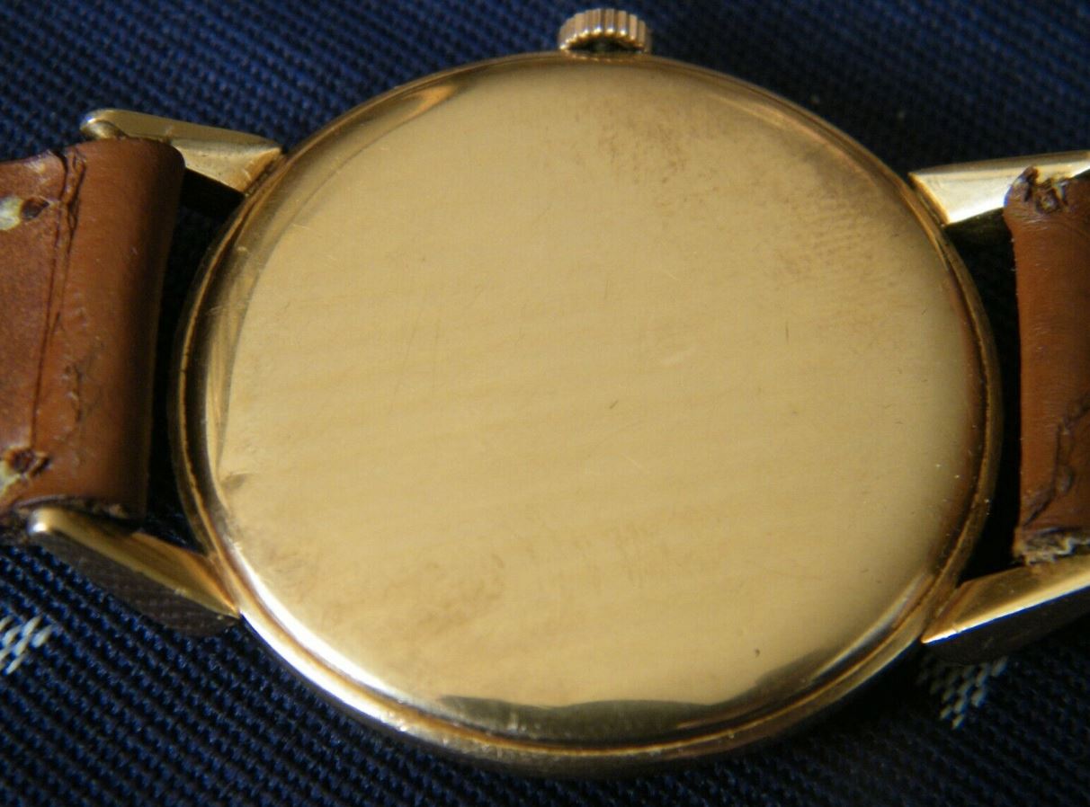

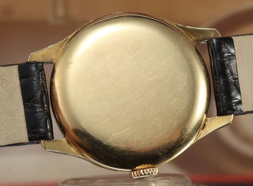

Below is another watch that was for sale in Spain. The case has a different style of "fancy" lugs but the serial number is close to the watch in question's. Interestingly, the case appears to have no hallmarks at all. Maybe they were present on the outside of the back and have been worn away by many years of use? Or maybe they were never there. Who knows.

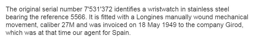

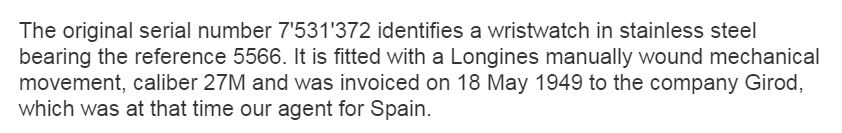

I got a response. See my post above.
910
1,053
