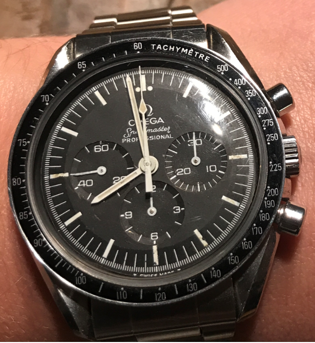

As far as I can tell, everything checks out on the pictures. Any seconds opinions would be highly appreciated. Pricewise just above the 4,5k mark.

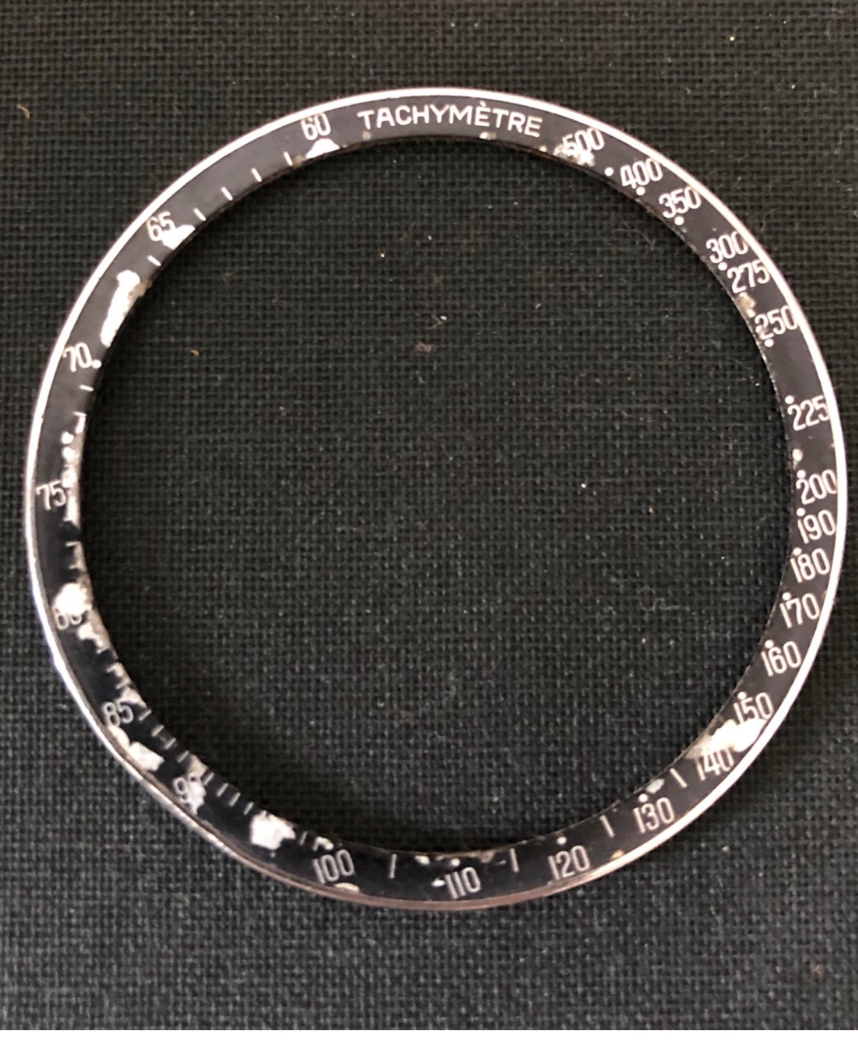

Bezel is incorrect (assuming it comes with the second bezel?).
Lume looks to be missing.

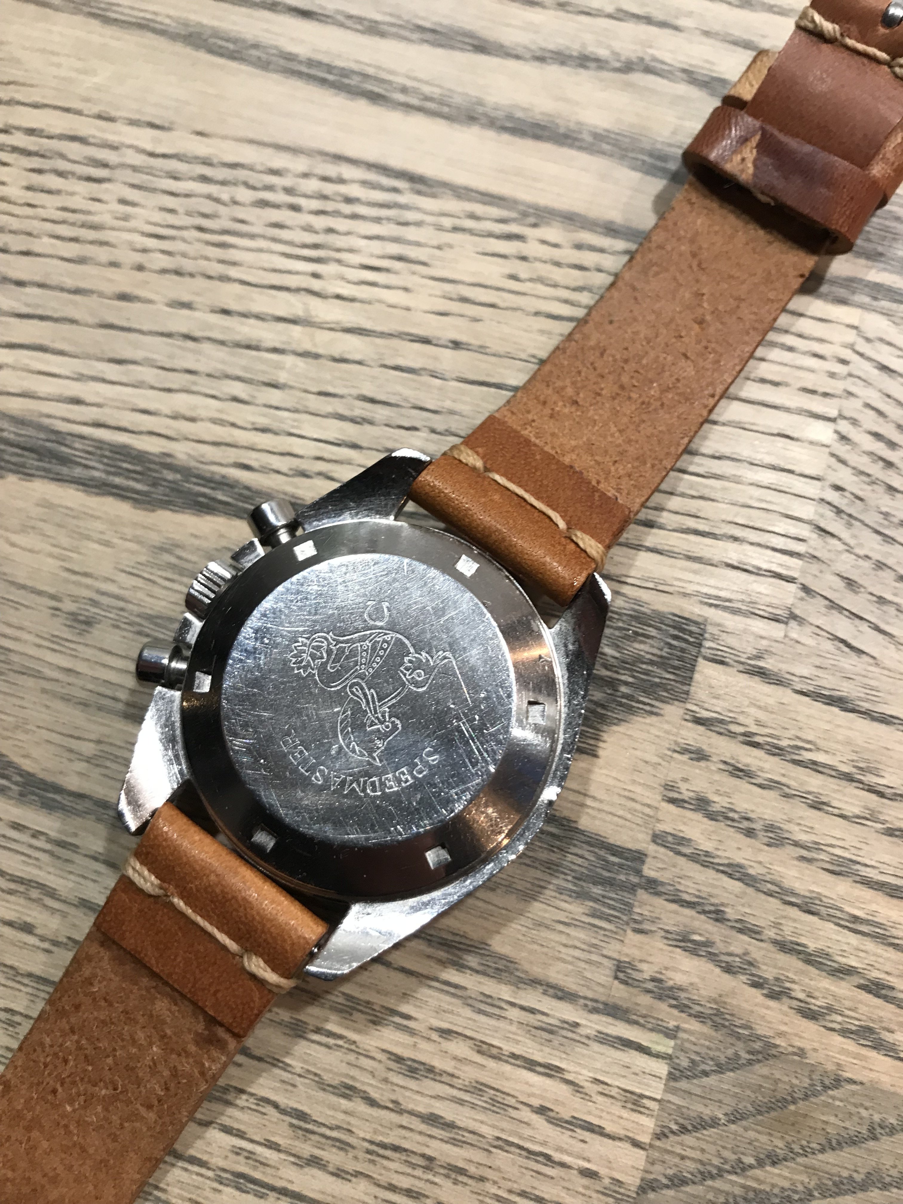

Can't tell much about the case from those pics.

The bezel is ofcourse a newer one, it comes with a supposedly period correct DOT as shown in one of the pictures

It has a dial from a -76 to -82 model, so not good for a -69. And some strange repro endlinks for the bracelet.

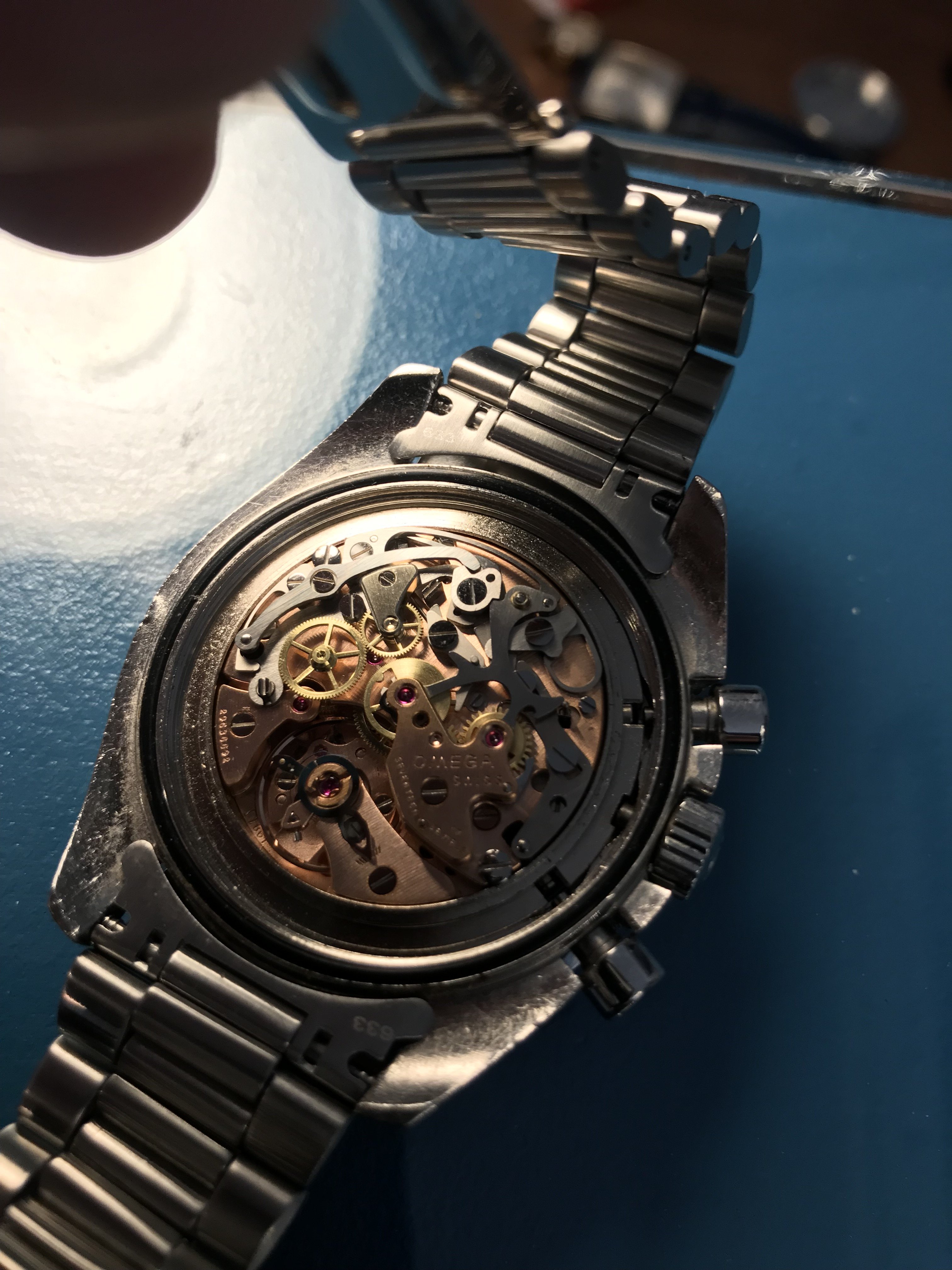

Movement S/N doesn’t match the dial. It’s not a great find.

Not much about this watch appeals to me. The dial looks weird with lume missing (and what is going on with the 9 o'clock marker??). Dial is wrong for a -69. Neither bezel is attractive as one is wrong and one is beat up. Cobbled together watch...avoid
