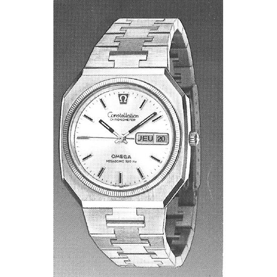

Hello to all of you falks,
this is my first post here. I am an Omega fan and have 5 Omegas in my collection. One of them is this beautiful and almost unworn Omega Megasonic reference 398.0829.
As I bought it and put battery, sound can be heard, micromotor was working, but second hand was fixed. Just sometimes second hand is moving a few seconds.
I send it to very reputable watchmaker who serviced it and after the service, situation is the very same. He is also confused.
Could someone help me please? Should I buy a new micromotor or it can be also gears. My watchmaker suspects at two gears.
Has anyone here parts for 1220 caliber?
As I saw, Jack Daniels83 has some parts, hope he will see this thread. 😀´
