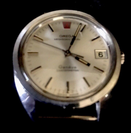

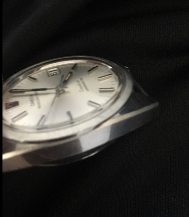

    Just wanted to share my new arrival! While browsing eBay last week, this watch popped up with pretty terrible photos. It was listed as non-working for parts or repair. I decided to take a chance on it since the dial and case seemed to look great even through the blurriness. I was hoping that all the watch needed was a new battery on arrival since the seller was not a watch-related business:

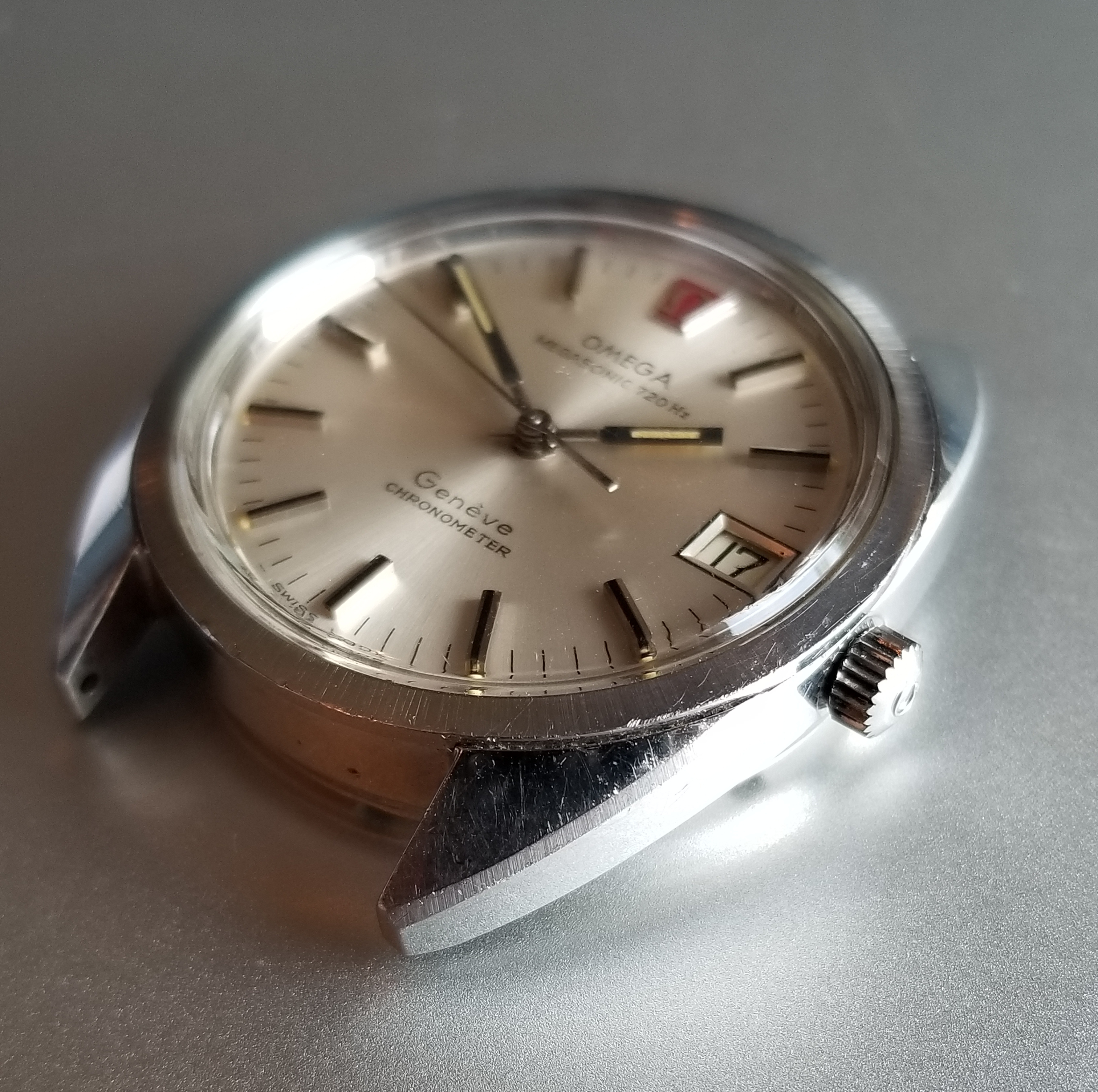

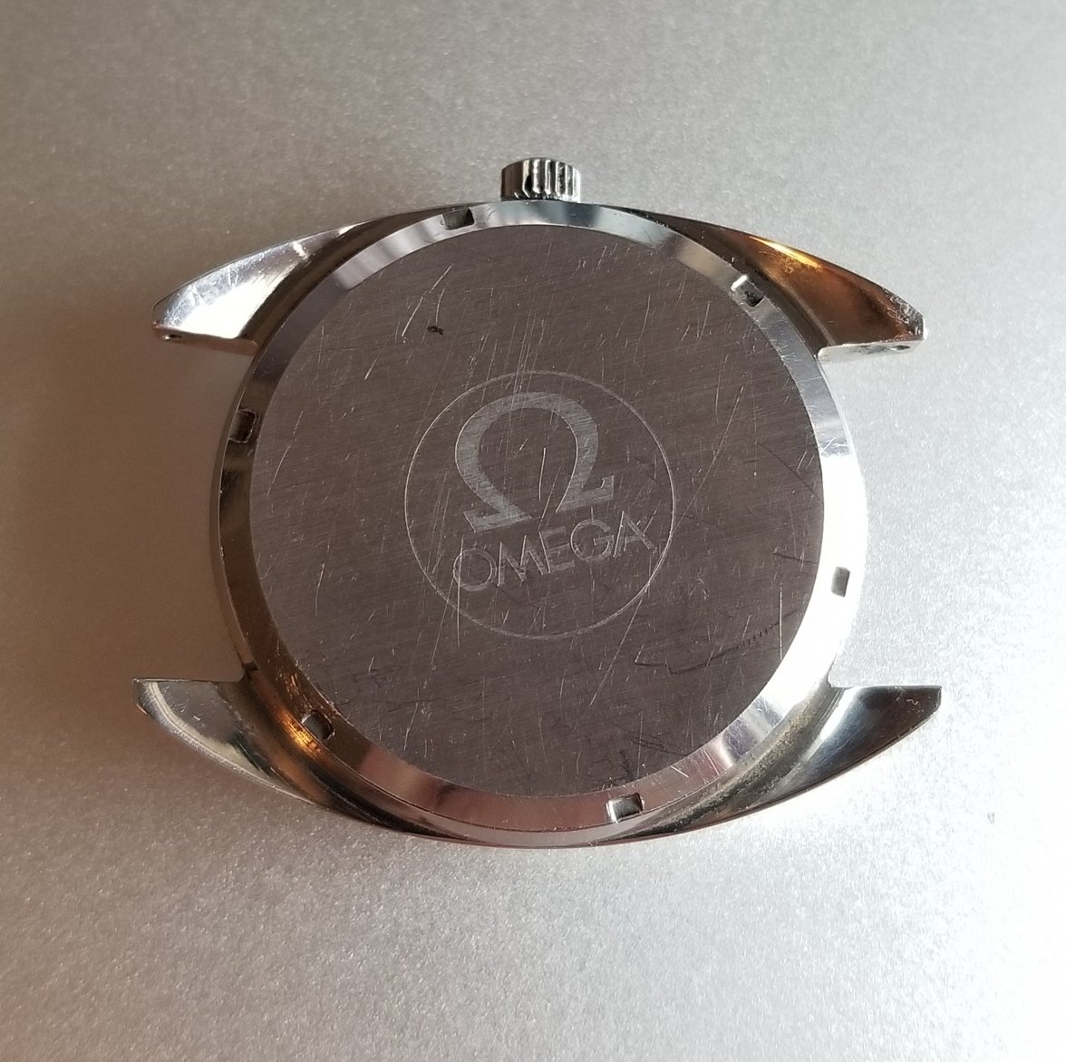

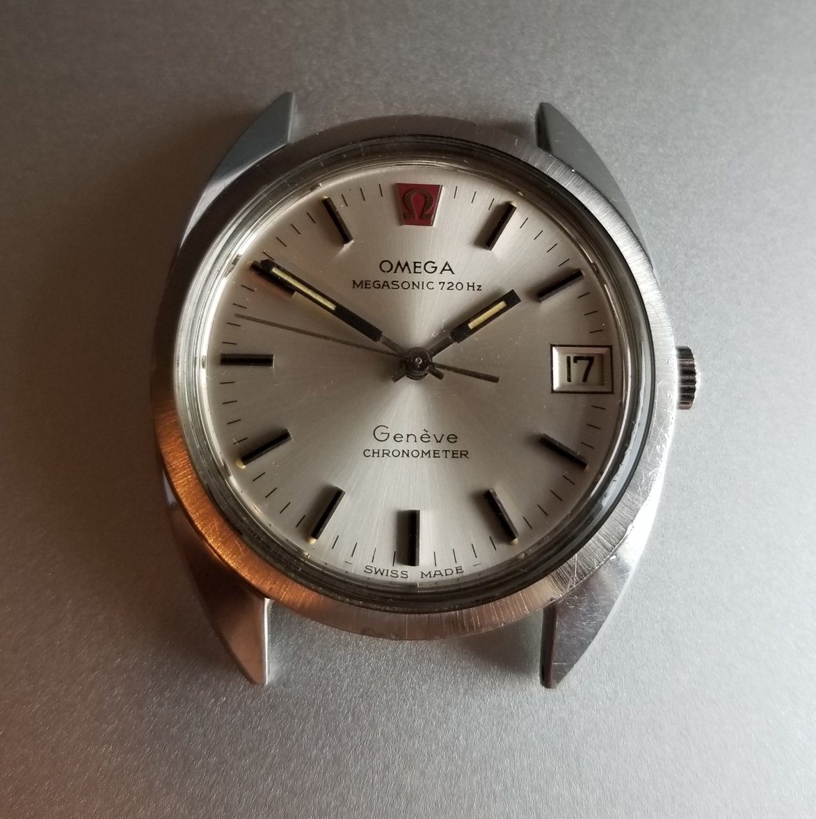

    The watch just arrived today: the case, dial, hands are stunning condition and almost appear to be unworn. I opened up the caseback and saw that the battery was installed loosely. I popped in a brand new Renata....and bam, it doesn't work :(.
    The caliber 1220 was first introduced in 1973 and designed by Max Hetzel, designer of the Accutron. It has an asymmetric tuning fork that resonates at 720 Hz instead of the more normal 300 Hz and a micromotor. The micromotor consists of an oil filled sealed box where a wheel mounted on four rubies. When the fork vibrates, this wheel bounces off two opposite ruby springs.
    For the time being, I will admire this watch for what it is while looking for someone to perform a service and get it running. If anyone here has some Megasonics, I would love to see them!

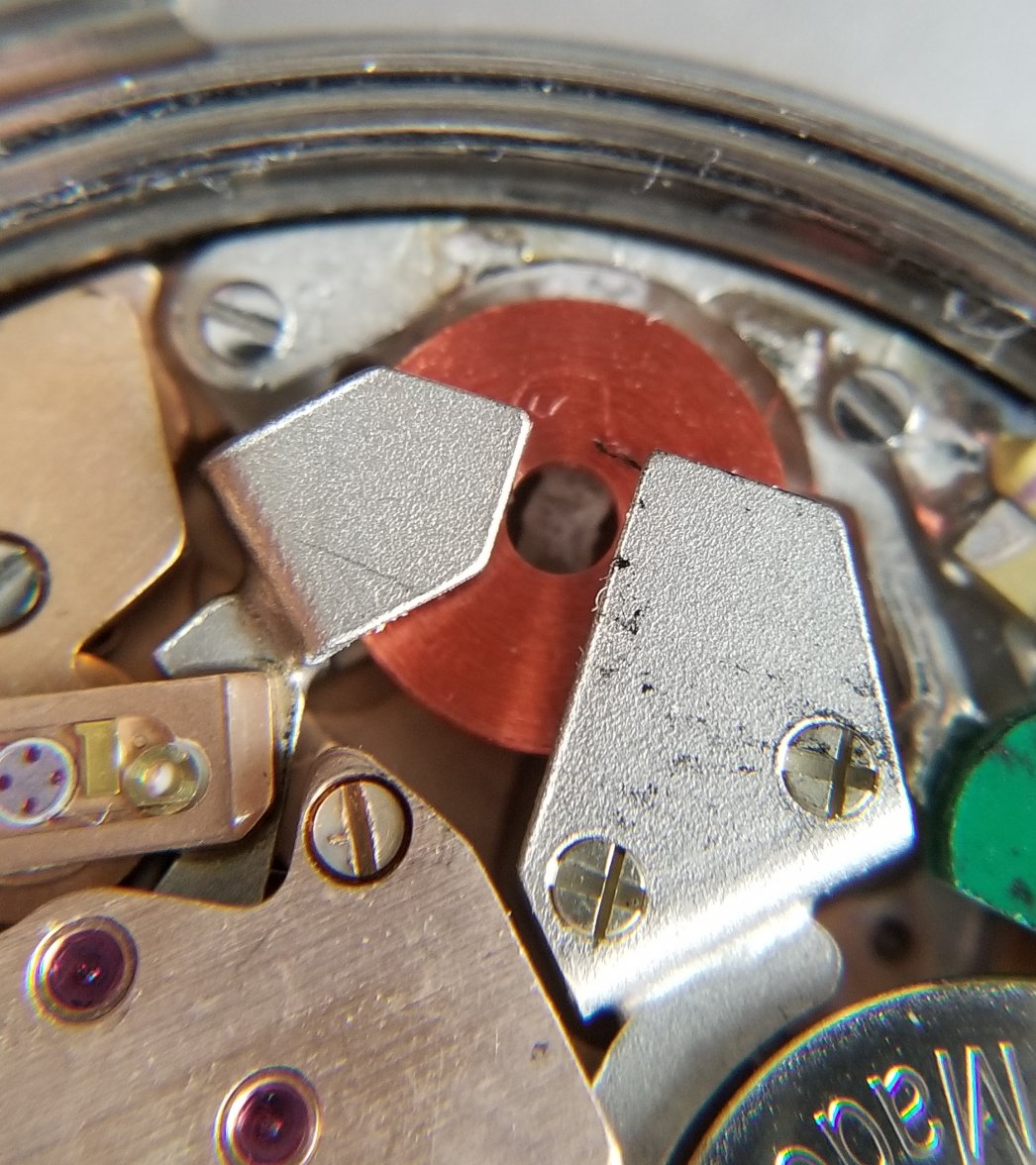

    That is what I am hoping. The gasket was completely disintegrated and had left black residue on the caseback and inside the movement. I have a feeling the coil might have some gunk on it as well.
    Unfortunately it is not humming or moving. The hands do move freely when using the crown and the date advances properly. I'm hoping it is just a matter of cleaning and servicing the movement, but I might be PMing you regarding those movements/parts if it's something more serious :)

    Wanted to update this thread since I just got the watch back from service. First and foremost, HUGE thank you to @JackDaniels83 who was instrumental in getting this watch back up and running.
    The repair was quite extensive and necessitated replacement of the Micromotor Tuning Fork (seen in the photos above). The watch is now running within COSC Specs as it should.
