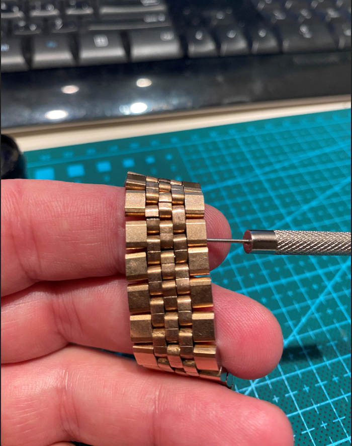

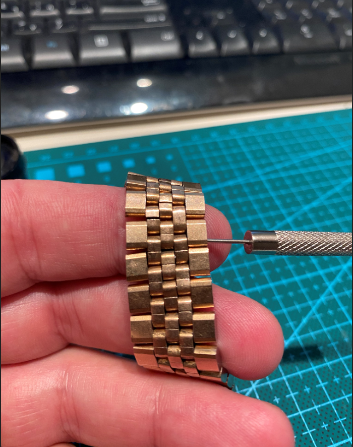

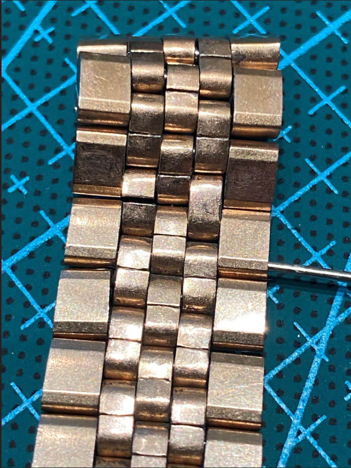

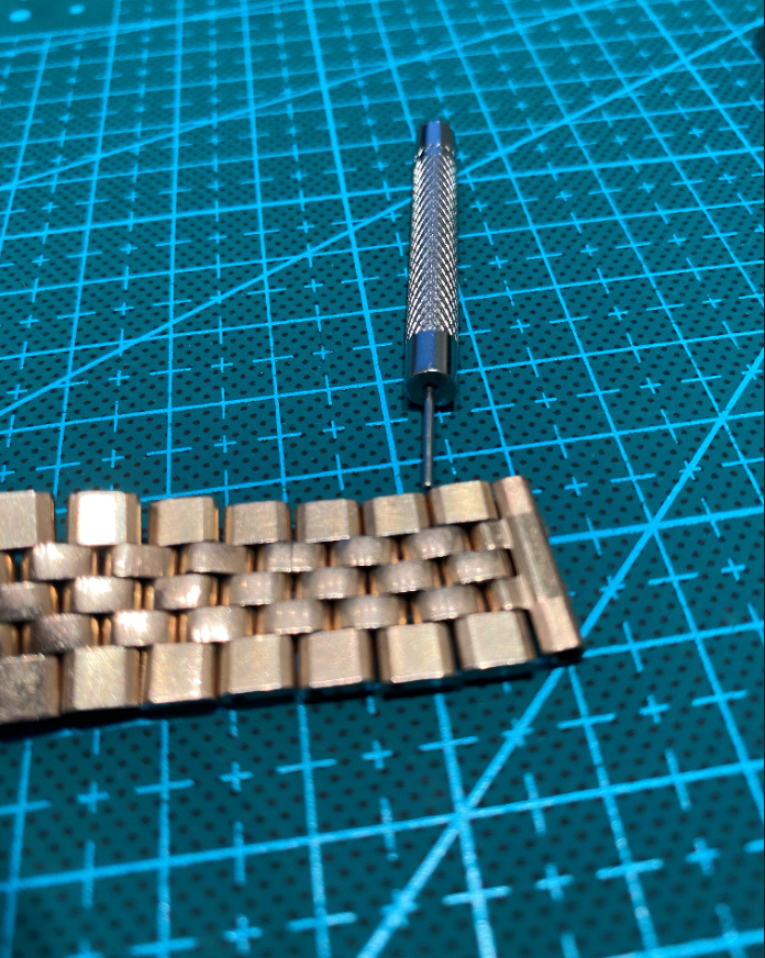

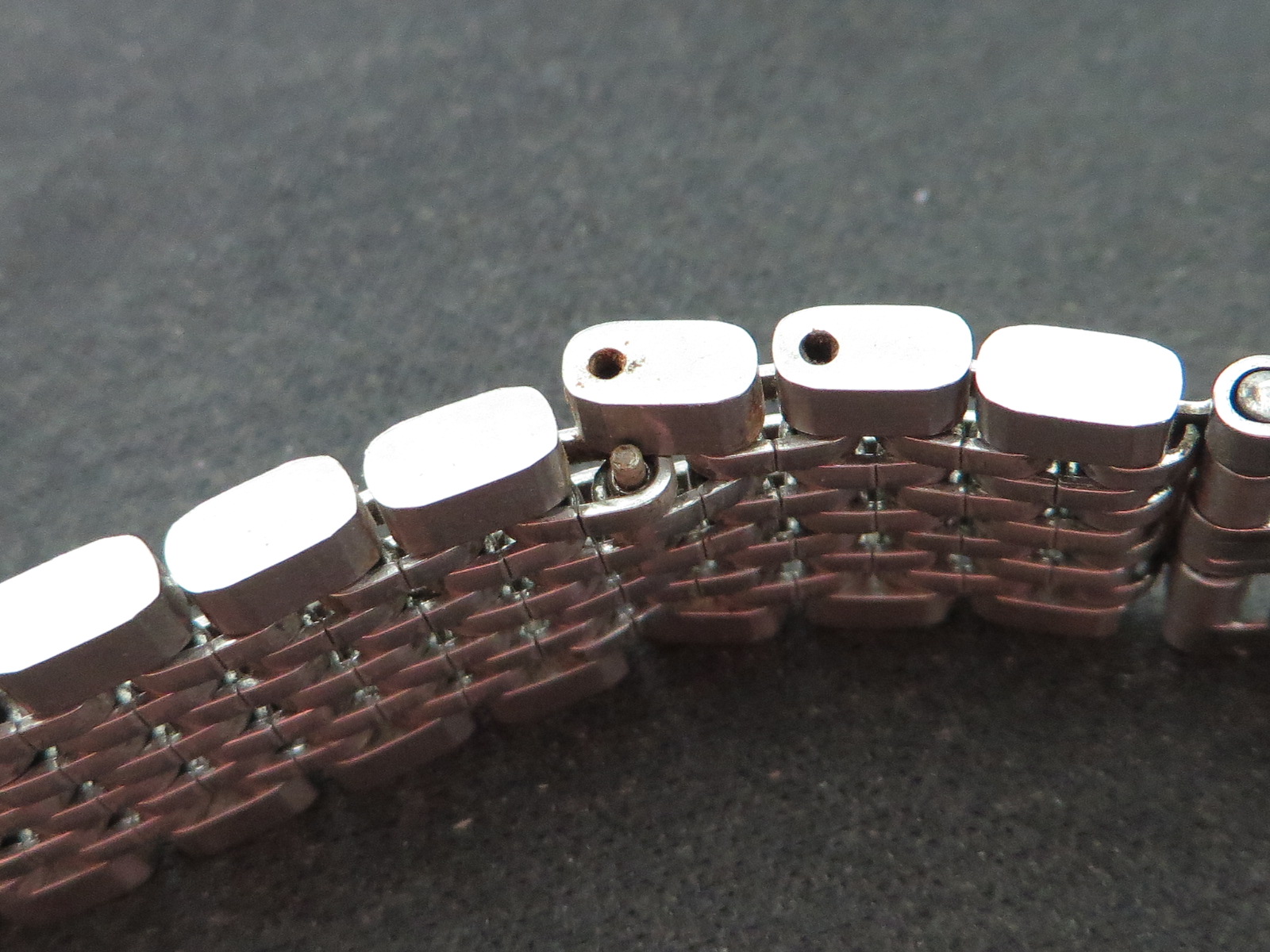

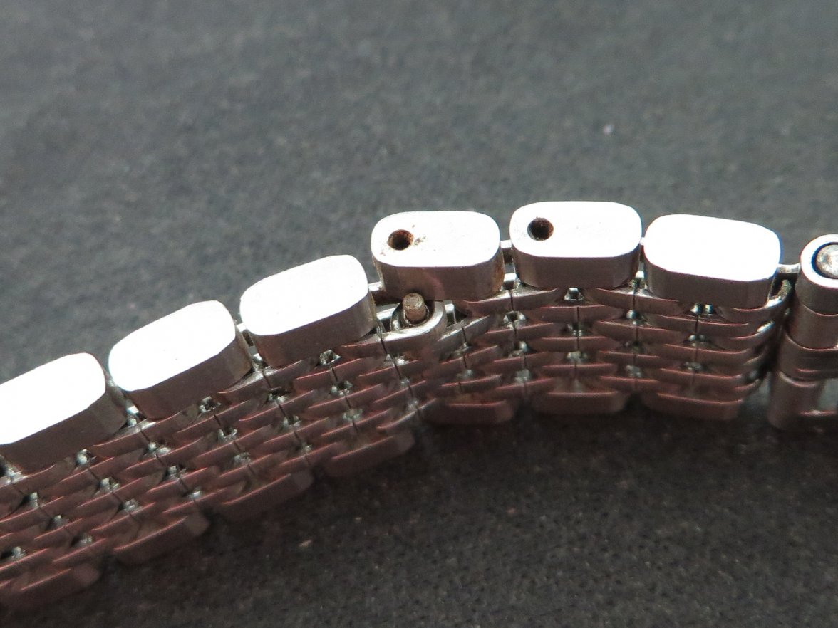

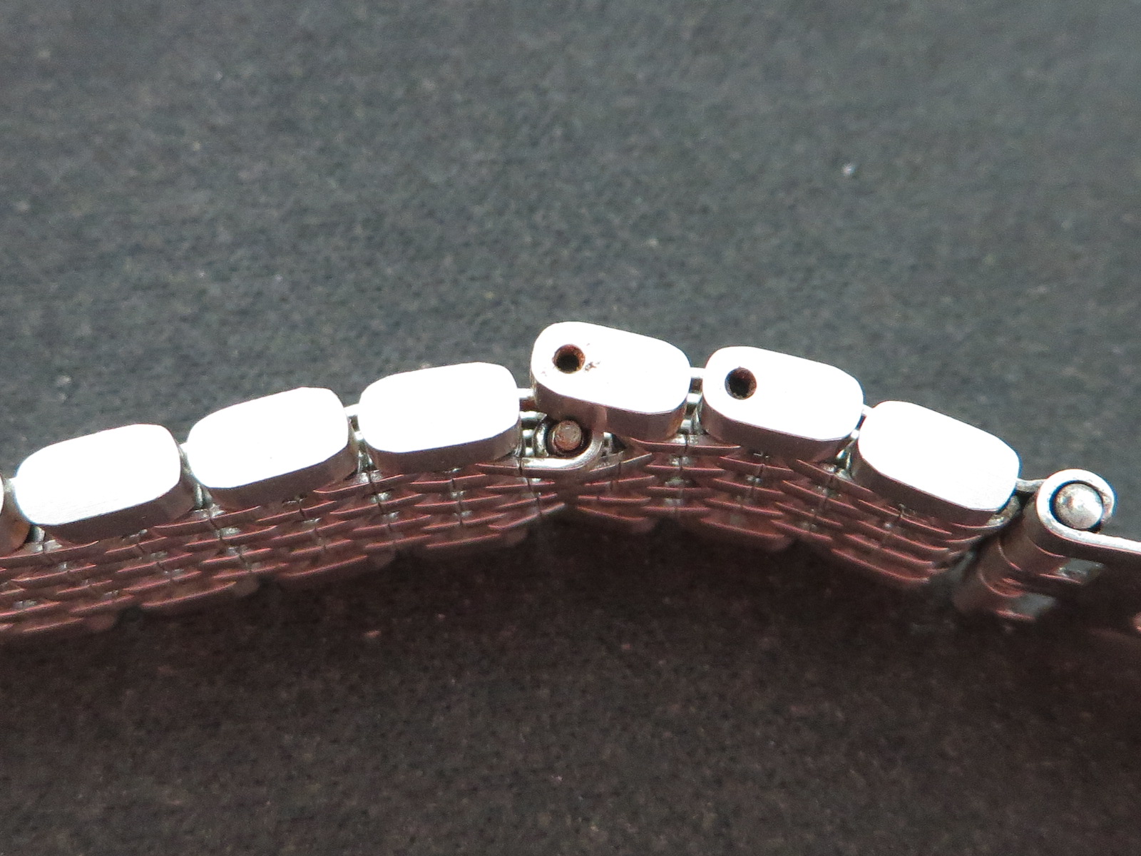

Just received a beauty on a metal band i'm trying to shorten, but unlike bands i
have taken apart in the past, this one seems to be different. Instead of one long pin going though
the bracelet, this one seems to have 2 spring loaded pins on each side.
I tried different things, including pushing the pins from both sides but with no success.
Not wanting to risk any harm i turn to the experts.
Thanx
Thanx
13,492
31,811

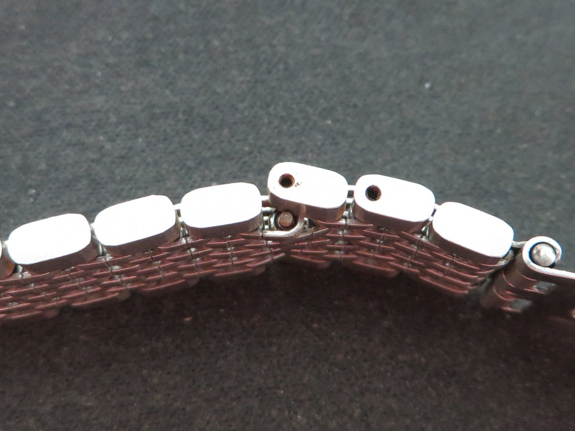

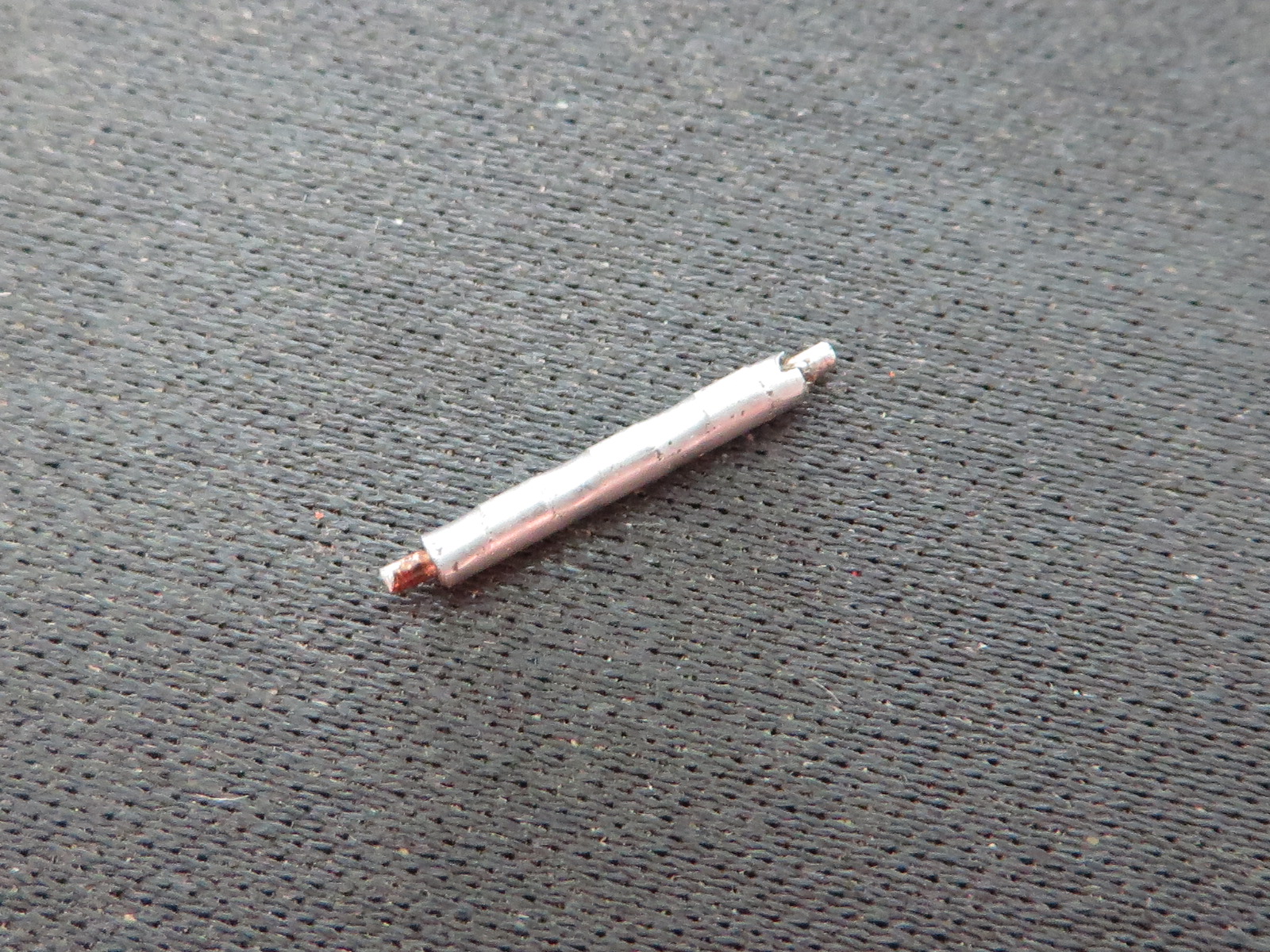

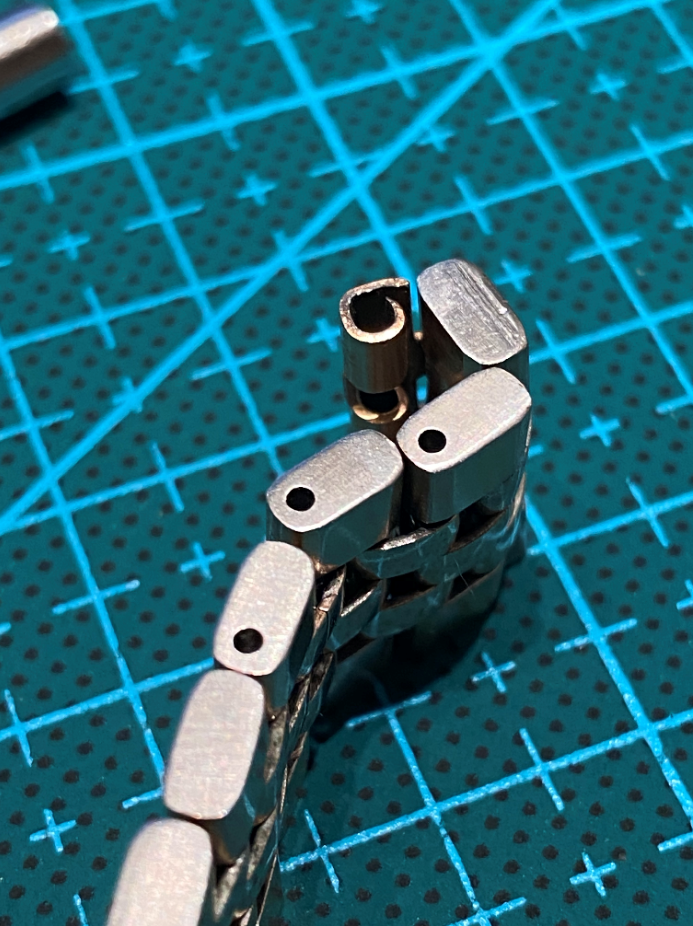

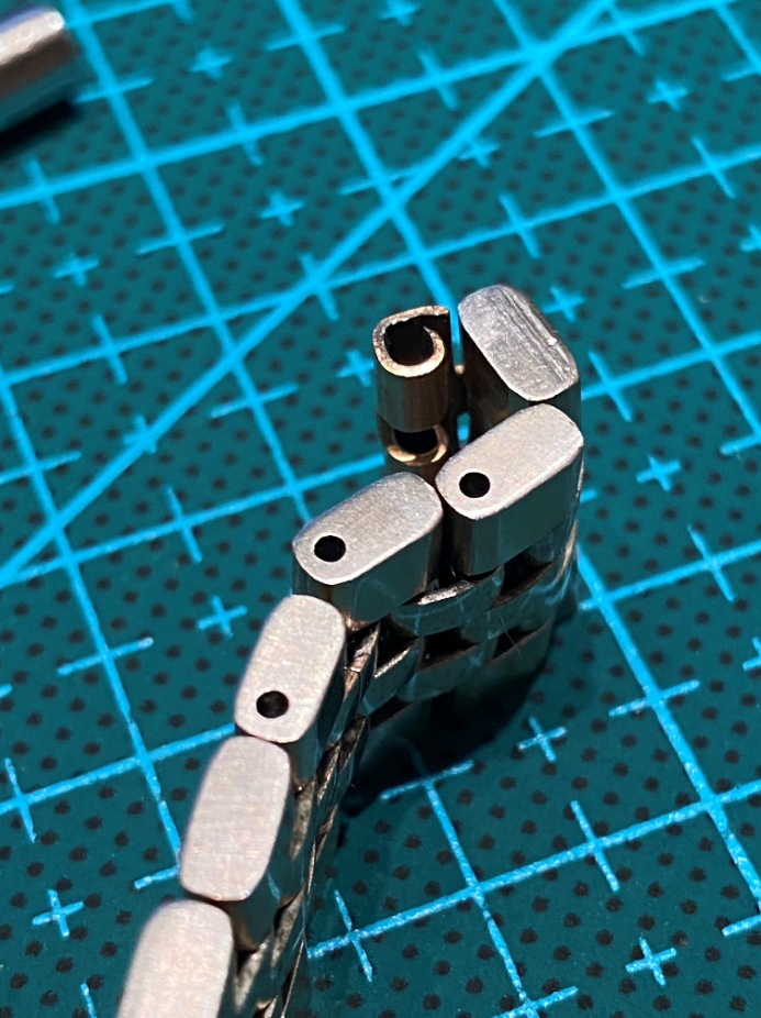

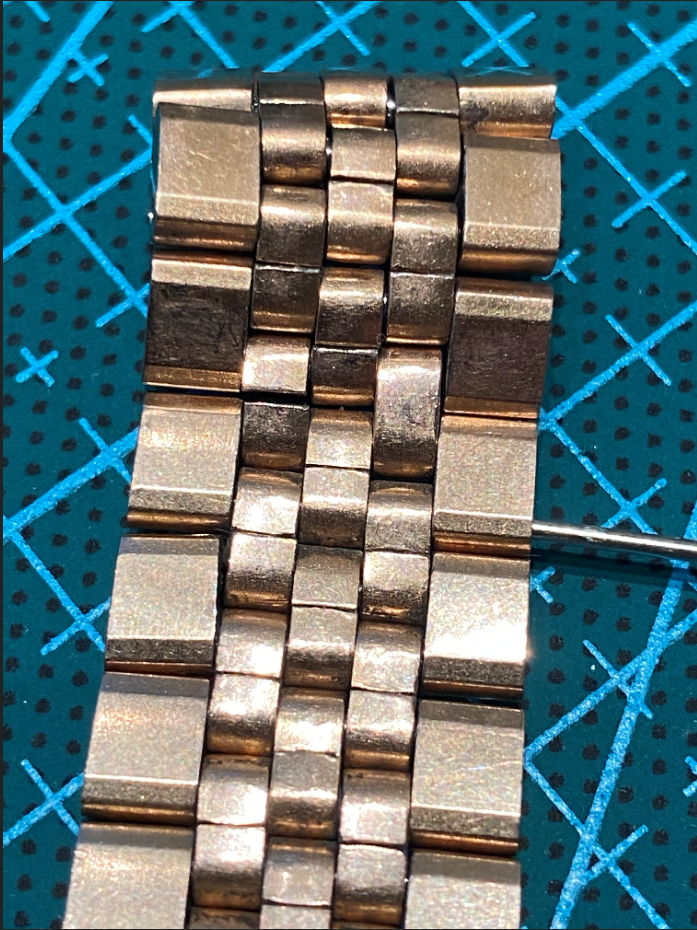

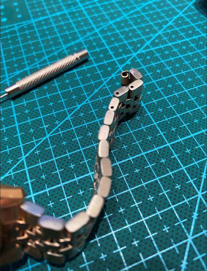

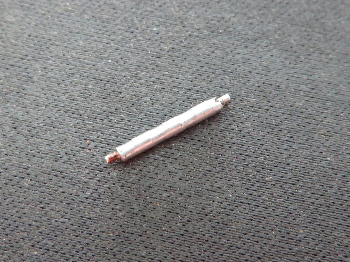

Should be a spring bar like this.
Push one side in and rotate the free side of the bracelet upwards to gain access, push through the other side or pull it through with tweezers.
