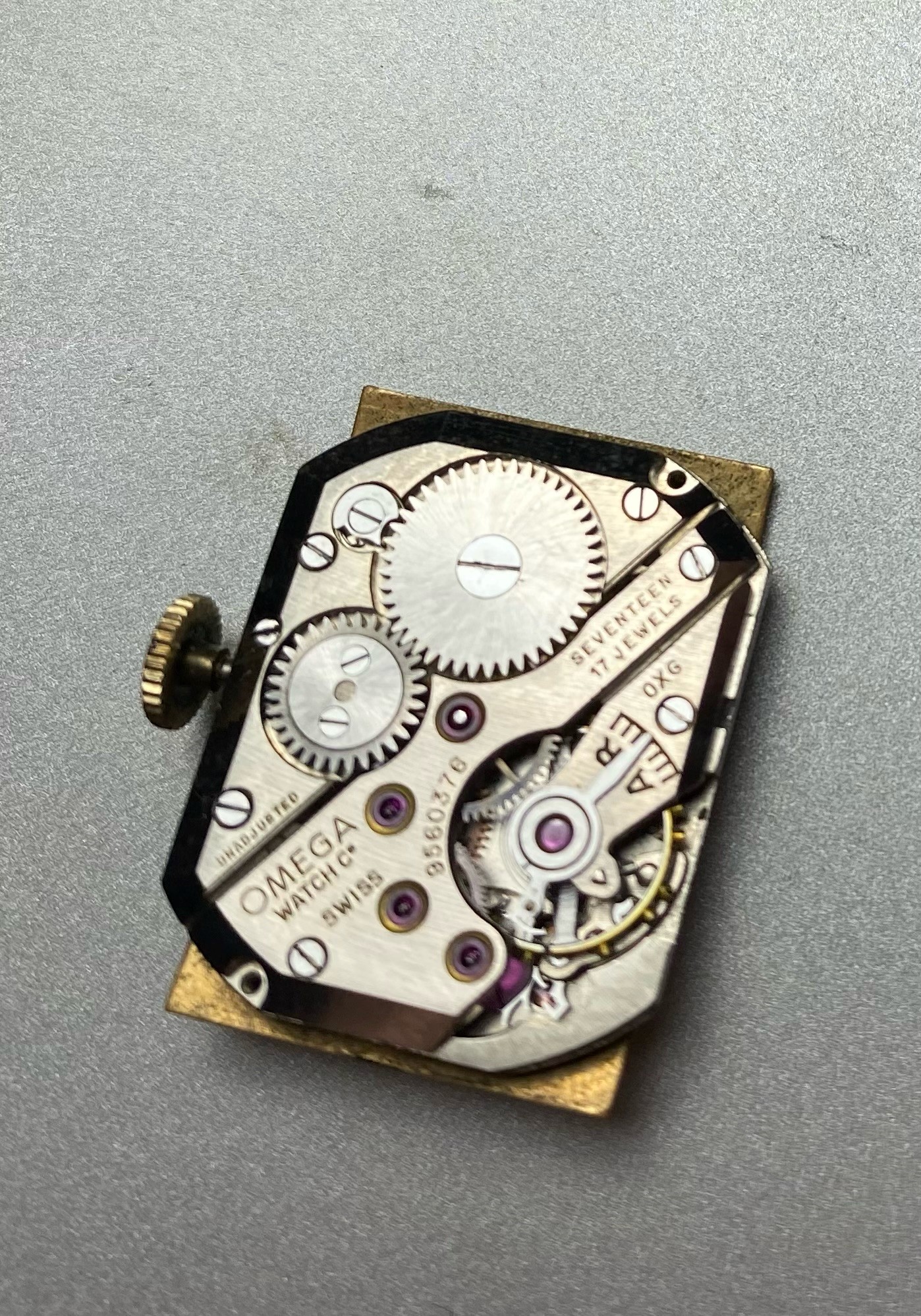

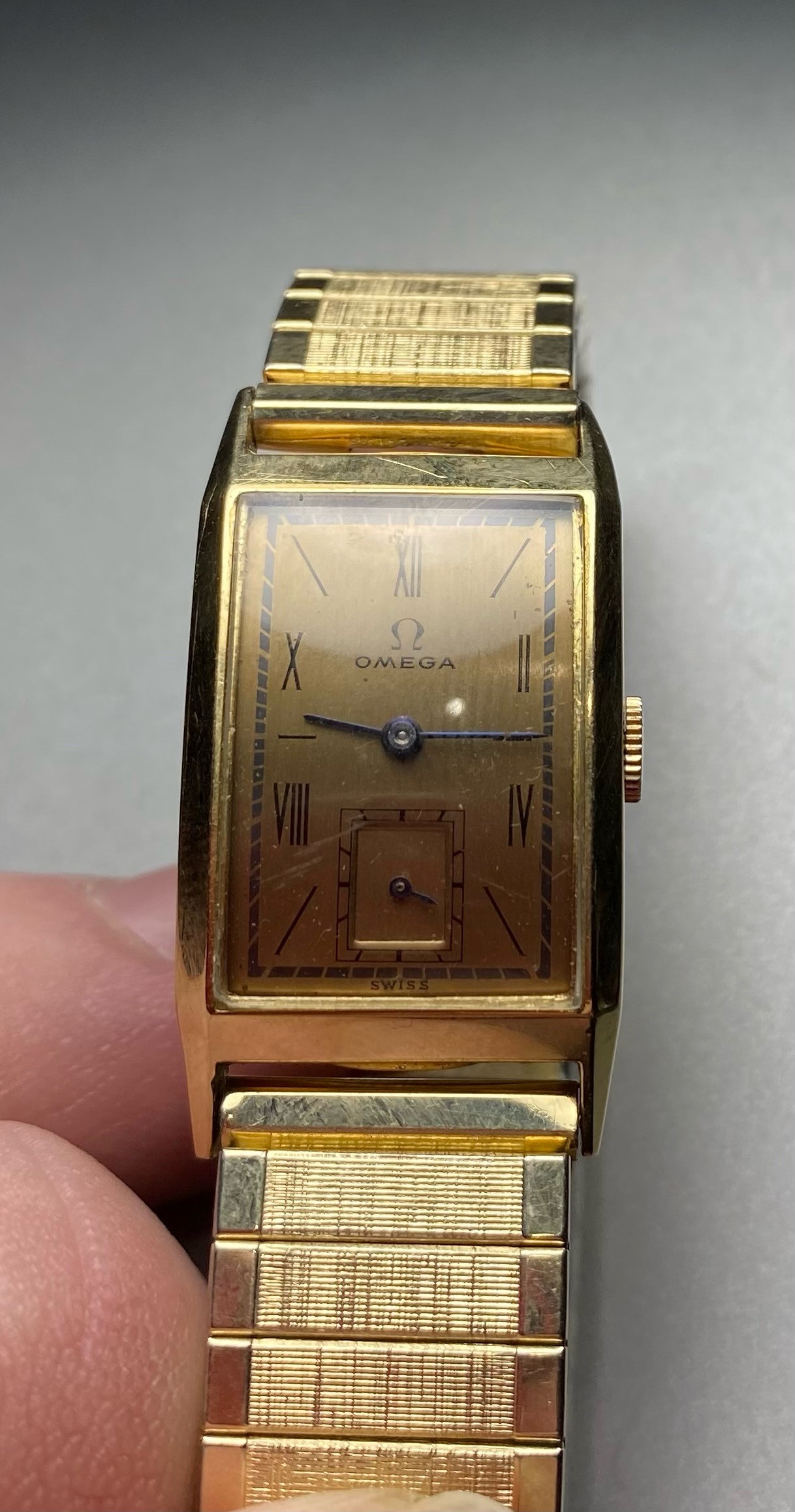

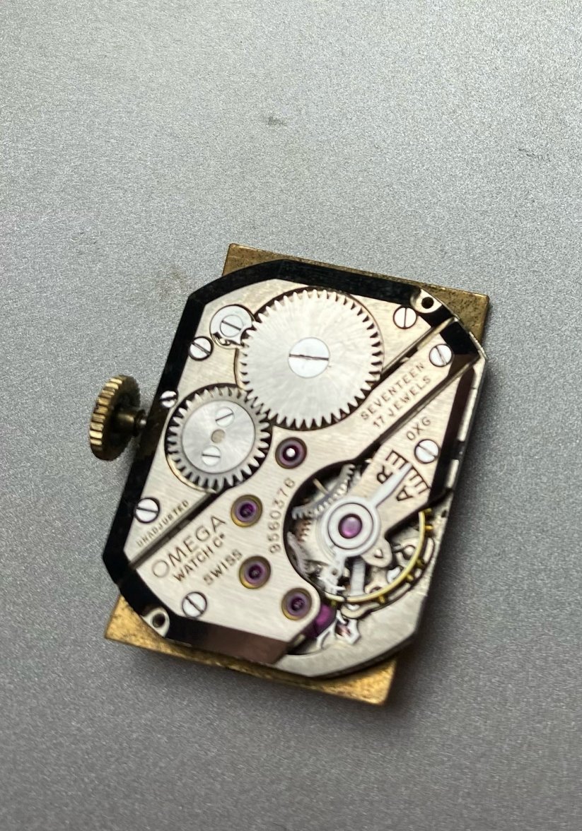

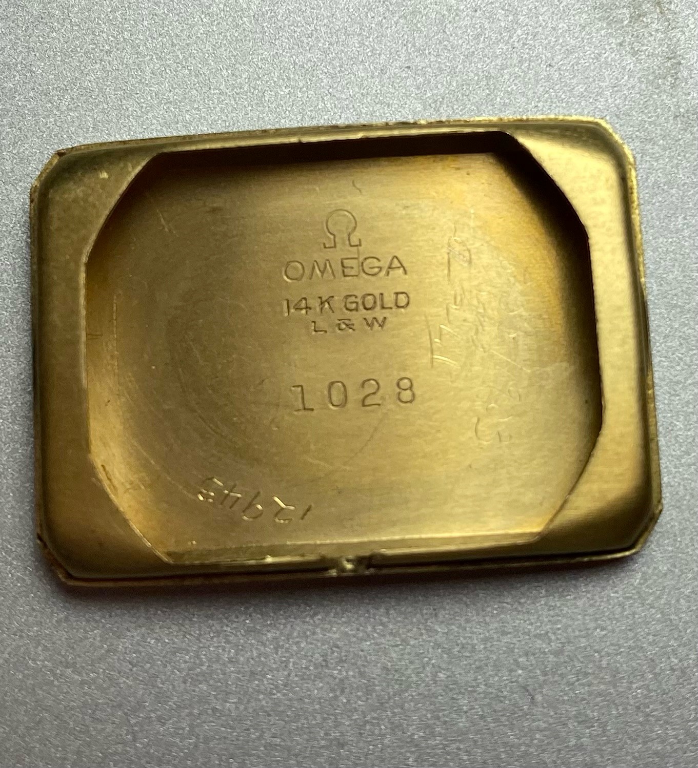

I am looking for assistance identifying/valuing an Omega watch that I have.
Sadly, I have no historical information on this piece whatsoever, it was part of a lot of miscellaneous items I purchased.
I am only able to tell that it is a much older omega, I believe I identified the serial number and I know the band is not the original. But I have been unable to figure out anything else about it, i.e. caliber, model, etc..
Any help that you might be able to provide me would be greatly appreciated. I have attached the best pics I was able to take with my phone.

You have an American cased Omega movement imported into the US by Norman Morris Corp, the Omega agent in that era, thus the OXG import mark.
The 14K gold case was made for Norman Morris by Lutringer & Wittmer.
The serial dates the watch to sometime between 1940 to 1950.
I think the movement is from the R17.8 family of calibers, introduced about 1940.
It doesn't have an Omega "model" name, unless Omega USA listed one in their sales brochures, it is simply a "gents gold Omega Watch".

Get it off that bracelet which eats away the gold inside the lugs. Nice leather strap and crystal polish

The watch looks totally legit to me, but this style is not particularly desirable currently and it's not considered an Omega classic. That said, whether or not to keep it would seem to be primarily a matter of personal taste.
