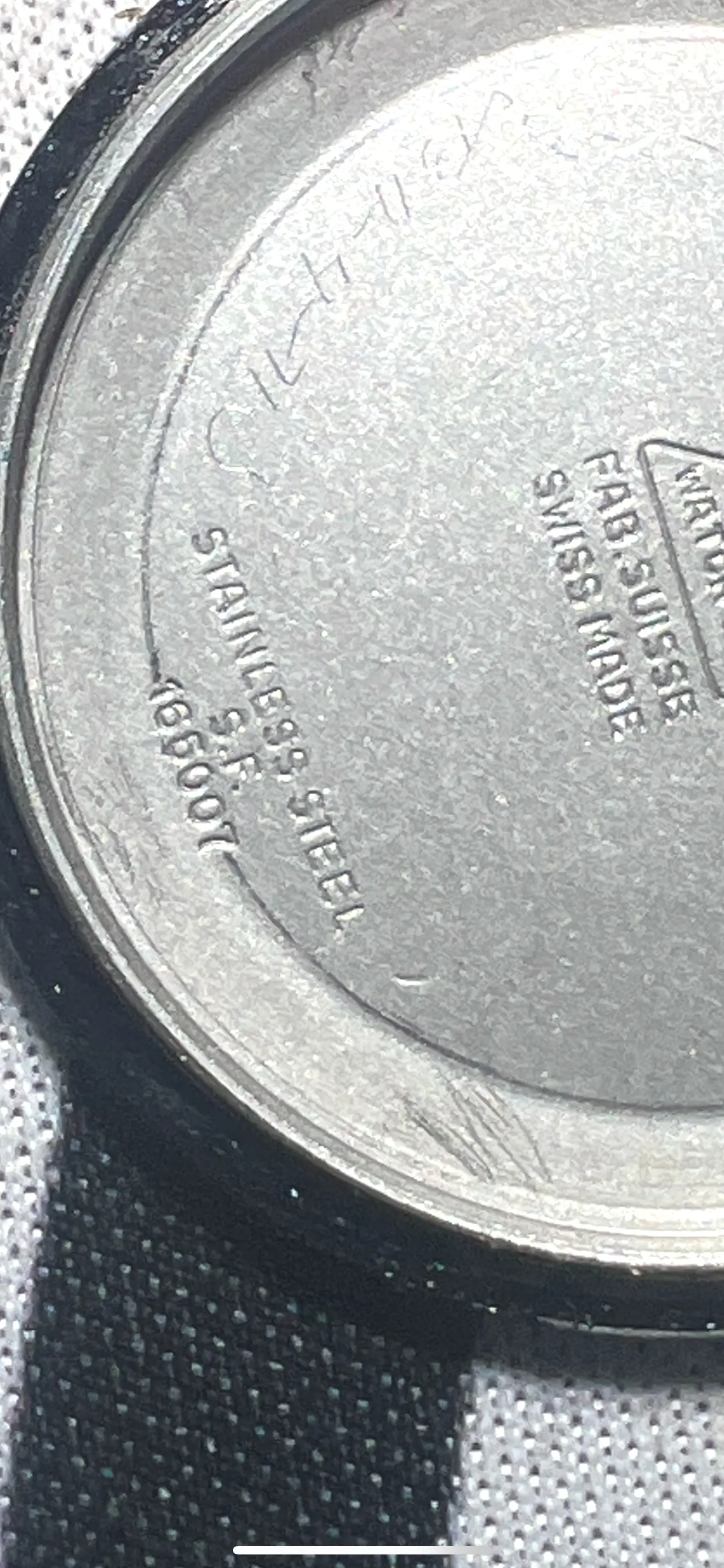

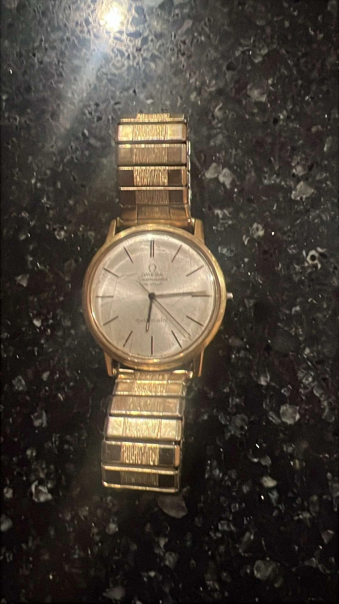

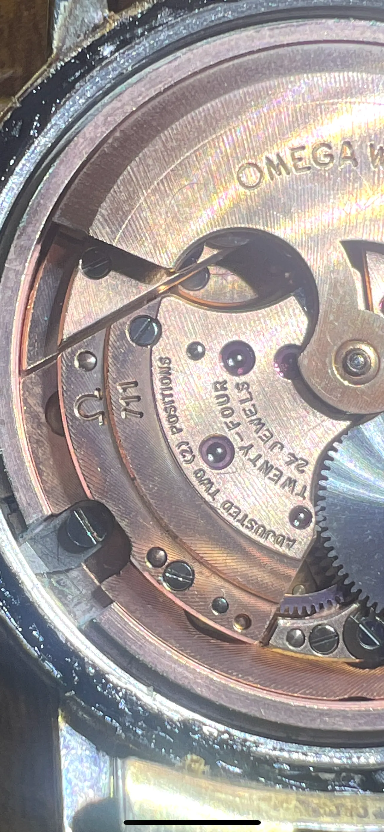

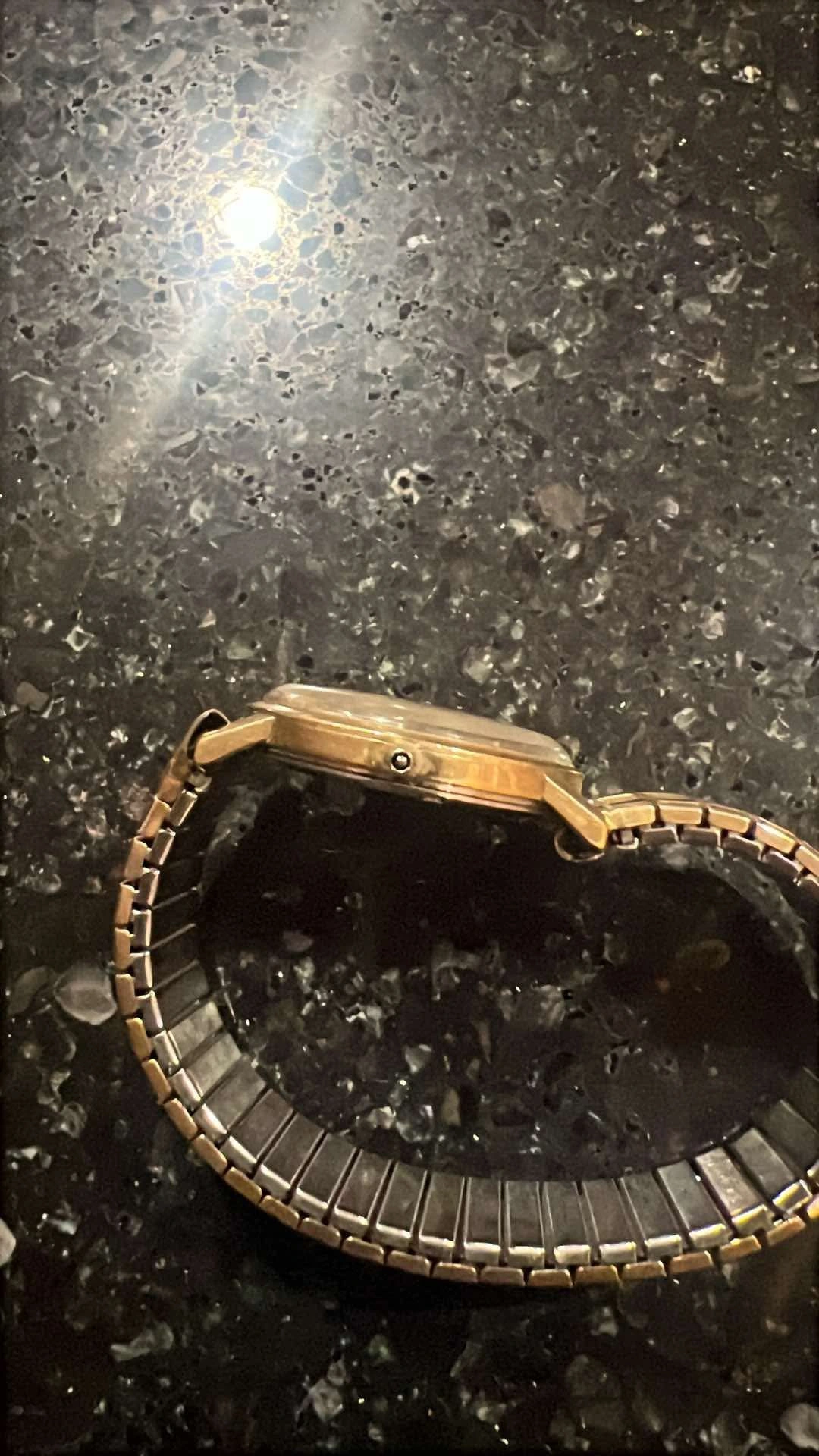

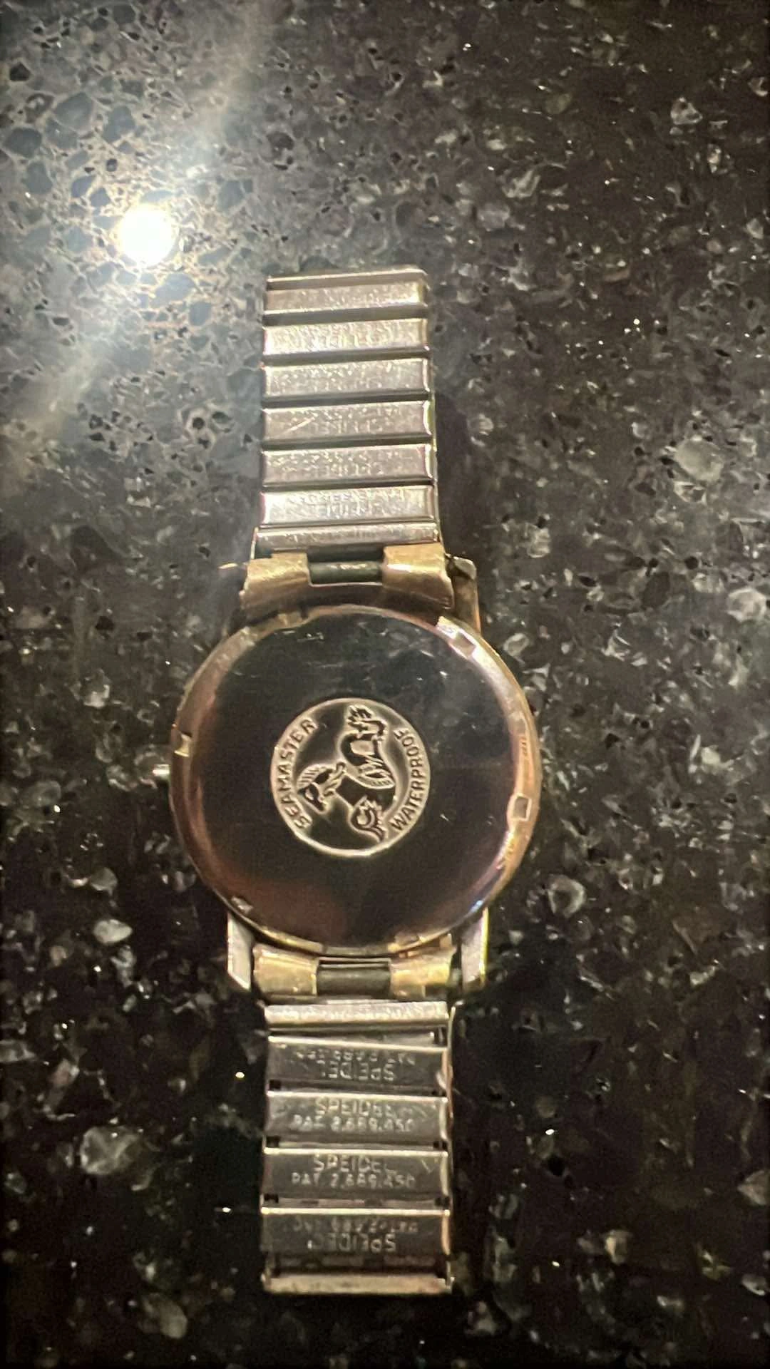

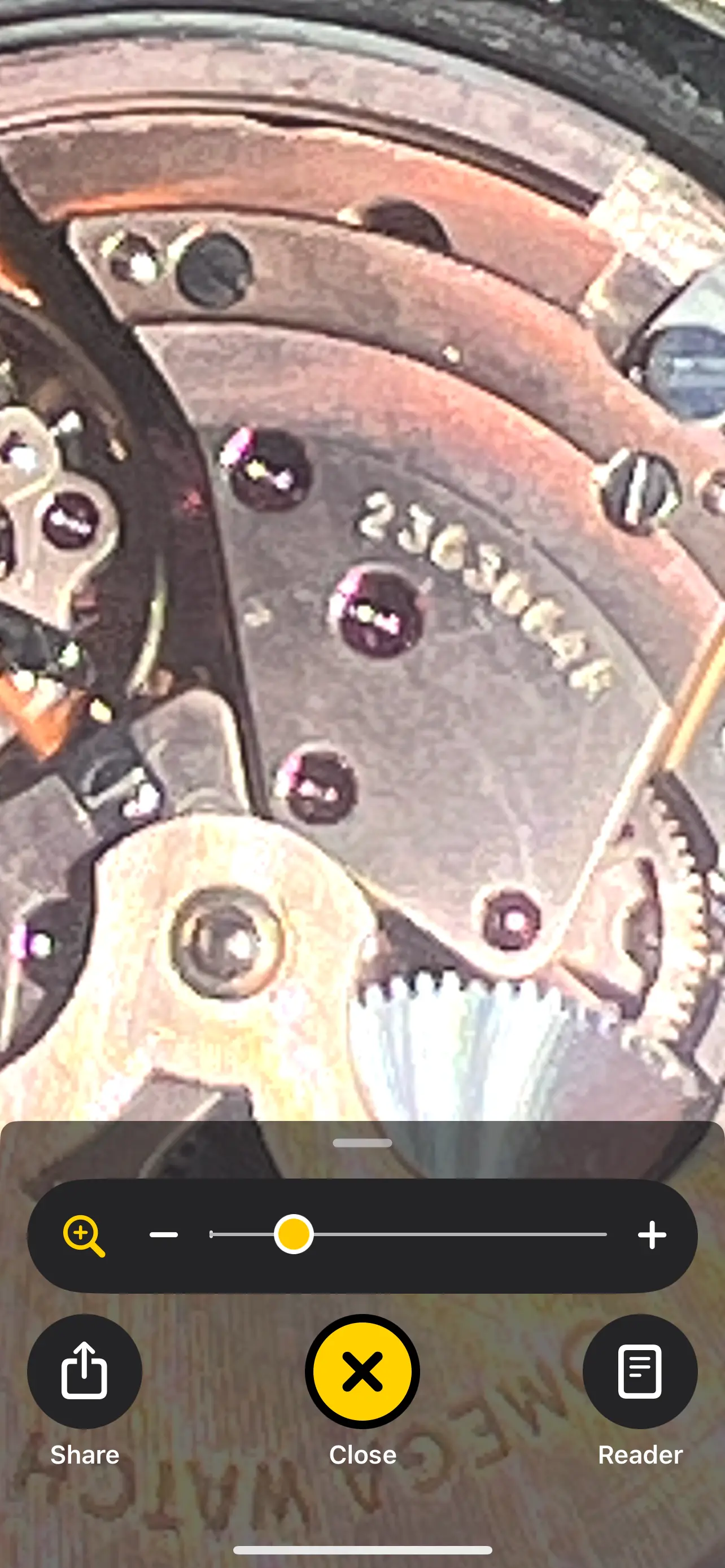

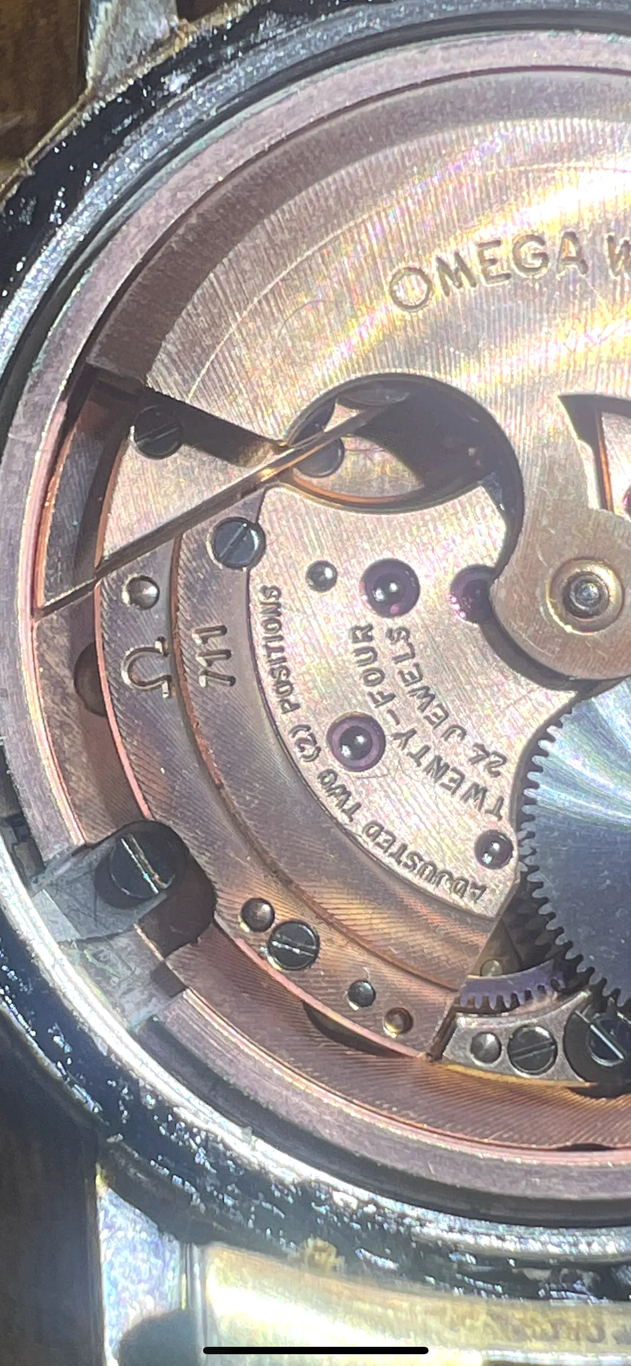

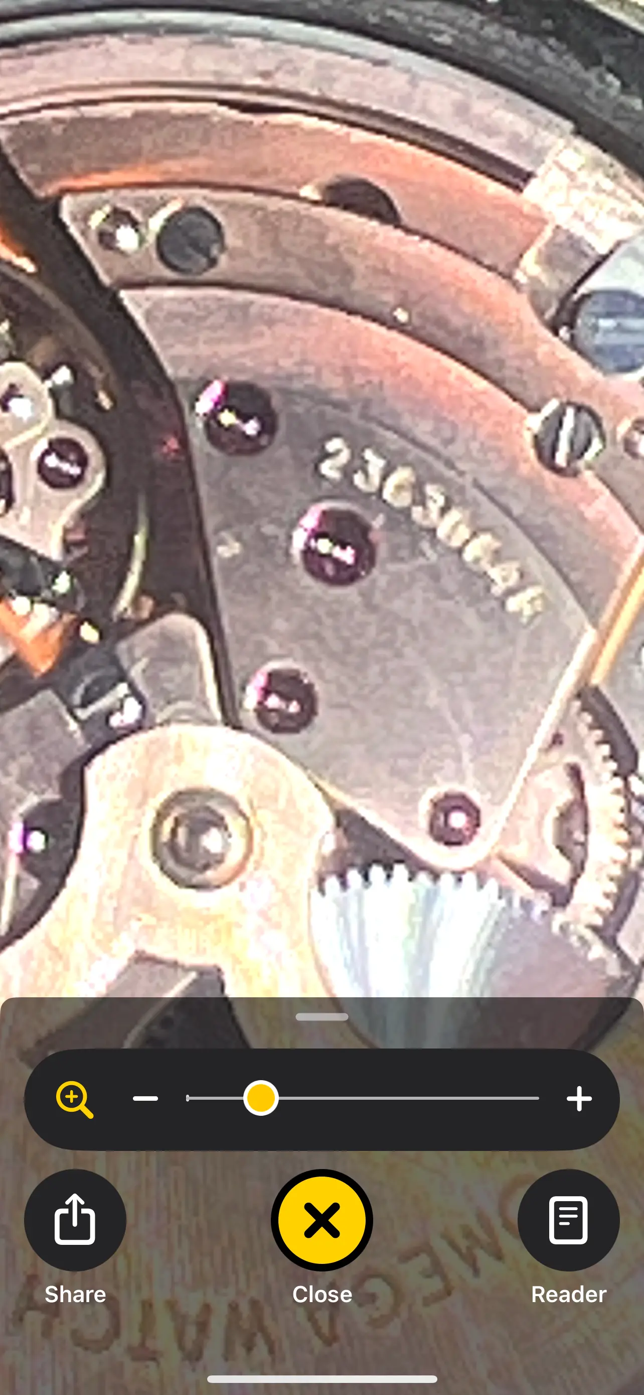

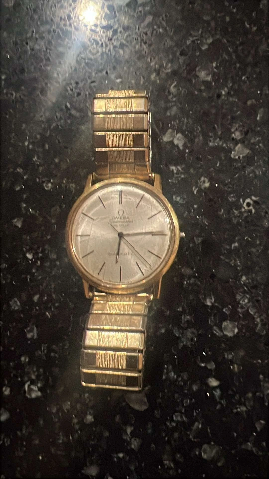

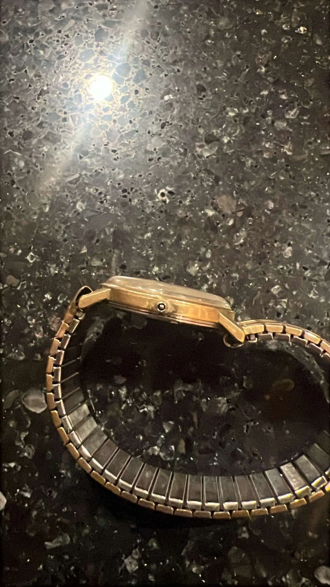

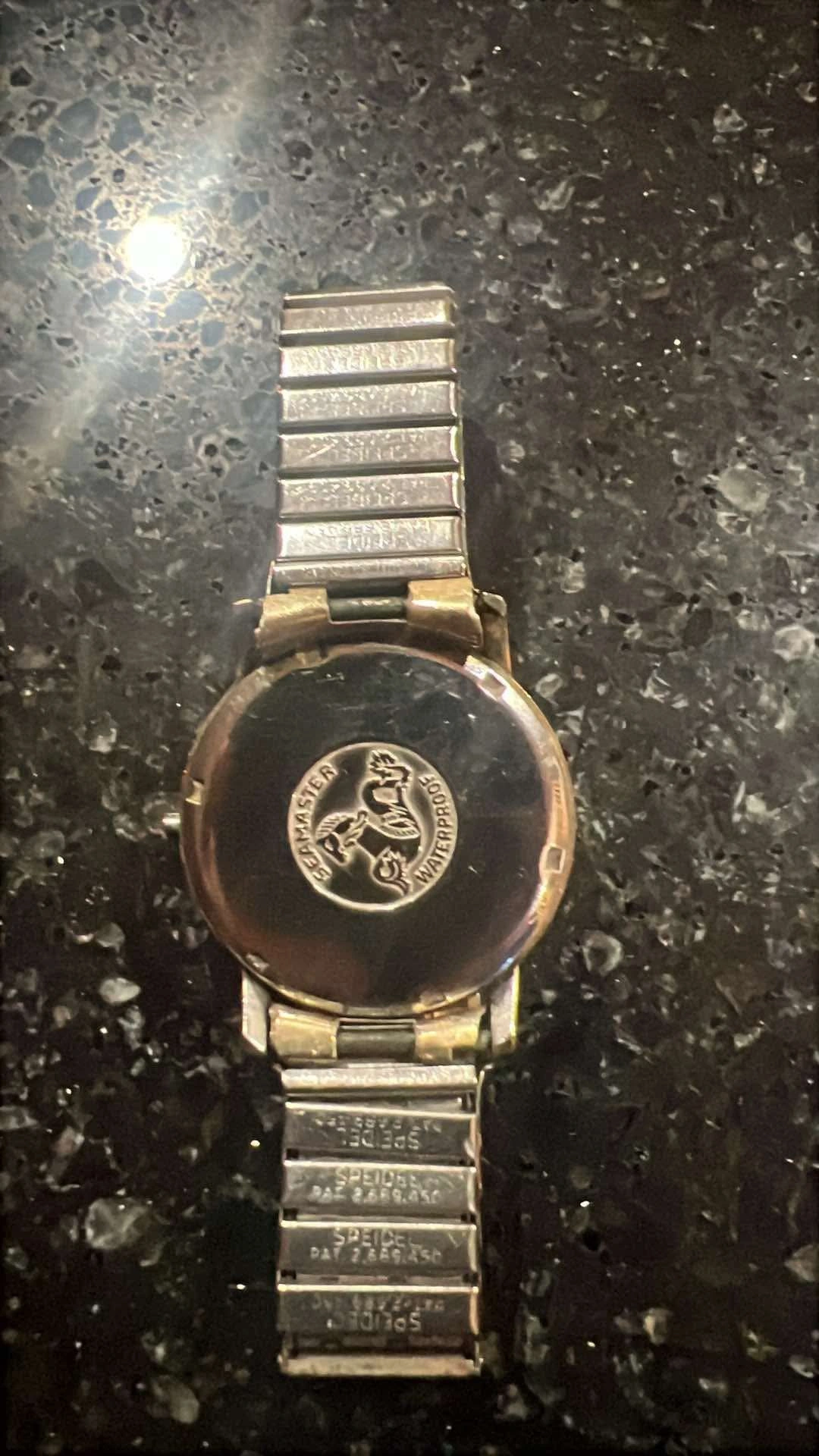

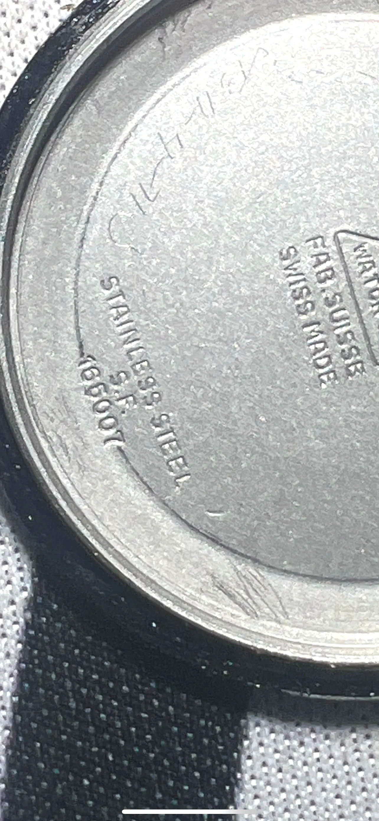

I inherited a watch from my grandfather. It is a Seamaster deville from the 60s but it is missing the crown. I don’t even know where to start to get one. Can you assist? From the case the reference number is 166007, which is also odd because I can not find much about the watch online. See pictures
30,303
78,234
The watch needs a service. The case back seal has turned to black goop, so this would indicate it’s been a very long time since it was last serviced.
The crown you will need is 069SX42044.

Thank you! From what I can tell the last service was in 1971. 🙁. Definitely in need of a service!
