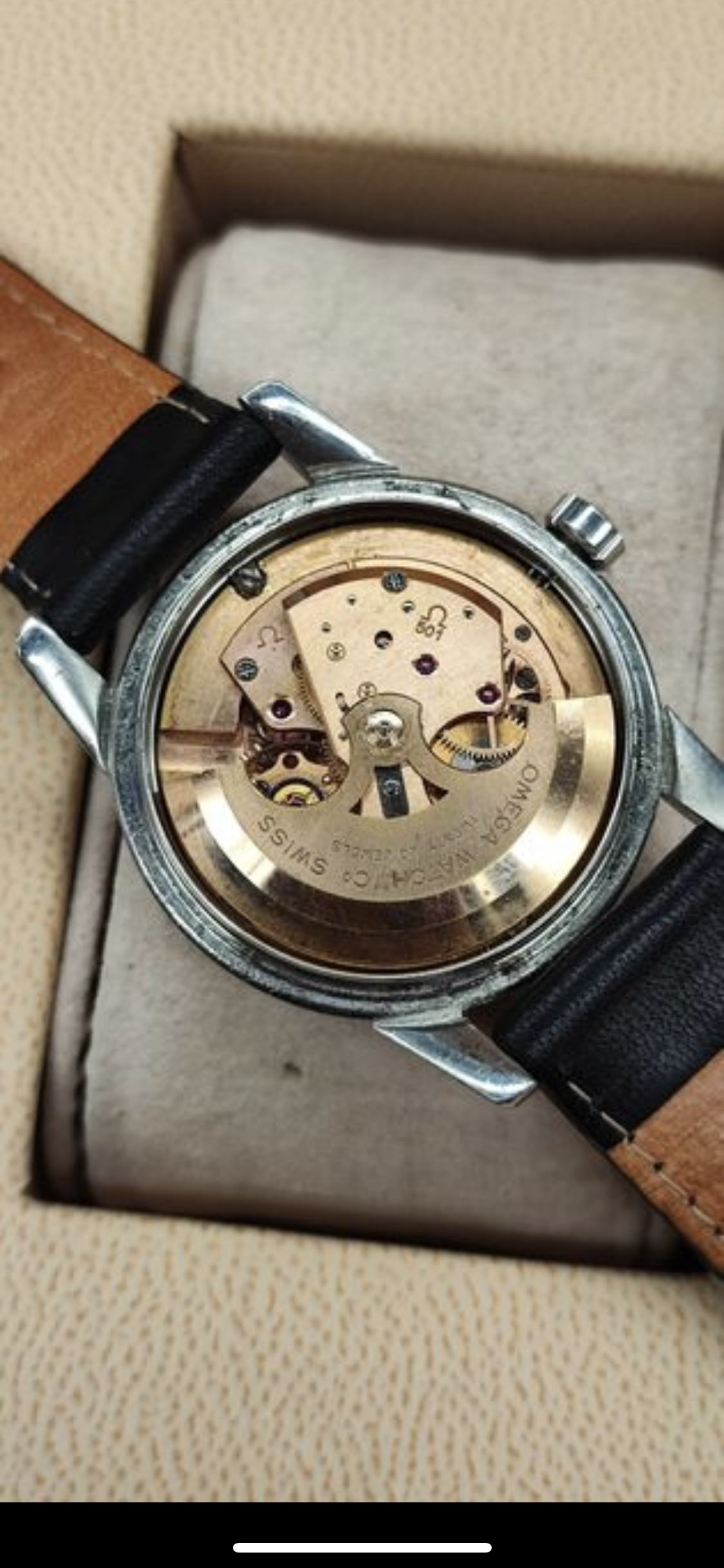

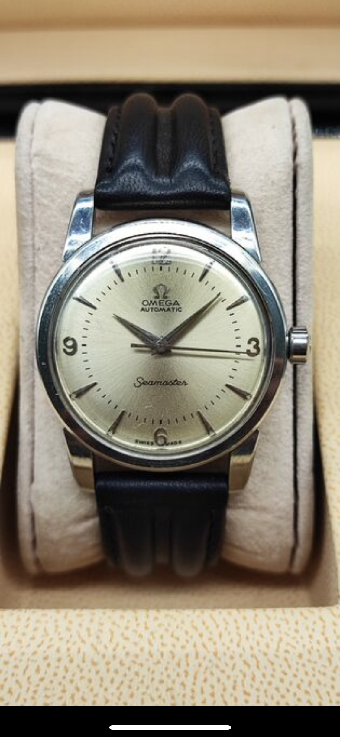

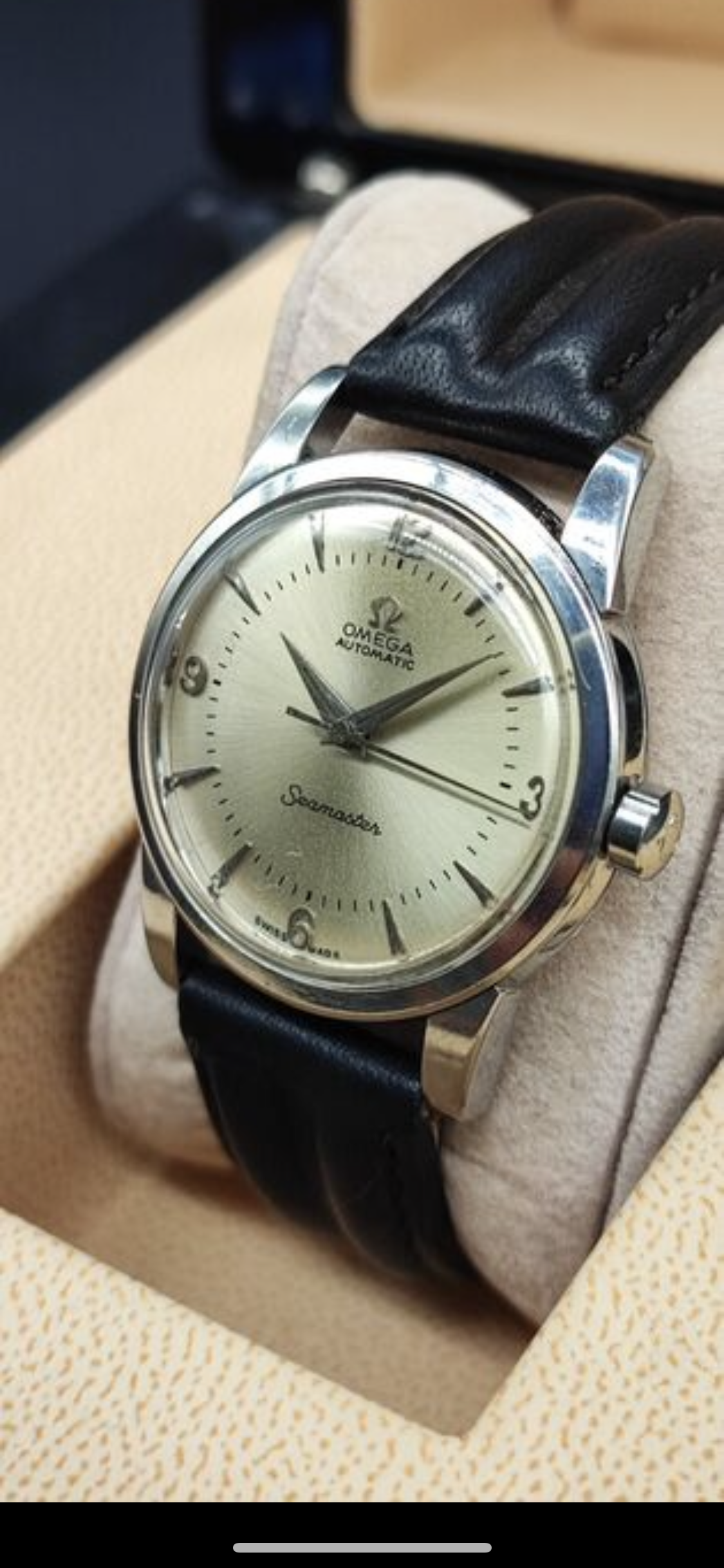

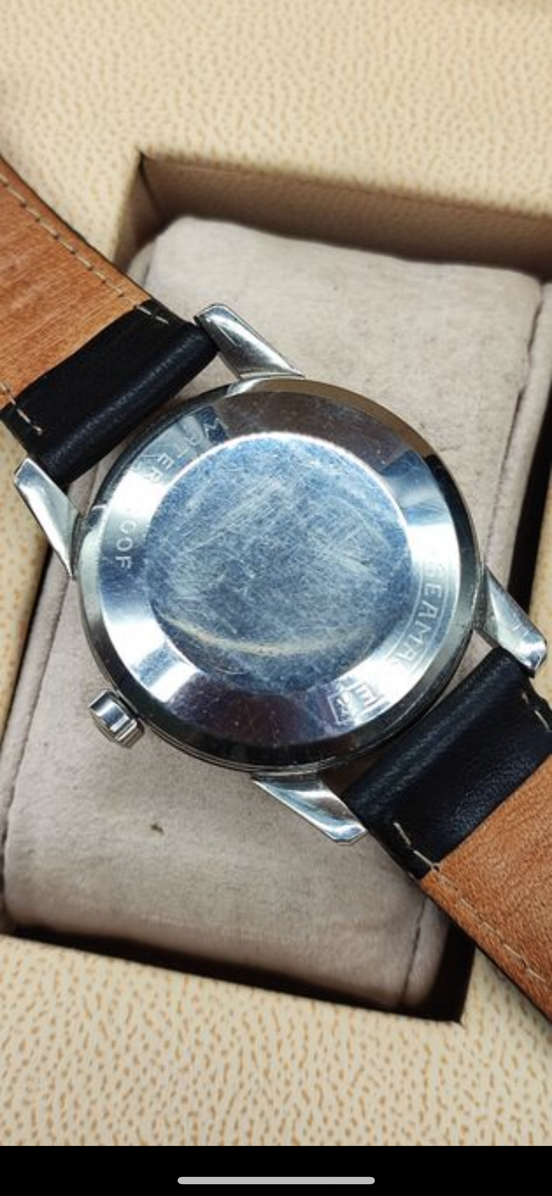

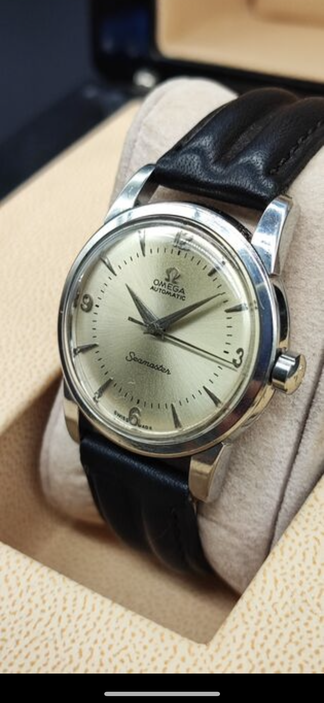

I just purchased my first Seamaster. The seller claims it is between 1950-1959, however I am unsure on how to tell. I have attached all the images I was provided with below.

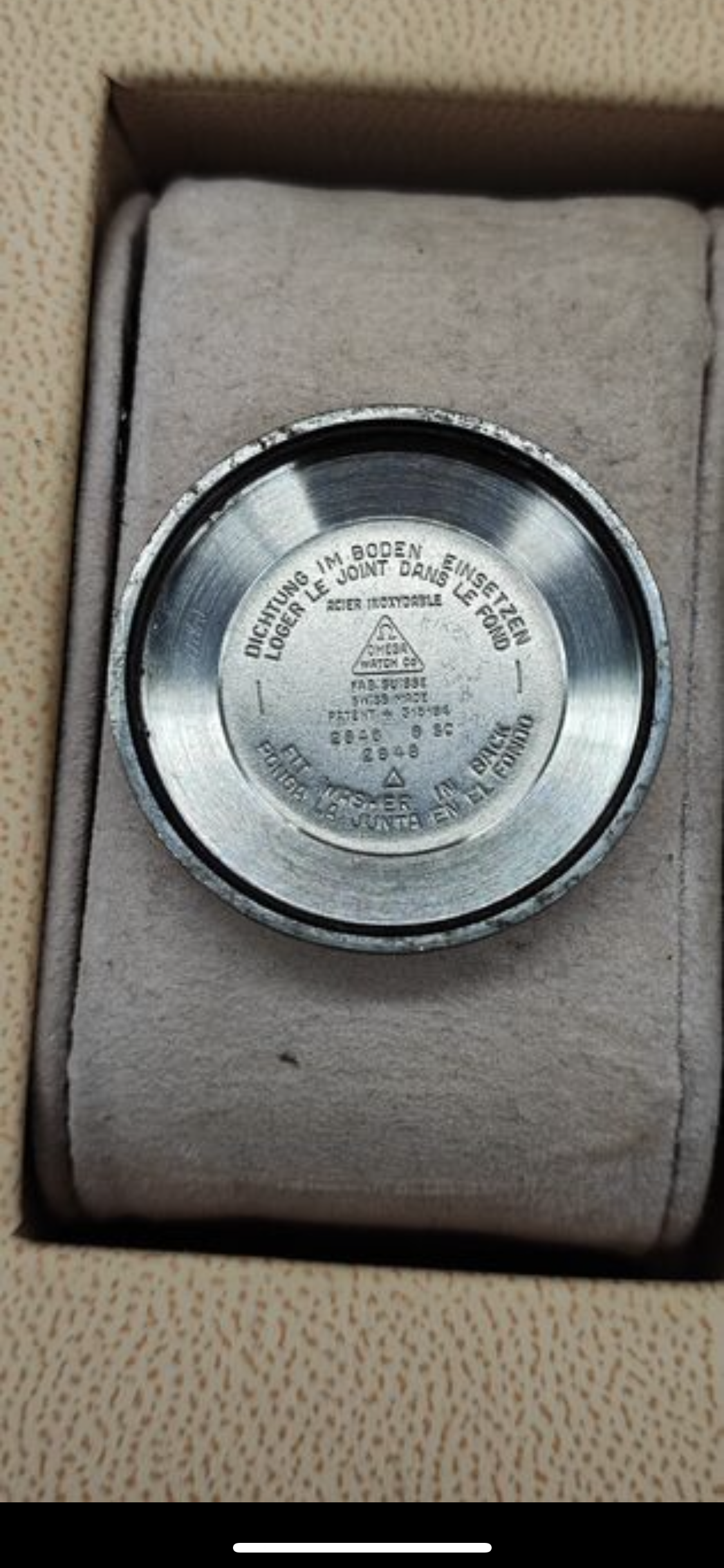

Also, it is referenced as 2846-8 SC, Cal. 501. Are these references correct?
I believe the watch and the strap are real but am unsure as it is my first. Please help me authenticate this watch and if it’s real please tell me more information if you can. Thank you for all the help ❤️

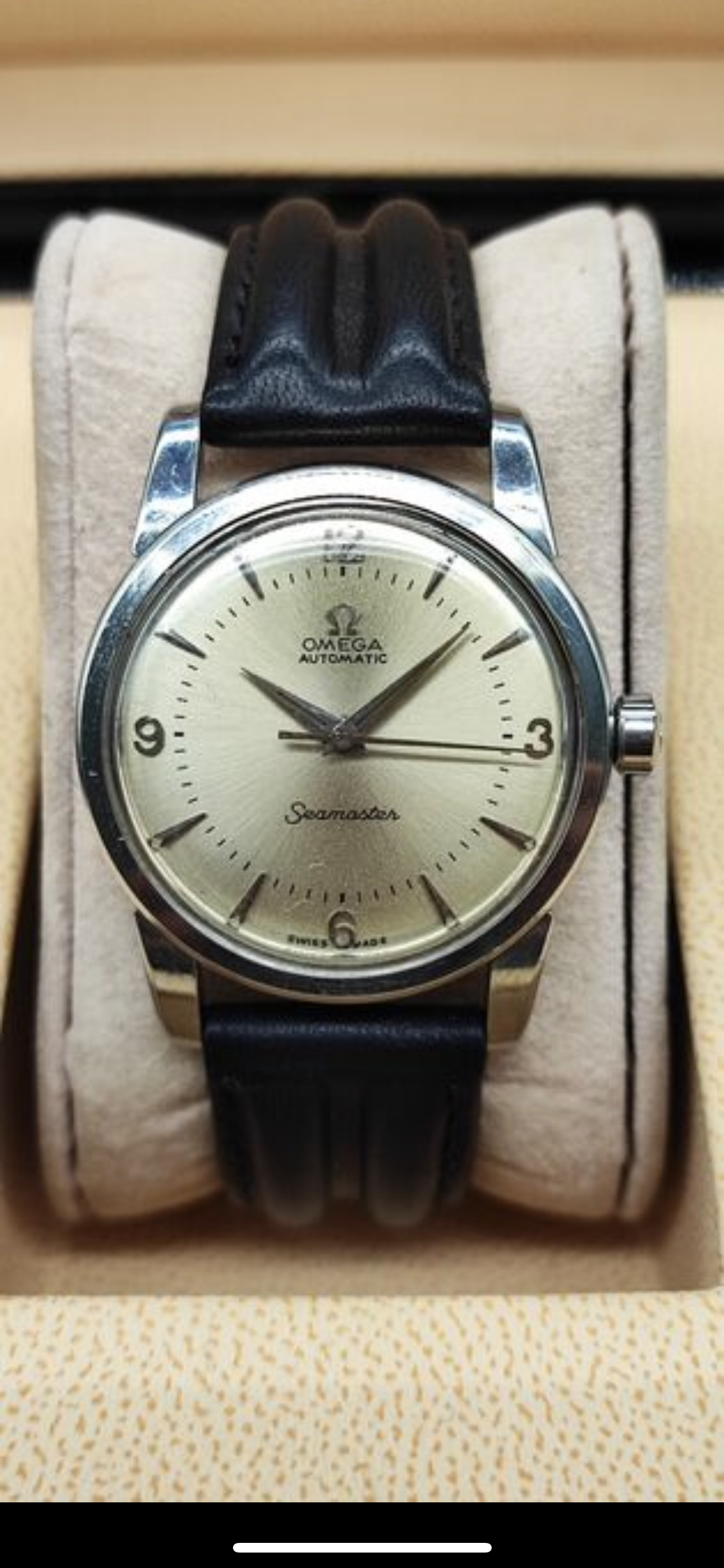

Yes it's genuine, ca 1958. Unfortunately the dial has been refinished.

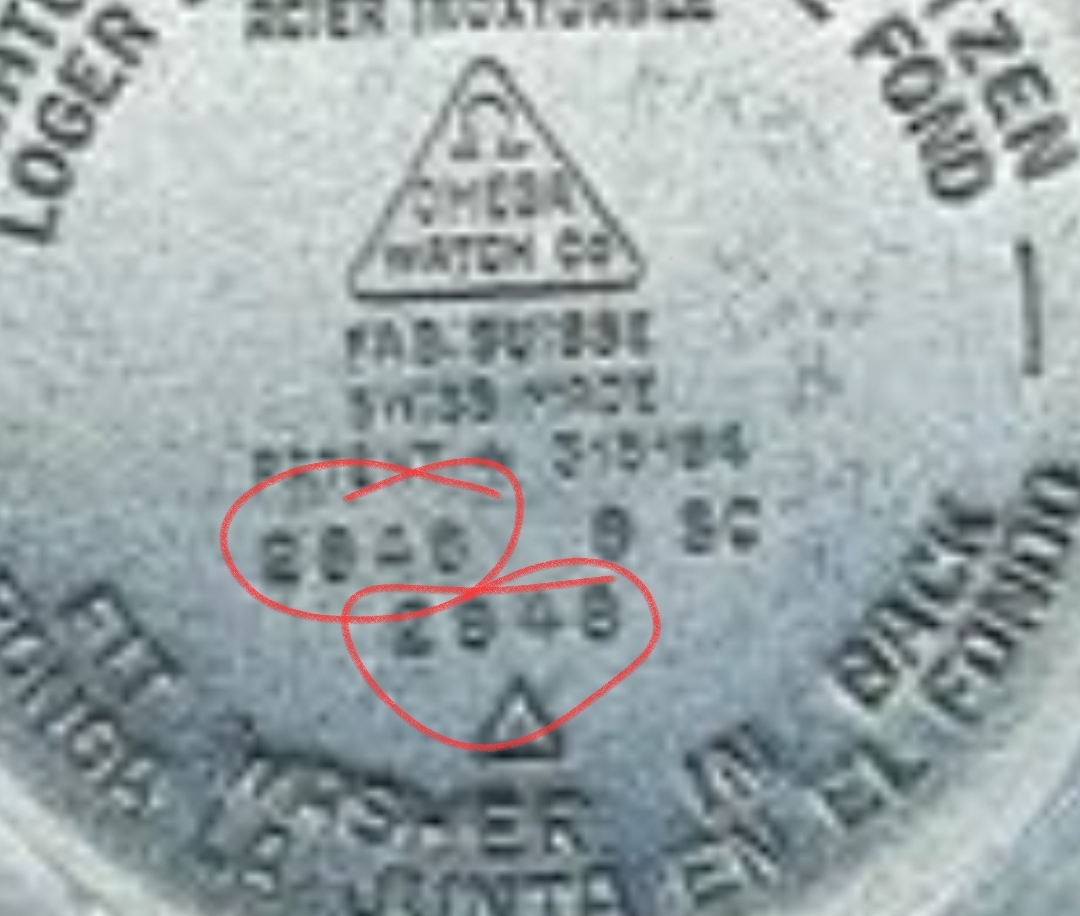

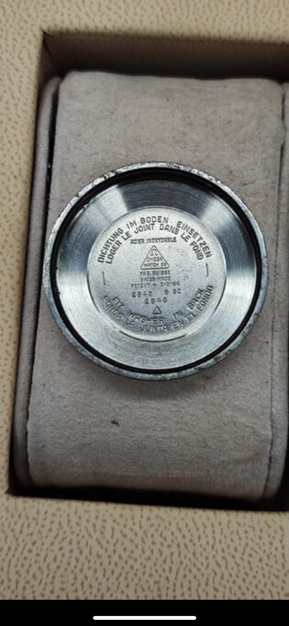

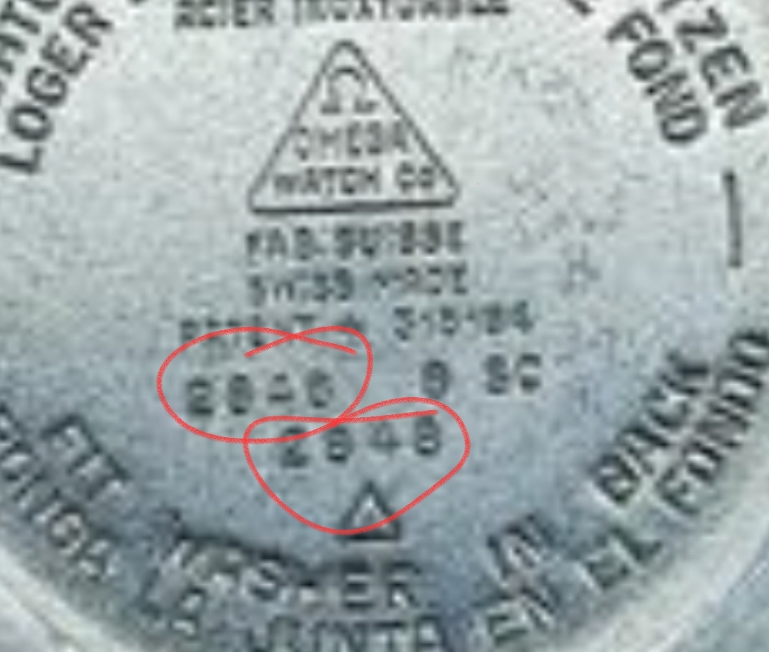

Reference number (2846/2848) is written inside of the case back. Unfortunately, dial has been poorly redone.

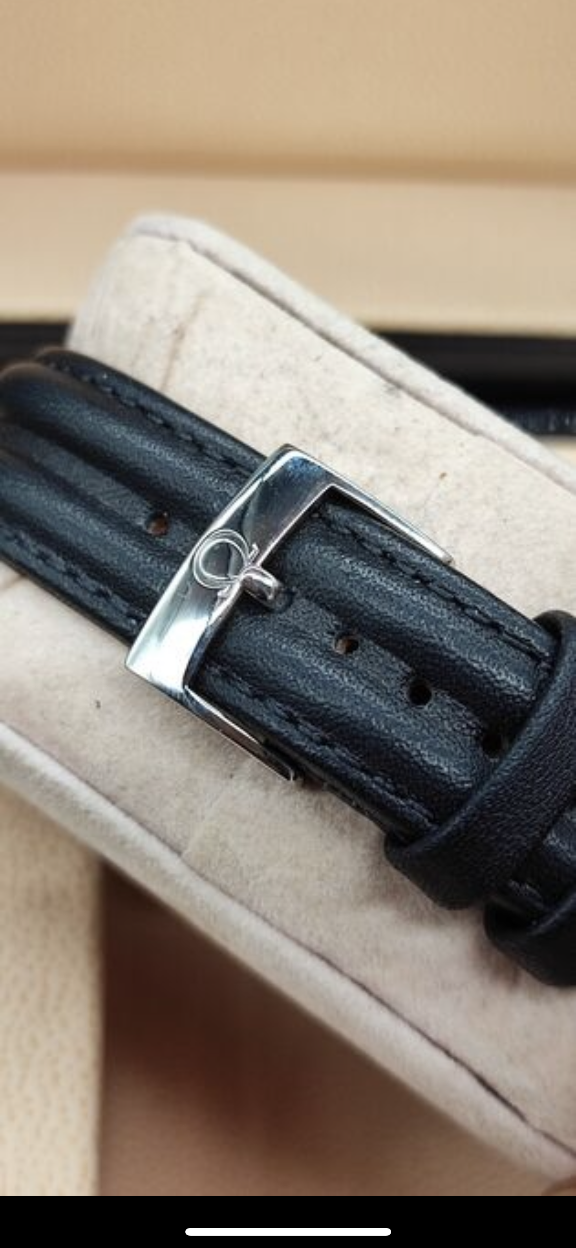

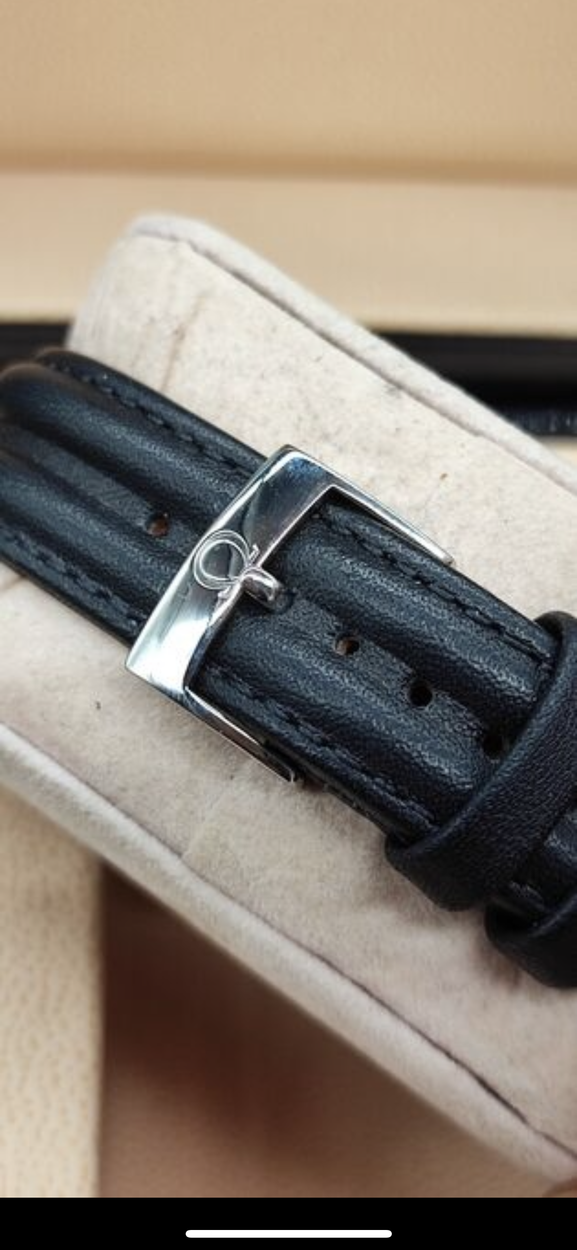

Pass this one. İ really love 2846-2848. Specially two tone dial. But this is a bad redial. Buckle is not original. You can find many others for good prices with time.
12
7
Thank you for the advice. Unfortunately I already paid for this so I can’t pass. Can you explain why the dial is bad? I don’t know what to look for and why it’s bad. Please educate me 😀

The redial is poor as the quality and consistency of print isn’t there. A collector wouldn’t buy it at all I’m afraid. Value possibly around 250£/€/$.
That said, if you like it and didn’t pay too much it’s a fine daily beater. It’s simply the noob tax that most of us paid when we first started collecting vintage watches.

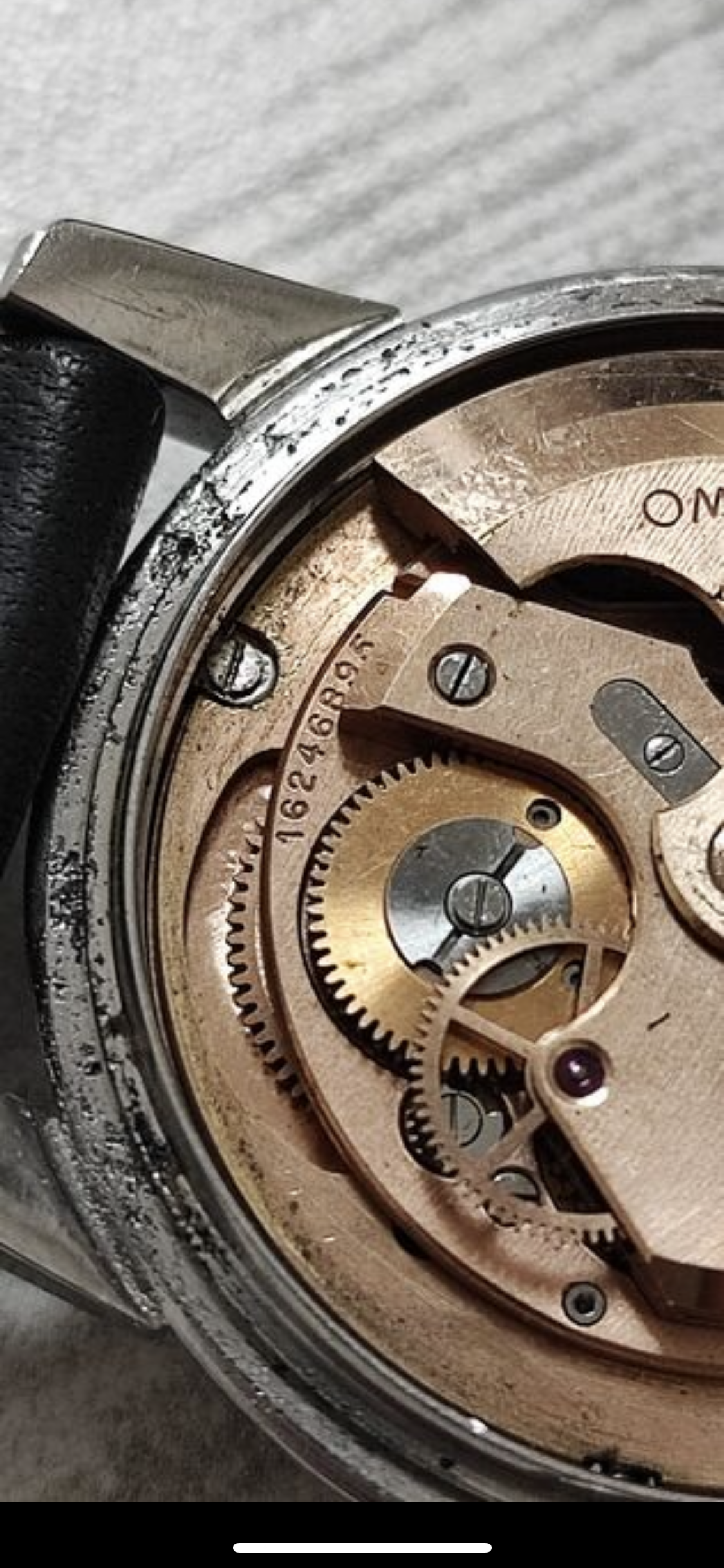

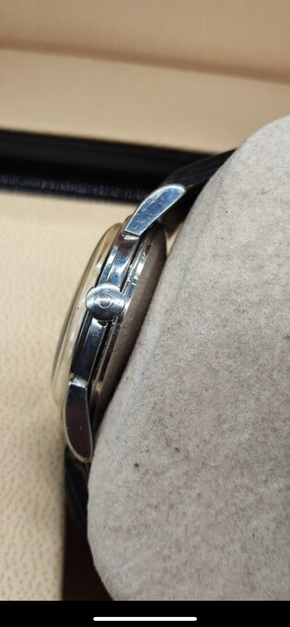

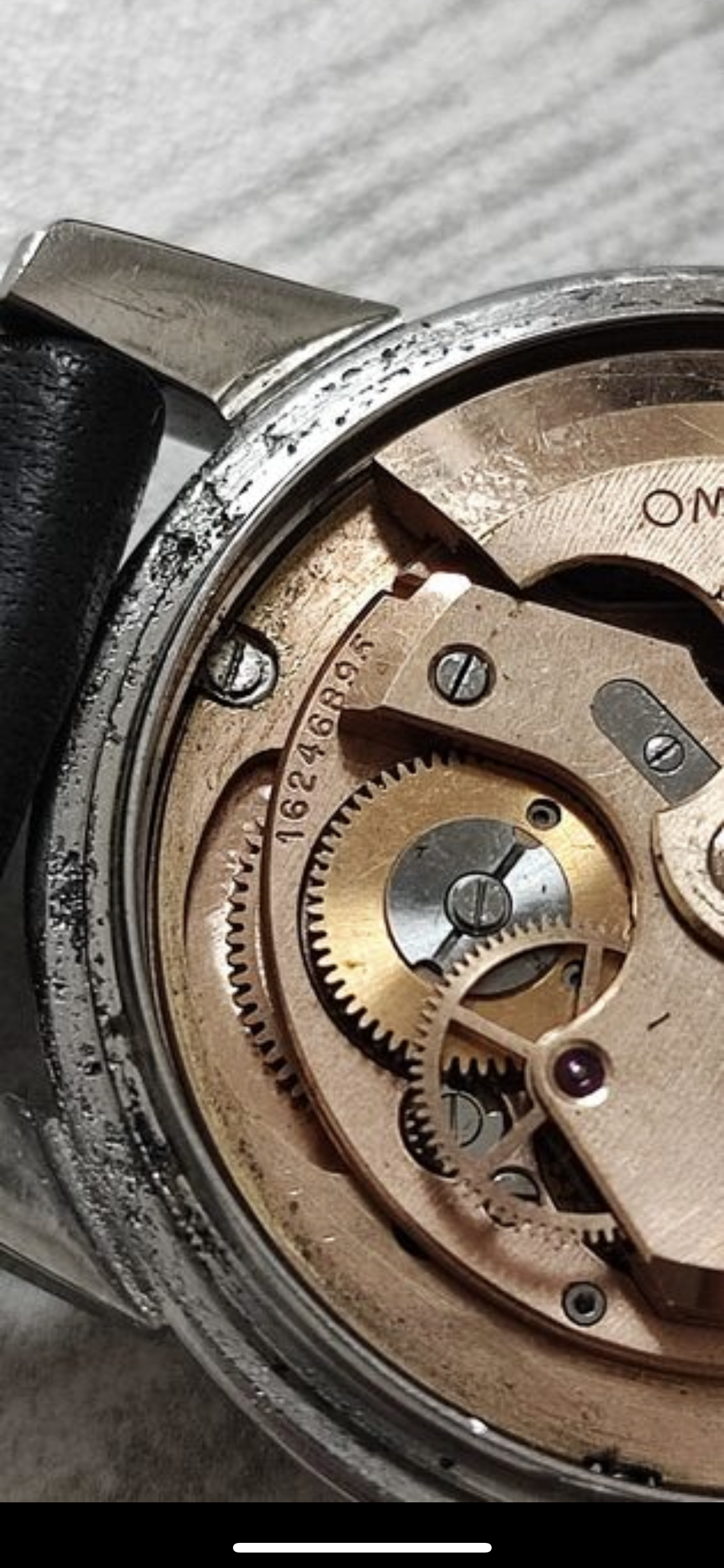

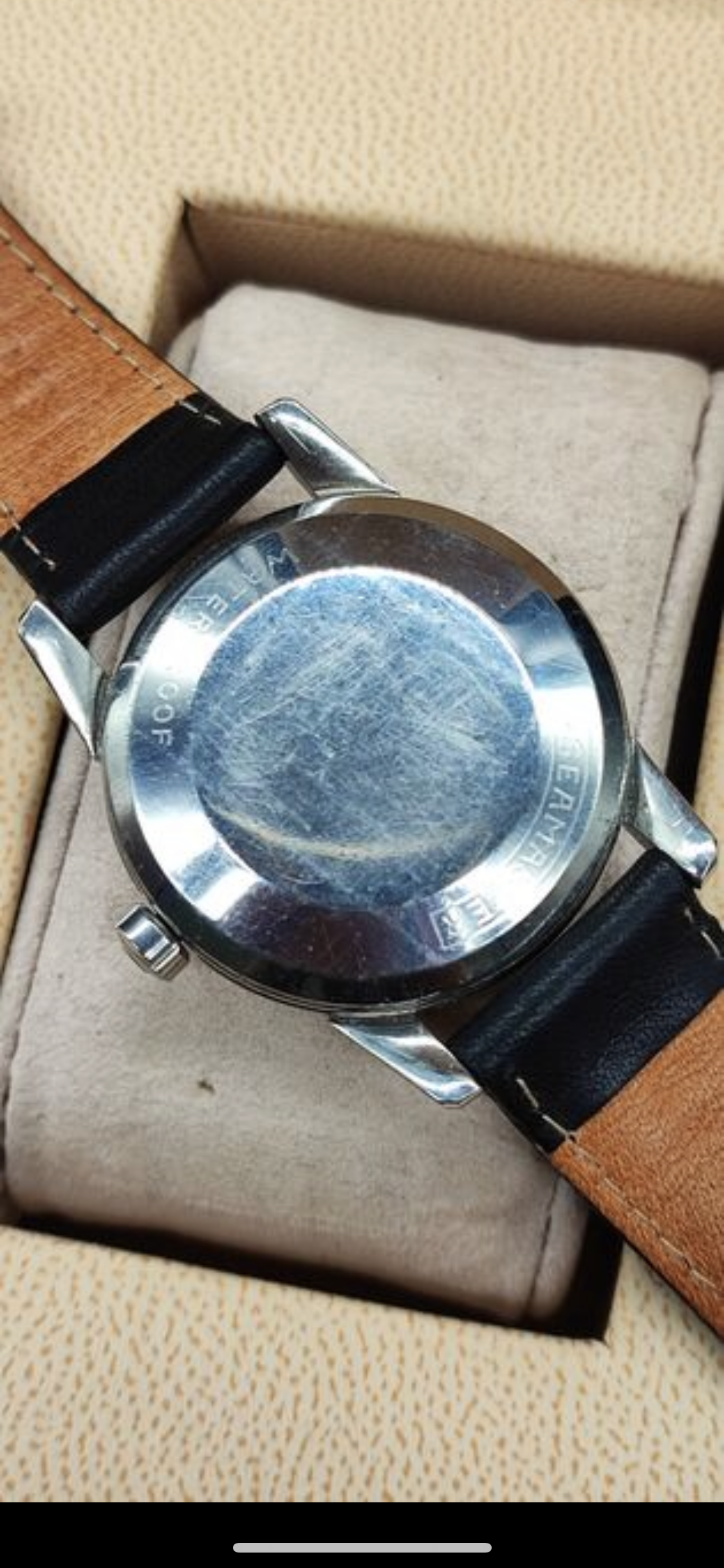

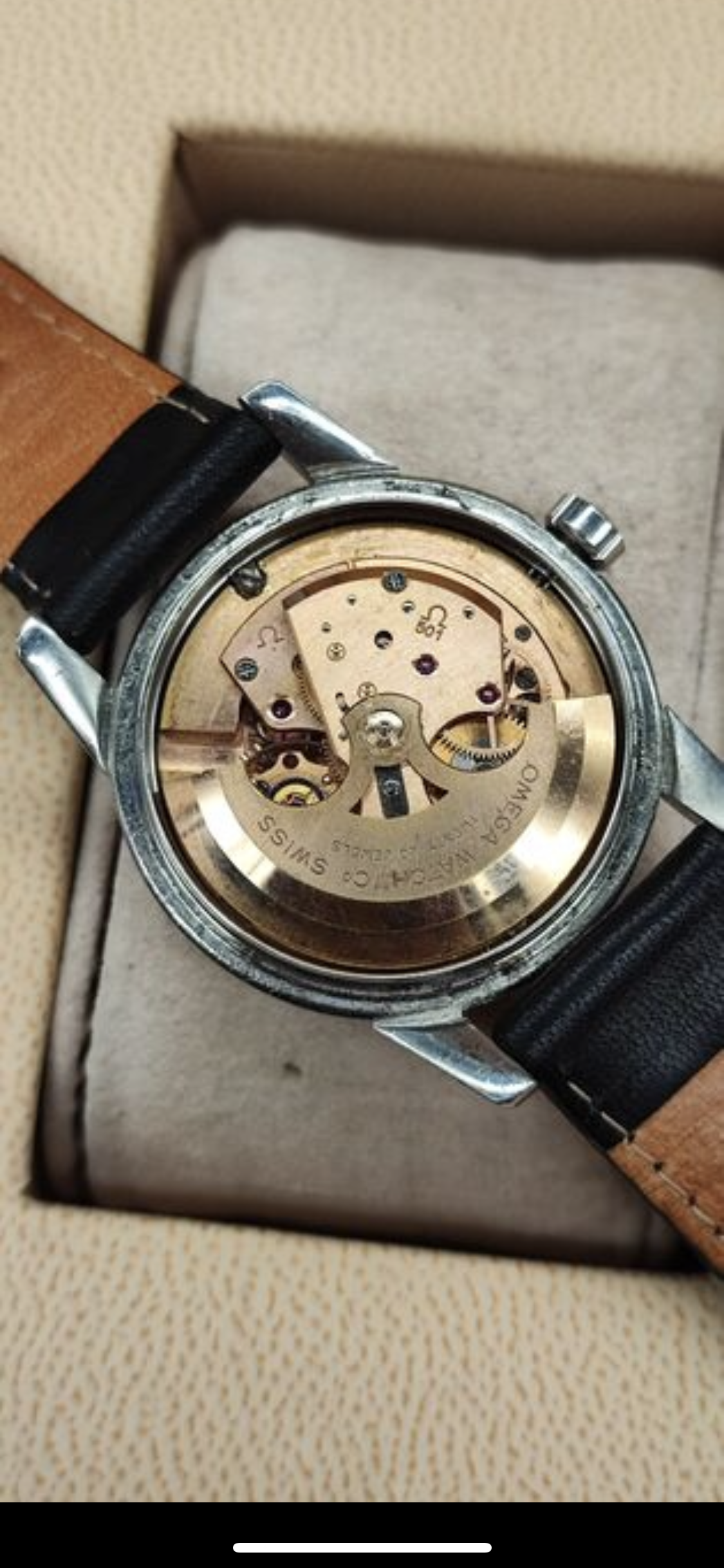

The dial makes up a significant portion of the value of the watch, but the dial is not the only issue. The case has been polished enough to remove all the original finish and edges, the movement looks a bit tired and dirty and there is pitting on the case as seen here:
The dial has uneven and overly thick text. The script is also wrong, it has a round S like in later 60s Seamasters where it should have a coat hook S, like on this dial (taken from a dealer's page);

The redial has been done well after radium was banned from use as evidenced by the use of the round S script.
It may be tritium lume on the indexes, which is much less hazardous then radium.
