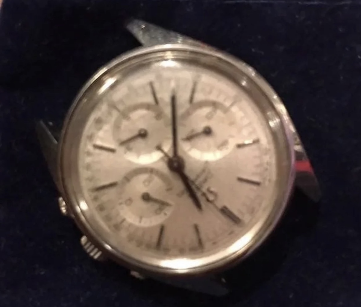

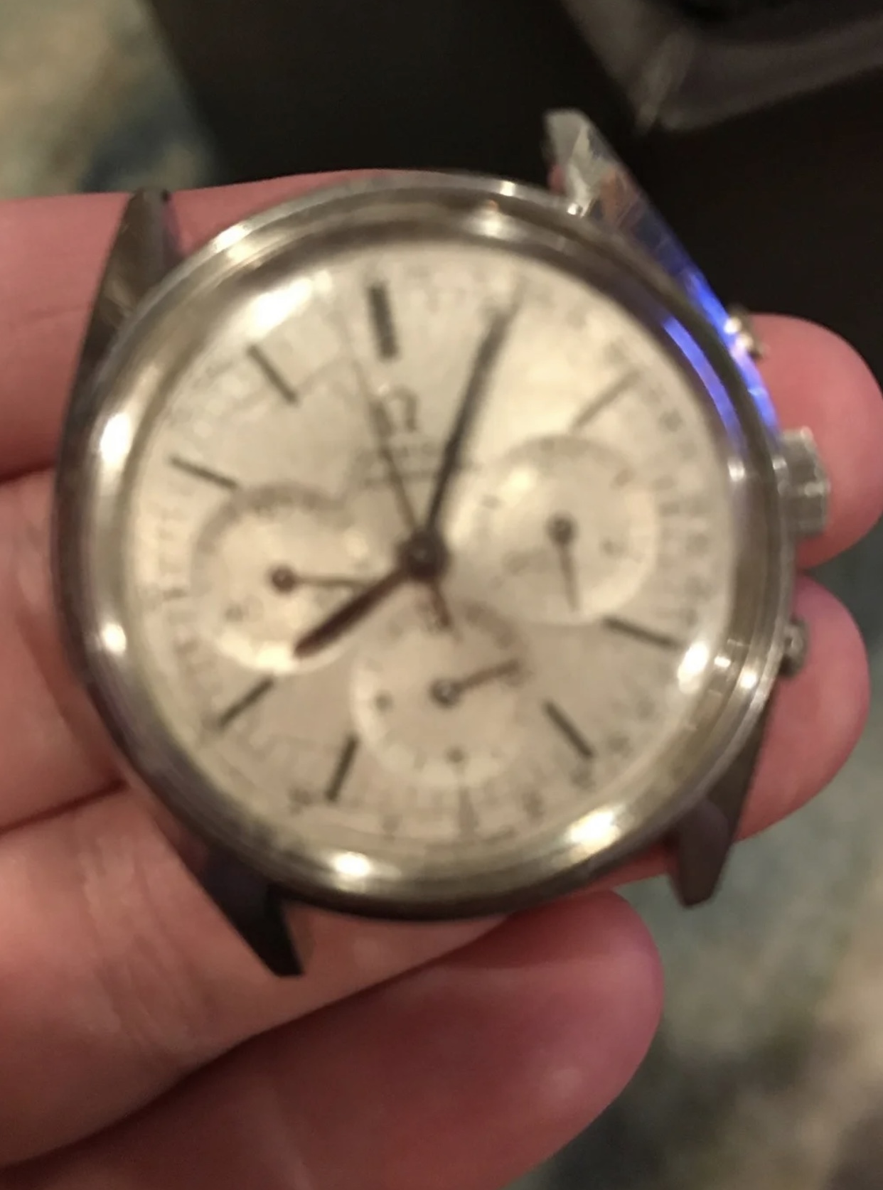

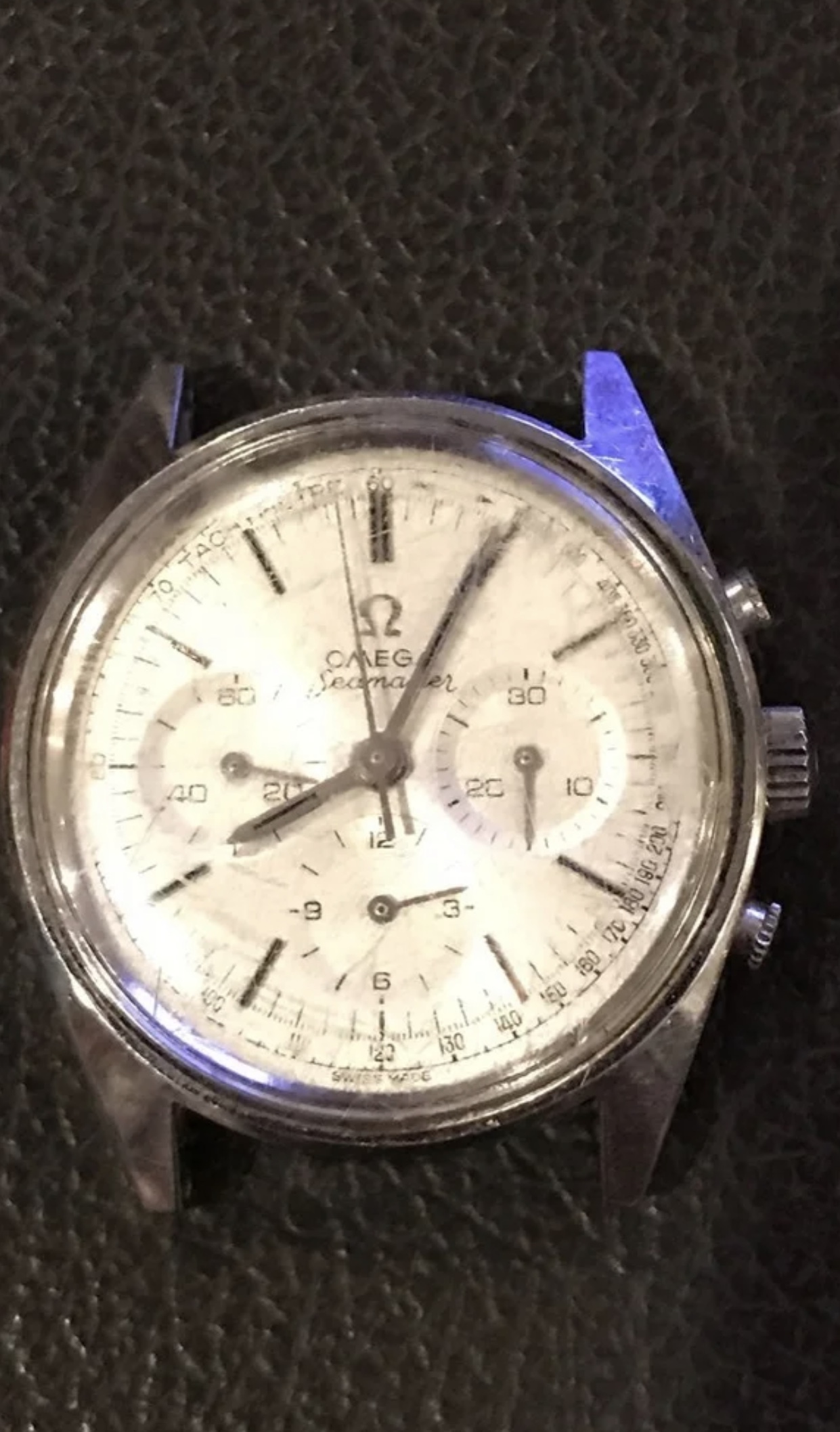

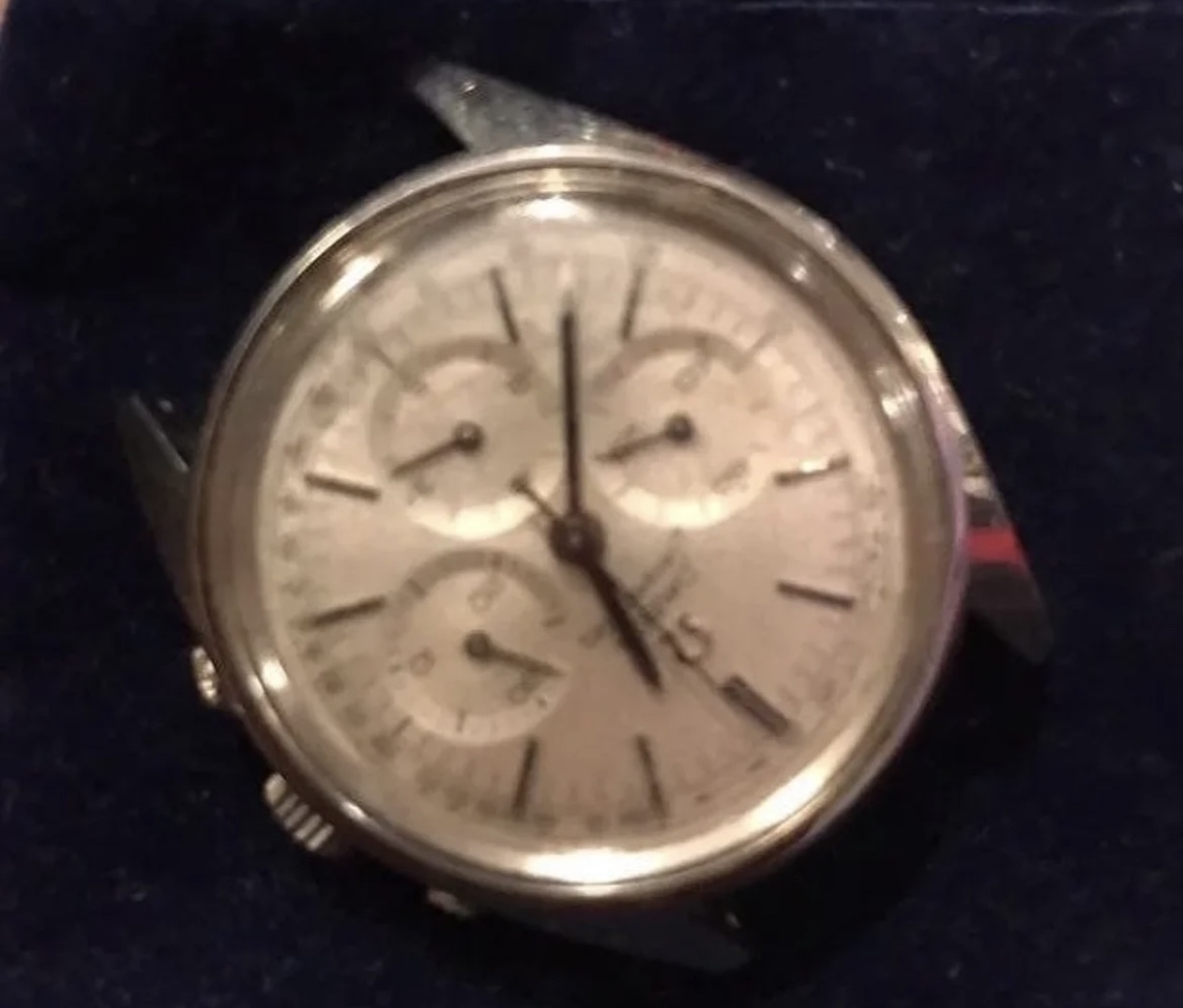

Hello OF,
I found this 145.018 online with some not so great photos and was wondering if anyone could tell whether the dial was a redial or not? I know it’s not a lot to go off of.... but still I ask. Thanks in advance for any help!
also: I realize the pushers are missing

Thank you for pointing out the S. I too haven’t seen that besides this example, but this doesn’t look very kosher from I’m what I can tell. Also, not necessarily dirt cheap, 2k usd

The ‘S’ hitting the ‘O’ is not right.
Other than that, I can’t see any obvious tells.
edit: I wonder if only ‘Seamaster’ was added to the dial of a non-Seamaster chronograph.
That could be a possibility, but all the instances of the 145018 I’ve seen have had either de ville or Seamaster on it, not just omega. But I know diddly squat about these so...

The later 145.018 had "De Ville" written on the dial instead of "Seamaster". I notice "De Ville" dials have no T indication at the bottom - the OP's example doesn't have either. It could be a later dial with Seamaster added.

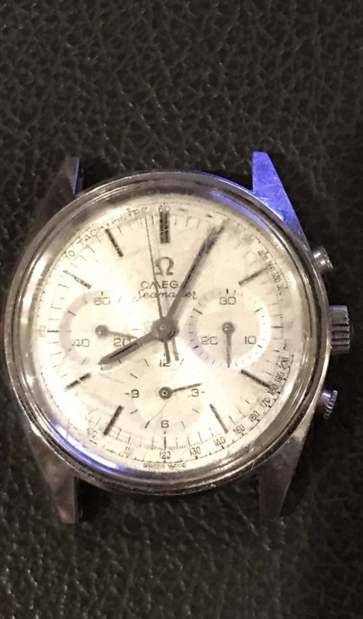

Mine also has Seamaster on the dial, you can find both

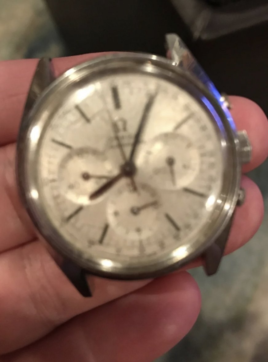

I’m going to pass on it, I’m not in a position right now to take this kind of risk. If someone wants the link, pm me. I’m really interested to see what this really looks like with a new crystal and better photos. Seller wants 1900 usd for it.

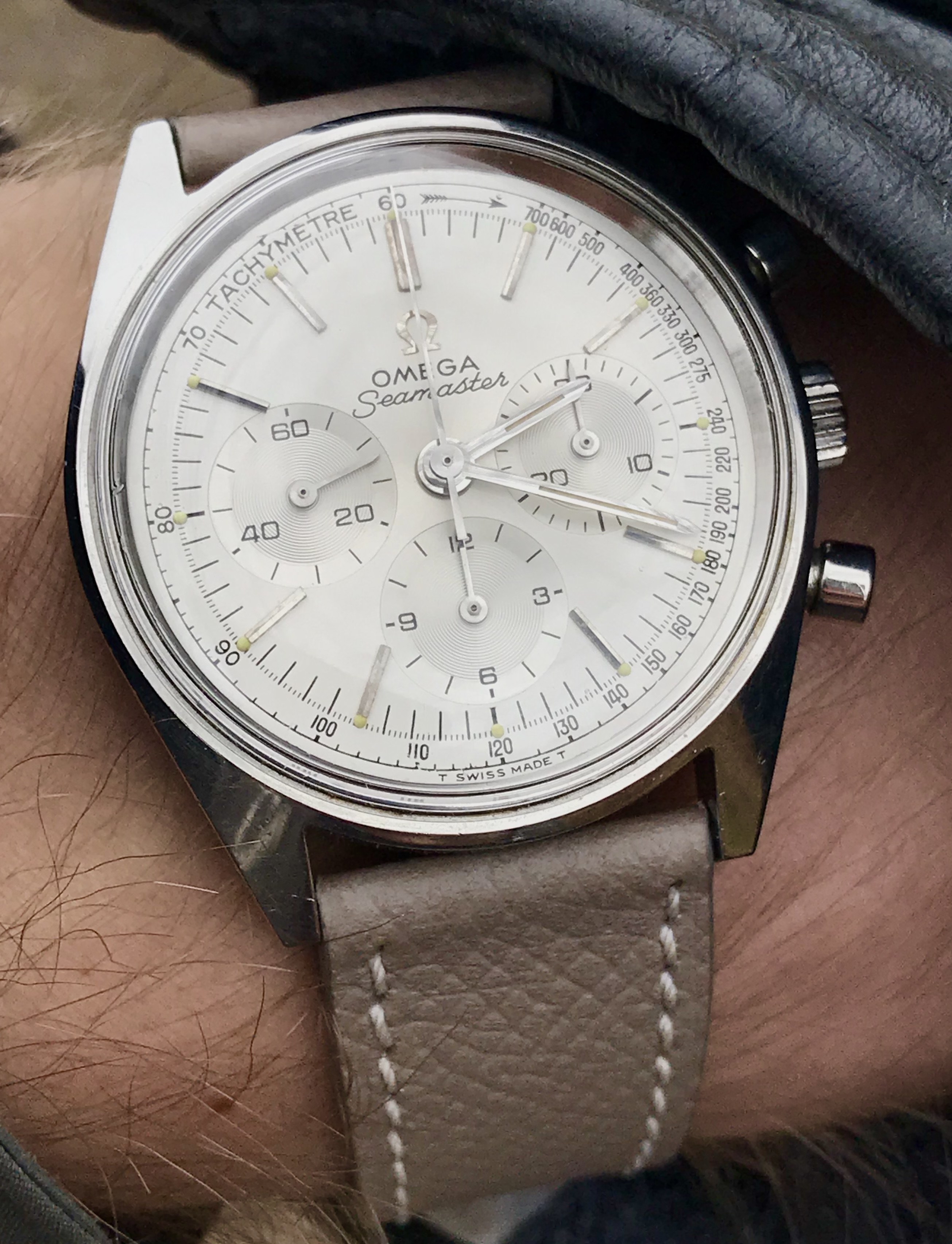

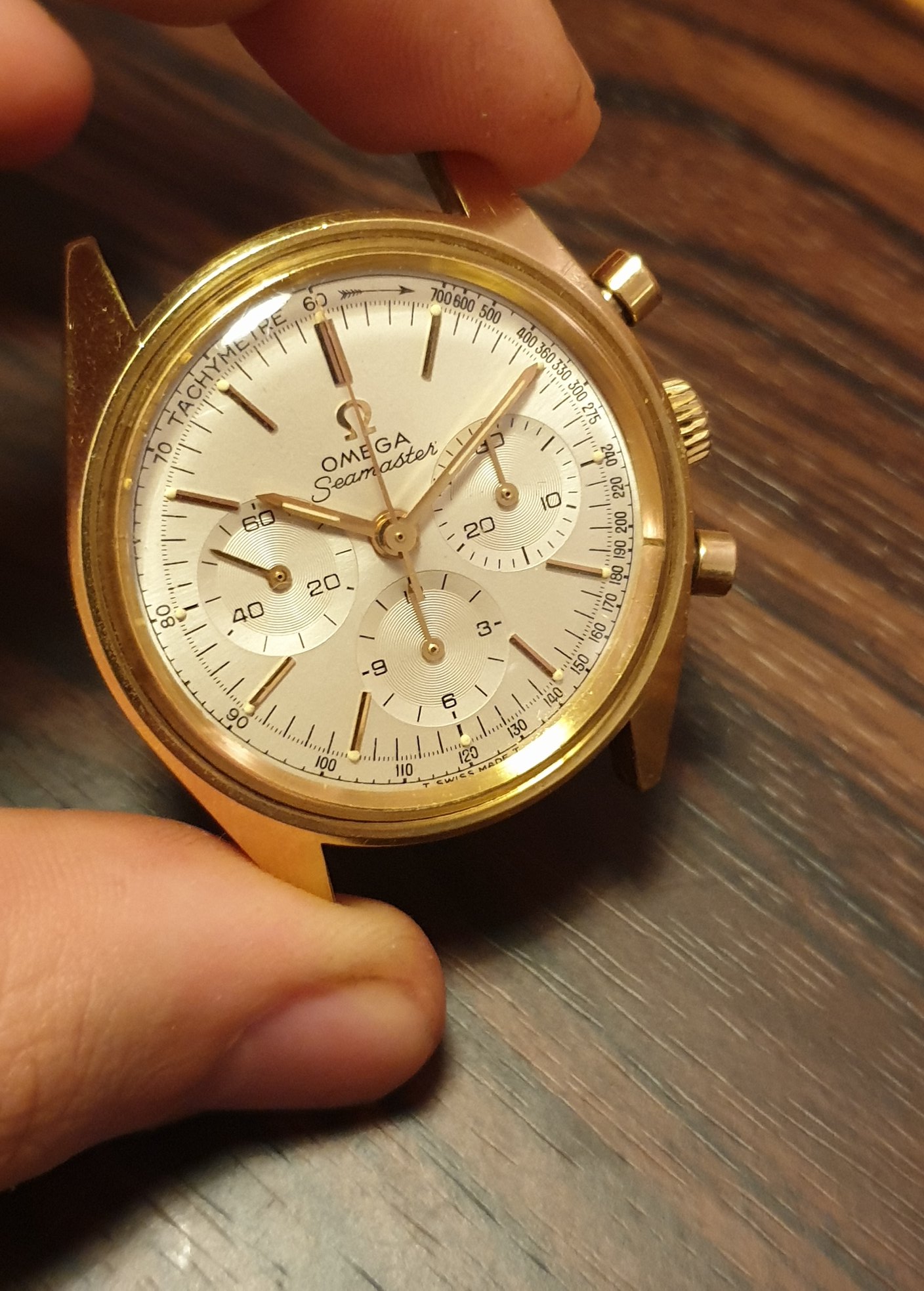

Yep, I think the earliest examples were with "Seamaster" on the dial and then they changed to "De Ville". Heres mine.
