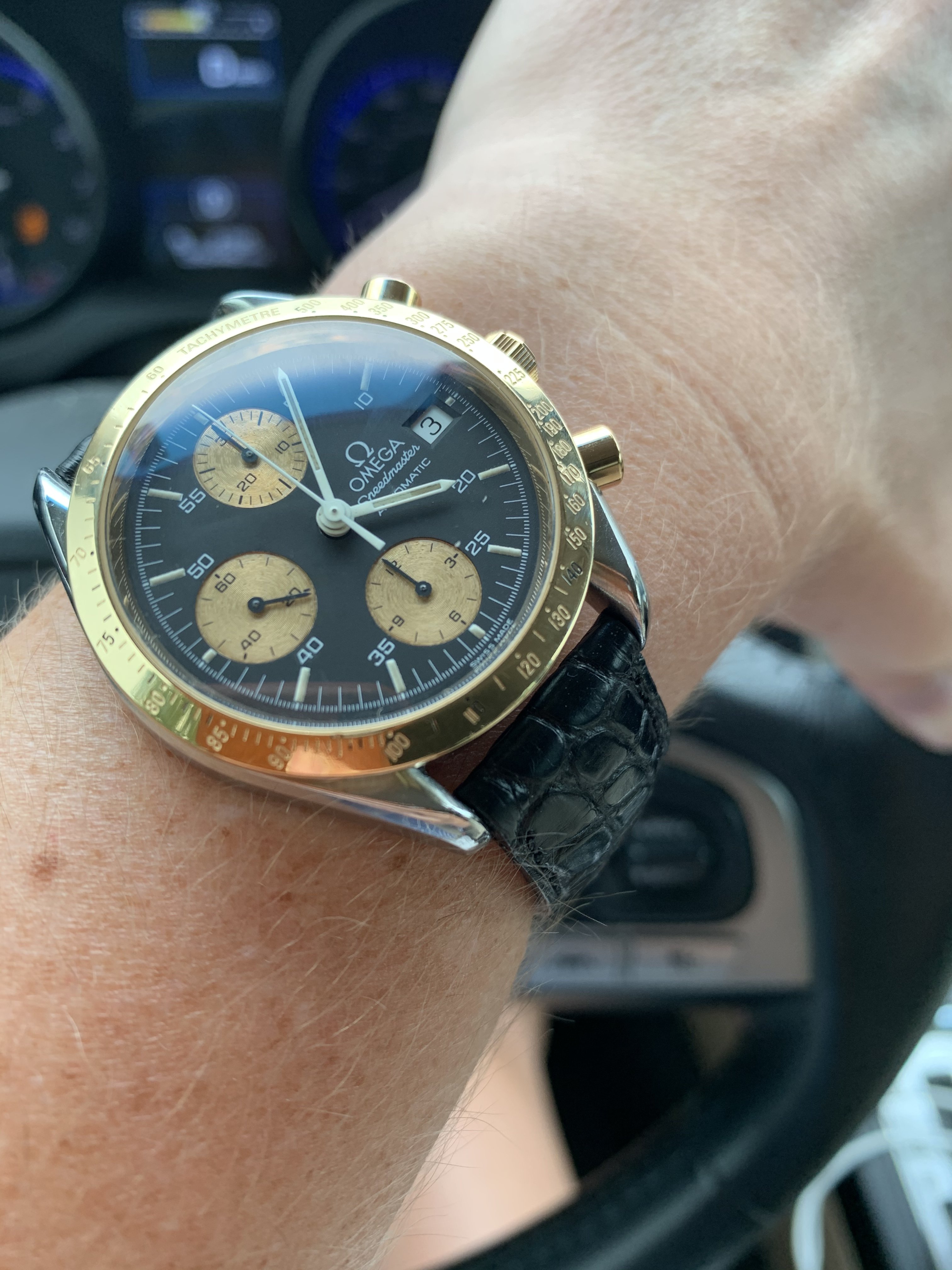

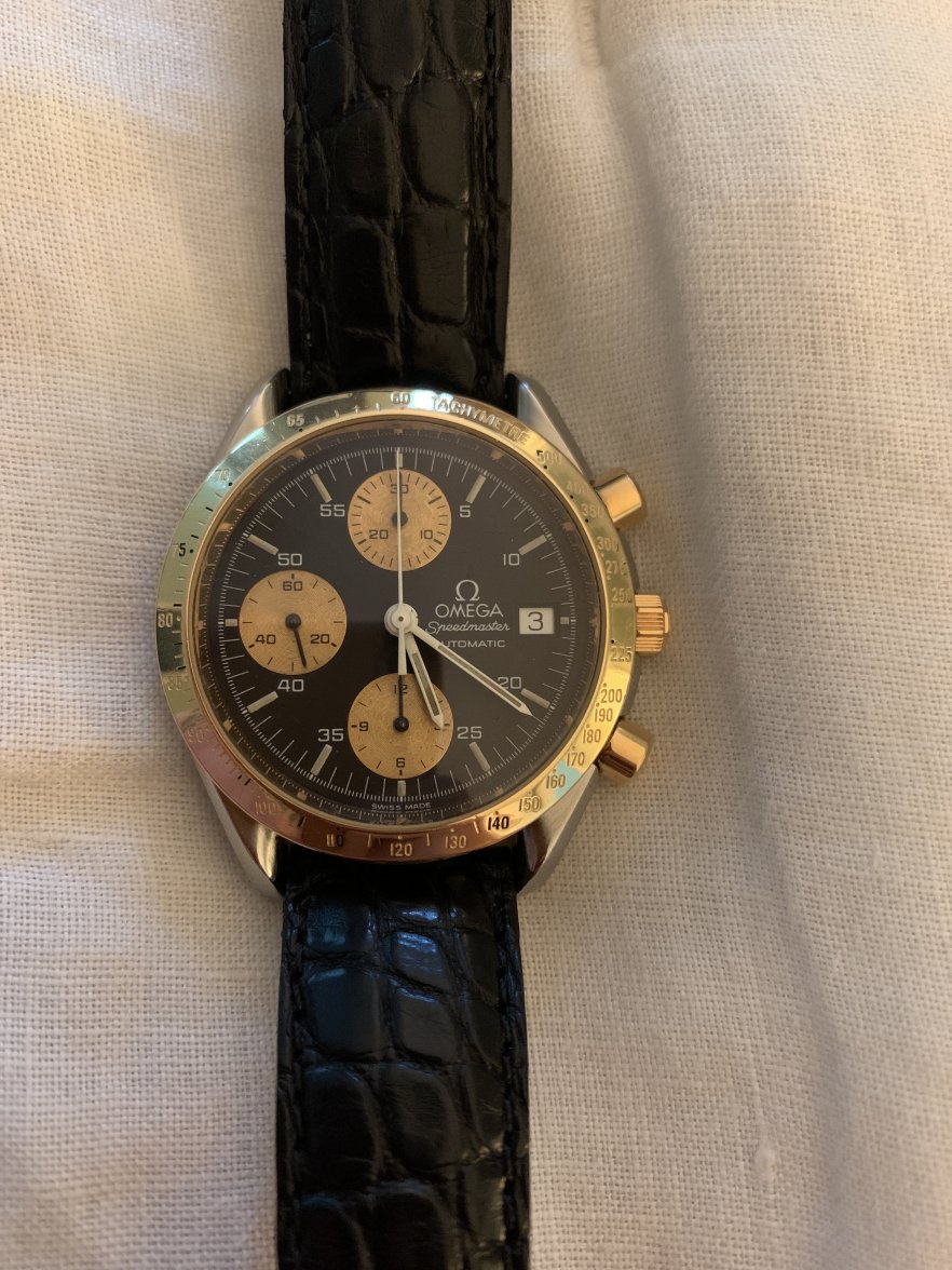

Can anyone help me identify my first omega speedmaster reduced? I’m trying to figure out approximate era and other information. The model is ST 175.0043-1 which I believe makes it around 29 years old? I have been hold with Omega forever and can’t get through. I have had no success looking up the serial number (54149354) though I’m not truly sure how to even go about doing such. I’m a newbie in this arena. Thanks.

Seems you already got it fairly well identified as an older reduced and the serial brings it to around 1993 according to databases online

I don’t think that is technically a Speedmaster Reduced, but is a Speedmaster Date. It doesn’t use the same modular chrono (introduced in the reduced) but a movement based on the Valjoux 7750. A lot of people called them Reduced because the case is about the same size, but your watch has a better movement.

That is clearly a speedmaster date, not a reduced. Different beasts

Well a reduced has a flat bezel, and has sub dials at 3,6,9. It also uses a movement that some people are not fond of. They do not have a date window.
Dates use a variant of the eta 7750 have angled bezels and subdials at 6,9,12 and a date window.
Later dates are normally chronometer grade movements as well.

not a reduced

From my limited knowledge, the typical Speedy Reduced models have a modular movement with the chronograph module sitting atop the watch movement rather than built integrated from the ground up (presumably this makes them slightly thicker than OPs watch). I think that's what Foo2rama is referring to.

That's not the usual convention to my knowledge. As suggested above, the Speedy Reduced name applies to the modular movement with sub-dials at 3, 6, and 9. The OP watch is an example of the Speedy Date.
If you call a Speedy Date a Speedy Reduced, some people will think you don't know what you're talking about, so we are here to help. 😀
