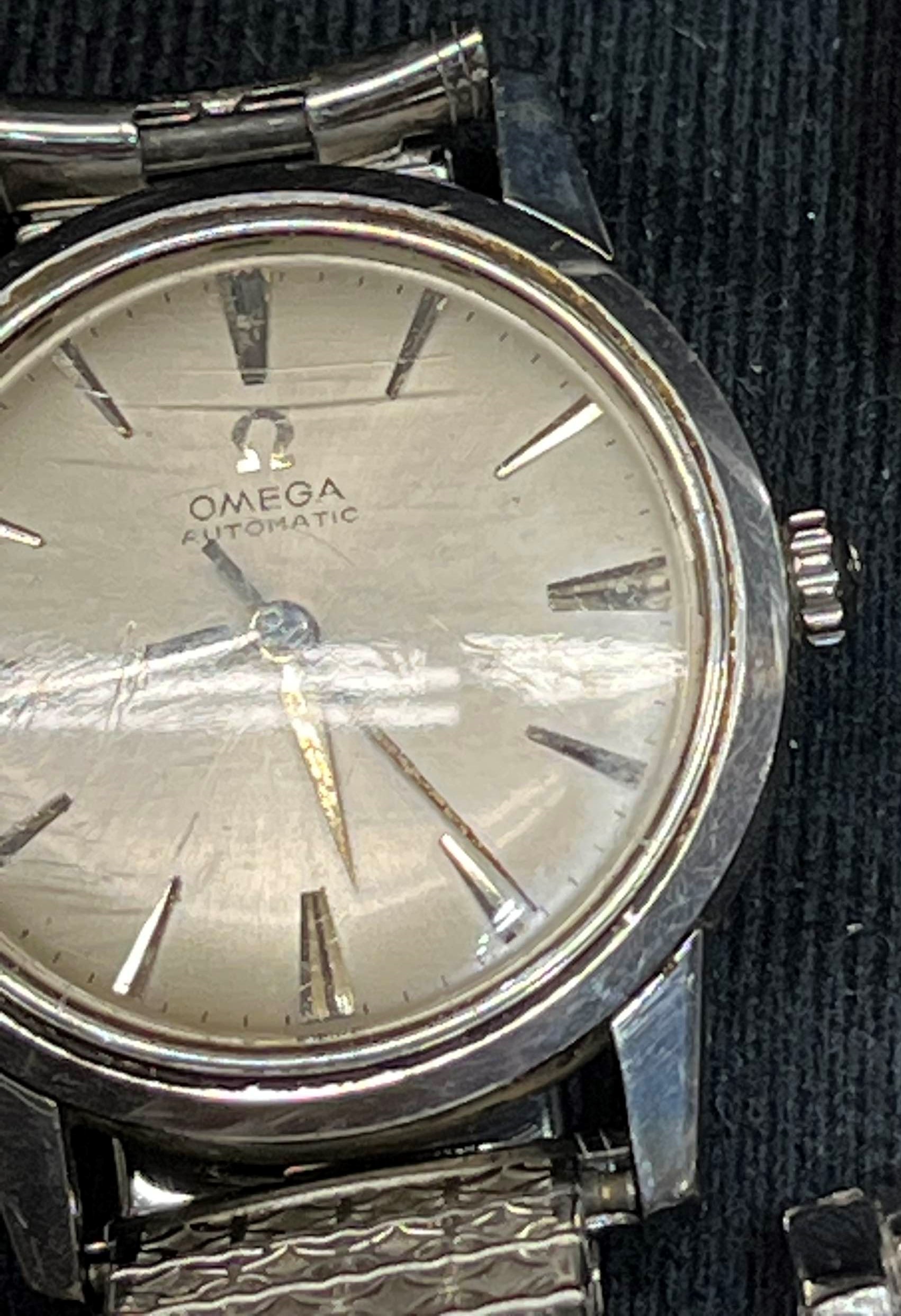

Help identifying this Omega seamasterish early 60s ish?
18
This very much looks to my novice eye like an early 60's seamaster without seamaster logo. Thoughts?

We need more photos to judge the watch. A 1960s Seamaster would be labeled as such on the dial.

This is the only photo I have. It is part of an auction lot and I can't get any more info. I don't think the seller has any clue since it wasn't even mentioned in the description. So, I was just trying to get an idea of its approximate date and whether they made a non-seamaster like this.
Edit. After continuing to search, it appears that omega indeed made seamasters in the late 50s early 60s that did not say seamaster. https://www.ebay.com/itm/RUNNING-Omega-Seamaster-ref-14774-SC-62-circa-1962/254623968712
https://sansomwatches.com/product/omega-seamaster-automatic-14773-sc-1-caliber-470-year-1958/ https://wannabuyawatch.com/product/omega-seamaster-ref-14774-sc-62-circa-1962/
Or at least they are being advertised as seamasters.

I do not know if I remember well but I think some earlier models of Seamaster had written only on the case back the word "Seamaster"

That's correct. Not all 1960s Seamasters have "Seamaster" text on the dial. This is especially true of early 1960s models. There are several OF threads on this. Here's an example - my 1962 Seamaster 14389. Hippocampus engraving and "Seamaster" on the case back, but no Seamaster text on the dial.
