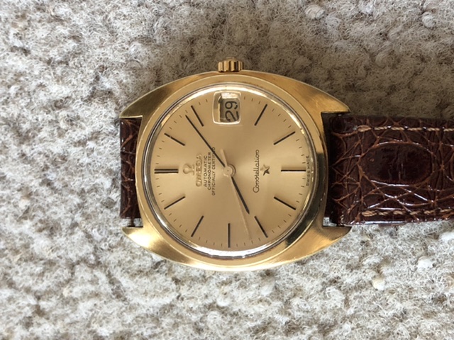

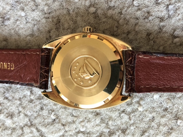

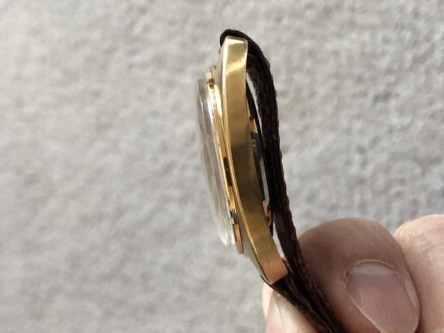

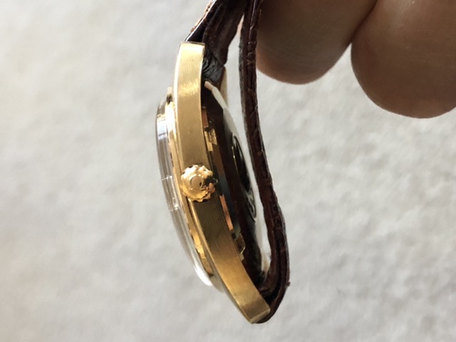

Hi,
I found this watch in father’s belongings after he passed away this year. He told me where to find before he passed but he didn’t get to share any details of its history. Since I don’t know have any experience with vintage watches, I was hoping someone here can help me identify this watch.
I believe that my father acquired this watch somewhere in Asia, most likely Hong Kong or Japan. I don’t think my father wore it much if at all. He was a frugal man and probably wouldn’t want anyone to know he had something like this.
I haven’t opened it since I don’t have the proper tools for this. I tried doing some research online but it doesn’t line up with anything I’ve seen.
I’m interested in which Constellation it is, whether it’s authentic, whether it’s been modified, and it’s value. I don’t plan to sell it but I would like to know whether I should take it to an AD to service it or to a vintage omega expert.
Here are some photos of the watch:

Condolences on your loss. You were left a very fine legacy watch.
This looks like a 18K gold version of the Ref. 168.009:
https://www.omegawatches.com/en-us/watch-omega-constellation-c-st-168-0009-168-0017?ab=1
It is possible that this is the deluxe version with a solid gold dial. I cannot tell from the photos provided.
These are fairly common and sell on eBay all the time. You can check the "completed auctions" section.
However, your looks to be in totally original condition. Much better than most you will see online.

Gatorcpa - Thank you for responding. I found the watch wrapped in plastic. Sadly, it probably is in its original condition. I wish he had worn it and shared the story of the watch. I don’t have any connection to the watch other than it was my fathers.
I wasn’t sure if it was that particular reference because the dial, hands and crystal didn’t match your link. However, I just found a listing on eBay of the exact same watch.
How can you tell if it is the deluxe version with solid gold dial?

The only way to know for sure would be to have a watchmaker perform a full disassembly and movement service. There would be an 18K gold hallmark on the back side of the dial. You can see pictures of a similar dial here:
https://omegaforums.net/threads/ome...-excited-on-this-one.24423/page-3#post-271223
Most people would recommend a full and complete service anyway, as it seems the watch has not been worn for many years.

If you are thinking of selling it, I'd suggest not getting the full service - disclose that it has not been serviced, and the buyer will allow for the expense and they can be sure it's getting serviced at a watchmaker they trust. However, you will want a watchmaker to open the back and take pictures of the movement (showing the caliber and serial number, and condition), and the inside of the caseback (for the reference number and hallmark).
If you're keeping it, get the same pictures to document the watch, but you can get the service at the same time. Don't take it to an Omega boutique or mail it to their service center - what you want is an independent watchmaker with an Omega parts account and experience with vintage watches. Tell and write "no polish" on the work order, even though your watch doesn't look like it needs it.

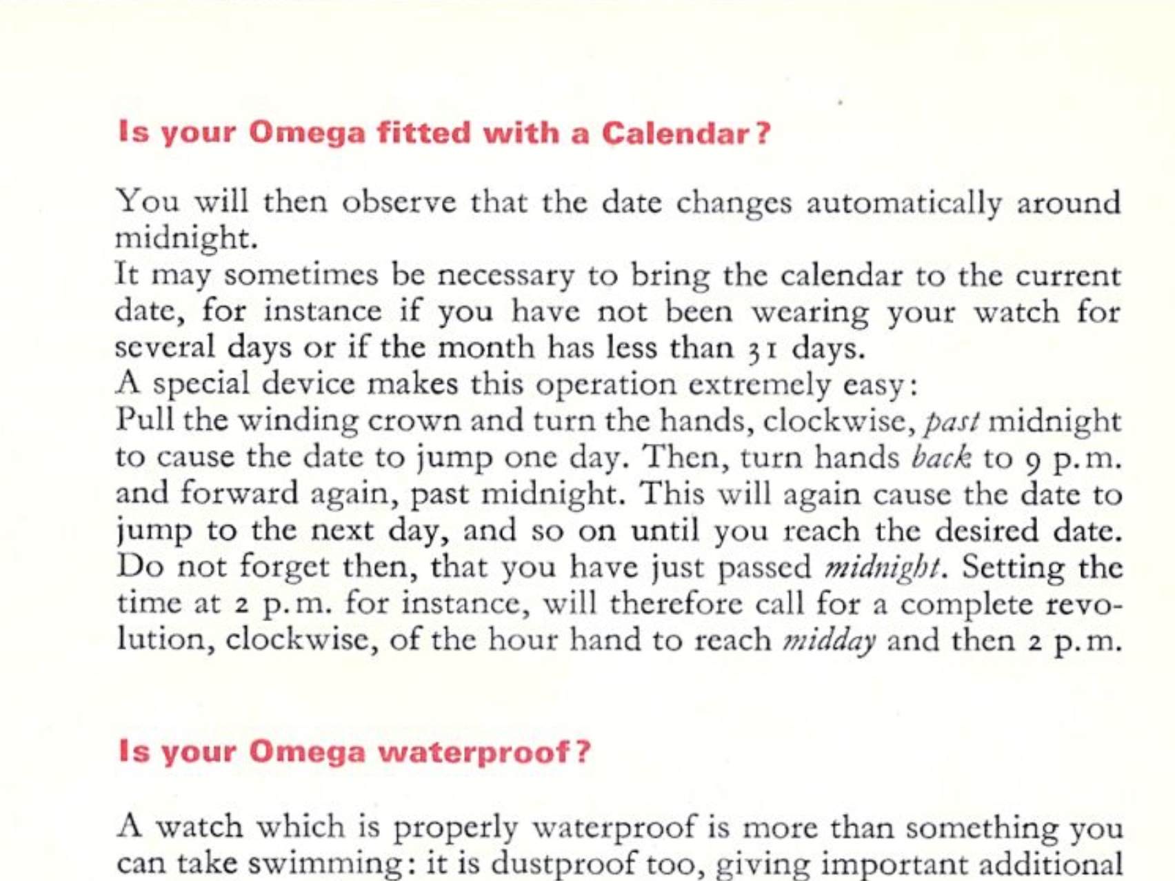

Finally, I have some questions on how to use the watch. The watch didn’t come with box and papers. How many turns does it take to fully wind the watch? How do you set the date? It doesn’t seem to have a quickset date function. Does that mean I have to turn the crown till I get to the desired date? Can I turn the crown backwards? Given the age of the watch I don’t want to damage the movement.

Unless the quickset function is broken it sounds like you have a calibre 561 movement. In which case you need to pull out and wind the crown to change the date. There is a semi-quickset method explained here in this extract from the Omega manual (page 7).
http://www.old-omegas.com/youandyouromega66.html
As above I would recommend a service as the oils will have dried up by now.

There are different quickset mechnisms, and there are also watches with no quickset mechanism. It's hard to say without knowing the caliber, which you'll find when the watchmaker opens the case. When you get it serviced, ask the watchmaker.
