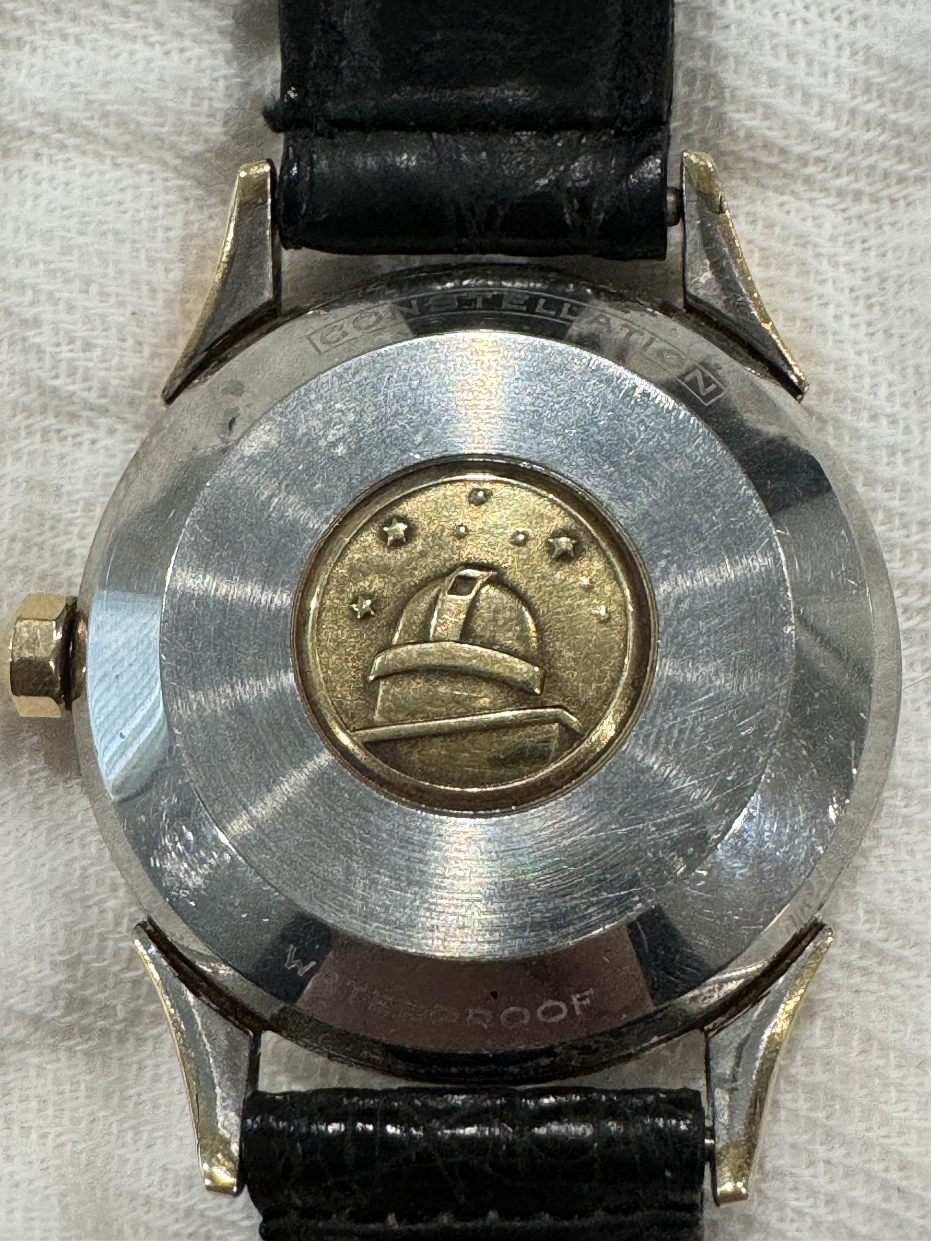

Hi All!
I'm fairly new to this, so please forgive my lack of vintage Omega knowledge.
I've recently inherited an Omega Constellation that my grandfather purchased while stationed in Germany in the early/mid-1950s. This watch is fairly worn but works perfectly fine - from what I've been told, it has never had maintenance or repairs. Given its history (and inherent beauty) I don't intend on selling it (and would prefer not to open it up, unless maintenance becomes necessary).
I've been attempting to uncover the history of this piece (while also trying to avoid having an Omega Boutique open it up to confirm reference and serial #s). Unfortunately, across all my internet research, I've not yet found a watch that looks exactly the same as this one - perhaps that could mean that it doesn't actually have all original parts?
Would love to see if those in this forum could help to identify this watch and/or share any particular details about it (reference #, is it indeed a "pie-pan", is the gold capping on the steel case real gold, etc.). Additionally, given that I intend to wear (not sell) this piece, I'm curious of whether you'd recommend that I get it serviced to help ensure that it survives another 70+ years.
Thank you!
8,186
36,751
I'd think that it's a gold cap 2852 with a domed waffle dial. A nice combination indeed, probably with a serial number somewhere around the 15 million range. The condition is good, obviously needs a good wipe down and more than likely a service of the movement.

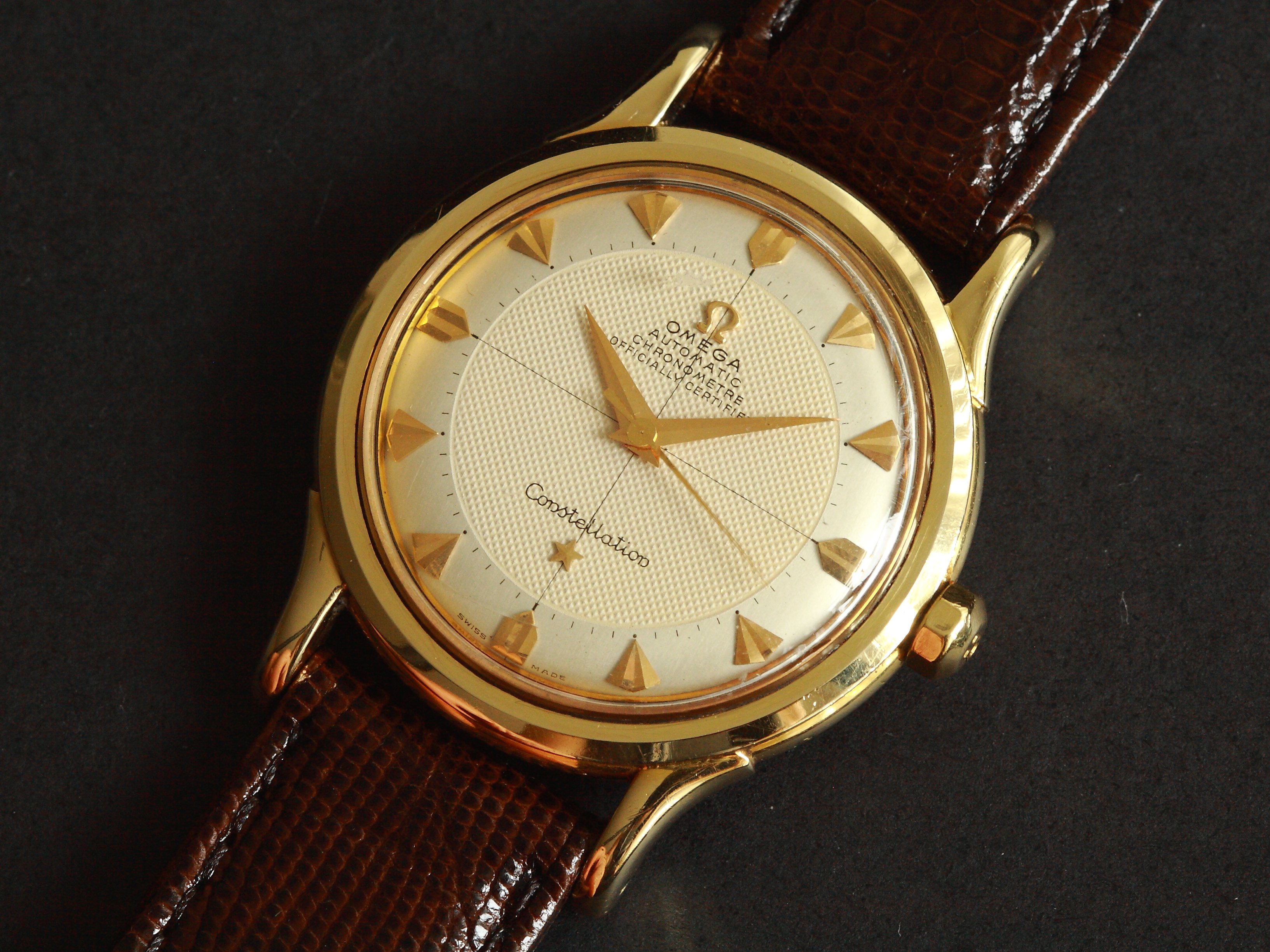

I have a very similar dial on a 2652

If it truly hasn't been serviced during its 70 year lifespan, the first thing that you need to do is stop wearing it, stop winding it, and get it serviced. The reason for this is that the lubricants in the movement dried out decades ago and what you have now is a watch movement that is akin to operating a car's engine without oil! You need to find an Omega trained and certified independent watchmaker who has an Omega parts account and have him or her perform a full sympathetic service on the watch. That means that the watchmaker will fully disassemble the watch case and the movement, ultrasonically clean the case, clean and examine each of the movement parts and replace those parts that are worn, reassemble and lubricate the movement and then put the watch back together. The watchmaker will also regulate the timing of the watch and pressure test it for water resistance. Have the watchmaker evaluate the condition of the crystal. If it's in decent condition, all of the scratches can be polished out. If not, it can be replaced with a new crystal. A couple DON'TS: don't have the case polished and don't send the watch to Omega for servicing. This watch is a real heirloom and should clean up beautifully. As others have noted, it's probably a reference 2852, but the reference number of the watch will be on the inside of the case back and the serial number will be on the movement. If you can tell us where you're located, we may be able to recommend an independent watchmaker for you.
