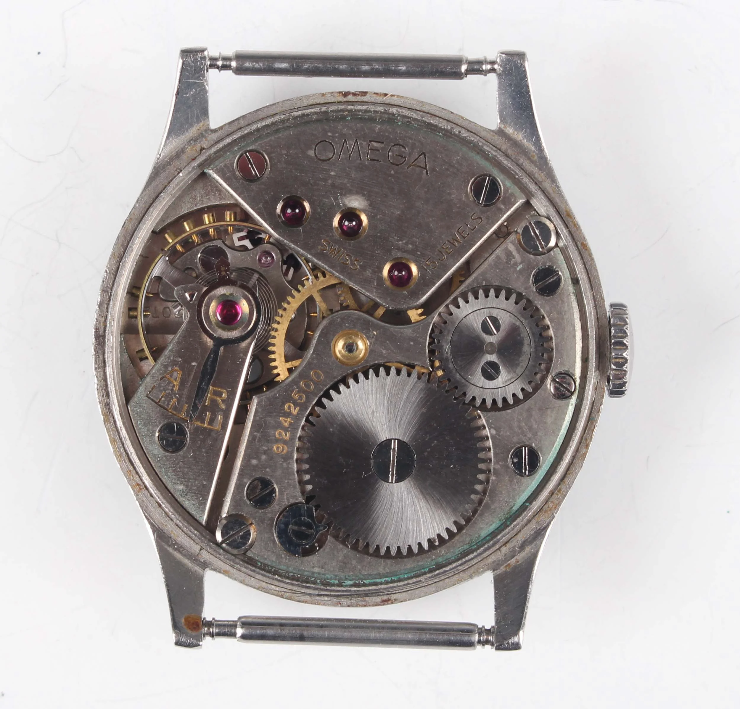

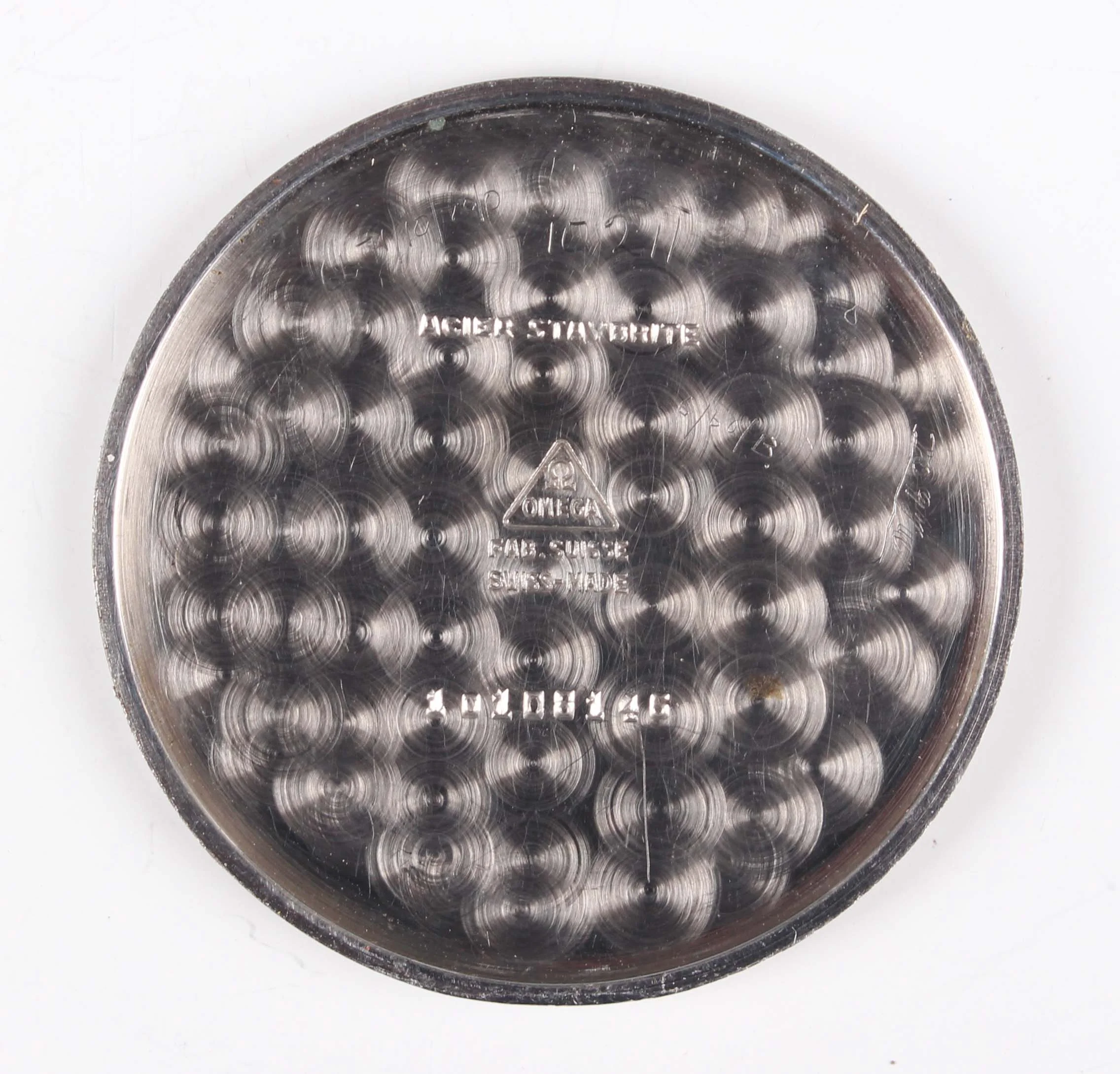

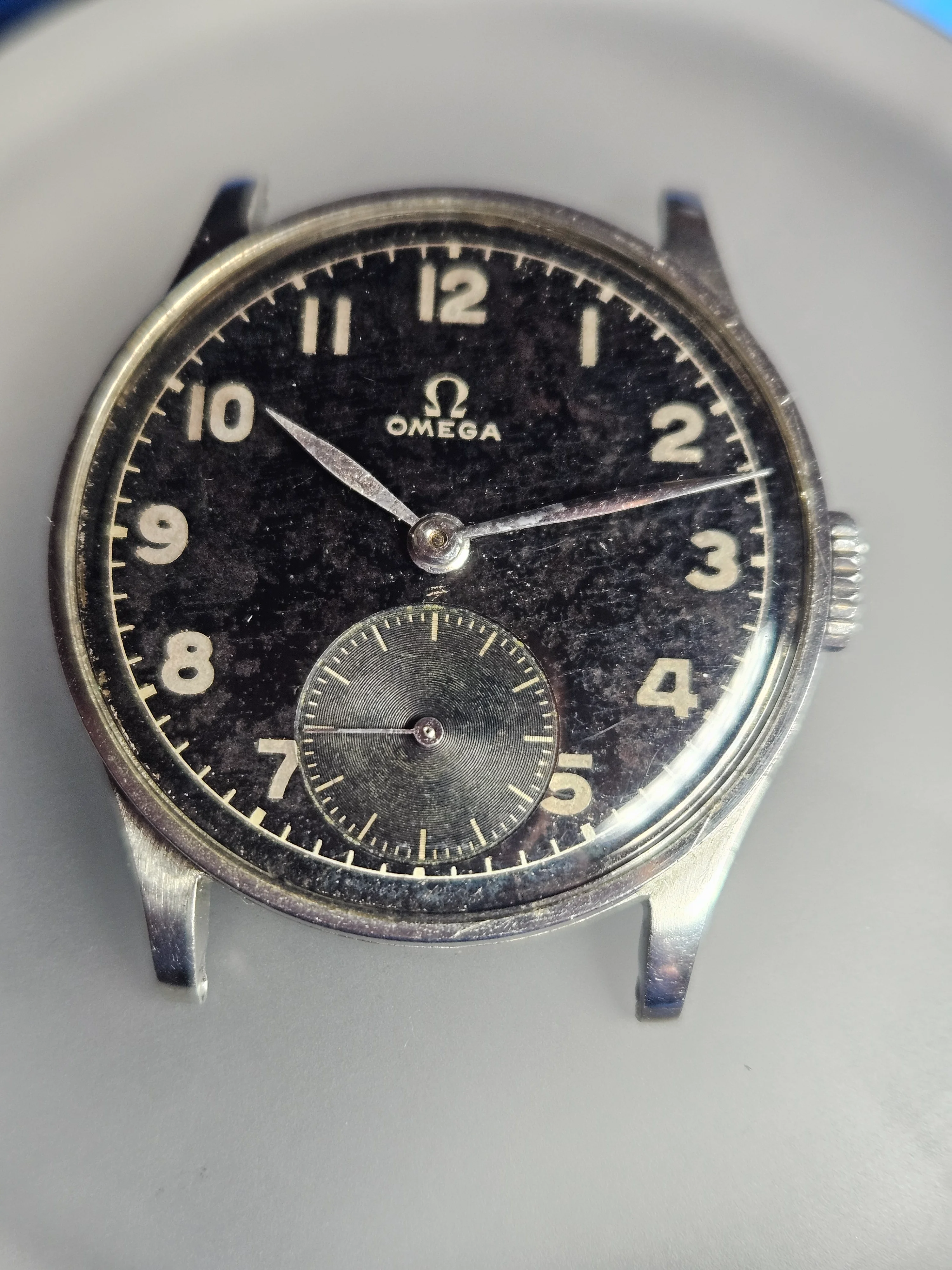

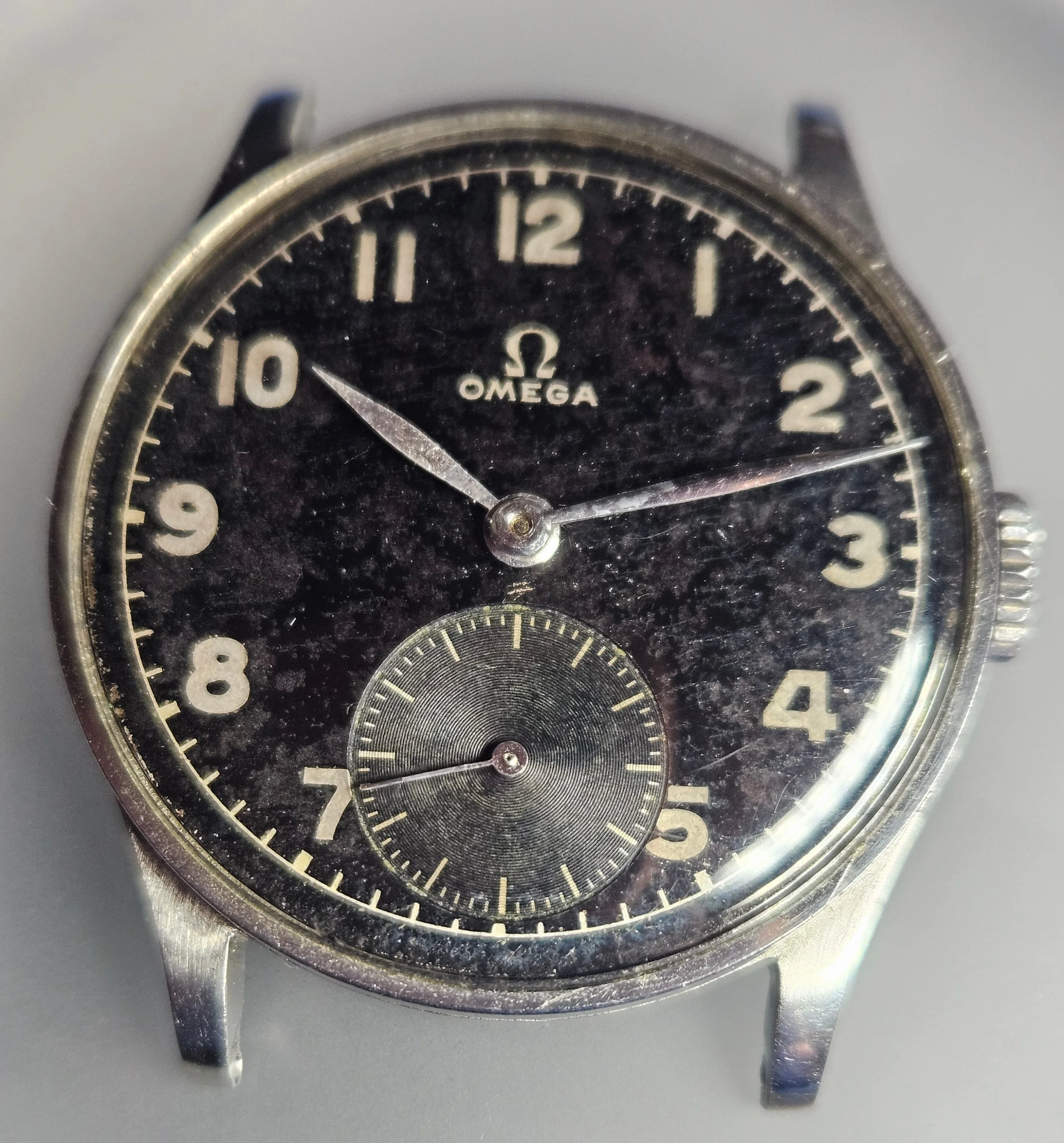

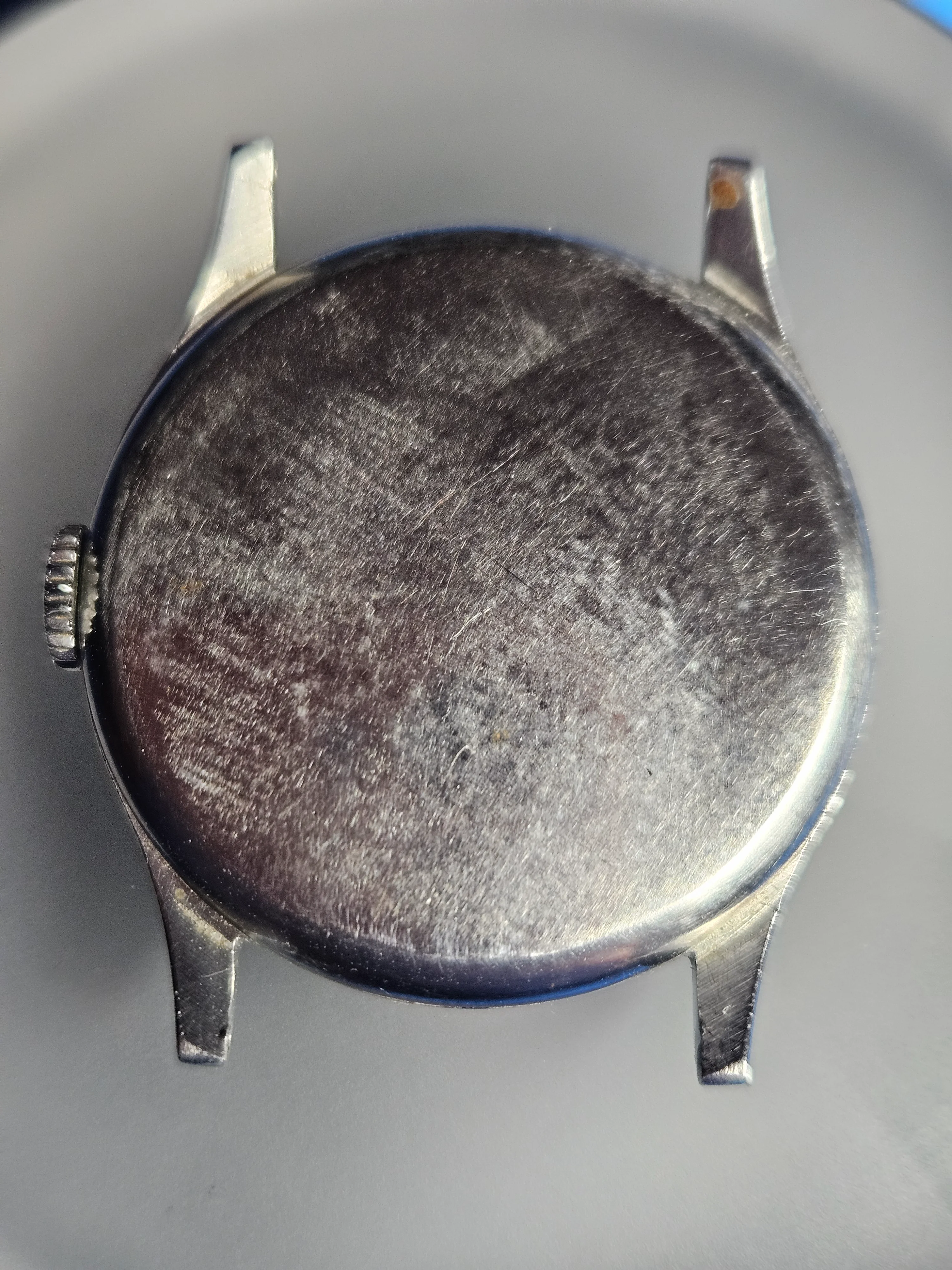

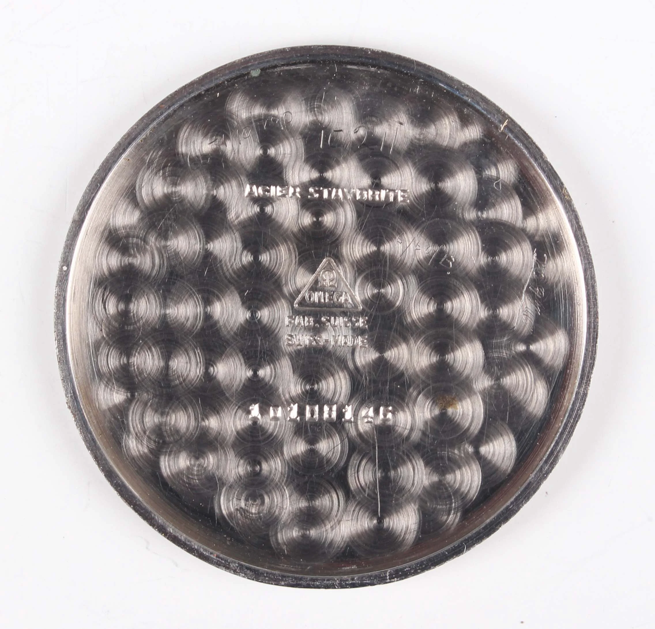

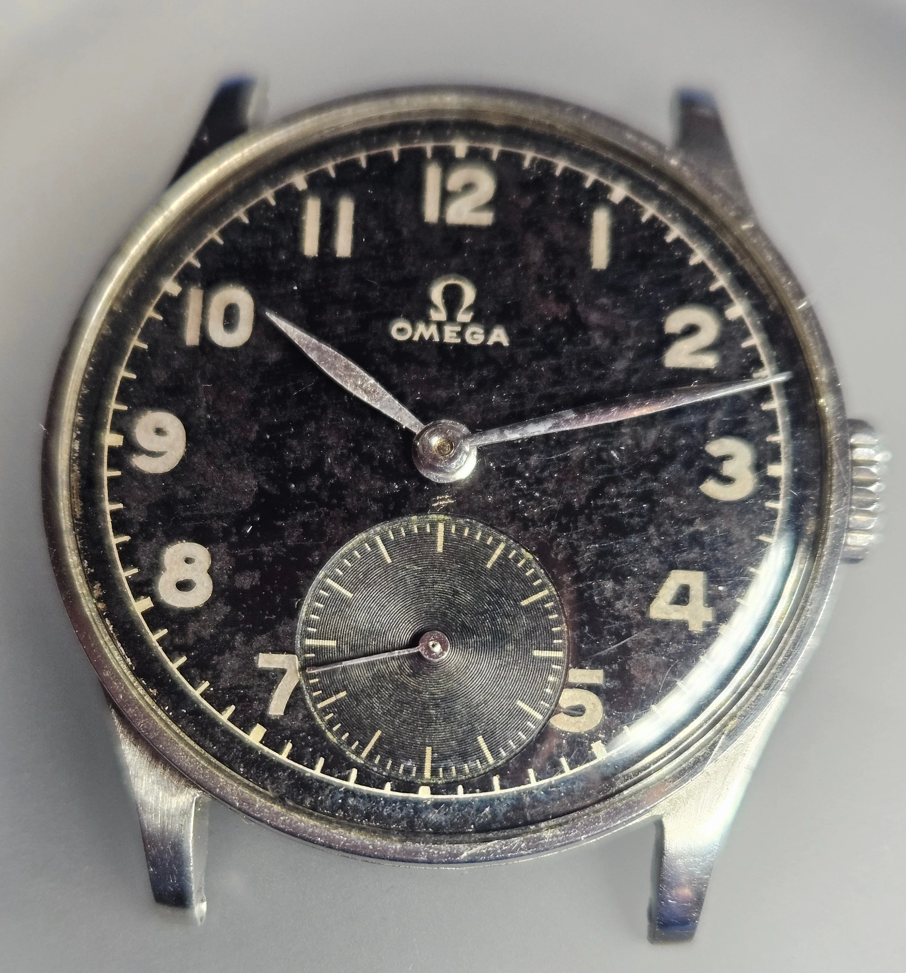

Hi can anyone give me any more info on this 1944 omega, maybeva military watch or military style. The case back number is odd and I cant find any others out there with this serial number. Some photos attached. Inside of casevavk is numbered 10108146.
Any help is much appreciated.

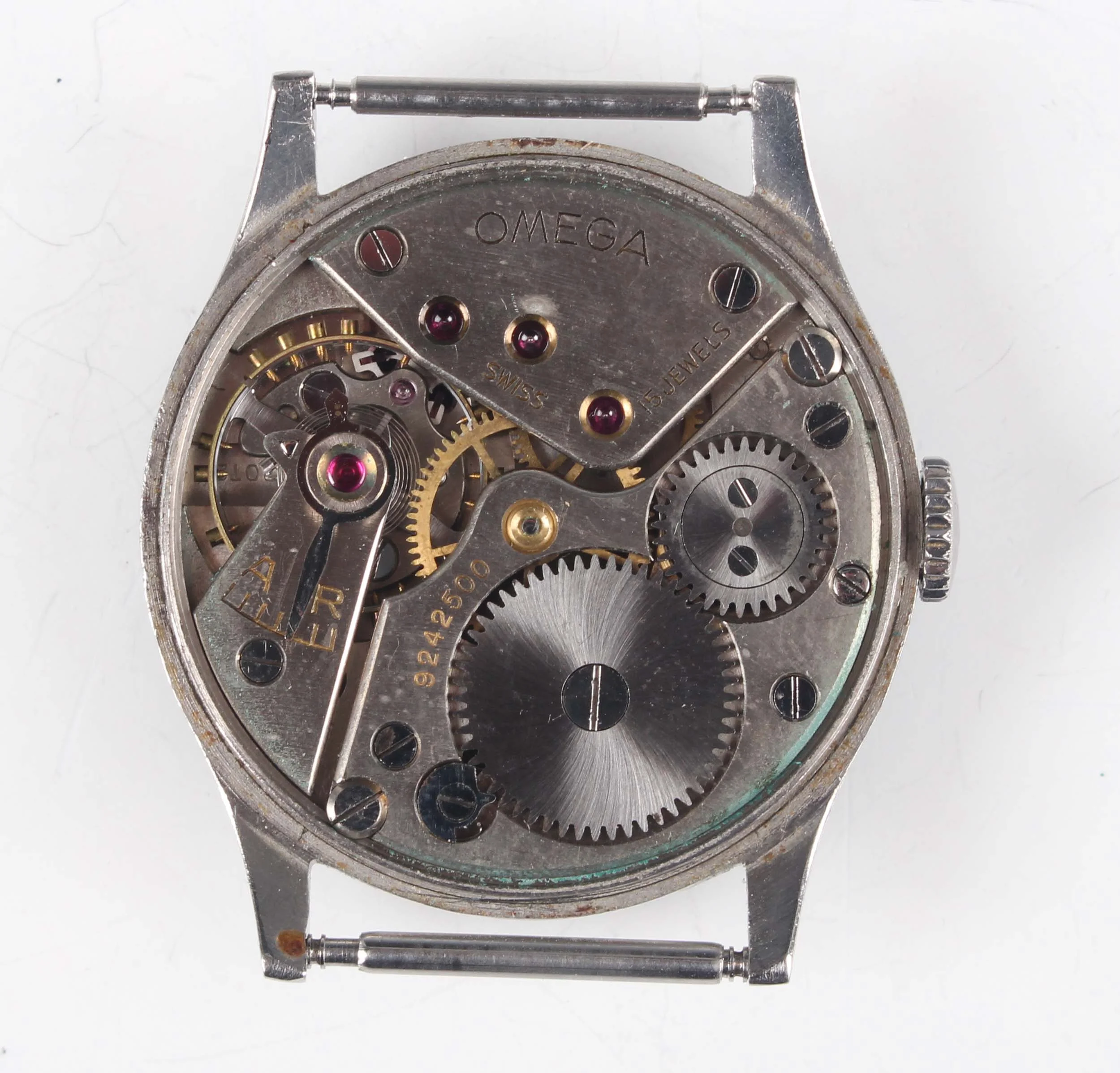

Serial numbers are unique, so you won't find another with the same number. It may not have a particular reference number. The moment serial number puts it at 1940. Gent's watch with cal 30T2 movement.
3,790
6,452
Serial is 9.2 mil. That is in the range of a 30T1

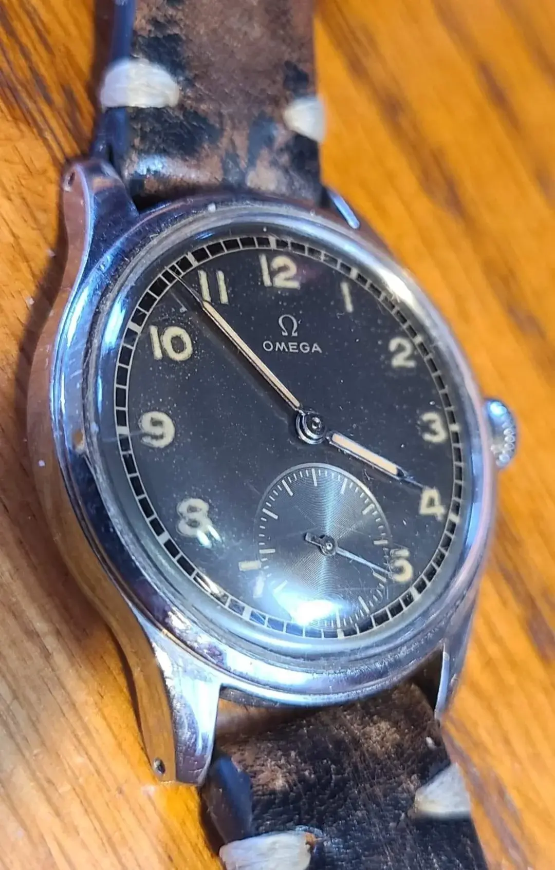

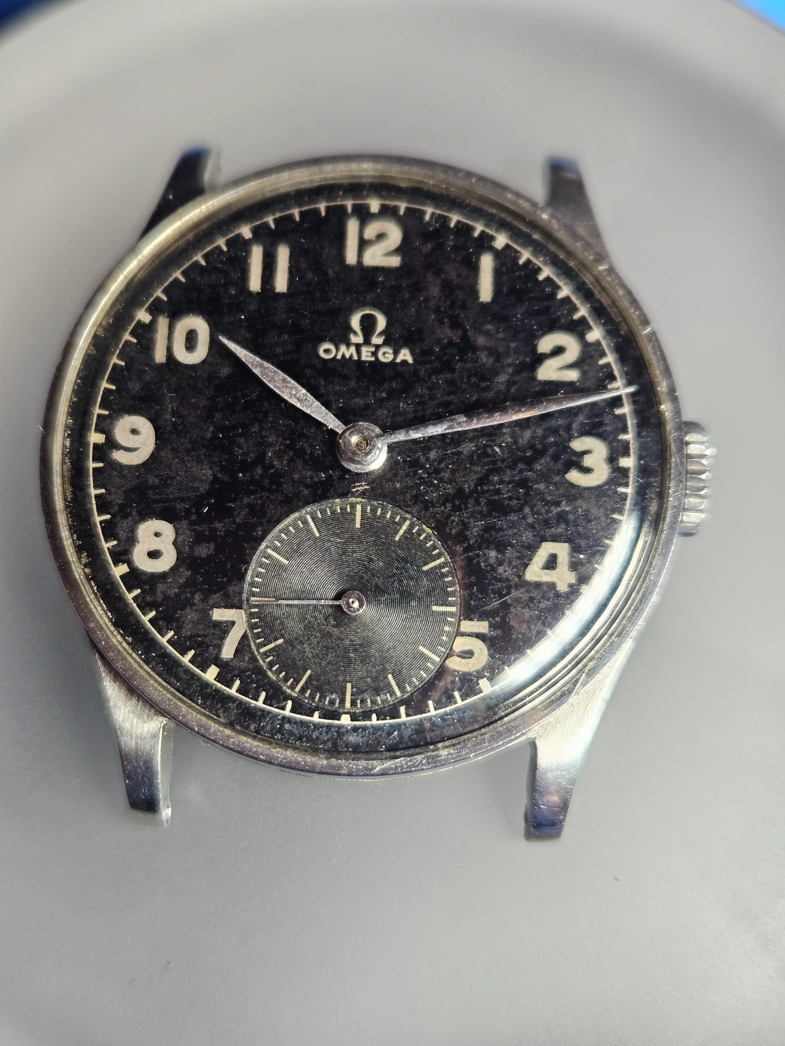

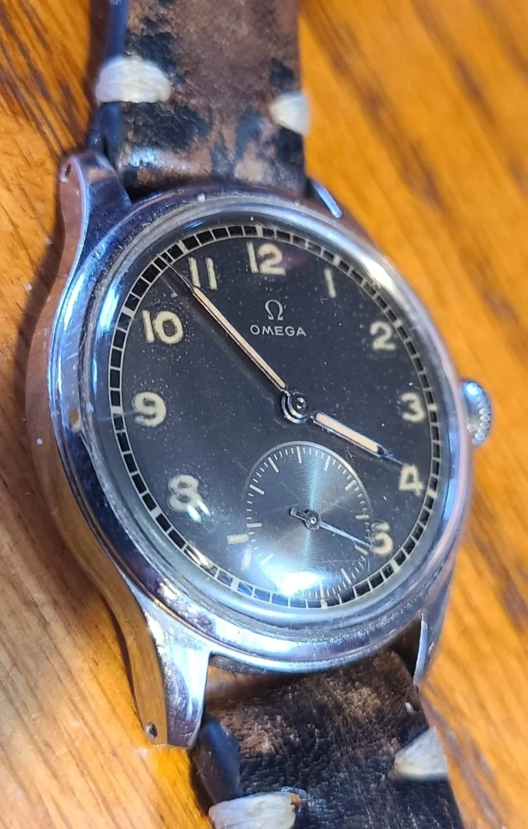

I also think the hands are wrong. They should have lume on them to go with hour makers.
Something like this
So do you think the movement has a mixture of parts? 30T2 is visible under the balance. And at first glance, the movement looks consistent in appearance.

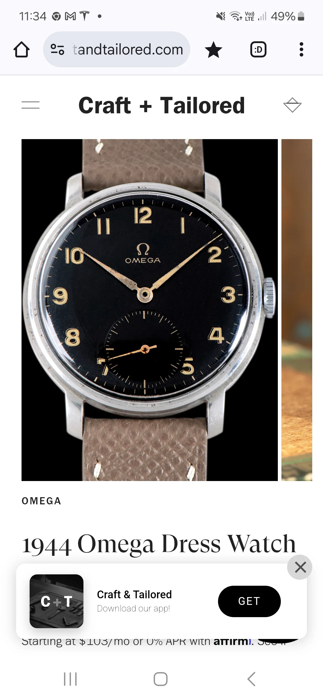

Found this one on ebay right now. Very similar shape and the same movement year etc, hands are even thinner with no lume.
https://www.ebay.co.uk/itm/20514199...UoC-cPkTyW&var=&widget_ver=artemis&media=COPY

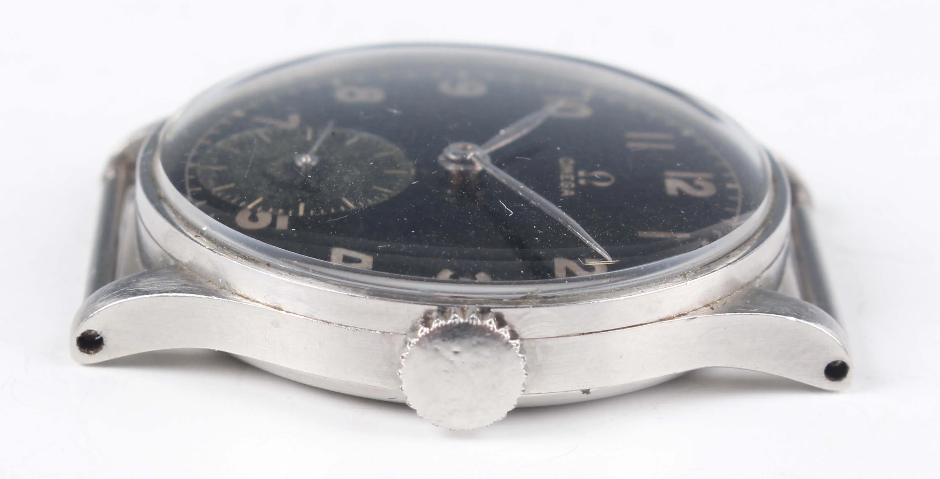

That watch is completely different, no similarity at all. Just look at the lugs. In any case, when there is luminous paint on the dial, you can be 100% sure that the hands should also have luminous paint. So that eBay watch clearly has the wrong hands.
All T1's I have are in 9.2 mil.
This one may be an exception.
You can see the hour markers but cannot see the hands in the dark, how can you tell time?
I wouldn't be surprised if there was some overlap in 30T1 and 30T2 serial numbers.
Well its hardly completely different, the lugs are slight different,.
24,843
55,270
Good, you can see the difference. It is a different reference altogether, unrelated to the OP watch. And the hands are not original. So the point is that it doesn't provide any relevant information about the OP watch.

IMO the font is thick
This is because the dial is 2 layers galvanical execution - some call it "gilt" which is a bit misleading as there is not any gold colour - I call it "galvanic sandwich" instead.
On these dials the "print" always looks a bit wider or less defined/sharp

IMO the serial number is perfectly fine for an early T2 as its 9.24xxxx
Most T1 I have encountered are 9.1xxxxx
Even my SC T1 are in lower serial numbers in the range of 9.18.... or 9.19.....
