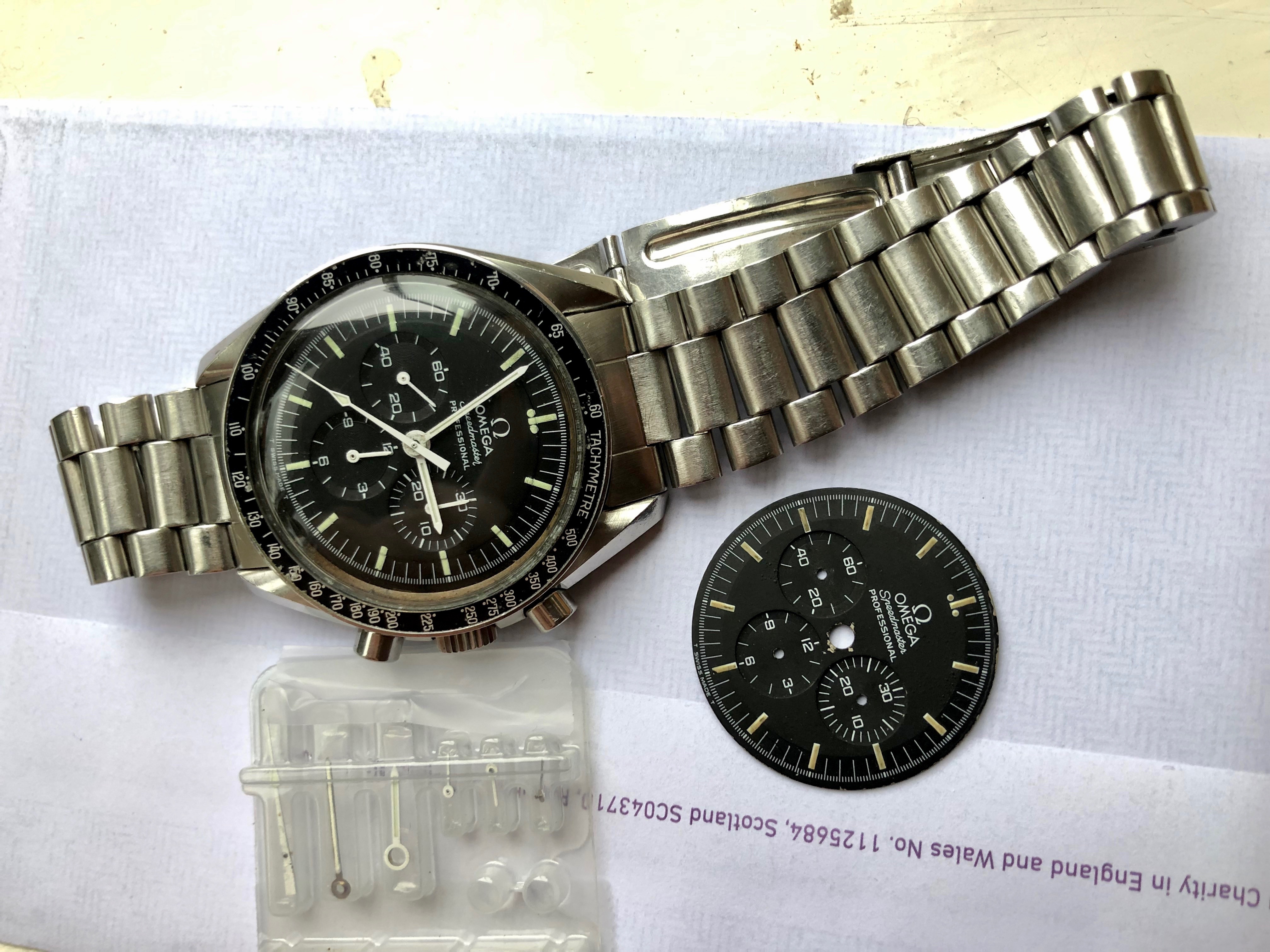

Update: it's on the bench. The movement is dirty and dry so it wanted a service anyway. There is an issue with the lower balance staff jewel bearing; apparently an easy job. Not quite so easy is the dial: it has no feet and was glued on. In all all fairness the seller warned me that it had come into his possession sans feet and his watchmaker had "fixed" it but it was someone he doesn't use any more after a couple of botches and bodges. Therefore he, the seller, couldn't vouch for how well (or badly) it had been done. 10/10 for full disclosure. (He was very open and honest about the condition of the watch.)
Anyway, my watchmaker is thinking of using double sided tape to secure it but is concerned about the clearance of one of the chrono sub-register hands (the hour one, I think). So ideally I want a 145.022 861 Tritium dial. But hopefully the temporary and somewhat suboptimal solution will hold it well enough until one turns up. Any idea how easy it will be to find one? And what I'd be likely to pay? I'd prefer "vanilla" to "mint" on the lume. If it's too much money I'll just live with the tape; at least I'll know it there and there's more no nasty surprises down the line.

Surprised your watchmaker doesn’t have a baggie of these
https://www.jewelerssupplies.com/dial-dots-910.041.html

I think that's what he has in mind; he called them sticky pads iirc
Yeah, properly applied, they shouldn’t cause a clearance issue (although I have no experience with them on a Chronograph) and don’t permanently mount the dial to the movement like glue, so can be easily removed for service. They are just tacky enough to hold the dial in place once reassembled (pressure sandwich) so it won’t shift

I found a step dial (is that the right term?) from (I think) 1970. Anyway it’s off a cal. 861 so it should fit. Makes the watch something of a bitsa or franken but should look good once it’s been fitted. It cost me £5 so nothing lost. The postage to my watchmaker was more.

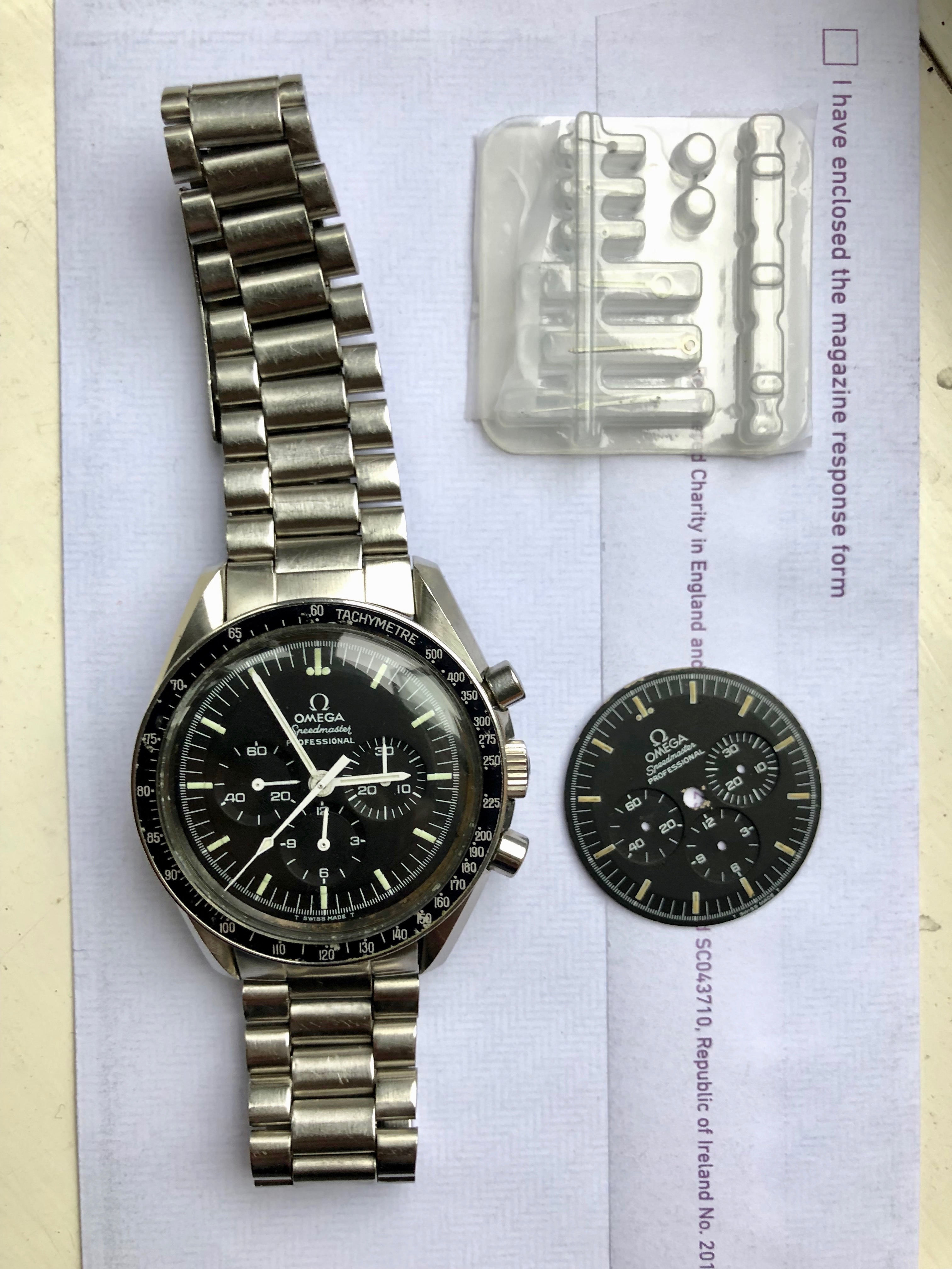

And she's back!
Looking pretty good, I think. Yes, I know that's an early '70s step dial on an early '80s watch but they're both 145.002 and it was all I could get.

And she's back!

And she's back!
Thanks again for your kind and encouraging words!
I can’t get my watchmaker to return my calls in under a week, let alone turn a watch around!! Way to go!
I would say the step dial is a significant upgrade even if it does fall into the bitsa catagory. But with the original along for the ride if you ever do sell it, that won’t be an issue.

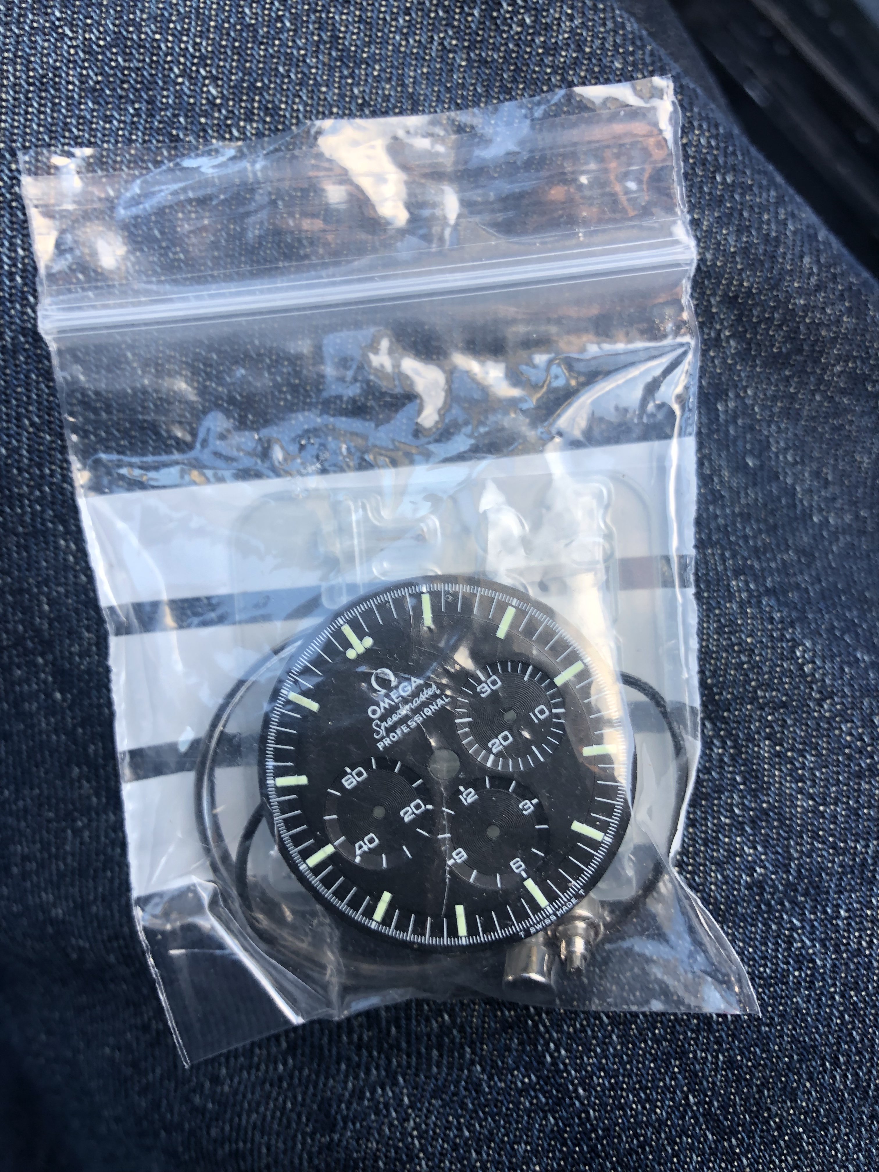

Enjoy! 👍
But go put this loose dial alone in a small container in a dry place without putting your fingers on it, please 😉
Done! Might be worth getting it fixed properly with new feet. Not an easy job I think, though.
