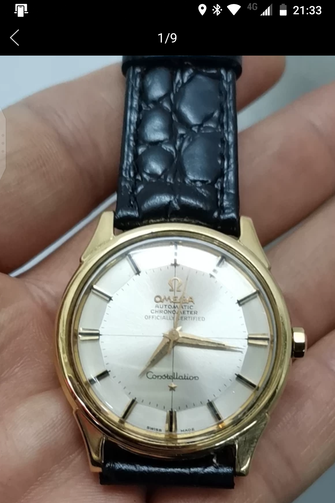

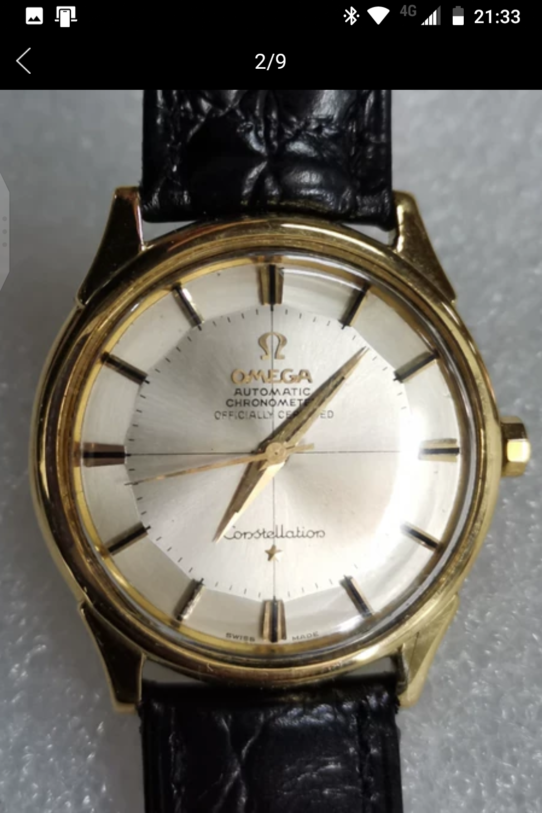

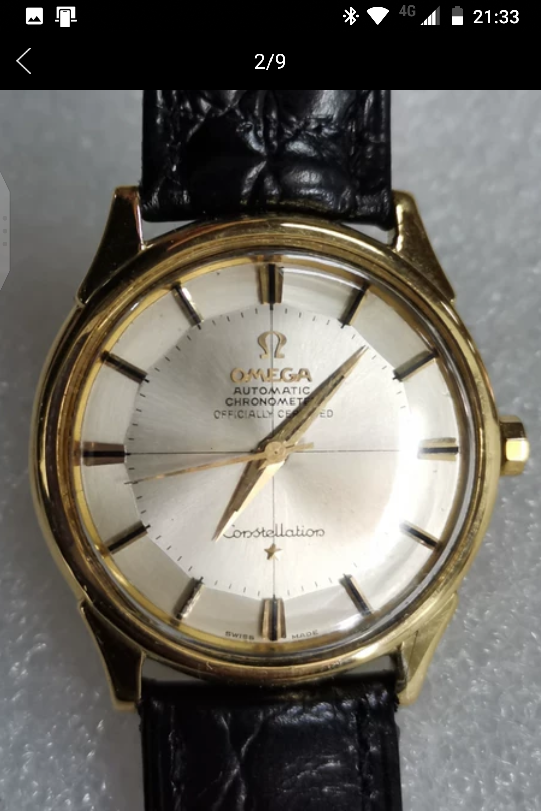

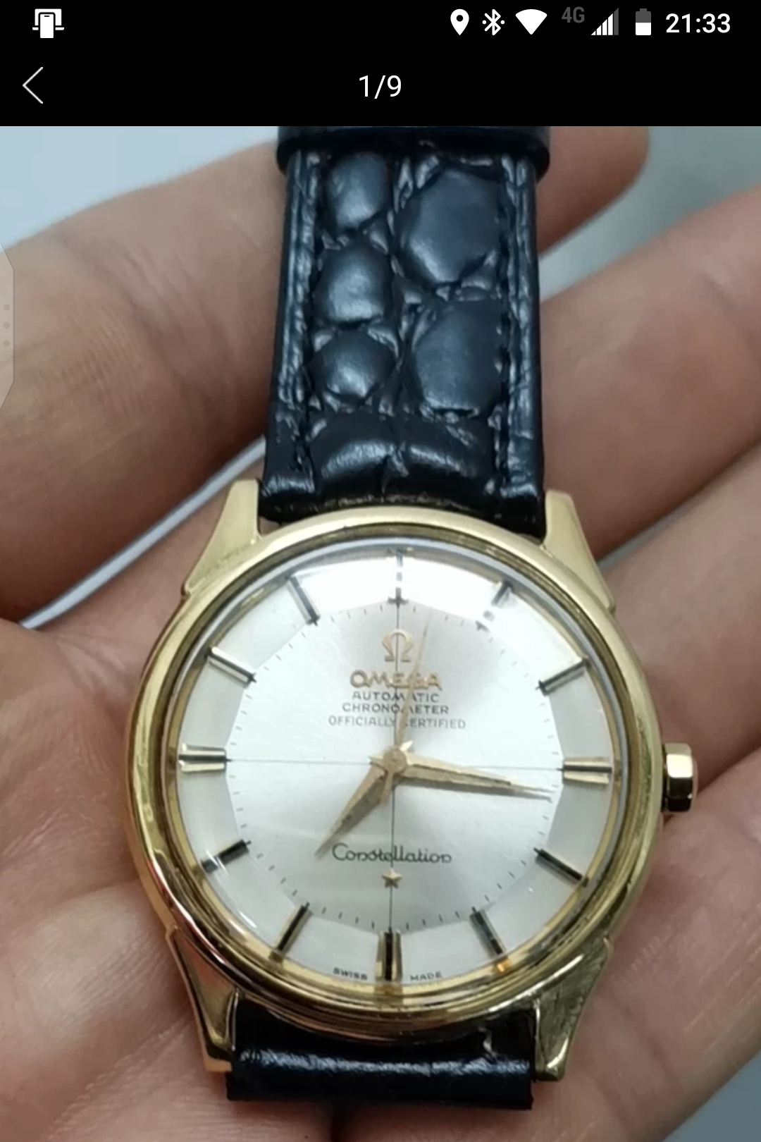

how about this constellation 14381
108
19
I found this 14381
It looks good, all original I think...about $2500...
What do you think?

I think you would need much better pics to assess the watch properly
You wouldn't usually expect 'officially certified' on a 14381 dial, so unless this text has been added (it does appear lighter than the text above it) it's likely a later dial has been transferred into this case.
the cross hair shouldn't touch the 'e' in constellation, which is a concern.

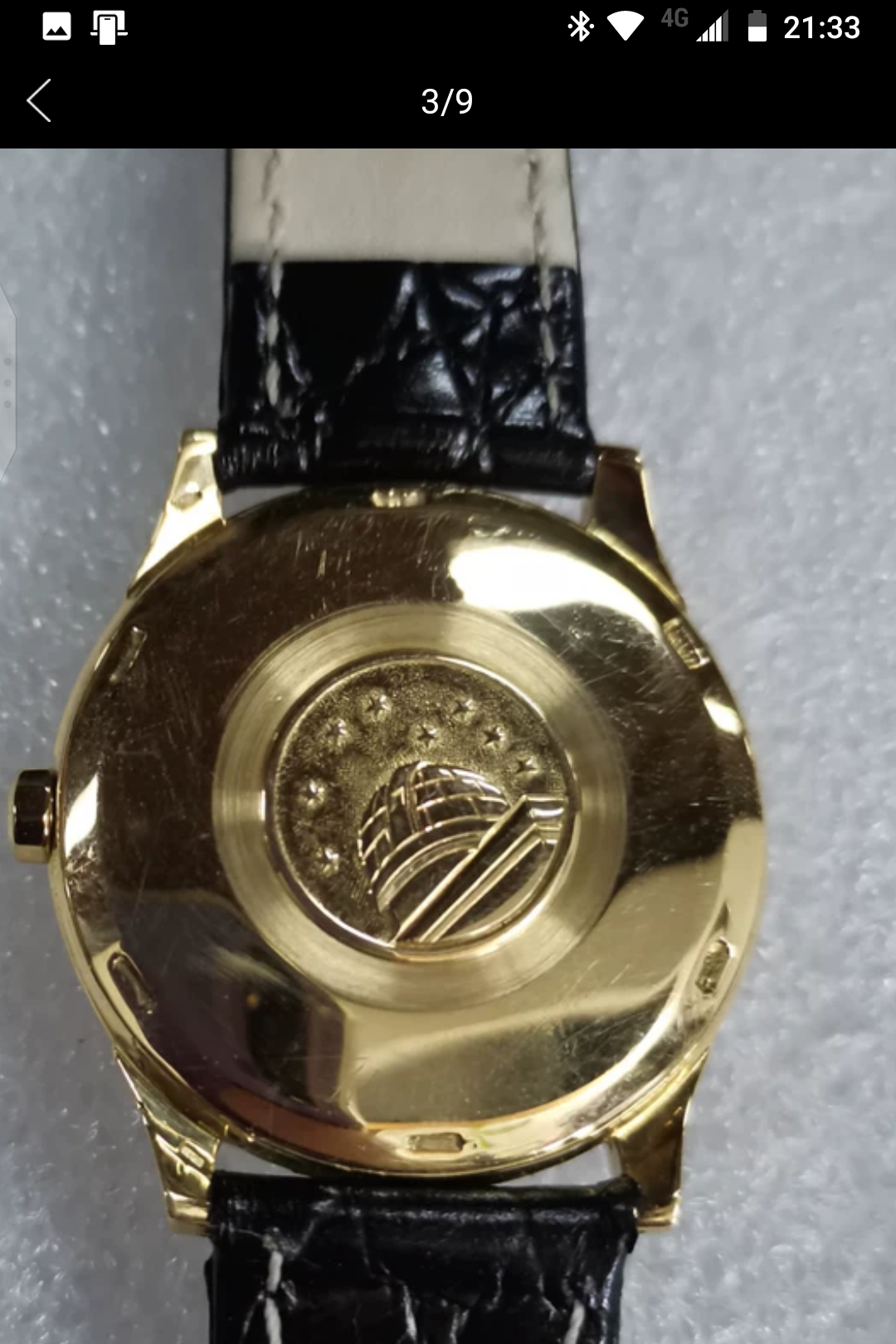

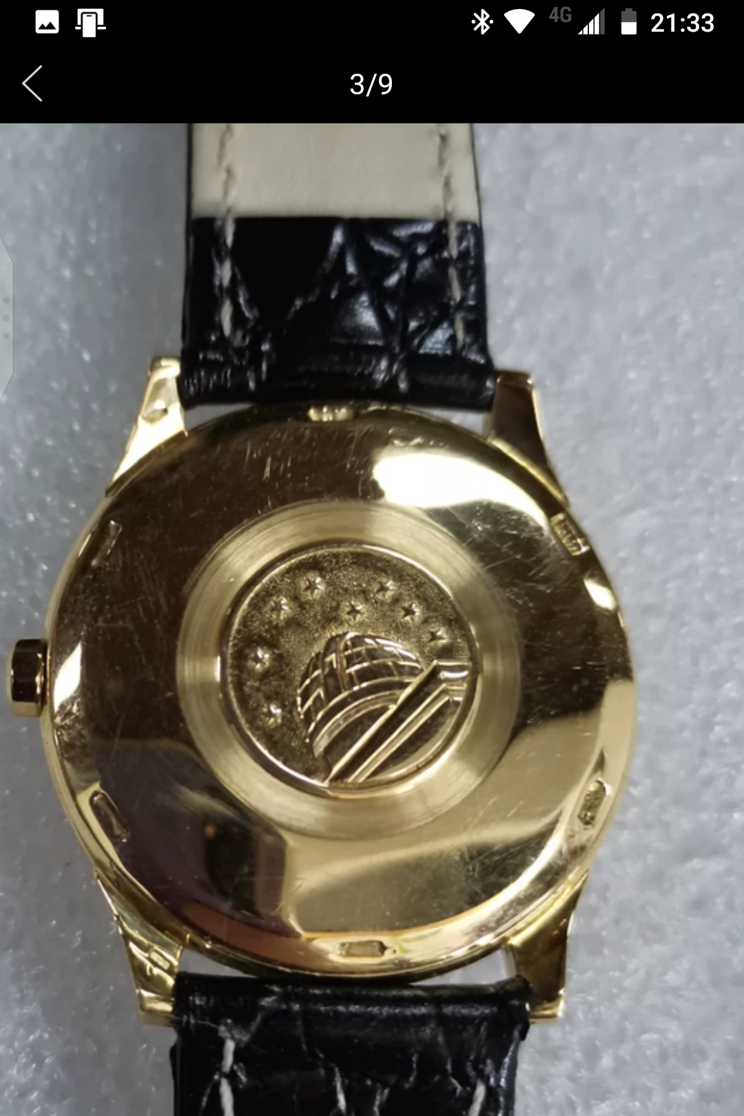

the lugs look heavily polished and appear really short

ok...thank you for point out the cross problem...
Thank you!
so pity XD

I've said this before like others.....If a seller knows enough to ask $2500, they know enough to take and post High Resolution and very clear pictures......unless there are reasons to obscure.
But a gold case(especially THIS gold case) in this condition is a non-starter for me.
8,174
36,709
My first impression was a redial, but the photos are poor so hard to make a 100% call
