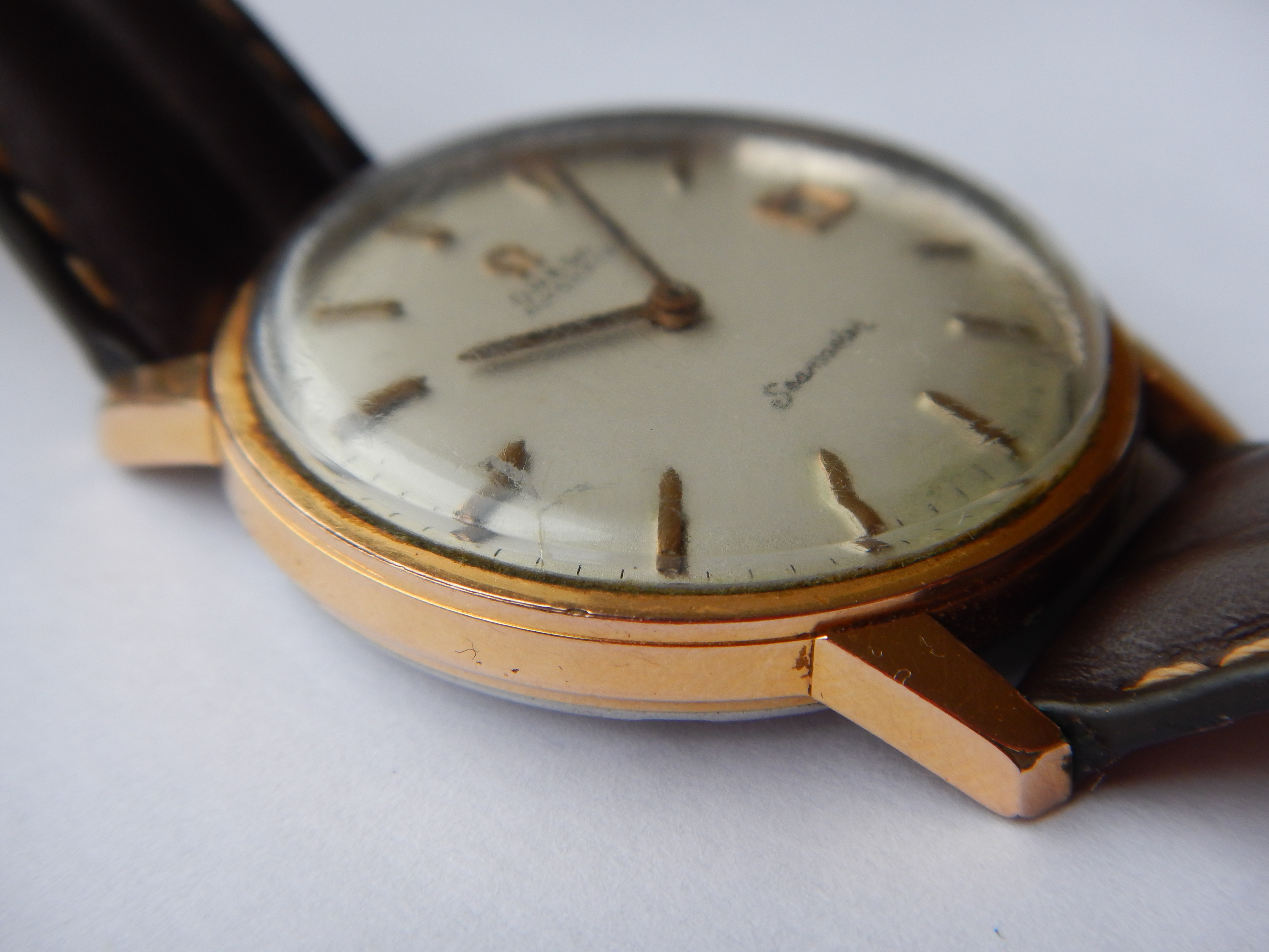

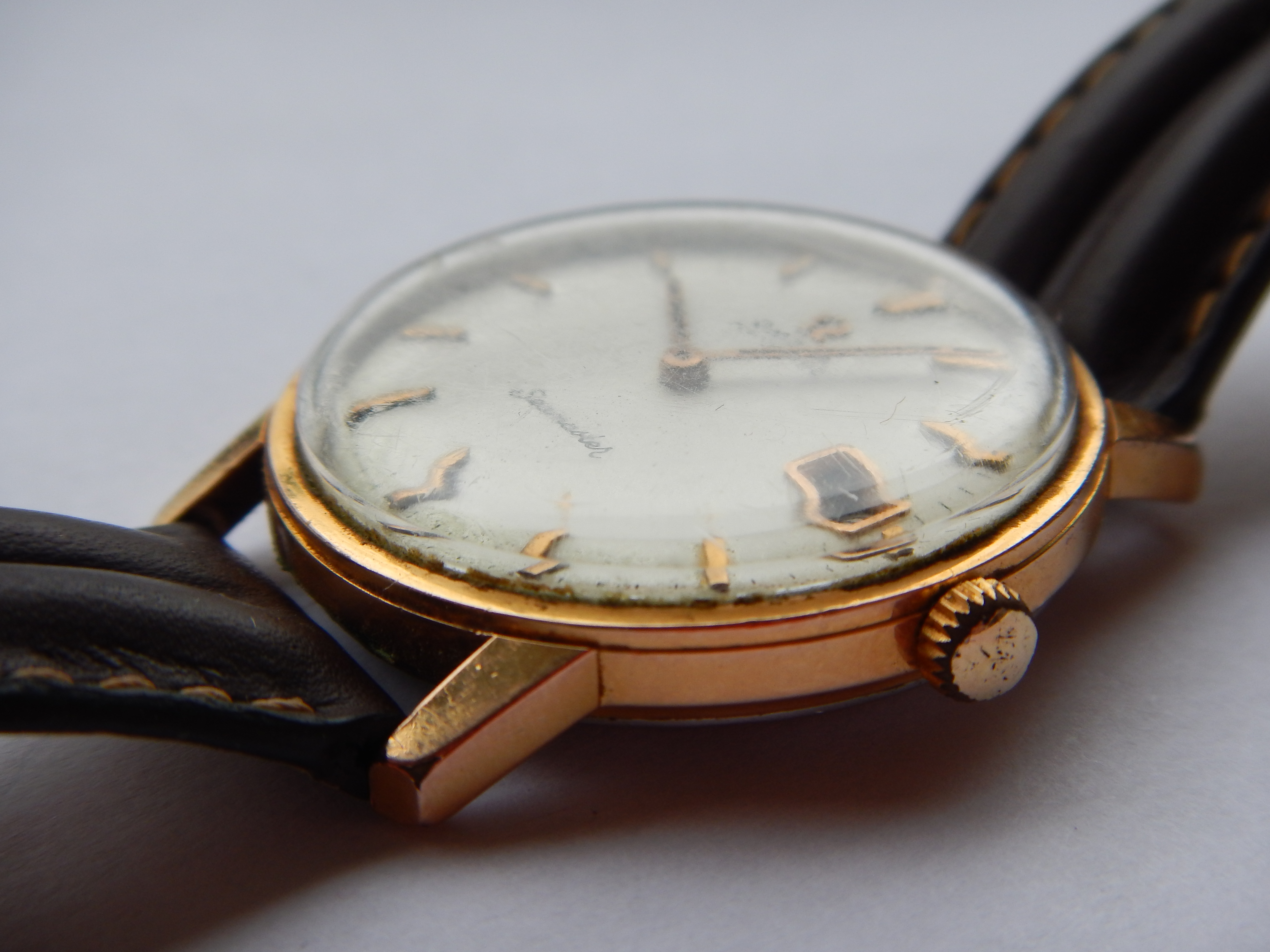

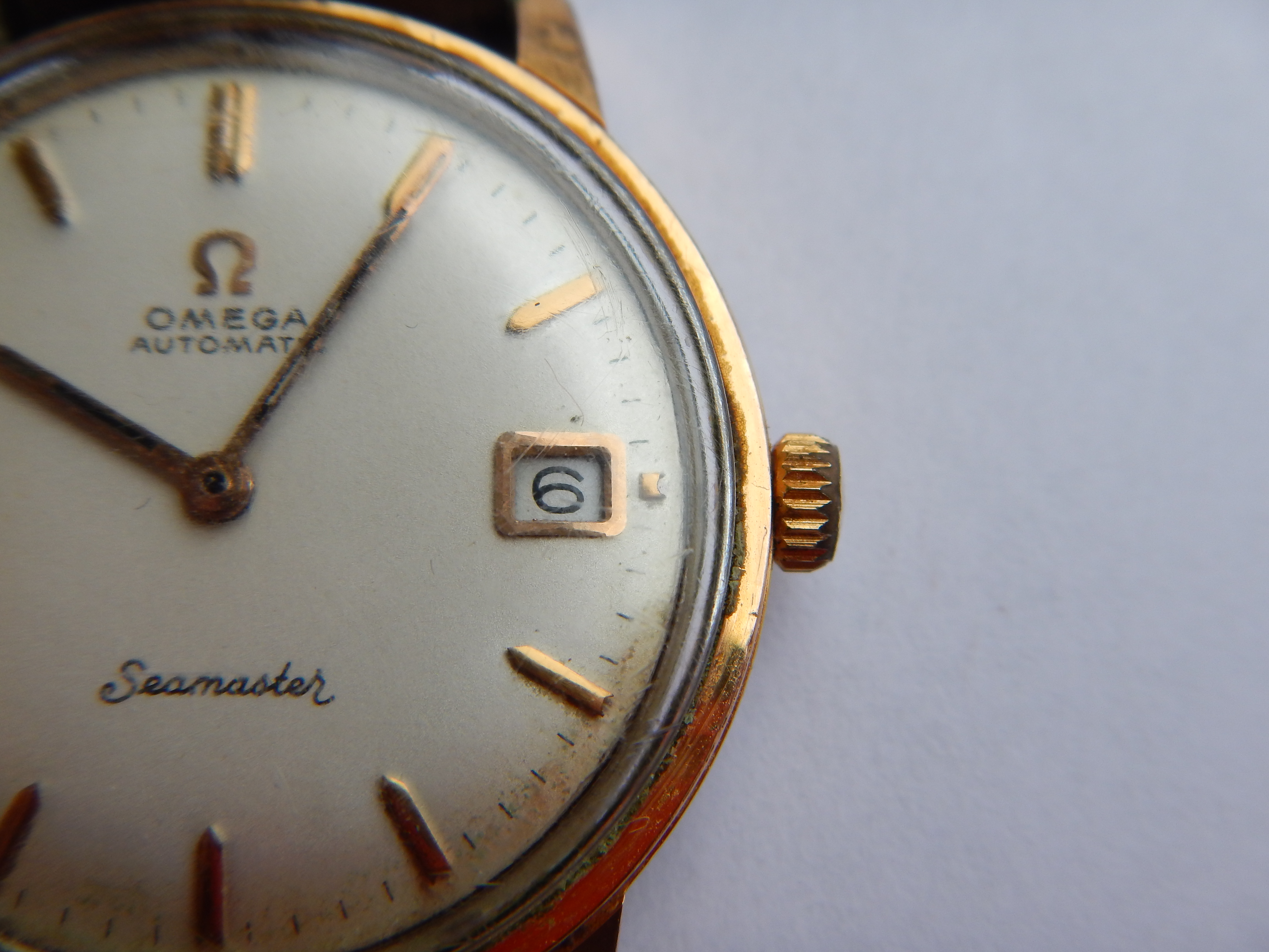

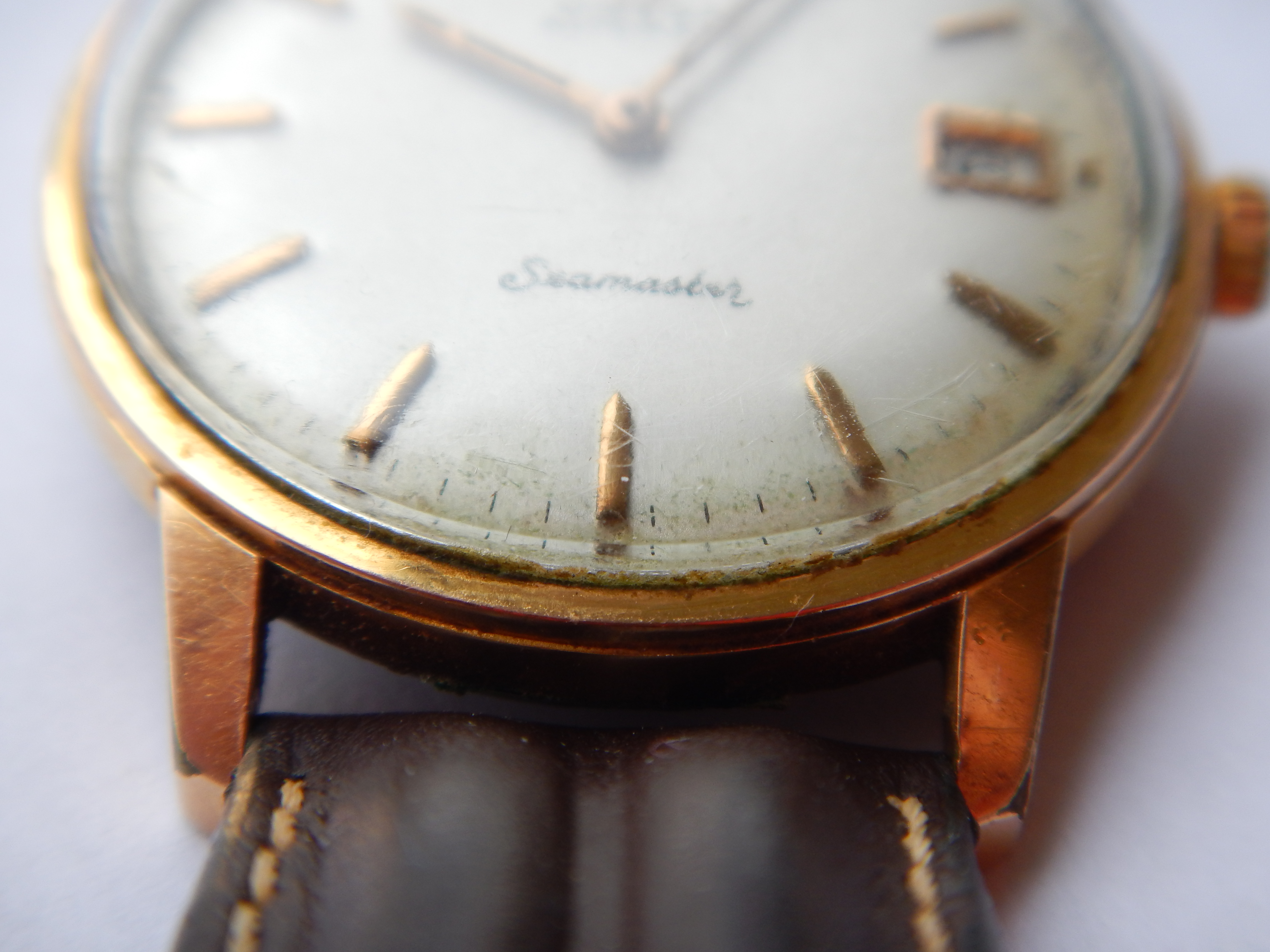

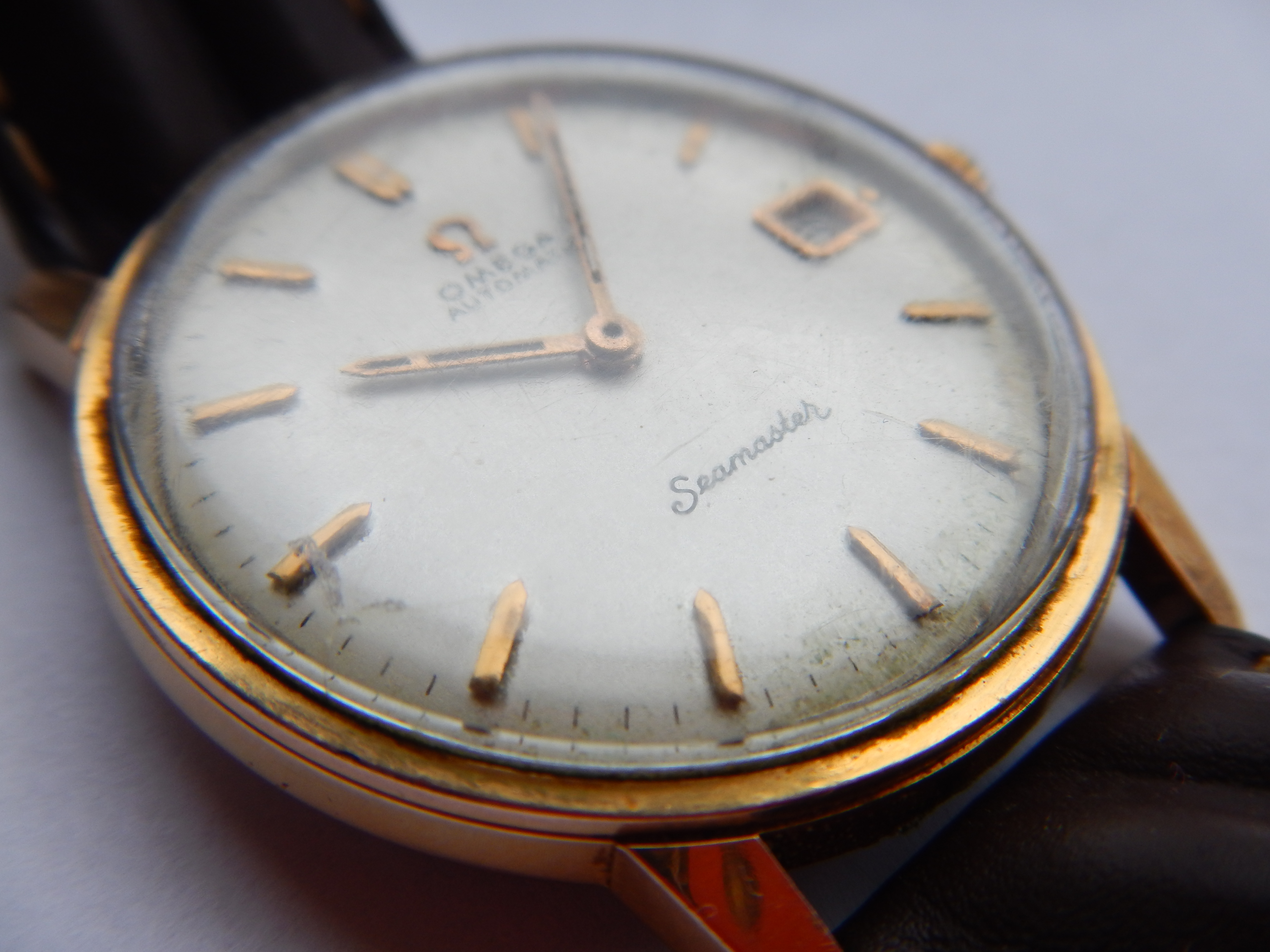

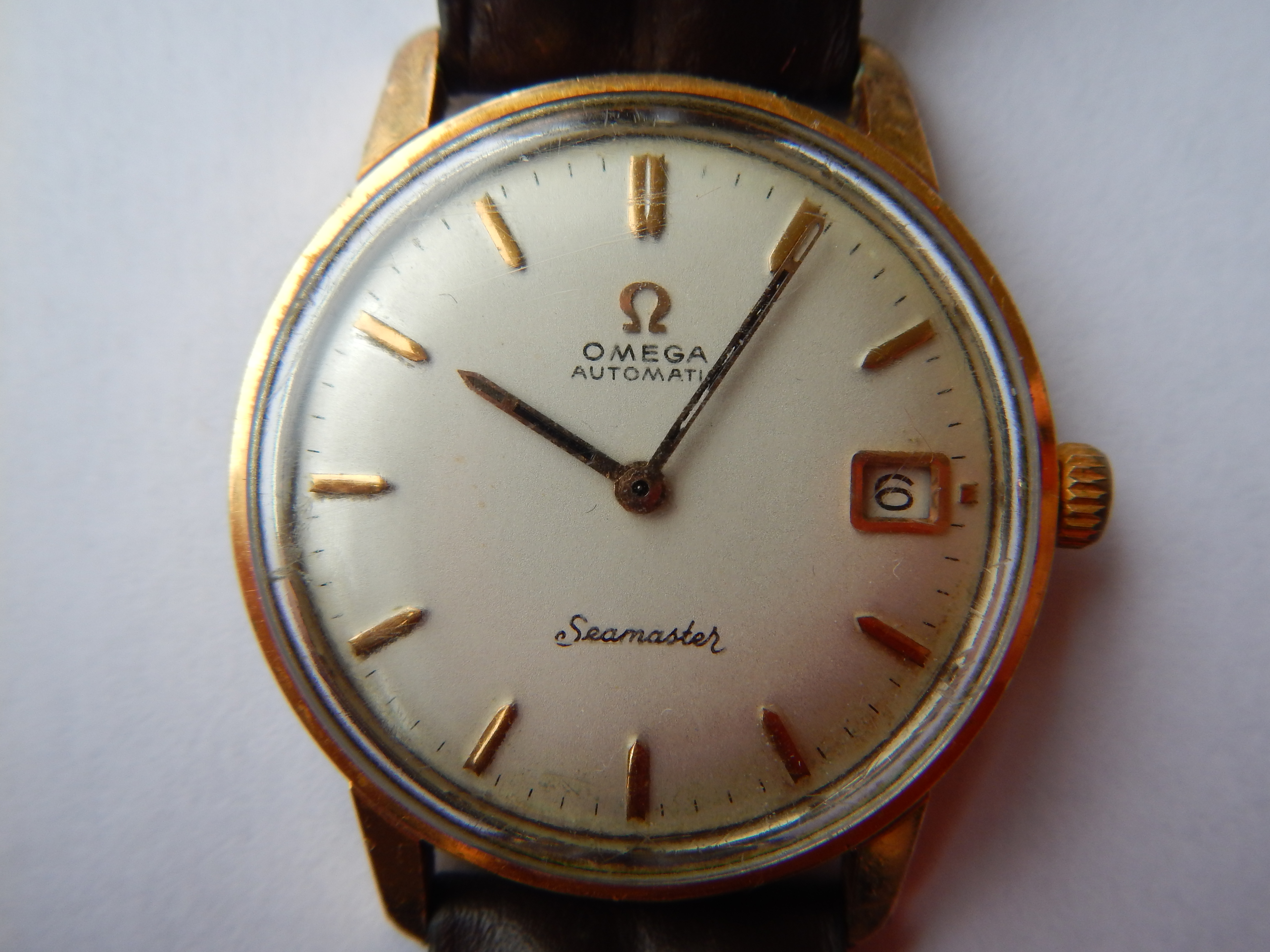

Hello everyone,
After hearing me talk about automatic watches several times, my grandmother just gave me my grandfather's old Omega Seamaster (I'm ecstatic). As a beginner, I am looking for as much information as possible about this watch.
The watch is gold plated. My grandmother tells me that she would have bought the watch in 1971 or possibly earlier, between 1967 and 1970. According to my first research, it could be a model 166.002 from 1966/1967 (see photo of the vintage catalog below). What do you think about it?
I think the glass has been changed (it doesn't have the Omega mark in the center) and the crown too (no Omega logo).
I also have doubts about the dial: I think it has been changed or modified in part (the lower loop of the Seamaster' "S" is different from what can be seen on other models of the same period). What do you think about it: is it a redial?
Also, is it normal that there is no seconds hand? Is it missing?
I plan to have this watch serviced/restored in order to wear it every day (considering its sentimental value, I will never sell it). What operations should be performed to be able to wear it with peace of mind?
Finally, do you have a rough idea of the value of this watch (only to be able to assess the cost of repairs accordingly - not for resale).
As you can see, I have everything to learn about this watch and all information is welcome. Thank you in advance!

There’s a good chance that it is a ref. 166.002 as you stated.
The second hand is indeed missing, the crown isn’t correct and to my eye, the dial has been repainted at some point.
Nevertheless it’s a family heirloom, so (personal opinion) a new crown, new second hand and a service would be the road I’d take. And for the long term, finding a correct dial 😀

Very likely a 166.002 (or 166.001). As stated there should be a centre seconds hand and the dial has certainly be repainted.
To a colllector a repainted dial is a big no no, but as a heirloom it’s likely the dial your grandfather looked down on for years so is now an important part of the watches history.
it also looks like the plating is worn through in paces such as the lug tips. It’s a judgement call as to whether you try and get it replated or again stick with it as part of the watches history.

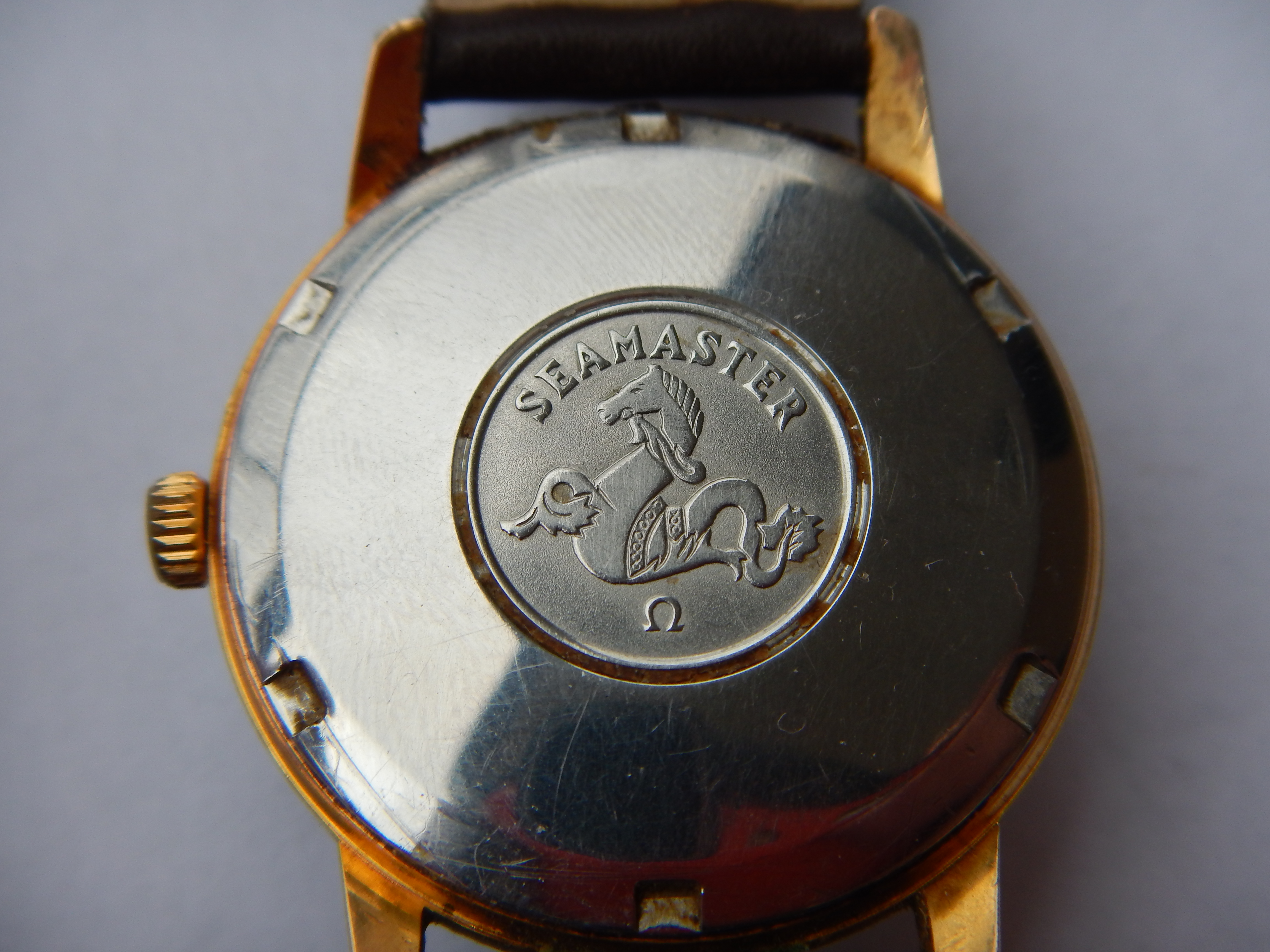

I went to a watchsmith yesterday. and he opened the case. It is indeed a 166.002 reference from 1966/1967. It's 40 microns gold plated (which is thick, apparently).
From a first glance, the caliber (a 565) does not look in bad shape, but the watchsmith will strip it down and provide me with a quotation for an overhaul (he's not a dealer, but he is certified by Omega and works only with Omega original parts and grants a 2 years guarantee just like Omega.. only difference is that the quotation itself does not cost 120 euros and it does not take up to 3 or 4 months to get the quotation). He told me that he hopes that the balance wheel is not damages because it is an expensive piece.
As for the price... He told me that a complete overhaul (including or not the dial, to my preference) would probably cost between 1000 and 1500 euros (without replating the gold). Thank you @MtV for your assessment of the value of the watch. That is more or less what I expected: around 500 euros in good shape.
I just wanted to know the price of the watch in order to assess the price of the work to be done on it, but anyway I want to wear this watch so I will have it serviced no matter the price (of course, I am not Cresus either...).
As for the dial and the gold plating... In the same way I like old motorcycles and cars (one of my hobbies) with their patinas, the repainted dial and the worned gold plating are part of my grandfather's watch history and I will very likely keep it as it is. This watch has traveled with him around the globe and was serviced when he lived in Africa or Asia in the sixties and seventies, so the "defects" are somehow like the scars of an old traveler (at least the scars of its favorite tool). In any case, what was good enough for my grandpa is good enough for me, as this watch is more a wearable memory than a museum piece.
Thank you all for these information. It is like a small adventure to have this watch working again and to find out its history. Also, it is certainly not my last automatic watch (without much originality, I find the speedmaster pro astonishing and dream of offering it to myself for my 30s).
