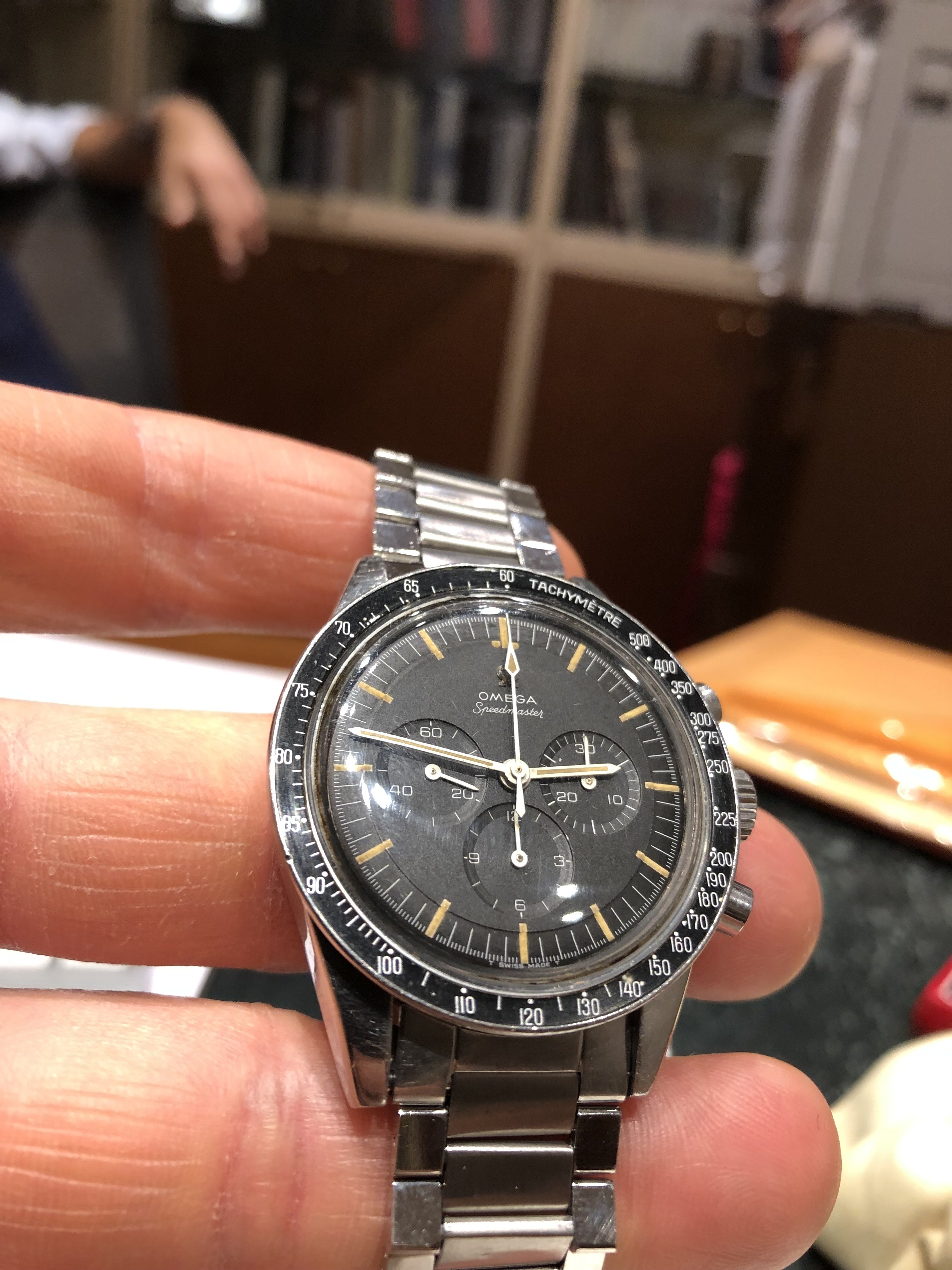

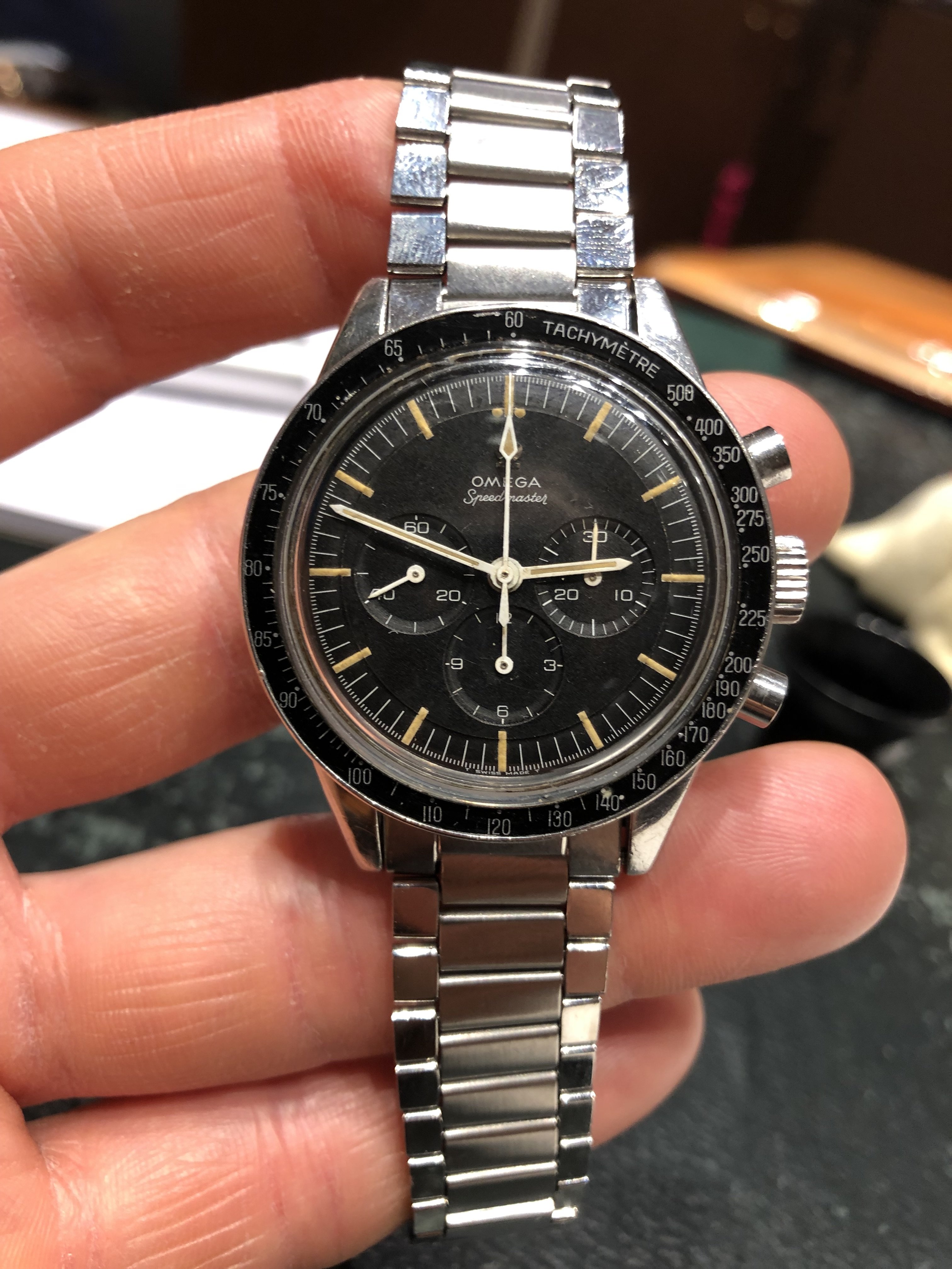

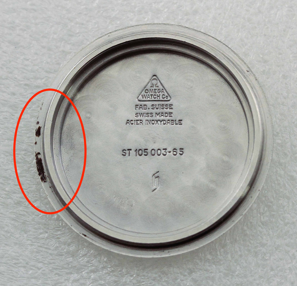

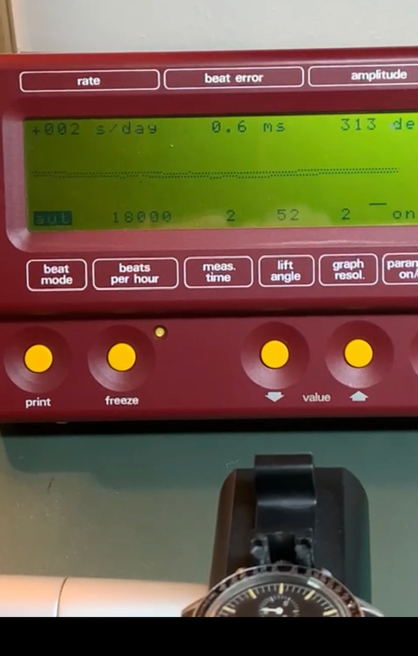

Dear all, I am a speedmaster enthusiast and taking my first steps in this world. I write from Italy. I ask for your help as I am considering purchasing an Ed White which has good points in its favor (Extract from the archives, dial, bezel, hands, lumens, bracelet, winding crown, pusher, all original and in good / fair condition and at the timing machine the mechanism is beating well) but two issues that I would like to bring to your attention:
1- The start-stop button is broken and needs to be changed
2- There are corrosion of the steel on the back cover and on the case
The question are:
How much does the presence of corrosion affect the watch?
Are they bound to get worse over time?
Is it possible to repair them?
Is it possible to find and replace a 3.5 millimeters by 4.5 millimeters pusher?
Approximate cost?
Thank you in advance for your help.

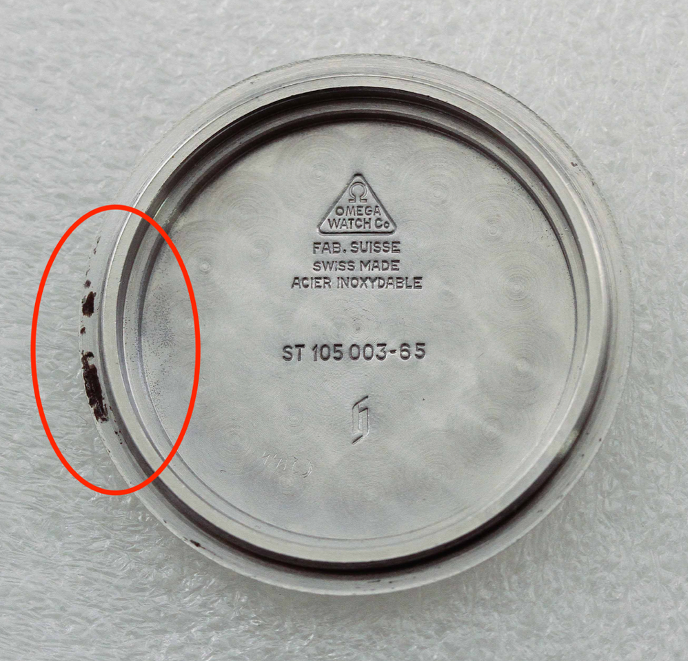

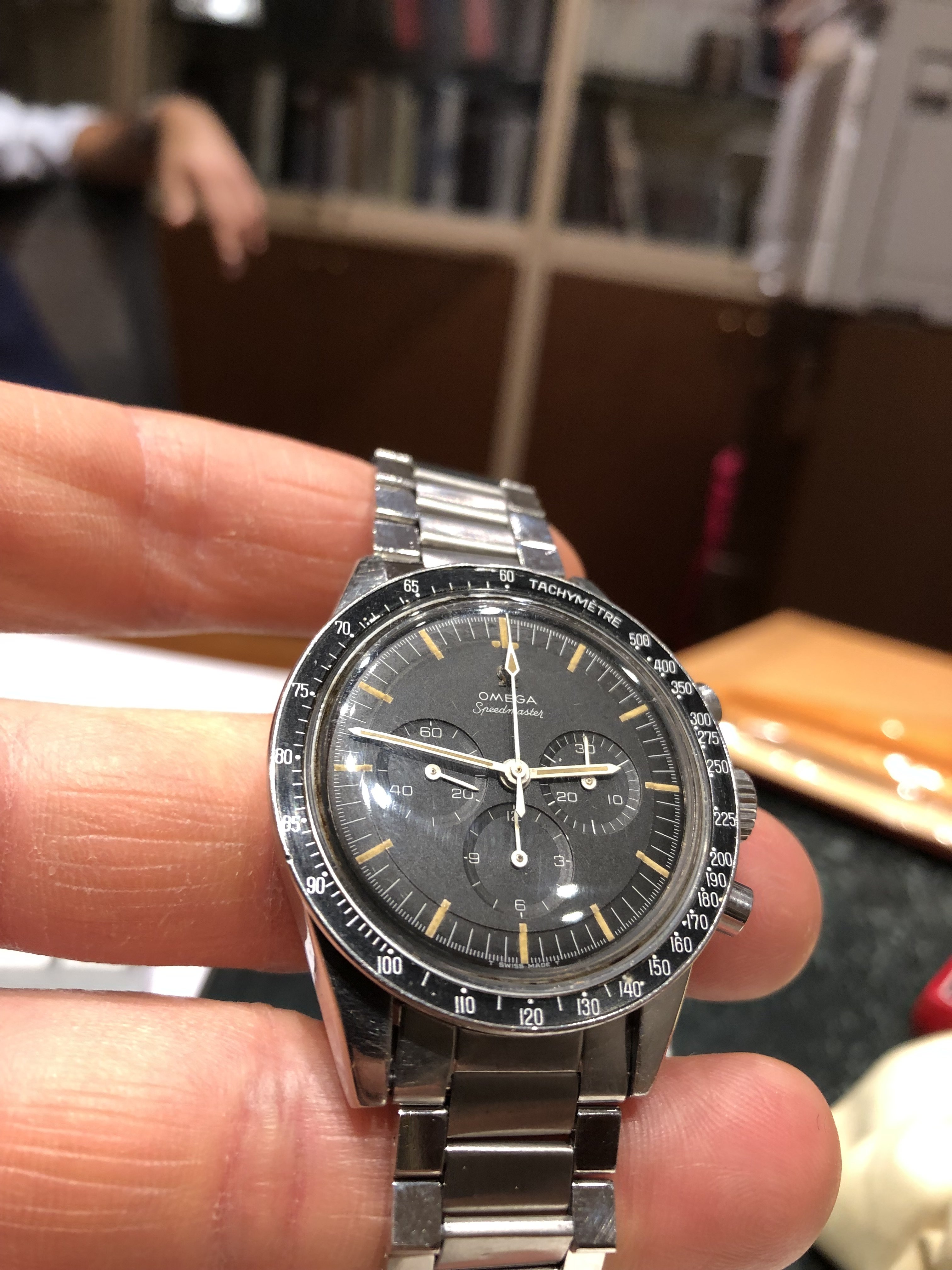

Based on those photos, I wouldn't worry too much about the case corrosion.
13,555
23,503
Is that corrosion or gunk?
Worst case, it’s corrosion - it would impact the value of the watch to me, but wouldn’t stop me buying it.
1,586
6,837
13500 euro ( about 15280 US dollars )
Serious price, for a serious watch. I don't think it is outrageous though. It's in a much better than average condition.

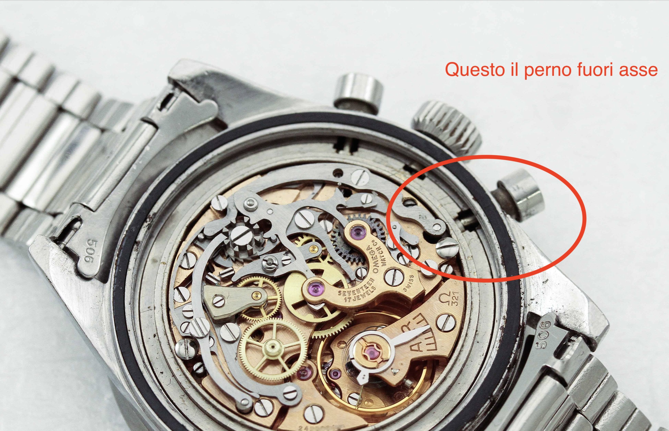

To your questions; yes, it is possible to source the right size pushers. Done so myself for another Ed White. See: https://omegaforums.net/threads/who-nabbed-this-105-003-65.124054/page-2
Don't quite remember the exact cost, but it wasn't too much.
Personally, I wouldn't worry too much about the 'corrosion' either; it looks like gunk coming from a very worn caseback seal.
If I'd be in your shoes, I'd buy it. I'd almost be inclined to say; let me know if you don't. 😁

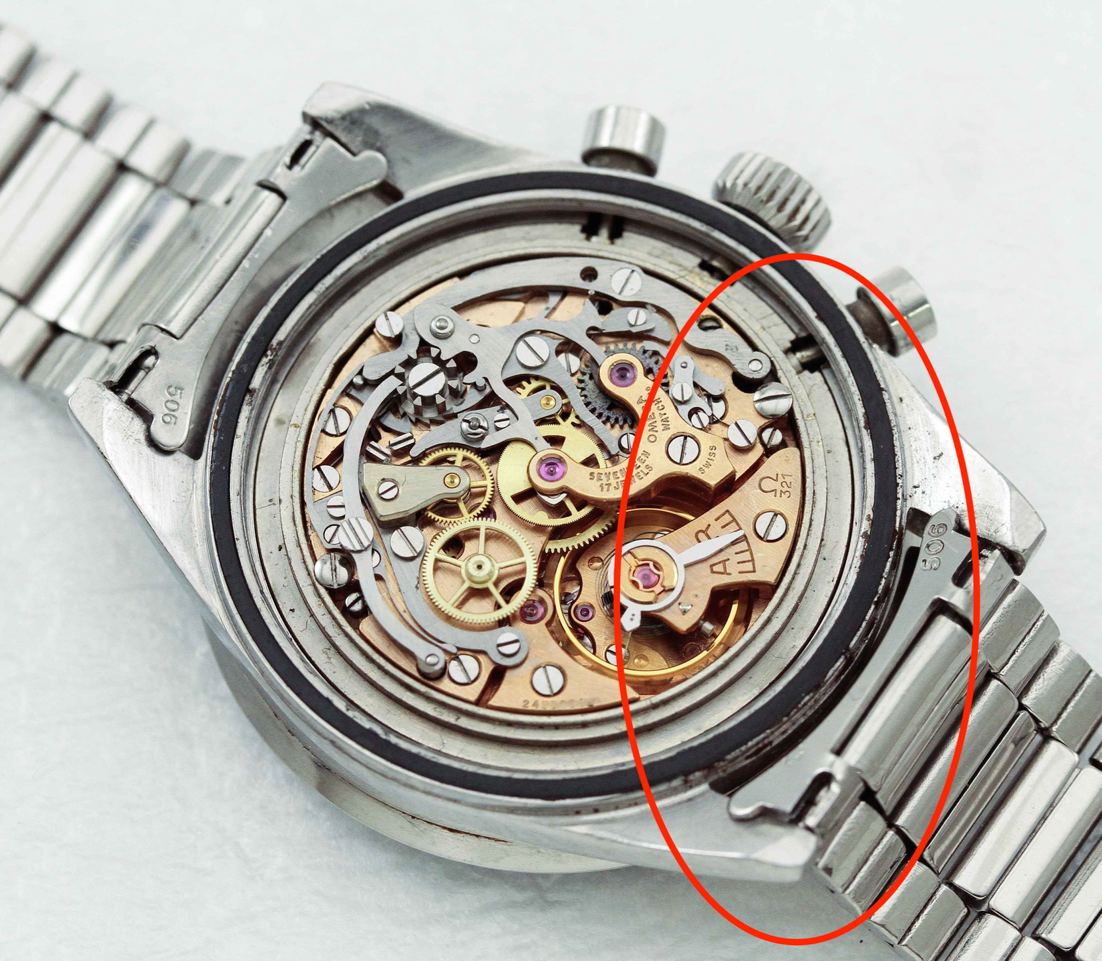

Thanks Aludic for your information and advice.
According with the dealer's watchmaker report the one on the case and back is corrosion, not dirty. What I'm wondering is if that corrosion can increase over time. Because I don't think it can be repaired.
As for the pusher, I did a quick search on chrono24 and found only one at a price (500 euros) that seems quite high to me.
https://www.chrono24.it/omega/coron...105003-st-65-105003-st-66-etc--id15116573.htm
I will also try at my watchmaker
24,836
55,256
Corrosion can always increase if you continue to expose the watch to moisture, especially salt water, perspiration, etc. It won't happen quickly, since the case is stainless steel, but obviously it can corrode. If you are careful with the watch and avoid excessive moisture, it should be fairly stable.

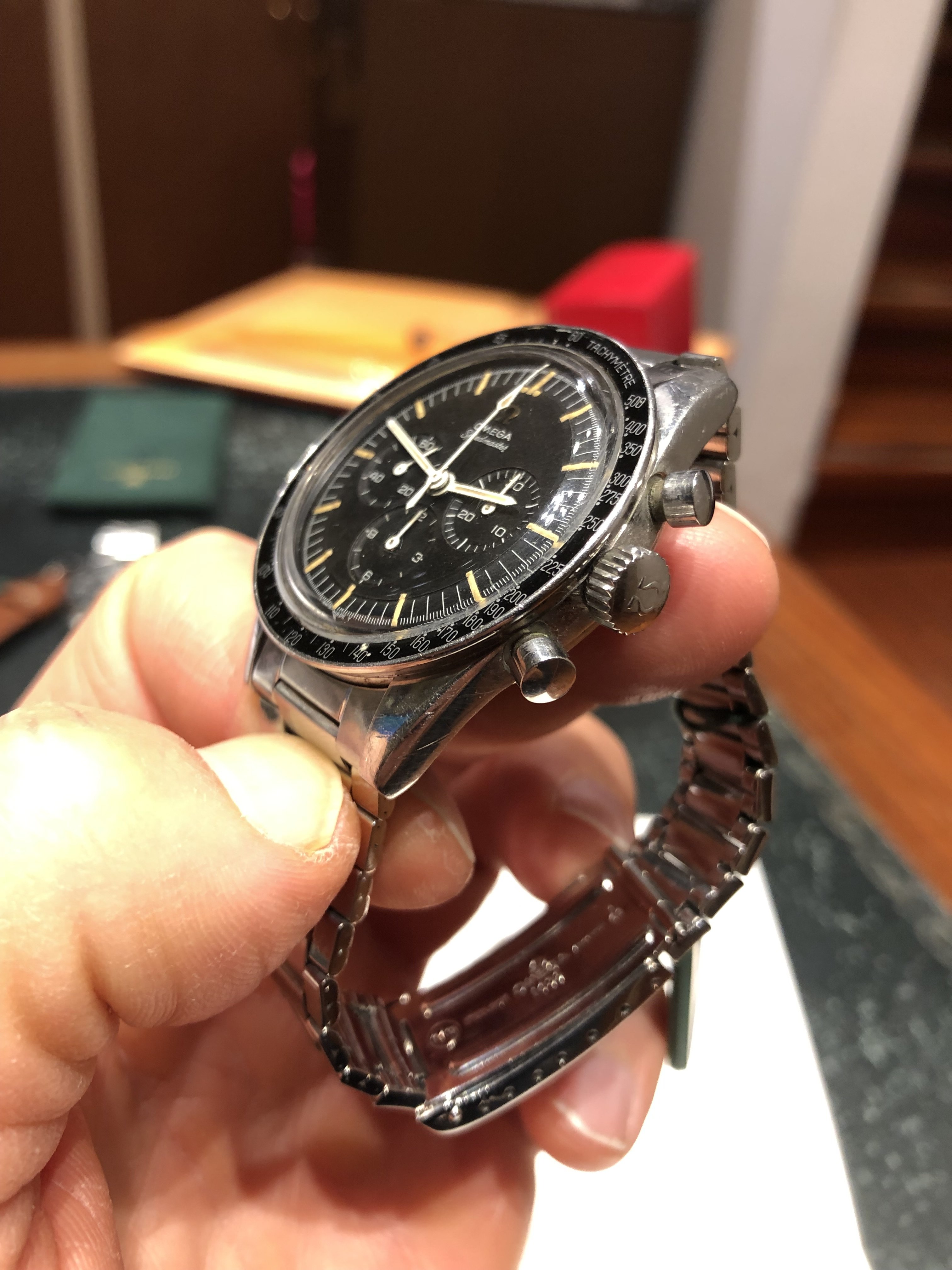

I would have a good watchmaker look at the pusher before rushing to buy a replacement.

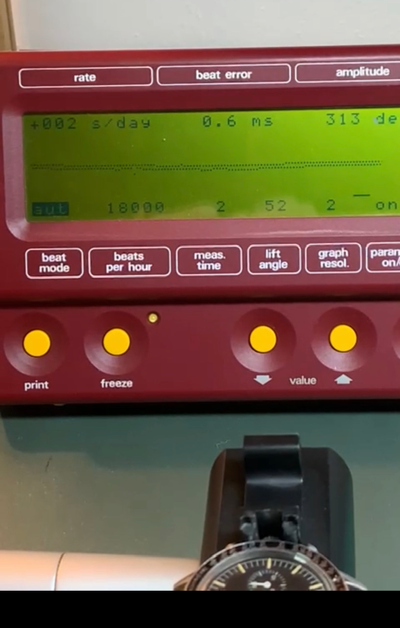

If it matters, you should be aware that the watch will likely require a full service.
The photo on the timing machine is quite misleading, as the lift angle is set to 52 degrees. The correct lift angle for this movement is 40 degrees. The balance amplitude number of 313 is grossly overstated, by as much as 72 degrees.
If that is fully wound at the time of that reading, the watch is running quite poorly.

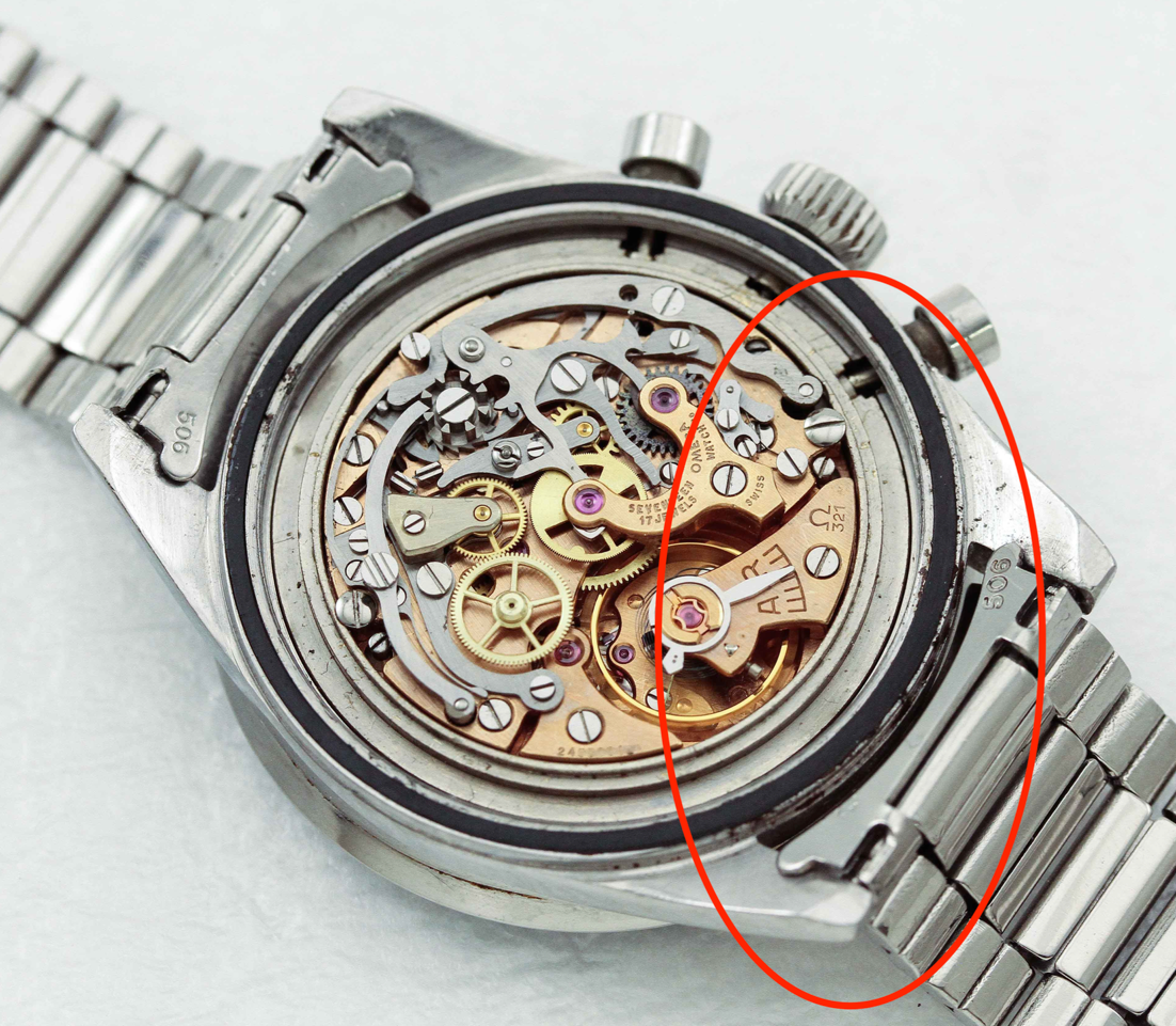

To my eyes the hands look in comparison to the dial lume, if the dial lume had mold then the hands would probably have the same patina.
The screw heads on the movement look in good condition too, some 321's have quite rough screws which indicates servicing but not to a good standard, 506 end links are quite valuable on their own as is the bracelet so that needs to be considered when looking at the asking price.
What this watch needs is a full service and clean by an independent watch maker like STS here in the UK or Simon Freese who serviced my Ed White just before I took ownership of it, they know how to handle and treat vintage Omega and you have a much more personal service, I would suggest having £500+ set aside for this work or try to haggle the dealer down.
Regarding the corrosion, as its stainless steel it seems strange that it has corroded, if that is the case I would imagine it would only be light and on the surface, again a trusted service and clean would deal with this and not be an ongoing issue.

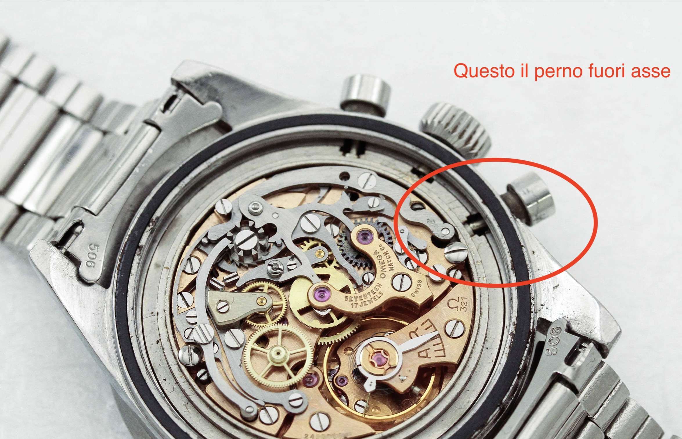

The dealer's watchmaker has found that the button is broken and the spots are corrosion.
It is becoming clear to me that if I want to proceed with the purchase I have to take into account a full service, this is the only way I will understand what to do.

If the pusher is broke then like you say finding an original is not easy and can be costly, keeping a watch like this original is key, if you can guarantee its 100% original parts and been serviced by a trusted name in the watch world then you will have a great watch to wear and a dare I say it sound investment.
