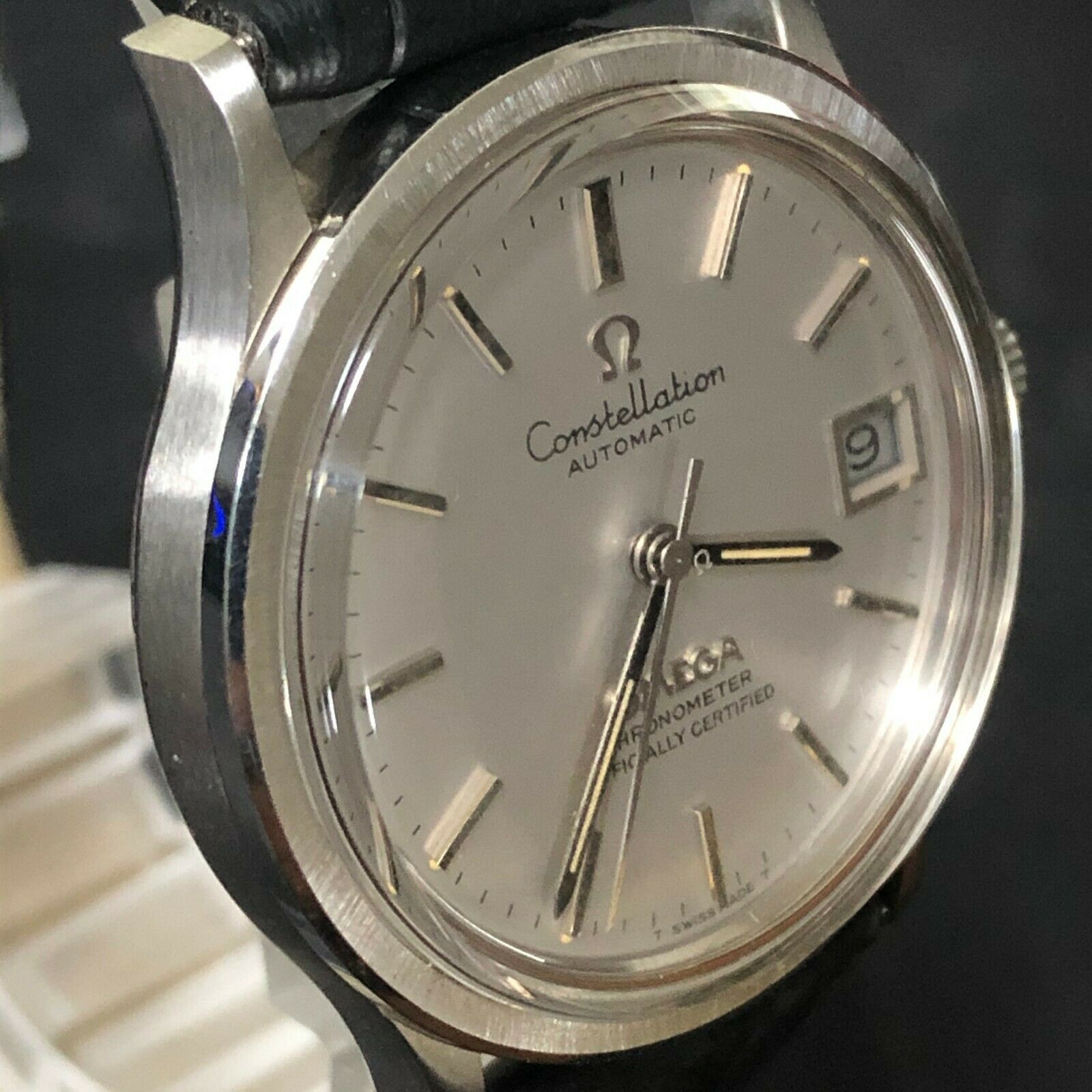

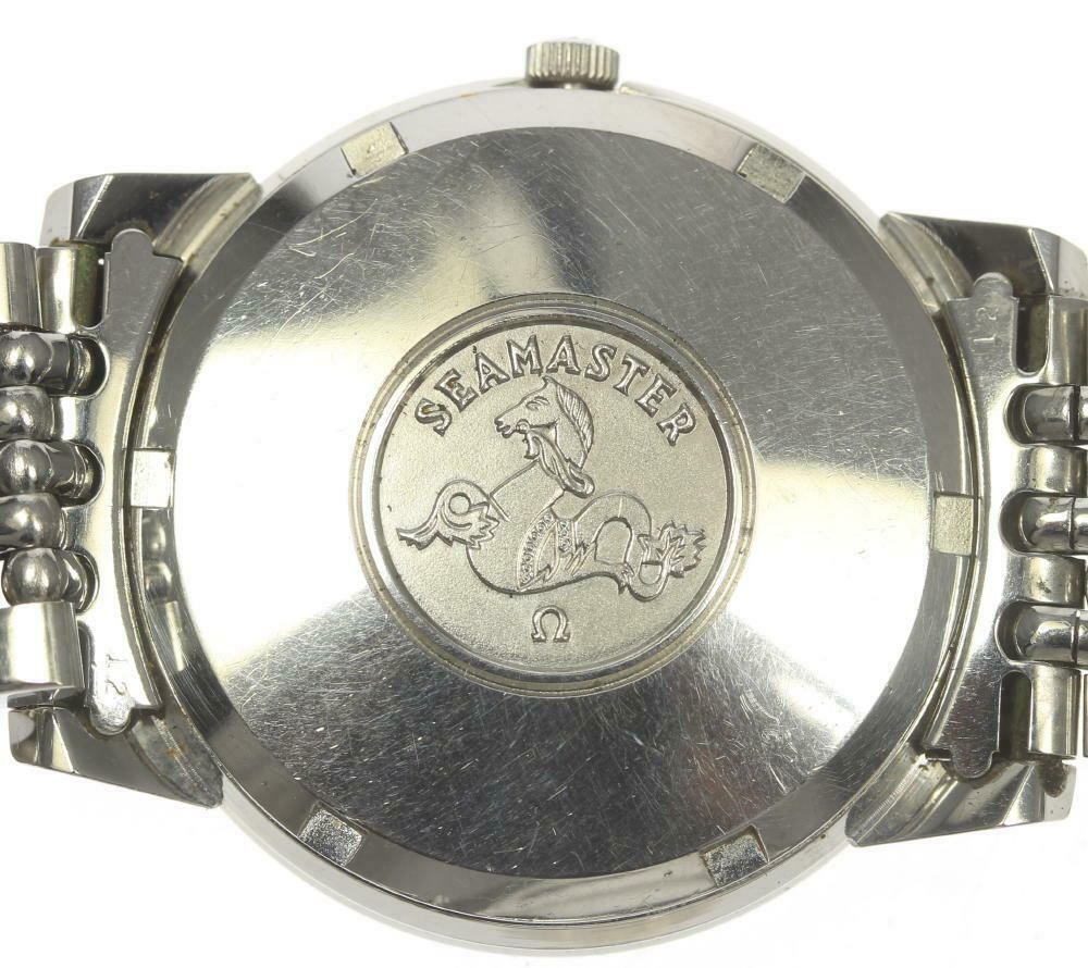

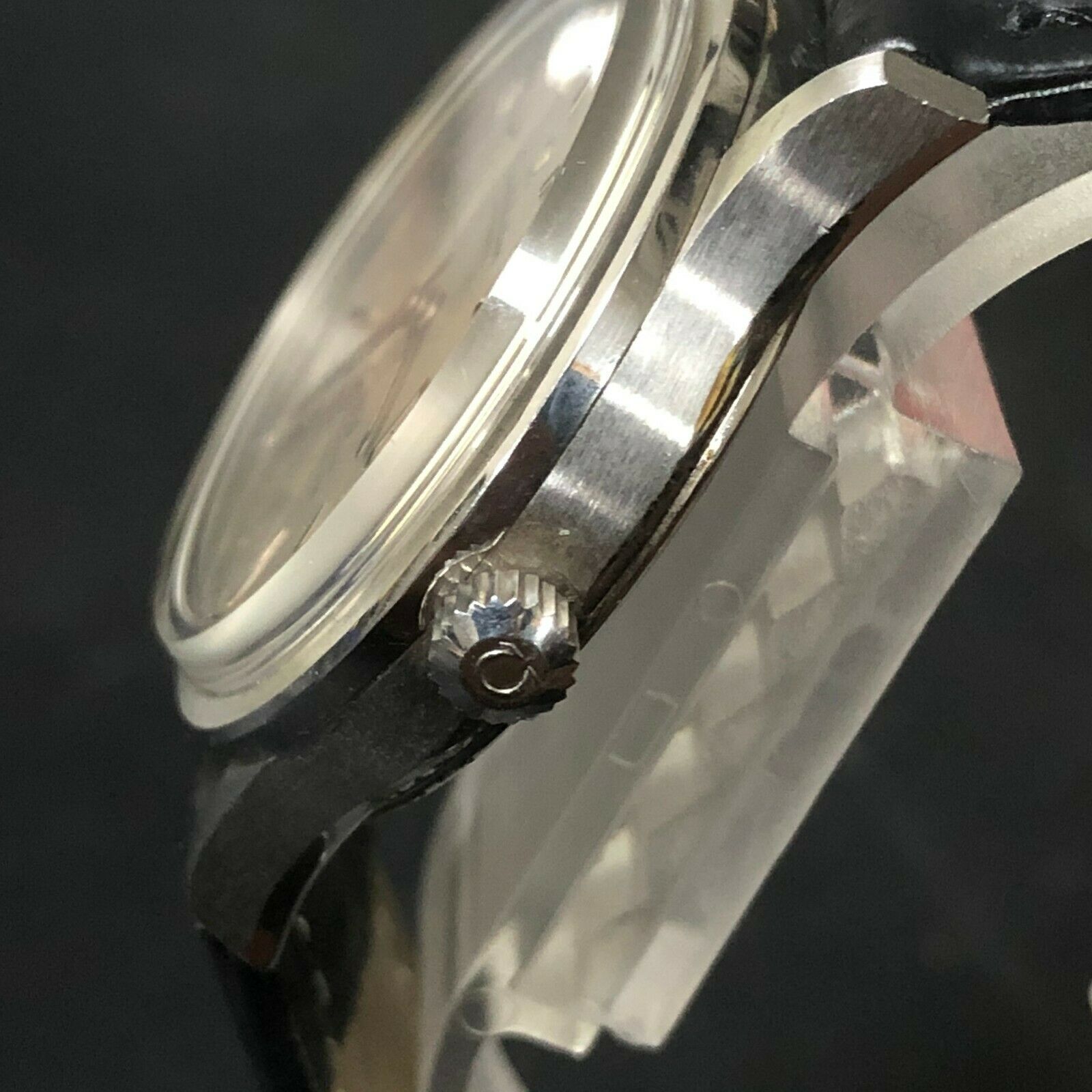

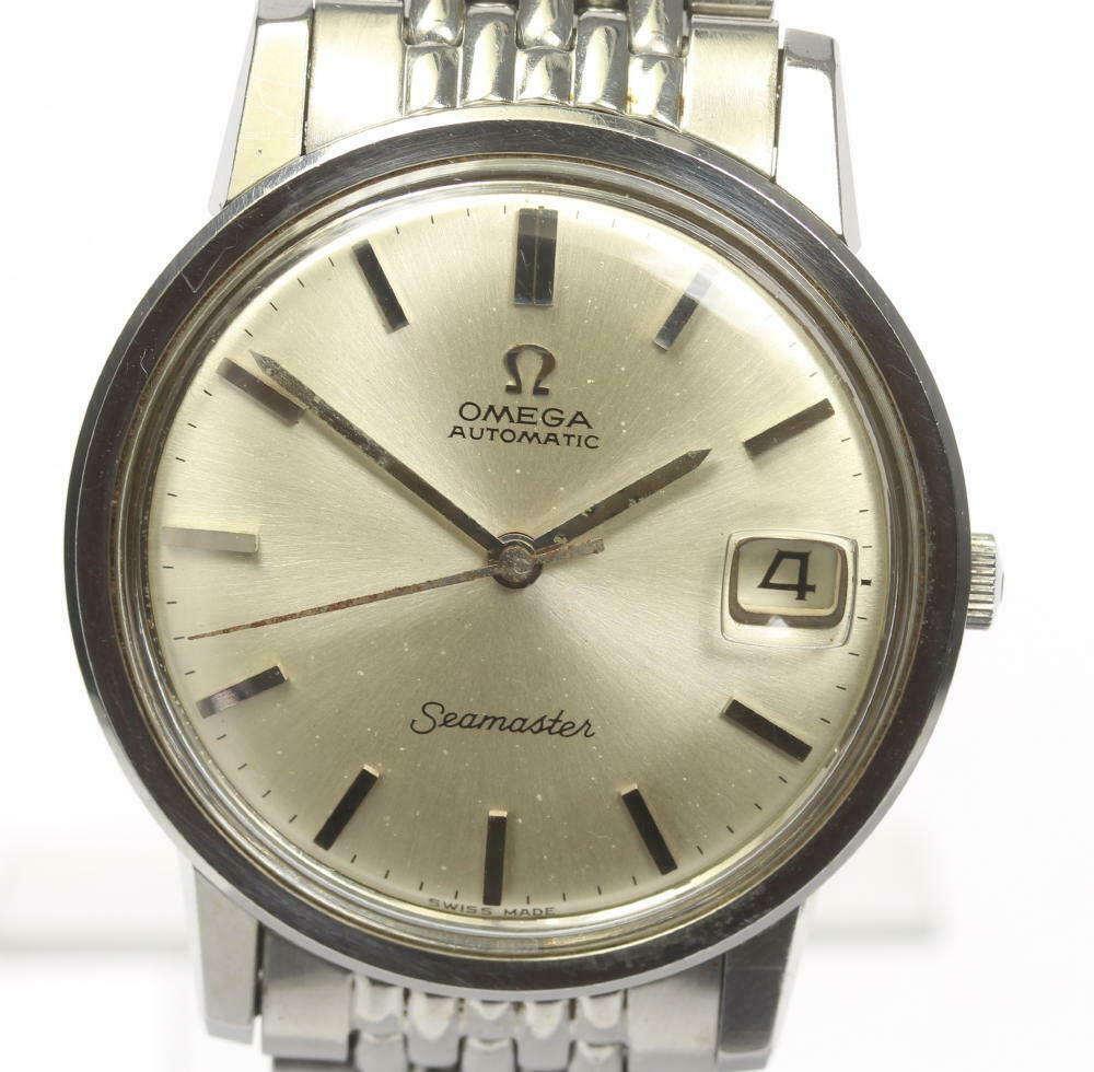

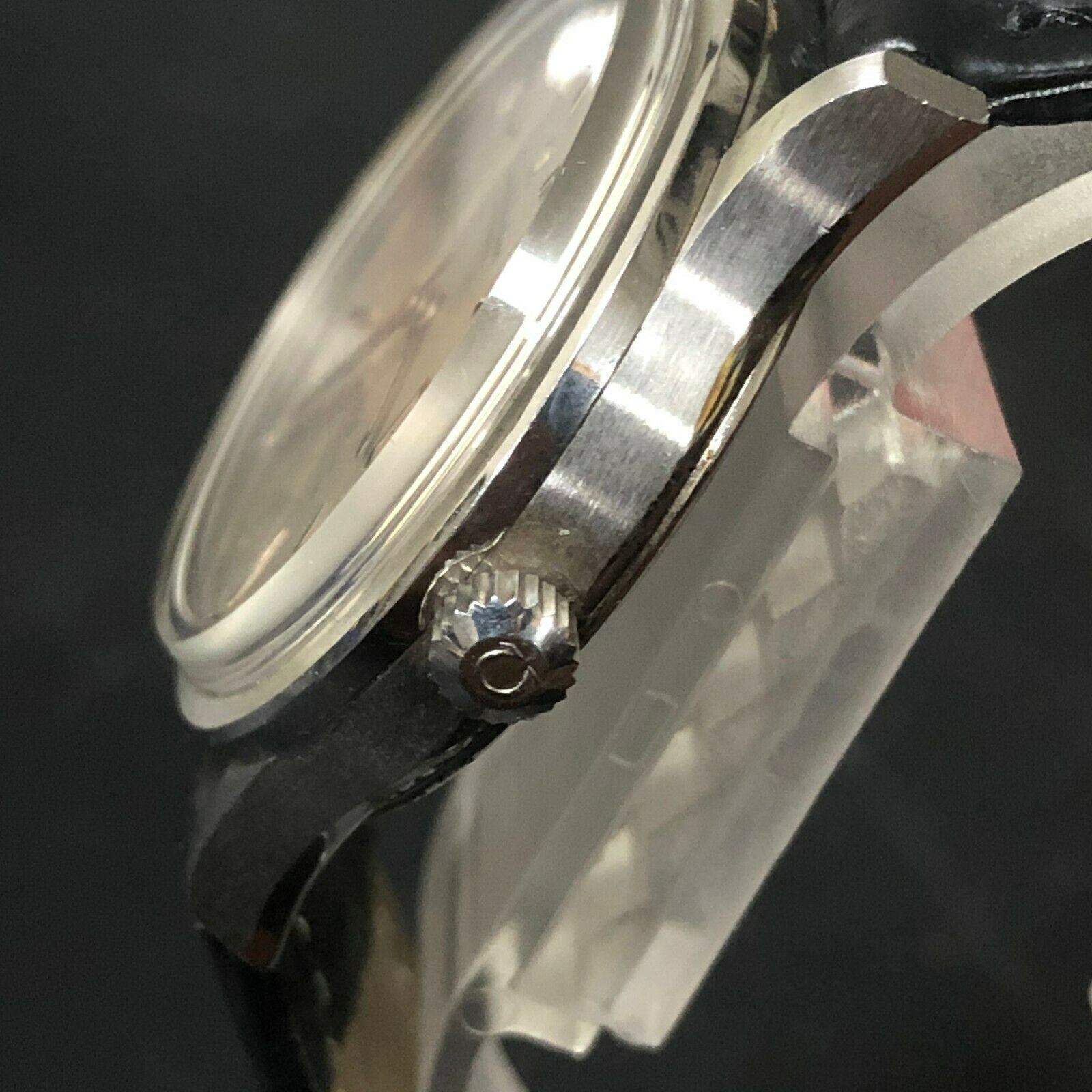

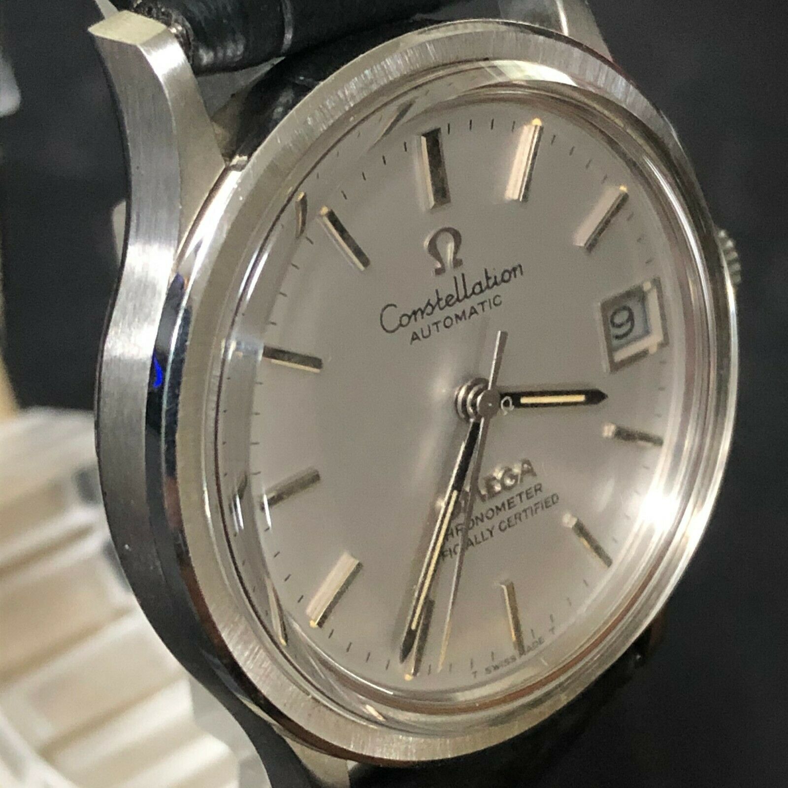

Hi, I'm completely new to Vintage Omegas, and I need help verifying 3 Vintage watches. Also what price range would be reasonable and how much value should a rice bracelet add? Thank you!
https://www.ebay.com/itm/Vintage-OM...ometer-OfficiallyCertified-Model/233690501695
- Looks to have original brushing/aging tritium but not sure about the movement as no pics were provided

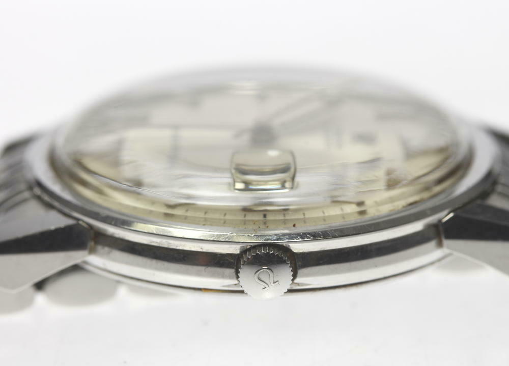

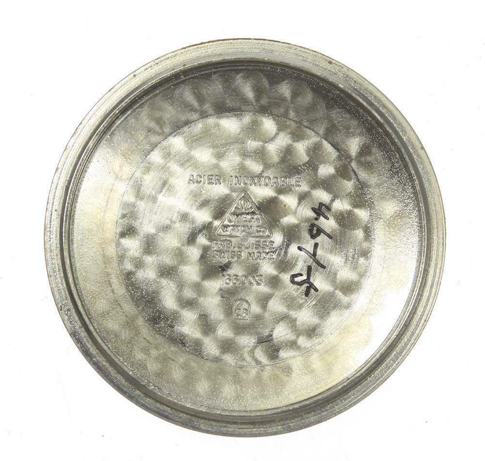

https://www.ebay.com/itm/OMEGA-Seam...ice-Bracelet-Mens-Watch-a-507975/283685364127
- Brushing seems gone due to polishing
Would appreciate any help. Also are there any other sites that you have found good vintage Omegas?

If you want help please post photos not links.

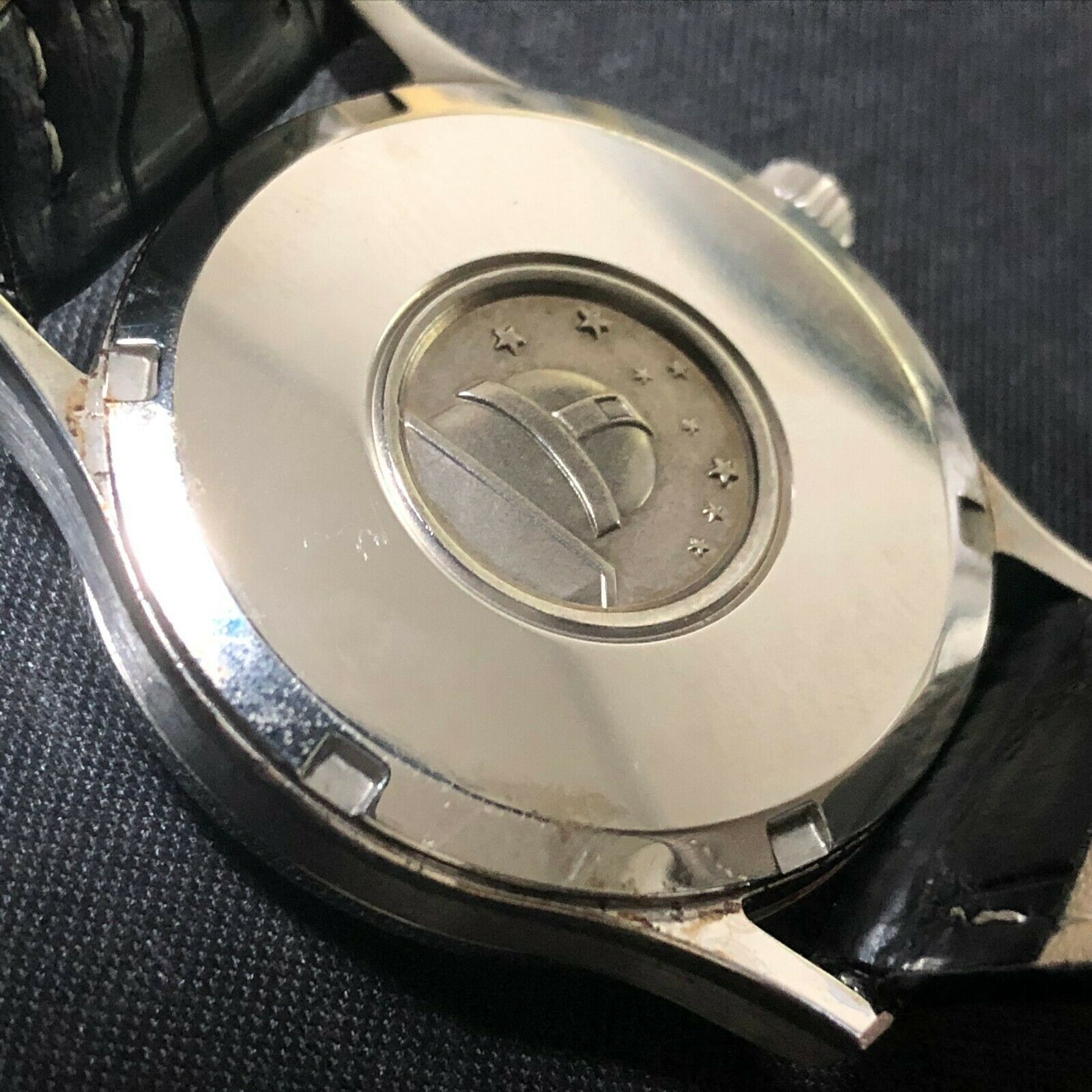

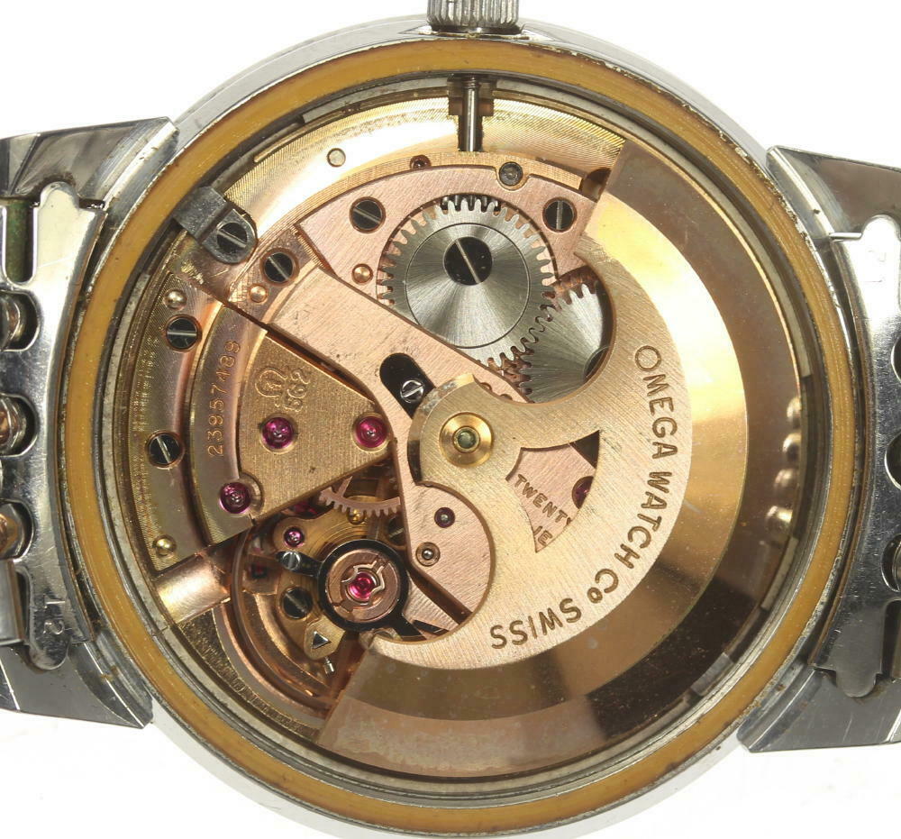

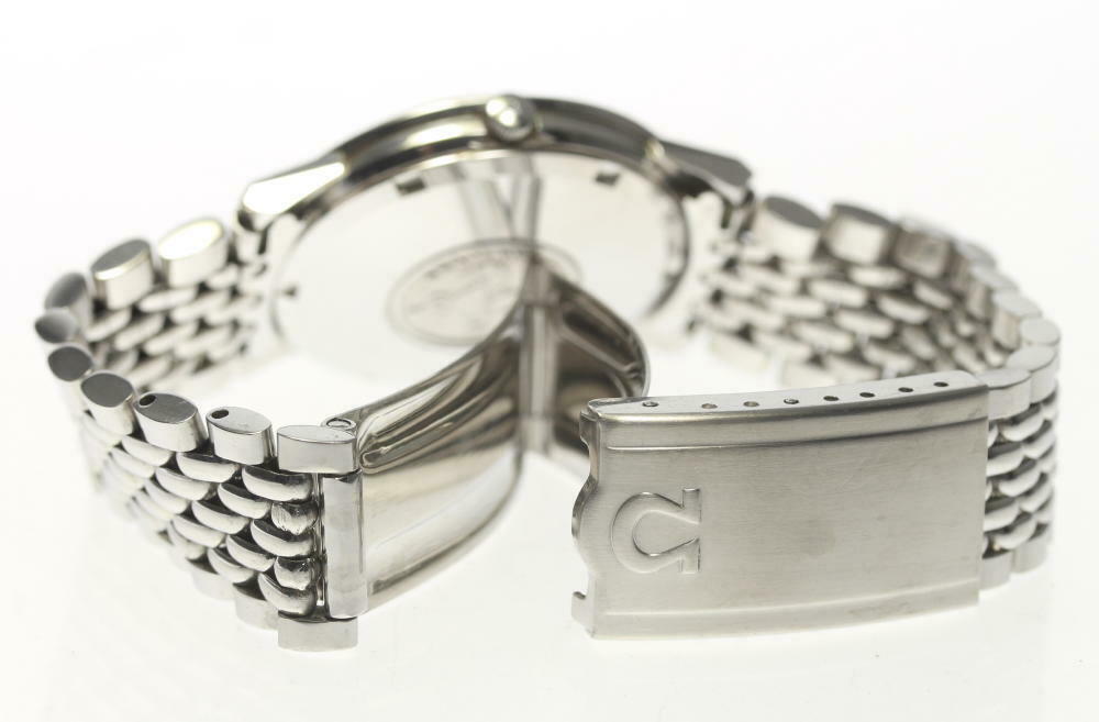

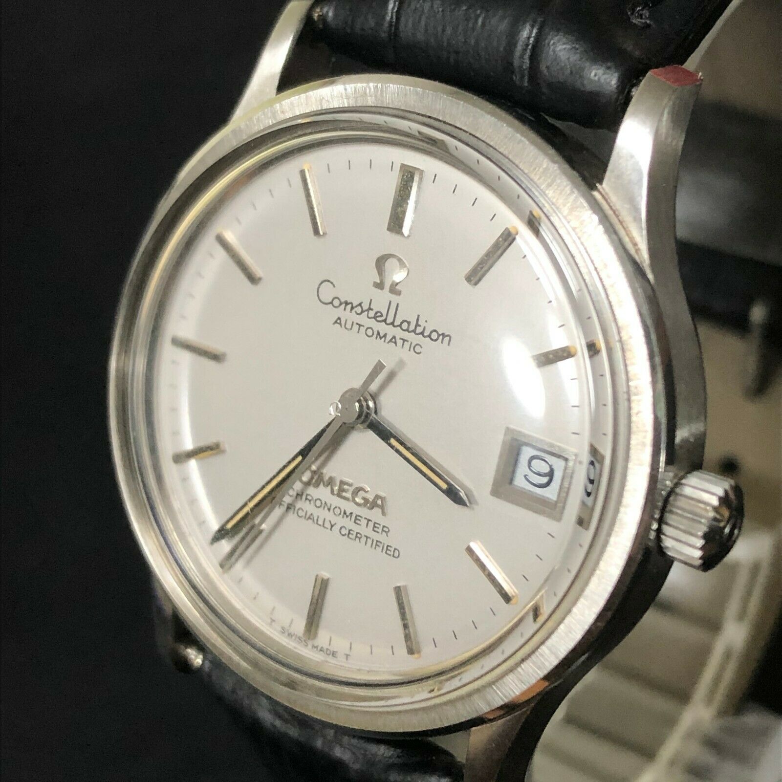

Yes they are genuine an appear to be in original condition.
Search eBay sold listings for value.
3,133
5,561

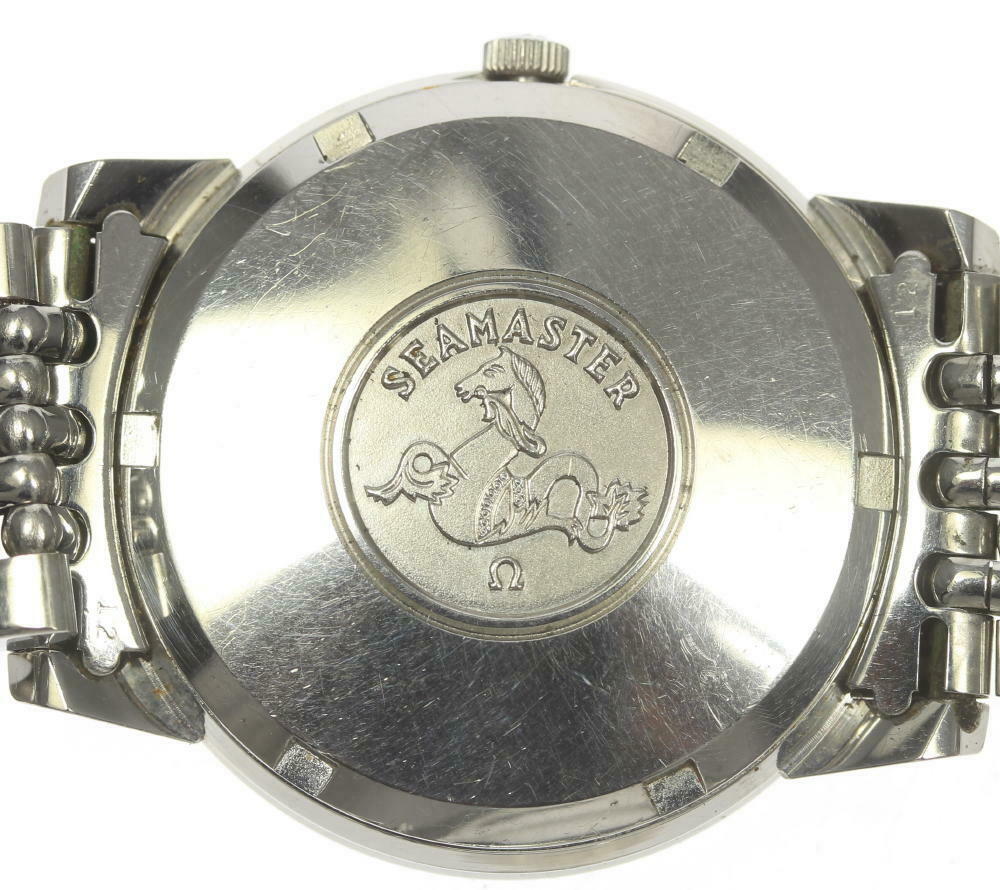

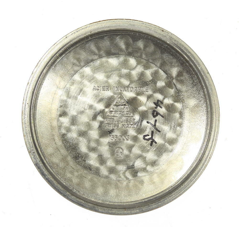

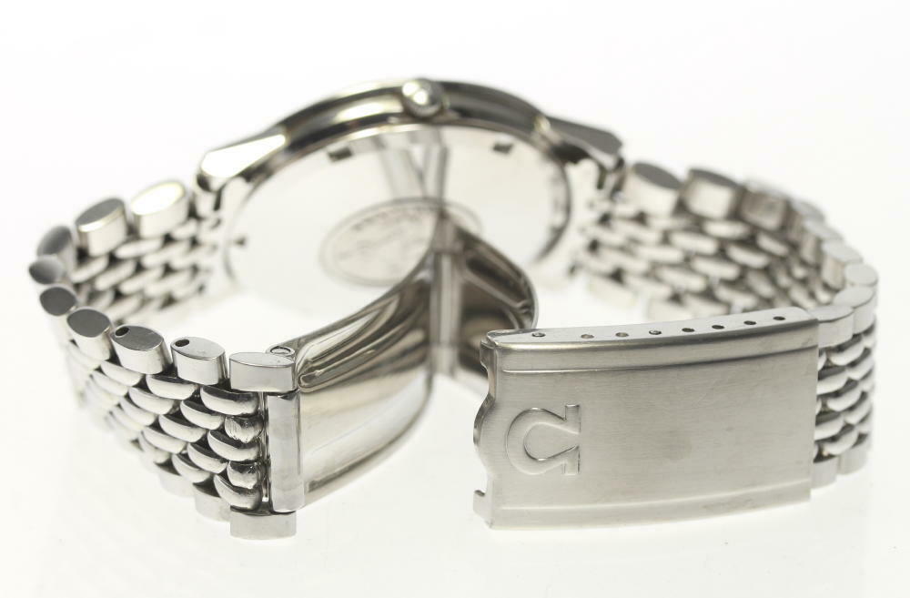

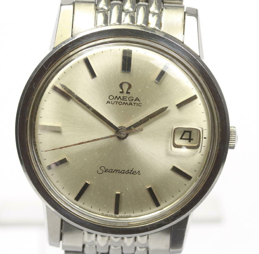

The lower one is fine, that is the finish it always had though the lugs look a bit less sharp than they might be - hard to be certain from those photos. The movement looks clean, uniform in colour and with no screws damaged or missing that I can see.

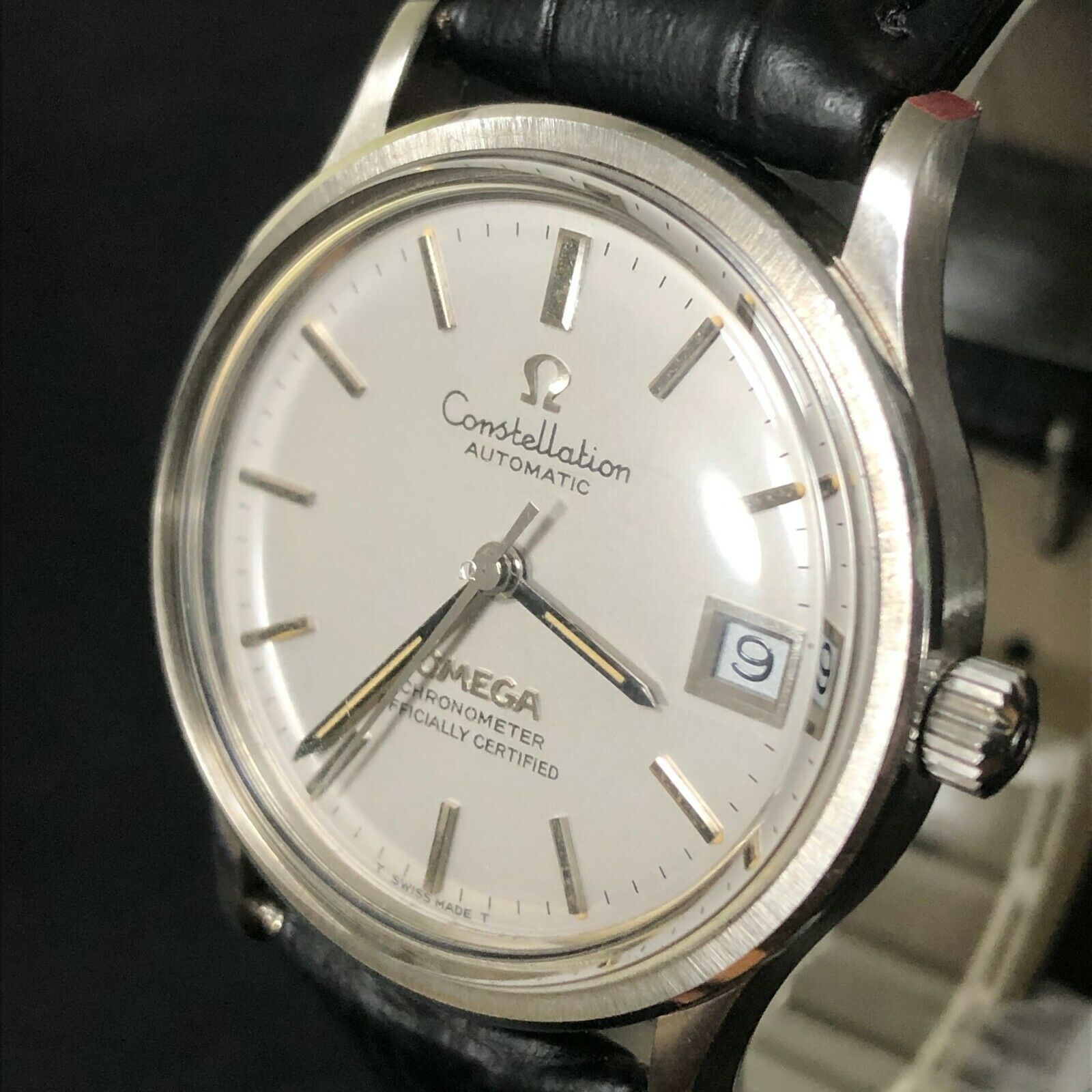

The Constellation may not be the most desirable reference, but the condition certainly seems to be exceptional.
5
I read that the Constellation's movement (1001) is not reliable so I will likely go for a seamaster with a 562 or 565

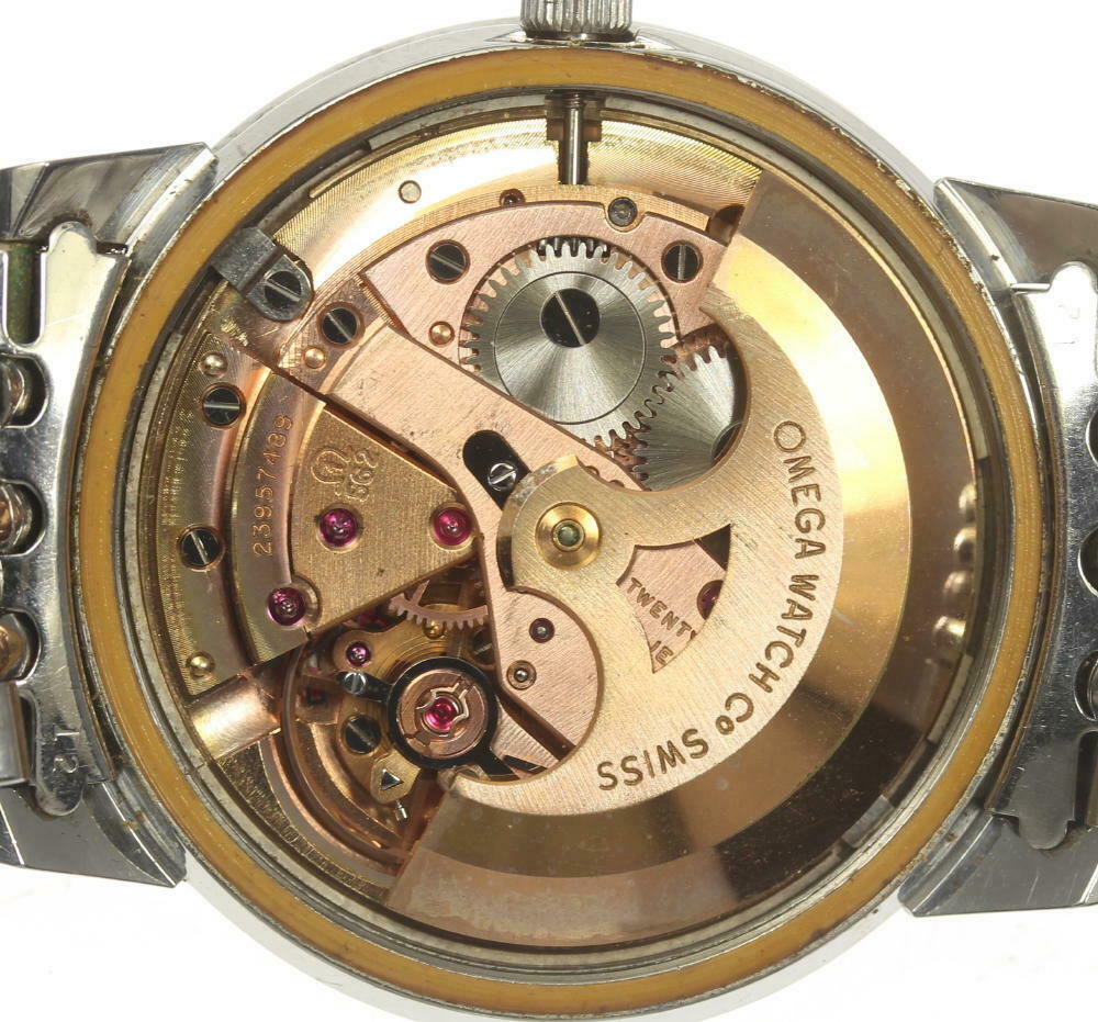

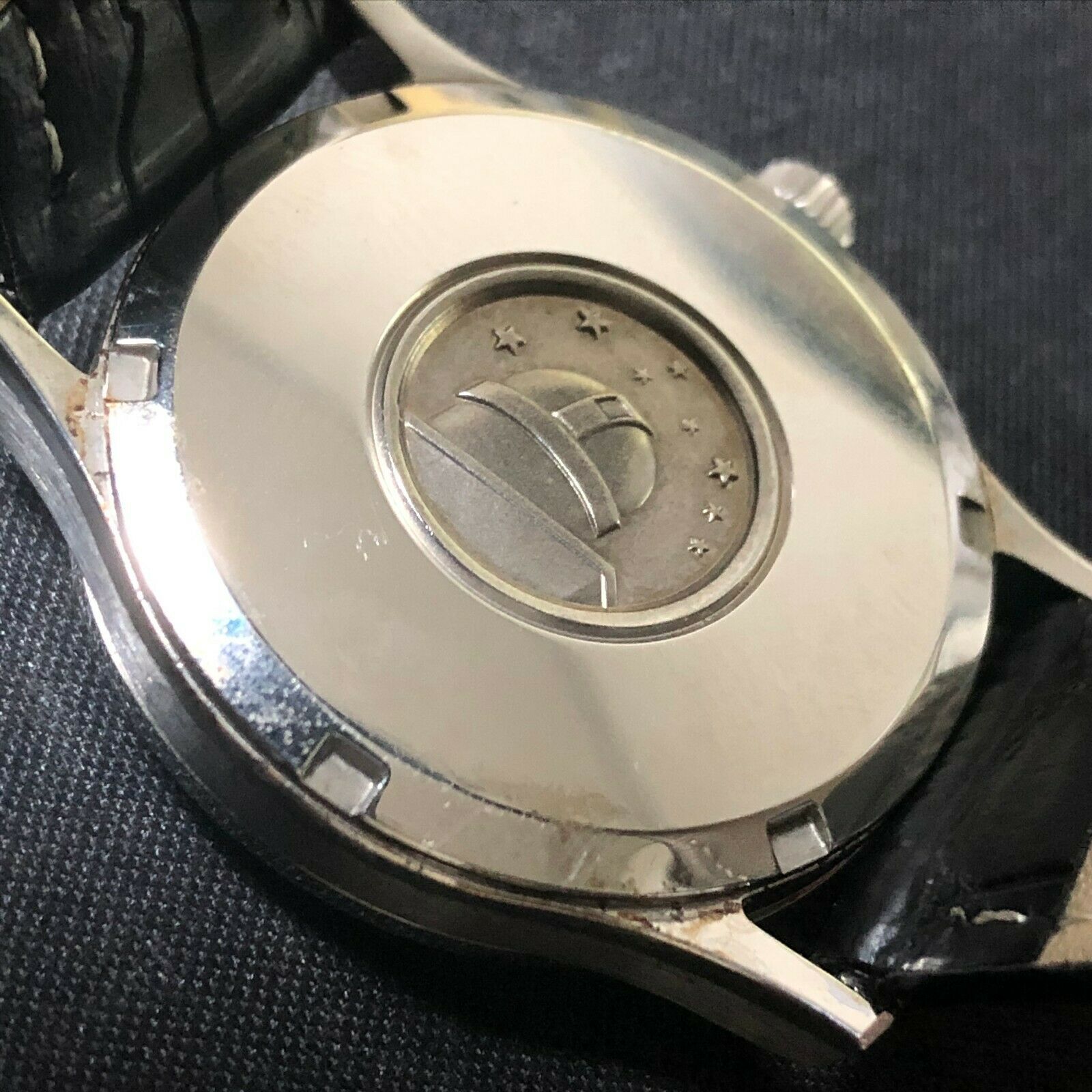

Thank you! I looked into sold listings and found that $550-650 is about the range for the seamasters, so I'll likely wait for a better deal
