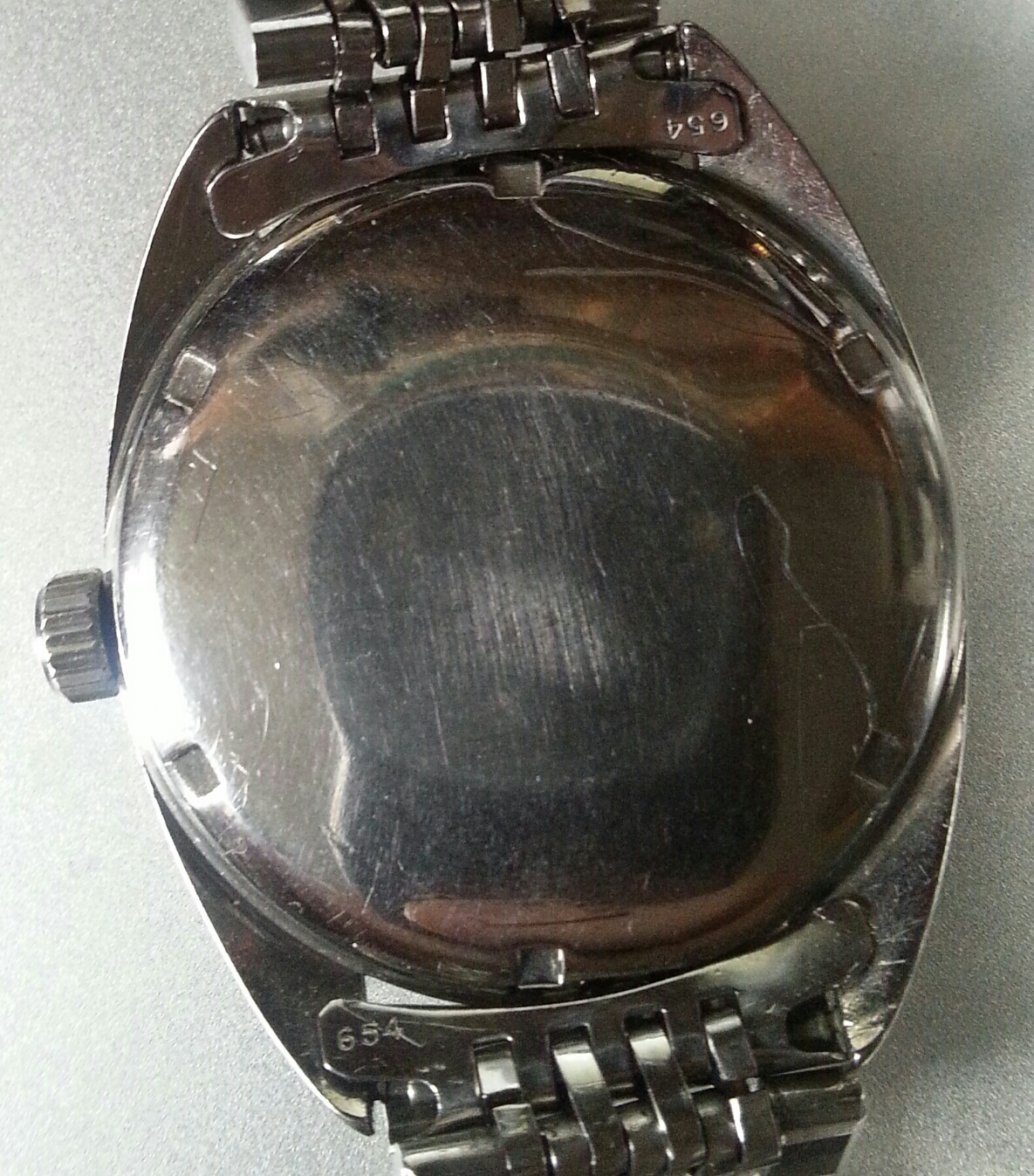

    Was the 168027 case ever used on a lower grade watch? I cant find any reference to a plain (564?) automatic or Genève made in this style in the late 1960s?
    I just got an SS Connie with a 168027 case back but with no logo on the back. I dont think one has ever come off it and am wondering if this back must be non-original? I have seen some Seamasters with pretty minimalist Seamaster logos on the back but I don't suppose Omega would ever have sold the Constellation with e plain back?
    (FWW it has a 1068/654 bracelet)

    Yes. Can you post some pictures?

    (sorry, the orignial photo appeared to be the 168017 back which I bought for this case which doesn't fit! )

    Nothing visible so far is right for a constellation (except the bracelet). Do you have pictures of the movement?

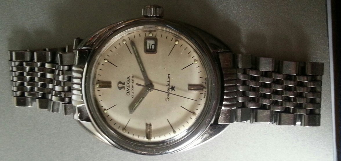

    Does this make it look any more like a Constellation? I figure the movement could look like this and be just a 565 and come out of a a Geneve but it does say 564 and have more adjustments. 20160413_094435-1.jpg
    Do we have any member of the al franken monster accusation brigade prepared to say that this isn't original or is it more probable that it has just lost a logo and had the back polished?

    The movement could indeed come from a Constellation or a Seamaster Chronometer. But it doesn't matter really since everything else, including the case, dial, hands and crown, doesn't represent any part of any Constellation at all.

    The case looks very different indeed. Look at the tips of the lugs for example, they should not end with a point but faceted. The top of the case is also rounded but it should have an edge.

    Yes. Me. The caseback would be paper thin if the "logo" were polished off.

    In my opinion this case doesn't look like any Omega case, and the problem is not just the back.

    Franken is when incorrect parts from different models are put together. Yours is a perfect example.
    And that number is 166.027, which is not a Constellation. It's a Seamaster 120 which does not look like what you have either, so the case alone is already made of different parts - a franken case.
    It's now obvious that Omega movements and case backs can fit different models. Just something you have to learn and always watch out for when looking at a vintage Omega.

    The 166.027 case back all have the seahorse logo at the beginning, but it's a thinly engraved logo and can easily be worn out, or on your case back it's been polished away.
    The rest of your case doesn't look like the real 166.027. Does that ring any bell to you? How about the dial, does it say Seamaster 120?
