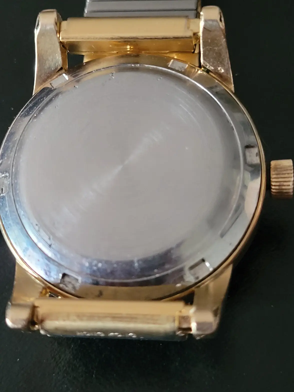

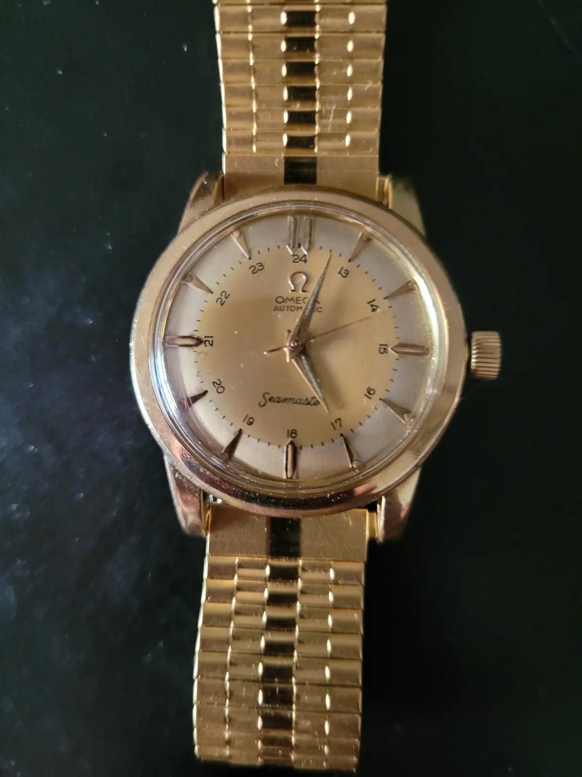

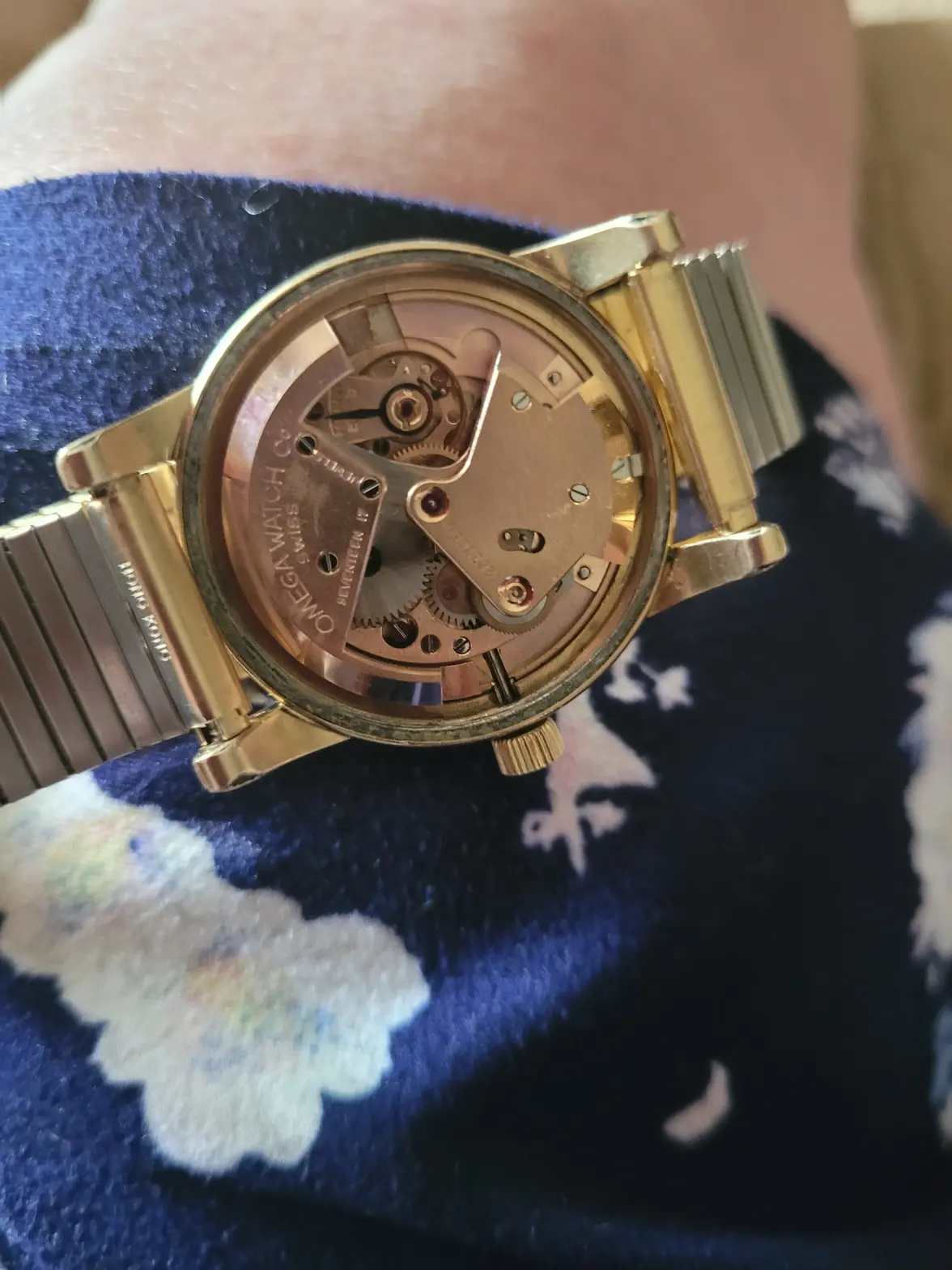

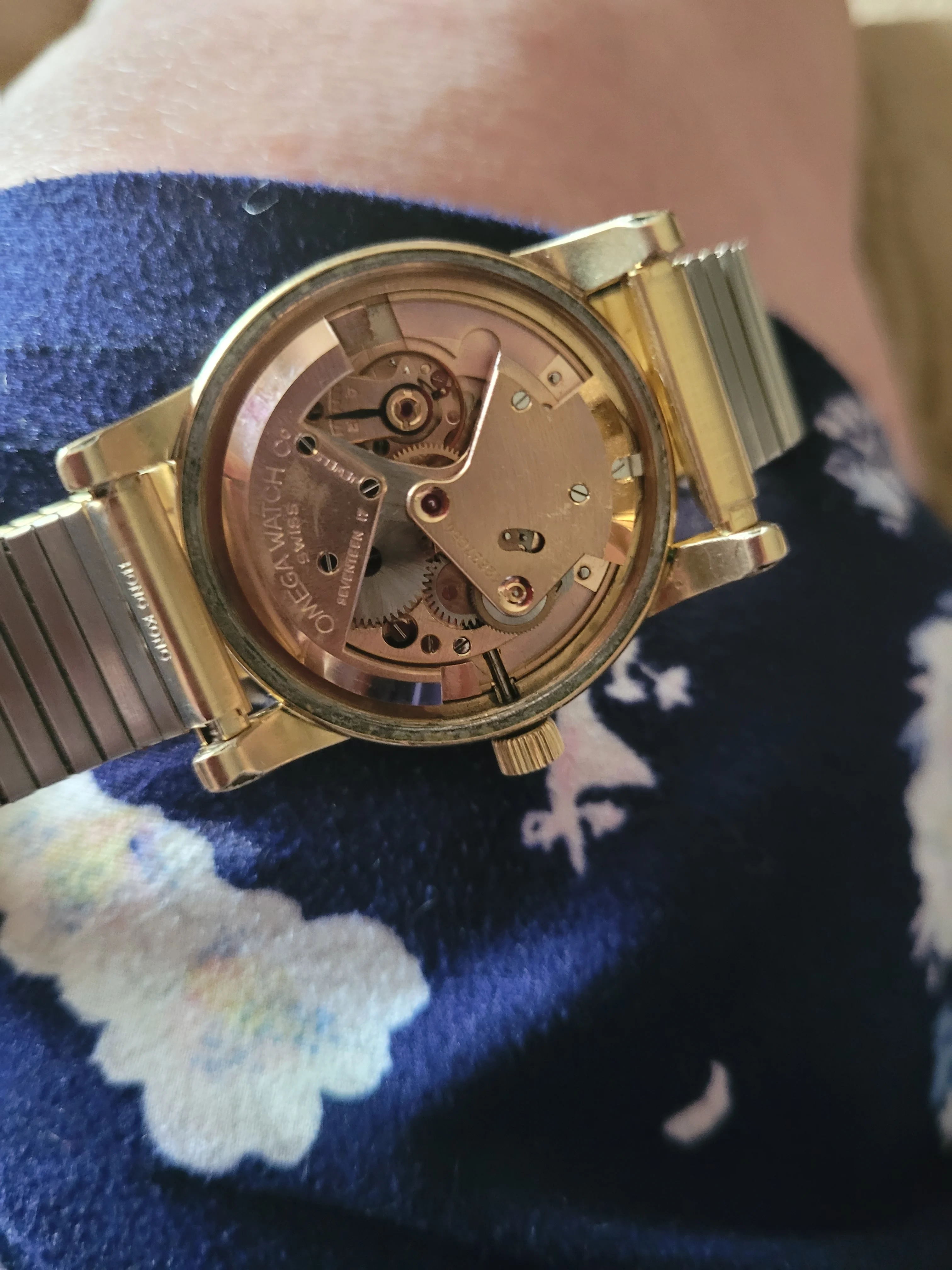

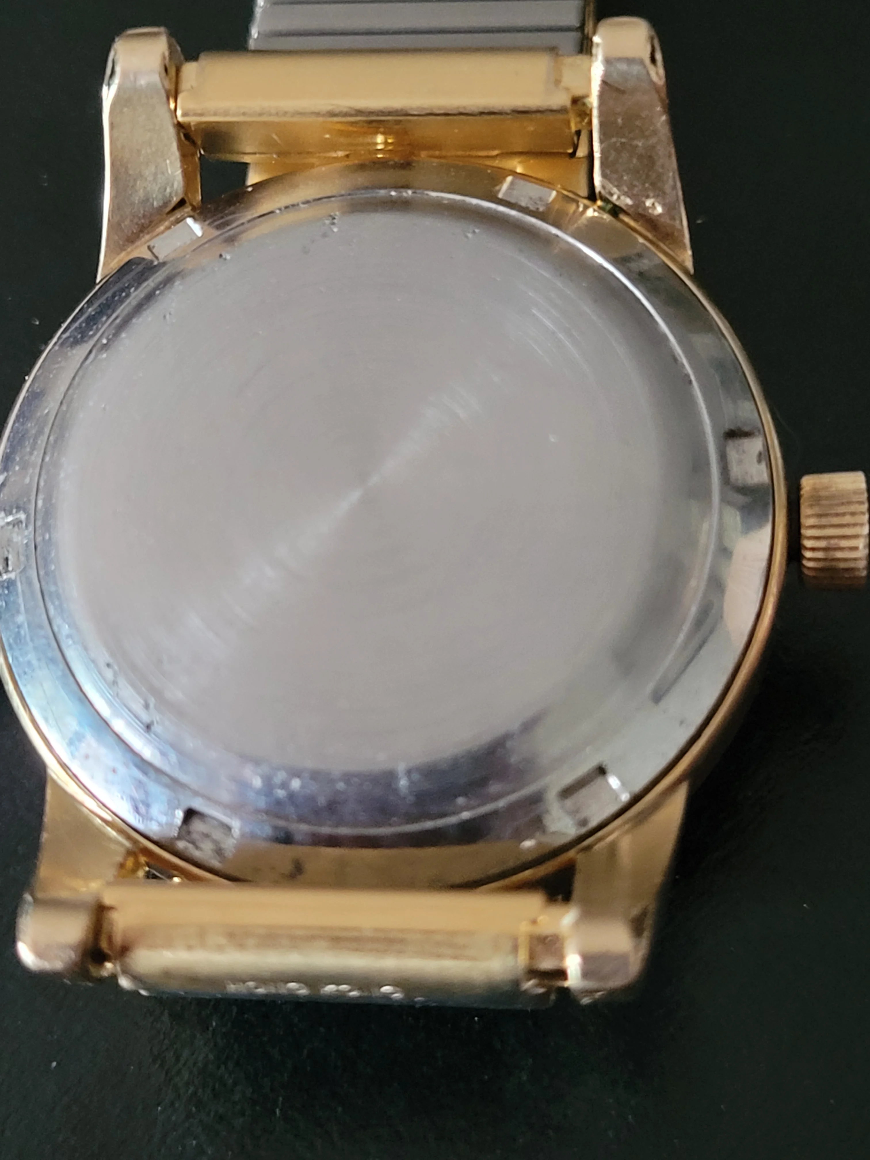

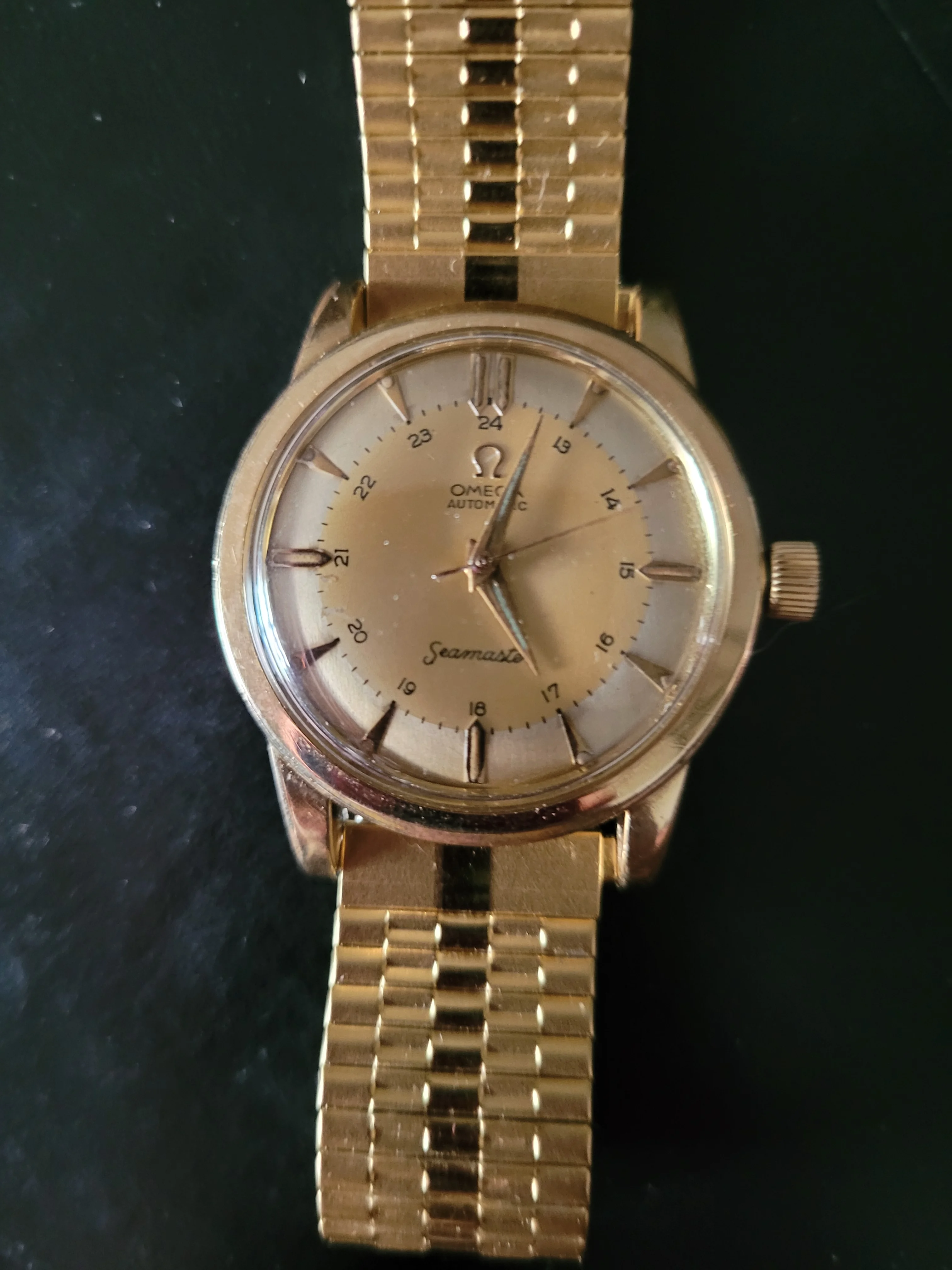

Poorly repainted dial, damaged case. No significant value as a watch. Someone might want the movement for parts.

Thanks for the info...I was told by a jeweler this was a rare watch...which is why im here to get other opinions.

Not sure what you think is repainted...are you thinking the mil 24hr time is the repaint? Omega made special watches that were for the military and not civ sale...I know this watch comes poss from the late 40s 50s and my dad was in ww2 and eventually canada...all opinions welcomed

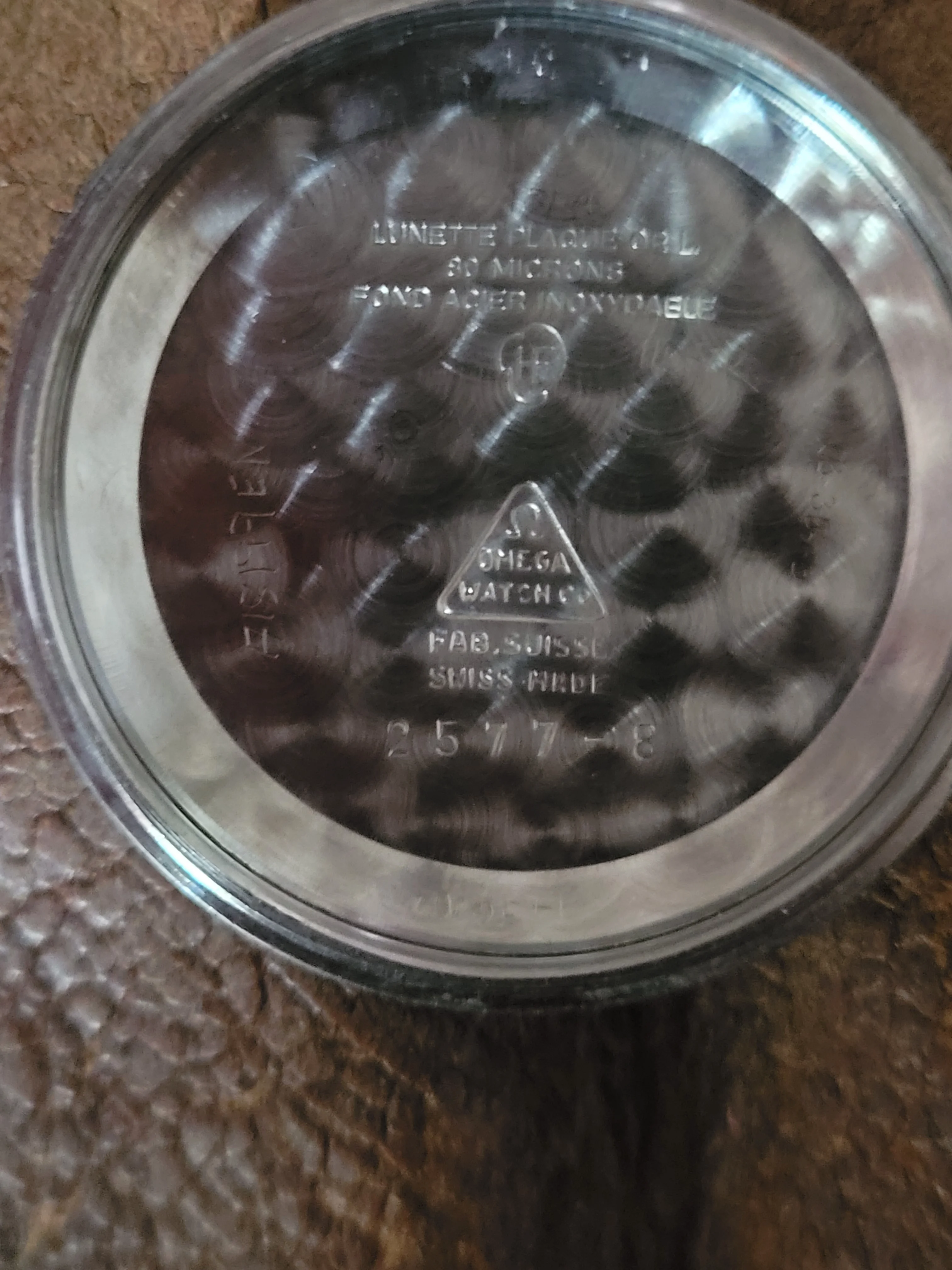

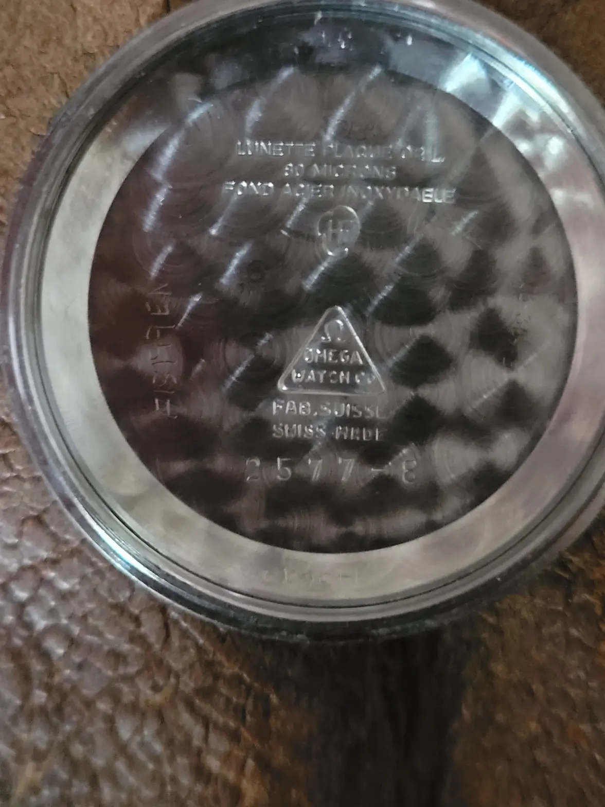

It definitely isn't a military issue watch, 2577s were never made that way so it has been refinished that way. This era of watches had very poor water resistance and moisture intrusion and damage to the dial was very common which is why so many of them have been repainted. This one just isn't repainted accurately.
Still a nice heirloom to keep given the family history but the value is very little as a result of the refinished dial.

The printing is sloppy and uneven. Incorrect fonts. Nothing like a legit Omega dial, and it would be apparent to anyone familiar with Omega dials. We see a lot of repainted dials, and this is well below average, IMO.
I'm sorry that this is bad news for you, but you didn't give any context in your initial post, so all we could do was give you the truth. Next time, introduce yourself and tell us that this is an heirloom with sentimental value, and we will be more gentle.

This is great inormation. Ive been wearing it and am getting the band changed. Your right its a keepsake and I wont go the extra step to have papers. I will however keep the jeweler that got it running again!

Sure the dial was redone in period which happens and it’s gold plated. The first ruins collector value, the second ruins scrap value.
It’s also somewhat evident you did little research yourself as the serial number and a quick google would give you the approx age 😉

Ya I’m far from an expert but the redials get pretty easy to pick up. Leaving alone the script if you study the hash marks you can see it. Doesn’t mean you can’t enjoy it if you like it. I ran into a constellation that had a really nice case and original bracelet with a redial so good I almost missed it. (Like I said I’m not an expert)
I would have worn it but the price was borderline made more sense to get a Seiko or whatever I got.
Anyway if you like it wear it.

Your family member had the dial done to his taste. Embrace it.
Ditch the band and put on a leather strap. The "stretchies" have springs that press the ends against the internal side of the lugs wearing through the plating. They destroy the watch every time it's handled.

This is what I was expecting from joining this form lots of great information. I have a leather strap to change out. I expect my Father bought this trusting the seller and beleived he had a gem. With all the information at our finger tips now and the ability to share that information..i can wear this watch with a smile now. Thanks for all the great sharing!
