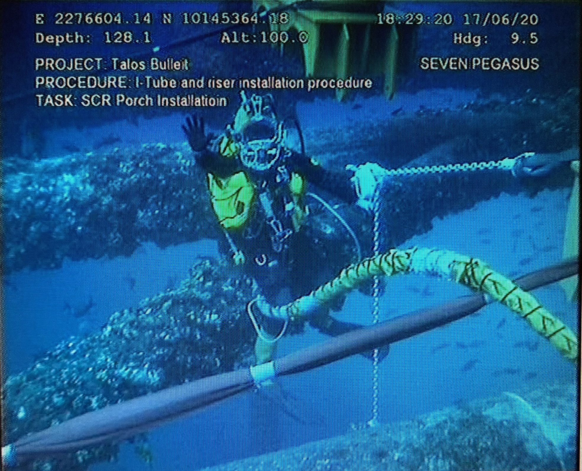

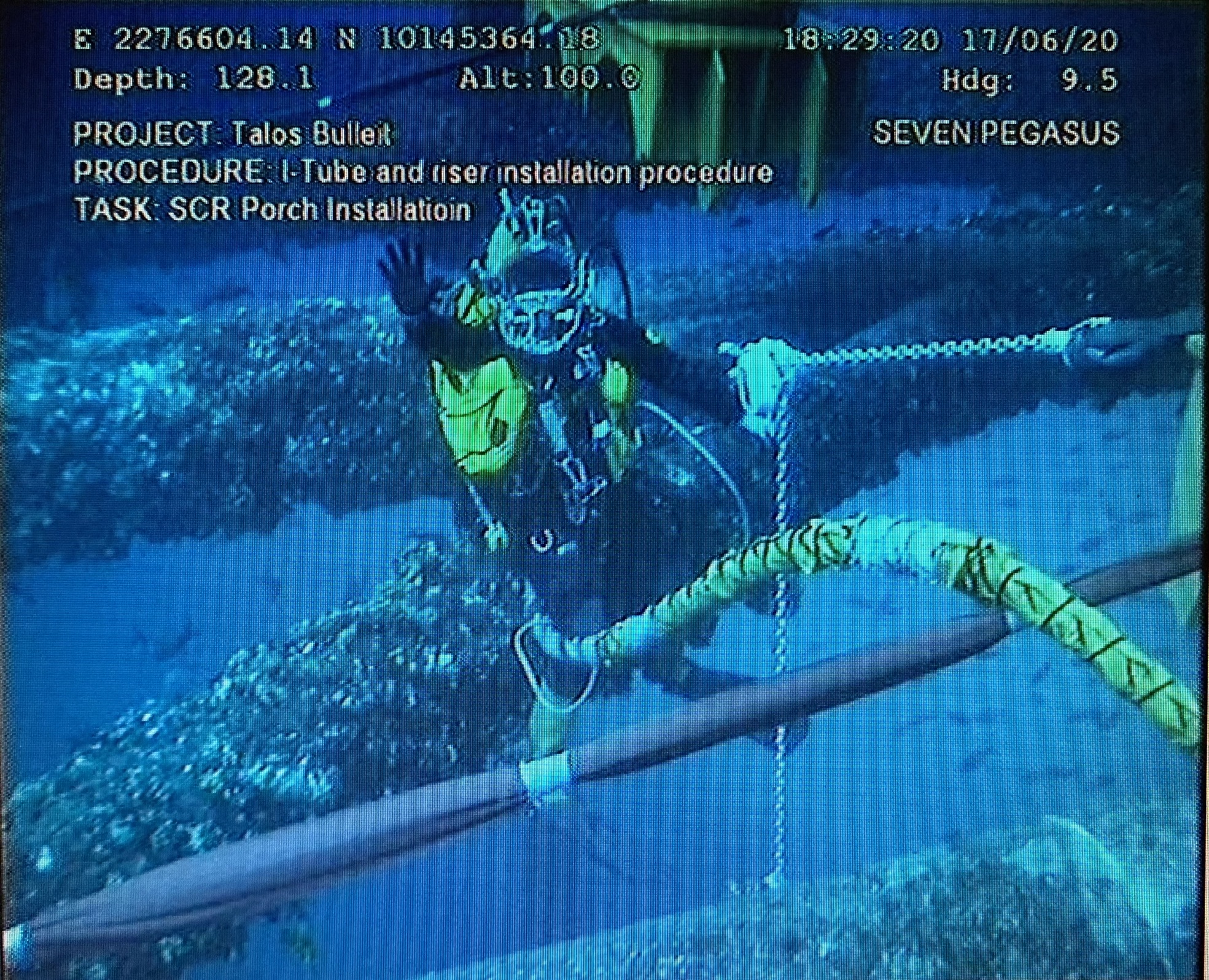

I’ve worn my planet ocean for 100’s of commercial dives, here she is in the Gulf of Mexico, there is still plenty of seamaster and sea dwellers being used as intended.
The Manual valve plus is when it’s closed there’s no chance of flooding due to lack of maintenance which a huge amount of HEV watches are liable to if the seals haven’t been changed and looked after enough as they pick up a lot of dirt and dust in daily use.
To the poster who hates the HEV, don’t buy dive watches ‍♂️ They are actually designed for us and we like them!
Are you wearing the watch inside the suit?
Inside a bell? Inside the deco chamber? I’m curious as to the profile that exposes the watch to He under pressure.

Yes it’s worn under my hot water suit and in the chamber and bell, we stay in the system for upto 28 days, the watch is only exposed to the helium in the living chamber and the bell as the atmosphere is pressurised using the required gas mixture which is mainly Helium.
