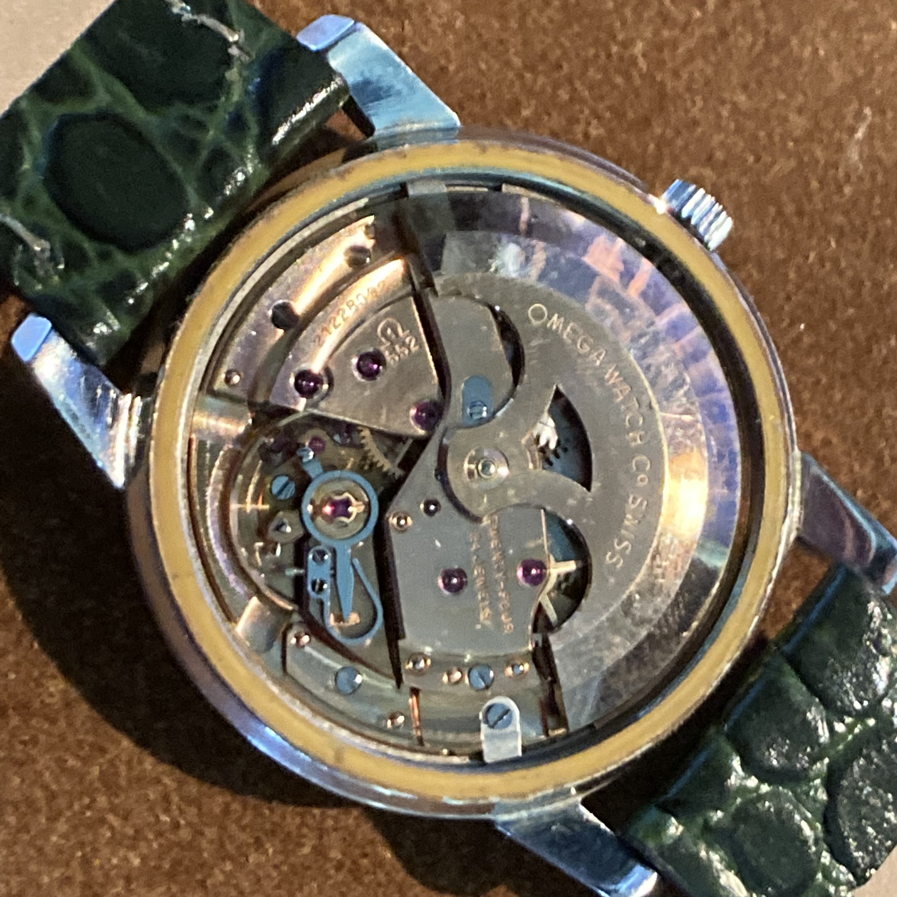

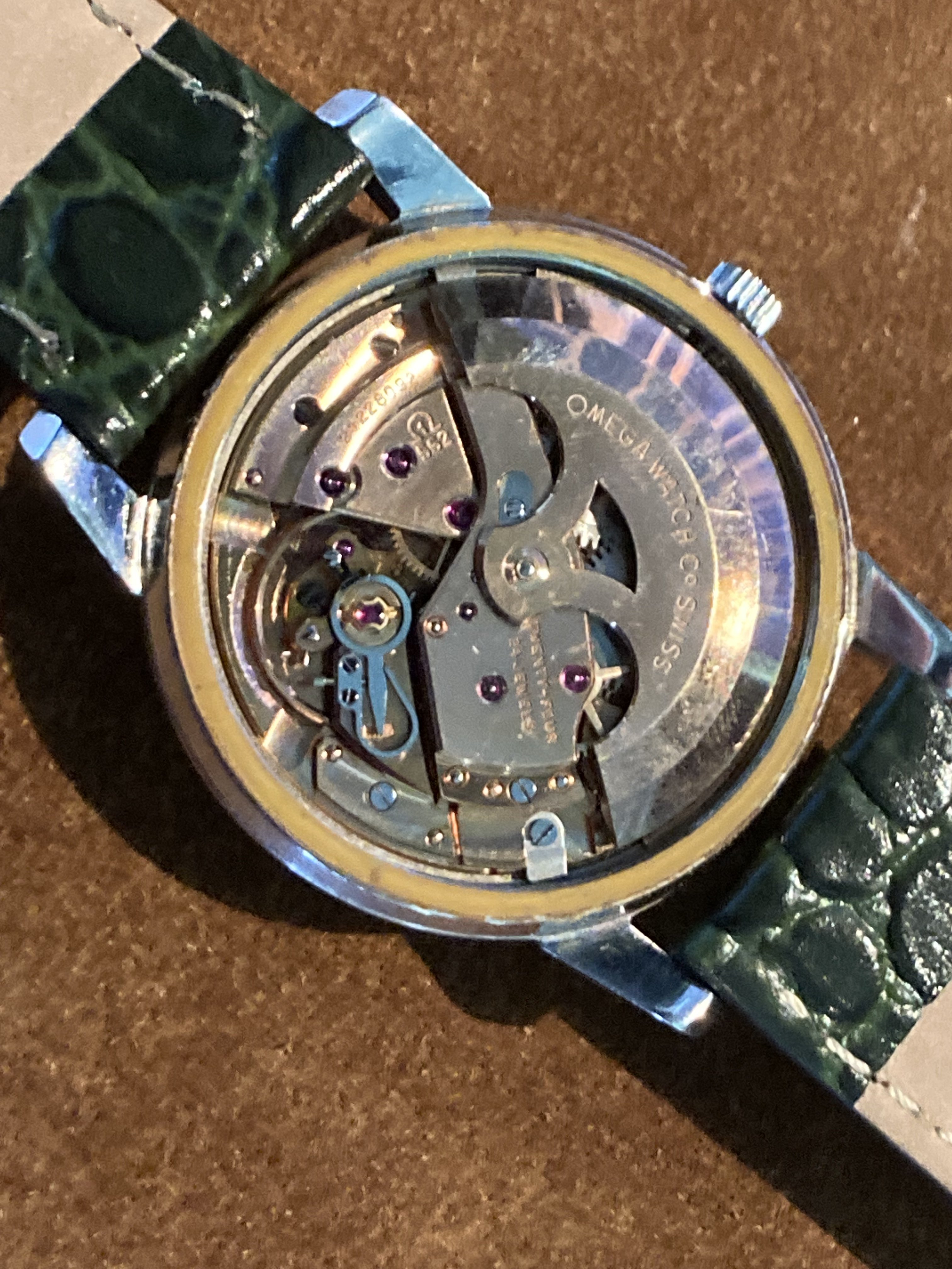

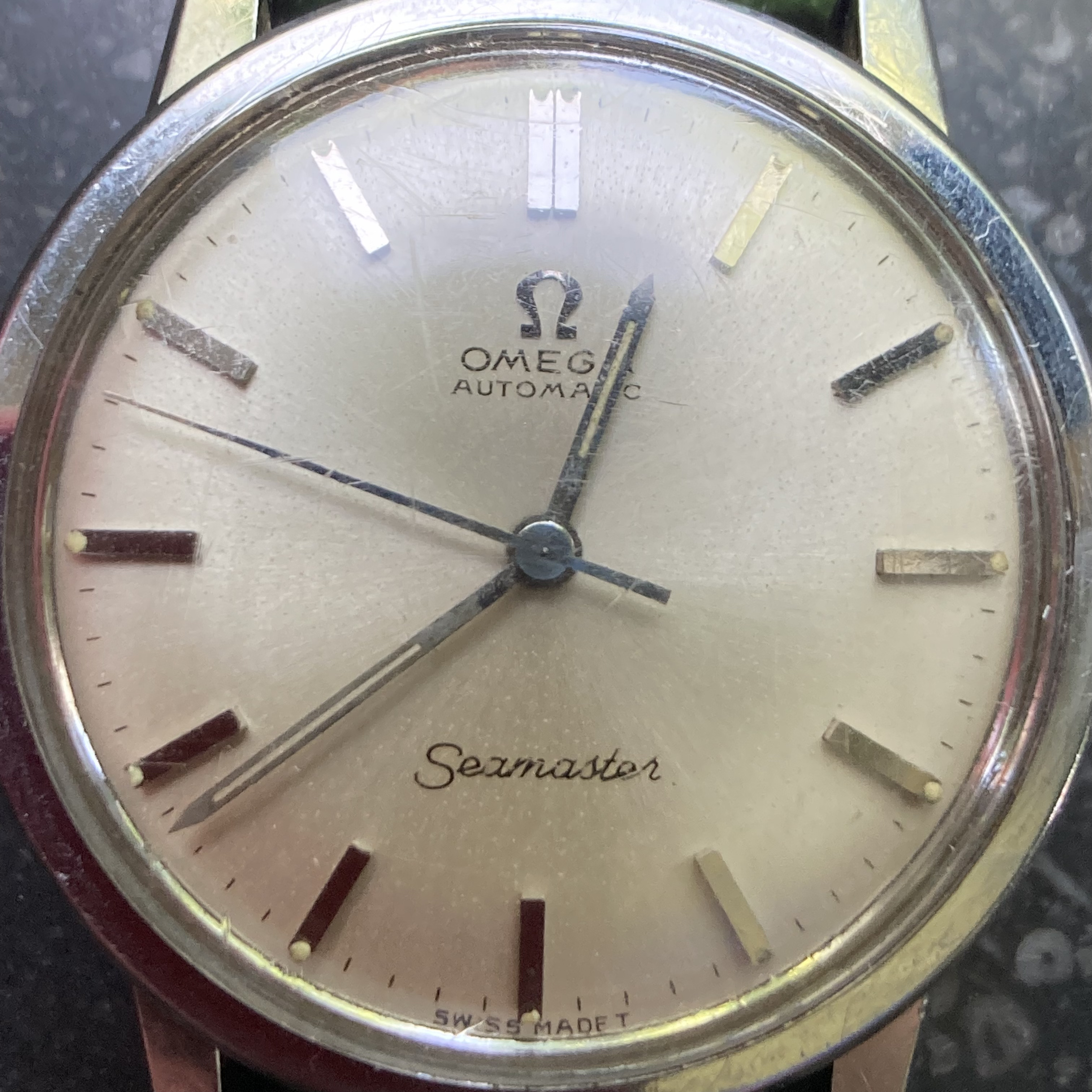

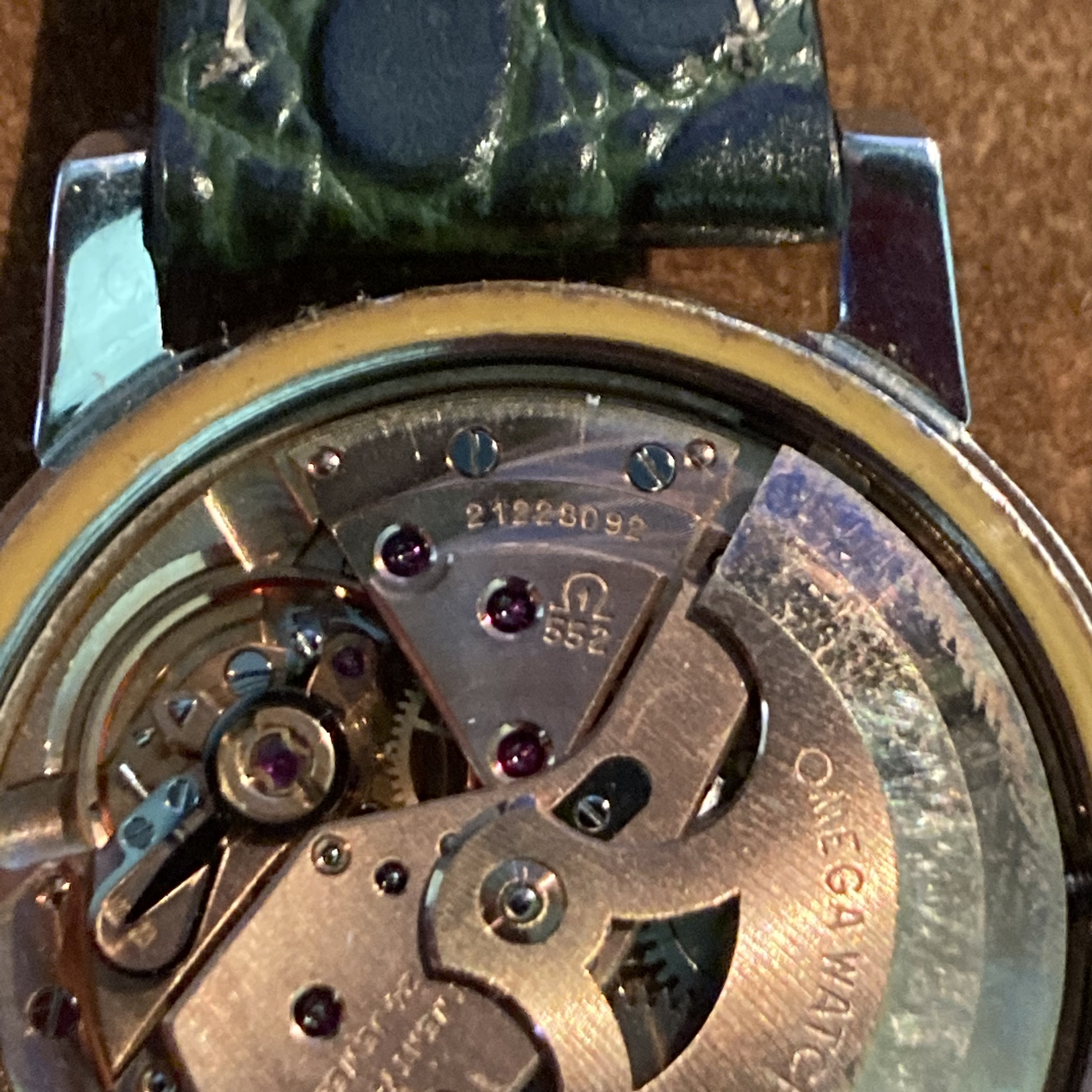

Hi all,
Just joined "the club" and thinking about buying this Seamaster. I have my doubts though considering the movement. There seems to be wear and tear that I am not sure about if this is normal. Any advice?
Thanks for your help!
1,372
2,001
Movement is in very rough shape, dial is sus (picture quality is too poor to tell whether it's a redial for sure, but I'm not optimistic). Hold your money for a better example.
620
4,971
Yeah, sorry for the quality of the pics. copy of a copy🙁. This was the best I could do. Thanks for the feedback. I'm told the watch has a timing variance of roughly 55 secs/24hrs
379
328
i would definately try to find a better example, crown is not original, dial looks odd (but difficult to see due to the pictures) etc..
with some patience you will find a good example
5,631
5,815
That could be one of a few things:
1. Not serviced
2. Serviced and not adjusted
3. Serviced and worn out
As for accuracy, Omega's specs are -2 to +10 in two positions (dial up and crown left) at full wind and no more than 20 secconds difference in these two positions.
Not necessarily knowing what "timing variance" means, it might or might not be to spec.
I think this one will be one of those where the price determines whether you'd want it for daily wear. I'd say a service after purchase is guaranteed here.
3,133
5,569

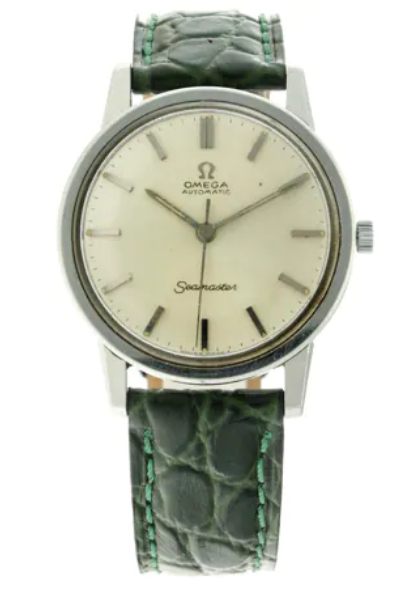

Even with this poor photo, the dial wording looks all over the place to me.
9,588
27,706
I don't think the movement looks too bad. There are signs of a wobbly rotor (tracks on the movement where it has dragged a bit + wear on the rotor itself) and there are signs of some neglect on the rotor (likely poor handling when it has been disassembled), but nothing horrible or unsalvageable, IMO.
The dial is hard to evaluate - a lot of issues could be hiding, but the hands seems to possibly have lost their lume. @Plees, how much do you intend on spending on your first watch?

@Plees Move on. It's crap. The watch has a dirty movement, wrong crown and I'm pretty certain the dial is repainted - look at how the word Automatic rises and falls at the end. A project watch is not the way to start a vintage collection unless it's something special, which this one isn't. For some reason new collectors often think they will get a bargain if they buy a cheap watch and get it fixed, but they invariably end up with a lot of grief and an expensive mediocre watch. It is actually cheaper to be patient and spend a bit more on something original in good condition. I am far from the most knowledgable person on here but I promise you that in a year you'll be glad you passed on this.

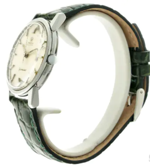

No doubt this one is difficult to evaluate with this pictures so good luck to you @Plees with your purchase
As mentioned above a lot of possible risks
My gut feeling says the dial is not repainted.
Looking at the facets the case seems to be in very good condition.
Reference should be 165.003
Waiting for pictures... 😀

I will be very happy if I am wrong about the dial being repainted. Hope it turns out ok.

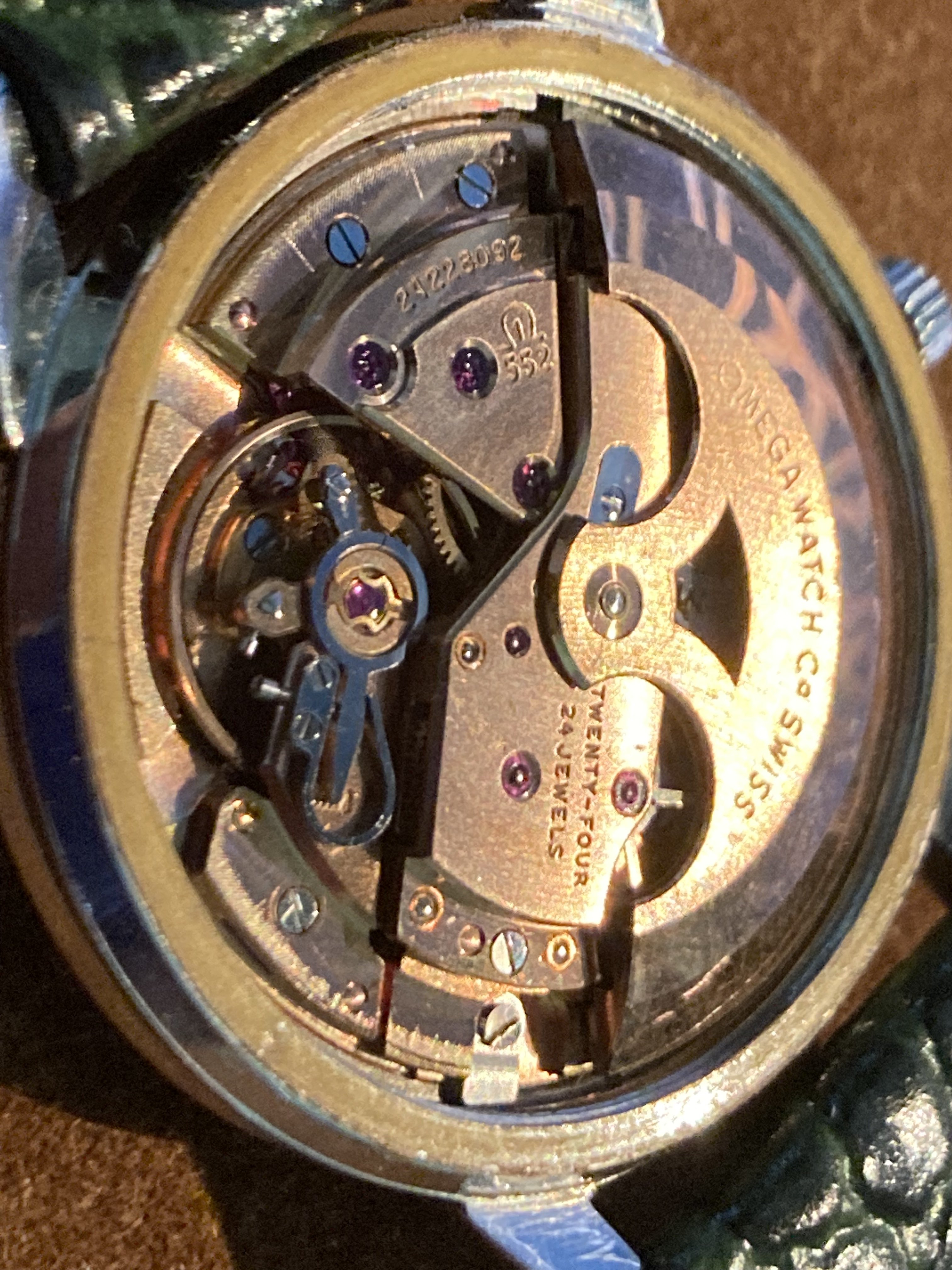

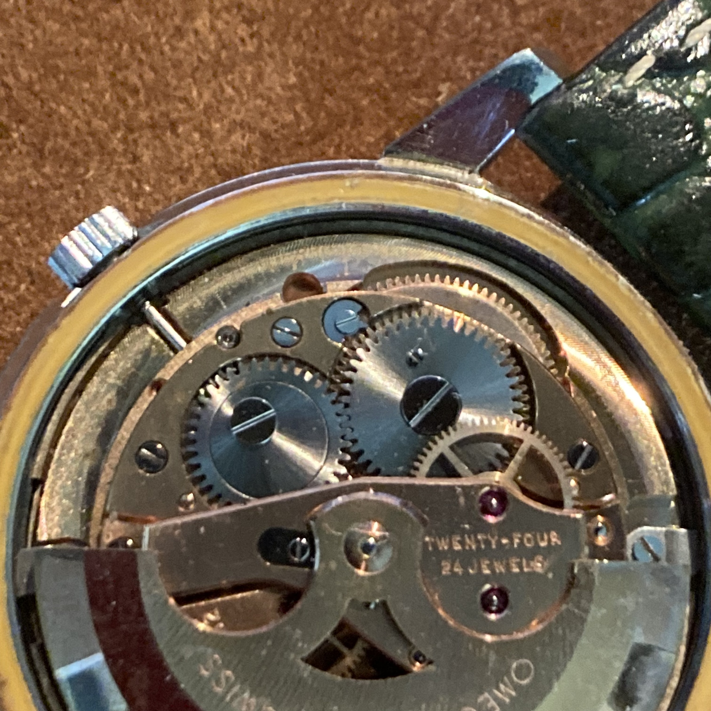

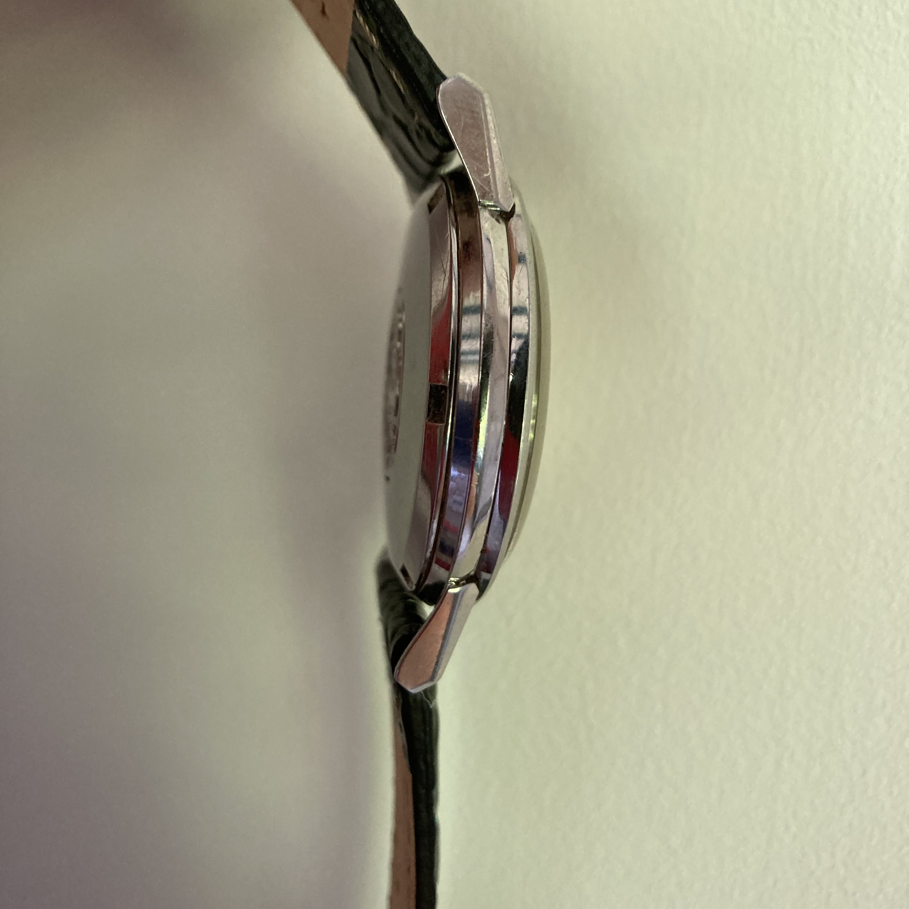

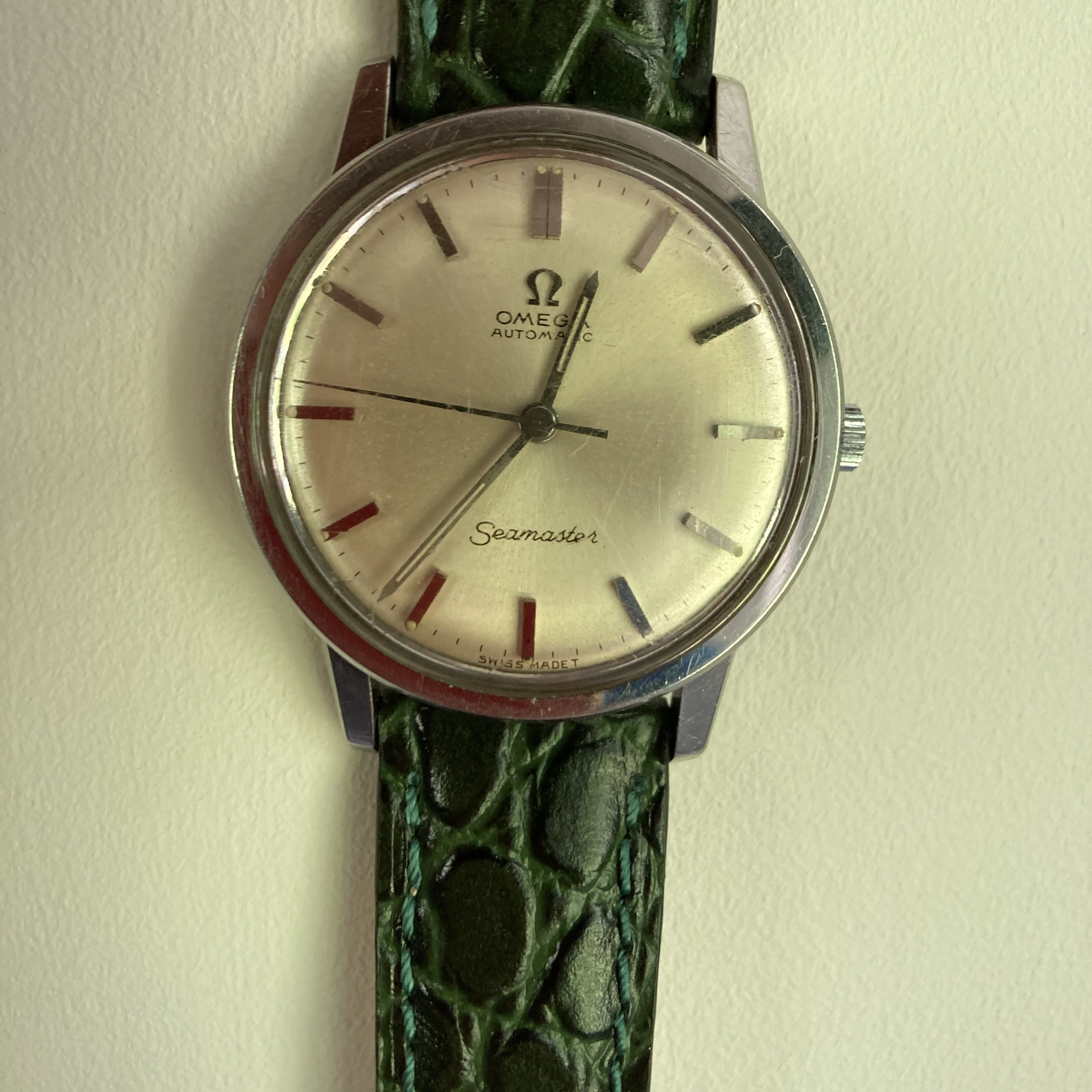

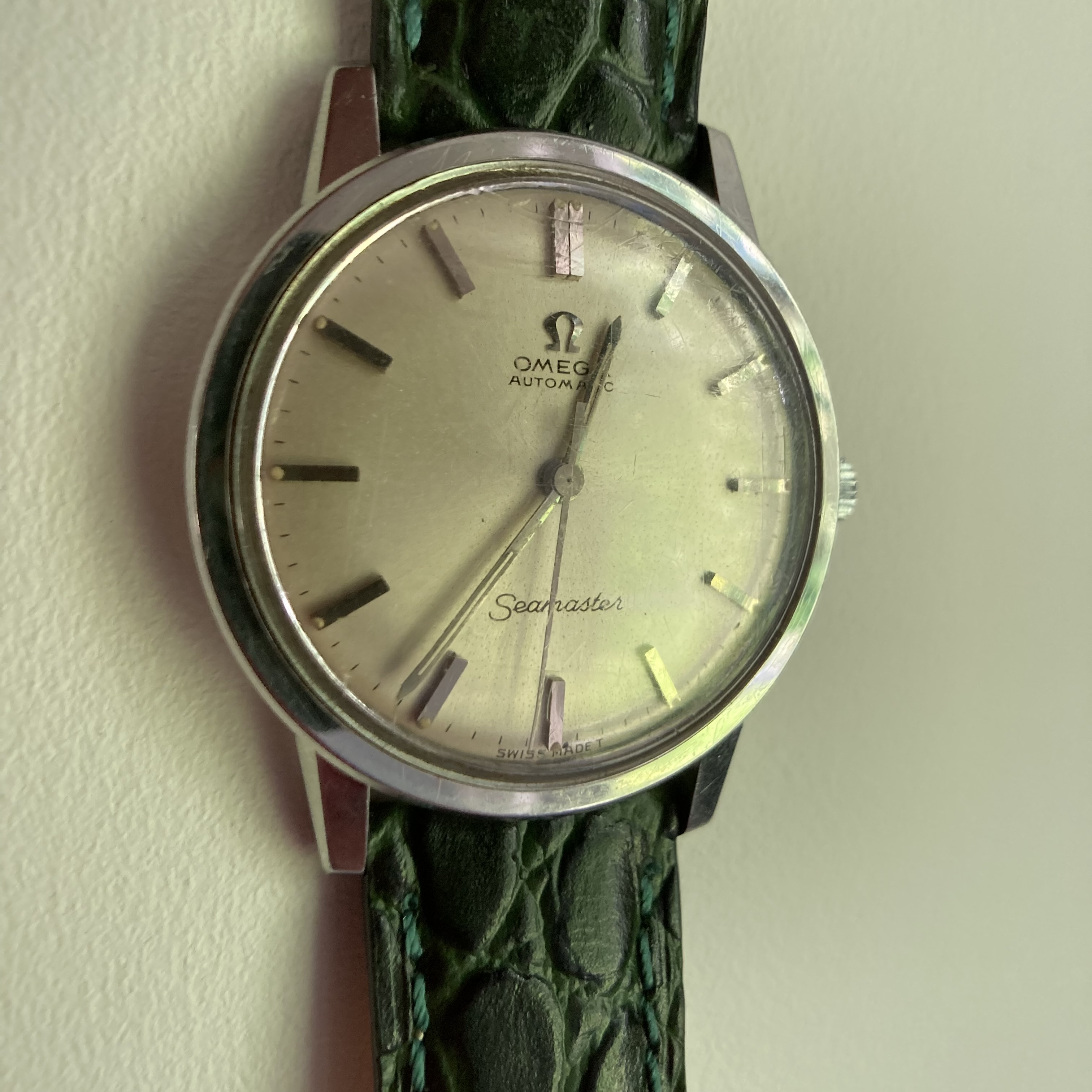

Hi all, just received the watch and for me it turns out better than expected. Of course the crown is not original, but as far as I can see everything else looks good. I have taken some better quality pictures so you can all have a look.
