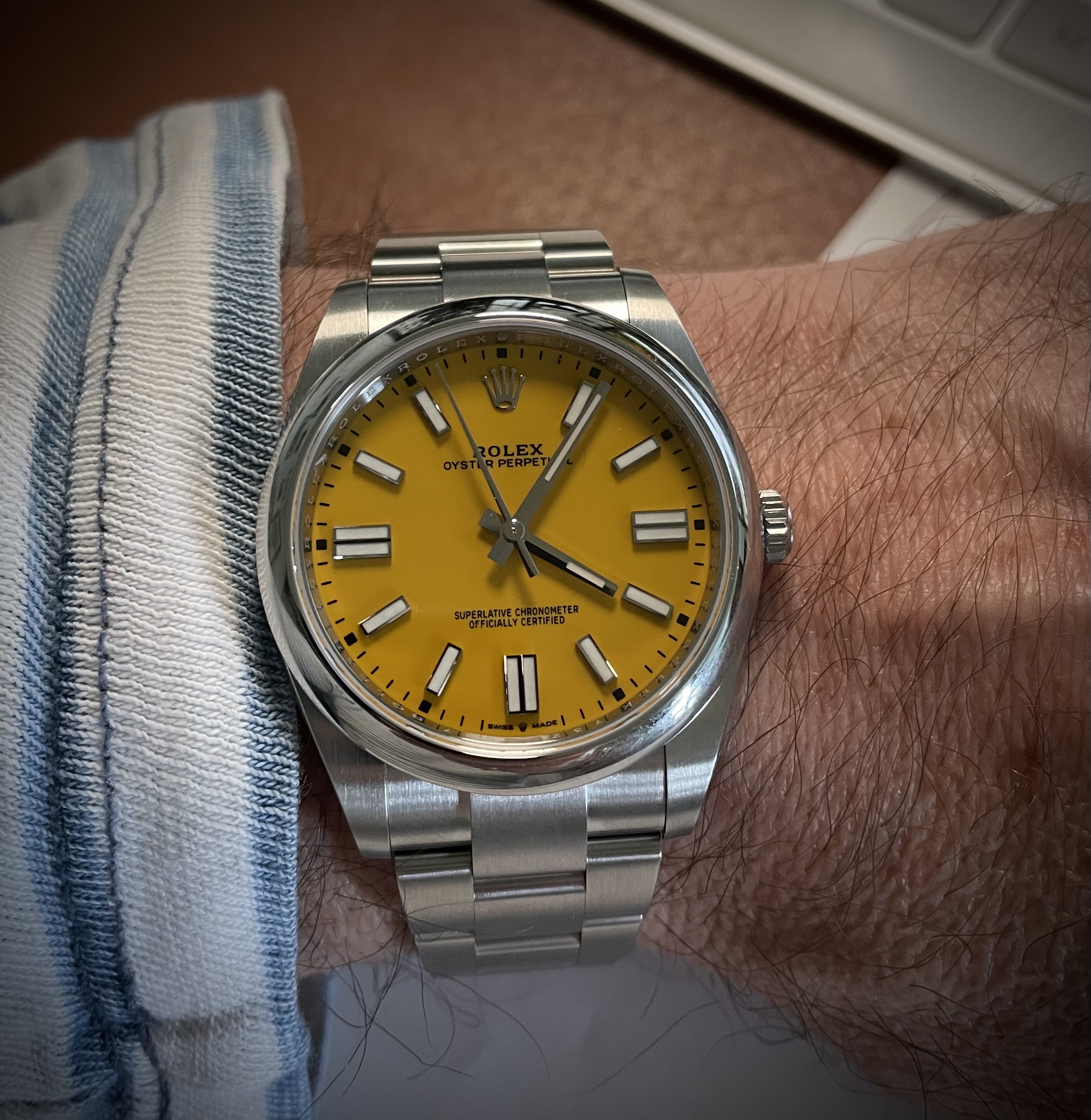

And nothing wrong with some color along the way to break up the monotony.
It's always been somewhat of a factor, but I also note the trend of customizing watches to suit the individual buyer. I expect that customization of watches, both "design your own" and aftermarket modifications of standard models will continue to grow.

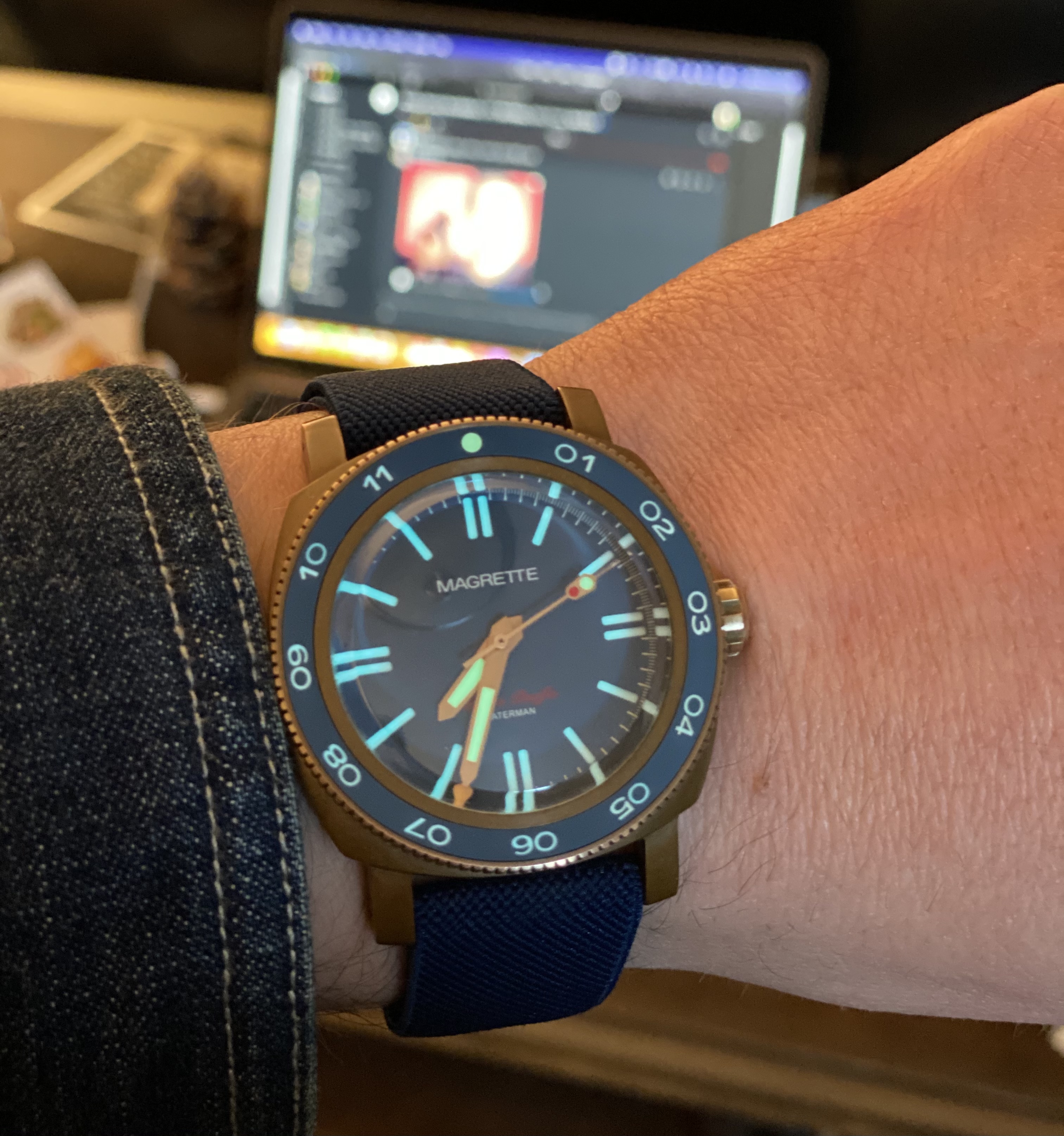

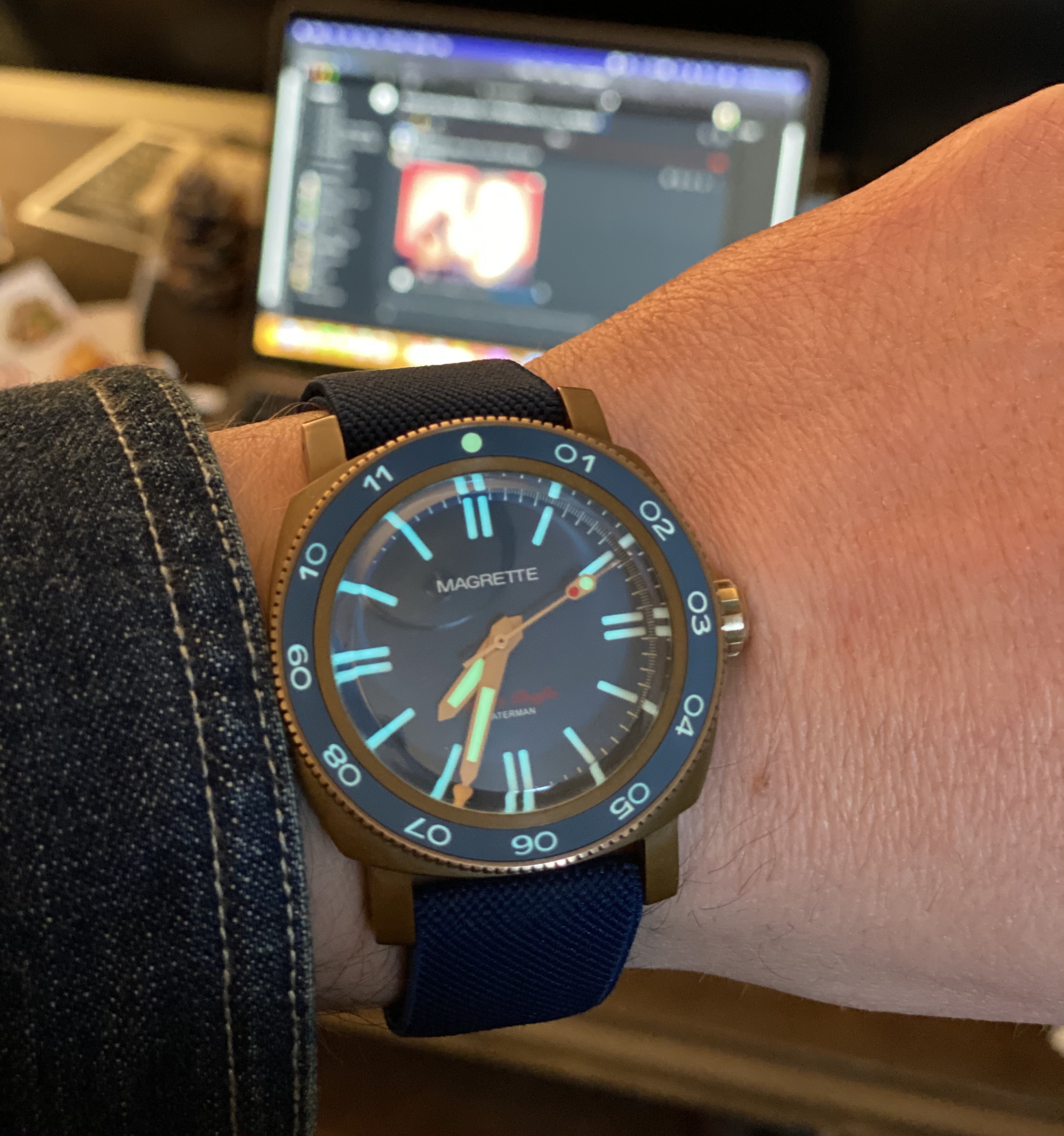

Hello all. Strange my first post on OF (after a year or so of lurking) is for Magrette! I have this model from back when it was a limited release a couple years back and am wearing it today. I don’t know about your wrist size but I feel it wears very well (I’m a 7” wrist). Here’s mine.

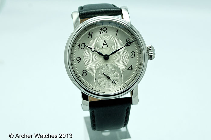

Here's a pretty cool watch from a small independent in Canada. Pretty sure servicing would not be a problem either.
