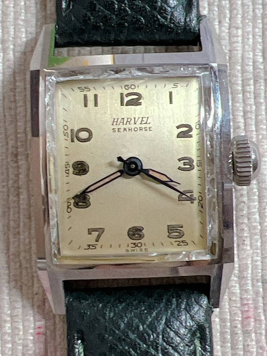

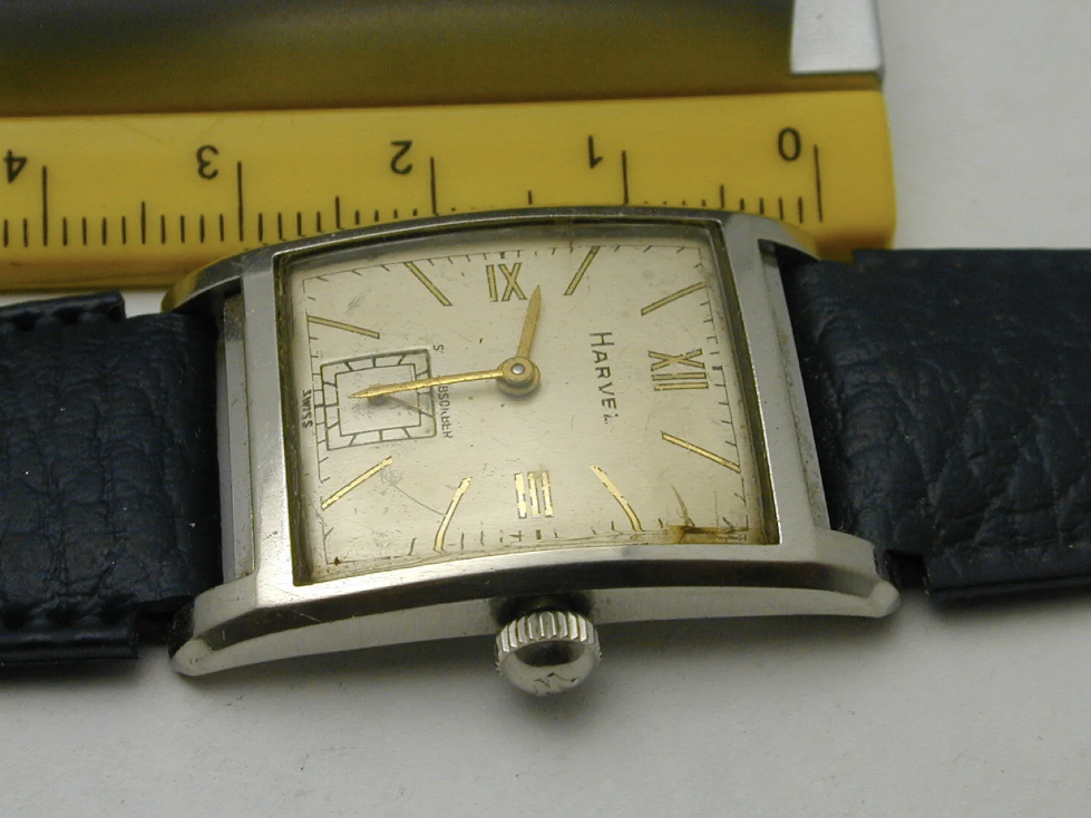

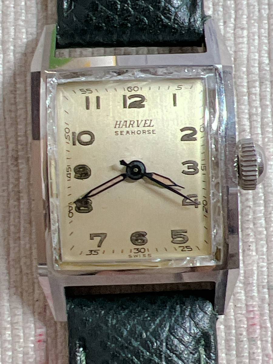

Hi everyone,
I just bought this watch as I really liked its look and it appears to be in excellent condition. Not really sure, but the crystal might be cracked. Look at that chubby second hand though!
Wasn't able to find out much about Harvel, and it would not surprise me if this watch was made by another company.
Has anyone seen this case construction before? It seems to be made out of several different parts. I guess it's supposed to make the watch water resistant. Any thoughts?
Once I have the watch I will take some additional pictures but was hoping someone has some info already.
Thanks!

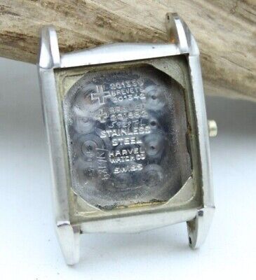

I came across another eBay auction for a Harvel water resistant case that has several patents inside the caseback. This again appears to be a slightly different construction (no tabs).
Searching for the patent numbers that can be seen inside the caseback lead me deeper into the rabbit hole to this Italian website. This forum post explores a rectangular Nivada watch with a water resistant case. This case uses the same patents and seems to have been made by the same company as the Harvel case above. The case company seems to have been specialized in water resistant casing.

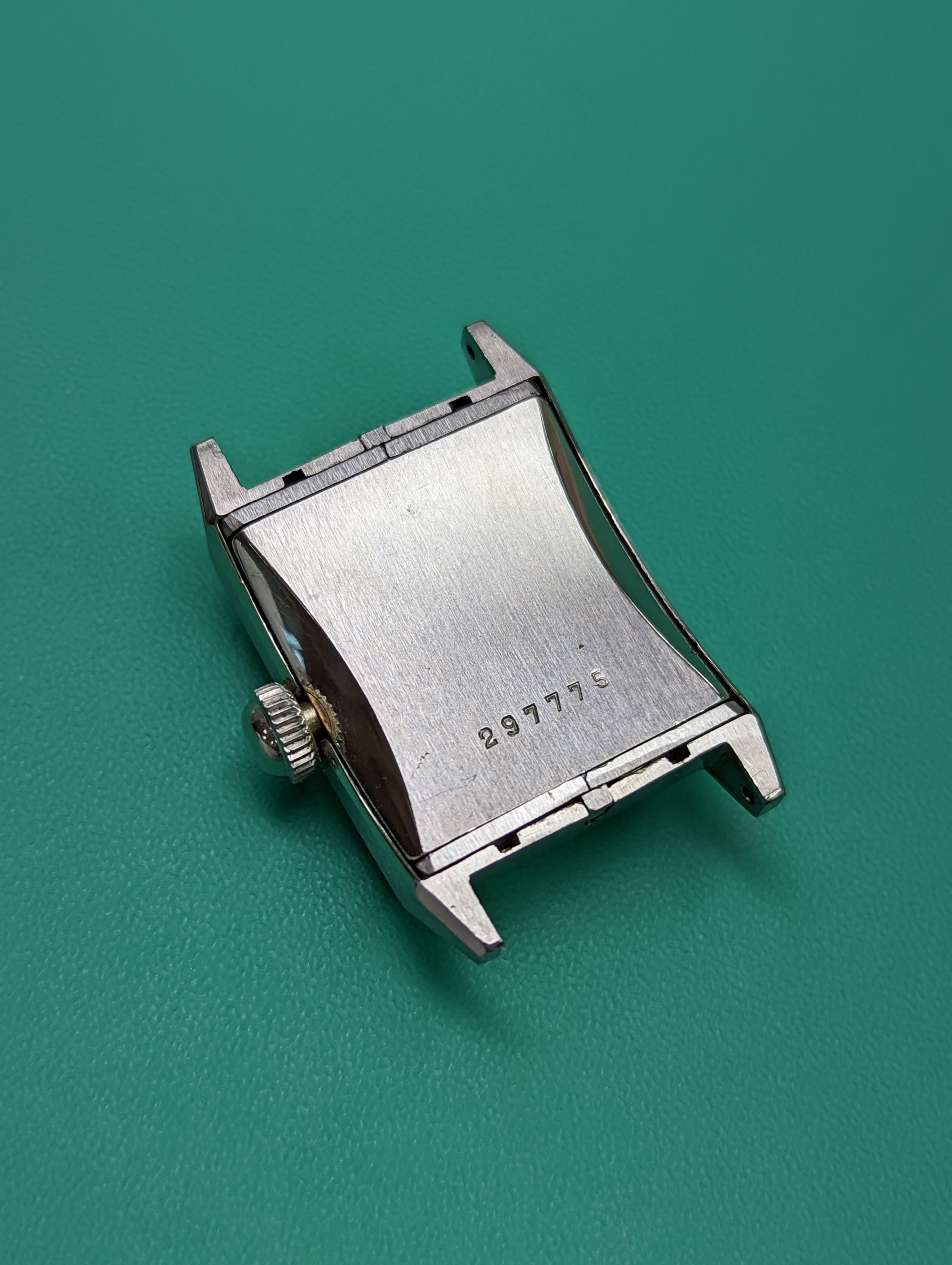

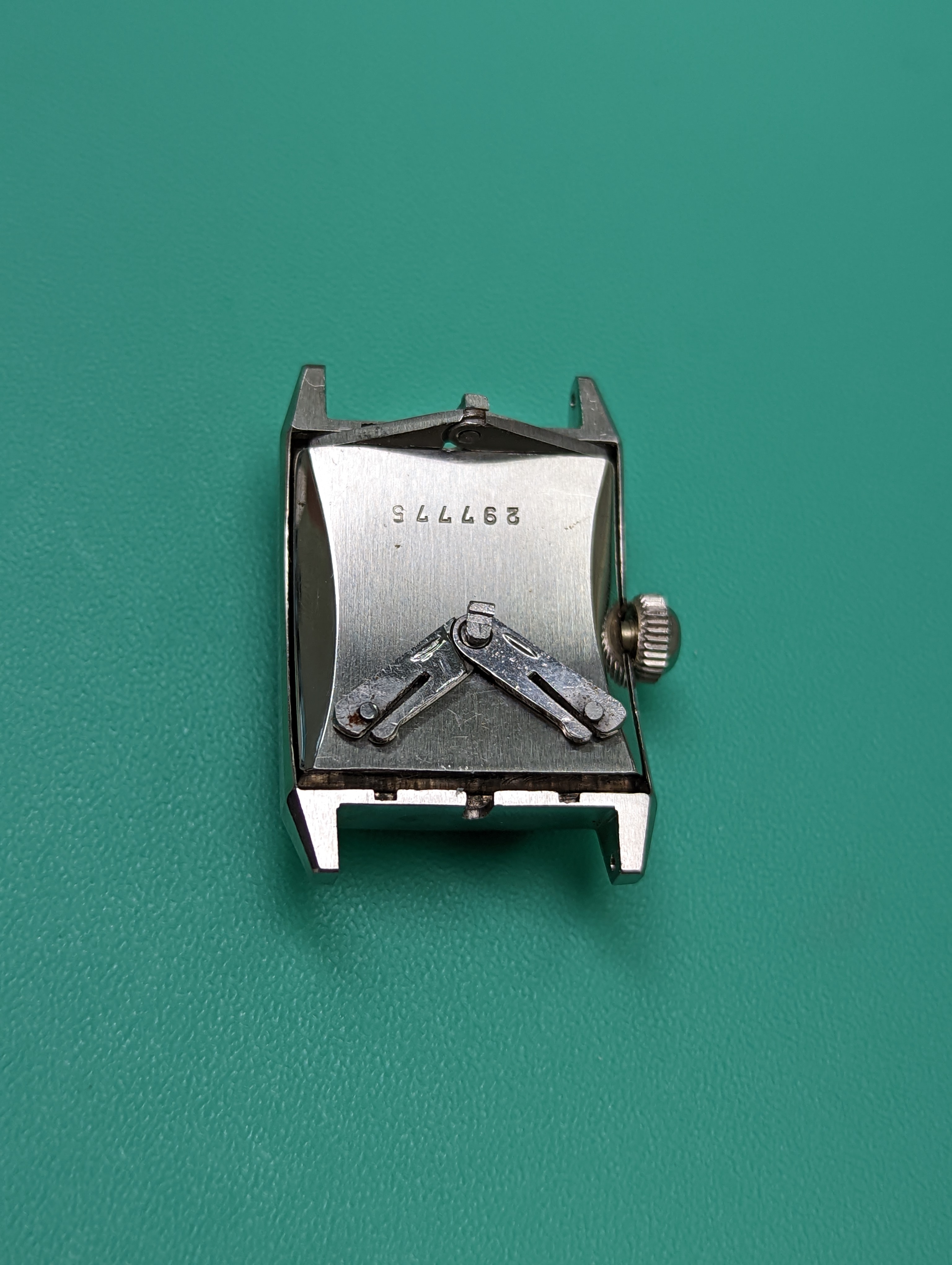

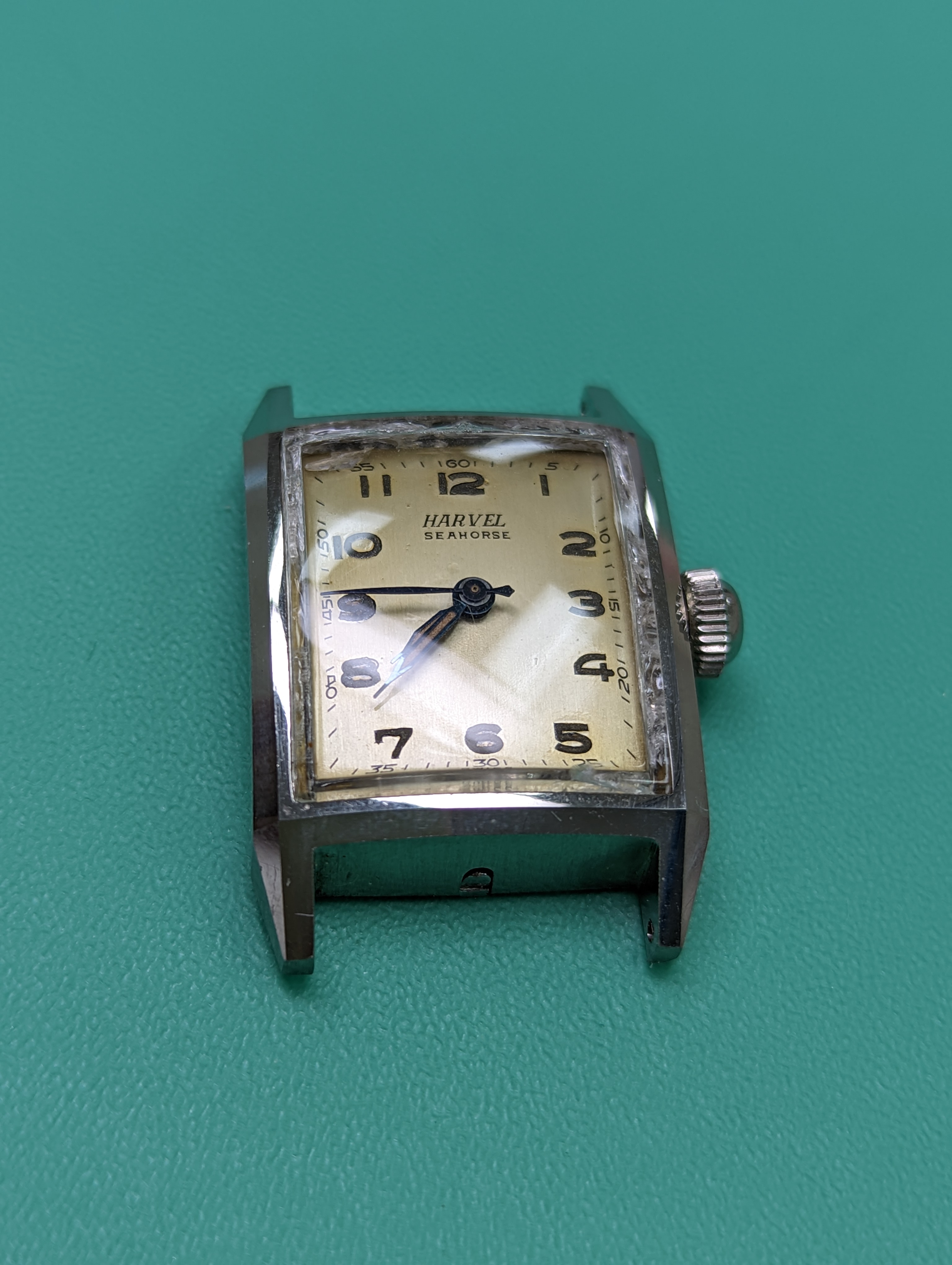

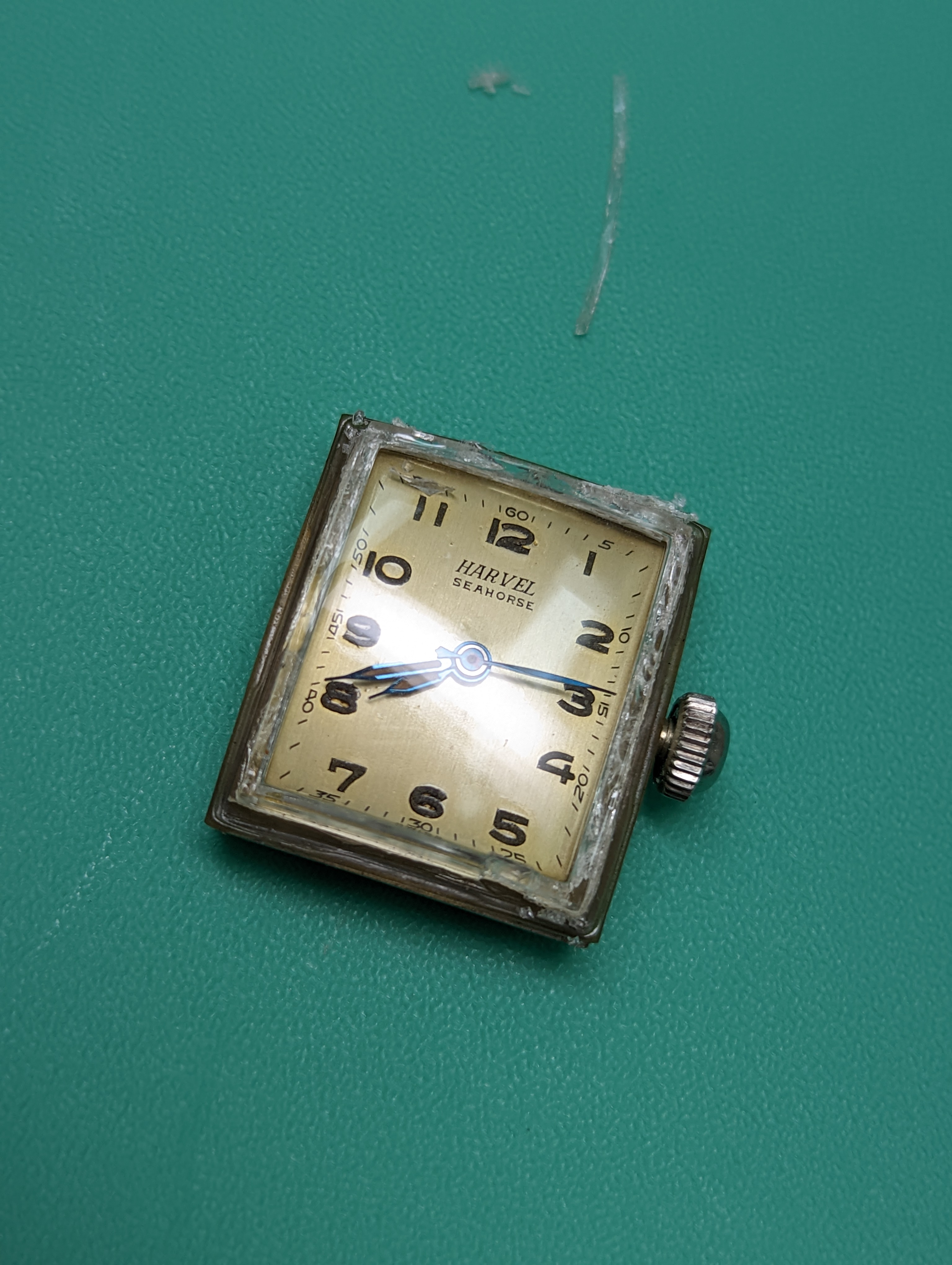

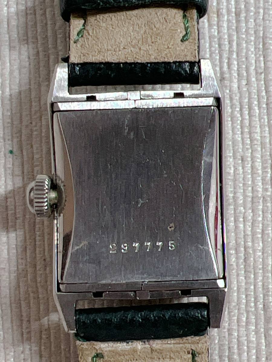

An update on the Harvel Seahorse, with an unusual water resistant case.
It is quite an elaborate construction with 2 hinged components that press the case middle against the gasket and crystal.
I will let the pictures tell the story...
Unfortunately due to the unusual case the watch needs a special curved and stepped crystal, which will probably make the watch only useful as a tiny paperweight. 馃檨
Well, I would start looking here - if you can;t find it by watch maker and model, you might find it by crystal type and dimensions...
Crystal Catalogs - G-S Supplies, Inc. (gssupplies.com)
i had the crystal replaced when mine was serviced by Raimond at Paul's Watch Repair in Sacramento

Really neat case design. Thanks for showing photos of how it is put together.

Unfortunately due to the unusual case the watch needs a special curved and stepped crystal, which will probably make the watch only useful as a tiny paperweight. 馃檨[/QUOTE]
Don't give up hope on the crystal. If you have a digital caliper, note the dimensions here. Wyler, Hamilton, Omega, etc all used this type of case. I have a few laying around that I will never use. 馃榾

You're right, I will check after the holiday and give it another try.馃憤

Just an update on the crystal.
I managed to find the correct crystal with gasket on eBay. It is a Wyler "947" crystal. I believe it is the same as used on many of the rectangular water resistant Wyler watches.
This crystal is also available from GS with number CMX345-12. However, I chose the Wyler crystal because it came with a plastic gasket.
Thanks everyone!
