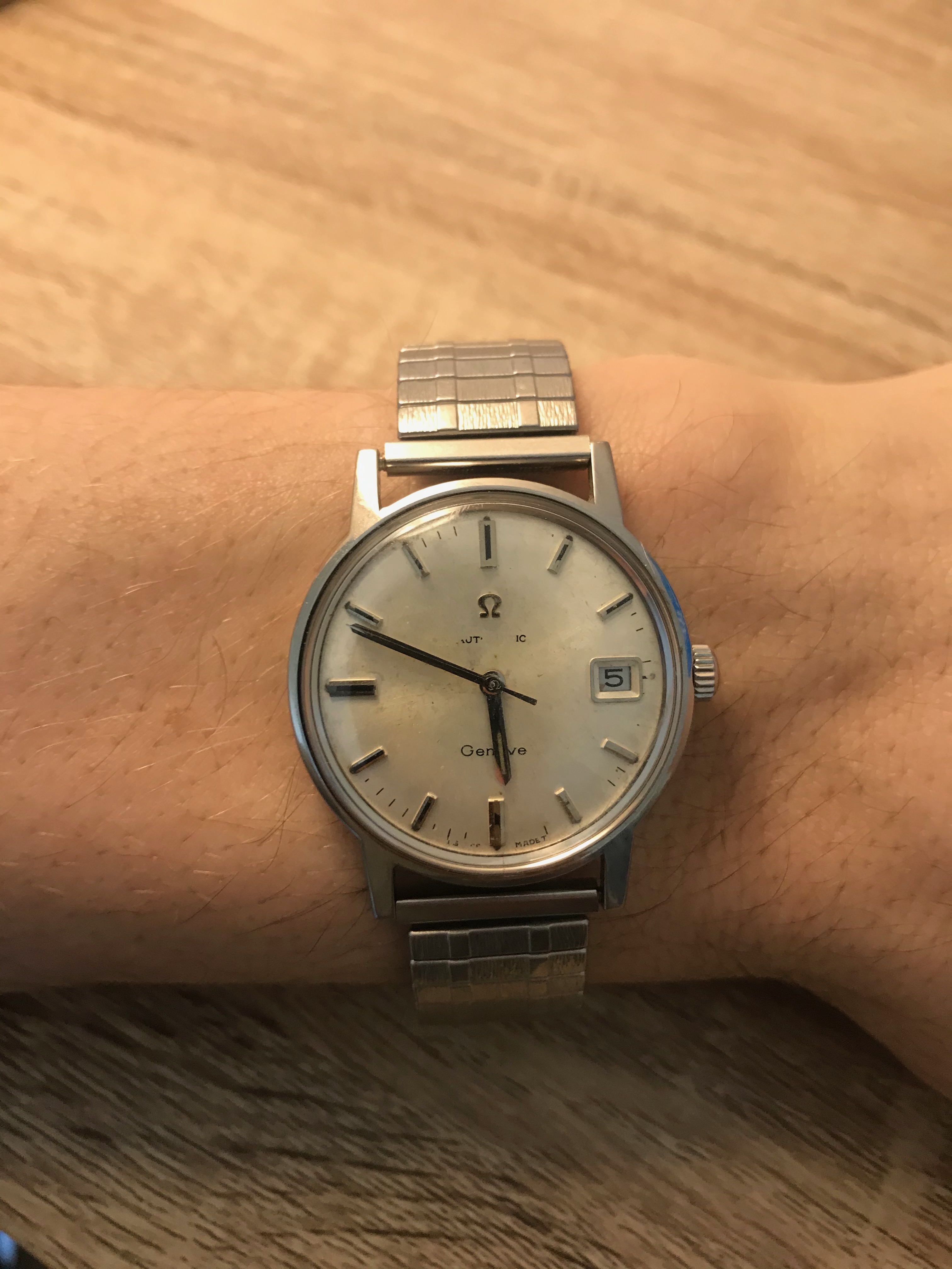

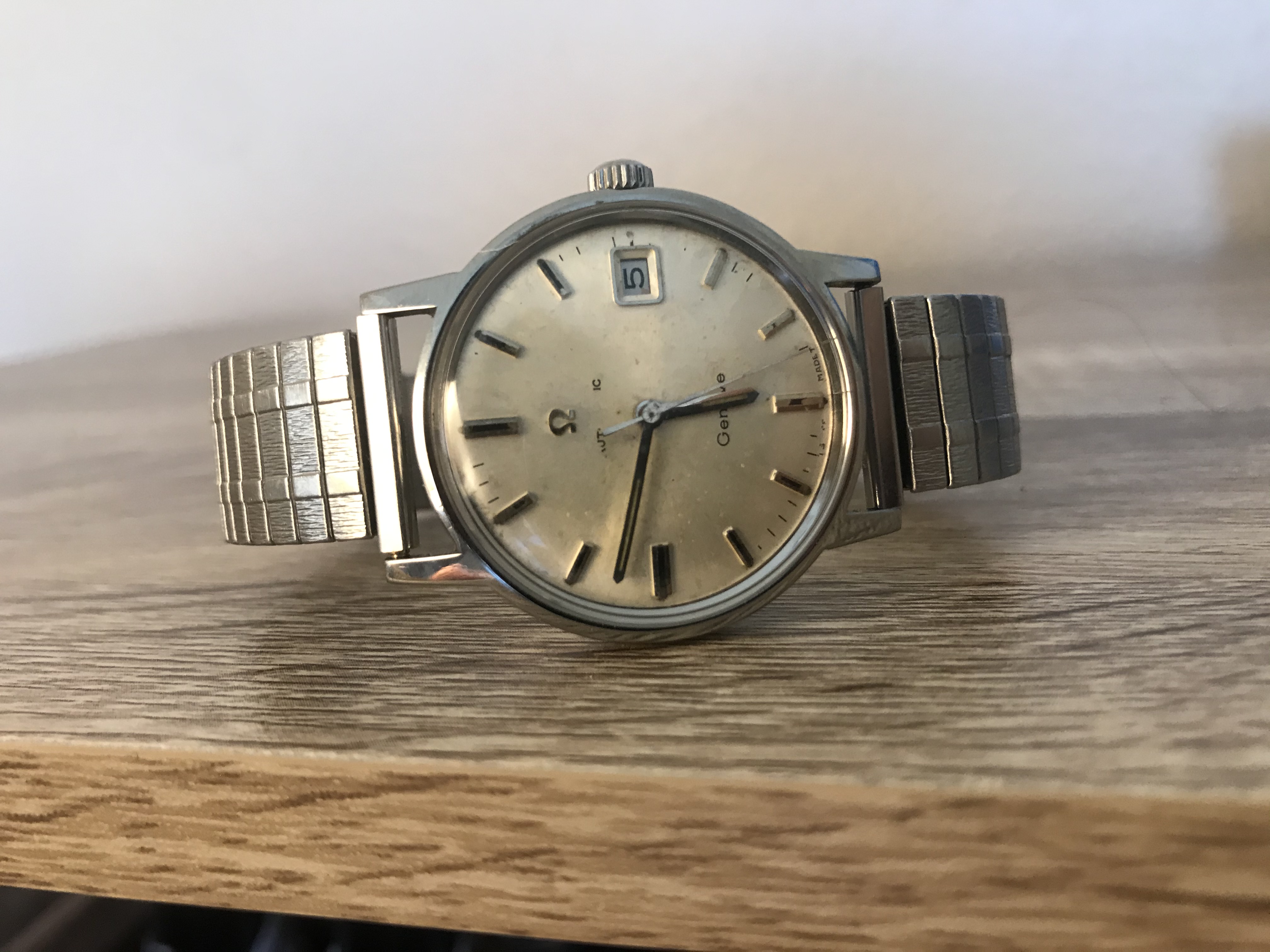

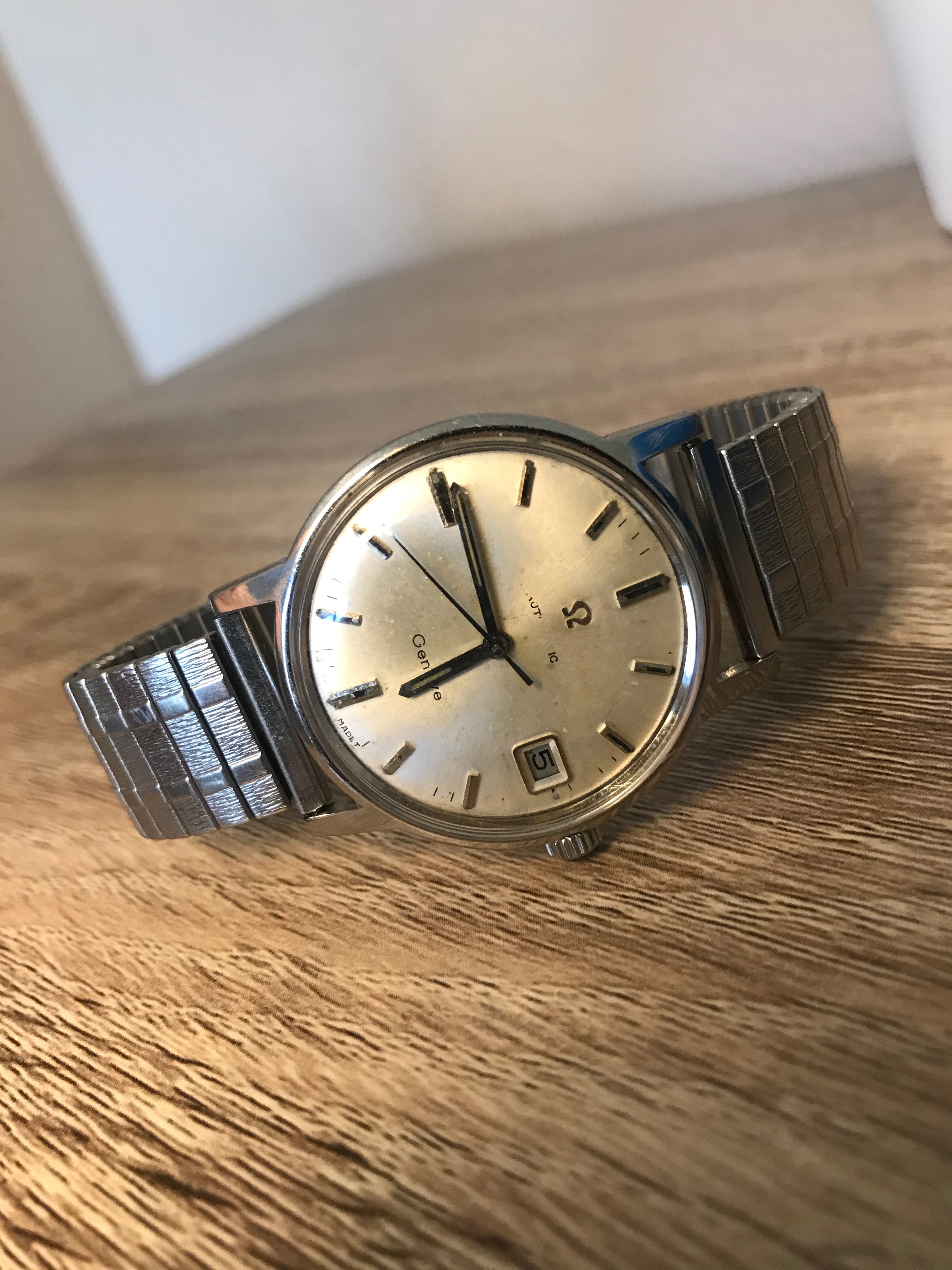

I just inherited a little watch from my beloved deceased grand-father. I never expected it to be an Omega, hence I was pleasantly surprised to spot the little logo.
As you can see, the dial has suffered a great deal of damage. The "Omega" mark is completely scrapped out, there are a lot of marks, and some indexes are also missing.
Nevertheless it seems to be running pretty smoothly!
There is a signed Omega crown, an indication "Genève", and "Automatic" (almost scrapped out too).

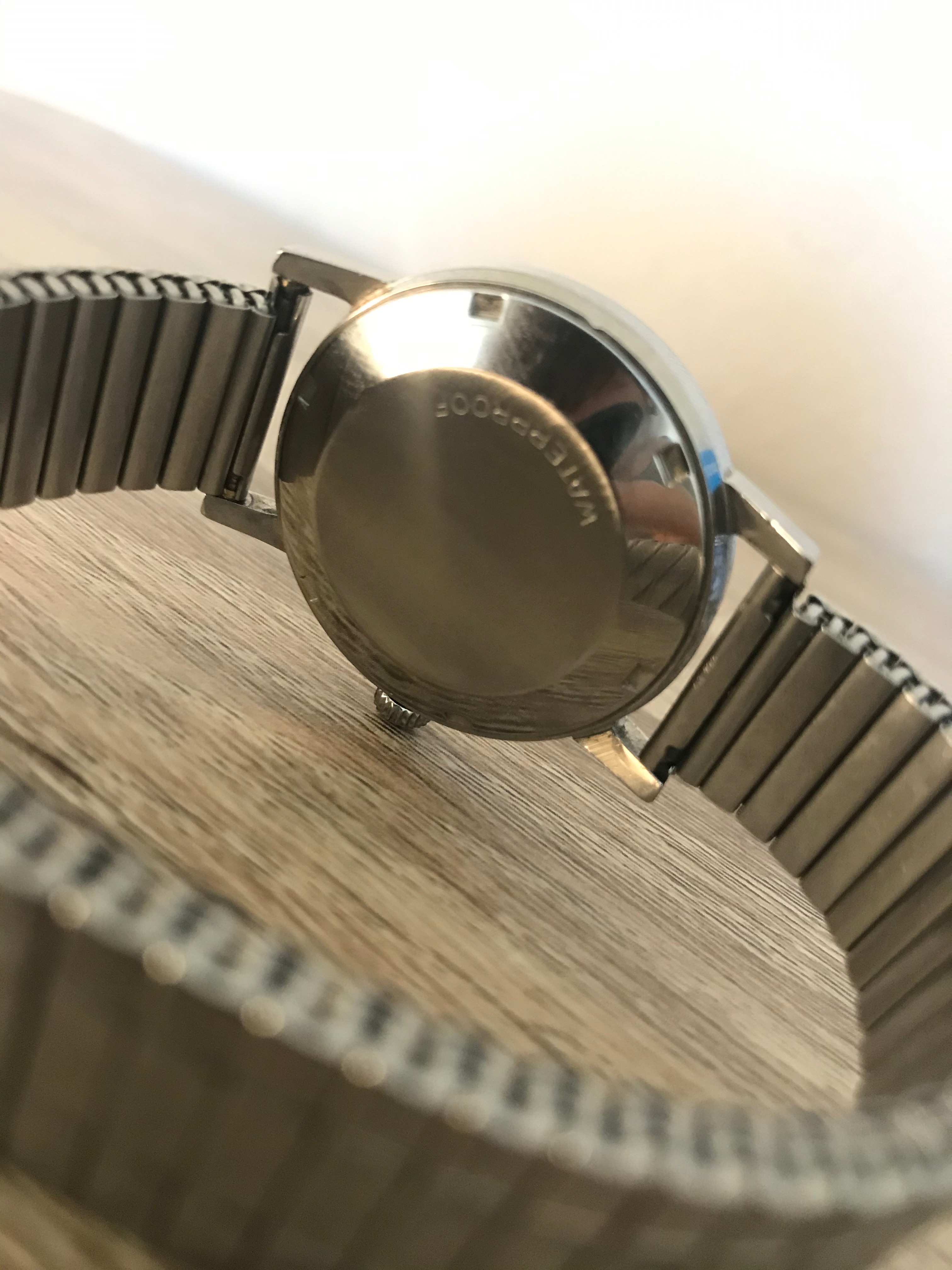

The back side says "Waterproof".
It is around 34mm if my measurement is correct.
I did some research and it looks a lot like a model 166.070, similar to this one :
https://www.zeitauktion.com/fr/omeg...ue-montre-pour-hommes-166-070-vintage-1903959
There is a stainless steel wristband which I'm pretty sure is not original.
2. Is it owned?
Yes, and I intend to keep it.
3. How you can help me?
a) Does the watch appear to be genuine?
b) Would your experience eyes be able to recognise the exact model/year? Is there any way I can determine this without unscrewing the back? (I have no idea how to do this)
c) Are the signs of wear "normal" for a quality watch like an Omega? I would imagine that these are due to over-exposition to water.
d) What would be its approximate value? I'm not considering selling it at all, it's only curiosity.
e) Would it be worth bringing it for review at a watch shop?
I greatly appreciate your help.
Kind regards,
Martin

Hi Martin,

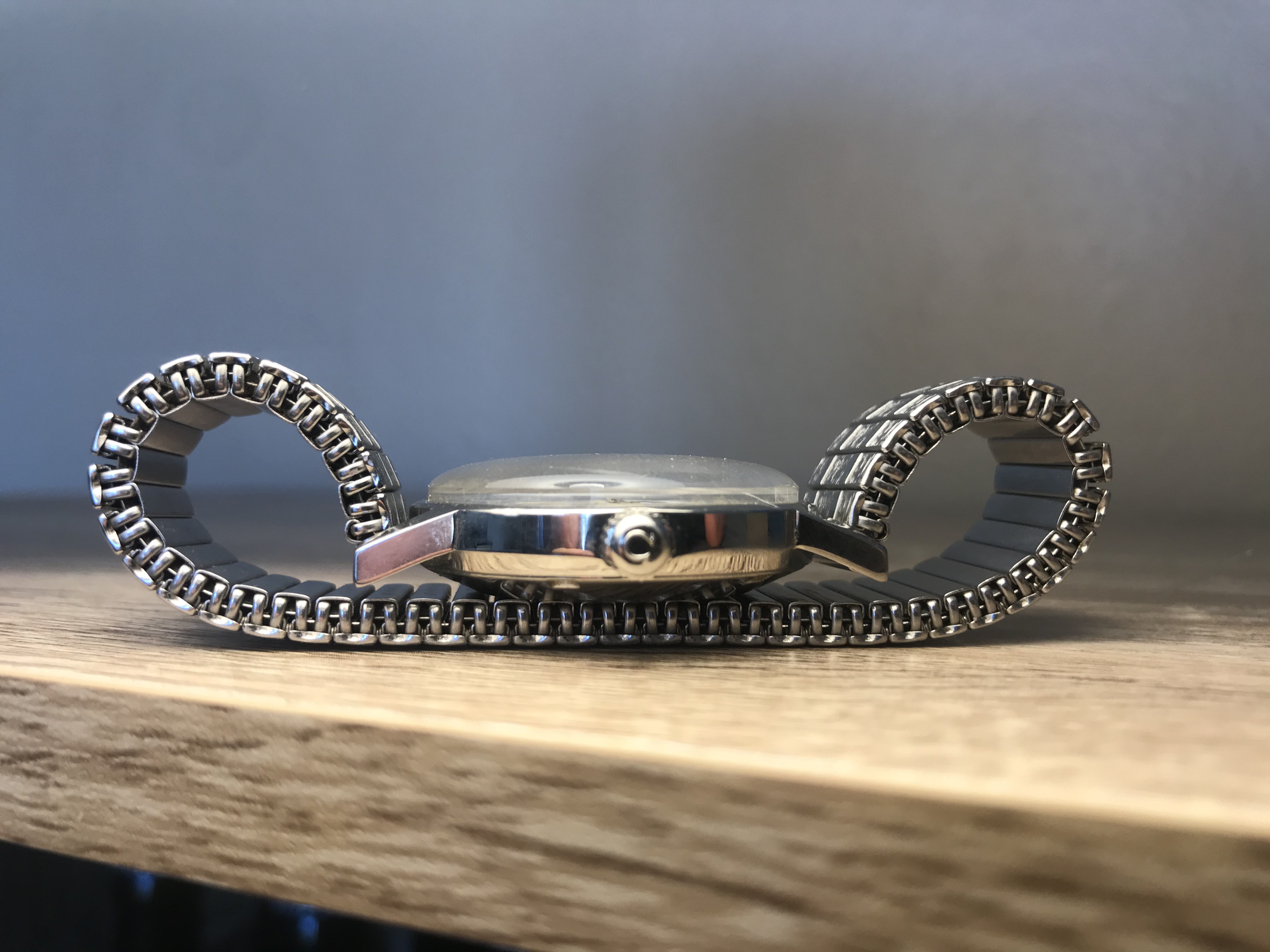

Sorry for the loss of your grandfather. Welcome to Omega Forums! Unfortunately someone has tried to clean the dial and this is the result. It may be possible to find a replacement dial. If you like the watch, I think it is worth the effort. I would also replace the band with a strap. That sort of band is not original and can eat the lugs like this:
https://www.instagram.com/p/CNBJSdIrBTs/?utm_source=ig_web_copy_link
A watchmaker can open it up for you and read the numbers off the inside of the caseback to get the exact model for sure.
Good luck.

To answer your questions:
a) yes it is genuine.
b) 60s Geneve is the best I can do, others may be able to do better, but a watchmaker can open it for you.
c) other than the dial it looks OK. Does it run at all? The dial is a good example of why it is best not to try and clean them.
d) if you can find a replacement dial and get it serviced it would be worth around $400us. Unfortunately, you will probably have to spend close to that amount to get it to that state. However, I wouldn't think twice about it. It is a nice classic model and a great memory of your grandfather.
e) definitely take it to a watchmaker if you have interest in wearing it.

It is up to you if you want to change the dial or not. I like a bit of patina, but this dial is too far gone for me. Inherited my Dad's watch which had a poorly repainted dial and I replaced it. I still have the original, but I am happy with my choice. You can read about it here:
https://omegaforums.net/threads/update-on-bad-redail-inherited-watch.87997/
Before you go searching for a dial you need to nail down the exact model you have. If you can find a dial that is very similar to the current dial but without the damage, I don't think it will change the character in a bad way.

Hi, sorry for your loss.
I think it is a reference 166.070, as you stated. Inside you should have a 565 automatic in house caliber, produced between 1966 and 1969 if I'm not wrong. Anyway, have a watchmaker open it and take pics of the movement and inside caseback.
This is a very good watch with sentimental meaning, if properly serviced it can serve you for many years to come.
My advice is to look for a spare original dial on the web, I wouldn't have it reprinted.
