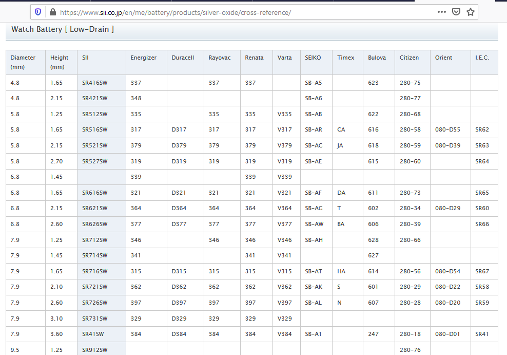

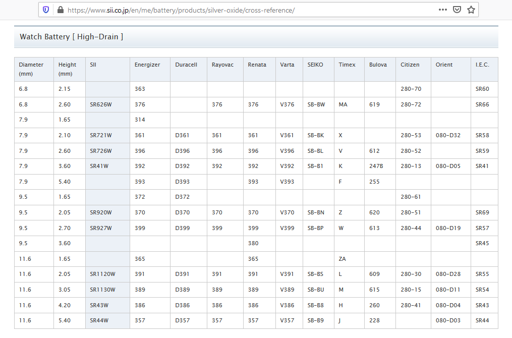

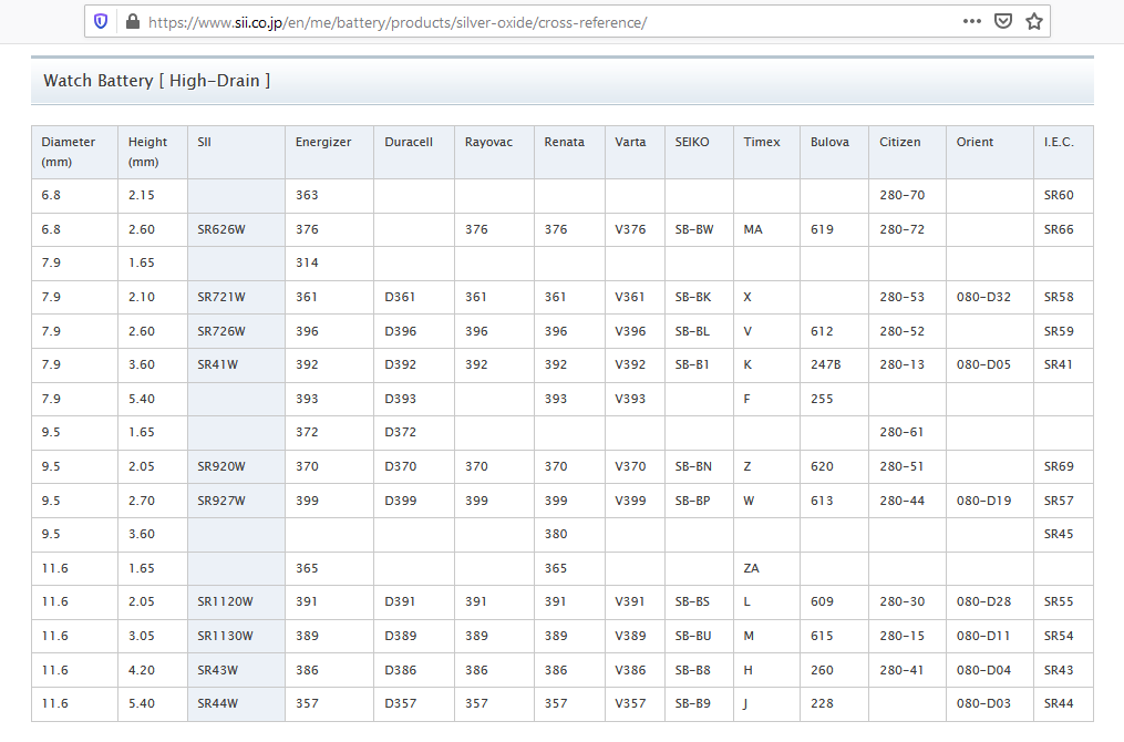

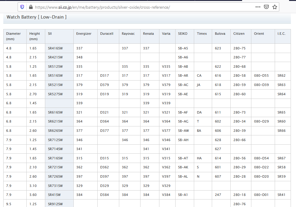

In case anyone is curious, here is a handy dandy cross reference guide from Seiko:
