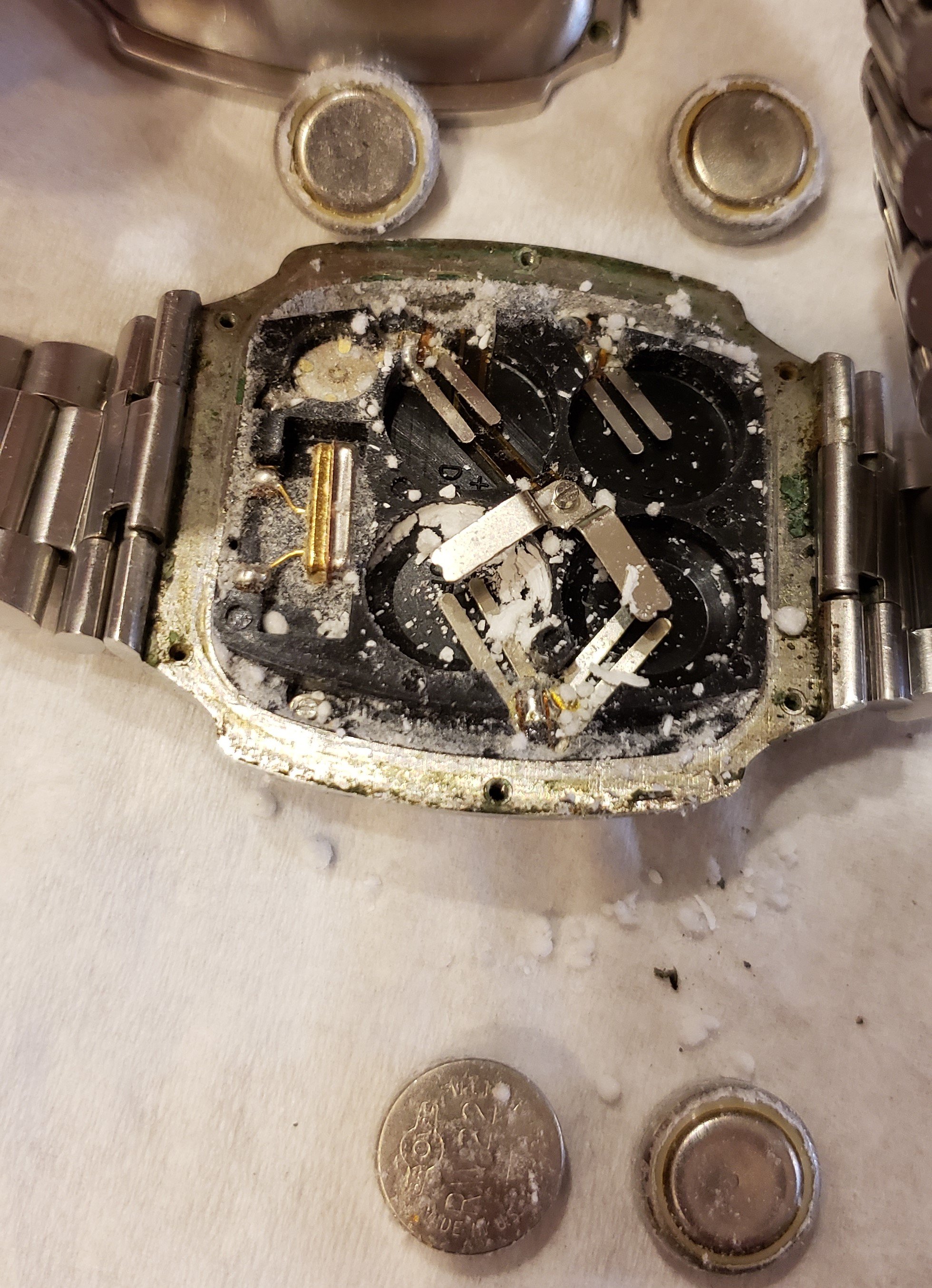

How dangerous is this? Massive mercury battery leakage in Pulsar
199
365

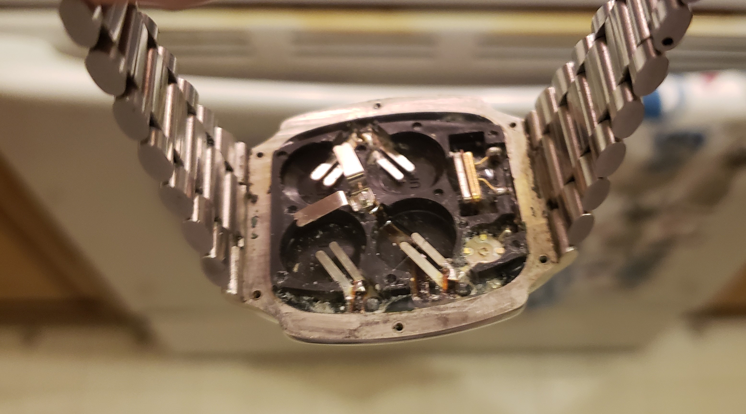

I opened this up a few months ago without knowing what was behind the cover and when I did this powder was everywhere. It wasn't until after that I knew I was dealing with mercury batteries. I vacuumed my workspace thoroughly and used a q tip with vinegar to soak up most of the powder. How dangerous is this?
10,745
16,730
Very dangerous for the watch, probably fatal. Much less so for you if you were sensible and washed your hands after handling.

Could be wrong here, but mercury / cadmium oxides that one would expect inside a button cell tend to have very strong colours - I'd say those white crystals were potassium carbonate from the electrolyte. I think the mercury it is either too thick to seep out of the gap in the battery seal, the electrolyte crystals have re-sealed the batteries, or it had already vaporised...😵‍💫
