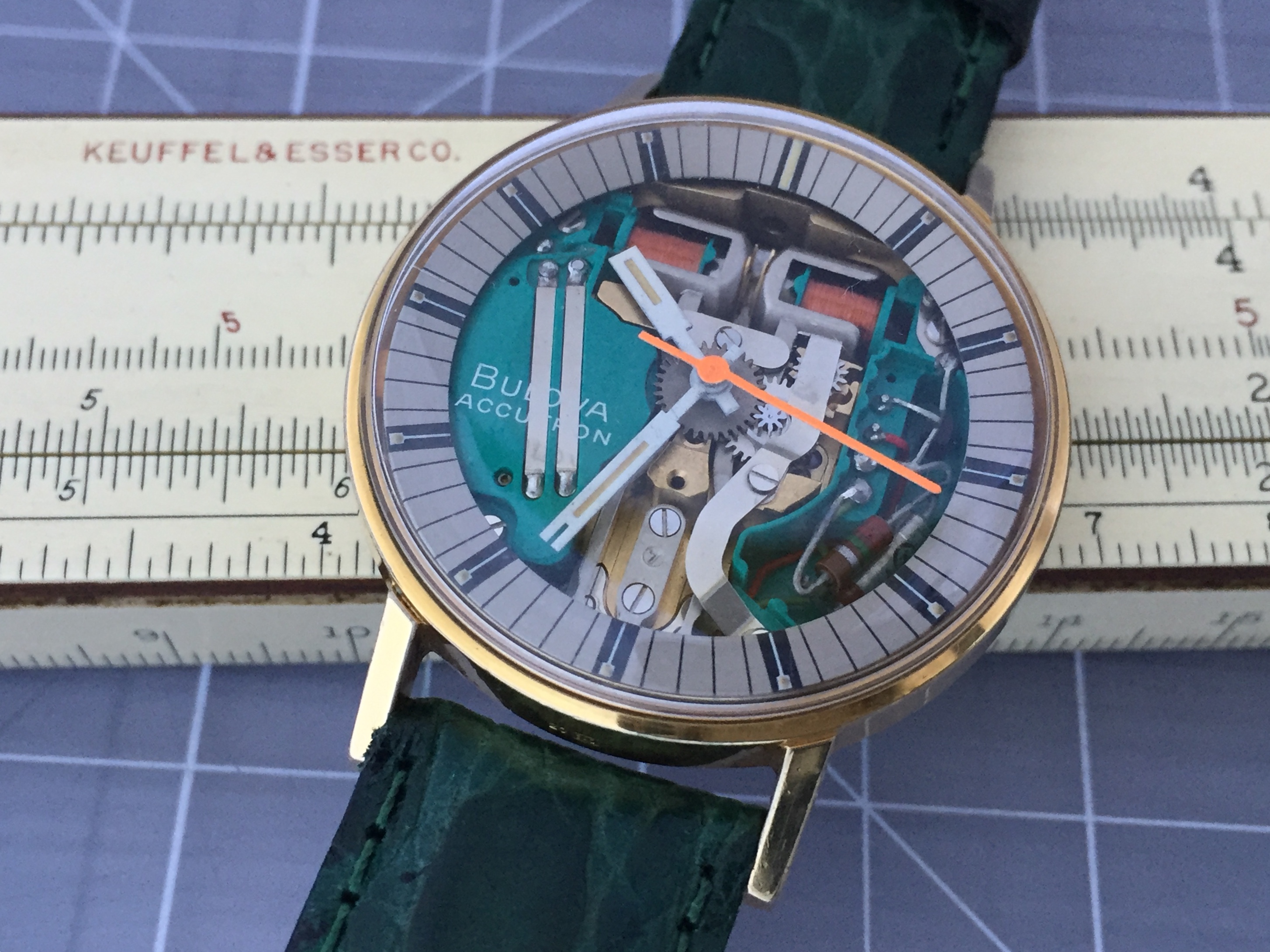

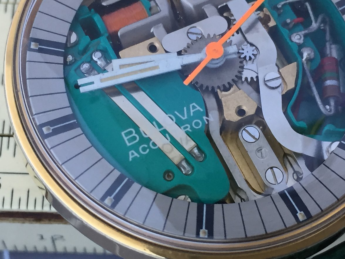

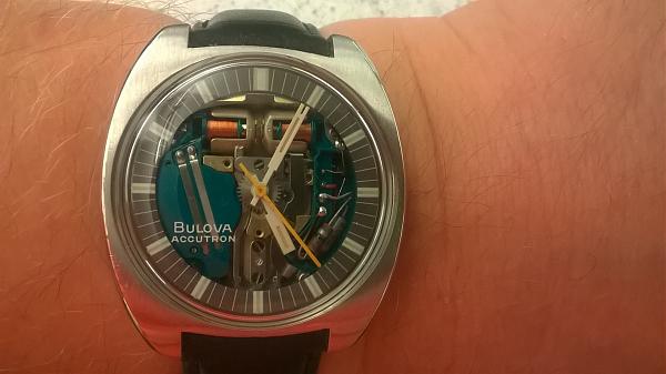

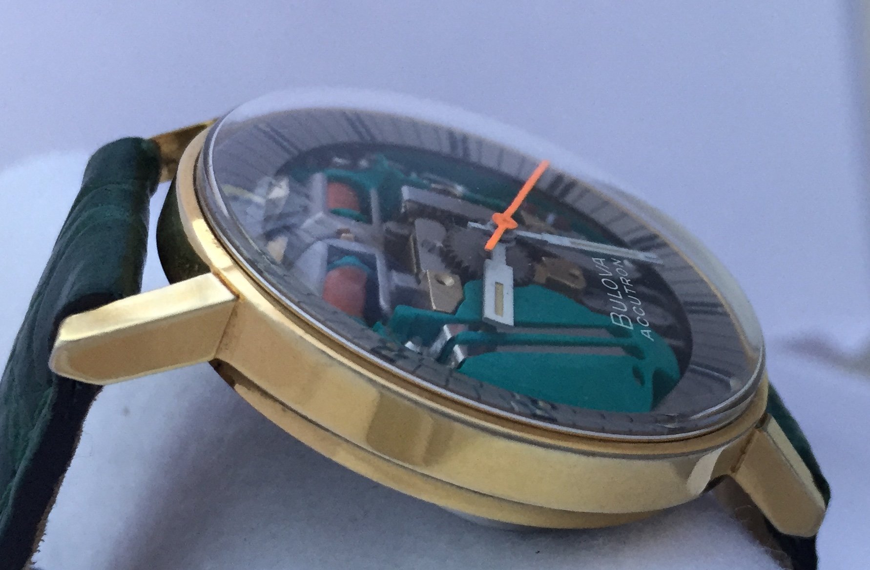

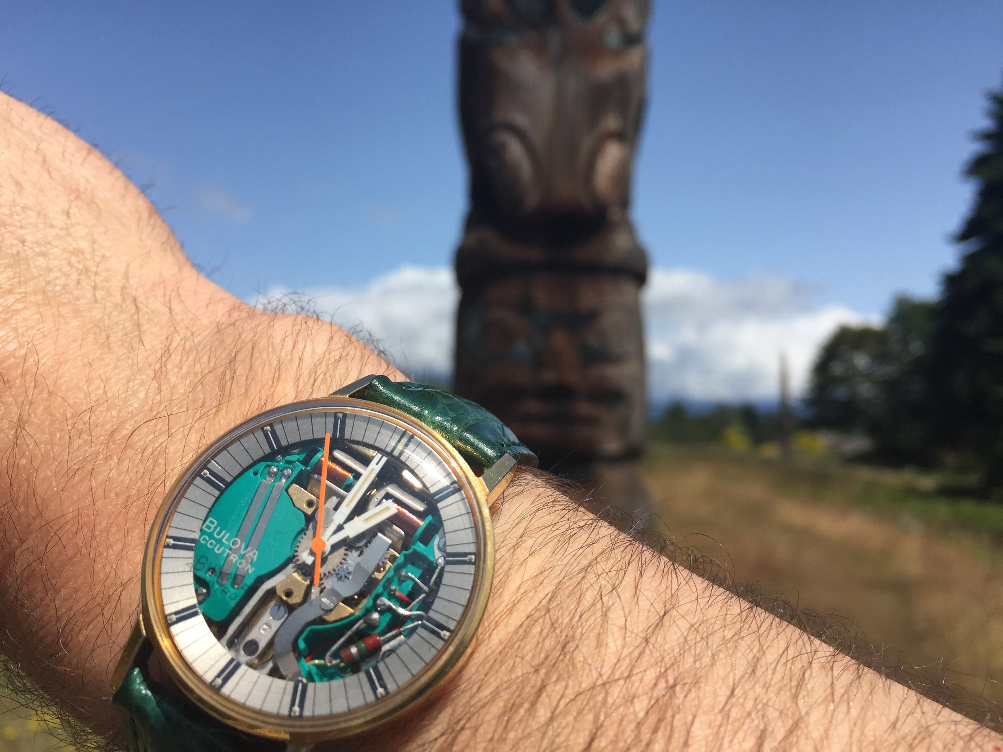

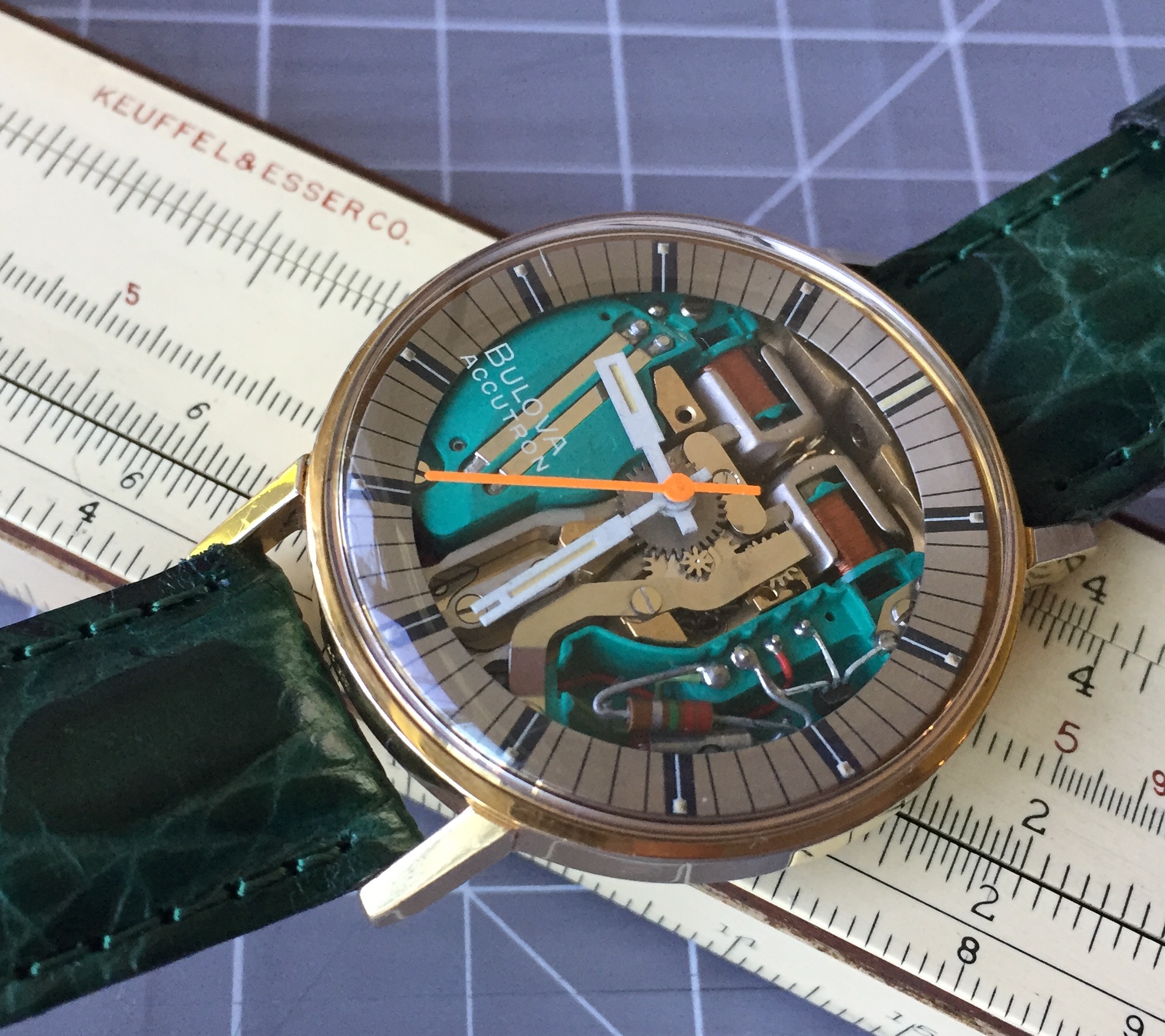

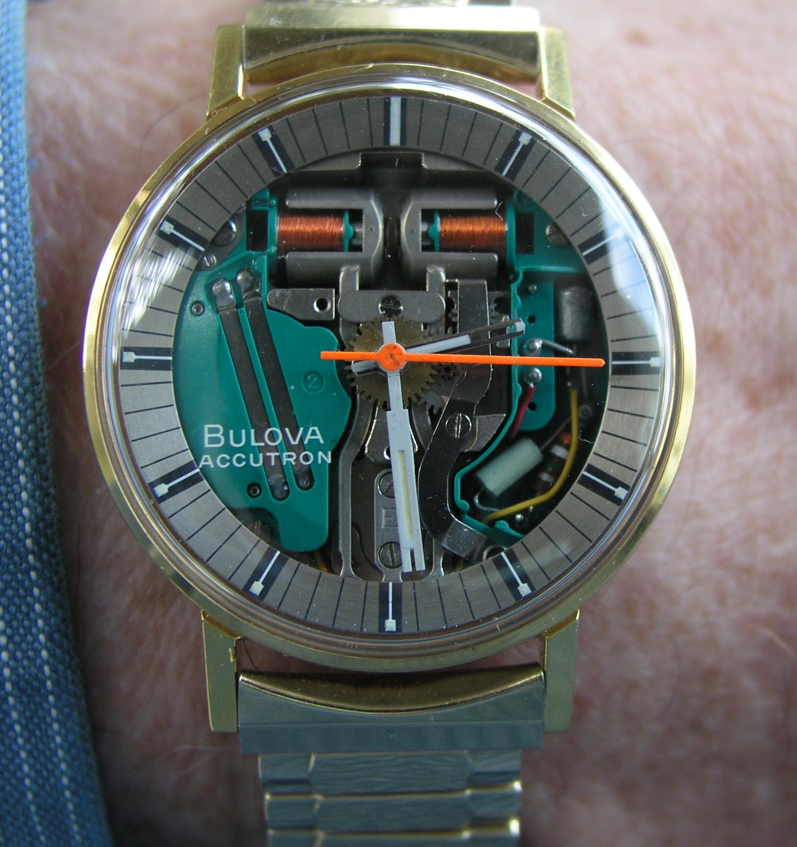

Thank you all again for your guidance with this spaceview. Before I picked it up, I had only seen a YouTube review of one, and had certainly not been expecting to find one in the wild. Hats off to TGV at the Urban Gentry for his review. Otherwise, I wouldn鈥檛 have known what I was looking at. Special thanks to Canuck, otherwise I would still be looking at a non-functioning watch!
This watch began its journey at the Bulova factory as an Accutron Spaceview in 1973, then I think it went into someone鈥檚 sock drawer for 40 some-odd years before sitting for some time in a charming barber/clock repair shop in Ontario. The owner, Paul, is a clock guy. Paul has the wisdom to not try and mess around with Accutrons. This is where I picked it up and soon sent it along to Canuck for him to breathe life back into it. Aside from it not working (a minor problem, no? 馃槜 ), it had a shallow crack in the crystal. I think that everything else remained in pristine condition because it malfunctioned early in life. The hack mechanism was not coming off of the tuning fork - requiring a small adjustment by Canuck - and a correct battery that was rightly installed sdrawkcab. This is the way with batteries in Accutrons. I was very lucky to find this in near-new condition, it has the original (I believe) band, but is now on green faux-croc, and a black buffalo strap for its winter wardrobe. A new crystal was installed, with the original stored for posterity.
What is fascinating about these tuning fork watches is the smooth second hand sweeeeep...
...and the hum. The hum is only noticeable when it is close to your ear, but it is higher-pitched and less pleasant than I was expecting. It could, perhaps, attract or repel teenagers, bats or mosquitoes. At the end of the day though, the hum is fun. This watch IS FUN. Once you see one, little else feels as fascinating. I hope you all get a chance to own or wear one someday.
Ladies and gentlemen, a 46 year old Bulova Accutron Spaceview N3 with 214 movement. It brings nice memories of a vacation with my parents, and it is an honour to share the final results with you here.

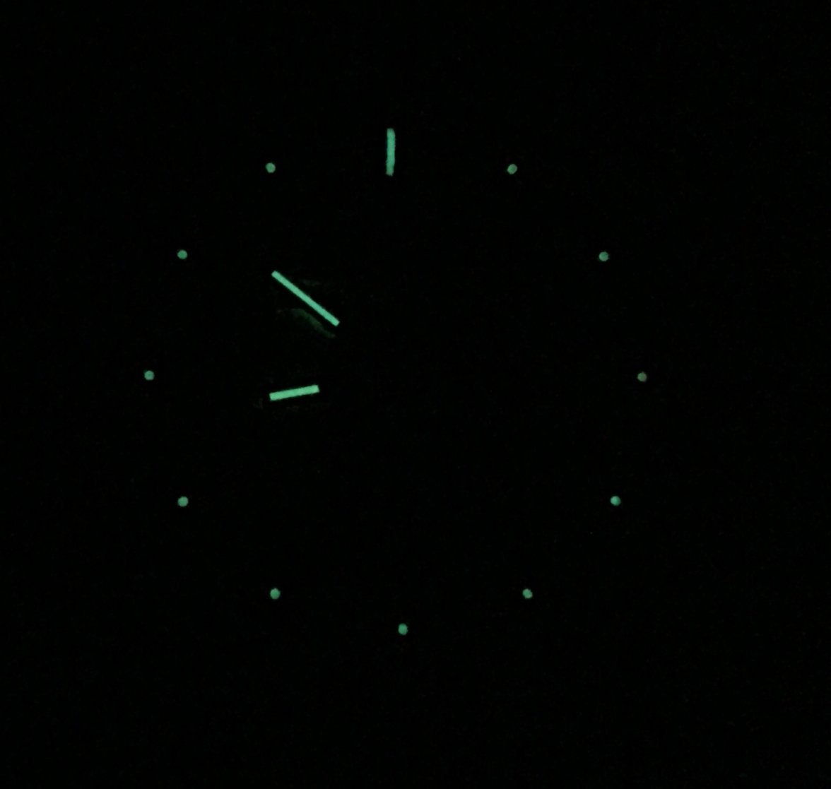

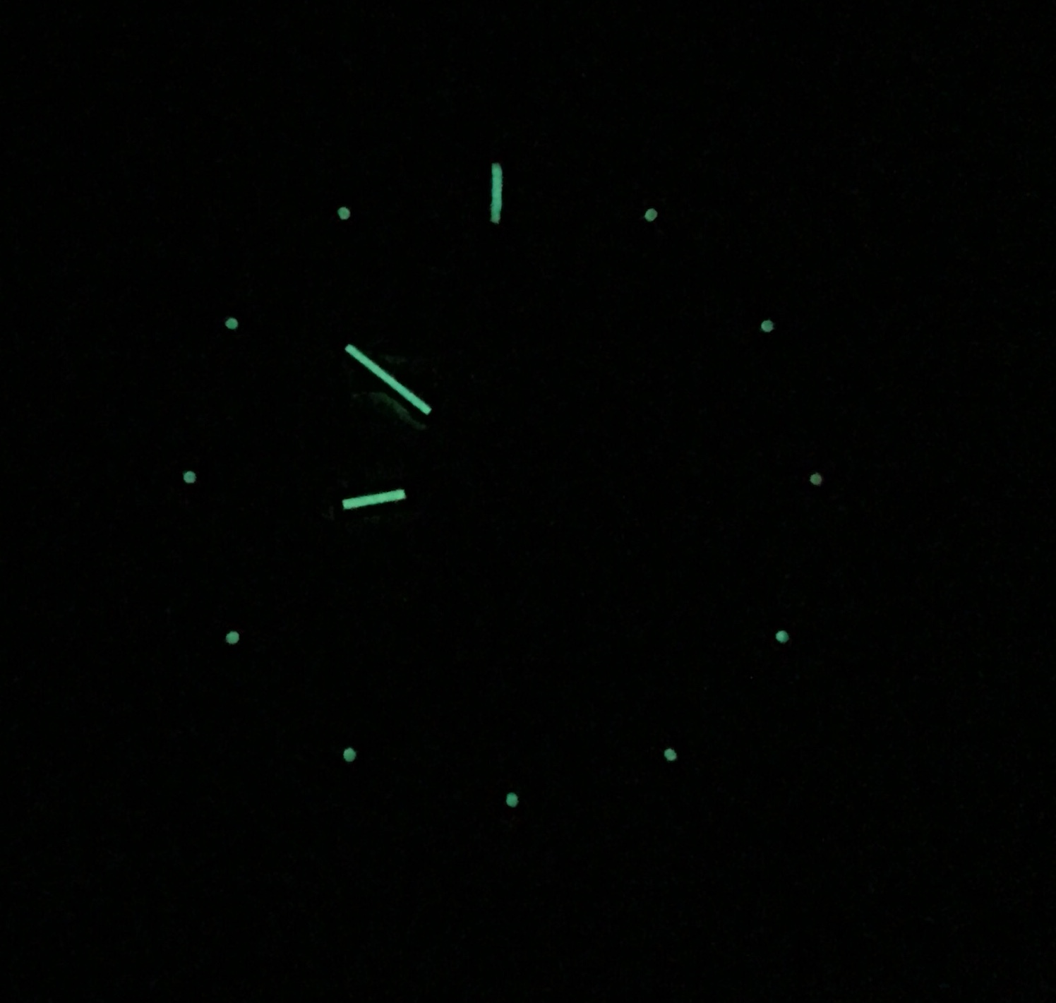

This was an unexpected find...lume!
And finally on my wrist
Seeing the photos I now realize I could have cleaned the watch a bit more :whipped:. Apologies. Anyway, I am looking forward to your thoughts!

All around great find , great restoration to service, great vintage condition, and not least a great story to relate to anyone who asks how you got it.

WOW! A review that would be a credit to a professional in the craft! Excellent photography. As to the sound the Accutron makes. If you ever have an opportunity to listen to an Omega mega-sonic, or a tuning fork Accu-Quartz, you鈥檒l find the sound of the tuning fork on your Spaceview mellow and pleasant. Then there is the Omega tuning fork model (ESA 9162). Different sound again. These tuning forks vibrate at 300 hertz, and are certainly less piercing.

Anyway, you were indeed very fortunate to have uncovered your Spaceview. Lightning is far more likely to strike a second time in the same place, than for you to get so lucky a second time. Enjoy (and I know you will!) I was pleased to be able to help.

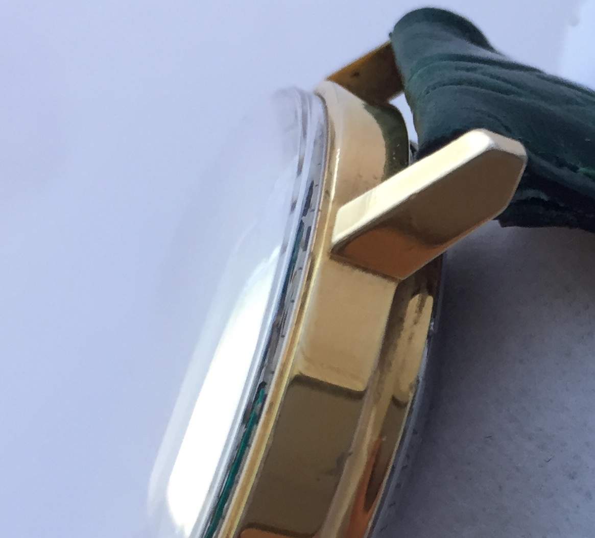

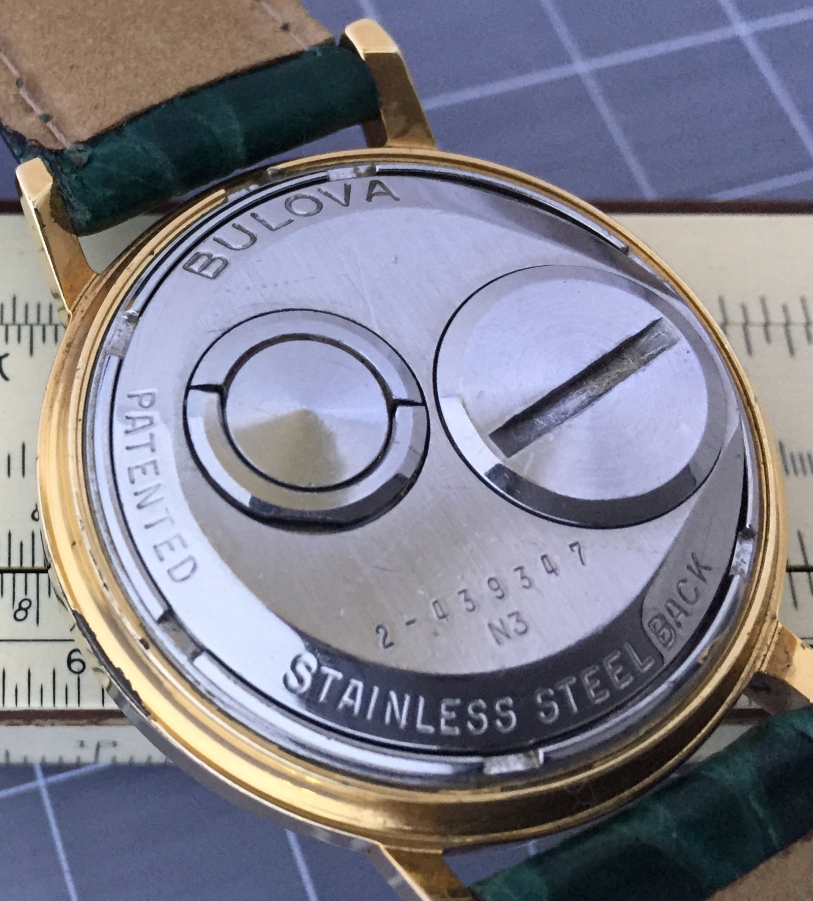

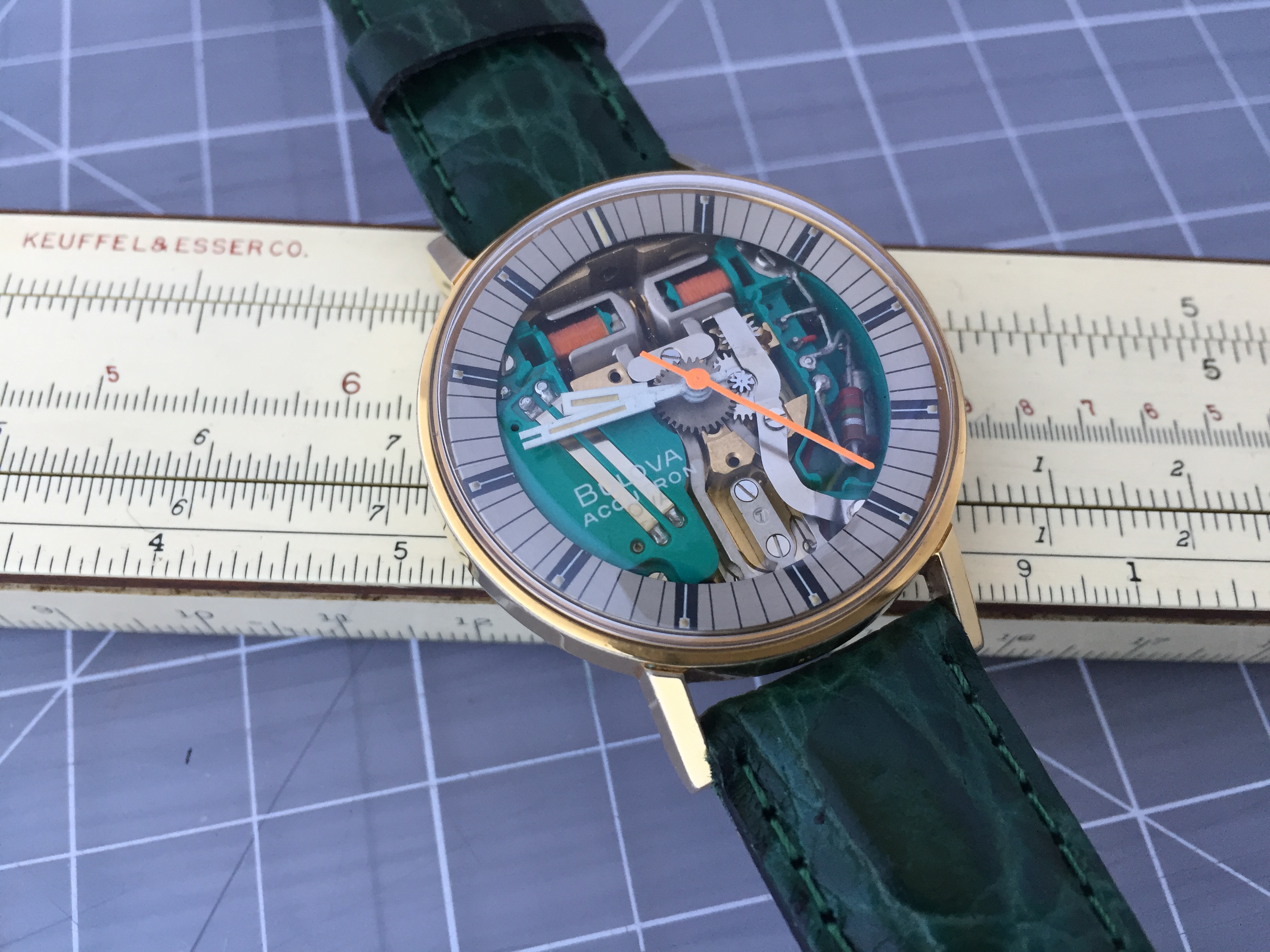

Over the process of resuscitating DaveK鈥檚 Spaceview, I decided I needed one as well. I went to my stash and put together basically the same watch. The bezel and chapter ring came to me in a lot of parts from a deceased collector (came with no movement or case back). When I sent DaveK鈥檚 case and the one from my Accutron to my supplier for a crystal, I provided them with a style number from DaveK鈥檚 watch (unknown to me because of no case back on my case), and they were able to supply two crystals. I have lots of Accutron parts and parts movements, but I didn鈥檛 have a pawl jewel assembly that was complete. So I re-purposed a 214 movement from an Accutron in my collection, fitted a pair of Spaceview hands (they don鈥檛 match, but I鈥檒l work on that). Next, I fitted the case back from the donor Accutron, and voila! My very own Accutron 214 Spaceview, two days after the 50th anniversary of Apollo XI.

Nice Project!
That Swiss Spaceview appears to be in case 891-1 or 891-2 (both called out in Yellow Gold). The Case 891 with no dash would be the Stainless Steel version. I am not aware of the 'Name' or Style # for that Swiss Chapter Ring.

You are probably correct. The bezel and case came to me separately in a bunch of Accutron parts, but there was no case back. When DaveK sent me his for repair, I had a case style number to work with. Both cases needed crystals which my supplier (Perrins in Toronto) was able to supply. Next, I鈥檒l see if they can supply a pair of matching Spaceview hands. The movement is from a donor watch from my collection, and the case back from that one was transferred to this one. There is a chance I may have a case back with the correct style number in my stash. I鈥檒l wear it the way it is for a few days.

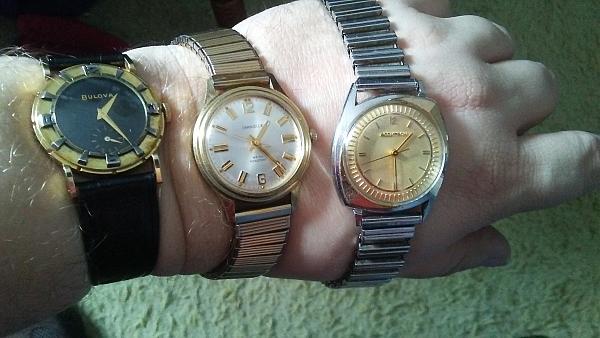

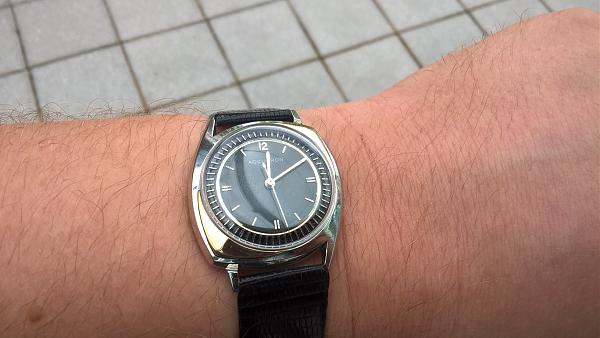

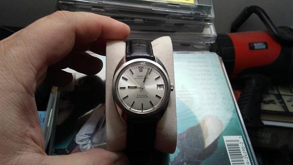

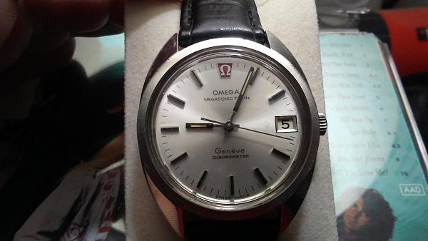

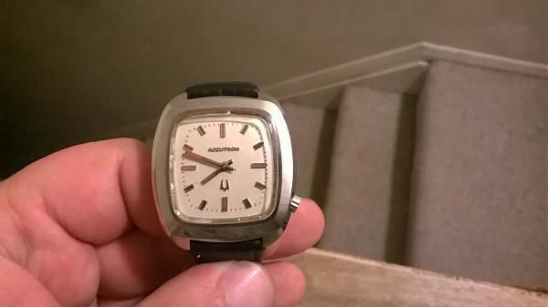

Here are some of mine. My oldest is a black dial Model 204 made in 1960. The black dial version was only made in 1960. I got it from a small shop in Baddeck Nova Scotia. The most complicated one is a Omega Mega Sonic that I bought on this forum.
