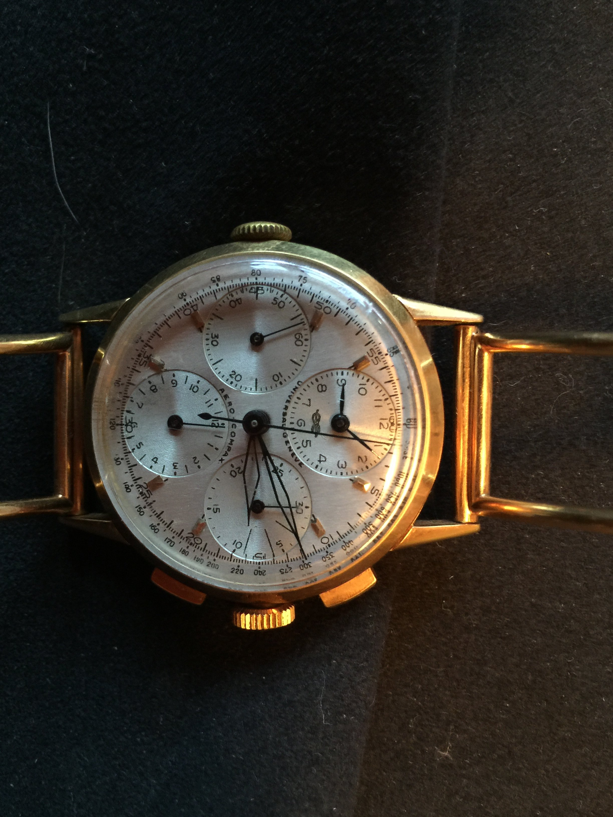

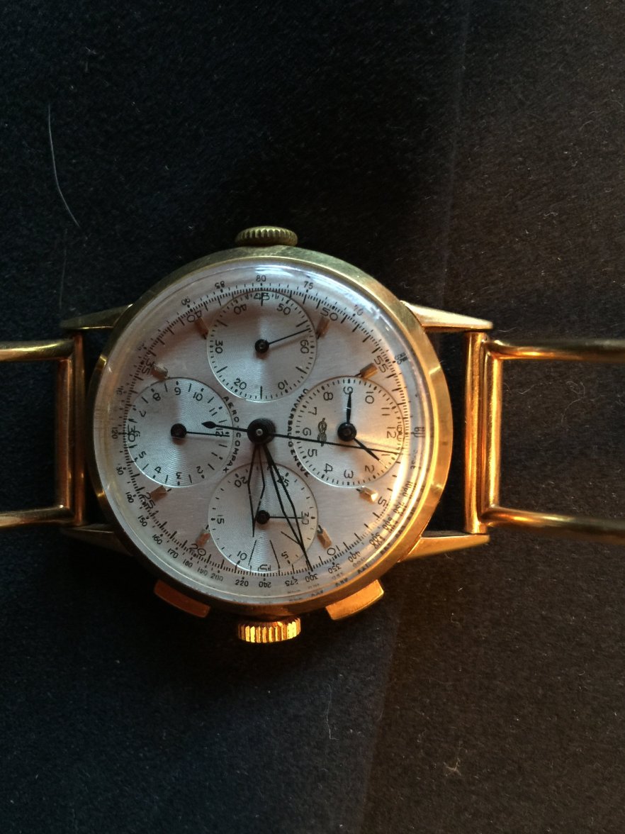

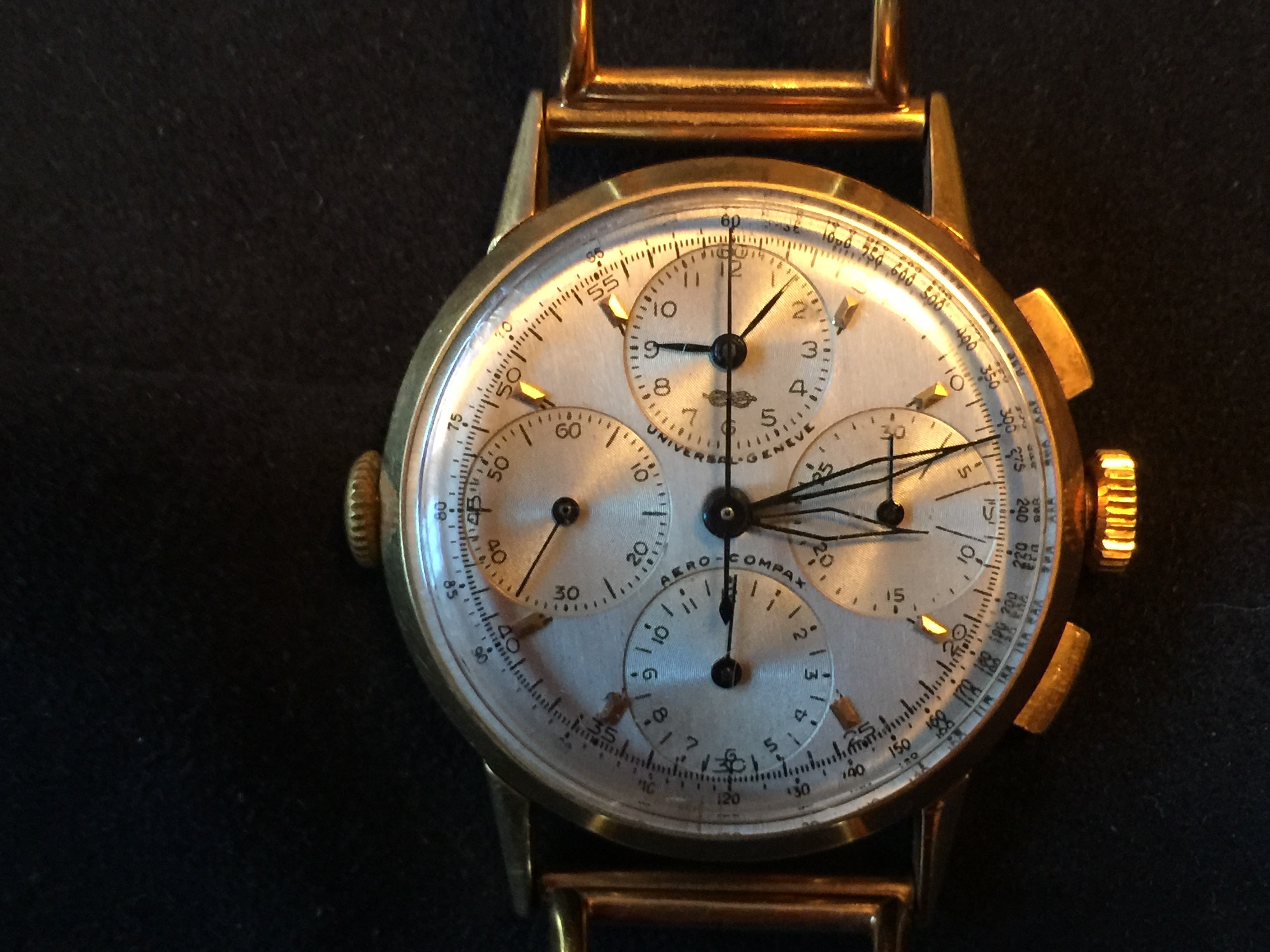

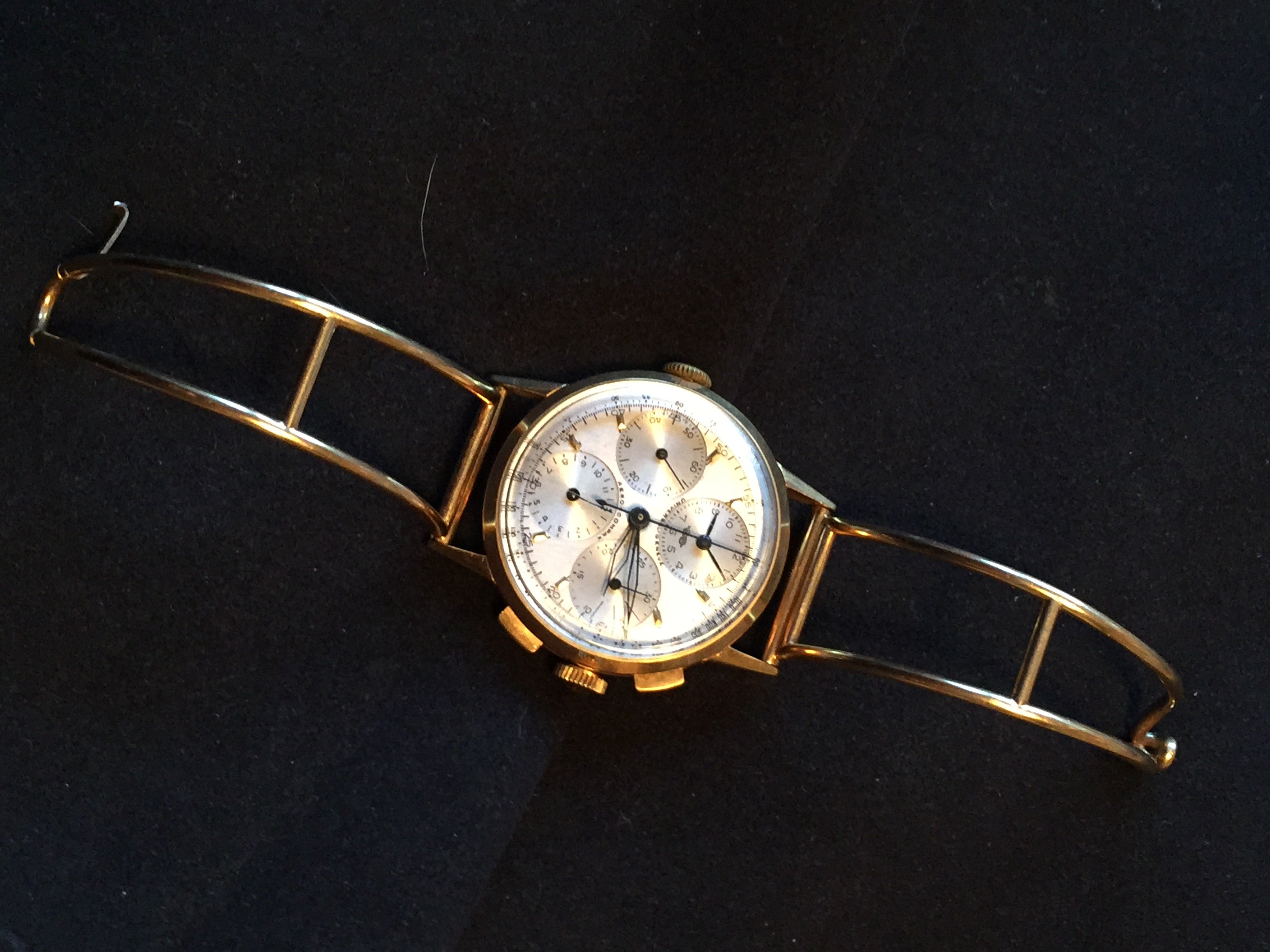

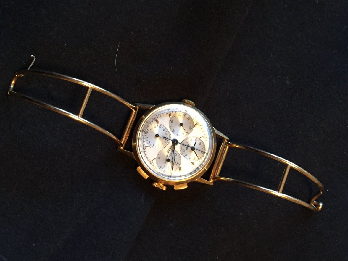

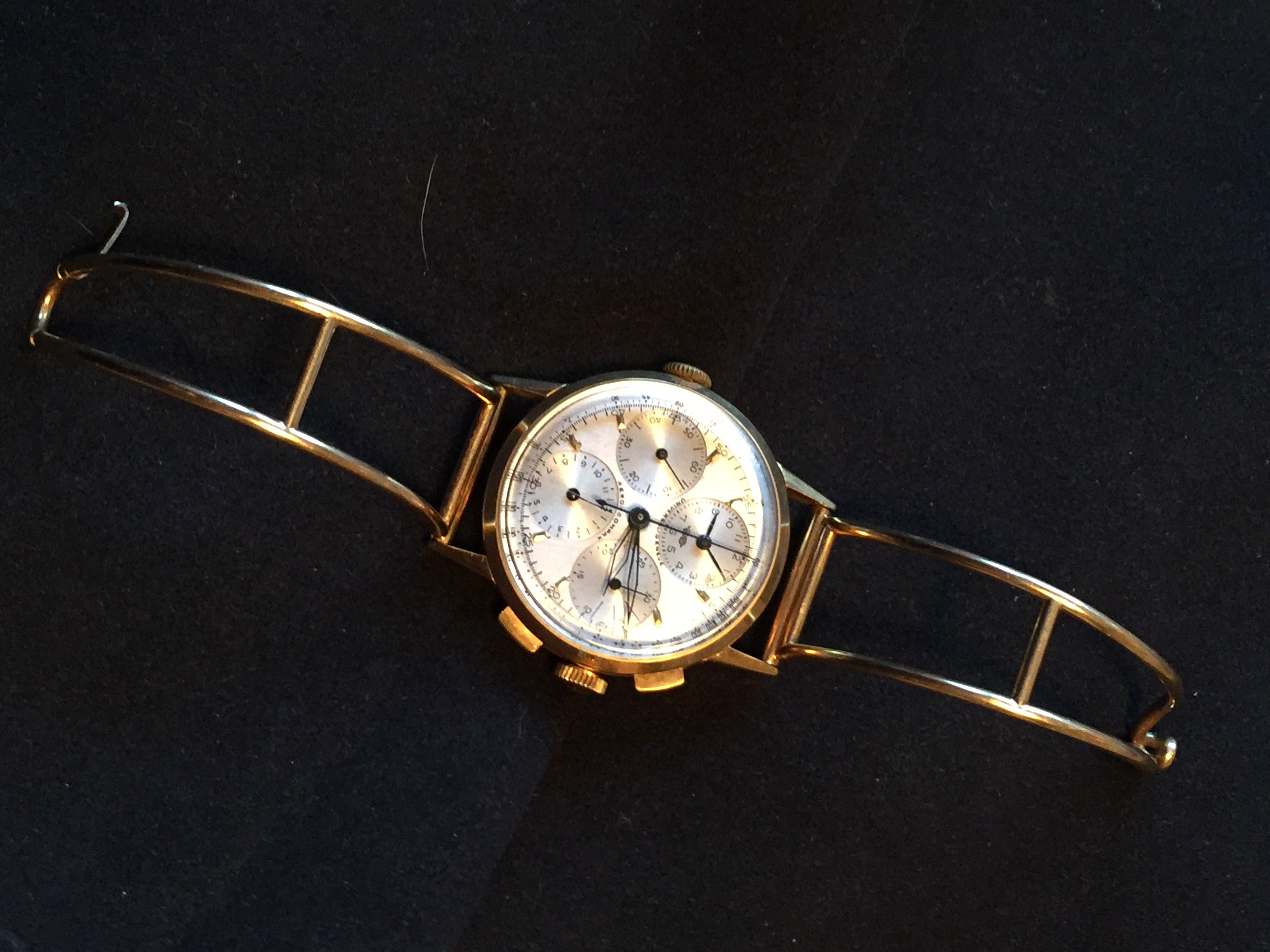

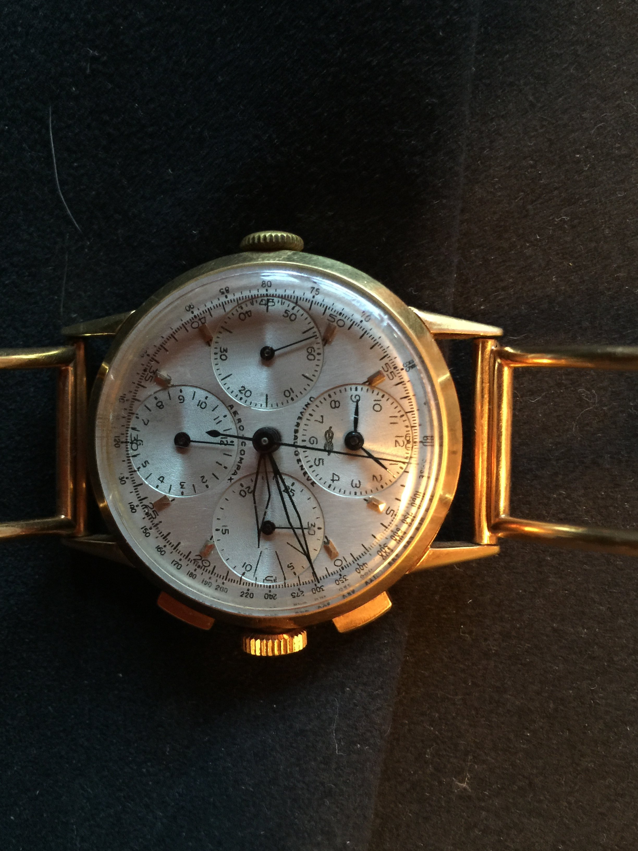

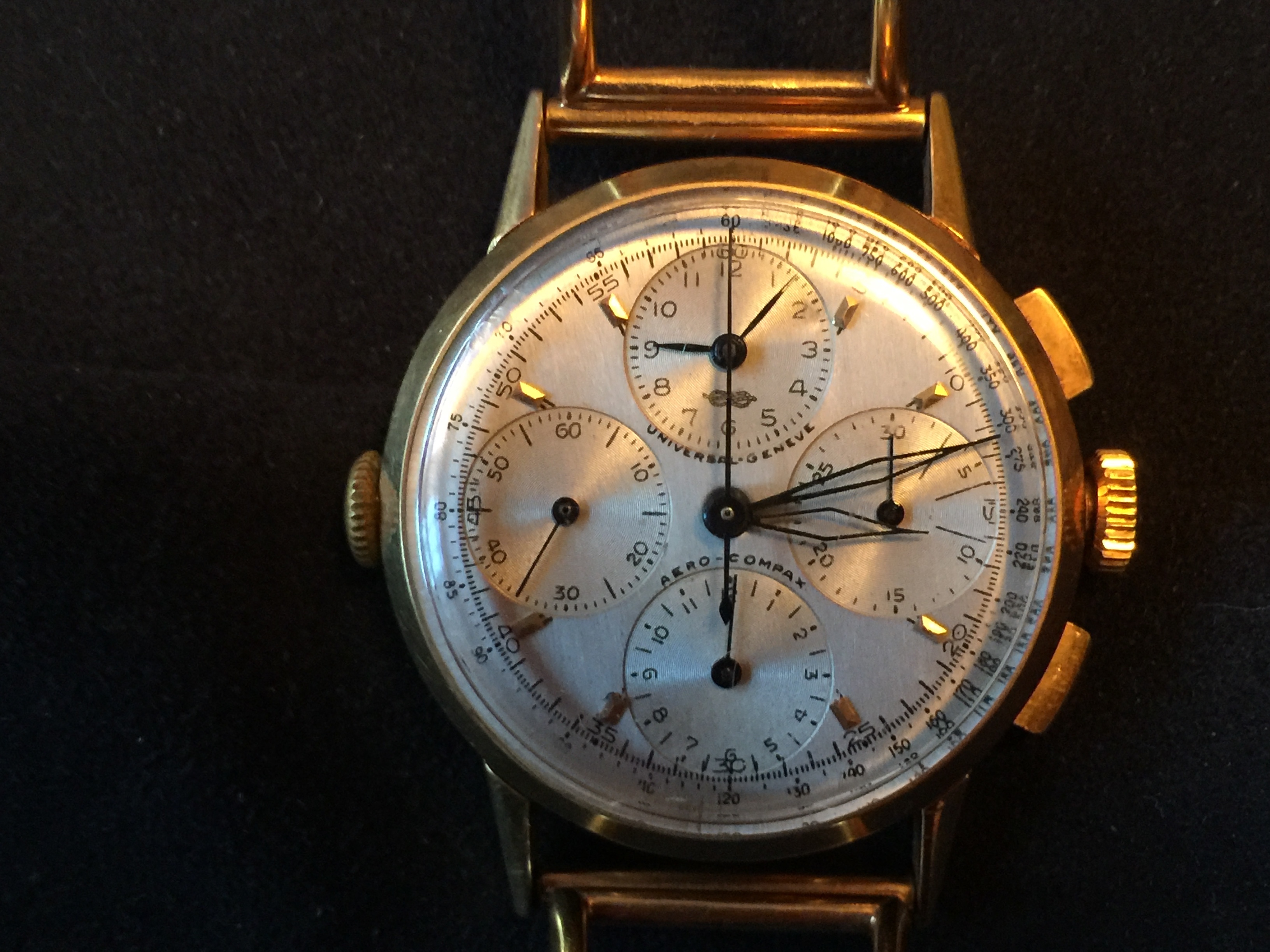

Hi you guys. I’m a newbie on the list. I have my dad’s UG Aero-Compax chronograph, circa 1940’s, gold with a fixed gold wire band. It works, but probably needs some cleaning. I’m attaching some pix. I don’t think it was ever worn much. You all seem to have a lot of expertise in these areas: what can you tell me about this watch? I haven’t found one like it yet online to compare.
Thanks a lot in advance!

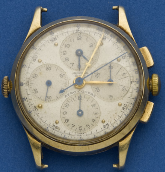

Wow! A very very lovely case and dial. Hour and minute Hands are UG, missing Lume, but as there is none on the dial not original to the watch. This left the factory with gold baton hands. Might have been a custom add on by the dealer. I would get it serviced before wearing it much. The knot is a “savoy knot” ... you can search on it here in the UG forum btw. Here is a factory ref picture.

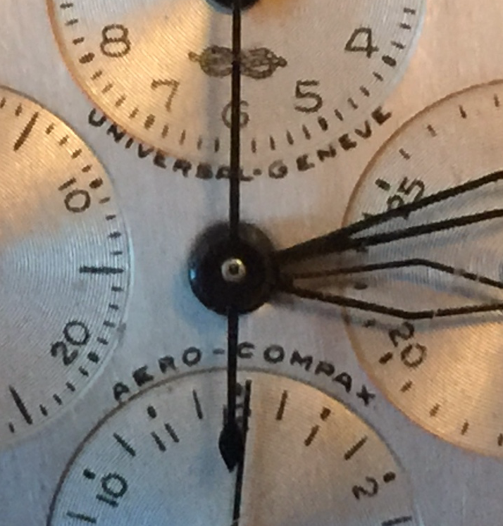

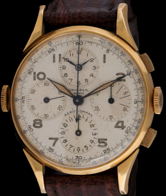

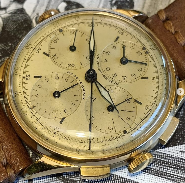

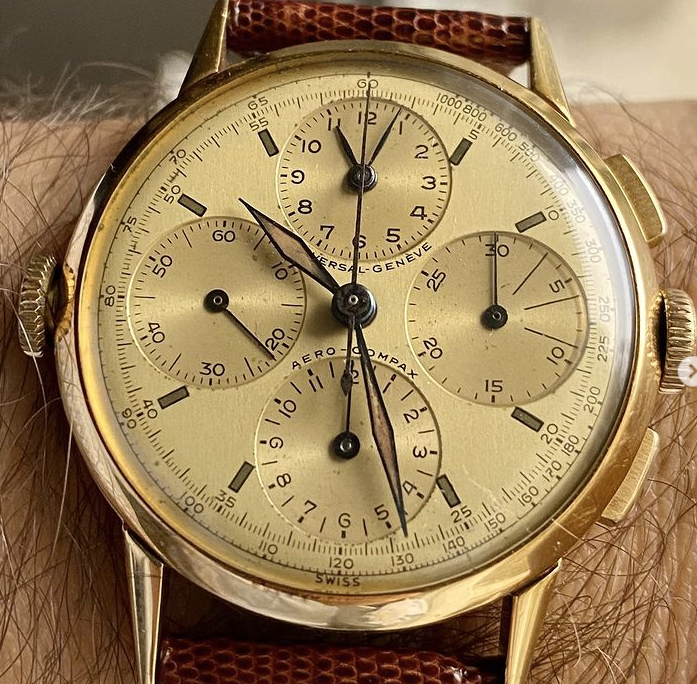

I am not a UG expert by any means but the printing on this dial looks quite poor. Also, the gold markers on top of printed lines appears odd, but I acknowledge that this could be normal for UG dials of the period. Below are a few other gold Aero-Compax examples. To me, all have more precise printing than the one above. Note, for example, "Universal-Geneve" and "Aero-Compax."
https://www.instagram.com/p/CIIsiAerVam/
https://www.instagram.com/p/CKrBr9KLkBA/
https://en.expertissim.com/universal-aero-compax-12277052
https://jewelry.ha.com/itm/timepiec...-geneve-14k-gold-aero-compax/a/171146-72052.s

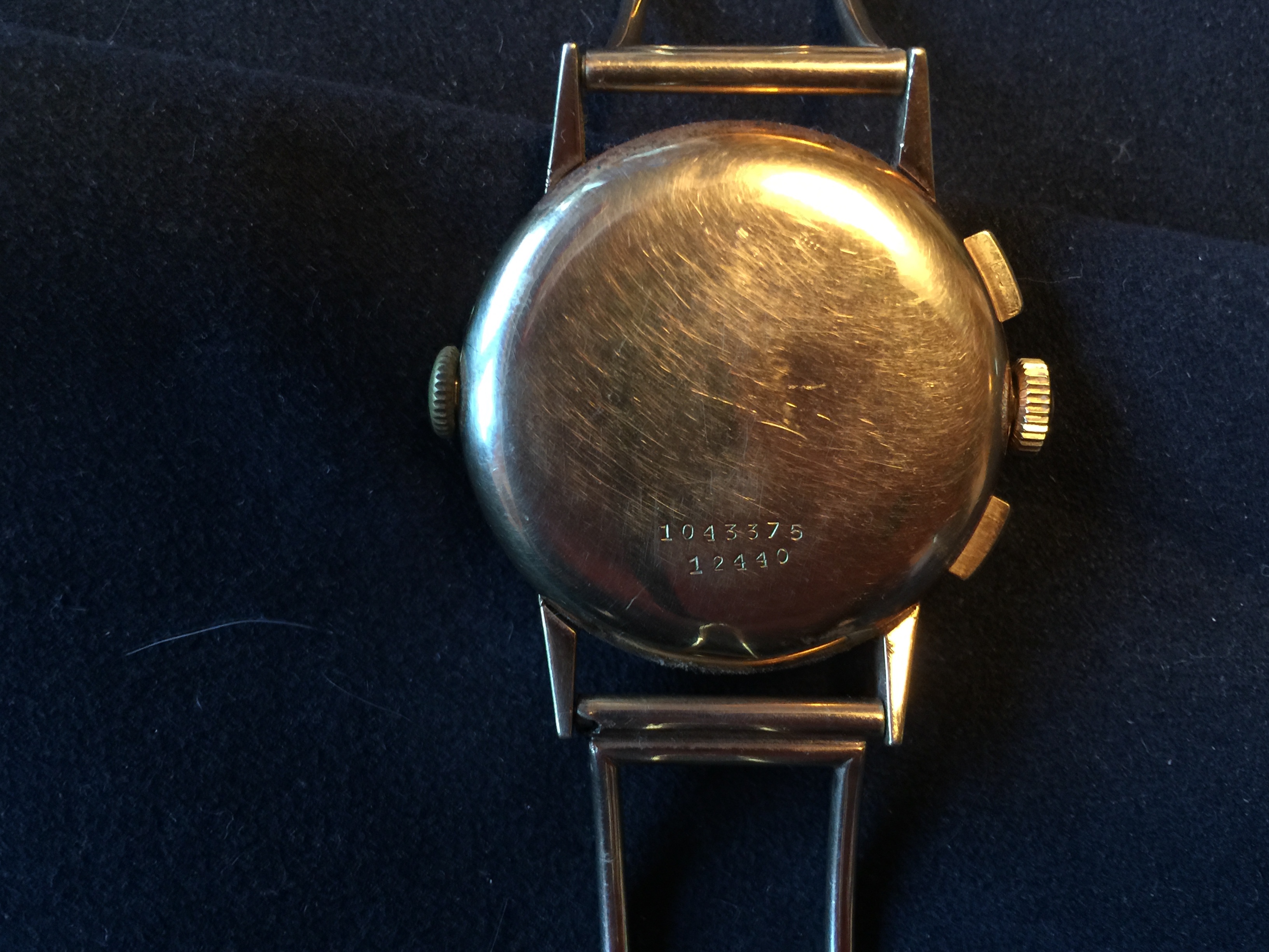

Good to know. The watch actually works. If you gingerly wind it, it will hold time for ~24 hours. Stop watch works fine, as do the smaller dials. It was only worn a few times, for dress. I am positive my dad bought it from a dealer, (or got it as a gift from his father, who would have bought it from a dealer). And, alas, I cannot wear it, nor my husband--we both have large wrists. Besides it would look a little odd on a woman--rather big!

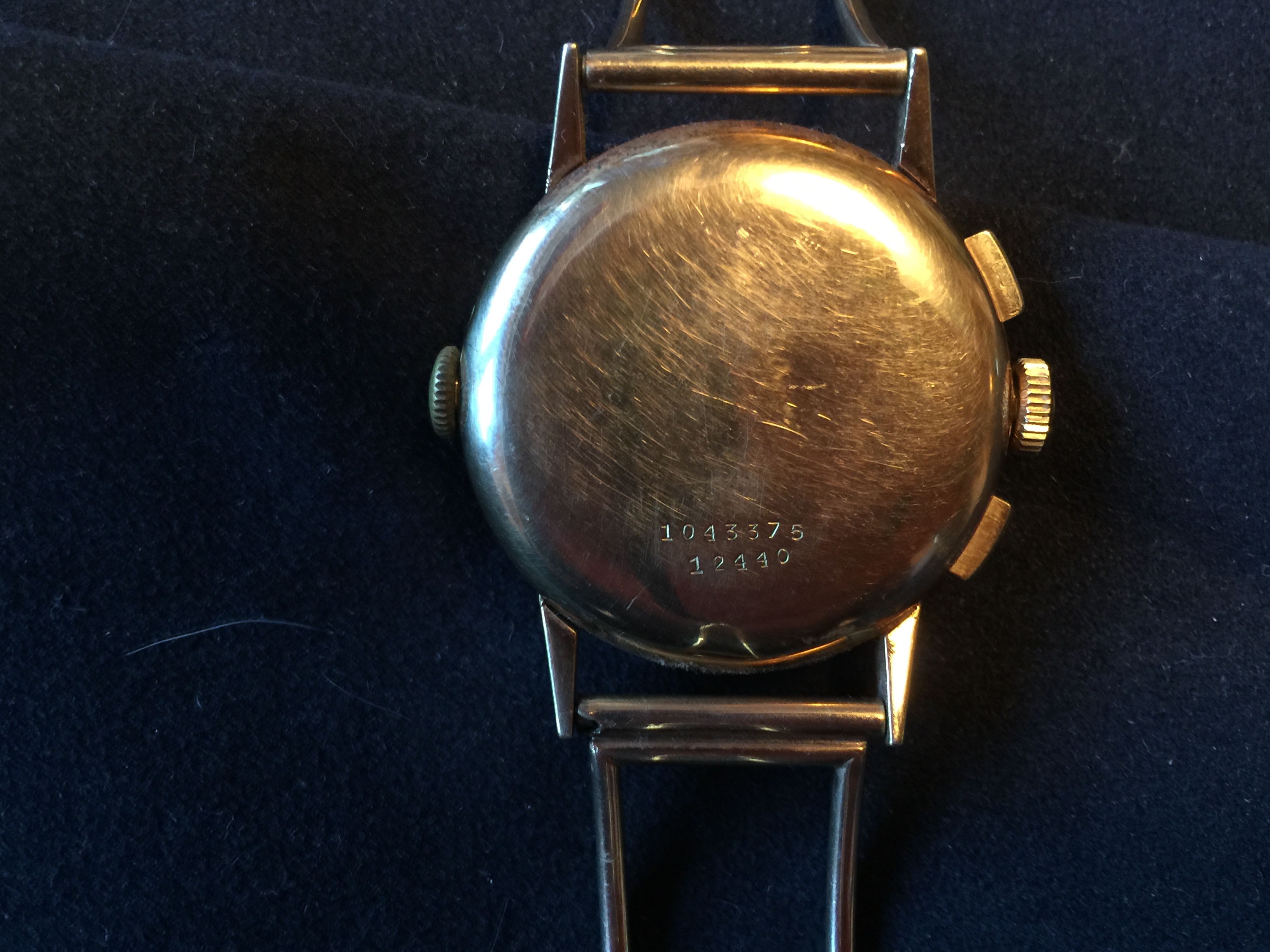

What do the numbers on back tell you?
Thanks--
PS I can send better pix if that would help at all.

Been through a few rounds on these. I think the dial is ok. This particular model is all over the map. Perhaps I’m wrong but I’ve learned not to be pedantic with the Aero.

the top is the SN ... see “Universal Information” sticky. The bottom is the reference . This probably has female springbars holding the band on which are very difficult for a novice. A good watchmaker could service the piece and put a leather strap on it for you. Personally black or blue matte alligator would kill. Don’t let them talk you into drilling the case for std bars.

You have much more knowledge than I on this topic, but if this is truly original, I'd like to know what UG's Quality Control people were being paid for...

I think we all would like to know that. 😗We know they used numerous suppliers. This particular model is thinly documented in Sala. I’m curious to see if this thread goes multi page.

To the OP, thanks for posting your dad's watch, very cool to have something like this in the family. No offense intended, but I would not call this mint, or even remotely approaching mint.
The dial looks redone and as Larry pointed out, the hour/minute hands don't match the dial, and both crowns look replaced. All common enough stuff to happen to a watch approaching 80 years old.

It's a redial. OP if you can open the watch and show us the movement you'll get a better grasp of the price and what's authentic in it.

Ok ... I’m now in the redial camp. Odd markings under indices, registration and print quality. I say this with some trepidation after the debates last year.

There’s no need to defend your father, no one is accusing him of anything, this is just a watch enthusiast hobby site. Mint is a vague term but generally means in same condition as it left the factory. Your watch is not fake, it’s simply had some of the components refurbished or replaced, as was common back in the day. This has a significant impact on financial value to collectors now, but doesn’t need to diminish its sentimental value and enjoyment.
It’s not a problem to have the thread here, it’s just you will probably get more response in the sub forum dedicated to this brand.
If the watch were mine, I would consider trying to find an original dial (not easy), or perhaps have the current dial refinished to a higher standard. I’m sure it needs a full service as well, if you want to use it. Either way, enjoy it 👍

I wouldnt call it a fake. The dial was repainted. Probably the dealer sold it to your father this way. It wasnt a big deal back then as it is now to a small group of watch nerds (myself included) obsessed with originality.

Dad was a pilot which totally explains the hands and why the dial was redone. These were working tool watches.

A well enjoyed watch. Very nice band too. Thanks for showing it.
Love to see the inside of it
Keep it in the family for another generation !
Get it serviced, new strap and wear it.
