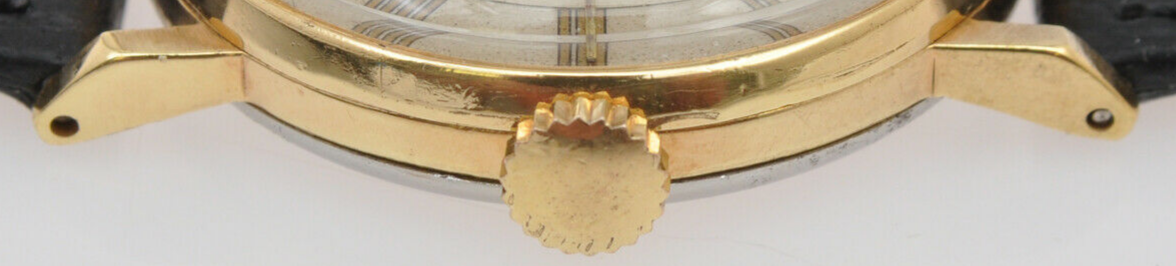

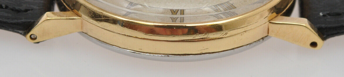

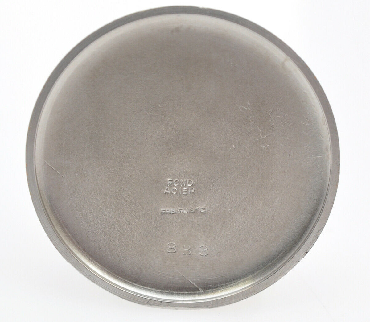

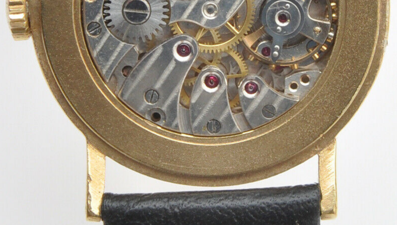

I found this watch listed online and while the seller has it listed as being gold plated, the scratches and dings seen in the photos give me some doubts (or wishful thinking). Hoping someone with a more trained eye can help shed some light. The watch is from the 1930's or 40's. Thoughts?
Thanks in advance!

It is my understanding that watches in the 1930s and 1940s were more often gold plated and gold filled then solid gold. If the watch was solid gold it would not have a steel caseback. Also, the high end brands, Patek Philippe, Audemars Piguet, Breguet, Rolex, etc, would be far more likely to have a solid gold case. Solid gold cases from less known brands were often melted down for their gold content. Many of the more expensive brands had gold hallmarks inside the case to indicate the metal content of the case; 18K, 14k, or 9K, gold filled, etc.
I can almost guarantee you that the watch you found online is as the seller has advertised... gold plated.

With that case back the best you can hope for is gold filled, so you can reveal pictures of the entire watch as no one is going to steal it away from you 😁

I was basing my post on the case back. The best one can hope from any watch that is gold colored with a stainless case back would be gold filled.

There are exceptions to that rule also.

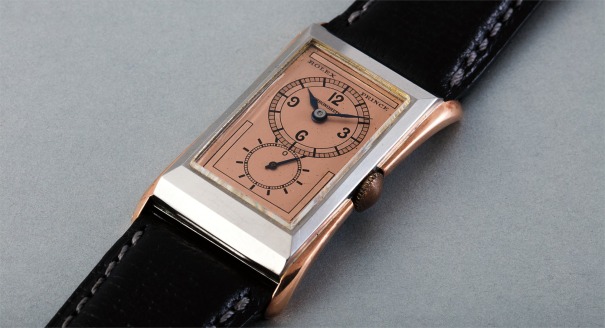

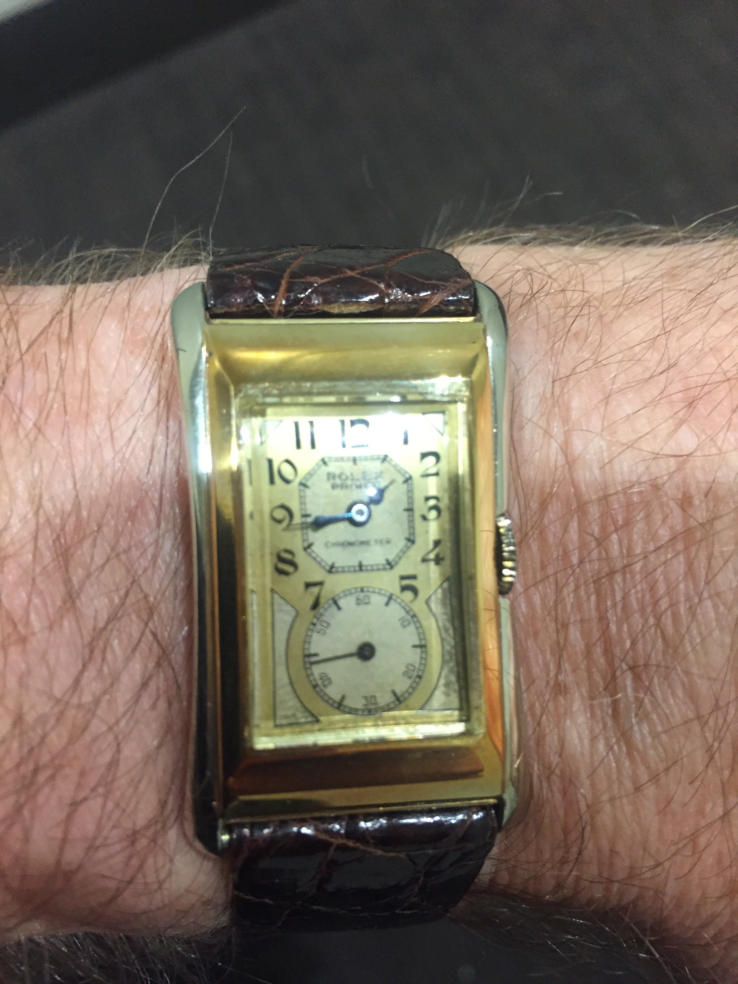

He's right. I once owned a Rolex two toned stainless steel and rose gold doctor's watch and the caseback was stainless steel. I don't have a picture, but I found one similar online and have attached the image. I sold the stainless steel and rose gold to buy a white gold and yellow gold Rolex Prince Blanchard Doctor's watch ref 971 which I still have today.
