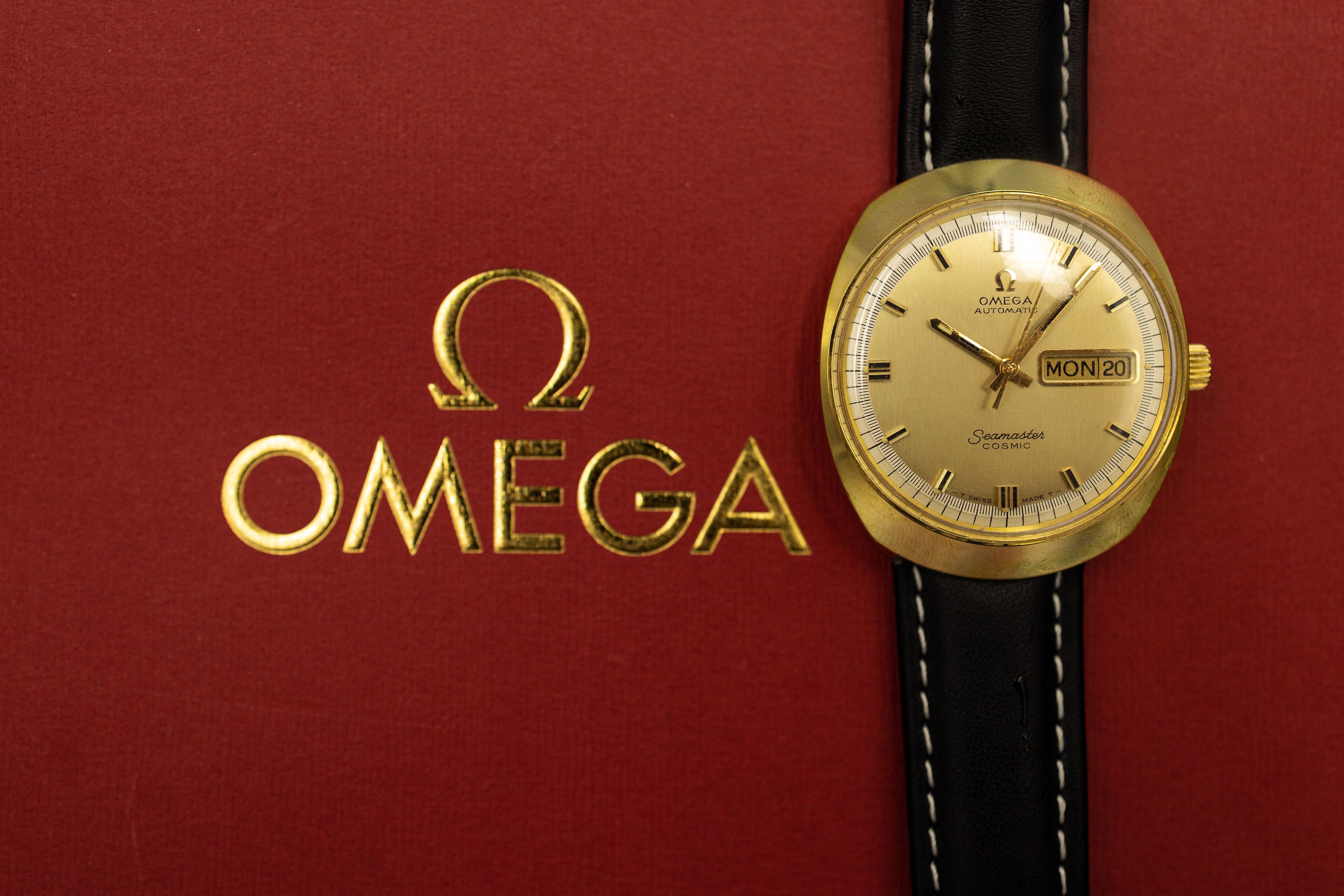

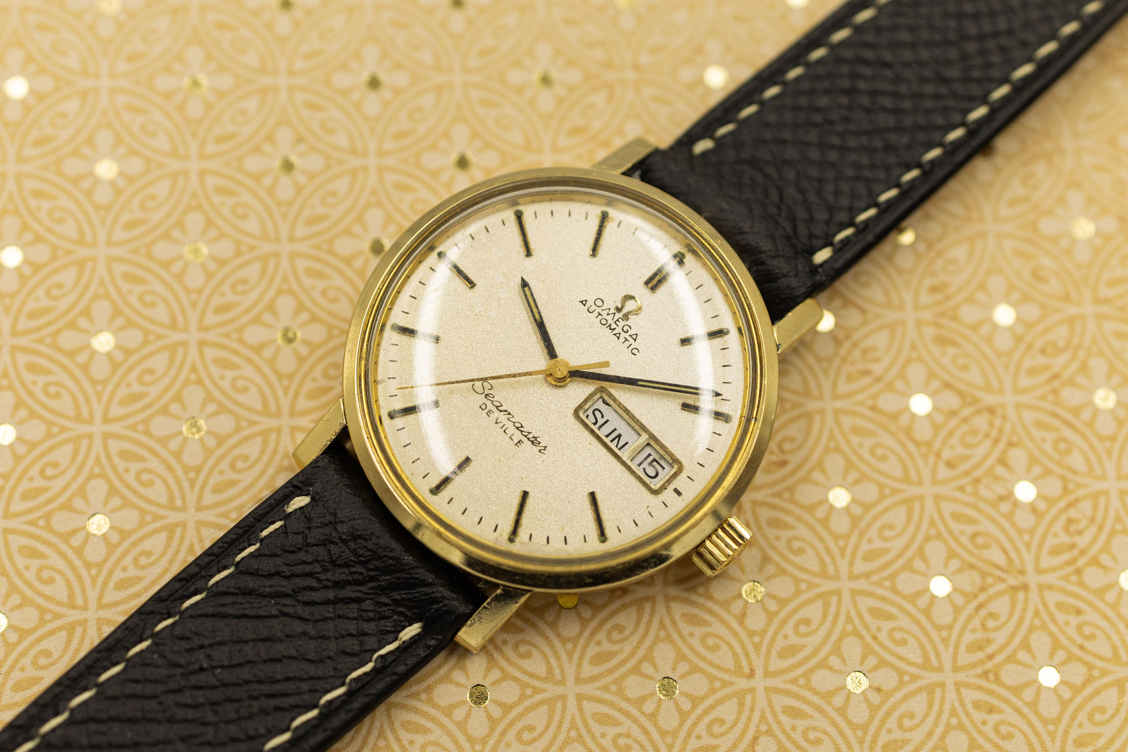

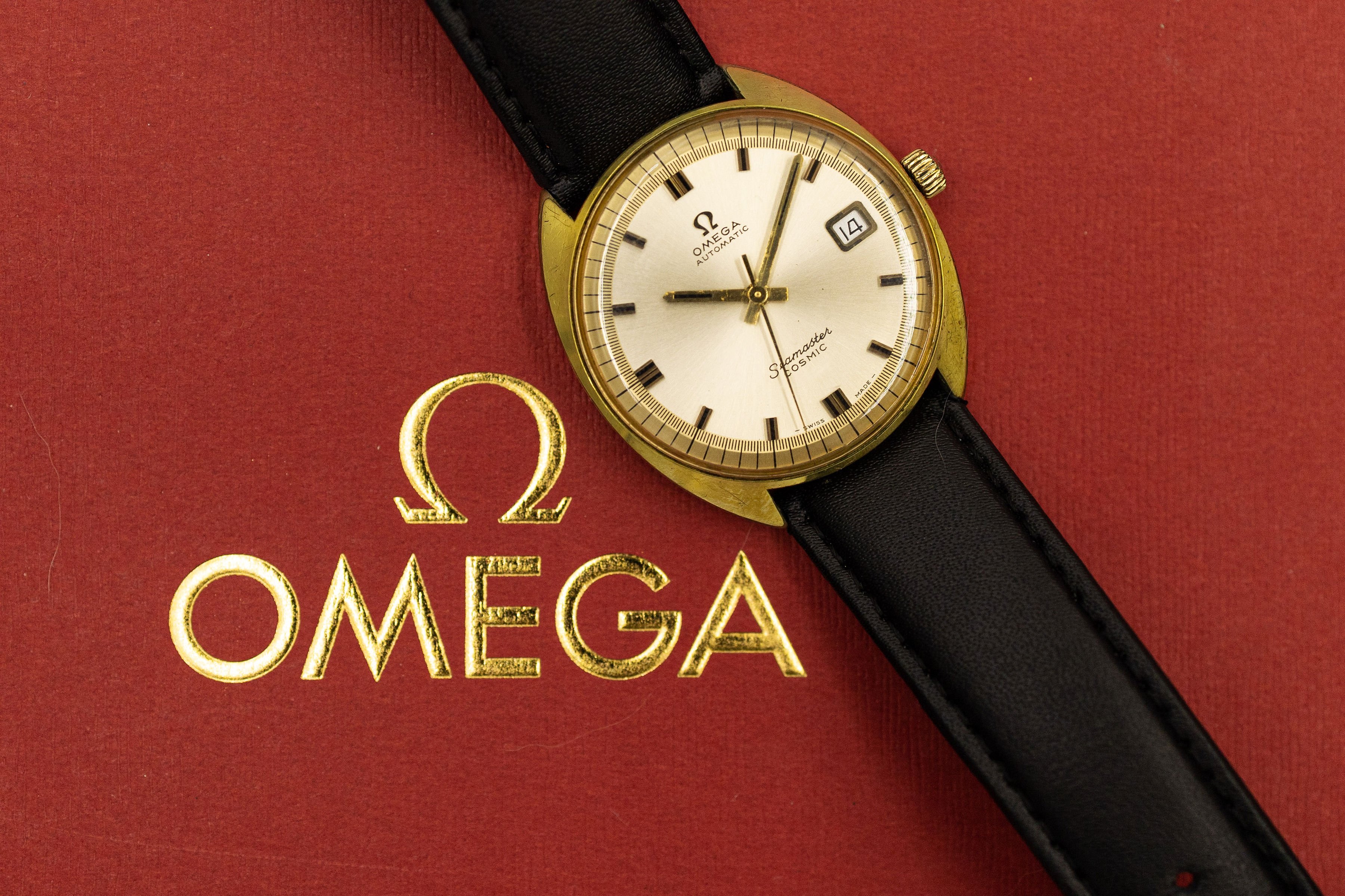

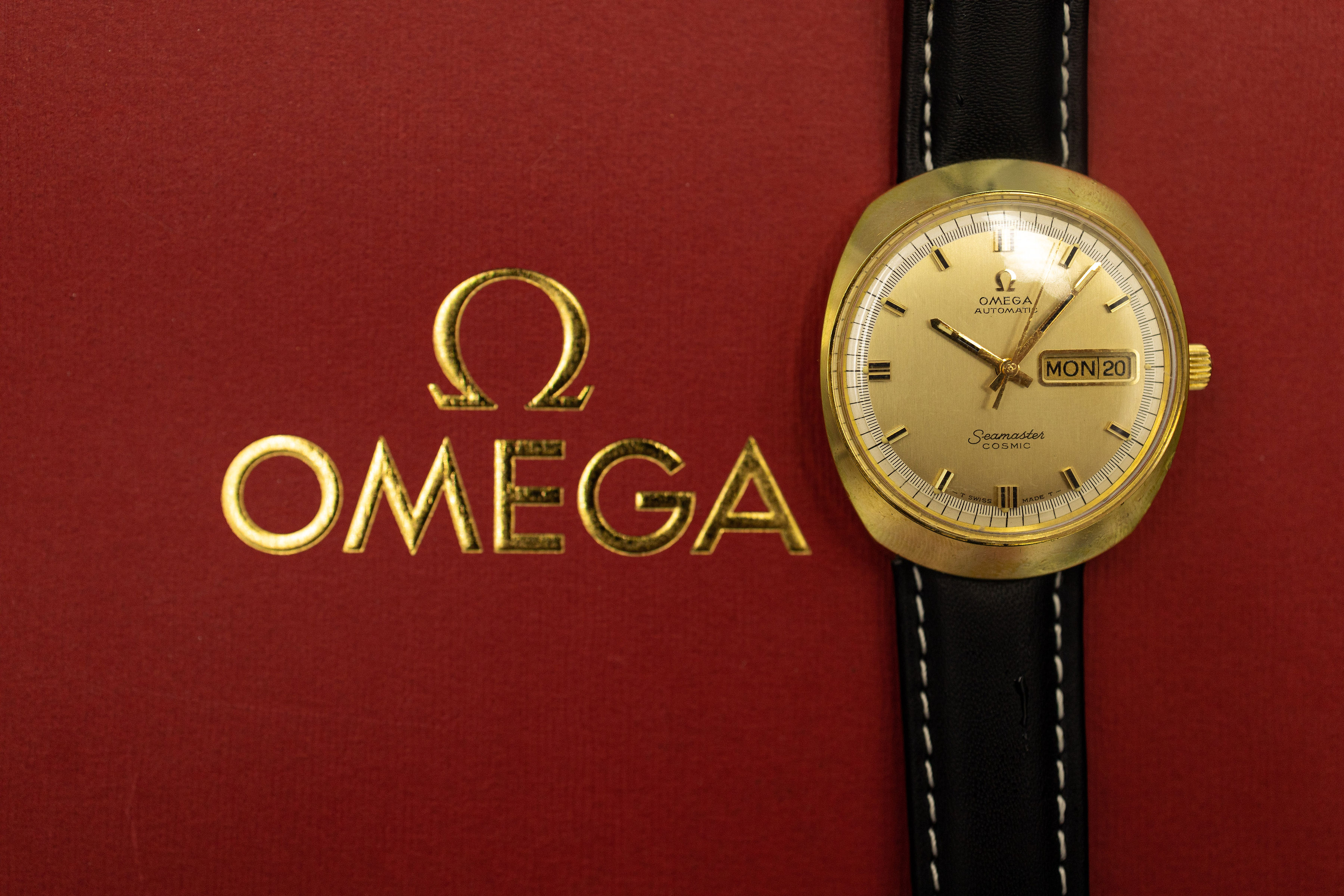

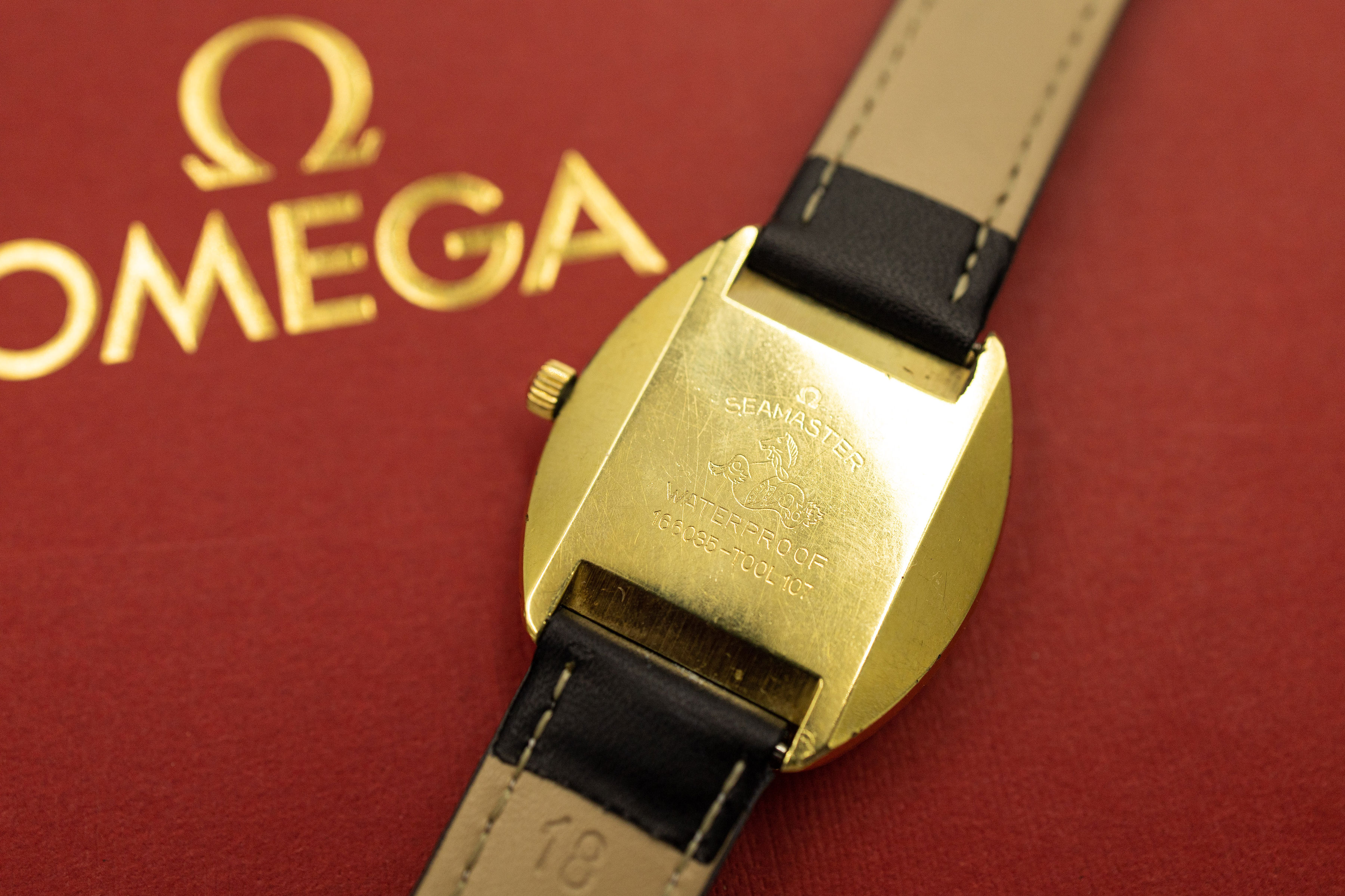

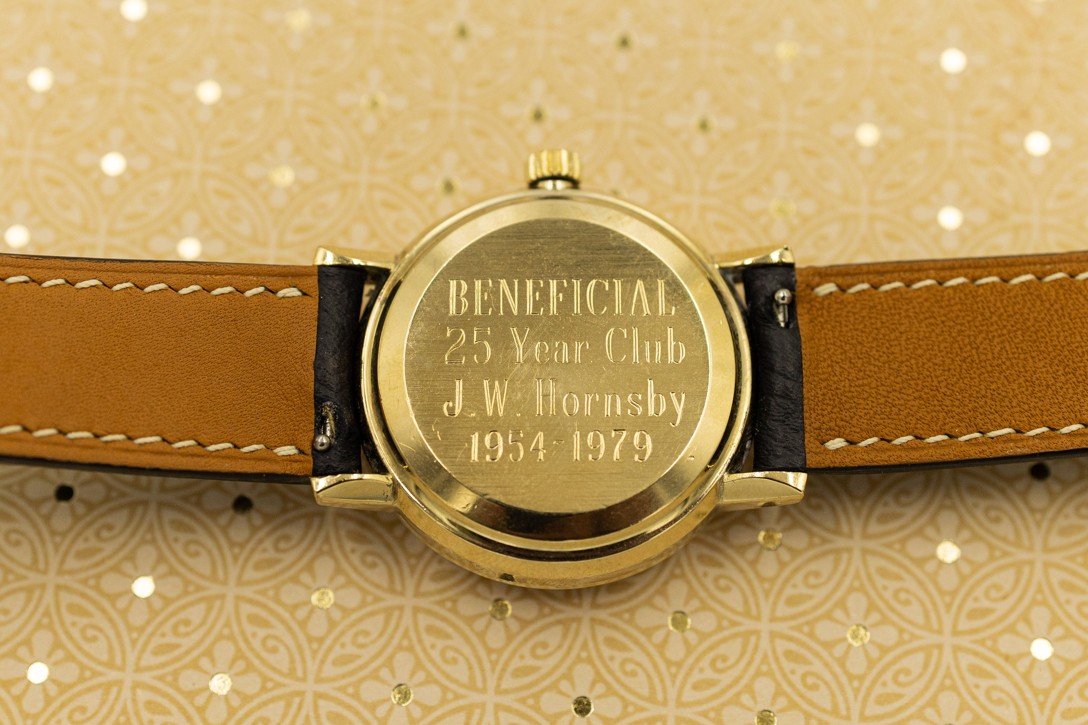

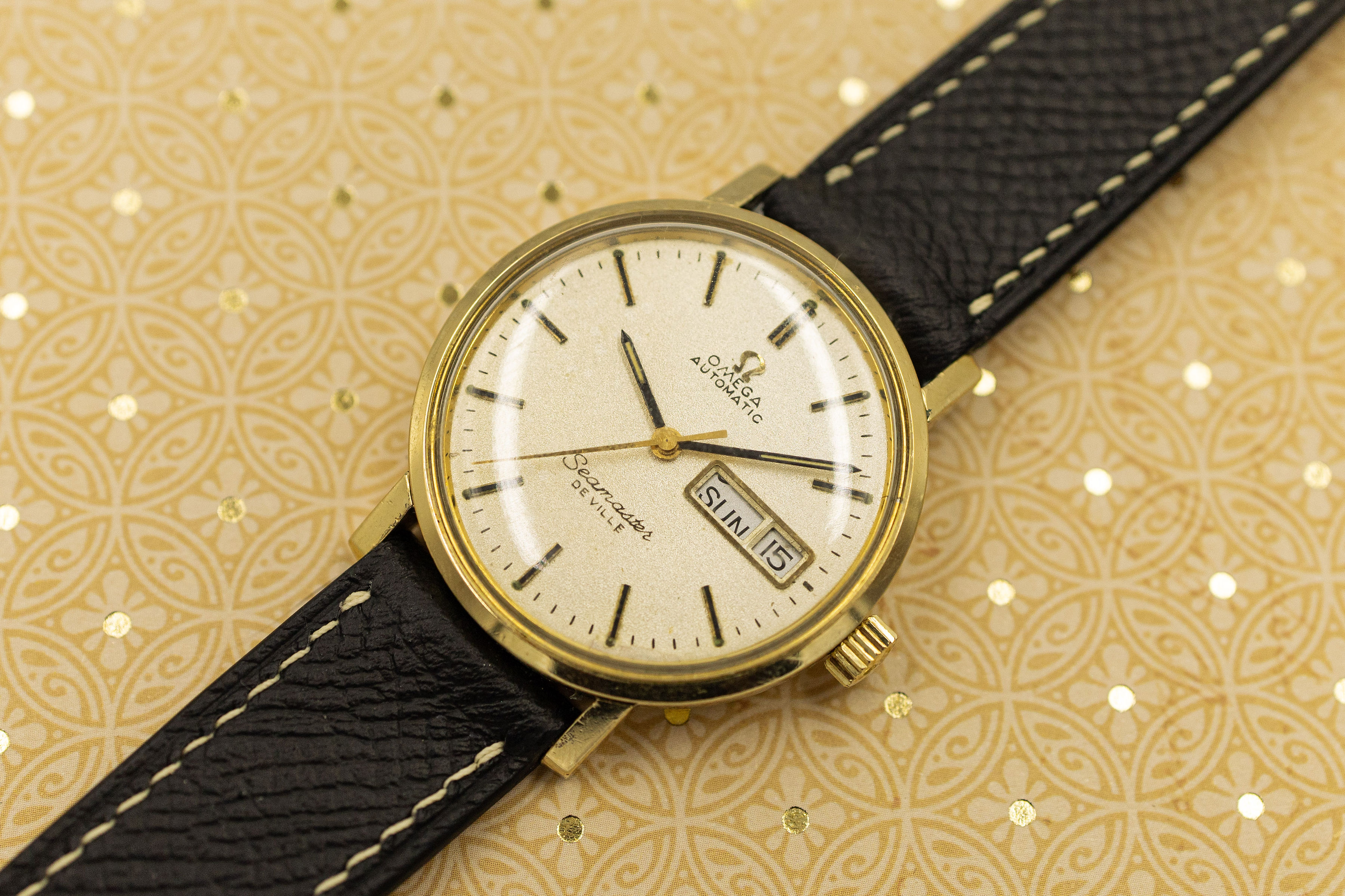

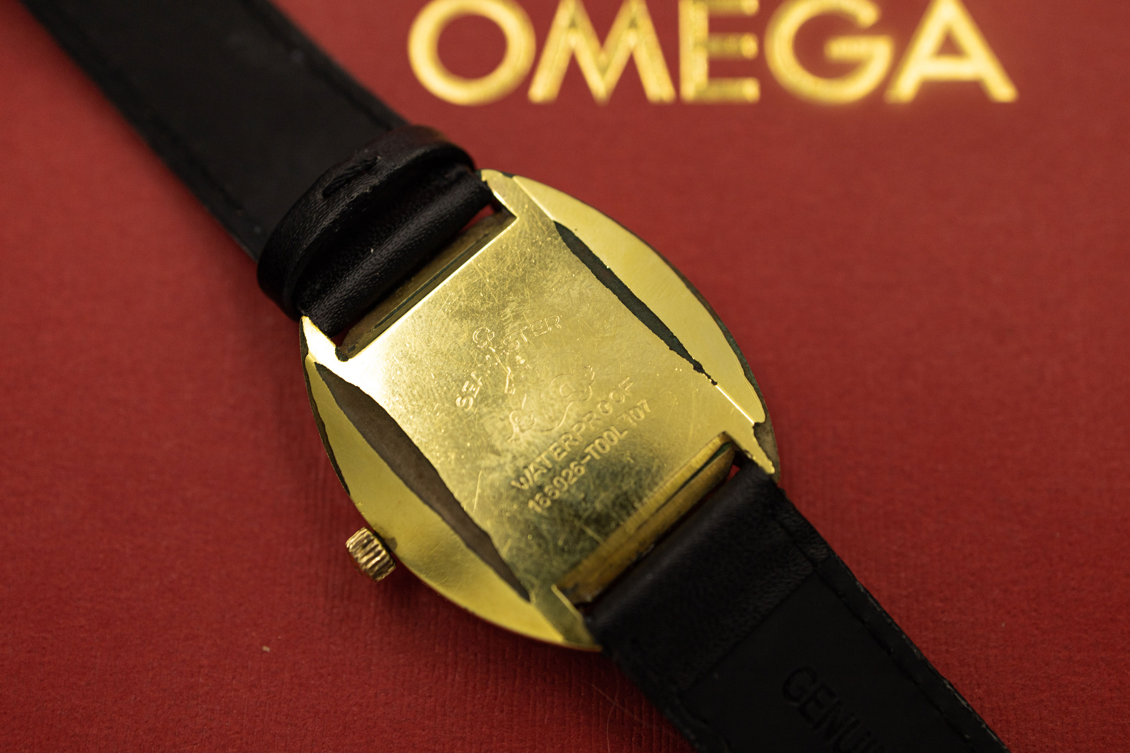

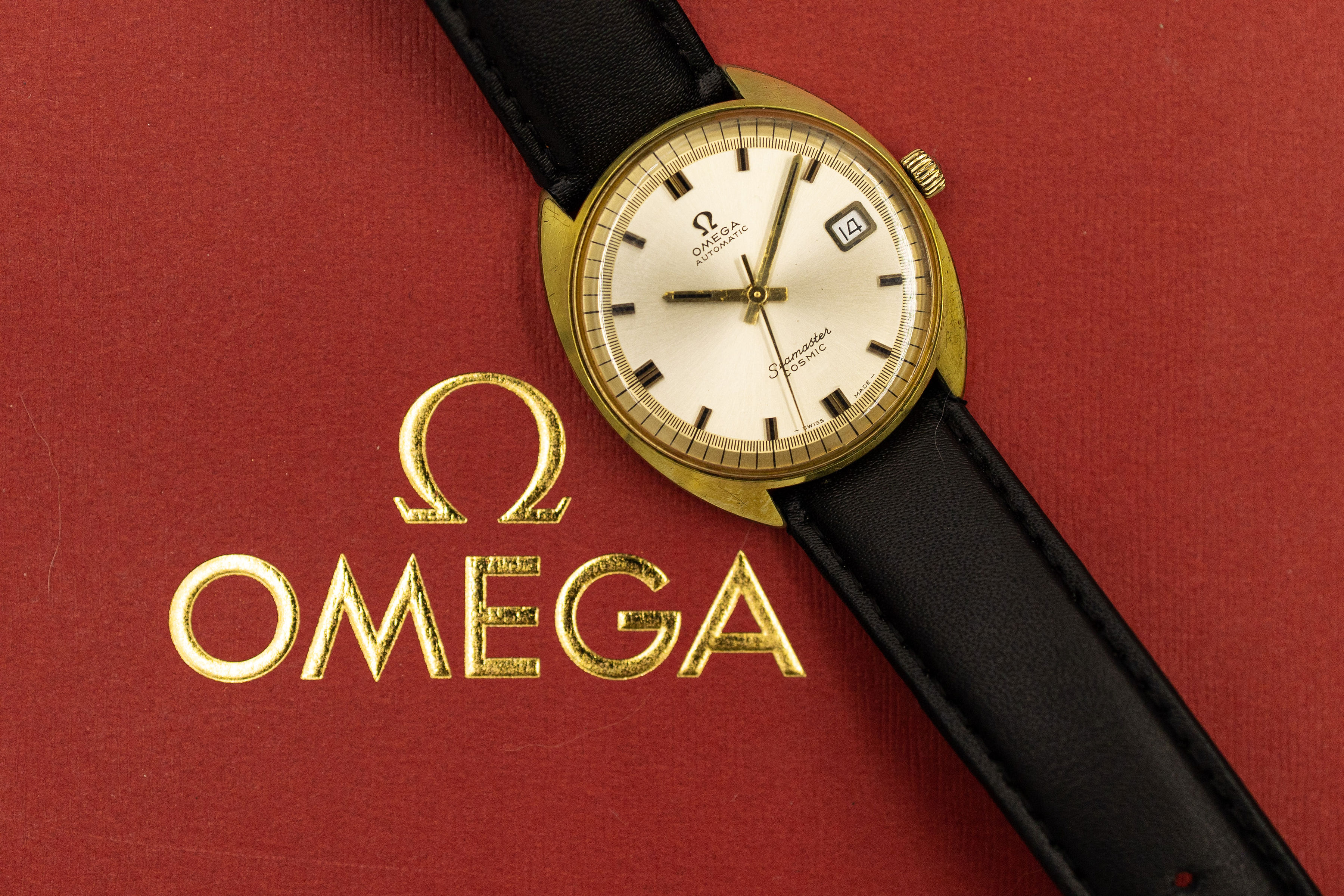

Hi vintage Omega community, I have a hard time discerning the difference between watches that are gold filled or gold plated, would appreciate some of your thoughts and expertise. I included two of my Seamaster Cosmic and a De Ville. Thanks in advance!
18,776
39,021
One simple indicator is that if the caseback is stainless steel, the case is plated/capped.
However! With the Cosmic, as it's a uni shell case this isn't the case 馃槈.

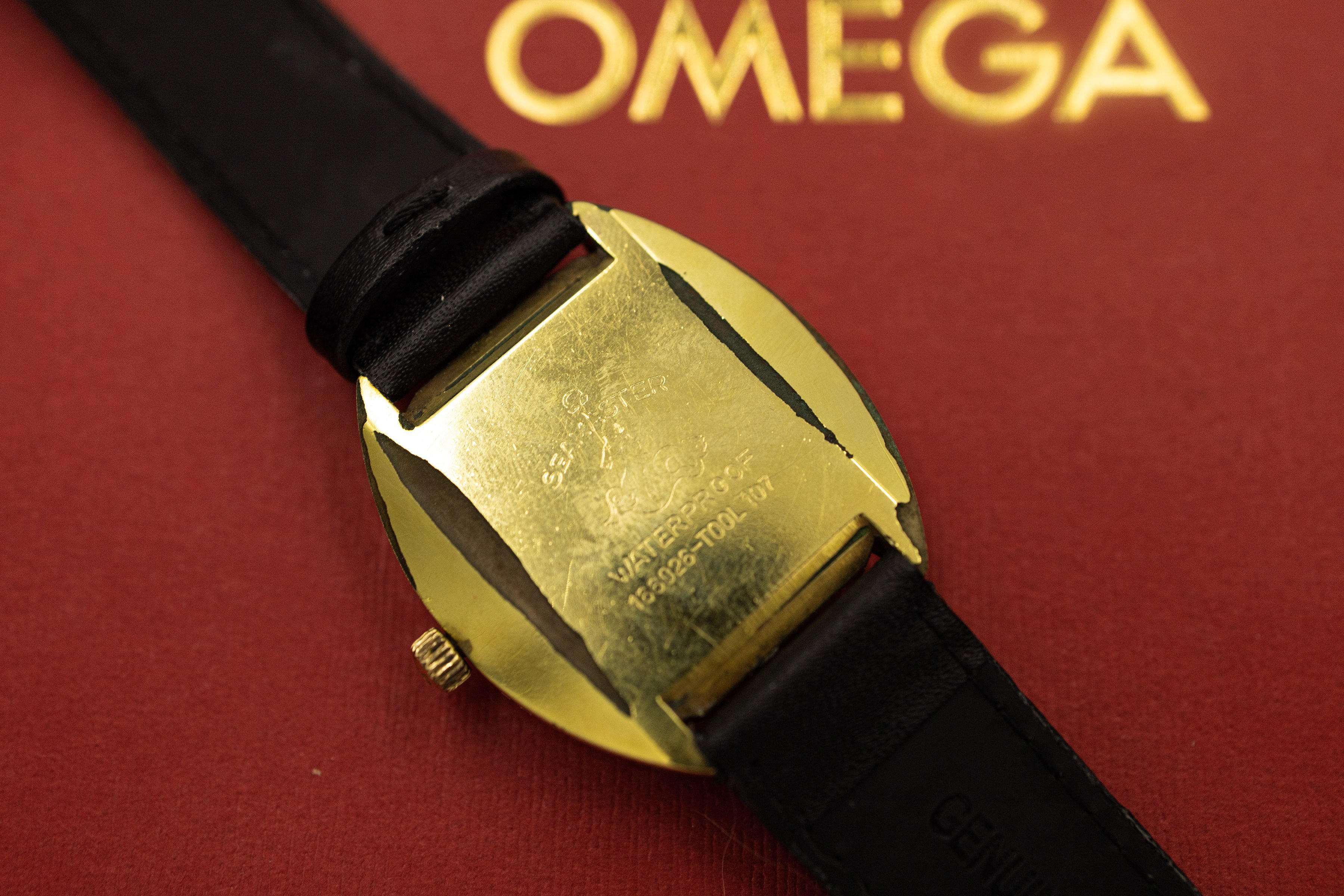

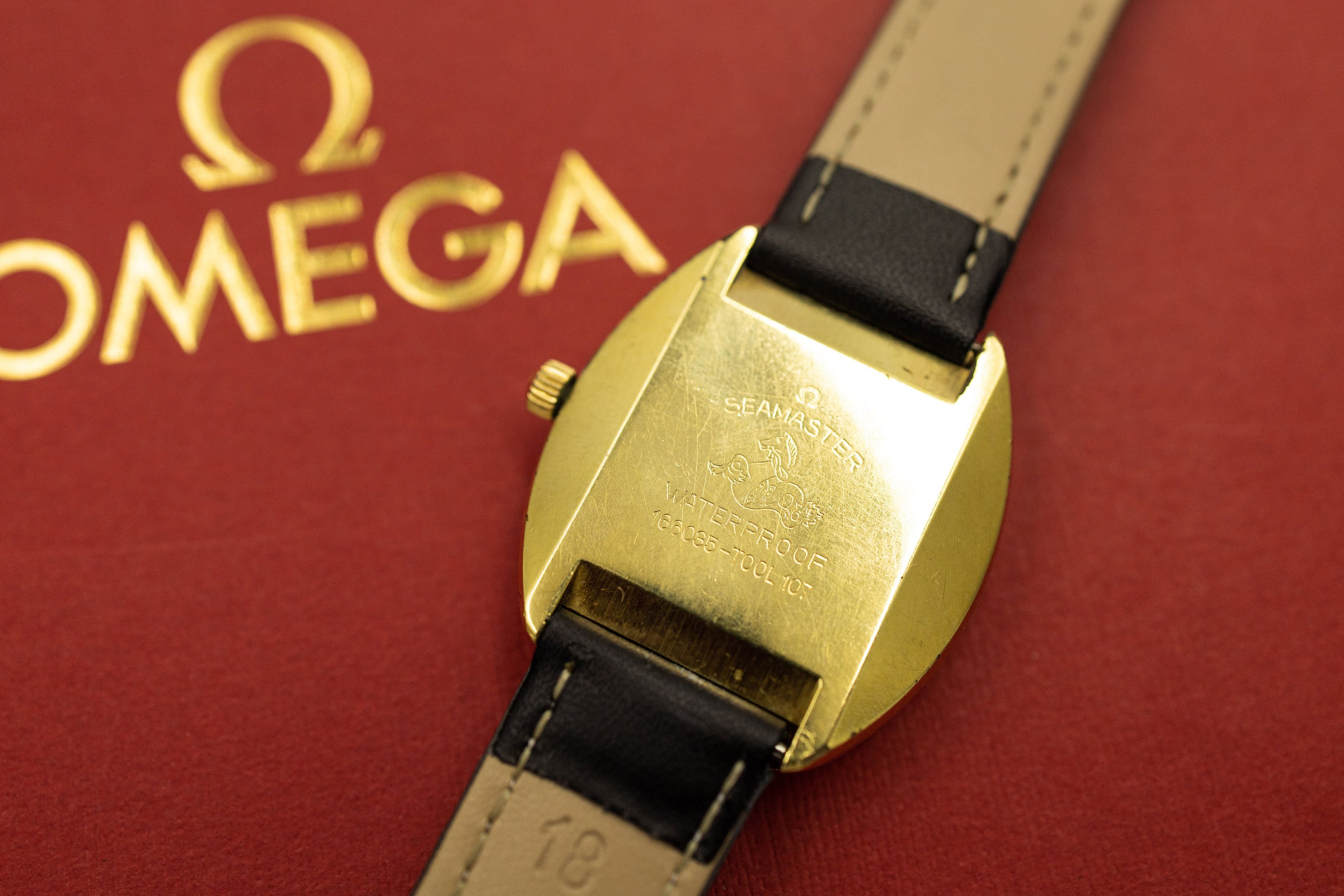

The whole case is gold plated and will be stated as such inside the case.
You can also see where the plating has worn off on one of your Cosmics.

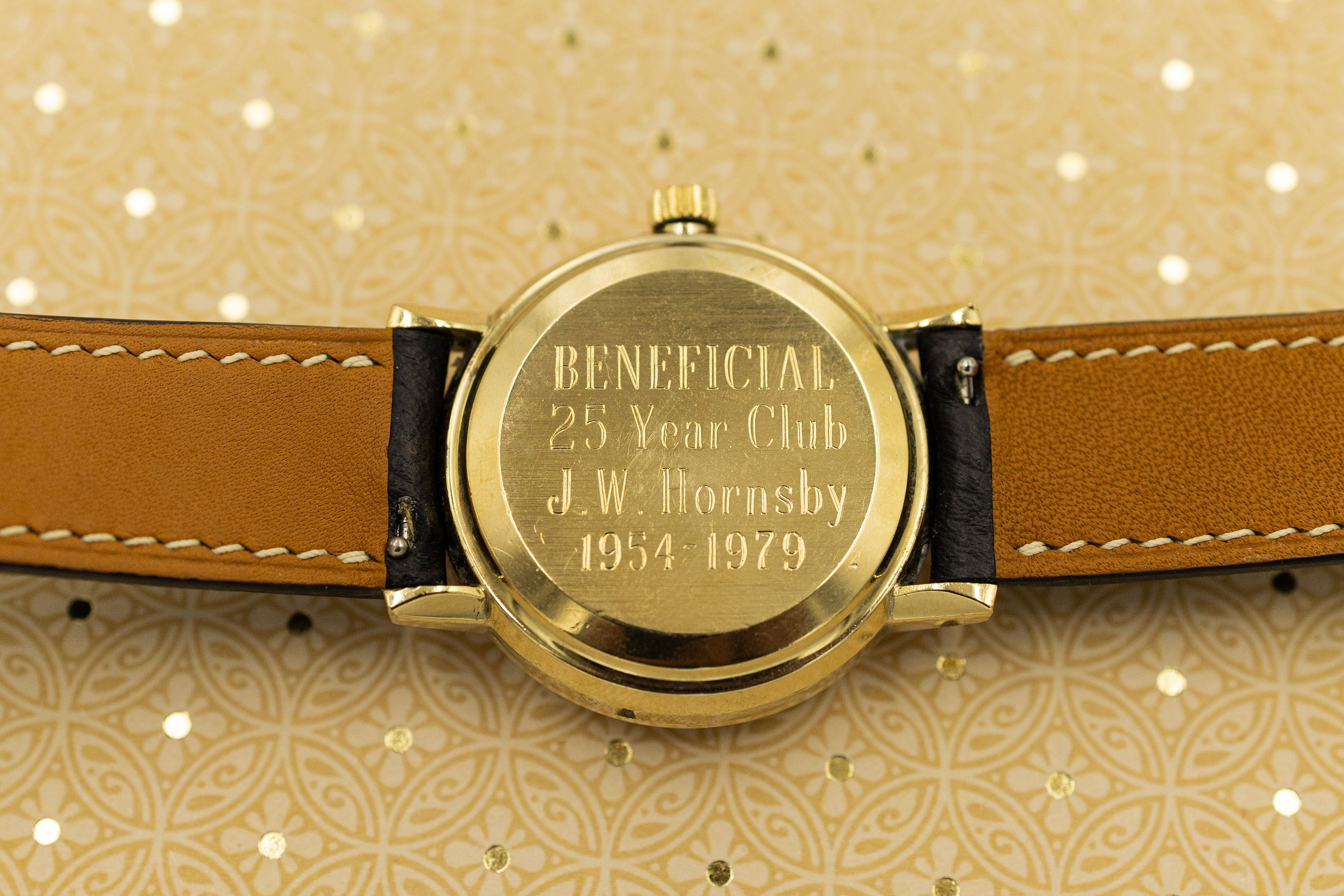

Apply this rule to the De Ville and we can assume that the watch is solid gold. Adding to that is the fact that it's a presentation watch and these were usually all gold during that era before companies got to be tightwads.
Definite confirmation will be hallmarks on the case parts, or markings between the lugs of the De Ville. The Markings inside the caseback of the De Ville will also tell you what you have.
