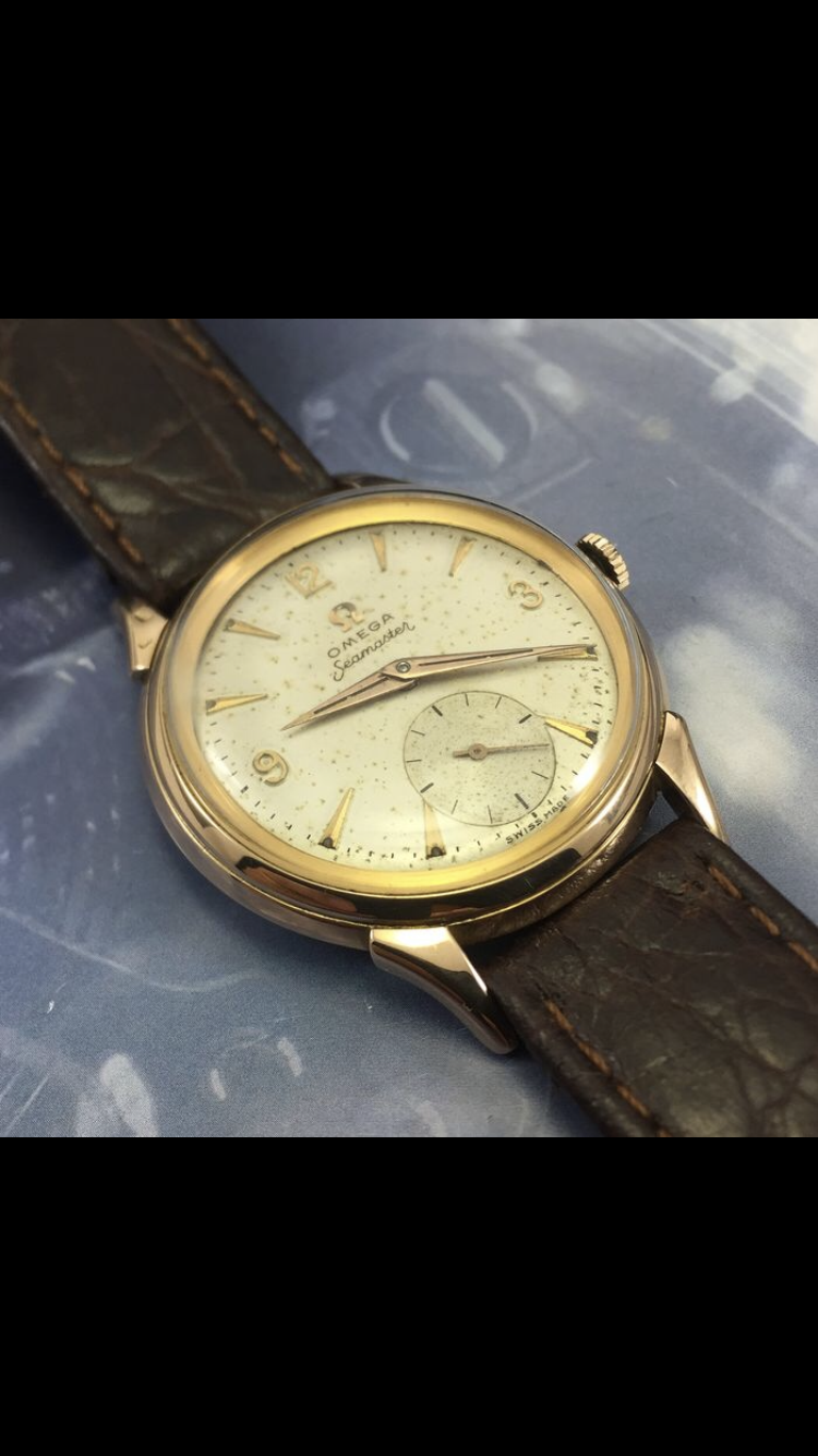

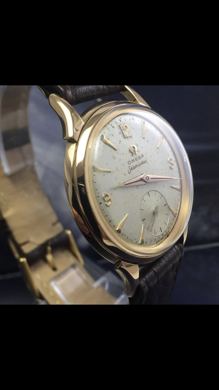

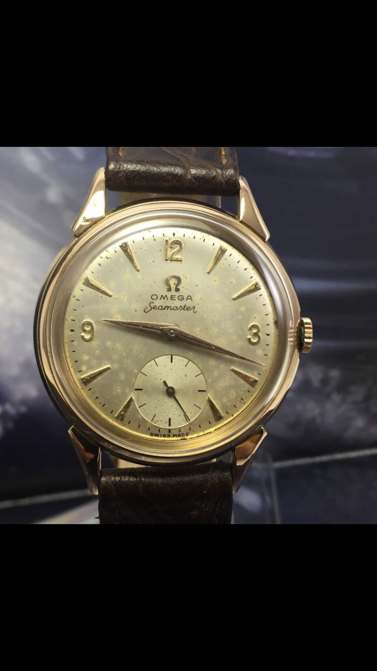

Can anyone give me some info about this watch? I don’t know the reference number, maybe a 2691, 2672 or a 2759. But I can’t find any of those in gold.

To start with: it is a redial. And the reference will be in the inside of the caseback 😁

Why do you think it is a redial? And i know the reference number is in the case back, but i dont have a picture of the inside atm, thats why i’m asking 😀

Couple of thing but wrong fonts and markers too sloppy.

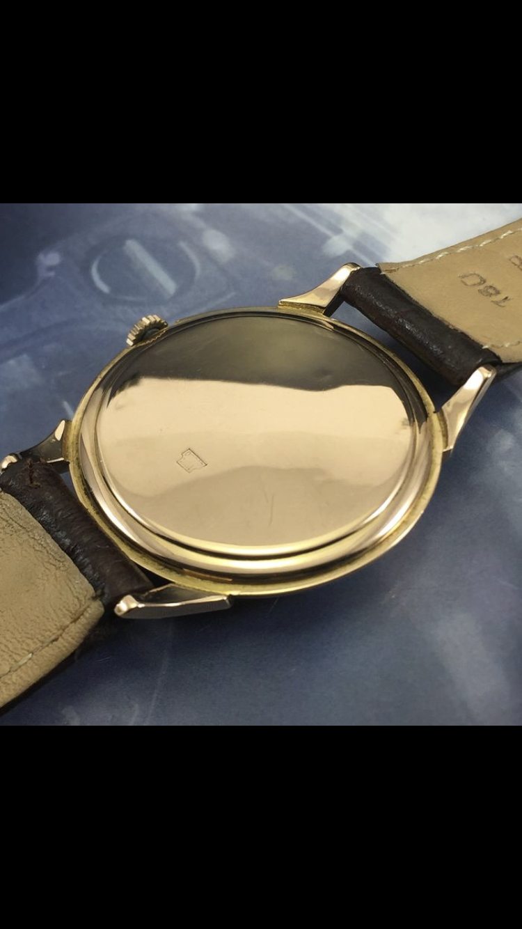

Dial actually looks original to me. The main problem is the overpolished non-swiss case. And these cases do not have a case/model reference number in the inner caseback.

I'm with @MSNWatch. It's legit dial.
Everyone sure the case is even real gold? How often are there marks on the back of the caseback like that?

Very common for South American cases.

+1 here
