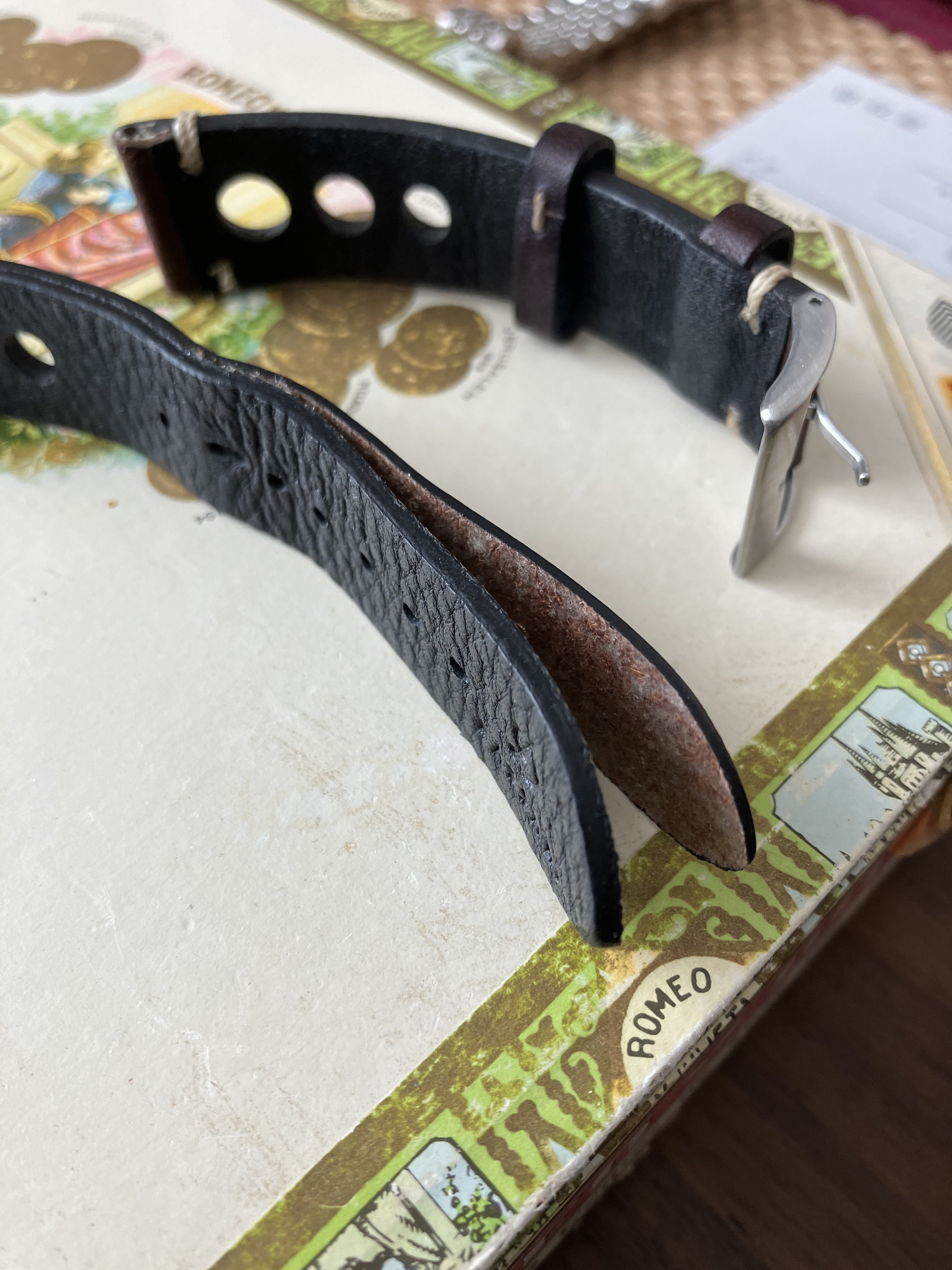

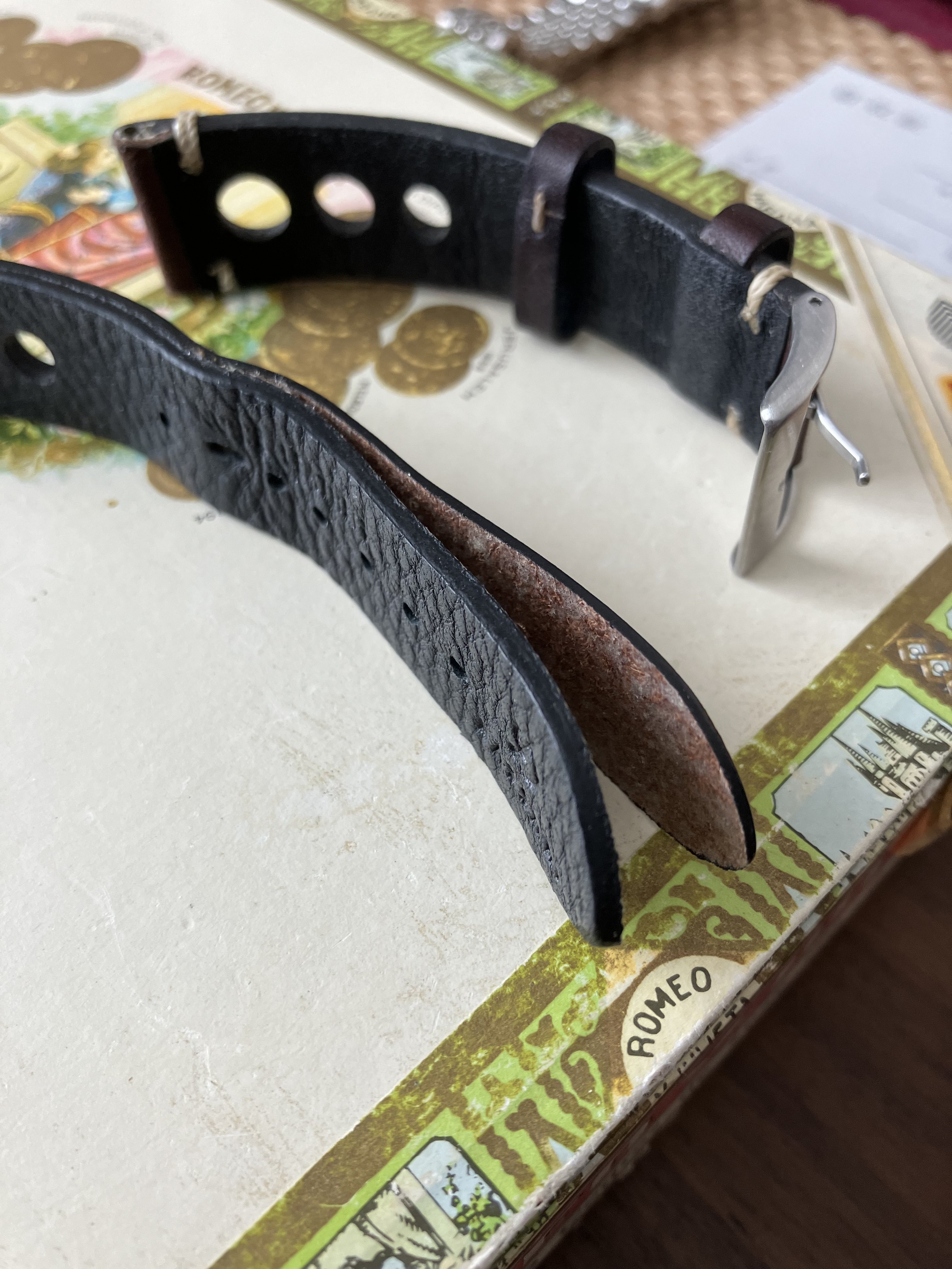

I’ve had two straps give out on me recently, one old crocodile strap that melted off my wrist at my sweltering workplace during our hotter-than-usual September and one leather rally strap that came apart because, I suspect, it’s overpriced garbage. What kind of glue works for this type of repair? Some kind of vegetable-based thing? What do you recommend?
