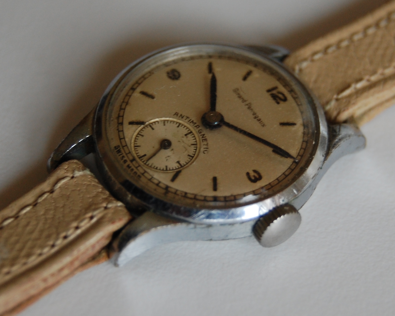

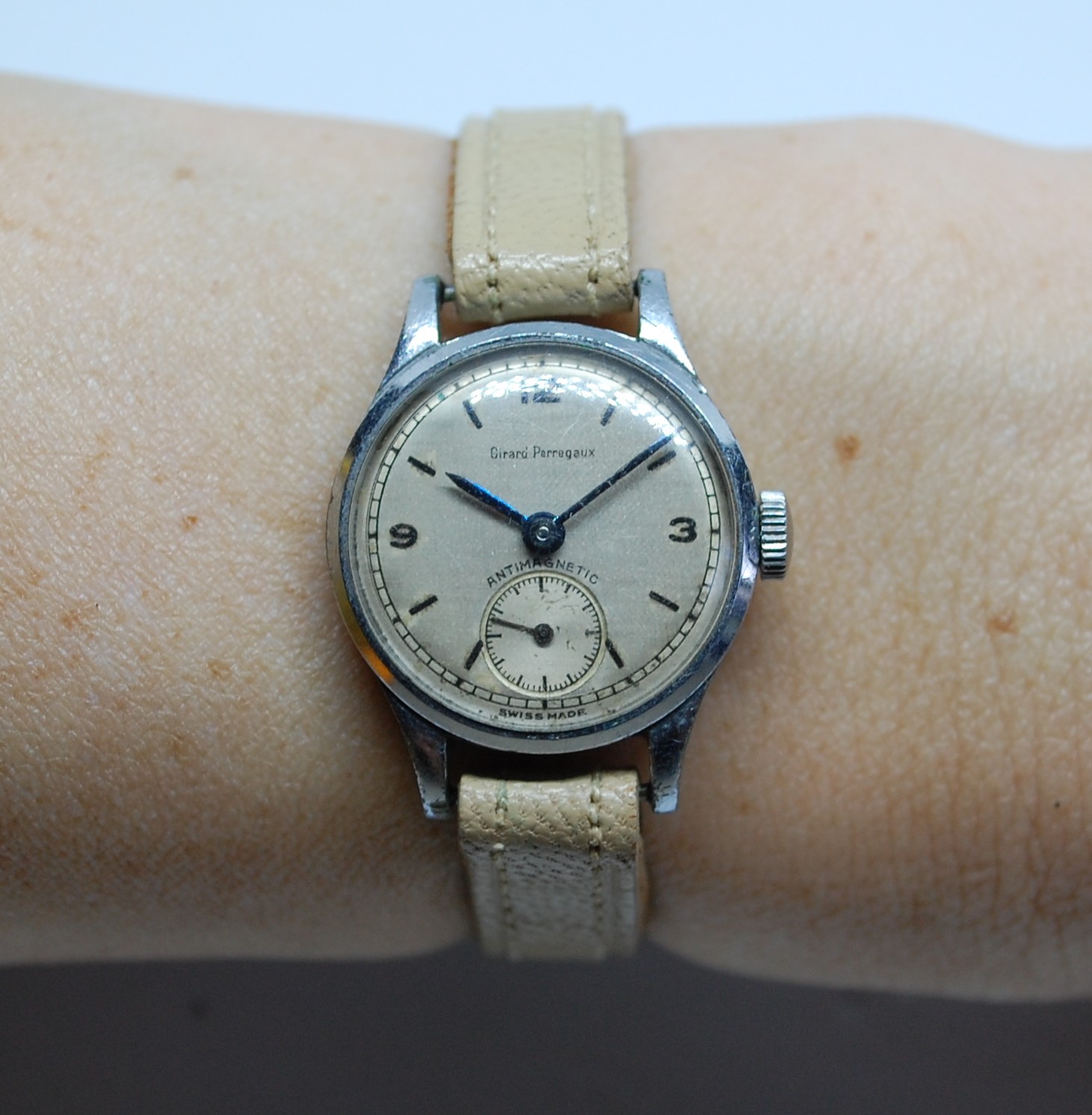

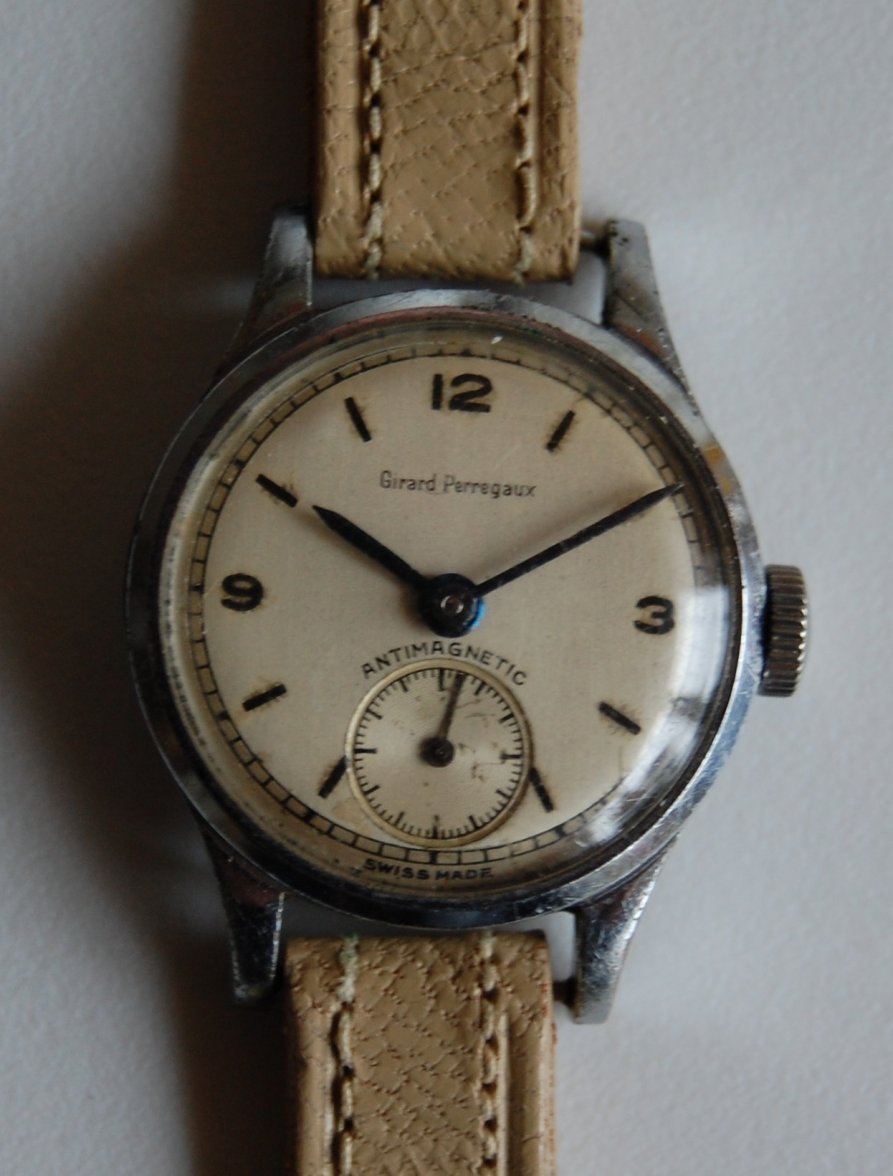

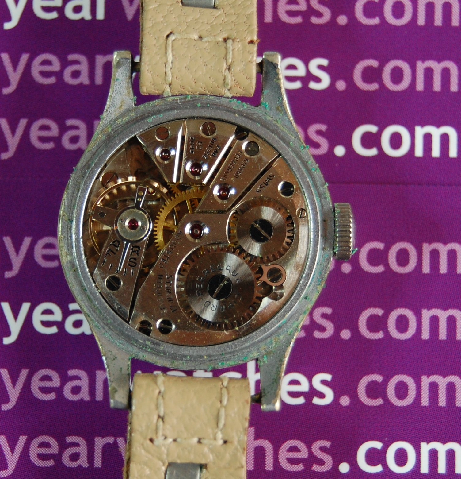

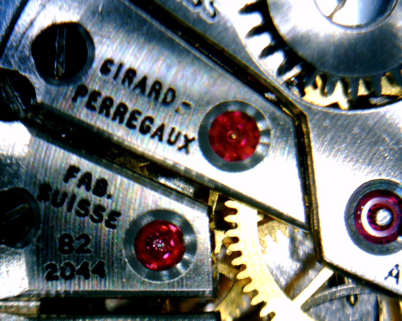

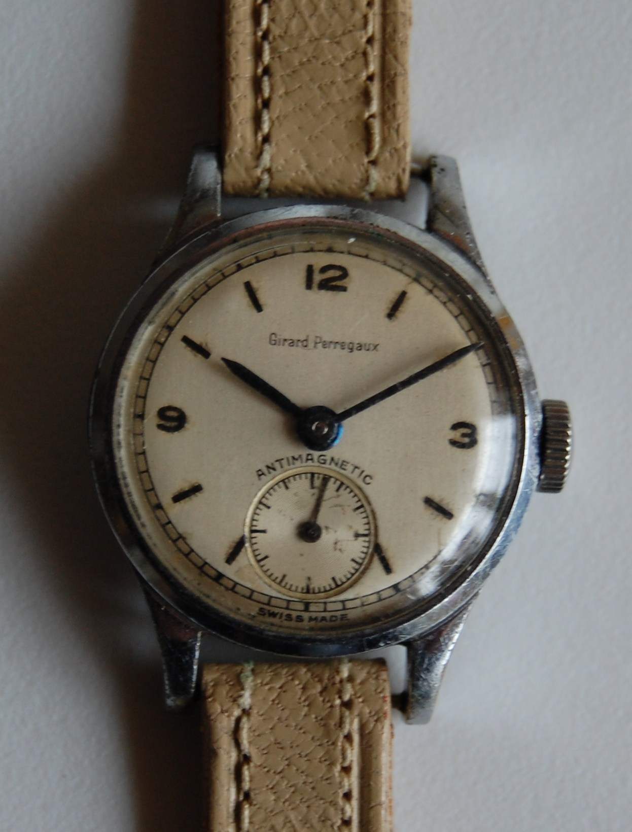

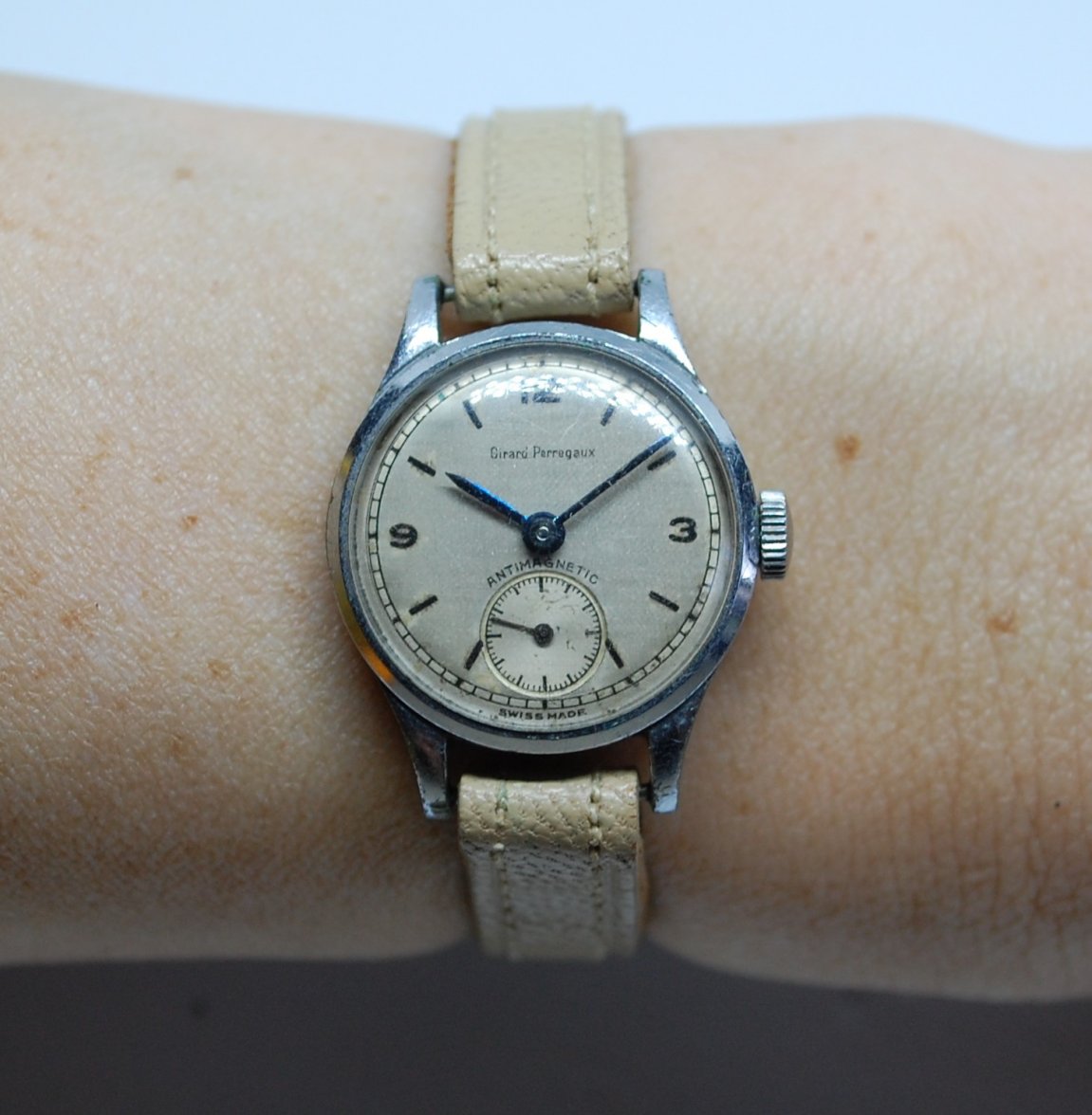

Hello! I'm looking to buy this watch. It's a watch from circa 1949, with Girard-Perregaux 82 ( Peseux 220) movement but with extra detailing and 17 jewels not the fifteen as standard
Width with crown 25.1 mm
I'm inclined , from my research, to say that this watch is authentic, and the seller has good reviews. I'm just a bit hesitant because I know that the "antimagnetic" on the dial in a vintage omega is a no no. I don't know enough about GP and didn't find enough information to say with absolute certain that this is common in GP watches.
If you could be so kind to help I would be very grateful!

The antimagnetic is OK for GP dials.
However I suspect a redial has been done due to the missing hyphen, Girard-Perregaux is a hyphenated name.
Also the sub-dial appears off to my eyes and the antimagnetic text curve doesn't follow the periphery of the subdial very well.
The middle "AG" in ANTIMAGNETIC looks pretty far off. The second A is different from the first.

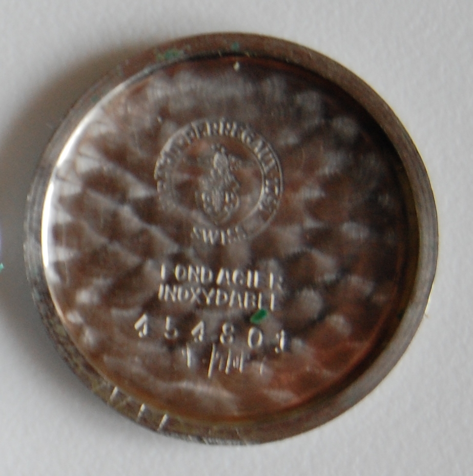

What everyone else said. And all that rust/green oxidization in the first photo. Yikes! 2nd time I’m doing this tonight, but a much cleaner/cooler GP available for sale on this forum right now.

Thank you all for the help! Such a shame, I really liked the overall look of the watch...

I'm not doubting your expertise, I found this scan from the 1940 US catalog, it doesn't appear to have a hyphen. Just wanted to know if is true for future and current knowledge.
But yes, the dial seems to be a redial. Some of the hour marks, looking closely seem a little ink blurred

I saw some GP that seemed legit without the hyphen but I did not inspect everything..
Nonetheless, even if there are some without hyphen, there is enough proof on that one to tell it is a redial
