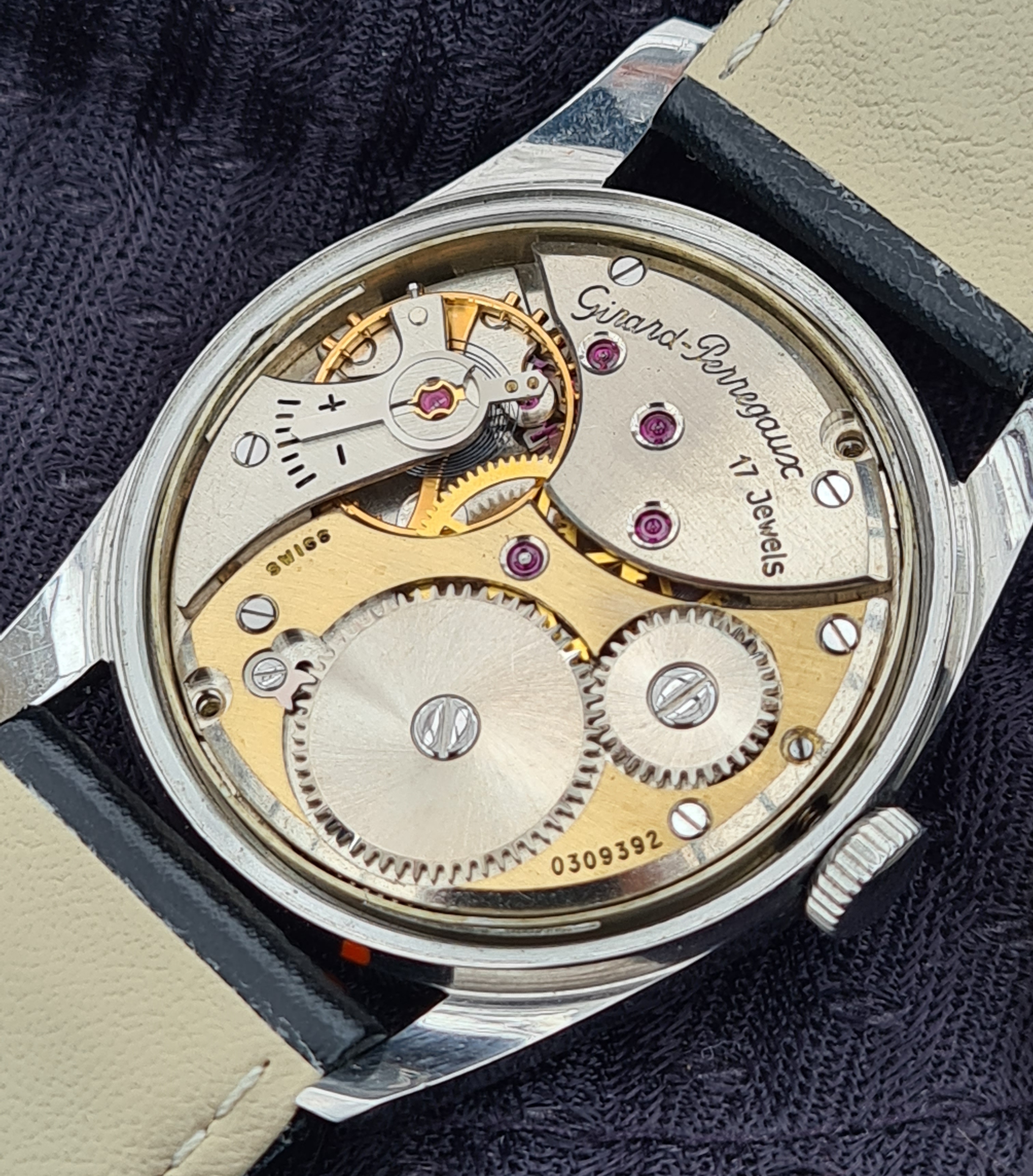

Girard Perregaux two coloured movement?

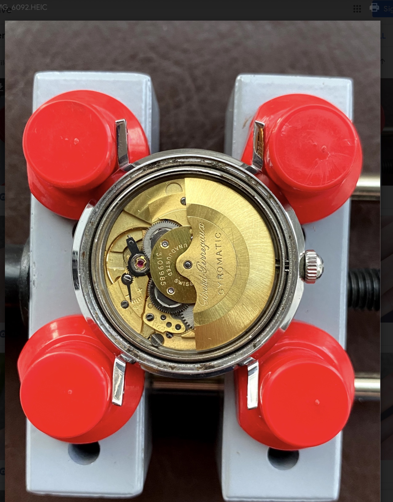

GP movements can be very attractive. This is my Gyromatic

Some GP movements are gold-plated, most are not. Looks like you have a replaced bridge, but I don’t think it is gold-plated.

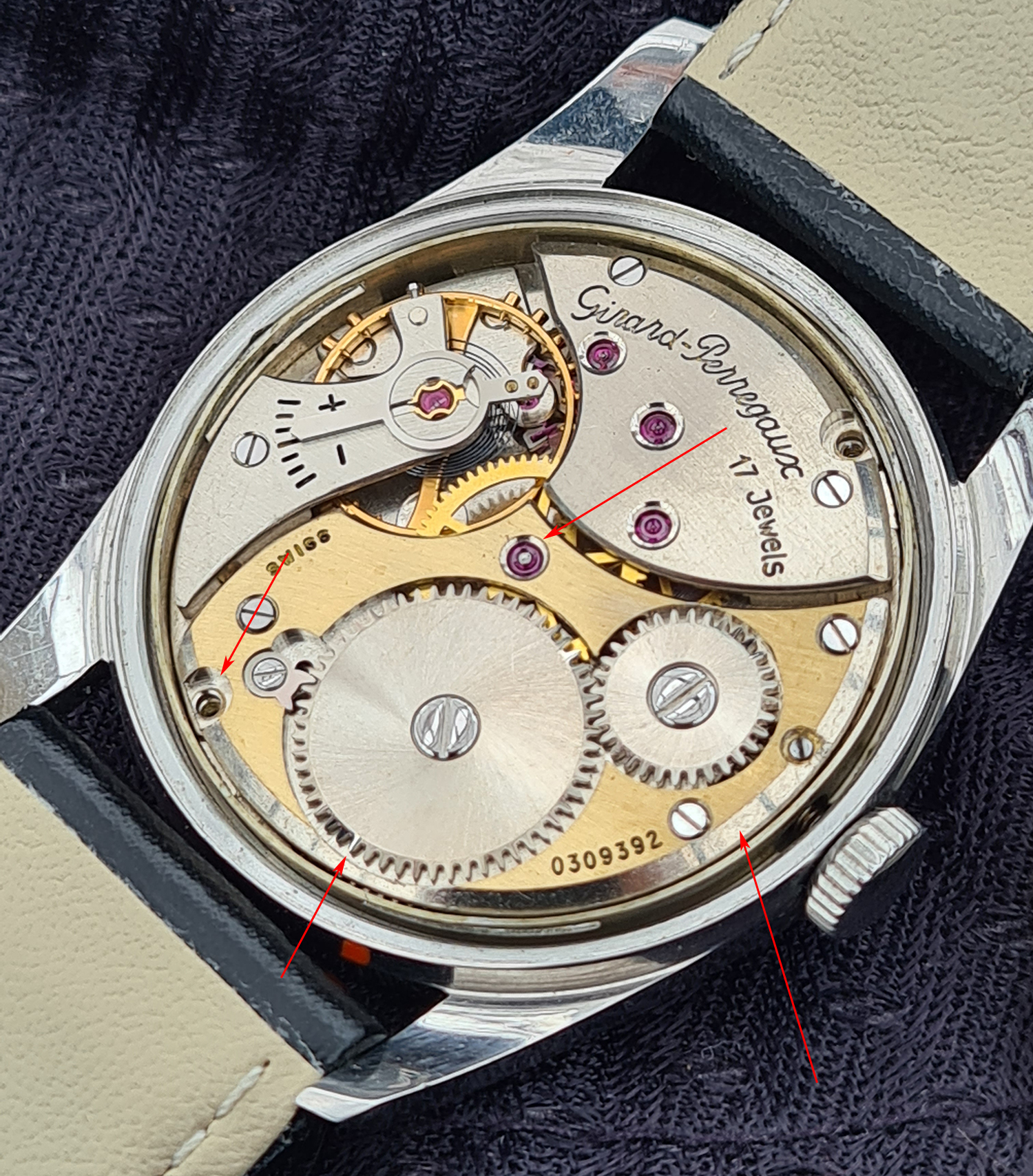

That was my first thought, except you can still see traces of the plating (probably rhodium) on the "golden" bridge.
Strange.
13,636
18,994
My thought is that the part was from another, similar movement, where the bridge was harshly cleaned. The nickel plating looks damaged, showing the brass underneath.
Either way, it's a bit of a frankenwatch.
Strange.
Perhaps this golden bridge was done by purpose at the factory. There are other movements from Girard Perregaux with two coloured bridges on automatic movements.
