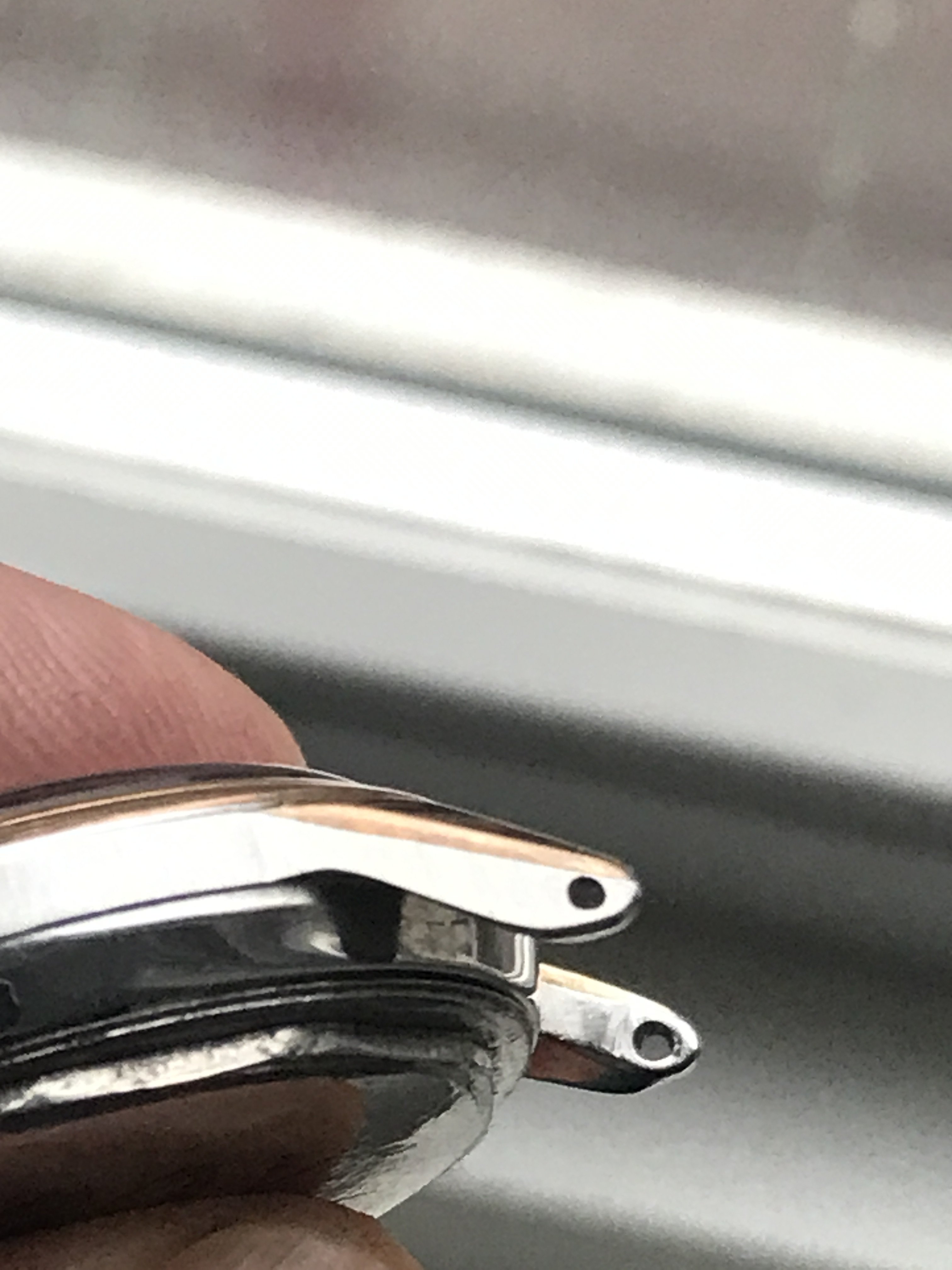

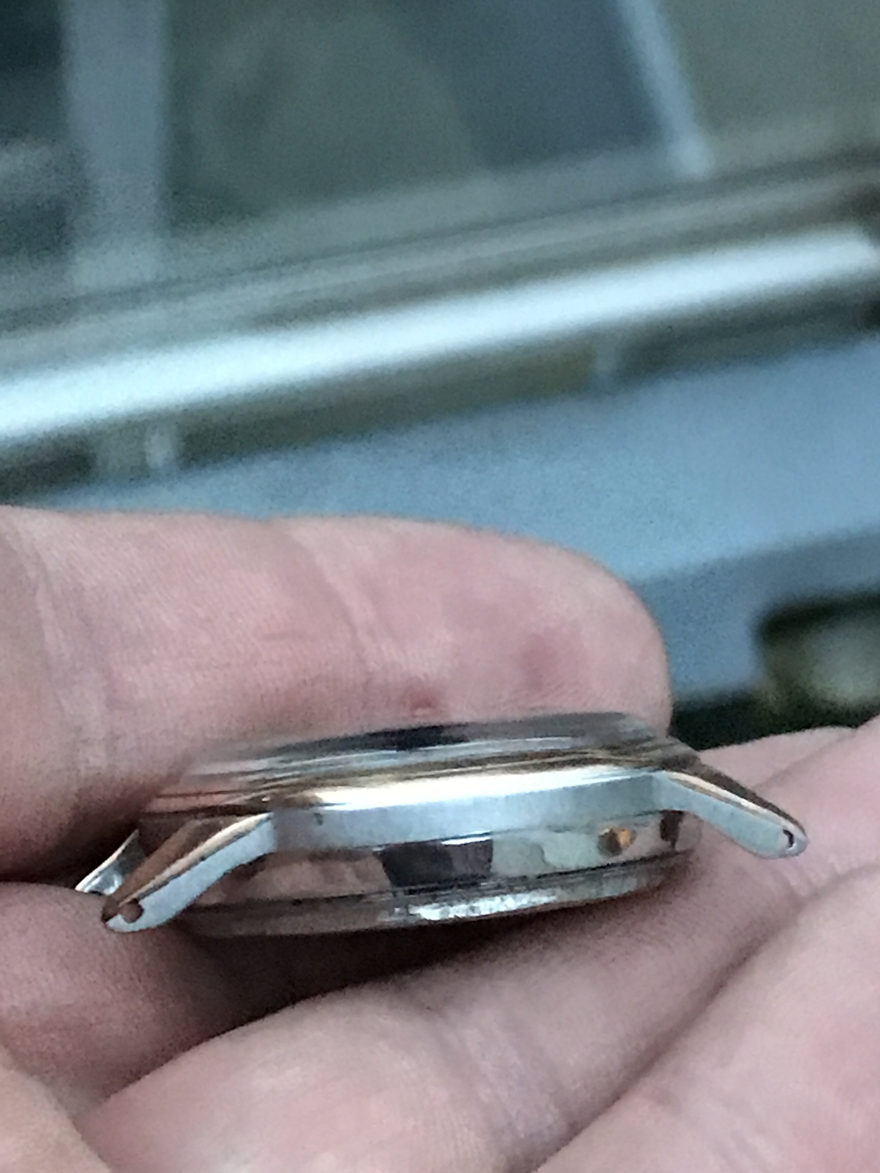

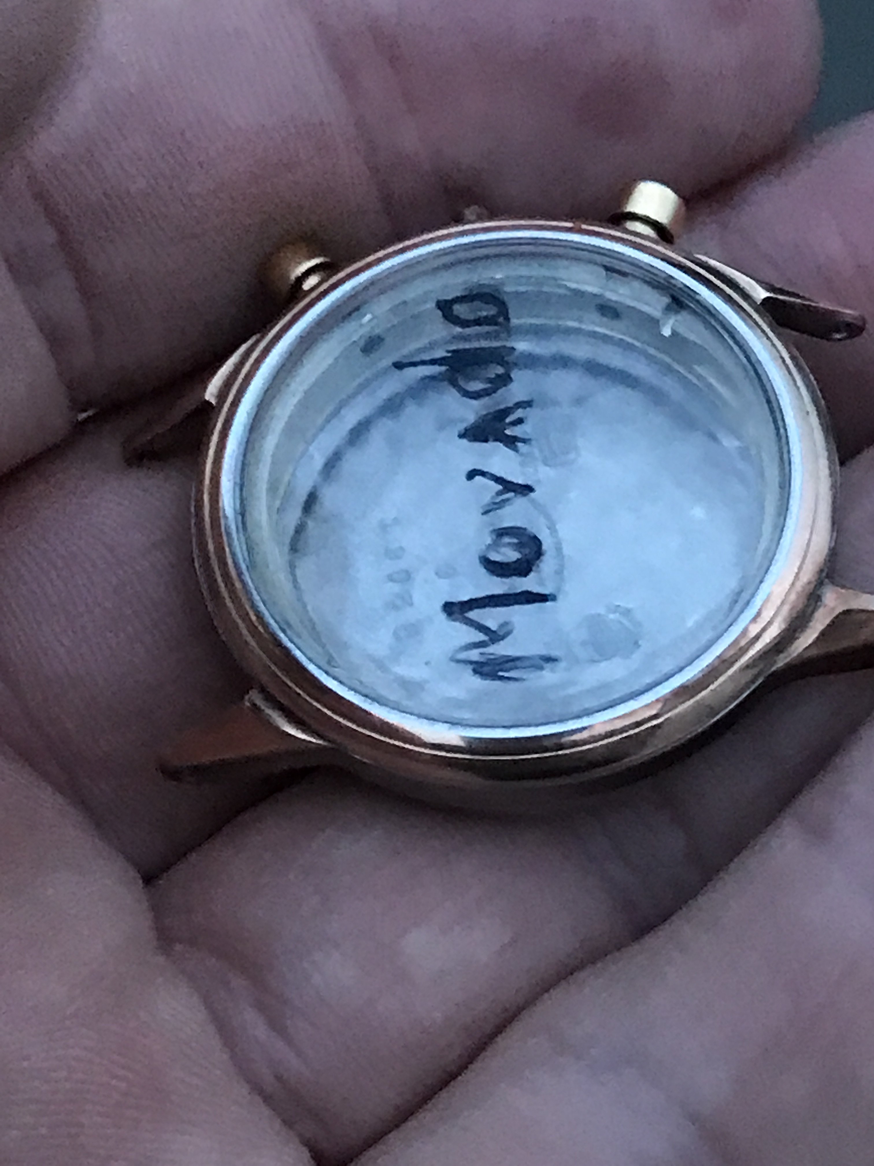

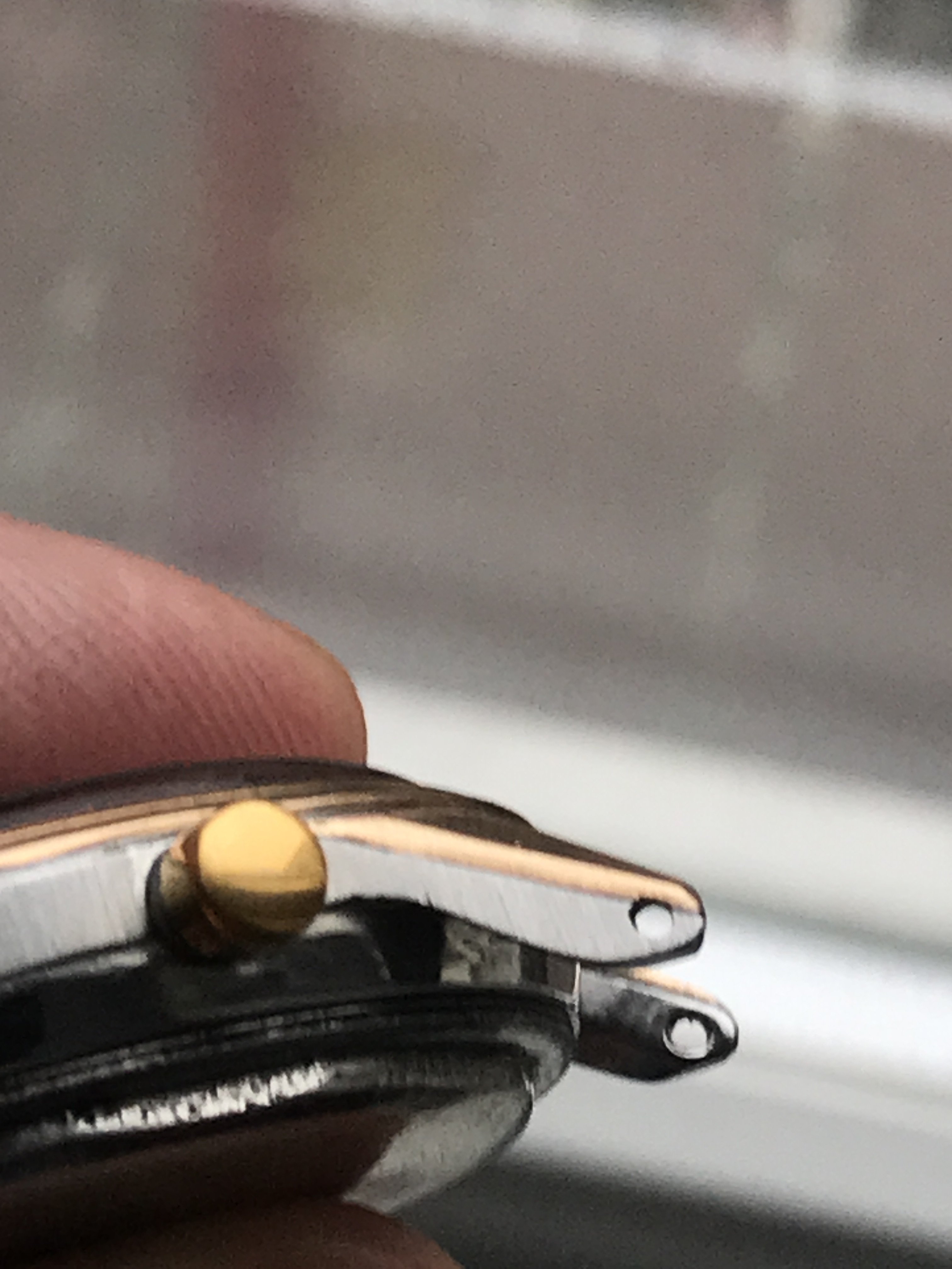

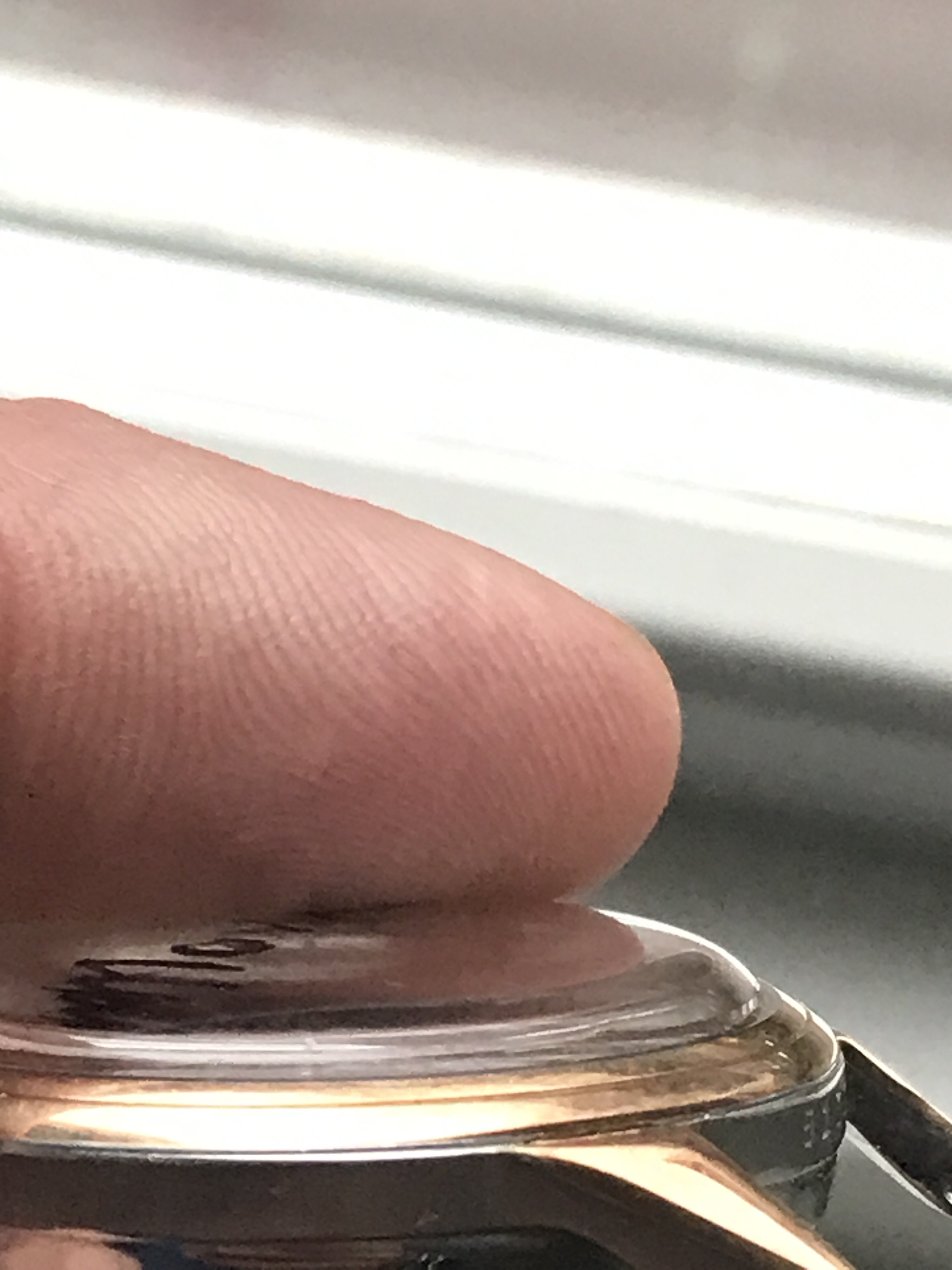

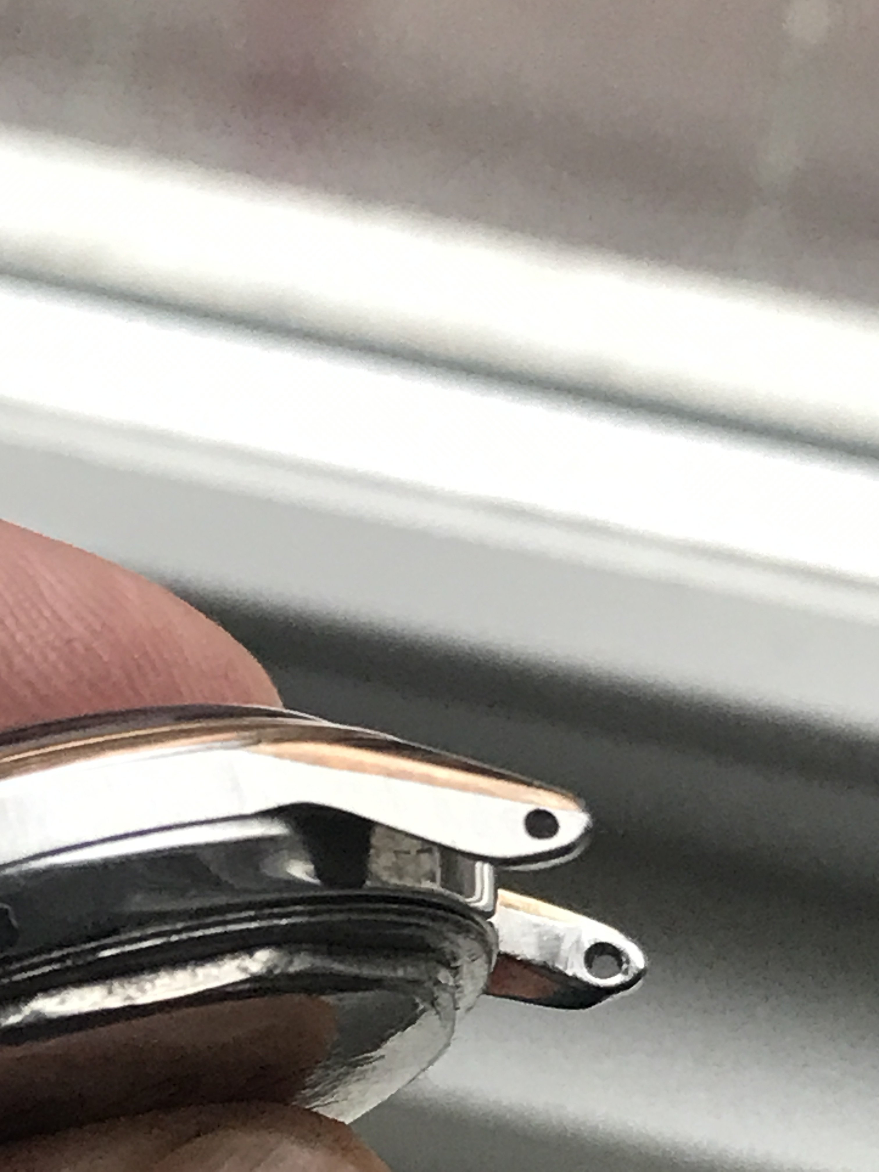

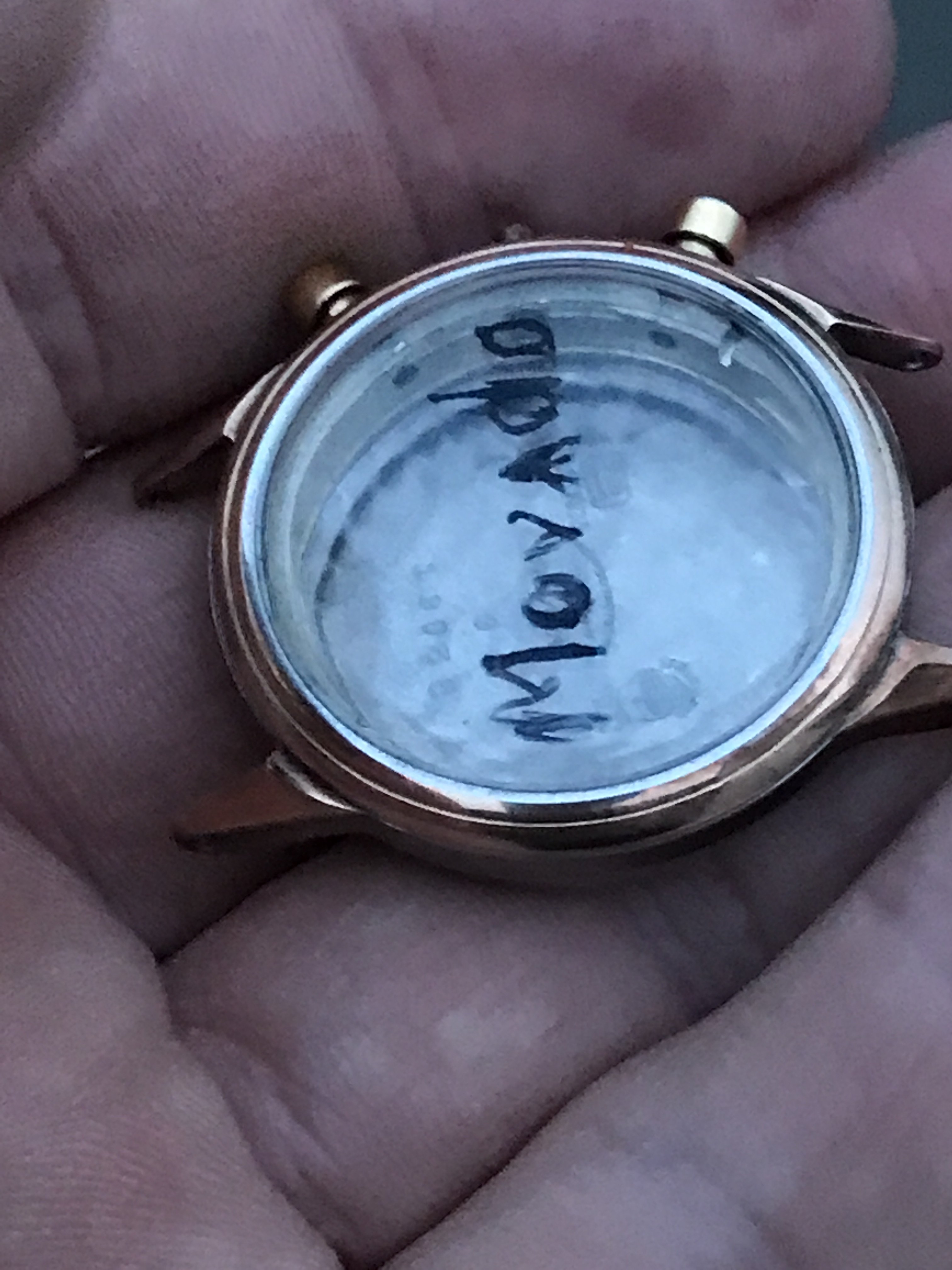

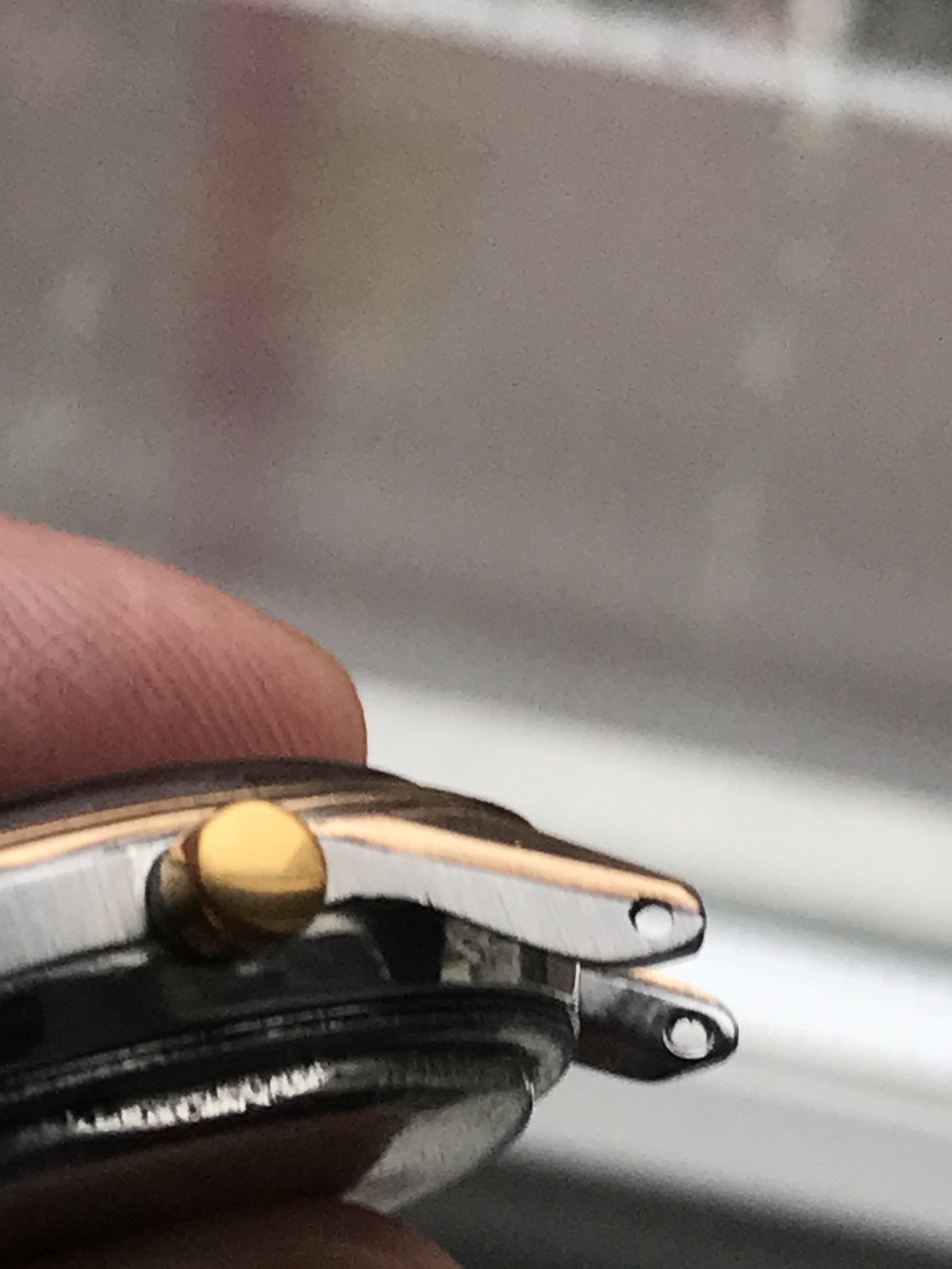

Just acquired one and want to make it a SS one. Anyone an idea and/or T&T's?

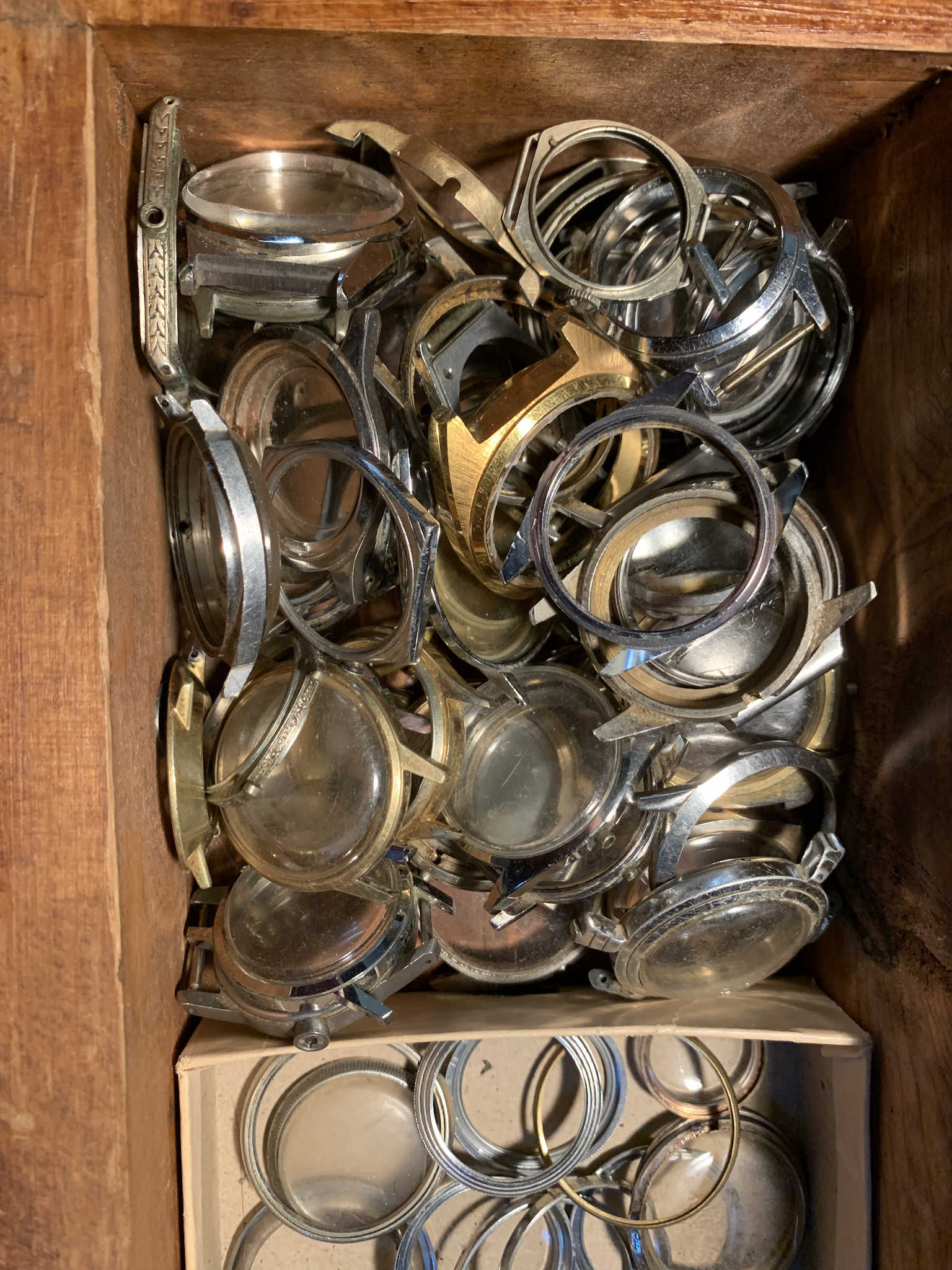

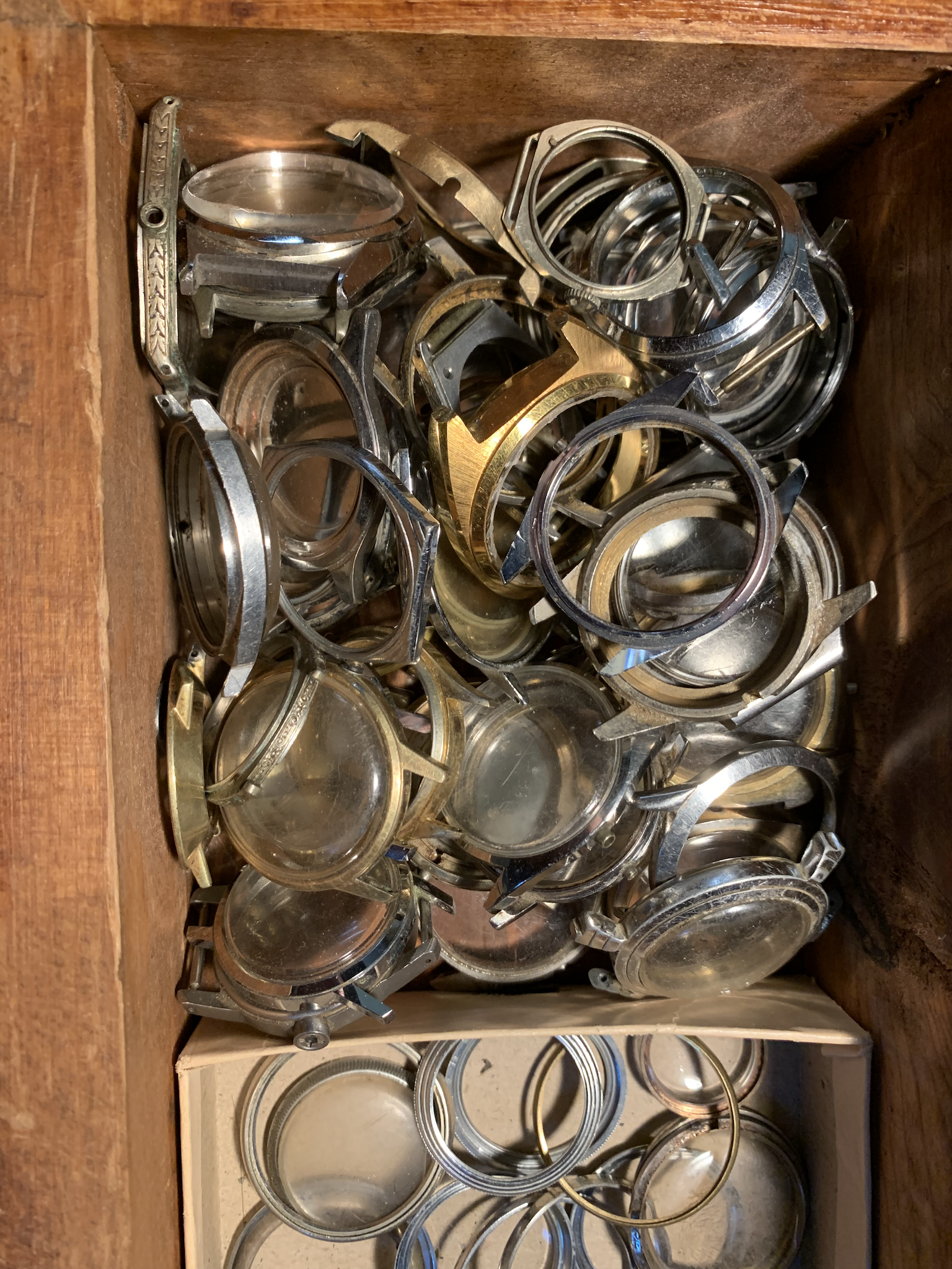

I would also not reccomend starting with this case. Here is a shot of cases I have collected over the last 30 years or so.

What ever is done, I recommend practicing on scrap cases first. If this is a one off, just look for another case and enjoy this one for what it is.

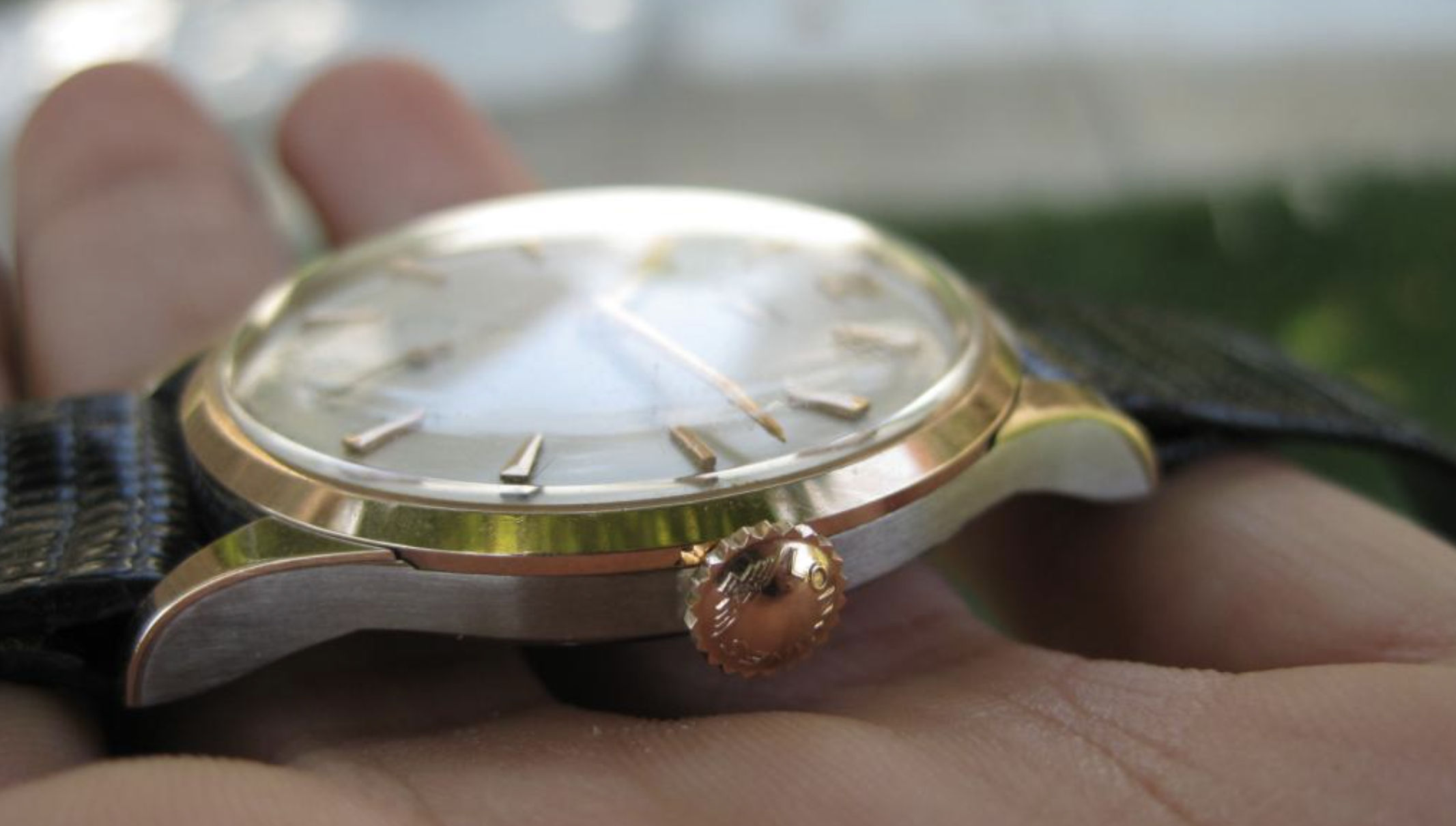

It looks like a gold shell case to me. Thereby, the layer of gold is much thicker than I either rolled gold plate, or gold filled. I suspect it may be necessary to heat the empty case to the point the gold solder used to fuse the gold shell would melt, allowing the overlay to be removed. The gold shell covers the bezel as well as all four lugs. You could ruin the case doing that! Maybe consider rhodium plating the case. Temporary, but a means to an end. Being your case is from a chronograph and you have the buttons to contend with, it is my opinion that what you have in mind is not possible. Let us know.
2,968
6,324
That looks like a "gold capped" case. Seems a shame to want to remove the gold, since it's probably a solid gold layer and gold capped cases are somewhat uncommon and cool (in my opinion). The bezel may, in fact, be completely solid gold.
Even if the bezel was not solid gold, to remove the gold would be to significantly change the shape of the case in a way that would look unnatural. Looks to be structurally supporting the spring bar holes as well.

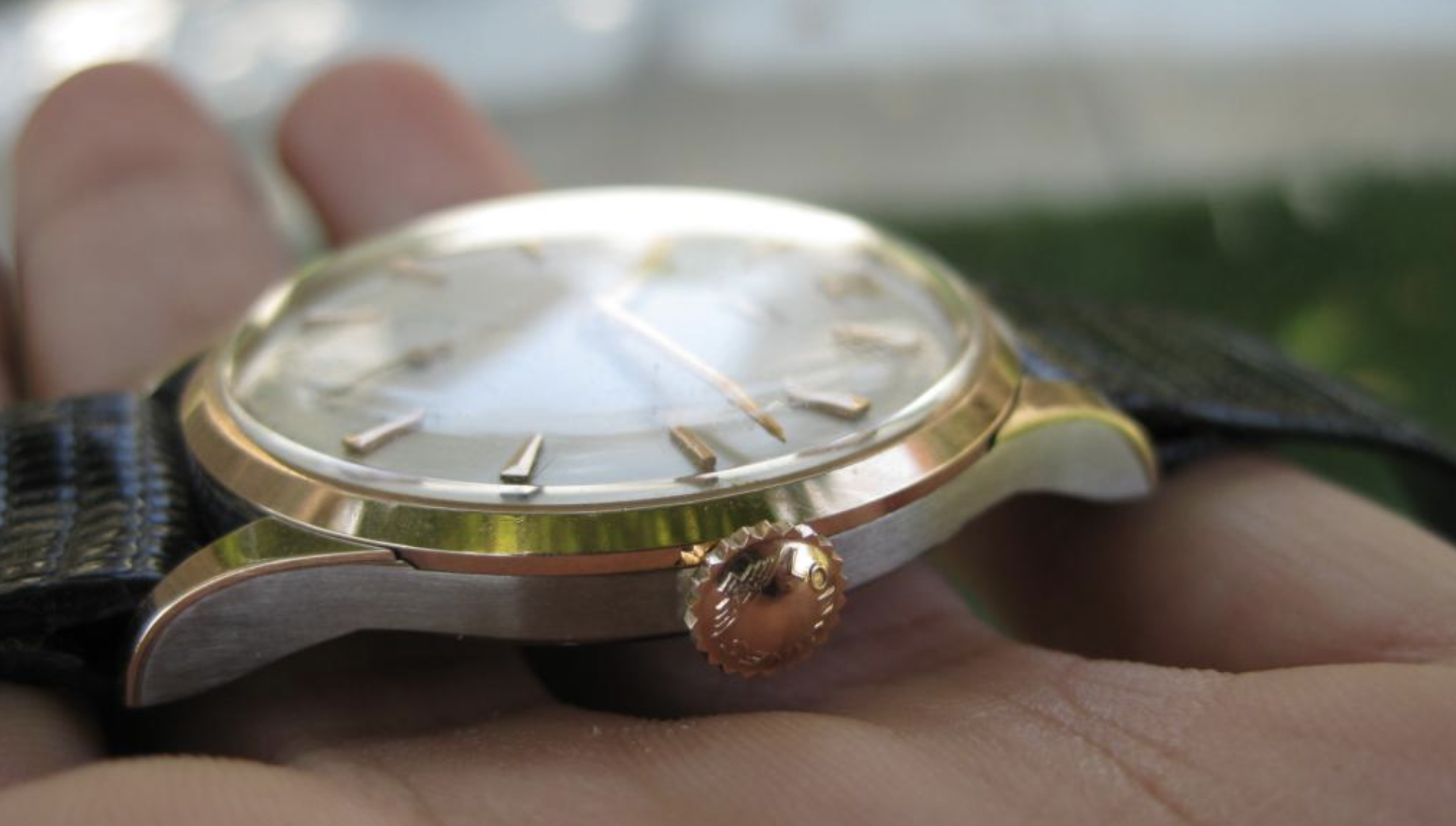

Here is a Longines with a gold capped case I use to have.

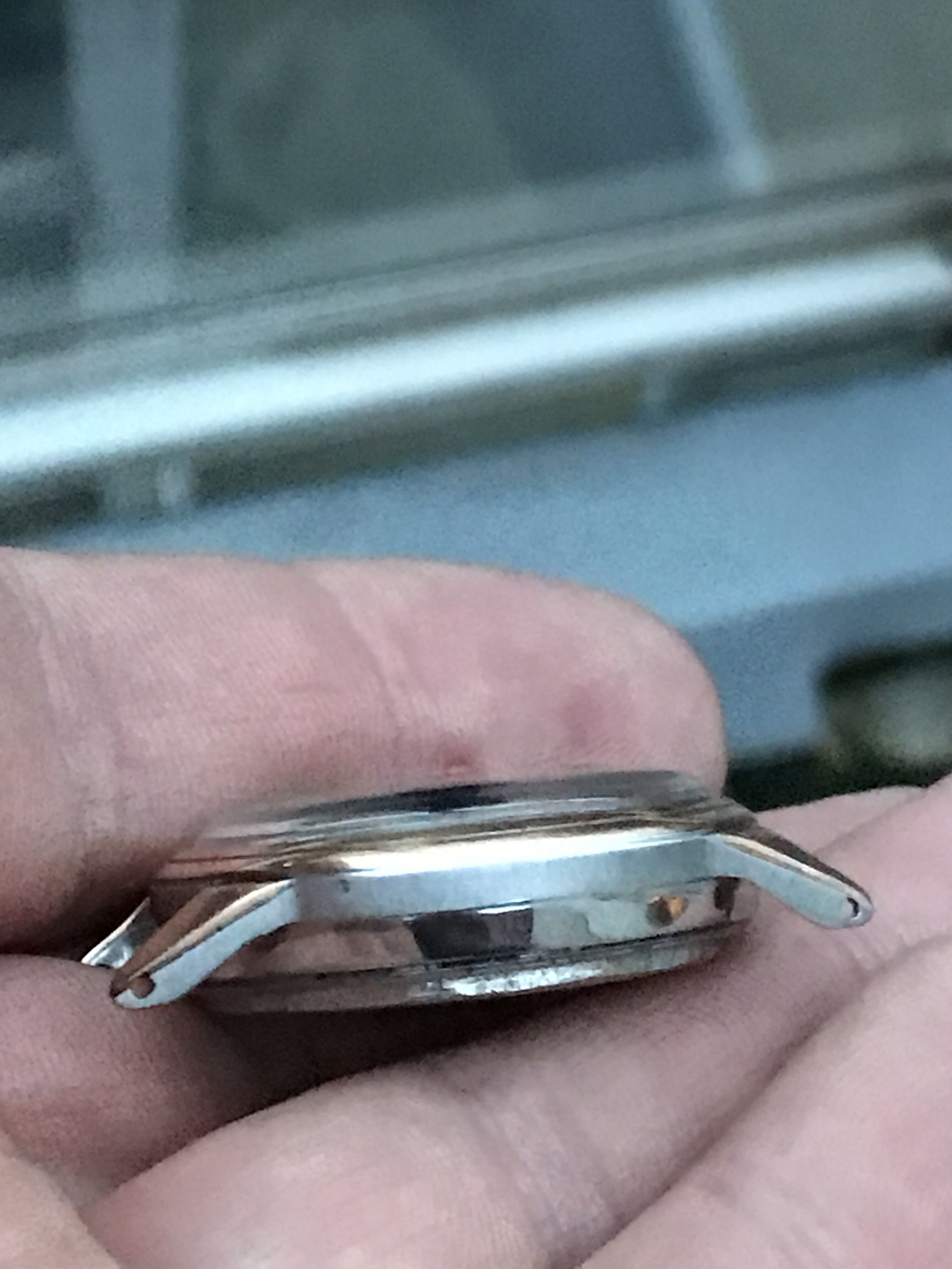

I'll have a better look to see whether it is capped

It is indeed. Complicating factor is that the movement + dial I have do not match so I think this case will end up in the parts box anyway
