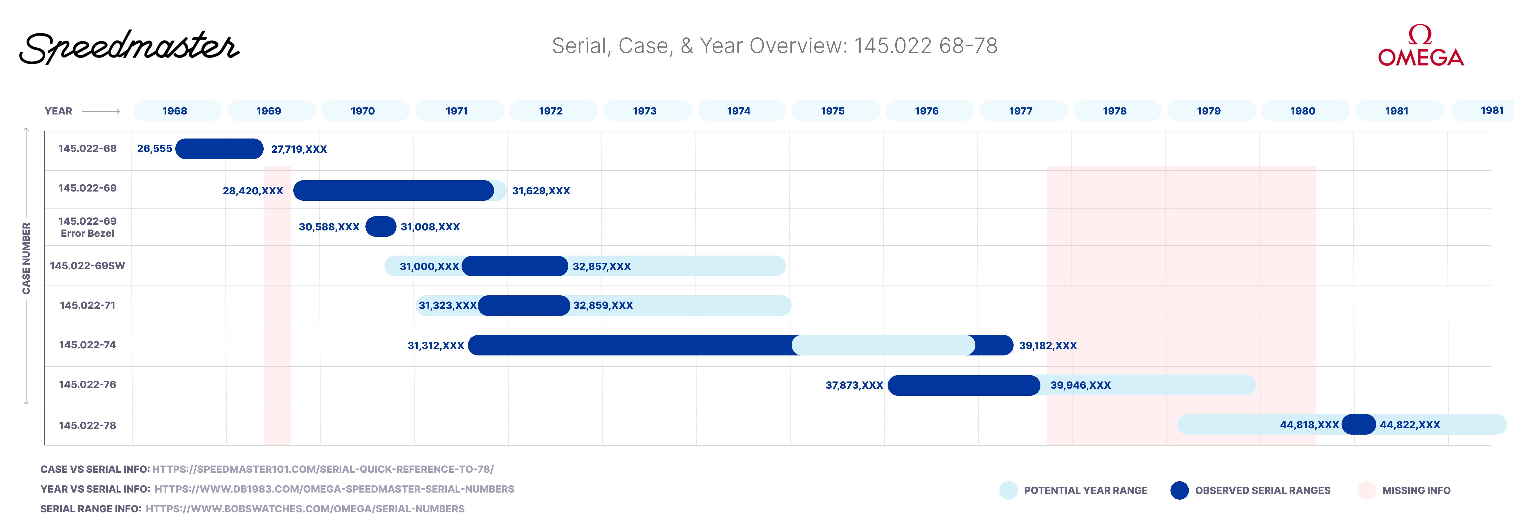

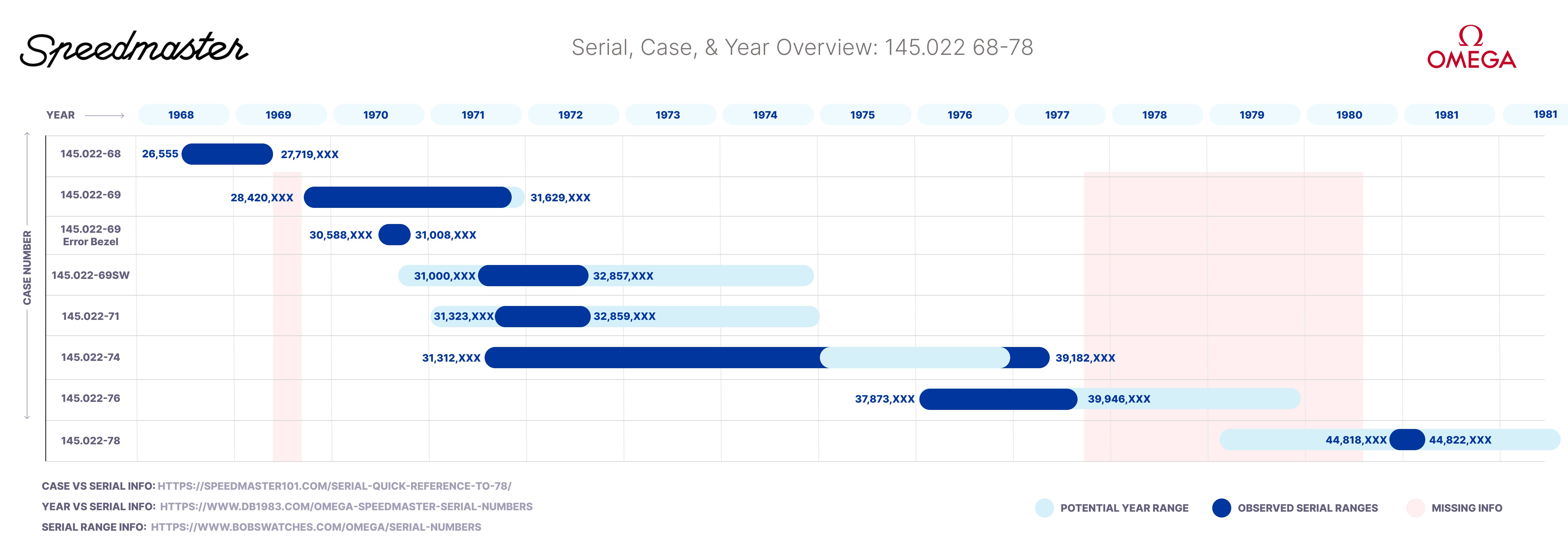

Another question... Do the serial numbers follow each version in groups, or are they mixed up? For instance, do all of the DON version serial numbers predate the DNN versions, which then all predate as a group the 220 error bezels, which then predate the straight writing versions? Or are they muddled up such that each version can be found legitimately in a serial number range of other versions?
I suspect that the 861 movements were probably produced in batches, but there was presumably overlap between bezels and case-backs.
678
5,570
Once upon a time I tried to make sense of the chaos by putting it in a more accessible format... I got this far before realising the futility of the endeavor...
